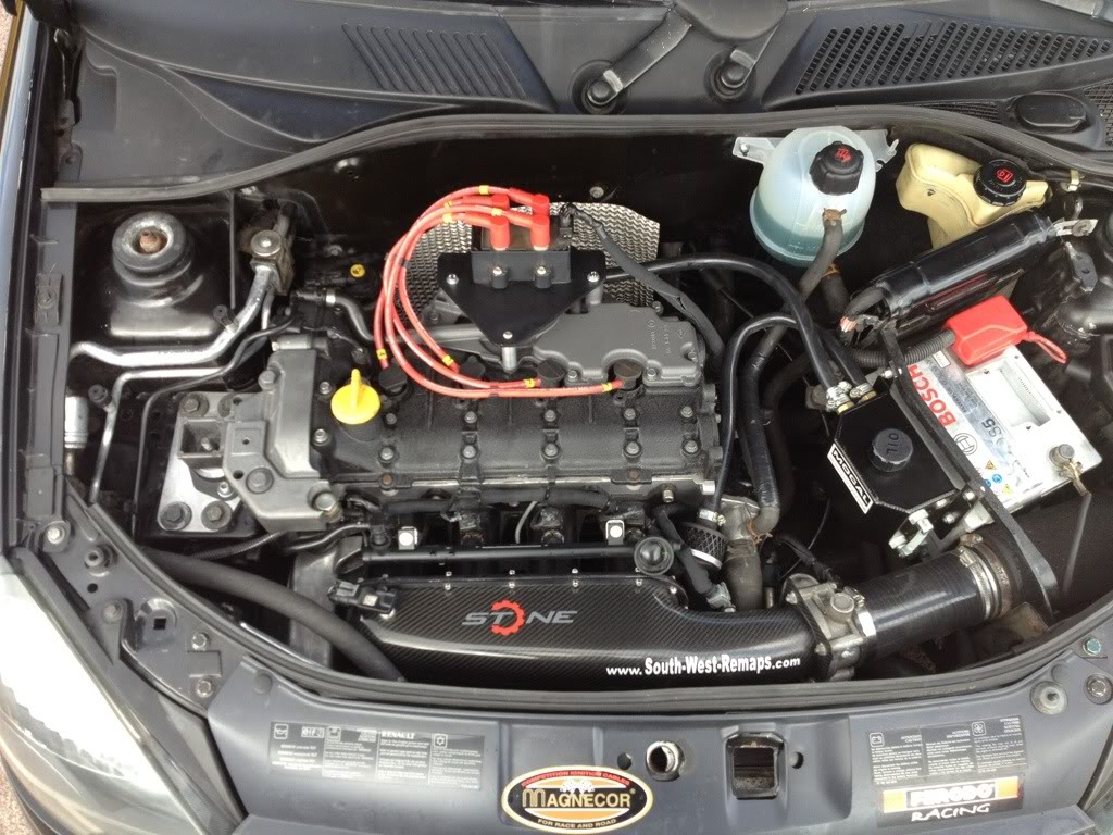

Here is ours if its any help:
(full size here: http://s7.photobucket.com/albums/y251/chip-3door/clio/?action=view&current=5ec7a29c.jpg )
Only pipe I can think of not very visible in that one is the servo pipe which goes into the back of the manifold into a 90 degree push fitting.
Unless you mean the beather pipe, which isnt connected on the RS2, it should go to an external catch tank or a filter.
Yes, it a small pipe and goes down to where the acoustic valve is.

1- when I spun our injectors around for our custom inlet manifold I spun the clip too. That away the injector hole still lines up with the clip. Only the tang is missing then on the fuel rail that the clip keeps aligned on. Swings and round abouts really. After the rail is bolted down the injectors going nowhere.
