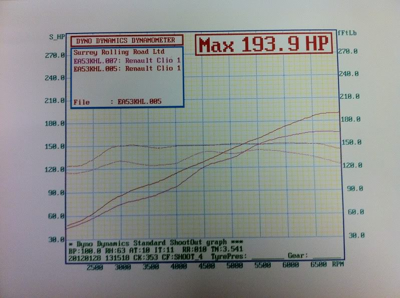

Was just talking to James and charlie has dug out the before graph for -J-
Thats standard car compared to rs2/decat/exhaust/remap
Quite a difference, I assumed his was going to be one of those freaky standard cars that make big numbers, but it was not particuarly going by that!
25lbft gains for a big chunk of the rev range, 25bhp or so extra, and not one single rpm anywhere it didnt make good gains in both torque and power.
Certainly impressive!

Would a 172 typically be looking at the same sort of outcome? 190's+
or are all these tests on 182's?
Cheers,
Aydon
  182/RS2/ Turbo/Mk1
That graph you just quoted is for a 172 cup mate.
I wouldnt call it typical though, I think thats one of the better responses that the RS2 has had so far.

Result, glad Charlie found it for James, nice to see the standard car vs the RS2 over laid :)
Will have to get a copy sorted when I finally get the mapping sorted!
  182/RS2/ Turbo/Mk1
If it can just make 4lbft more at the top you will have 200bhp, and it "looks" possible it could do that from that graph if the VVT didnt turn off.
-J-
  RS2'ed 172 Cup
Will have to wait and see!
Tbh I'm happy with the unmapped figure so anything more is just a bonus.

It is impressive - but it's completely useless without a graph with just the decat, exhaust and remap as well so you can see just how much difference the RS2 made ;)
  182/RS2/ Turbo/Mk1
Well its not useless, it shows people what they will get from their standard car potentially if they go for the same mods. Perfectly valid before and after test for the whole setup of decat/rs2/remap.
To be an analysis of just the RS2 versus a standard inlet and the other mods though you are correct, but trouble is with that, even if James decided to do the test you are saying then you would then get people saying "but what if the remap on the rs2 was better than the one on the standard inlet" etc as any remap done for one wouldnt be suitable for the other, they have different requirements.
  182/RS2/ Turbo/Mk1
Ive seen quite a few examples of the rs2 and of remapped standard inlets etc and IME the best people can really expect from :
Remap / decat / standard inlet
Is a torque curve that starts low, builds to around 160lbft but is only there for literally a thousand rpm or so, and then tails off, and a peak of around 180bhp
On the rs2 they can expect:
150lbft from the floor right up till amost the limiter, and a peak of around 190bhp
so if you look at peak torque the standard inlet wins, if you look at a useful torque spread the rs2 wins, if you look at peak power the rs2 wins.
They are quite different in how they react, the standard inlet is very very good at around the 5-6 region, but its massively compromised everywhere else in order to achieve this narrow peak torque improvement. The RS2 by comparison does the whole rev range well, but doesnt have one little section it does superbly like the standard inlet.
Amazing how different to drive the cars are from just the one change, and various people will prefer one versus the other.

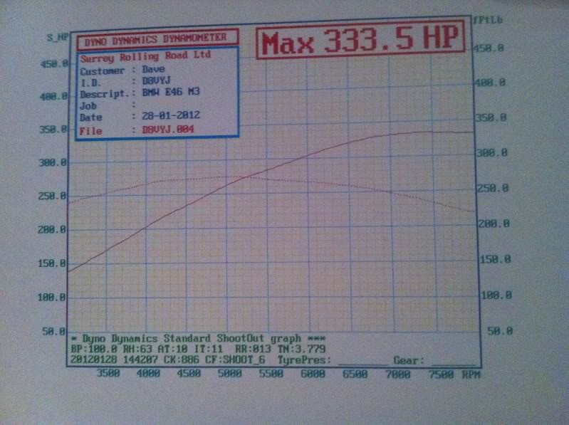

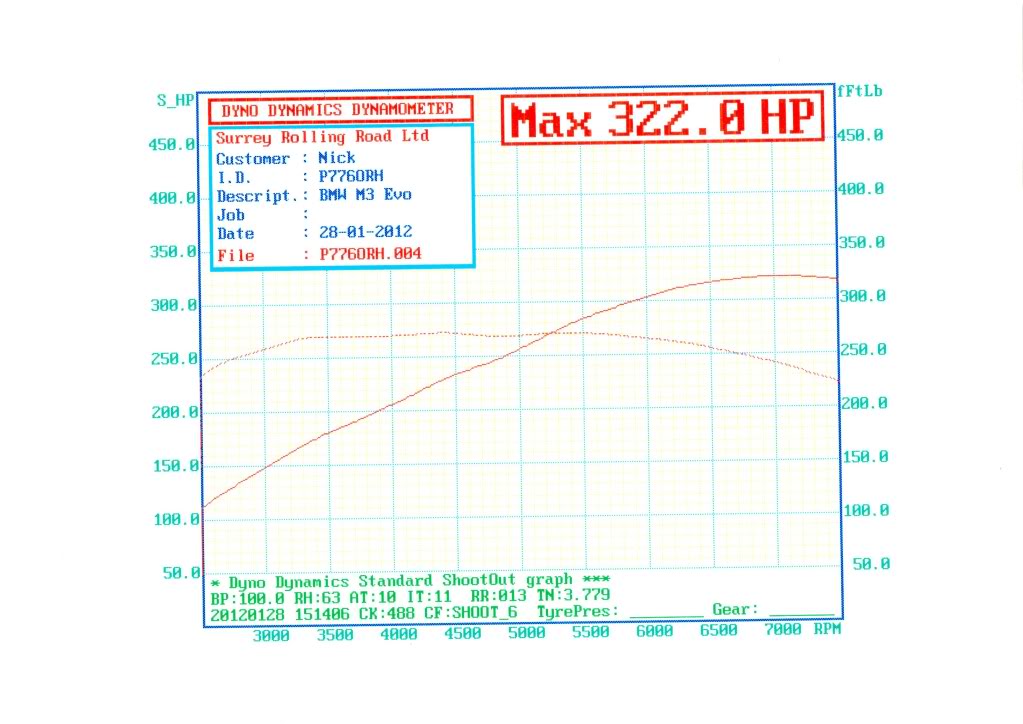

A big long smooth torque curve looks nice - but how does it help on a track car when you never drop below 5k?
Personally I'm happier with this
Loads more torque/power above 5k. As for below it - well who cares if you're driving around at 3 or 4k then you're not really going fast anyway lol

Agreed for a pure trackday car, nothing under 5K matters at all.
On the road though 3-4K is where you are likely to spend a lot of your time.
Dont forget though, in the case of the RS2, it does hold on very well to the torque at the top end where you really want it on track too, at 7K for example, there is only half a dozen lbft between your car and the trophy this thread was about.
I dont think anyone would argue that for an out and out pure track car with cost not an issue that ITBs arent a better solution than an RS2 though, if that is the argument you are trying to have. I certainly would never say that personally.
Only reason i went from ITBs to a single plenum on my williams engine was to allow it into local road rallies, not because I thought I would gain power at the top end.
That BMW engine isnt making much power per liter so easier to keep the torque curve flat than on a cammed up typical ITB car etc.

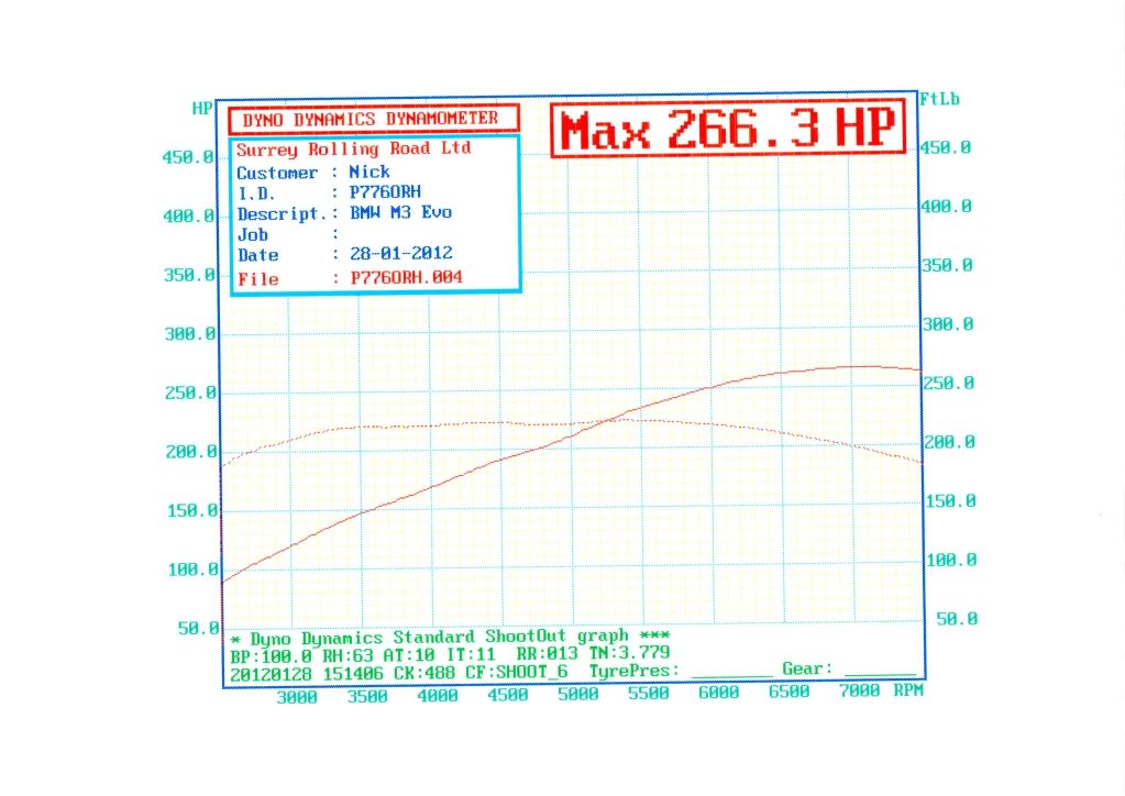

Thats at the wheels Chip, 322bhp at the flywheel from a 3.2 straight 6 with ITB's as standard.
I'm sure you do drop below 5k when on a trackday, i'd actually be amazed to see a car do any circuit other than a drag strip where you'll be above 5k all day long.
It does indeed help as you have much more of a rev range to use rather than having to shift a million gears for corners to be quick. Having that much low down torque and power will save you at least a gearchange and still be on the 'boil' leaving the corner with a shed load more rpm to play with without having to change up a gear.
Is that the ATW figure?
Shame mine doesn't stay around 300 across the rev range.
Indeed at the wheels Tim. Here's the flywheel power graph, not that it makes a lot of difference as we all know wheel horsepower is far better to talk about then pub figure flywheel results! ;)
Indeed mate, only 100bhp per litre, which is the utter minimum you're going to get out of an F4R on bodies with a half decent setup. And TBH for an Evo M3 thats actually quite good, most fall short of the 321bhp book figure and hence are under 100bhp specific output. I mapped a really mild cammed one this week and that did 212bhp for example, easy to get more, although the F4R is a pretty piss poor engine for ultimate power potential TBH, the valve area is rubbish.
I'm sure you do drop they 5k when on a trackday, i'd actually be amazed to see a car do any circuit other than a drag strip where you'll be above 5k all day long.
Generally only if you dont know the track or something goes wrong TBH.I definitely dont ever go under that in my mk1 clio (172 gearbox) round combe for example.If you do go under that, its not going to be for very long.
If you are any good on track, there really is no need to be using the low end of the rev range, thats what a gearbox is for. Even if driving an M3 on track (which like you say has a good torque spread) I wont dip under 5K at all generally.
When dealing with a dyno dynamics the flywheel is just a straight multiplication of wheels anyway, so doesnt really make much difference which you compare if its cars with the same transmission etc.

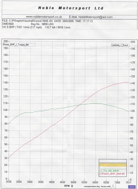

I'm not talking about numbers either. When have you ever seen a 4 pot on ITBS with a flat torque curve. Least not like that
Yes mate, all the time, common as muck.
One of the most commonly converted to throttle bodies engines ever is the C20XE vauxhall engine, Ive got one on bodies myself currently in fact, and working for Total Vauxhall mag I obviously see them all the time.
