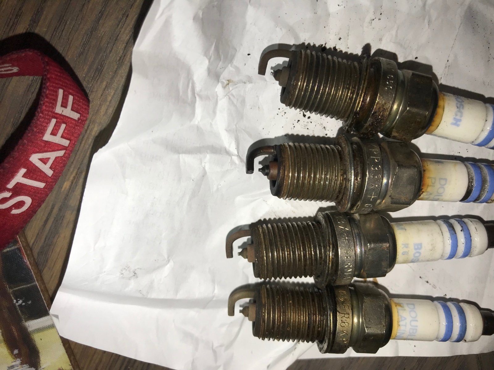

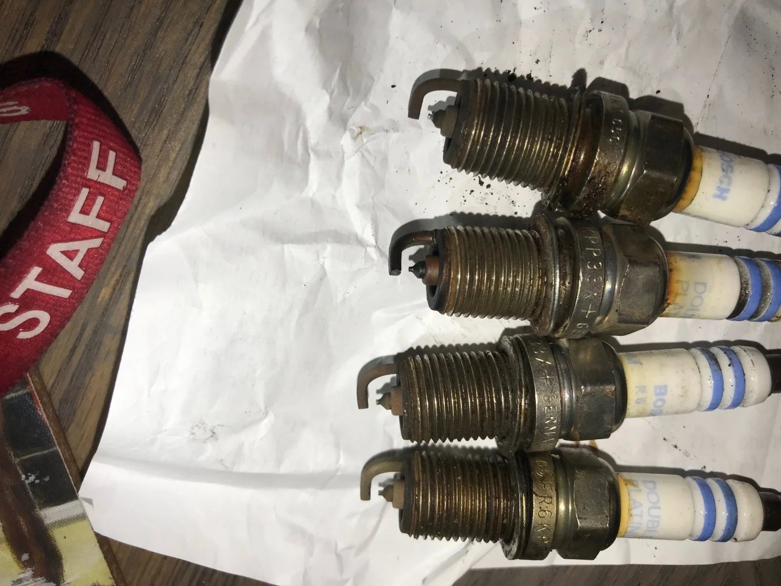

So the issue came back 4 weeks after swapping the ignition coil.
This time took the plugs out and surprise surprise they are incorrect. One of them is slightly darker so assume thats the one with bad ignition lead.
Will change plugs and lead this weekend and see what happens.
