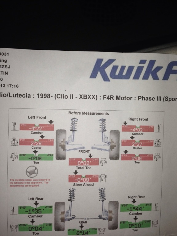

Lol at 1 degree toe out each side Chris

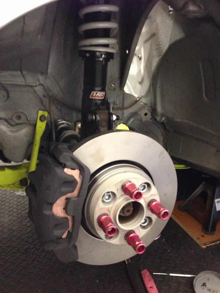

Do you know what make your front spacers are - I quite like the fact they seem to have steel inserts in them rather than just being alloy
If you have slotted holes for camber in your struts. DO NOT use camber bolts, they will move.
If I used the top mount for camber as well, I could get about 6deg's, so don't know who told you that.
Sorry Tony i must be having a blonde moment, AST top mounts say they can only offer a further 1.4 degrees of camber, and standard mounts with camber bolts is 1.5degrees, (i think) so just under 3 degrees total. What am i not getting?![]()
