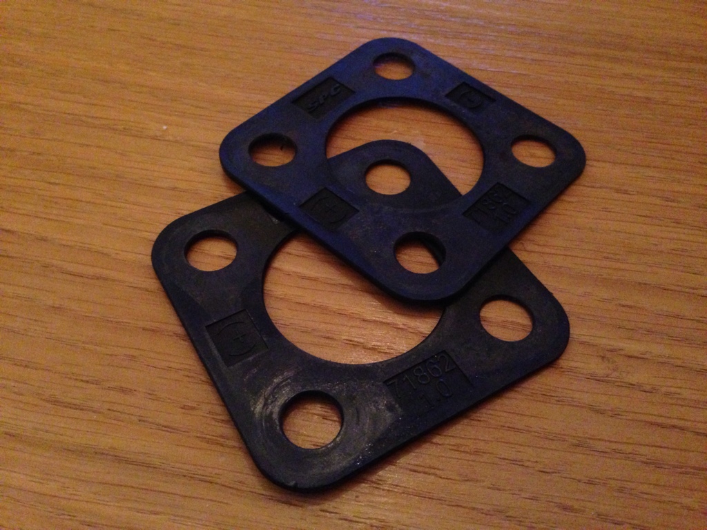

The car handles very well but its when i'm going really fast round the corners it understeers a little and i'l like it to be a bit more aggressive on the turn in! I will try one thing at a time i recon. So i'll stiffen up the rear AST's and see if that helps!

Try some toe out on the rear if you really want it to turn in better!! I have run shims on the back of mine to put a very small amount of toe out on mine and the results speak for themselves! You look like some kind of drift hero as well! Lol!
From the factory they run quite a lot of toe in. Even a small reduction in this improves them.
That's quite interesting - I have some toe shims from K-Tec I was going to try on the rear but they're cheap plastic things and wasn't sure if they'd make much difference
yes they do, thats why I asked. Even parrallel it would be better. But what do I know.

So these are 1.0deg camber shims which i will use on the rear to give me some toe out! Hopefully this will improve my turn in :)

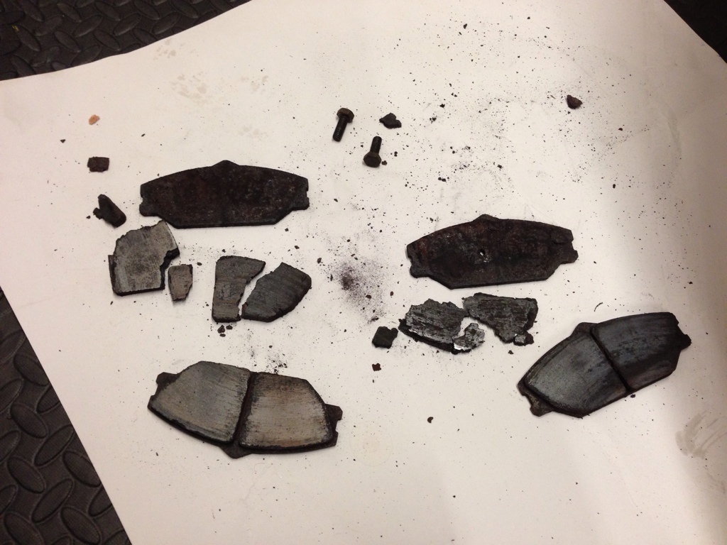

On another note, friday i get the car its wash after its trackday at Oulton Park a few weeks ago and started to give the car the once over to check everything. Upon looking at how much brake pad was left i noticed they had crumbled away on the inside pads!!! So i had to remove them for further inspection.
So as you can see they have fully had it! So i will be looking to replace them. I want a fully race brake pad and may go for Performance Friction or maybe another set of CL's
The discs are worn a little funny too so i might have to replace them too :(

There was plenty of life left on the outer pads but the inside ones had crumbled away!
They have served me pretty well to be honest.

But it still they shouldnt fall apart!
I will buy a new set of pads and a set of Brembo HC's this time as i really dont need the Max's
Dmallett, i just put a 1mm think washer in the bottom iirc. but i will be using these shims for Toe out.
