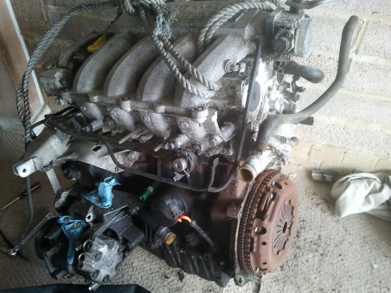

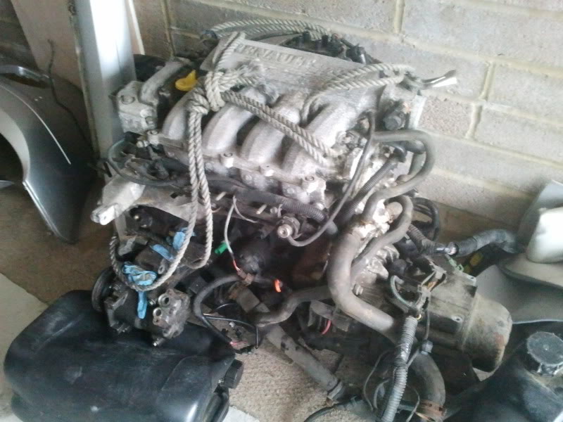

The engine came pretty complete, with inlets, coilpack, loom, coolant hoses, PAS pump, air con pump, exhaust manifold - you name it it had it, so once back home I stripped off all the bits I didn't need.
Here is my filthy 'new' engine:

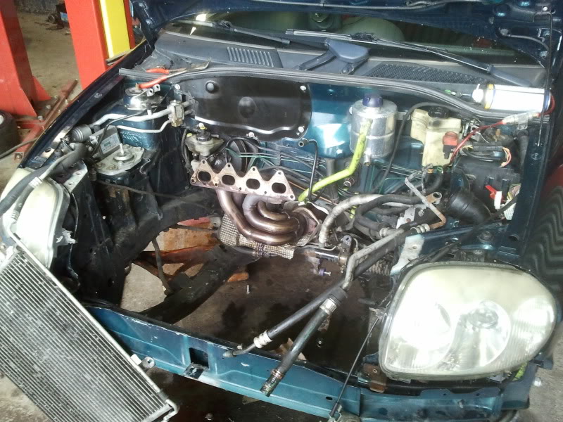

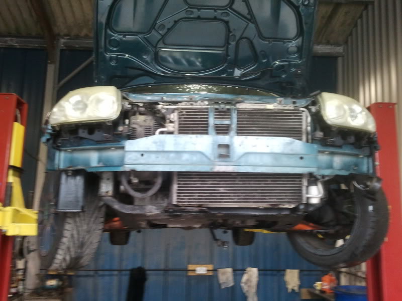

Once I had arrived, we cracked on and the engine and box was out in an hour and a half, and we then took our time in stripping all useable/better ancilleries off the old engine and fitting onto the new one, once it was cleaned mind you, as it was filthy!

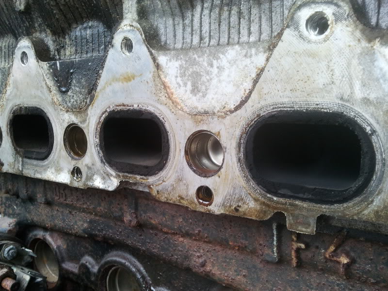

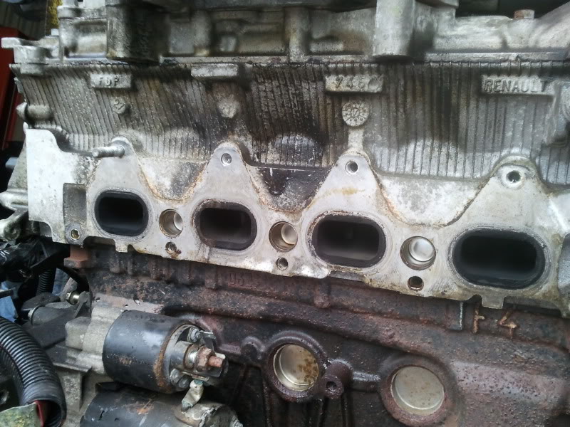

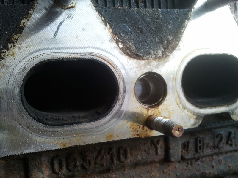

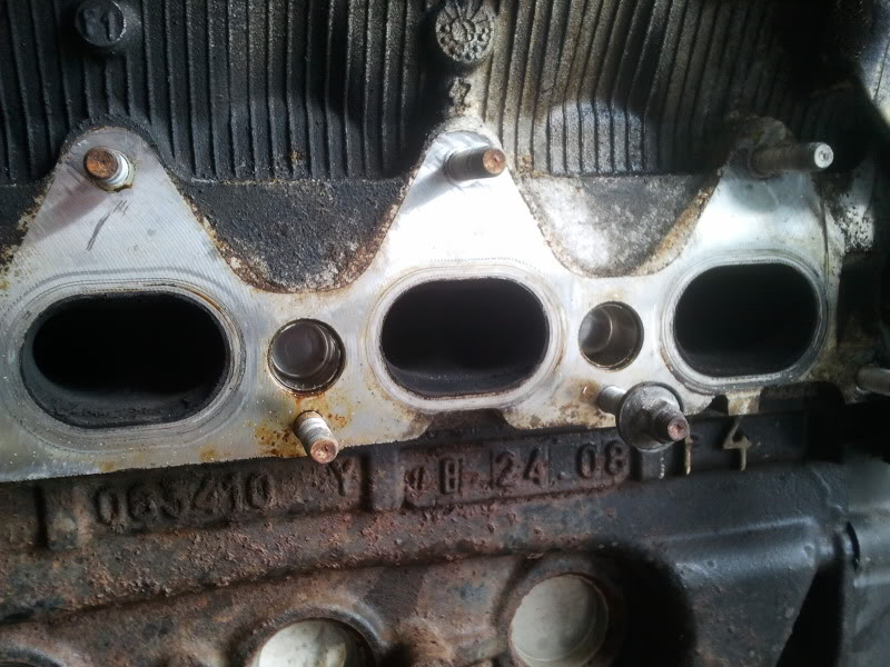

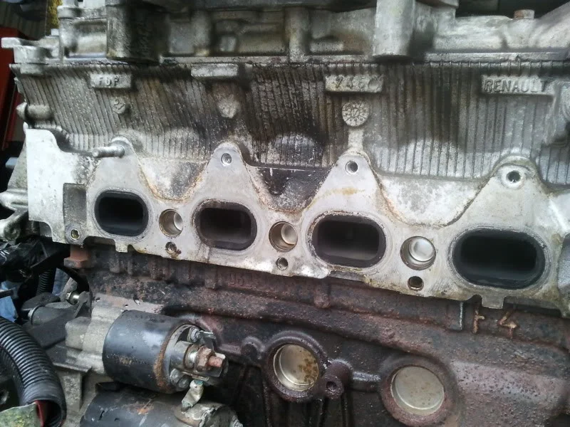

Another interesting thing we found, as soon as we pulled the old engine out, we noticed the size of the exhaust ports - cleaning up the block to check the engine number confirmed it, it was a Ph2 engine!
Here are the exhaust ports of the old engine:
And here are the ports on the Ph1 engine that went in:
So im not sure if this car has had an engine change in the past (From looking at it, how old the bolts/nuts are etc, if it has been swapped it must have been quite a while back) or if because it's a late registered Ph1 and that it's an import that maybe it was a parts bin special, who knows! But a Ph1 engine has gone back in, so thats the important bit
