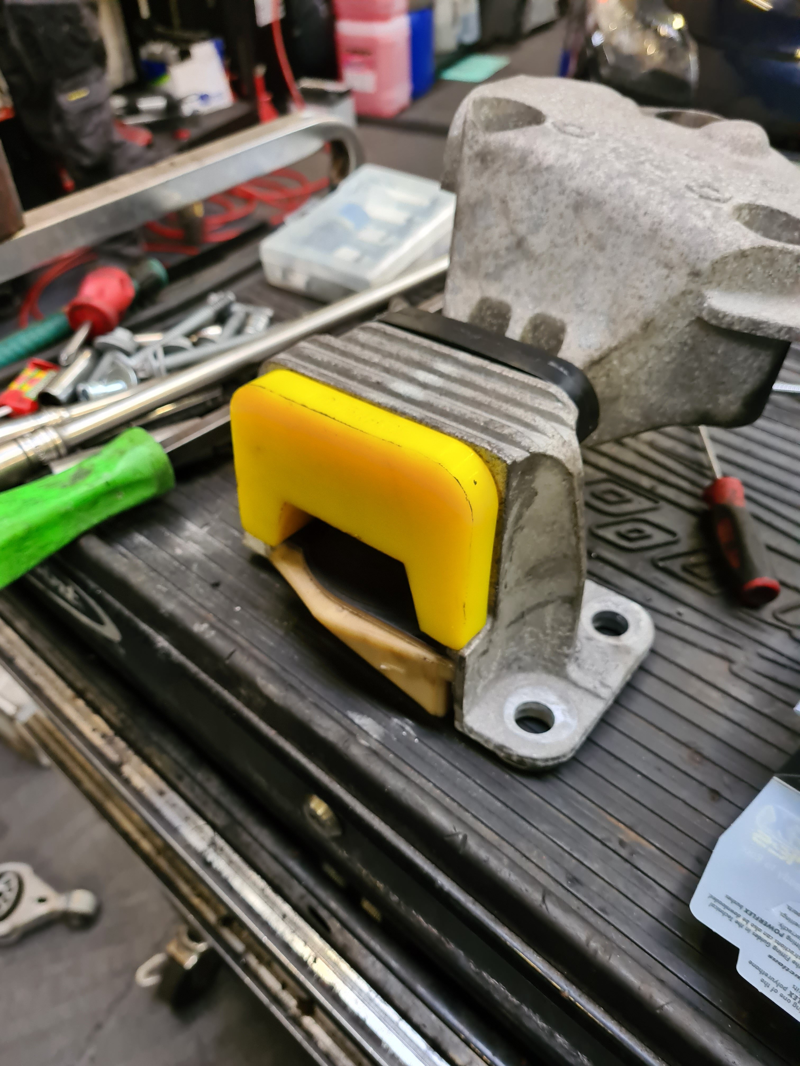

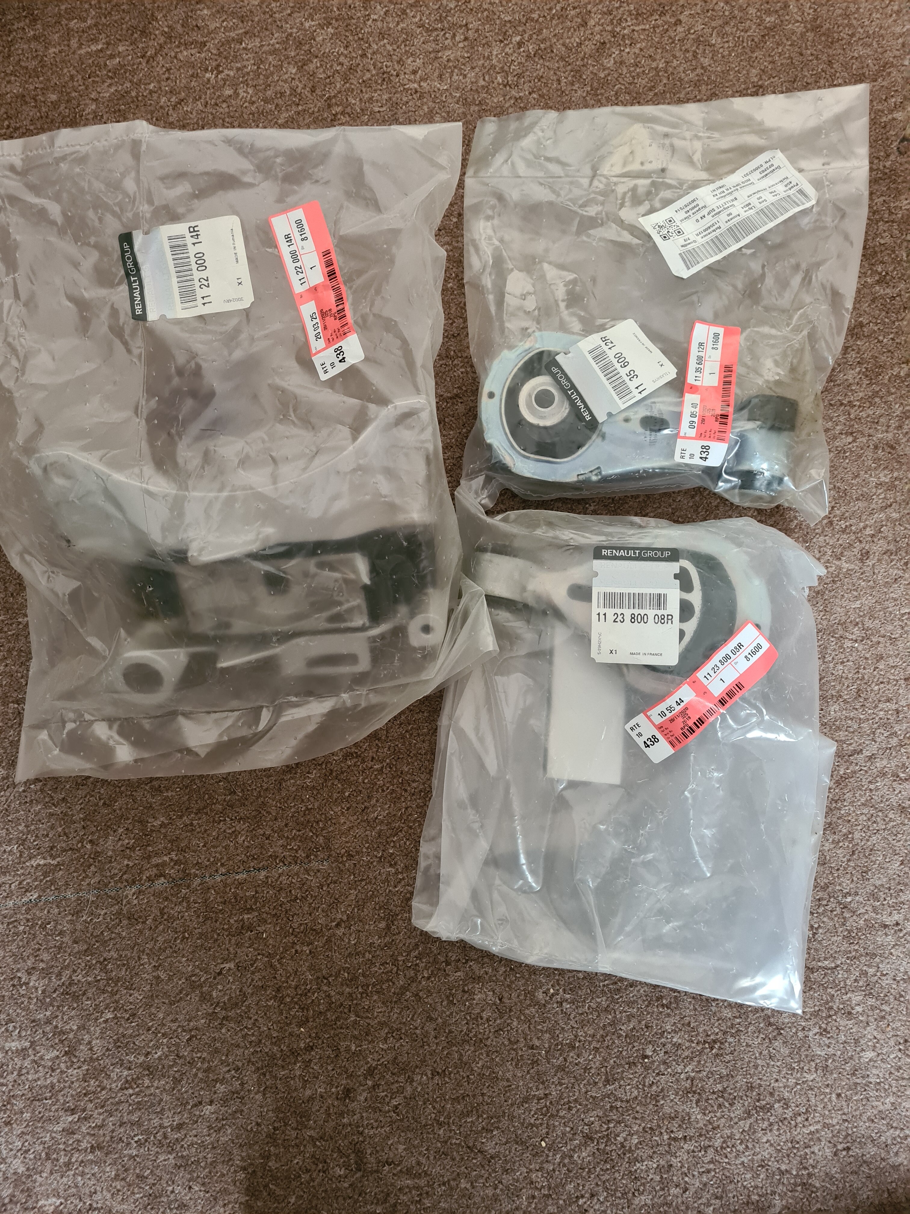

Box of Renault parts arrived this morning. My new engine and gearbox mounts. People tend to fit the 265/275 gearbox mount, which is 112212065R, but the part is on back order from Renault with no ETA and I couldn't see any difference between it and the 250 version 112200014R, luckily there was one 14R left in the country so I snapped it up! For the engine mount, I have the powerflex insert to go in and at the same time will fit the stronger bolt.

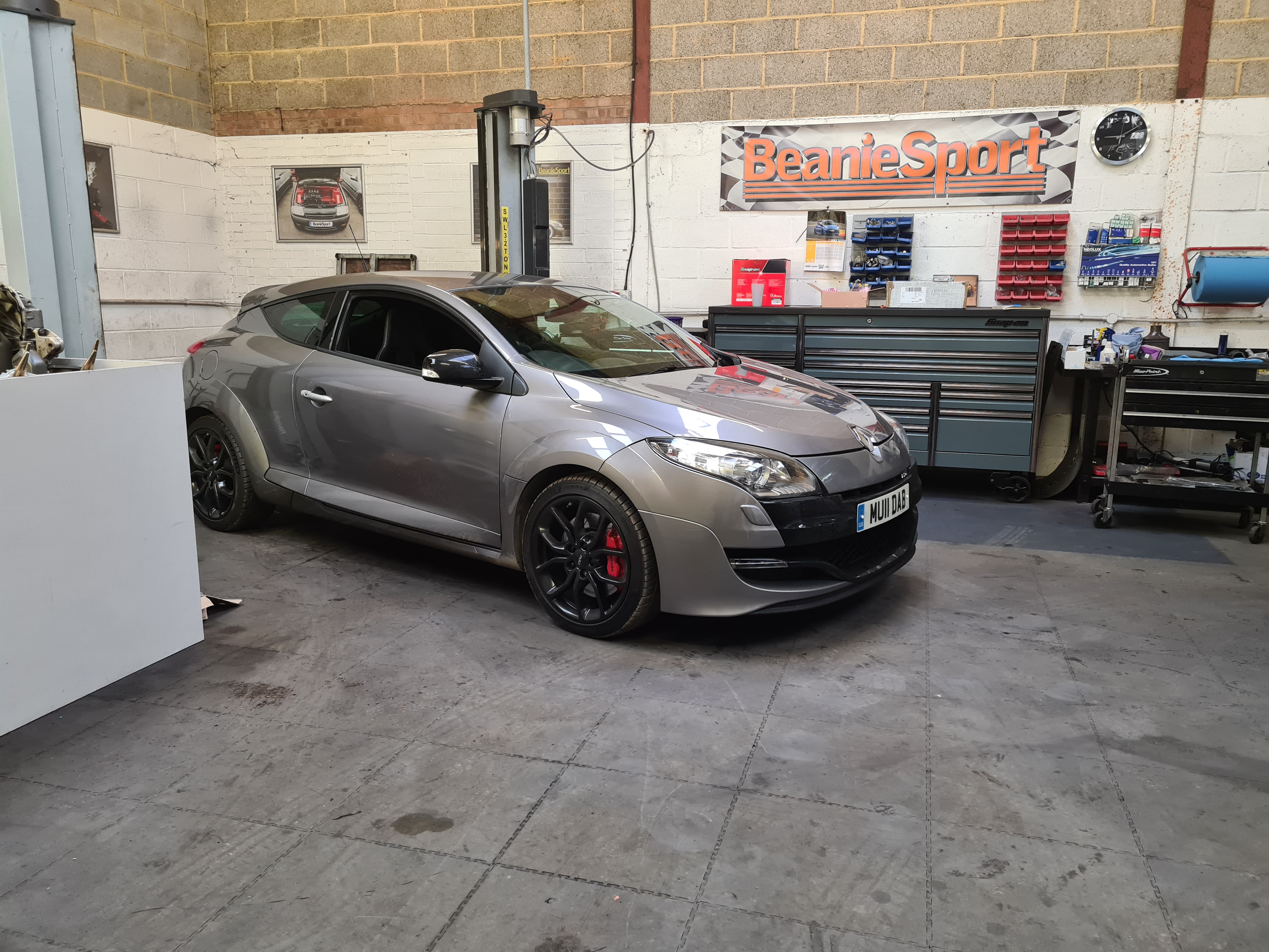

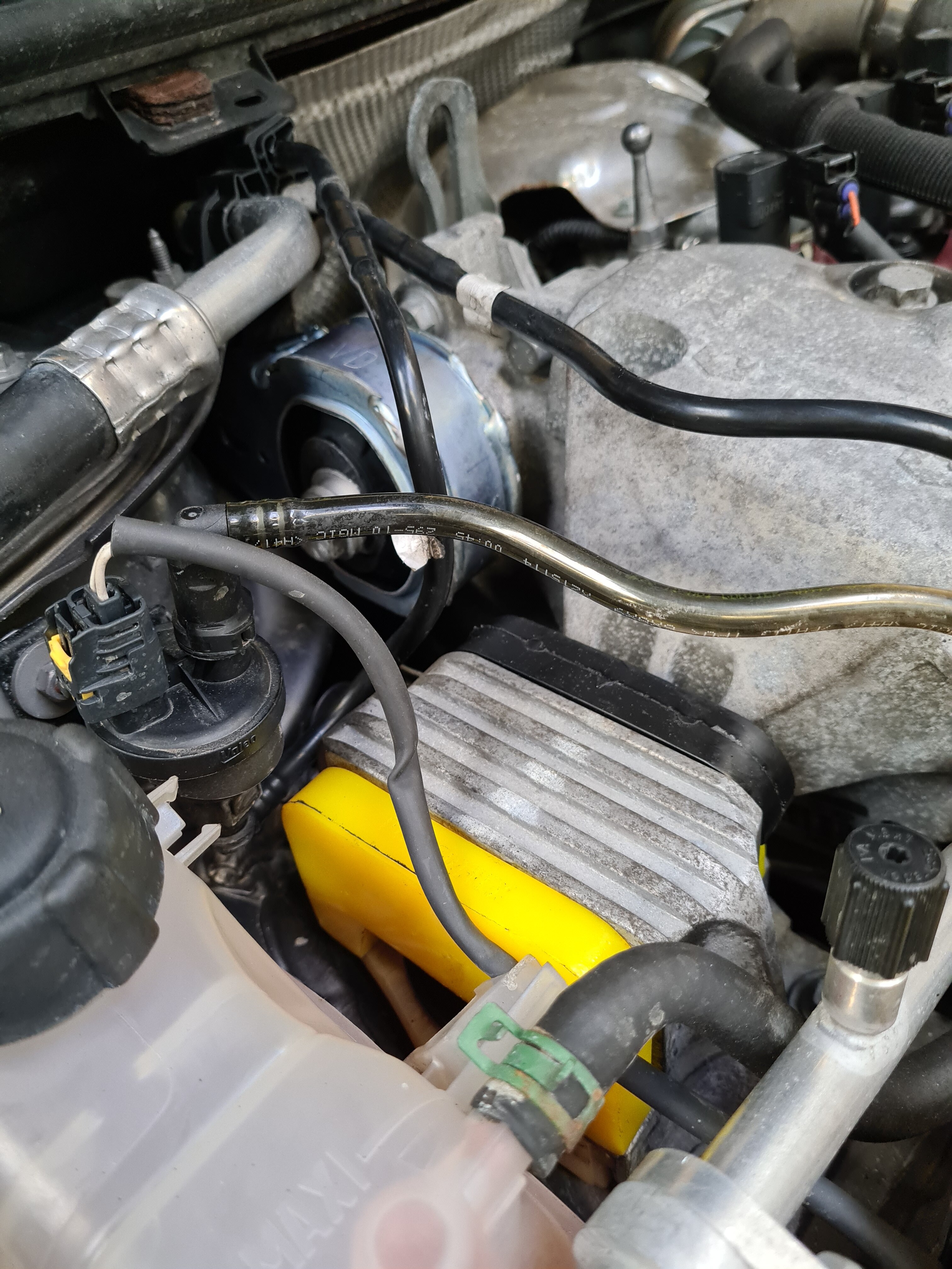

Popped to Beaniesport today to see Chris, went for a test drive on arrival as he owns one himself so he knows how it should feel. Straight away he said it feels tighter than his and drove lovely so that was good to hear. Get it back and on the ramps and no issues to report. It's really clean underneath, no leaks or anything so that was great news and now I have seen it underneath, I can put my mind at ease. Cracked on with the mounts and the top dog bone was completely separated so it was a good job I decided to change them. Drives even better now and the slight jerkiness has gone with no extra vibrations from the powerflex insert. Also the extra piece of mind that the gearbox bolt has been replaced.

I did engine mounts with Powerflex inserts, makes a nice difference!

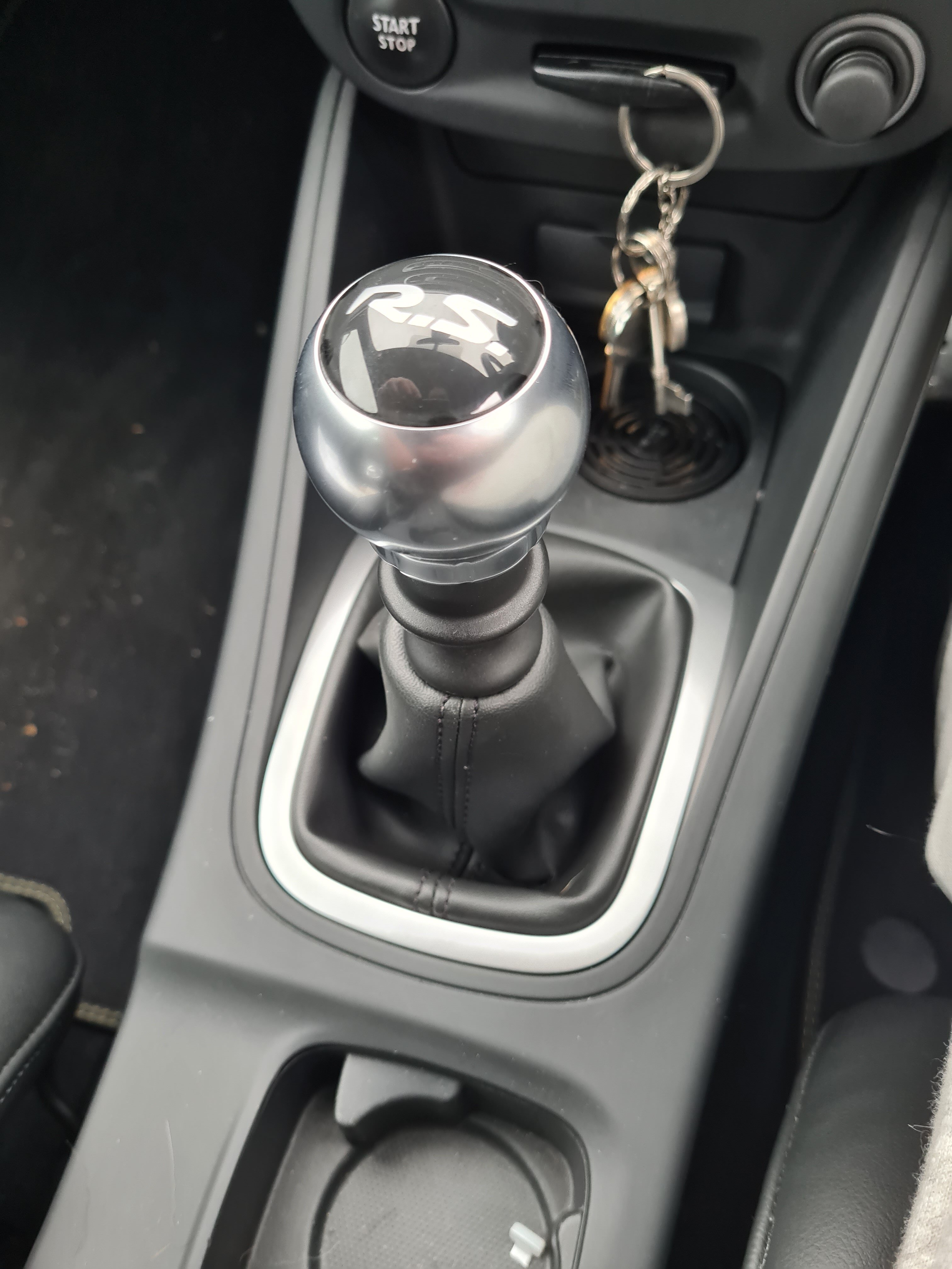

Finally found a photo of my POS

I always fit the lower gearbox vibra technic mount, prolongs the rest of them. I have got the insert somewhere for the top one.

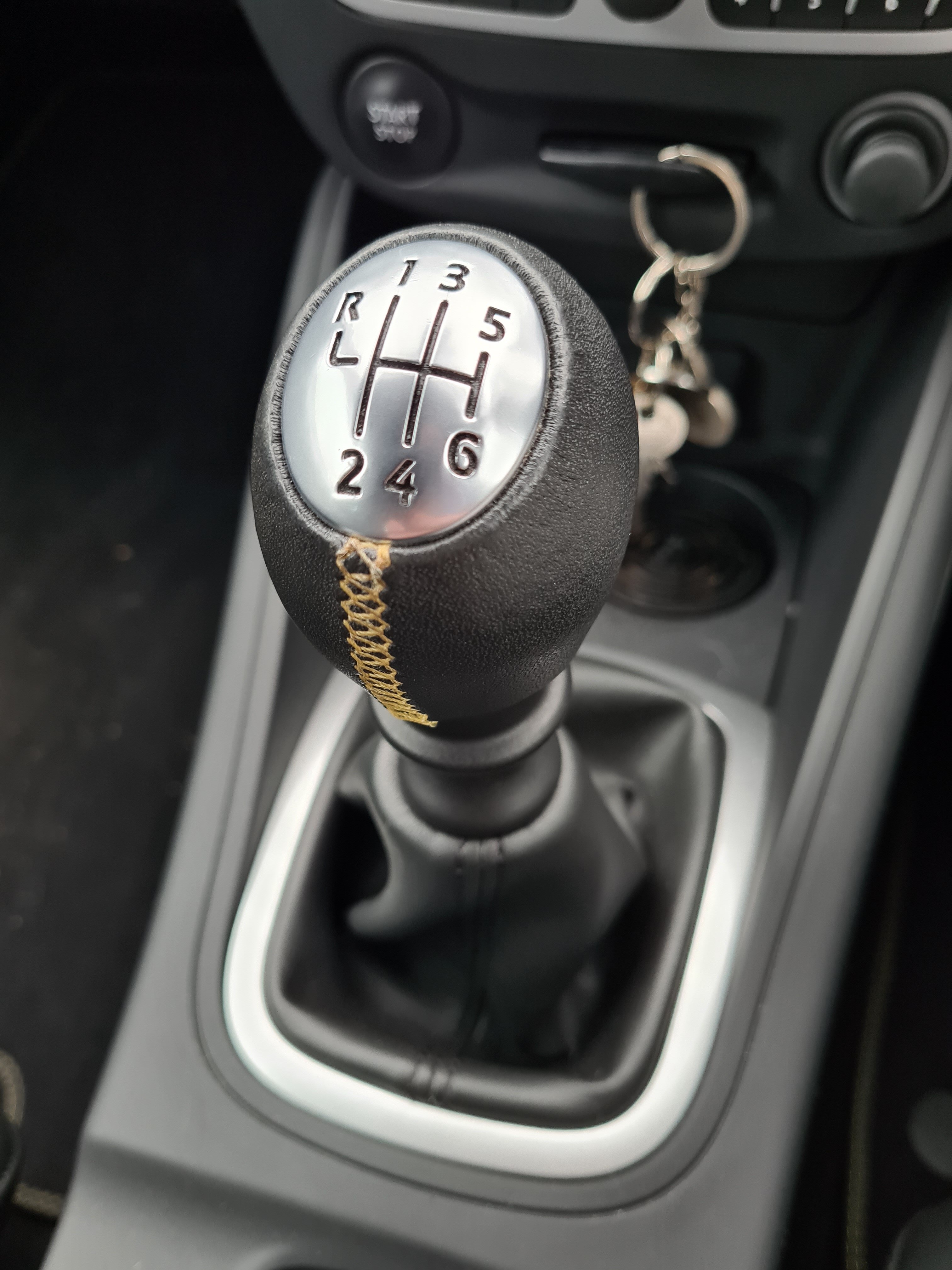

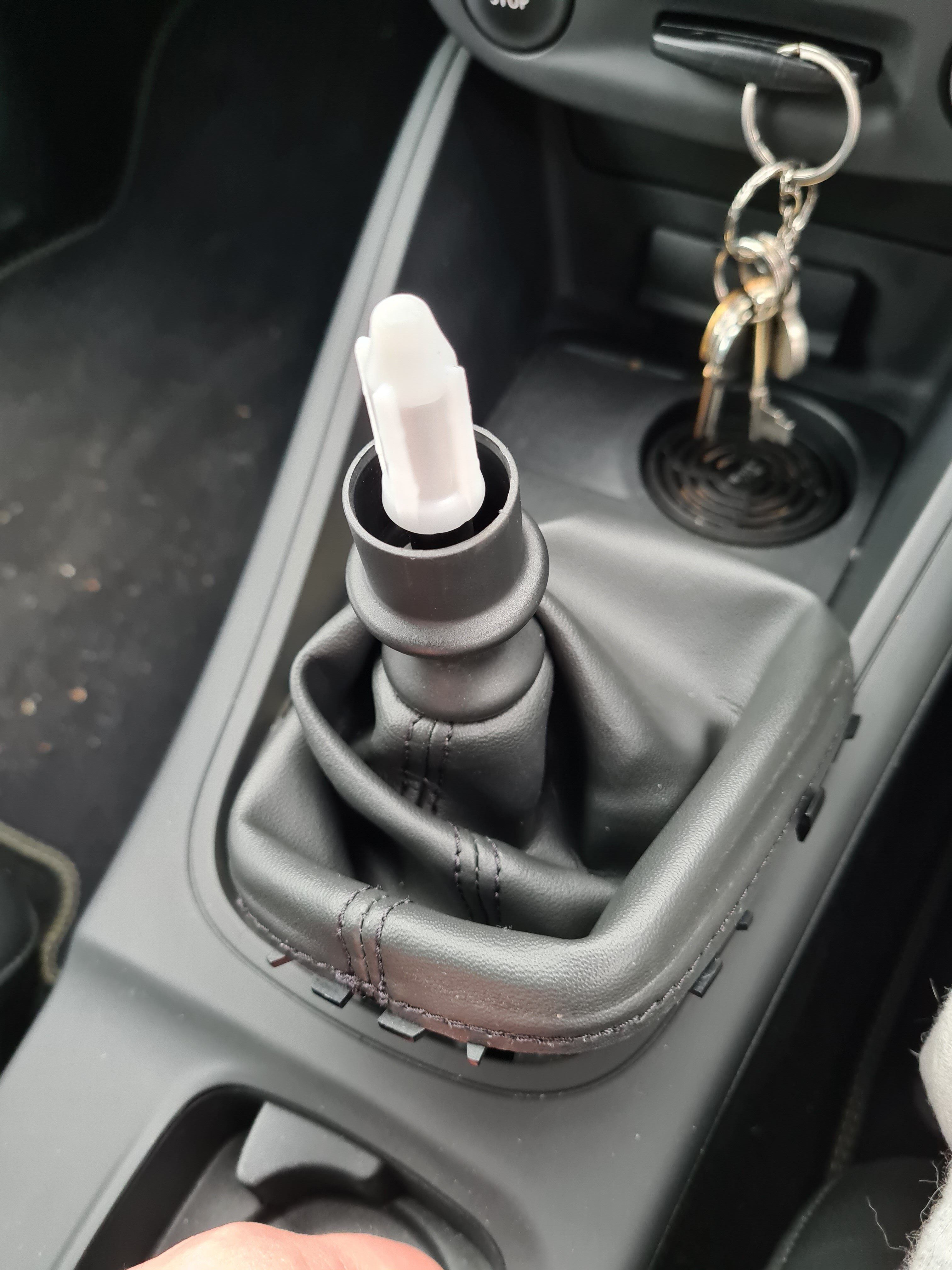

You realise you don’t have to put the keycard in the slot?
Yes, but it was deadlocked previously so keyless doesnt work and yes I know once it's started you can remove the key, but saves it rattling around scratching trim. Only use keyless if I'm popping in and out somewhere.
