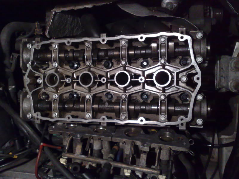

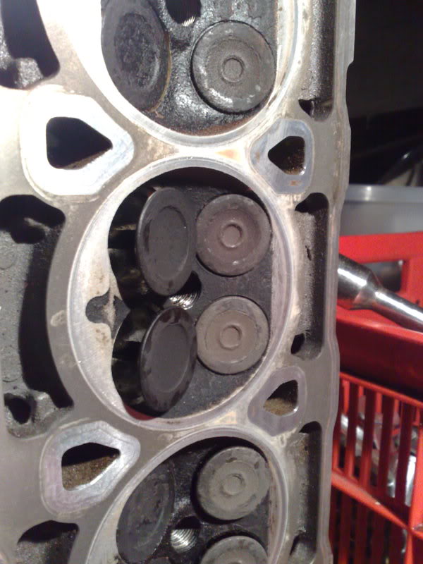

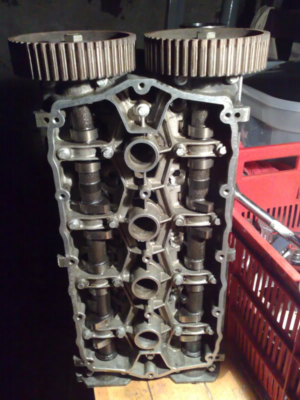

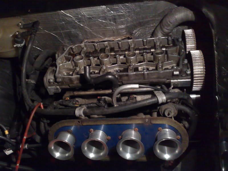

Got the head back, all 16 shims were wrong size, all changed, some porting has been done to the head.

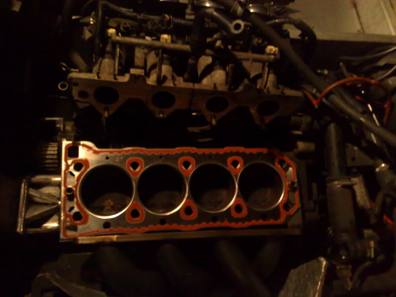

New Payen head asket fitted to try avoid failure in the future
Head fitted with new bolts

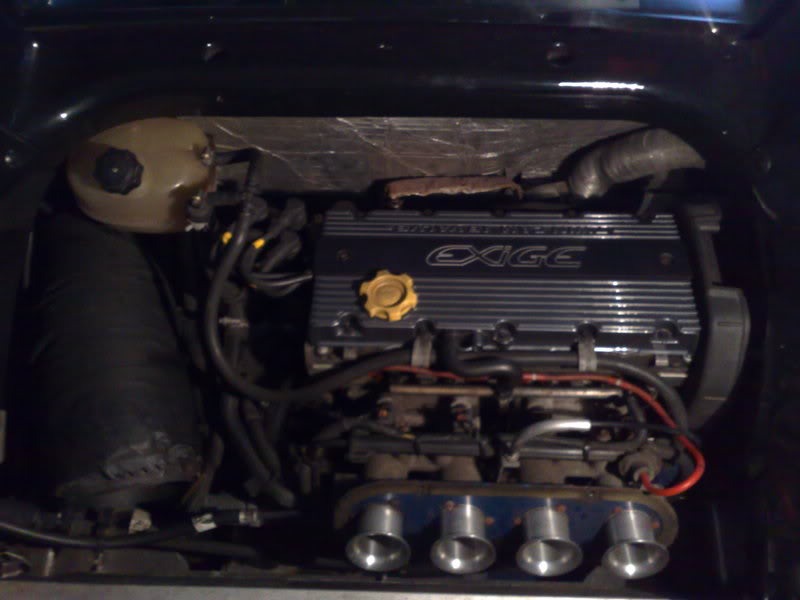

New painted cam cover fitted
The leads were fcked so bought some red magnecor ones (not shown)
Took a few turns over by hand then started after a few turns with the throttle fully open - :D

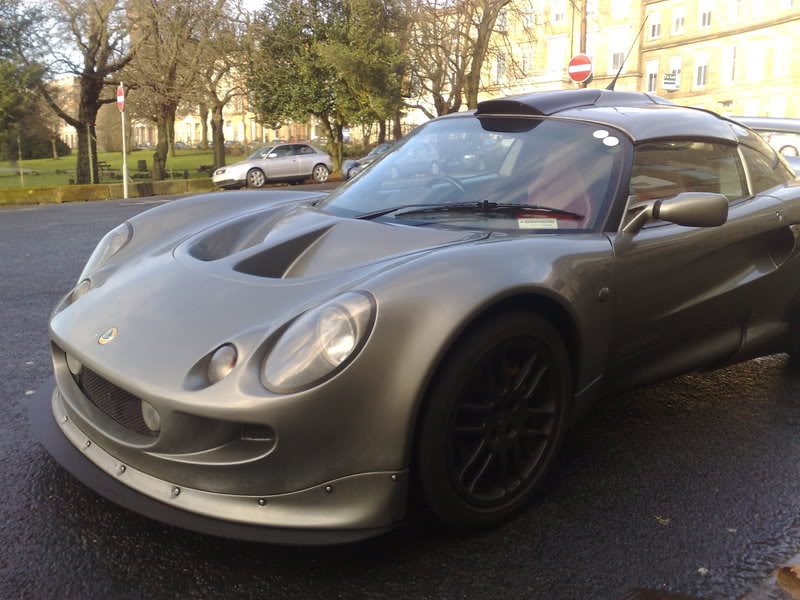

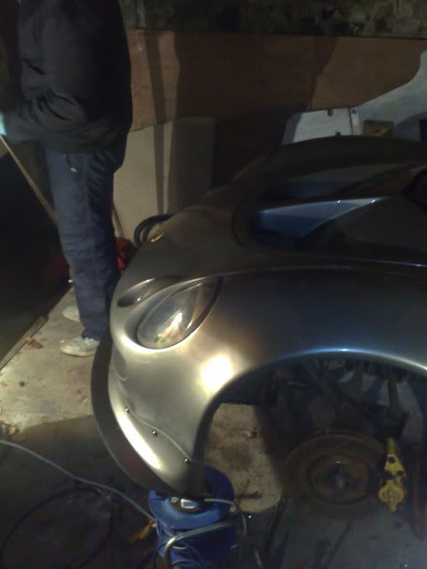

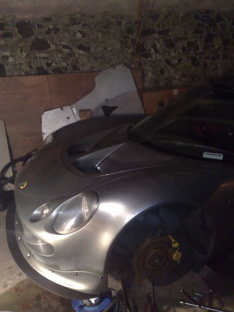

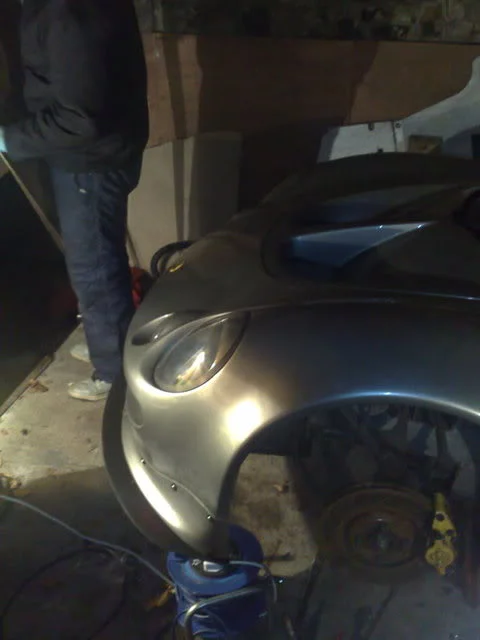

Fitted a new front splitter too while I had the car up off the ground -
No pictures of the full car yet, not been home from work early enough to see it in the light :(

The new MLS gasket is the choice for elises gav, the payen I chose is meant to be better for the VHPD K series
