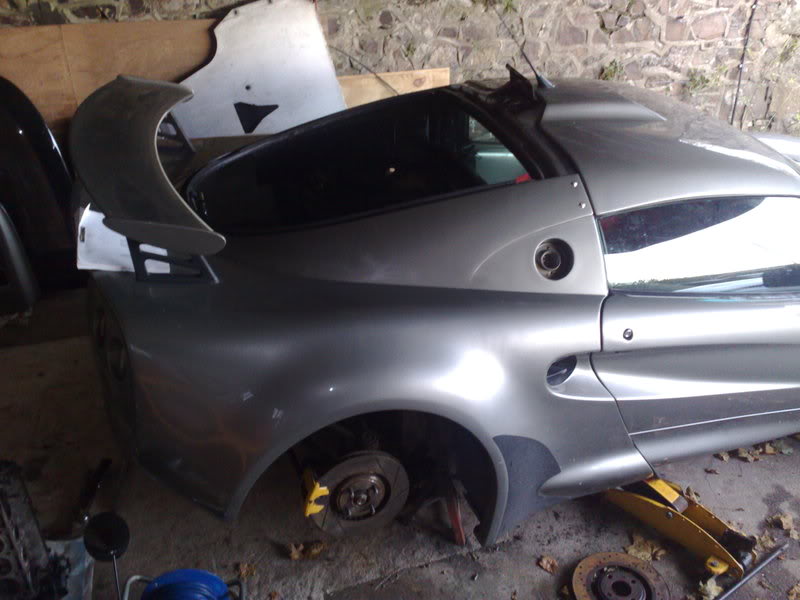

S1 Exige refresh
Car  Exige S1 + Honda S1
Some pics etc for the people who may be interested-
Thought after 68k miles on the VHPD thought it would be best to strip the engine down to see what kind of state it is in, and if it needs rebuilt. I need to send the head off to Dan to sort the Shims out and stop them rattling when cold too.

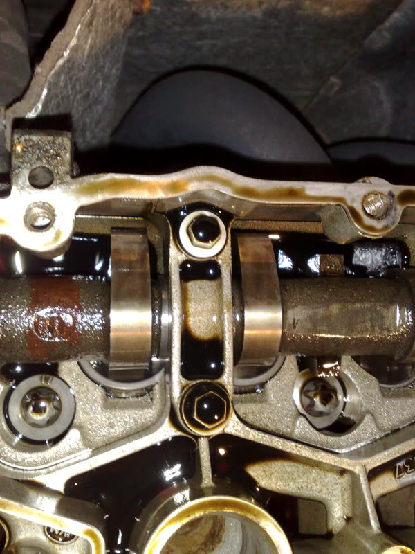

The cams seem like new, almost no wear, which is nice.

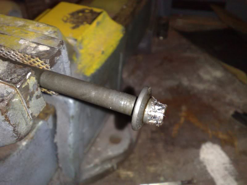

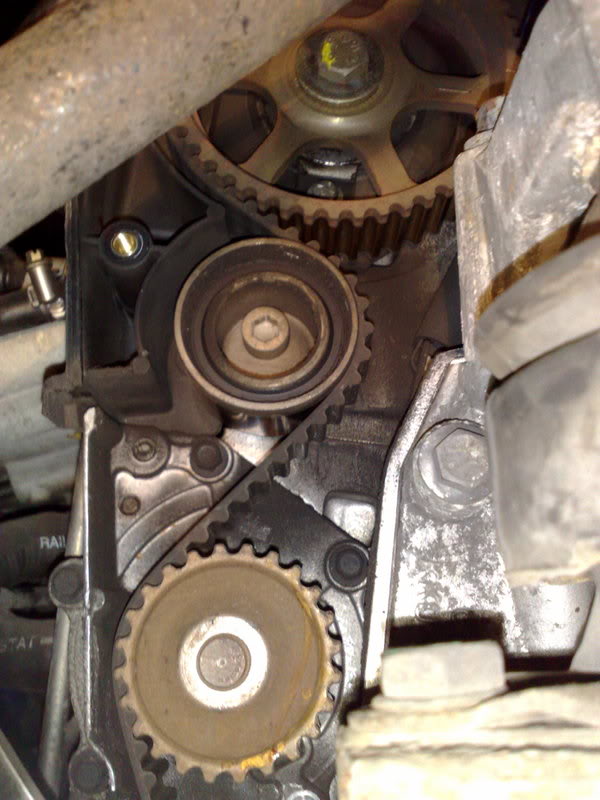

The tensioner bolt wouldnt budge, with a breaker bar on it and ended up being rounded off.
The head bolts have been replaced previously, one was overtightened and needed a bolt remover to get it out too.

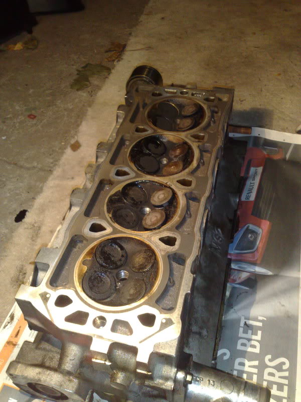

Head off, still had the tensioner fitted.

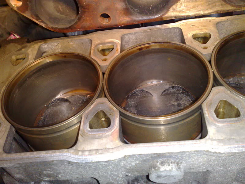

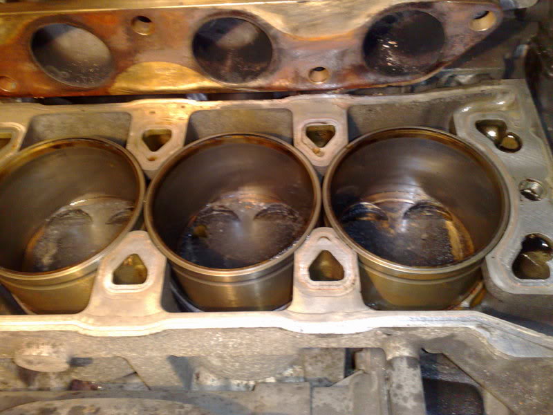

The liners are in good condition, slightly glazed and a bit of scoring on the thrust side but def not 68kmiles of abuse!

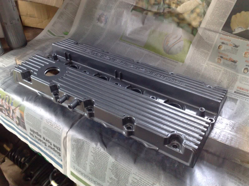

Thought this would be a good chance to paitn the cam cover titanium too.

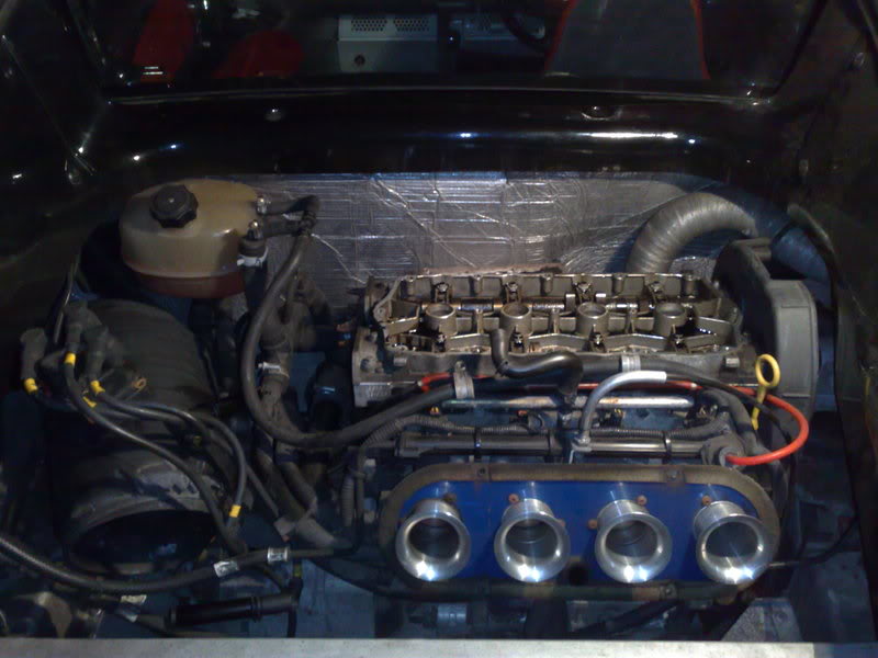

never new they where TB'd or aint your's standard?
All VHPD K series use ITB's, they are covered by an almighty airbox though
