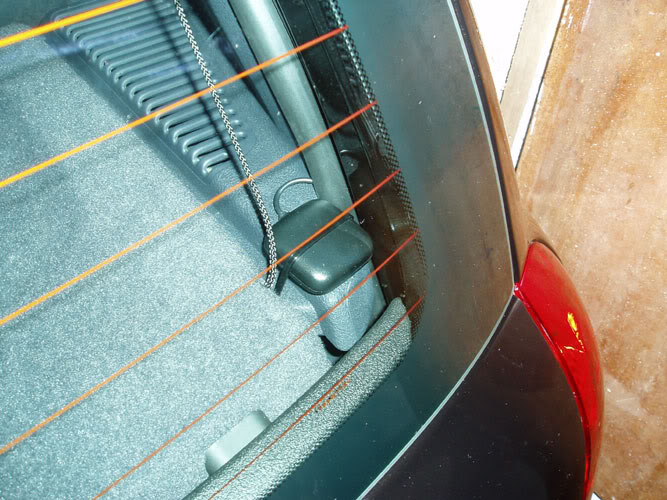

Right, here we go. Firstly place the antenna part here. just to the right of the back seat. I'm using double sided tape for this, Ive used closure plate tape I get from work, this is sticky to hold it, but is designed to be removed with no marks left. (im looking at alternative ways of securing)
a closer view.

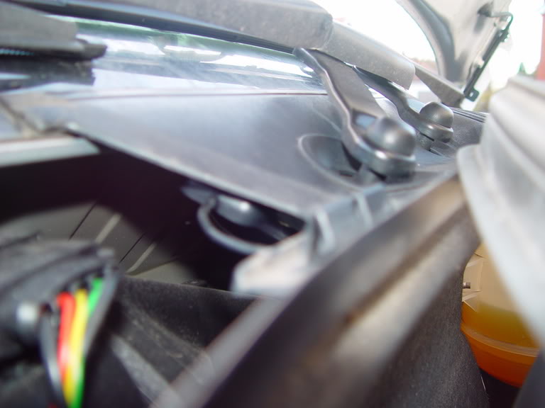

all you need are the tips of your fingers. this is where the build quality of the Clio comes into its own (lol) use the tip of your fingers to gently push the cable behind the plastic trim and the window.
Carry this trend on BEHIND the seat belt then down underneath the door rubber as pointed. again, only fingers needed.
And along the bottom door seal.
Carry on up the seal toward the front...
and then up between the side of the dash and the door seal... coming out about an inch as shown.

I've got pretty much a FULL signal all the time. I fitted this 4 weeks ago and its never dropped below 4 bars. and when you dont want to use your SATNAV just fold the cable back out the way.... like so... and remove your equipment.
