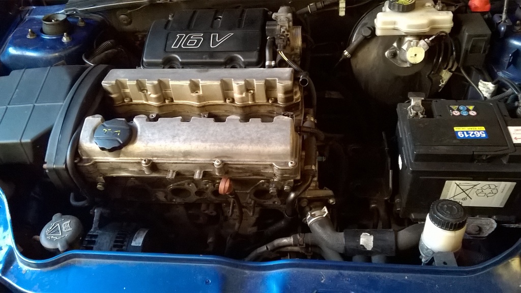

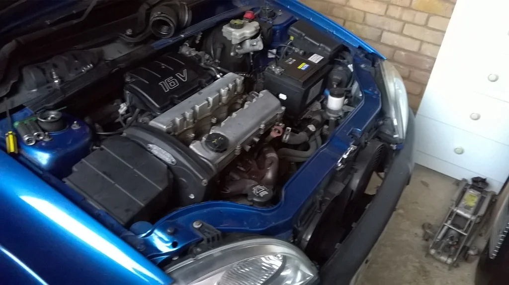

That must be the only standard VTS currently in existence?
Very nice!
Very nice!
Very nice!

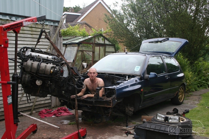

Lol, whose that weido?
Aren't you the guy who can't drive?Gonna jump in here.

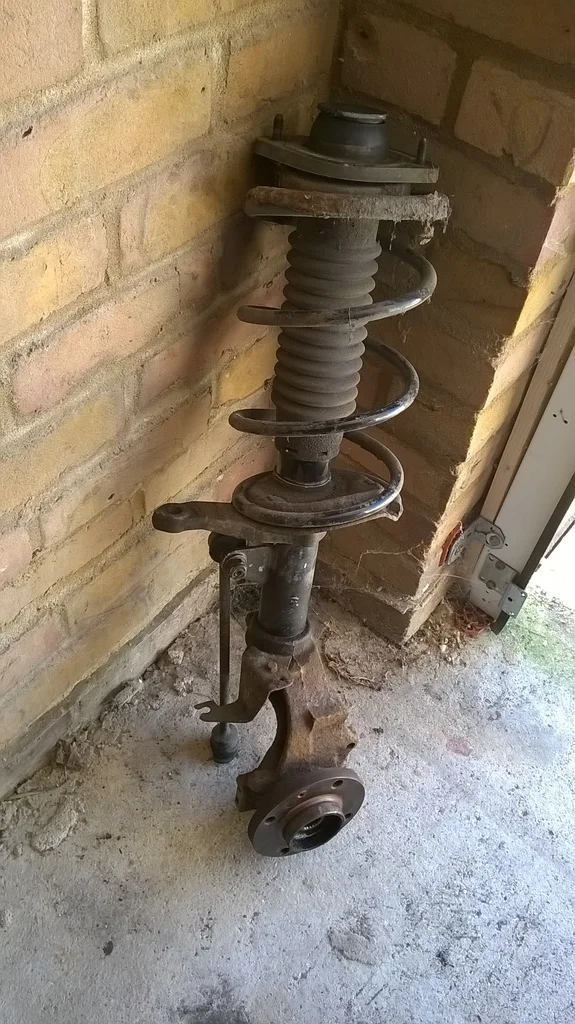

Best thing for these cars is to lose the weight, sticky tyres and better brakes and then go from there.
I use 266mm brakes with mintex 1144 pads and mtec dimpled and grooved discs, it stops better than my megane with brembos.
Suspension wise, I'm using Gaz GHA's, but it's down to preference, a lot of others use B8's with Faulkners, gas do have damping and height adjustability though...

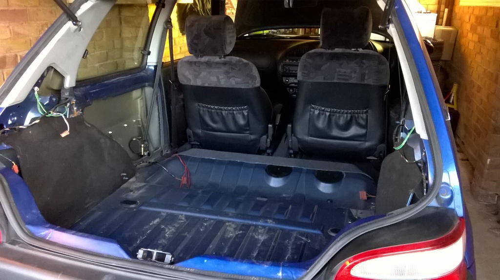

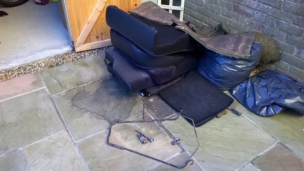

Yep all by hand so im already - 500 Kg so farI hope you've been weighing all the parts your remove :wink:
500?
I regret taking all the interior out of my 106. The weight difference was minimal at best but I suppose you get the race car feelz.
then it's time for:-
Plastic windows.
Drilling out 50% of the plastic in the bumpers....because aero isn't a thing at all.
Side-exit zorst (shorter = lighter)
They're only 930kg's as standard, so if you get it to 880kg's it'll f**king fly lol
