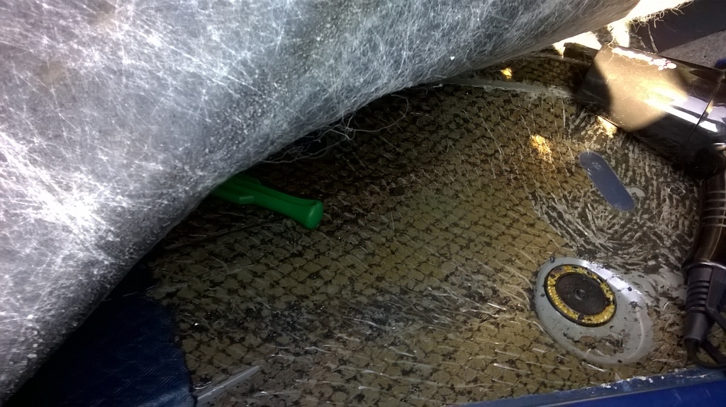

Ok so with 3 and a half weeks to go before the Nurburgring trip Tyre leader have lost my Nankang NS-2R tyres , the new thermostat is still playing up and not opening all the time causing the car to overheat and when removing some of the sound insulation I have nicked a fuel line and fuel is leaking in to the passenger foot well .

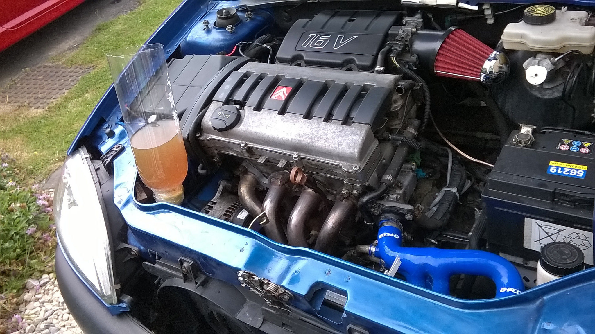

I have installed a VTR fuel line as this is the only stock fuel line in the country it would seem . It is a bit longer but all the connectors and size is the same as the VTS .
The cooling system is now working spot on and is running cooler after installing a 306 GTI 6 82 deg thermostat and bleeding the car for a 4th time .

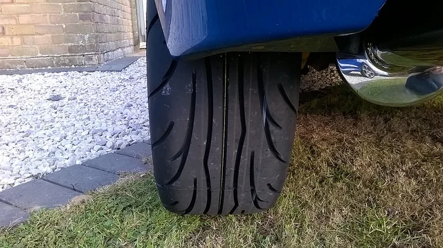

Nearly there with the car .

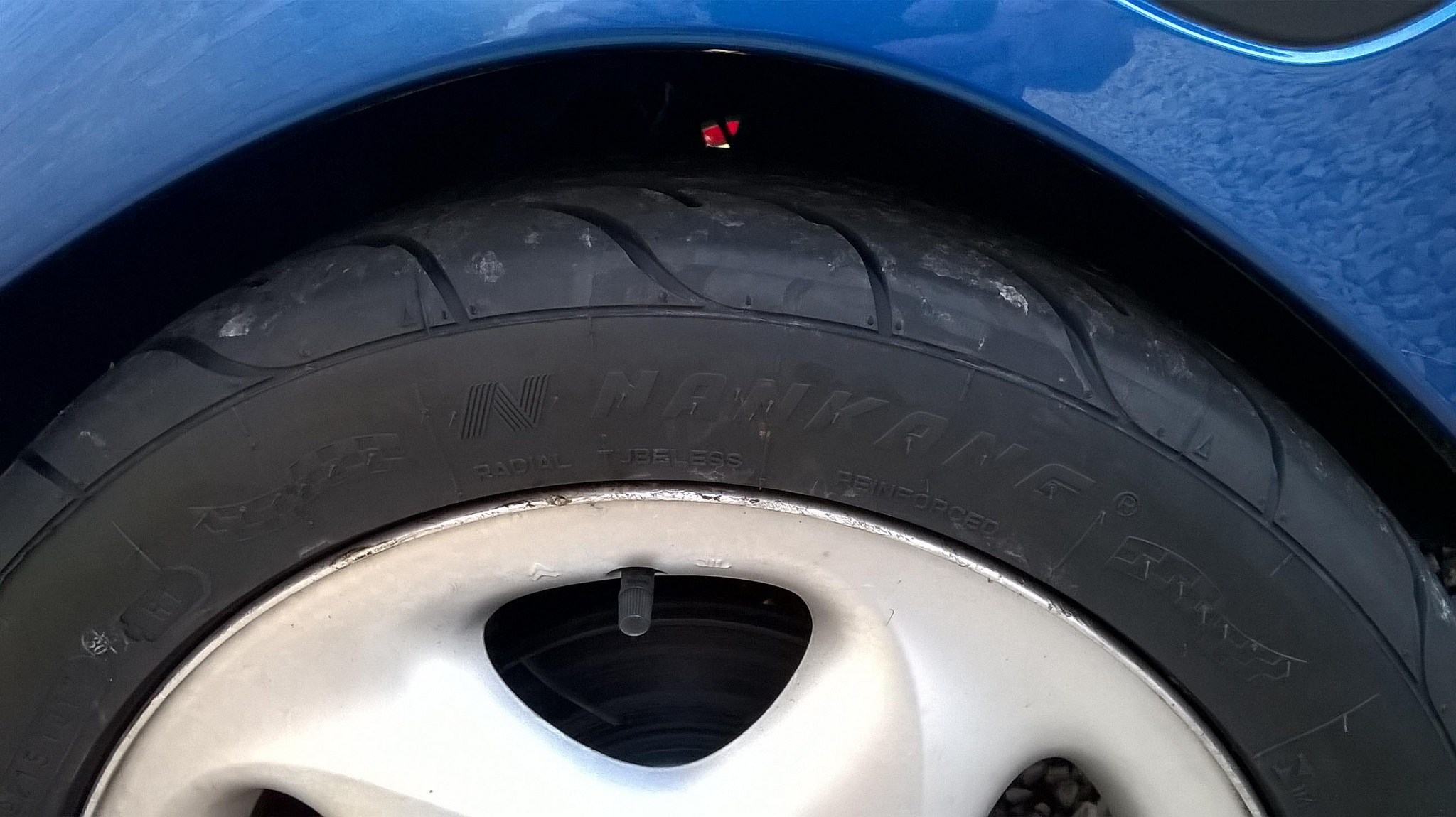

Nankang NS-2R tyres fitted yesterday .
They are 195/50/15 so just about fit and I mean just with only a few mm clearance .
The stock size are 195/45/15 but I can’t get any semi slick tyres in this size so have had to go for the 50 profile .
WP_20170717_19_49_29_Pro[1] by Alan Kaveney, on Flickr
WP_20170717_19_49_10_Pro[1] by Alan Kaveney, on Flickr

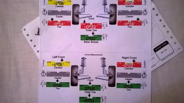

And the tracking done .
WP_20170717_22_11_02_Pro[1] by Alan Kaveney, on Flickr

They rarely match up perfectly on Saxo's I have read
Below is from another forum
I had my tracking done yesterday on a hunter allignment machine and got a full digital readout on caster, camber and toe for front and rear (excluding castor for rear obviously).
The angles which are not adjustable though (every thing except front toe) are not equal from side to side etc, just wanted to know if this sounds okay or if something sounds bent:
NSF camber: -1.02 degrees
OSF camber: -0.06 degrees
NSF caster: 0.55 degrees
OSF caster: 1.06 degrees
Can't argue with science
Lol

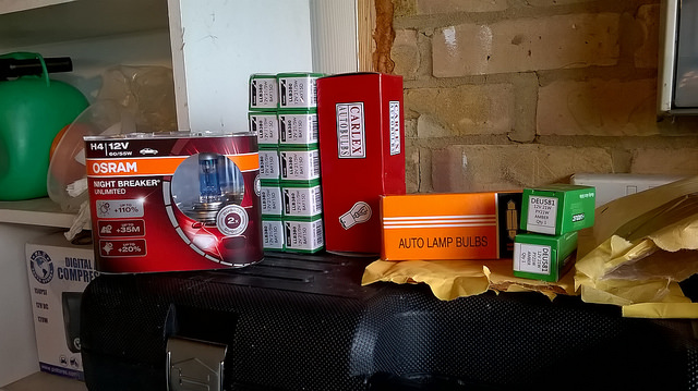

All bulbs replaced .

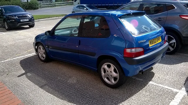

WP_20170722_15_01_54_Pro[1] by Alan Kaveney, on Flickr

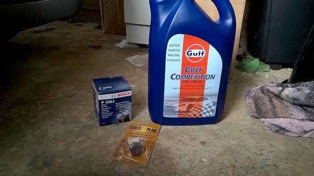

And oil , filter and Gold sump plug changed .
WP_20170722_17_44_52_Pro[1] by Alan Kaveney, on Flickr

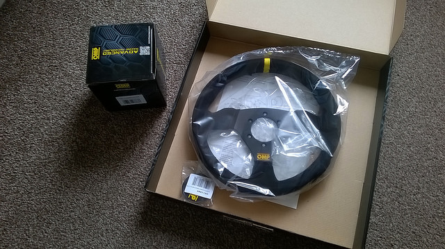

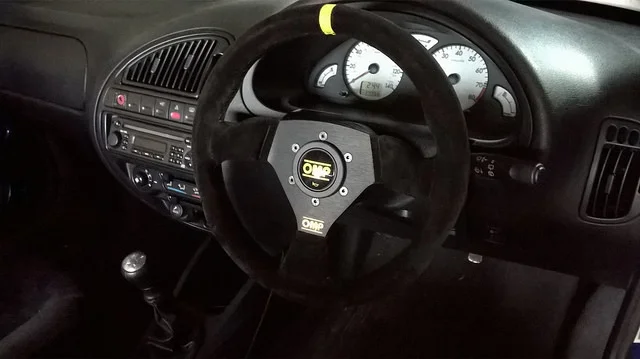

Ok so after saying the car is done and I will not get anymore bits this year I could not help getting a OMP steering wheel to finish the car off .
It is an OMP flat 300mm and done in suede .
WP_20170729_11_28_42_Pro[1] by Alan Kaveney, on Flickr

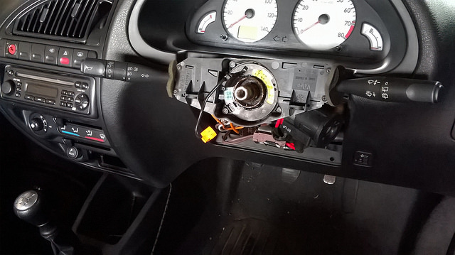

Removing the old one was easy and the new unit fits well .
WP_20170729_13_41_37_Pro[1] by Alan Kaveney, on Flickr
It feels very nice and is very small .
Only bad points are that I cant see the dials now LOL

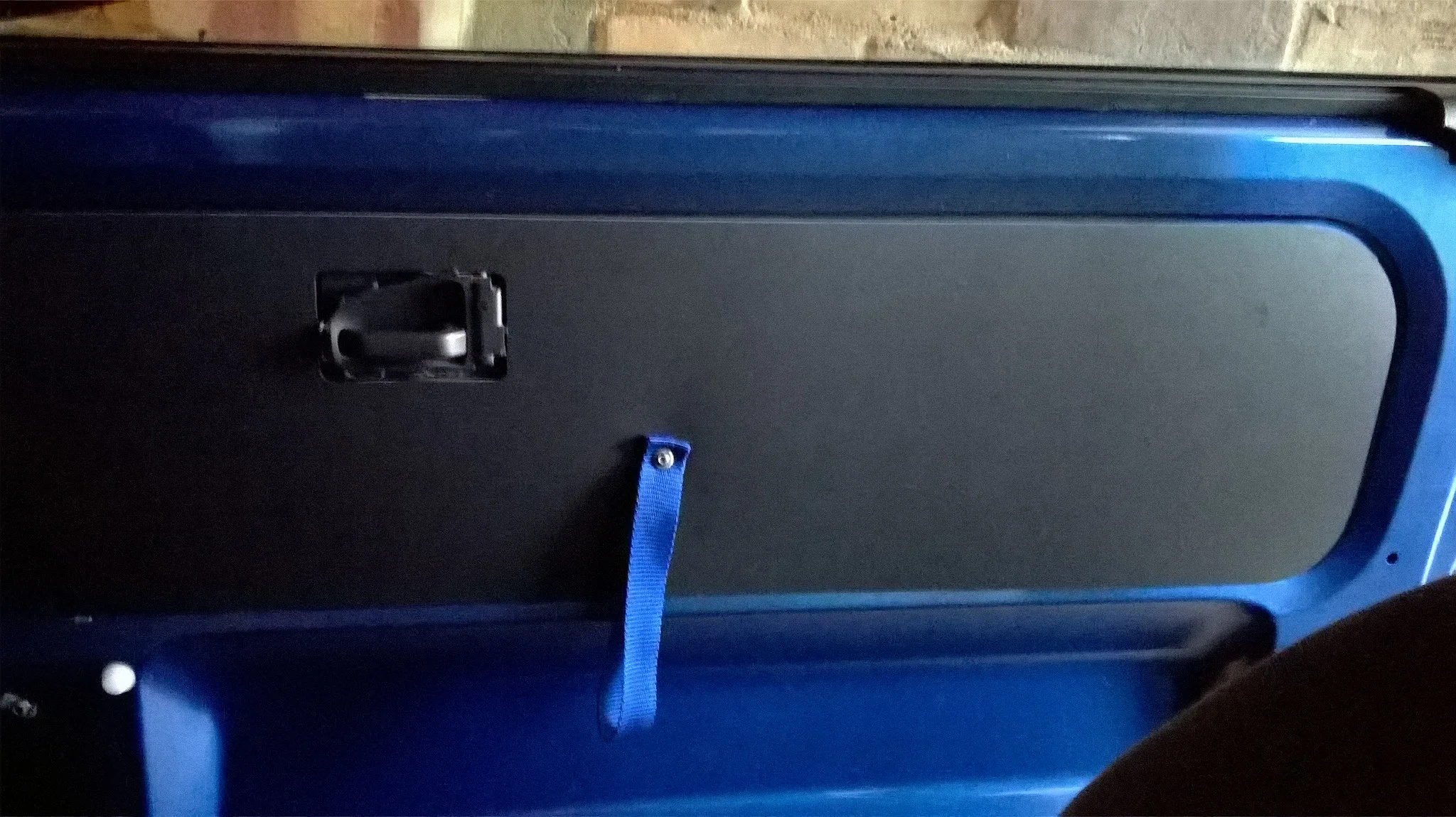

So my lightweight door cards turned up just in time to fit them along with the Blue door pulls so last night I installed them .
WP_20170803_19_27_37_Pro[1] by Alan Kaveney, on Flickr
That is now it and we will see if the car makes it back or if I will need to look for a new track toy :)
