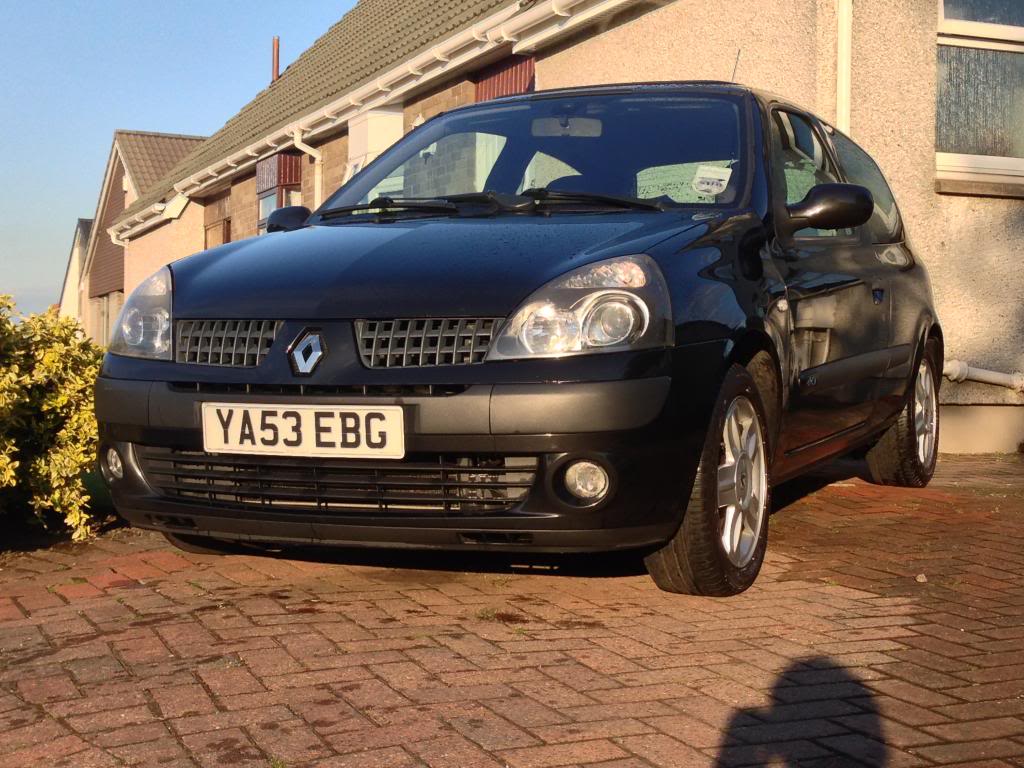

Don't have any pictures of the car back when I first got it, but this picture shows essentially how she looked back in December:
I started out with a list of mods as long as my arm, and first on this list was a set of xenons and an RS grille. Got a set of xenons cheap off of ebay not long after buying the car, which turned out to be a nightmare to fit because the mounts had broken inside of them. So I decided the best bet was to rip them open, butcher my old reflector headlights and have a bash at fixing them!
After a lot of work, this was the outcome:

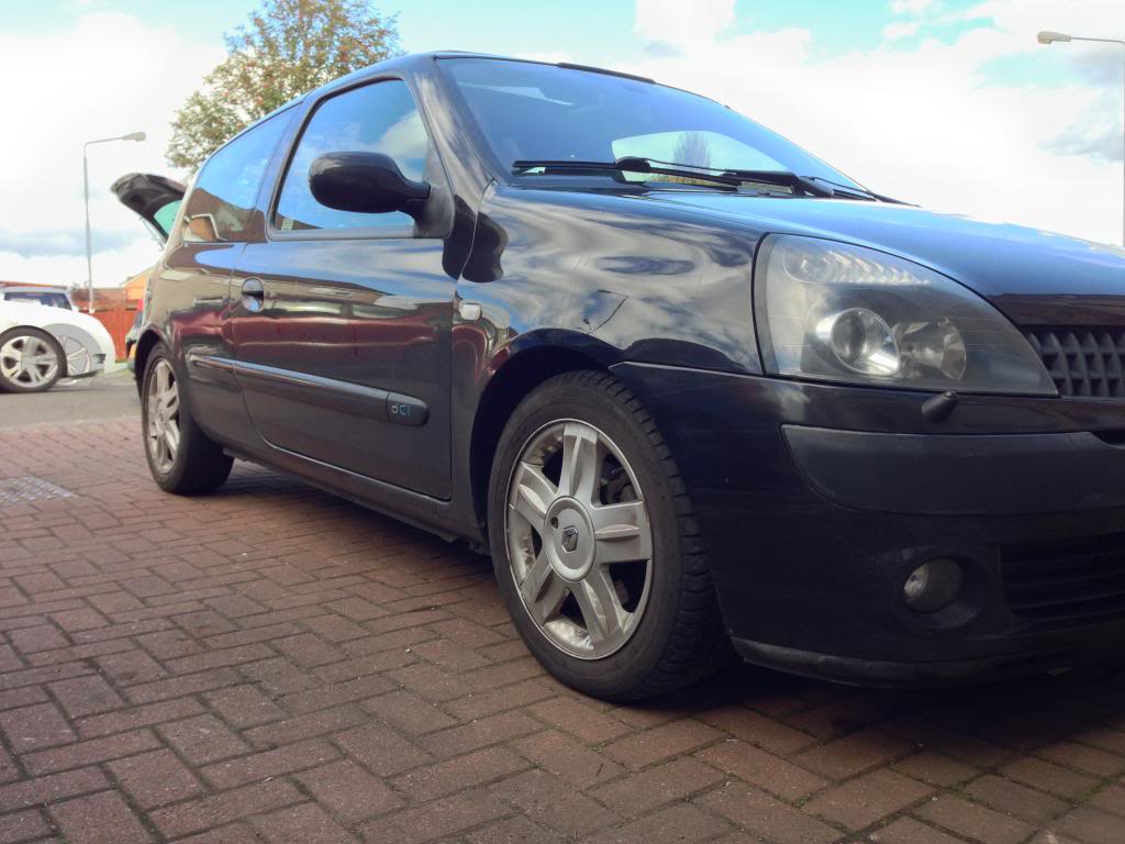

Finally, I've wanted to lower ever since I got it. Picked up a set of Eibach Sportlines and got these fitted along with new front dampers and top mounts. Makes an unbelievable difference to the look of the car and it handles so much better now.
Rear done
Fully lowered

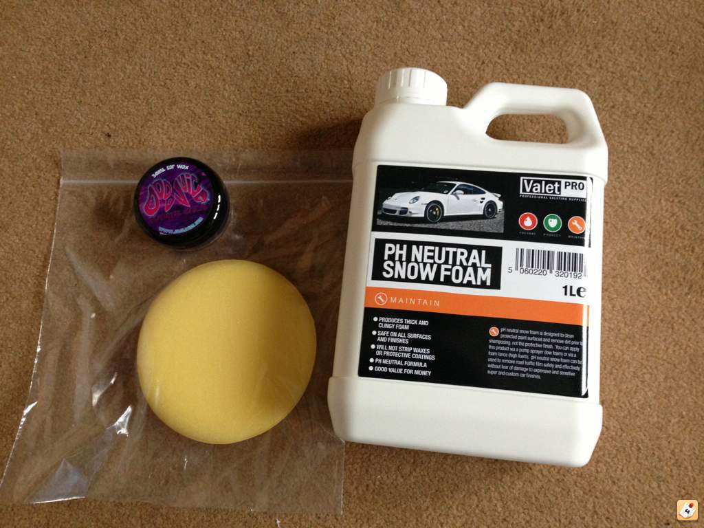

Just a quick update on some stuff I've ordered/received for the car.
Came in from work today to be greeted by these, courtesy of G172 on here! Hoping to get these fitted next week and sort out my sticking caliper at the same time.
Treated myself to a Nilfisk C110 power wash and a snowfoam adaptor too. From what I've tried of it today, it seems a good bit of kit for the price.
Finally, got some snowfoam and a sample tub of dodo juice purple haze wax and applicator pad. £5.95 for the tub of wax and "should do 3-4 cars" according to the label. Bargain! Just need some decent polish now and I'll get my winter detail done!

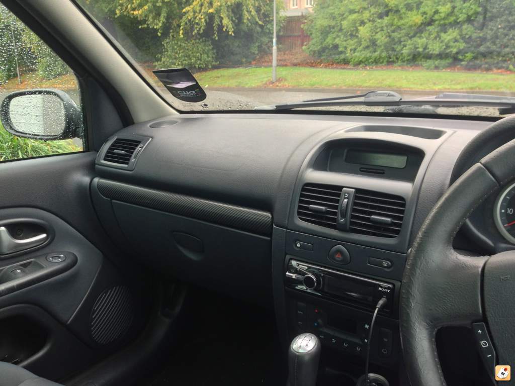

Small-ish update. Ordered some carbon wrap which arrived yesterday so I did the usual and wrapped my dash strips
Thought about doing the door handles and the gear knob inset too. Not sure though!

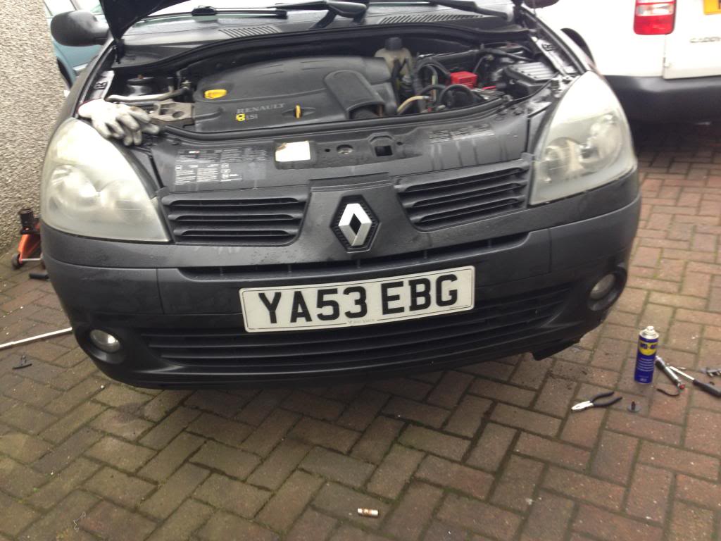

Also got the new front discs and pads fitted last weekend and cleaned up my calipers too, hopefully get them painted some time soon. Thinking silver or a really glossy black!
I'll be ordering some PlastiDip this week for the front grilles since their faded bluish colour and white marks from wax are getting on my nerves, will get pictures up of that when it's done.

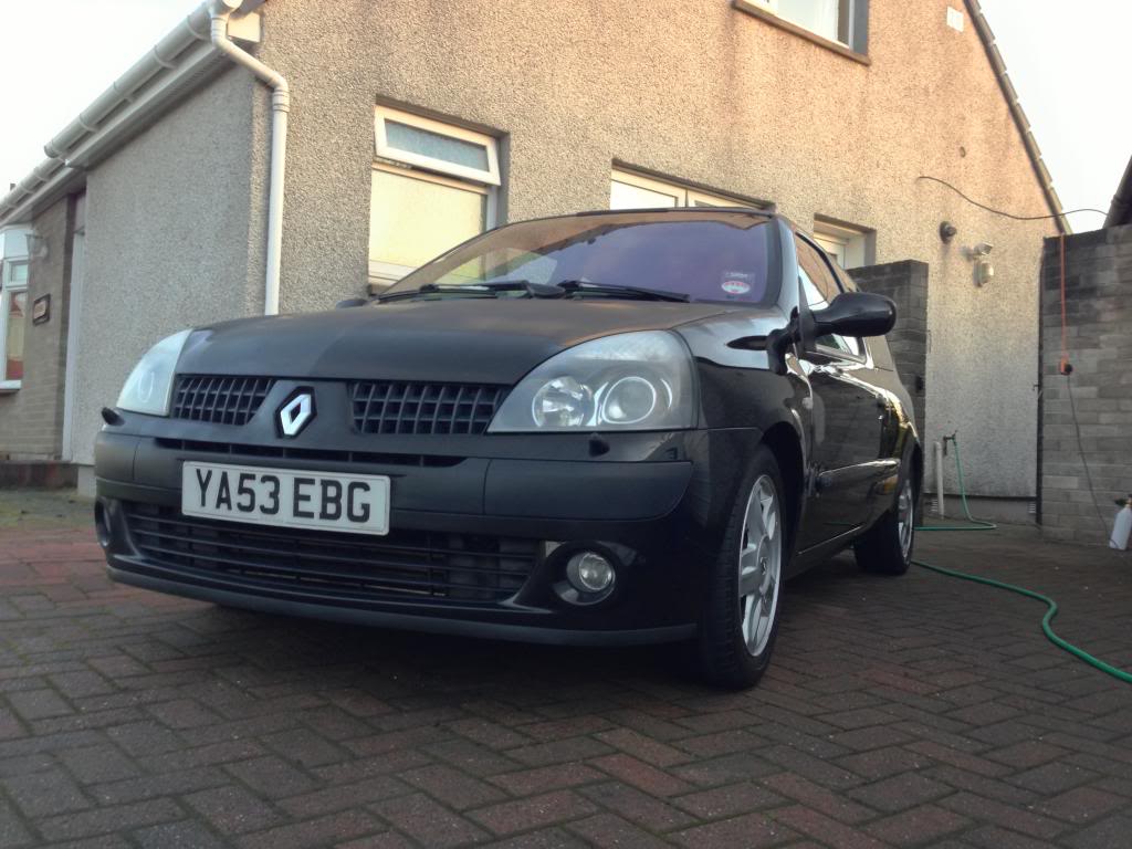

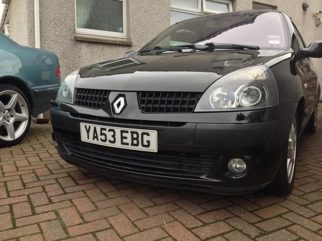

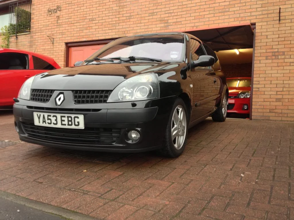

Bought myself a Fabia front splitter and some matte black plastidip this week, along with another batch of cleaning products! (Dodo Juice BTBM, Sheepskin mitt, drying cloth, iron x and some Megs tyre gel) :D I highly recommend the Meguiars tyre gel, simply because it's THE best smelling thing ever! :rasp:
Got my top grille sprayed with the plastidip on friday night and to be quite honest, it was the biggest waste of £15 i've ever had! Prepped the grille by cleaning it up and sprayed it. Looked decent when it was going on but when I went to fit it again on Saturday morning after leaving it to dry, it hadn't adhered properly and was peeling off. Luckily that bit's hidden by the bonnet, but even still, I'm not too happy with the overall look of it. Isn't very black looking.
So for anyone thinking of buying this I wouldn't recommend it at all! Folliatec is much better stuff, my mate done his alloys using it and after one coat it looked perfect and was dry in about 20 minutes. No prep work besides a good clean either!
Pic of the painted grille fitted Saturday morning (after 5 coats) :
Think I'll probably do it again with something slightly glossier looking.

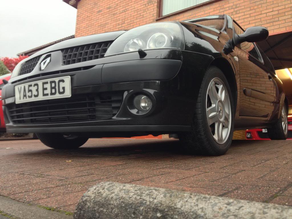

Fitted the new splitter yesterday, which turned out to be harder than I first though. Bumper off job! :dapprove:
All done (with a half decent clean):

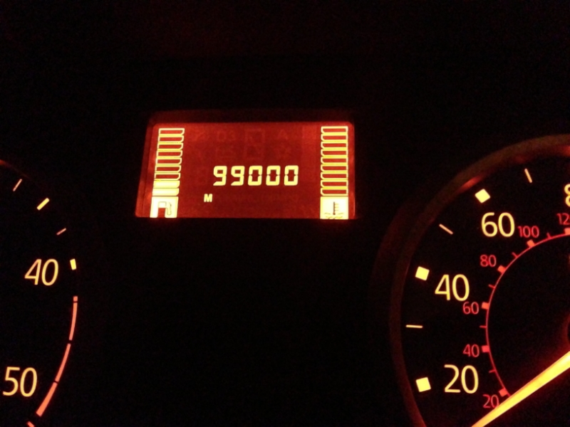

Oh, and this happened tonight, not long to go until she reached the old 100k milestone!

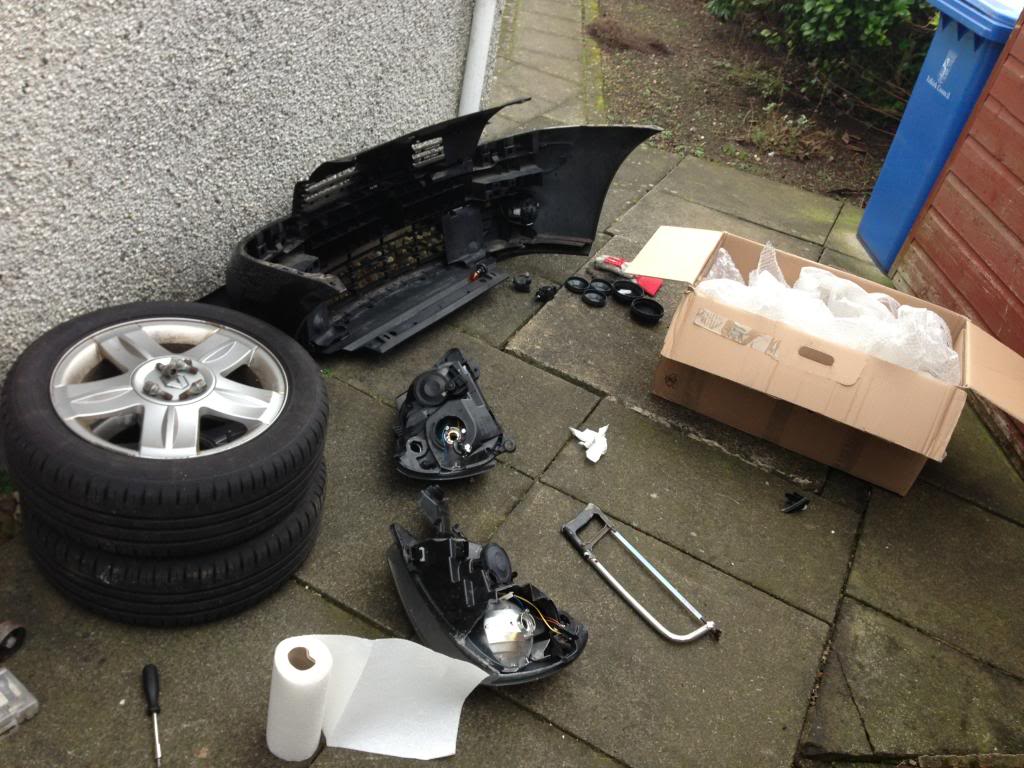

Been a while since I updated this, so here goes. Fairly big update!

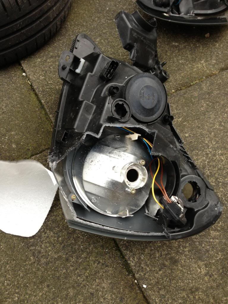

Finally fitted new side lights a couple of weeks back, since my cheap eBay ones were slowly dying. New ones are awesome, they're so bright they light up the trees across the road from my house :eek:
Pic of the old ones (left) and new ones (right):

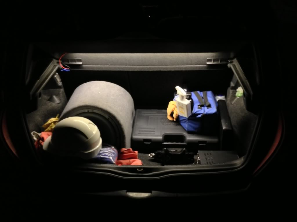

Sticking with lighting upgrades, I fitted an LED strip in the boot two weekends ago. Best £10 i've spent. The standard boot light hardly gave off enough light to see where things were, so I decided to fit the LED strip instead of trying to get a brighter bulb or whatever. I stuck it onto the underside of the parcel shelf and made sure it was sort of hidden. Fired on a few spade connectors just in case I needed to remove the parcel shelf. Quite pleased with the result (need to tidy the wires away though):

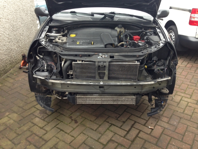

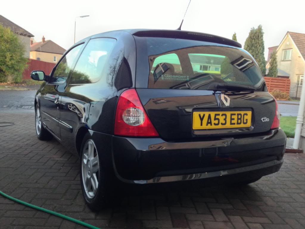

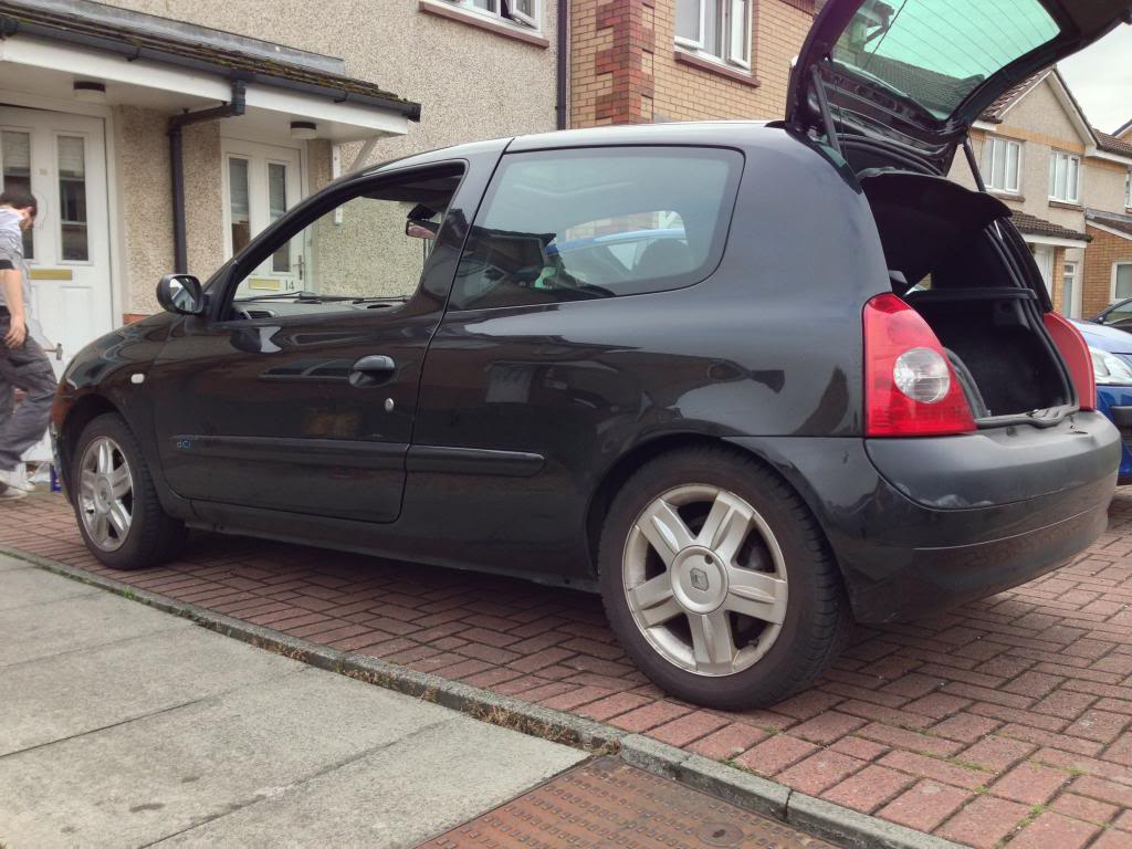

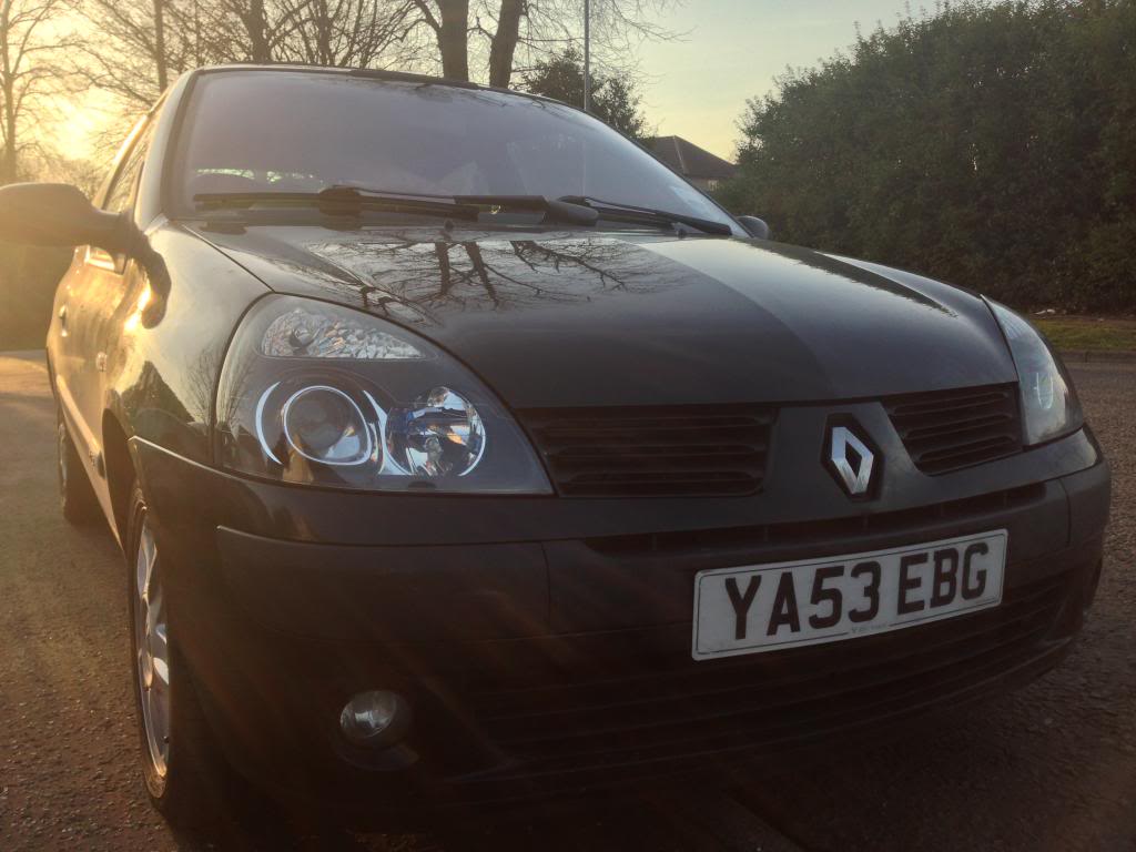

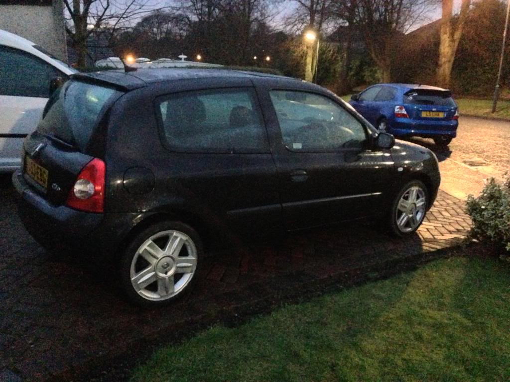

Fitted a 172 rear bumper that I got last week :D Always thought the rear of my car looked really sh*t when compared with the front, but now it feels like it's the other way round. Need to colour code the front end soon and get some spacers then get my 172 alloys refurbed and onto the car after winter.
I have no intentions of turning the car into a 172 rep or anything, just the rear bumper and alloys for me. Quite like the look it gives, without making it look like a sport too much.

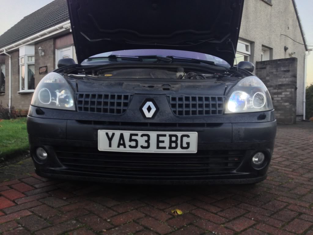

Managed to get a half decent winter prep done at the weekend there, thanks to some dry and quite mild weather! pH Neutral Snow Foam, followed by a wash with some Dodo Juice BTBM and then dried the car and fired some iron-x onto it. Made a MASSIVE difference to the alloys! After that I clayed, polished and waxed it, using AG clay and rapid detailer, SRP and Dodo Juice Purple Velvet. Finished off with some Megs tyre gel and a bit of trim restoration. Not exactly a huge detail by any means, but didn't have the time/daylight hours to manage anything more. Happy enough with the results, and happy knowing the car has a coat of wax on it for winter. Although on saying that, it's now filthy again after going to work and back today :dapprove:
Pics of car after winter prep and new rear bumper:
Front end looks really s**t there, couldn't for the life of me get rid of the condensation on the bonnet.

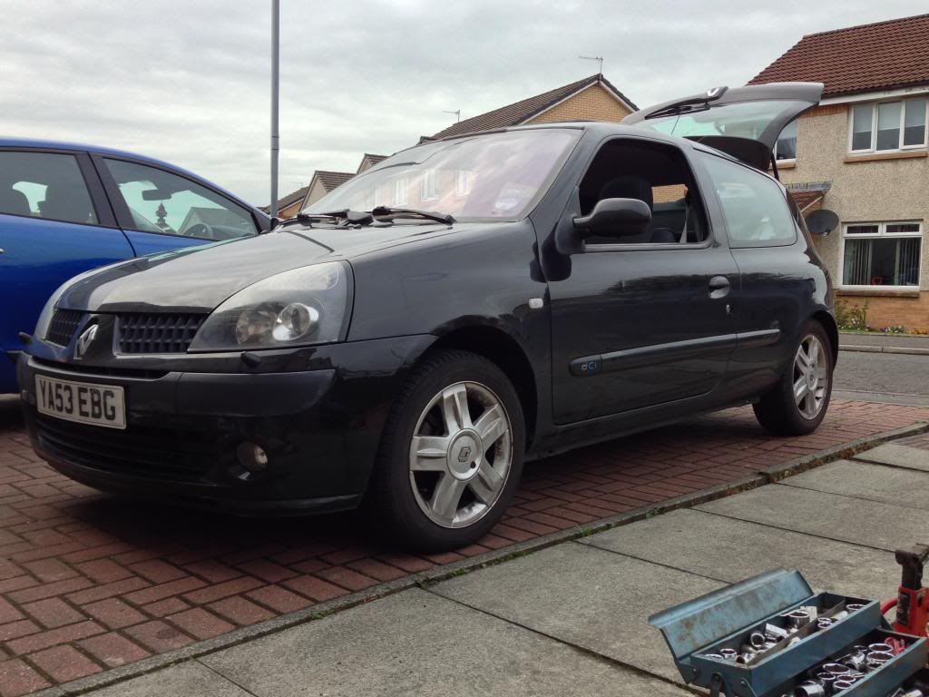

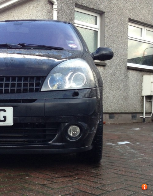

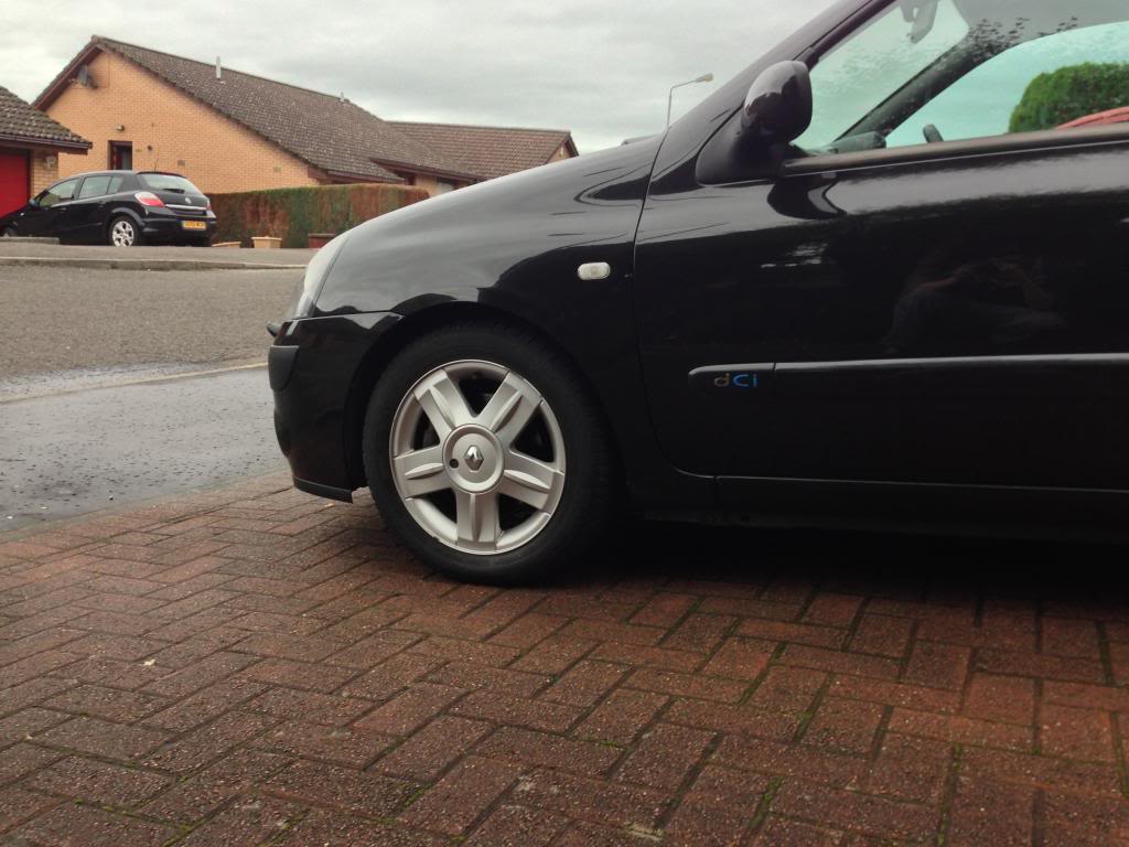

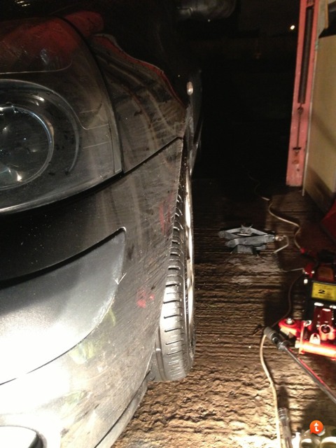

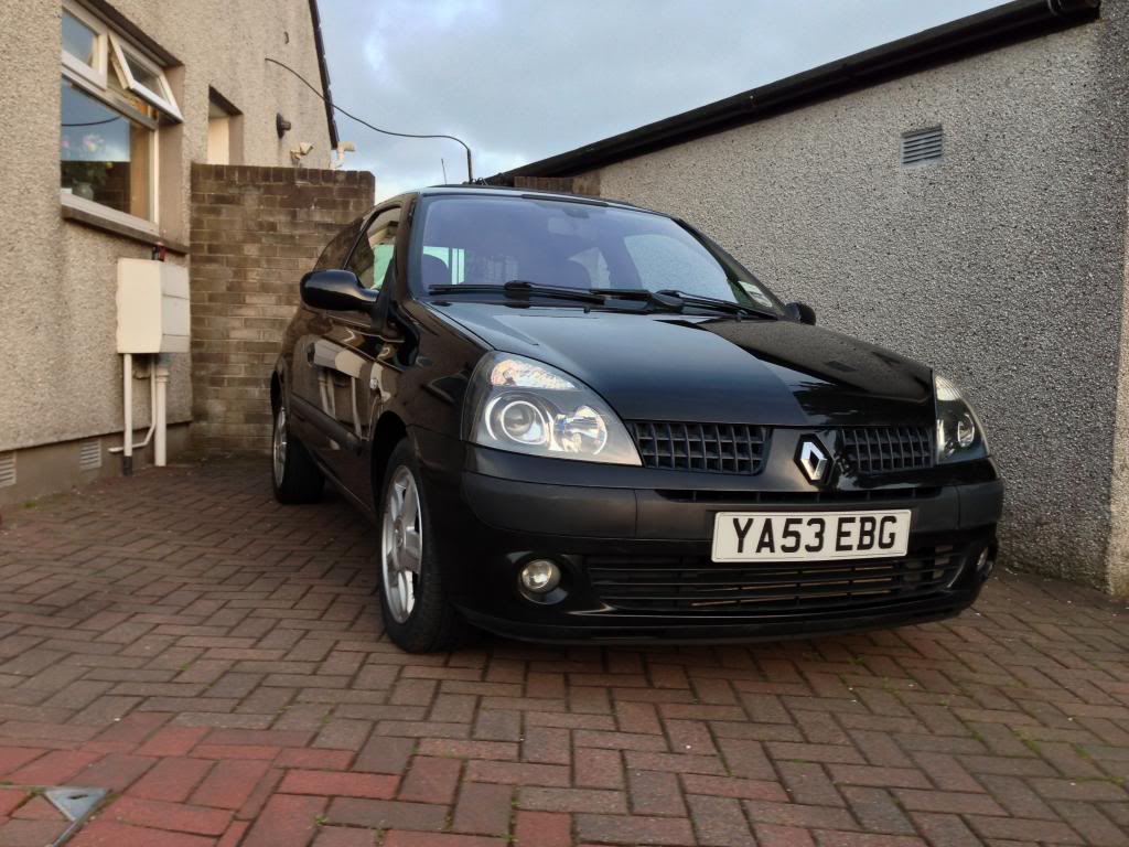

Got my front spacers in the post on Thursday, fitted them last night
Before:
After:

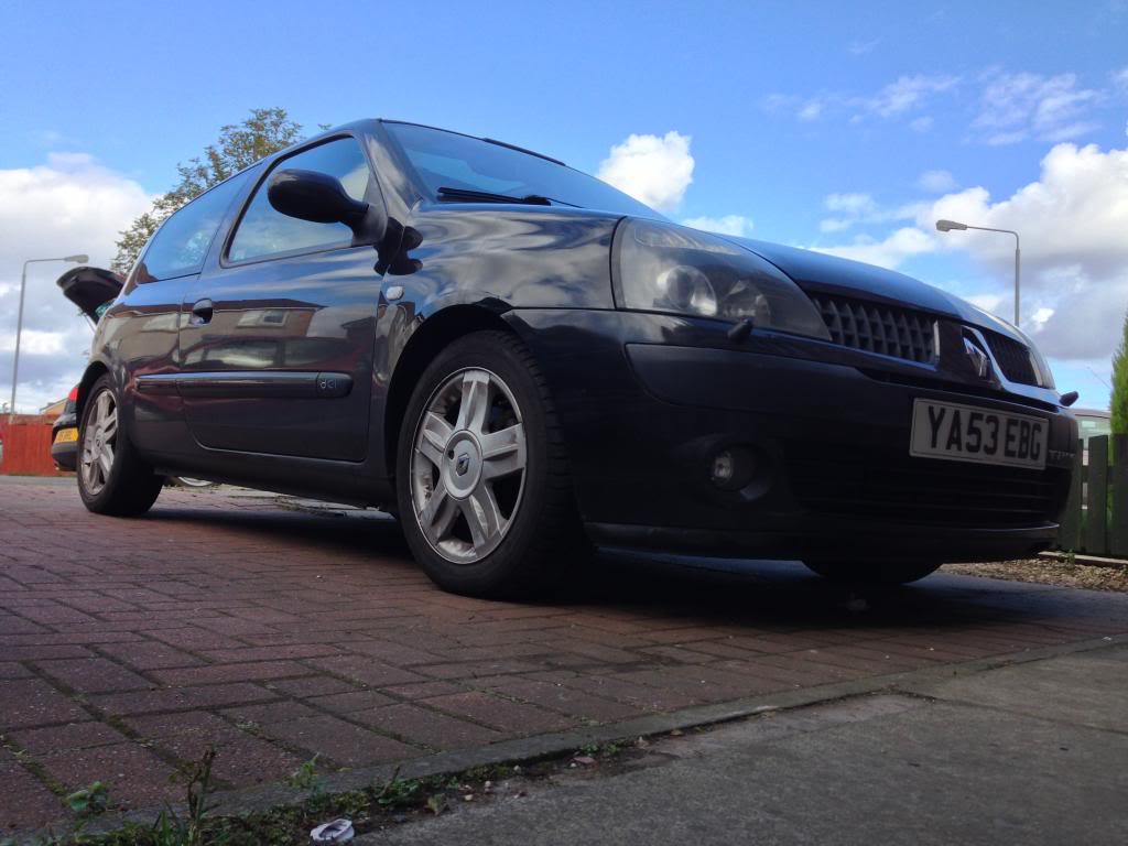

And a bit of a better picture from today in daylight!
Quite happy with the results. Should sit another 5mm further out once I put my 172 alloys on too. Now just got to get some rear spacers fitted. Rear wheels look even further in the arches now :(
Cheers for looking! :D

Put a light on the handle inside the bootlid, just as effective but also lights the rear of the car. And it doesn't have to be unplugged when you take your parcelshelf out.
The light i've got lights up a good area behind the car too. I just put it on the parcel shelf as it was the easiest place to wire to since I could just take a feed off the standard light. Couldn't be bothered wiring any further lol. It is a bit of a pain if need to take the shelf out but it's just connected on spade crimps.

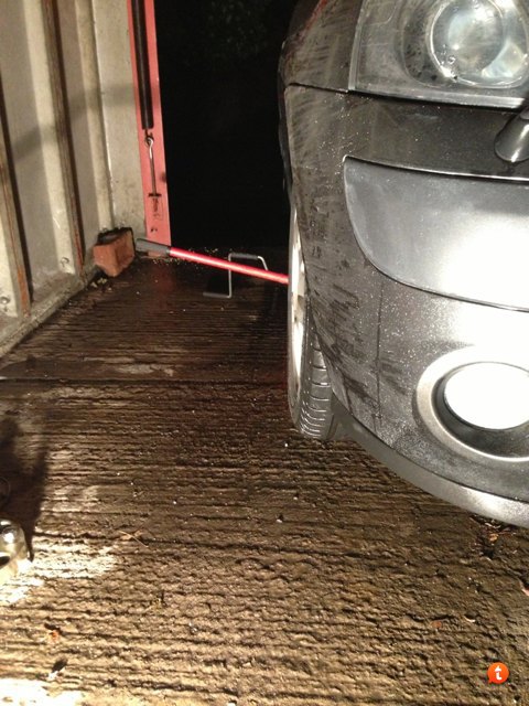

How big are those front spacers? Need to be careful with the rears as non sports don't have the same arch clearance as sports.
sburrell93
Scotland - South
Just flicked through your thread, Slight envy of your 100 horses. Looks good though
Cheers mate, the 100 is good but it's a lot harder to find some parts for which ends up being a bit of a nightmare at times.
They're 25mm, going for 15mm on the rear. I didn't realise that, thought the arch clearance on the back was the same! My wheels are sitting pretty far in though so I think I'll be fine with 15mm but I'll maybe measure just to make sure now.
  Many.
Didn't realise there was space for 25s on the front of a non sport! But tbh I never played with mine in that form.
15 on the rear might be a touch too much. The arch lip isn't rolled on non-sports, On sports it has a slight roll which gives loads more room (I'd say 7mm). I have a sport disc rear beam and 10mm spacers and had to roll my arches with 195/45/16 tyres on 172 wheels. You might get lucky, but check it first!

Yeah, there was loads of room under my arches. Looking at photos, they still sit in a bit further in than yours do on 25mm spacers with the sport setup and wings!
I've never really properly checked the back so you might be right. It looks like there's at least 20mm between the widest point on the arch and the edge of the wheels though. Is that the best way to check or should I be measuring from somewhere else?
  Many.
I'm not happy with my fronts tbh, but 30s is taking it a bit far and I'll probs have even more rubbing issues than I already do (Cup wishbones and how low it is causing it to rub the front arch liners)
Get the rear loaded up with people/heavy stuff and check, I found my wheels caught the arches in places I didn't expect at all. Otherwise, leave yourself a few mm's of clearance. I'm still battling mine!
sburrell93
Scotland - South
Yeah 30 is a lot! I think the fact mines only on sportlines is helping avoid rubbing. Did you notice an improvement in the handling with your spacers? Mine feels a LOT more stuck to the road but I don't know if I'm just imagining it lol.
I'll try that, hopefully I still have a good bit of clearance, back wheels sit so far in it just looks silly compared to the fronts!

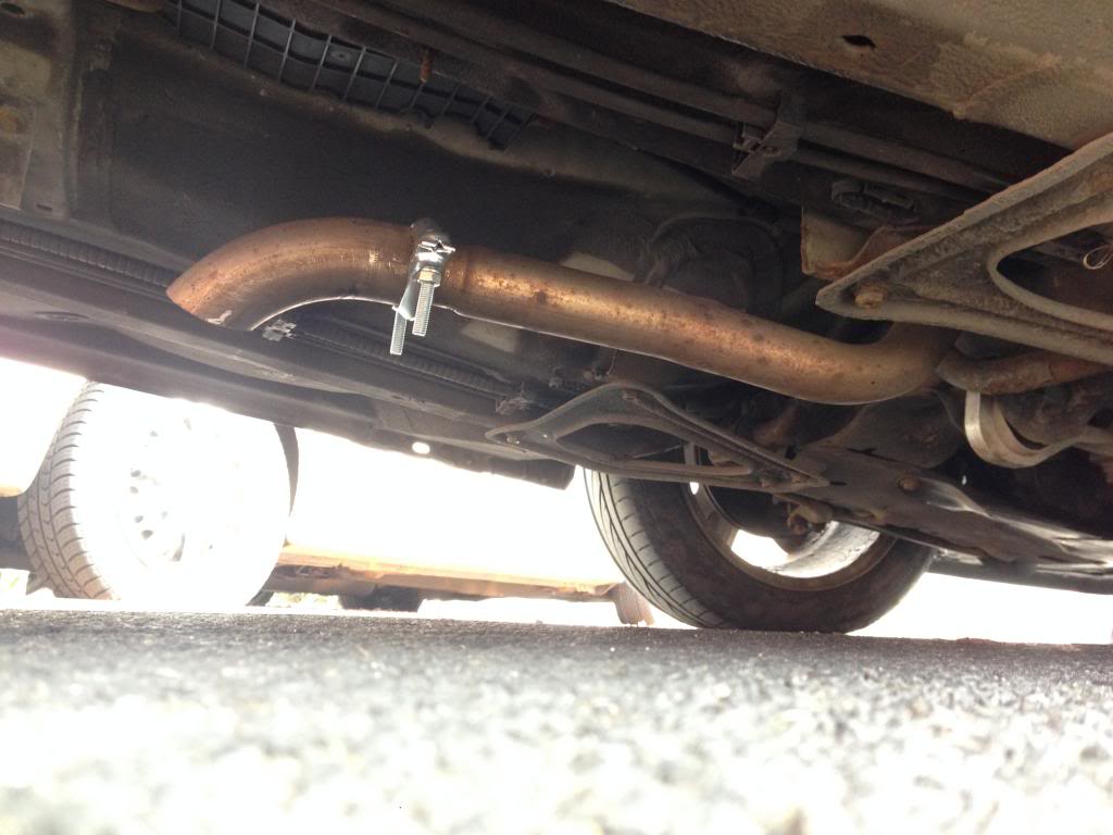

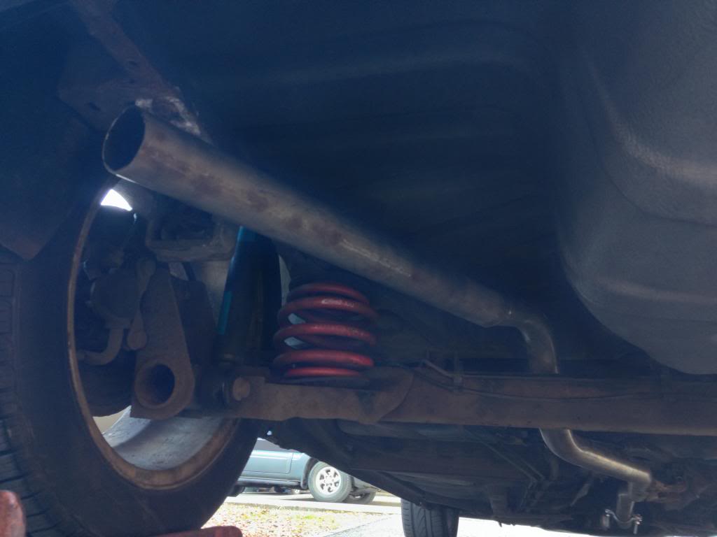

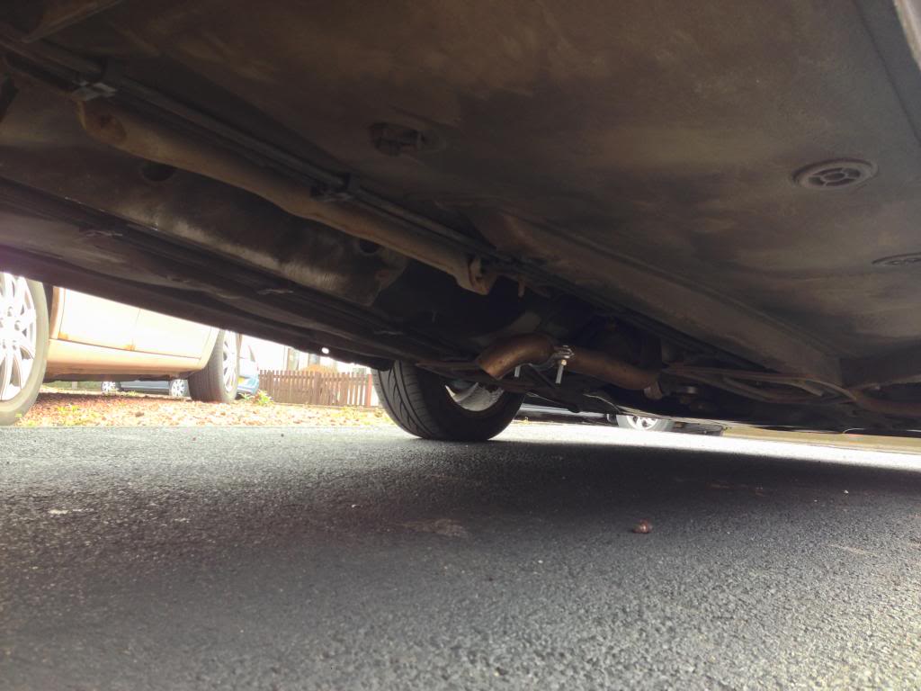

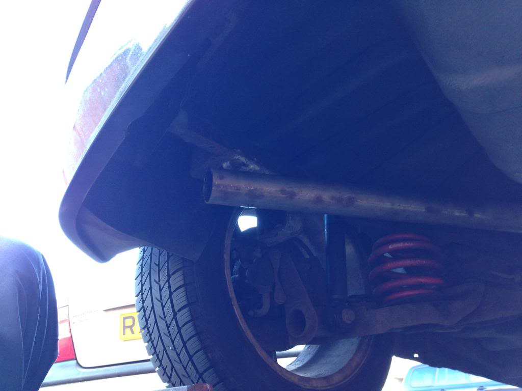

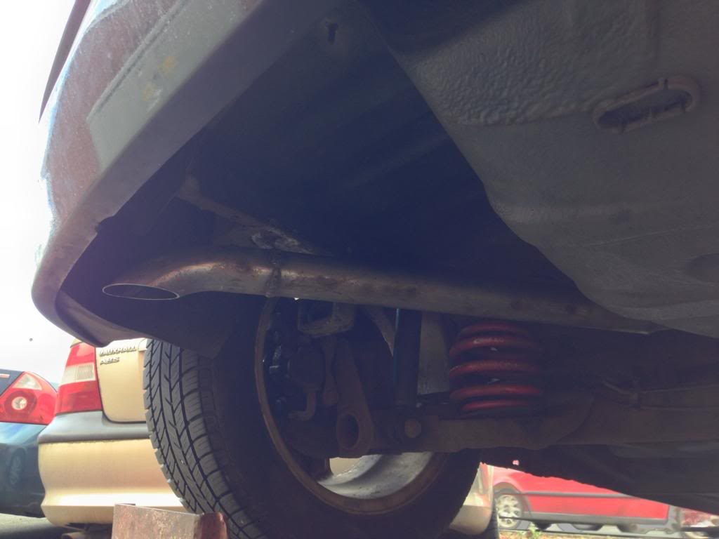

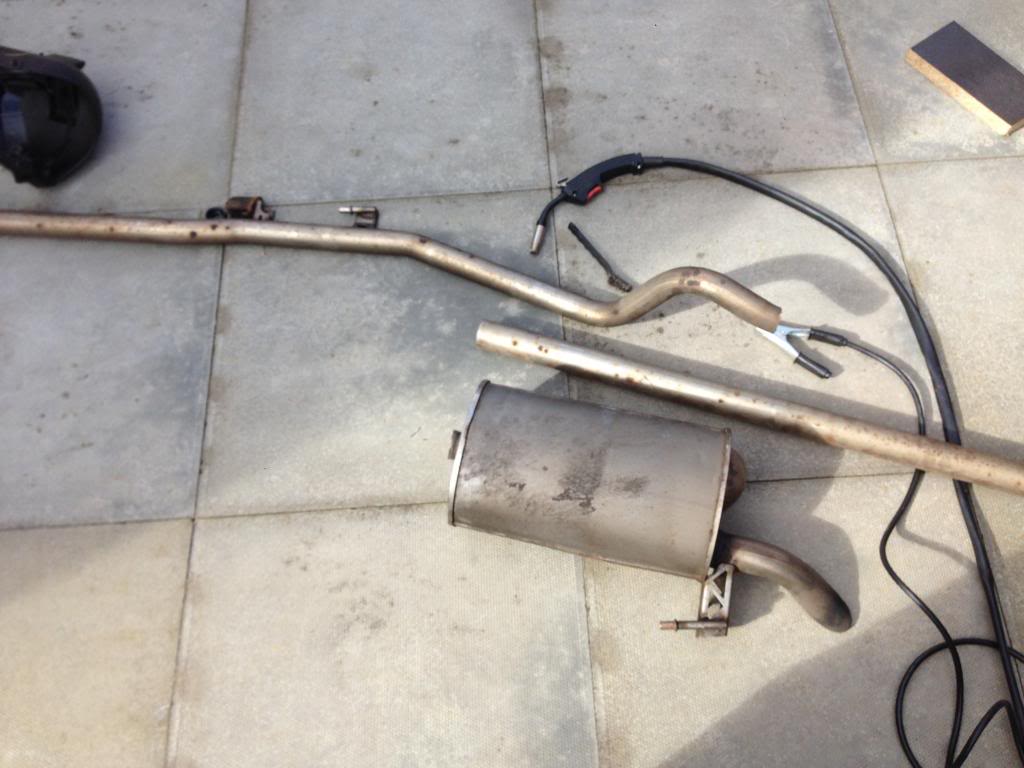

Smallish update. Removed the backbox from my car this weekend in prep of the remap i've been wanting for ages. Just need a decat first too.
Started on Saturday by going and getting some pipe from the scrappies and got bored so decided to do this:
Bodge jobs ftw! :DGave me an idea of how it would sound at least.
Finished it off today. Started with the backbox and rest of the pipe off the car like so, with the new pipe ready to be sized up and cut:
A few cuts and welds later, I had this:
And from that, I got this:
There's also a hanger been tacked onto the pipe now to stop it moving about too much, but was done after that photo was taken.
The downward facing tailpipe is only a temporary measure just now until I get a cut out in the bumper and get myself a decent tip, new hanger (possibly one of the red solid ones to stop it hitting the bumper once I cut it out), and a piece of exhaust surround trim from a 182 (anyone reading this with one spare give us a PM) ;)
Cheers for looking :) c+c welcome!

Looks good dude!
Best thing for the hanger is fill a standard mount with tigerseal or similar, powerflex (as per on my car too) splits after 5mins.
What you reckon to the sound?
Dr HMS Derv Destroyer
  MK1DTi/vivaro/corsa
That must of been loud as hell having the short one on lol
I loved mine without the exhaust on at all. Just the decat down ppipe lol
Tbh I wouldn't bother going uprated mounts mate, the exhaust will weigh f**k all
  Many.
I suggested making it like the first one to be sure he liked it, before cutting the backbox off.
When you're trying to get the exhaust lined up in a cut out perfectly, you want a uprated mount. I speak from experiance.
