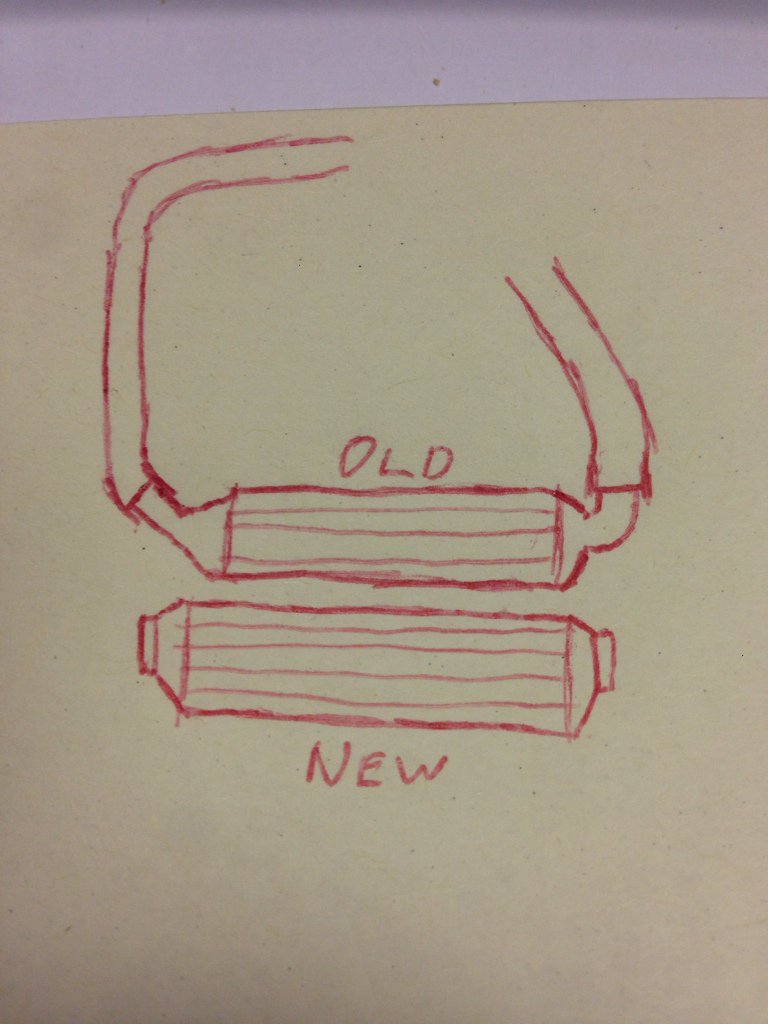

It's actually harder mate. Difficult to explain...2 secs I'll try and draw a picture lol
EDIT:
It's a bit like that. Easy enough to connect up the right hand side. Could use a 90 on that and mount the IC centrally, but as you can see on the left hand side, it's near impossible as the hose would have to double back on itself to connect up.
My other option is push the IC over to the right slightly, so I can use a 135 bend on the right hand side, and a 45 on the left. I just can't find a 135 reducer though

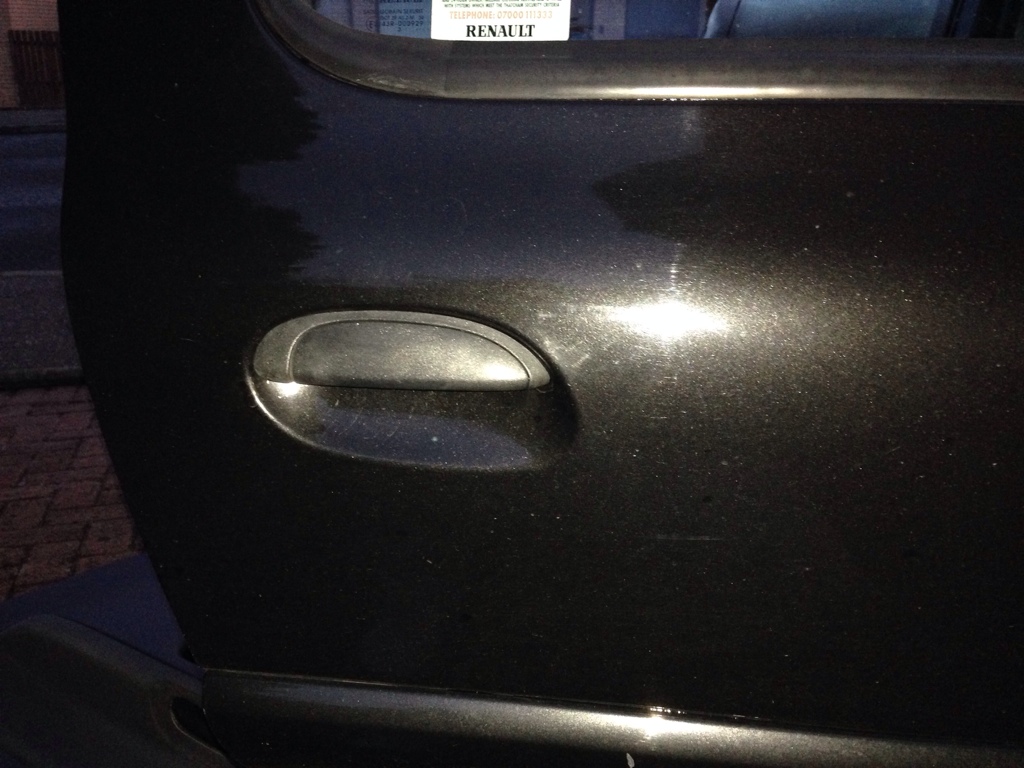

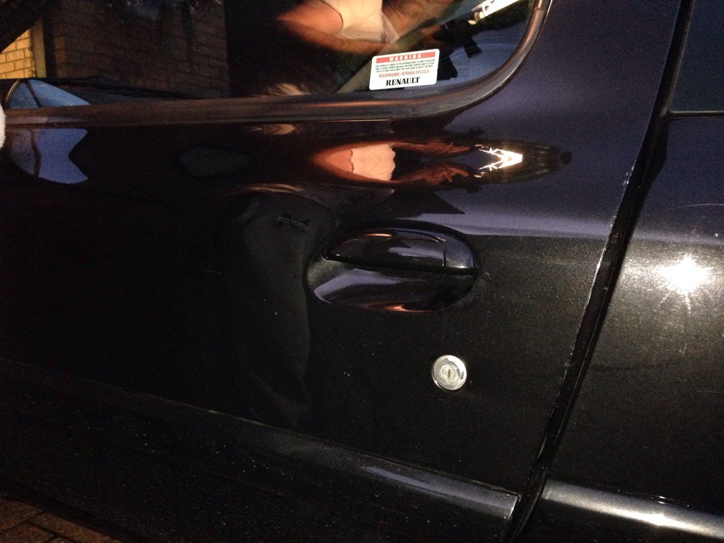

On another note, fitted colour coded door handles tonight. Not the greatest of pictures, was dark when I finished, but it looks so much better now.
Before:
And after:

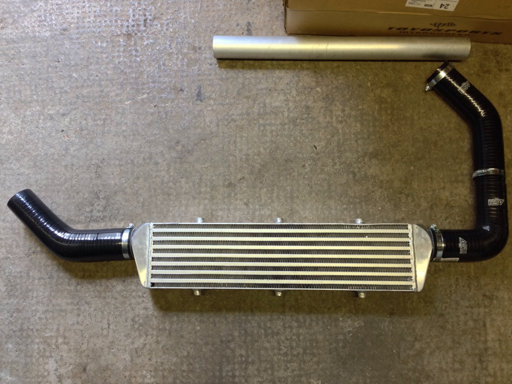

Silicone hoses arrived today. Couldn't get a 57-51mm 45 degree reducer anywhere, but they've sent me a 60-51mm reducer instead (on left in photo) so that'll be going on tight as f**k with a hose clamp and I'll just hope for the best until I can get a proper sized one.
This is the general layout I'm going for. Hoses will need shortened slightly though.

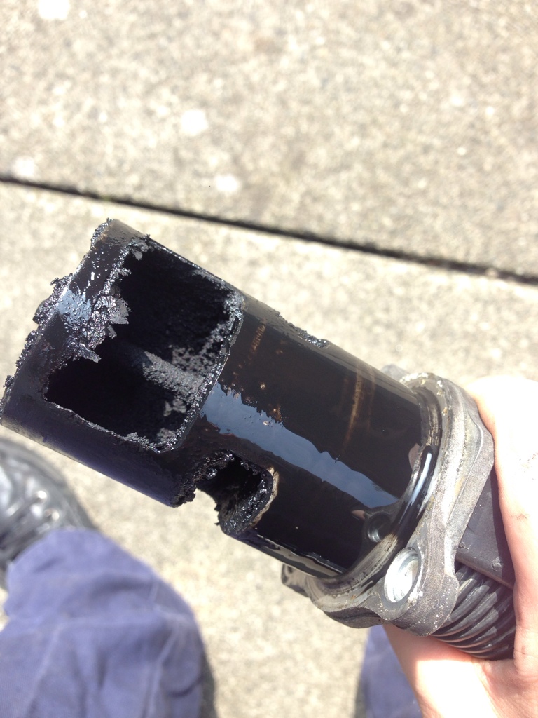

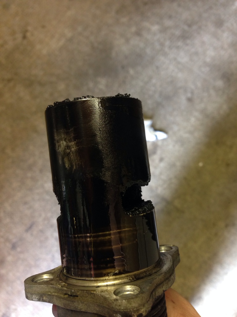

Decided to clean my egr and inlet pipe out today. Started with the pipe, which was minging! Didn't get any photos of it though.
Got these photos of the egr though
I know a bit of oily residue is normal, but f**k me, that was almost dripping off it. Worried my turbo is on its way out :( Car doesn't use any oil at all though which is the strange bit. Didn't have to top it up at all on the 9k miles between my last two services.
On a brighter note, everything is now all clean, and the car feels like it pulls a bit better.
How much oil was in the intercooler when you took it off?
It'll smoke before it goes completely if its leaking like that anyway.
There wasn't any pooled in the intercooler itself, but the pipes were a bit wet. It was just the egr that was like that. Car doesn't smoke at all really, and I've never noticed it using oil. Guess I'll just need to keep an eye on it.
How did you clean the hard pipe matey? I have found it a nightmare to get everything out and never have done completely
A really long screwdriver lol. Just used that to scrape all the gunk off the inside of the pipe. Done that as much as I could and then to pick up any loose stuff I used the screwdriver to push rags through and clean out what I could. Didn't really manage to get into the inside edge of the u-bend though, but it cleaned out the rest of it pretty well.

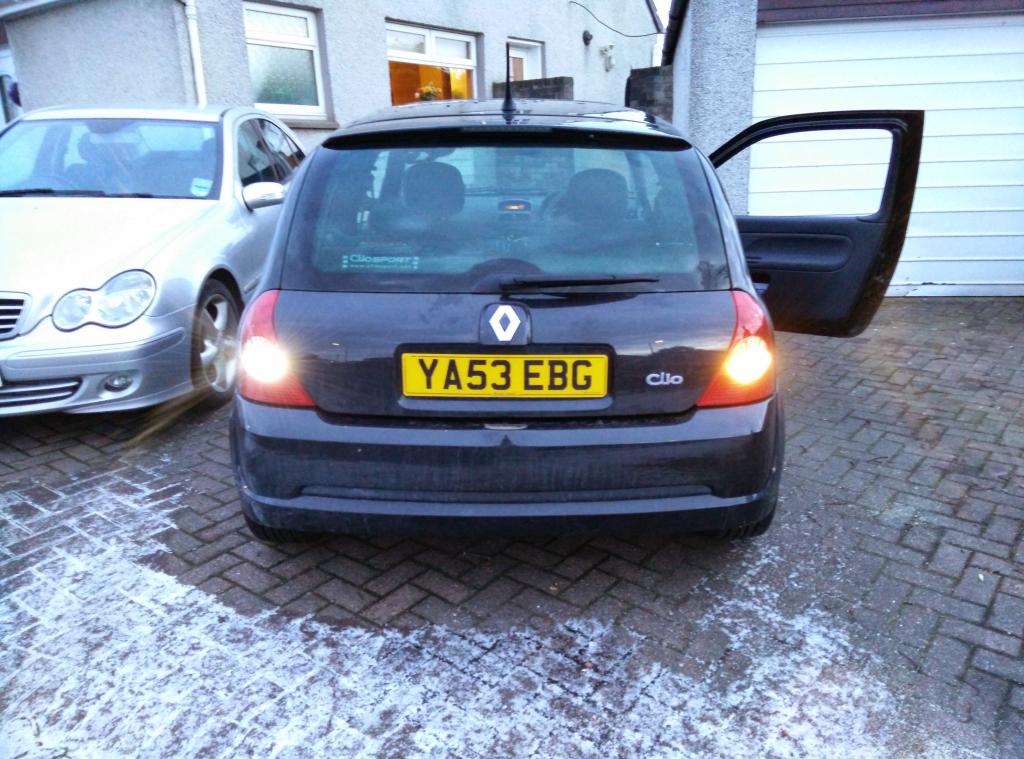

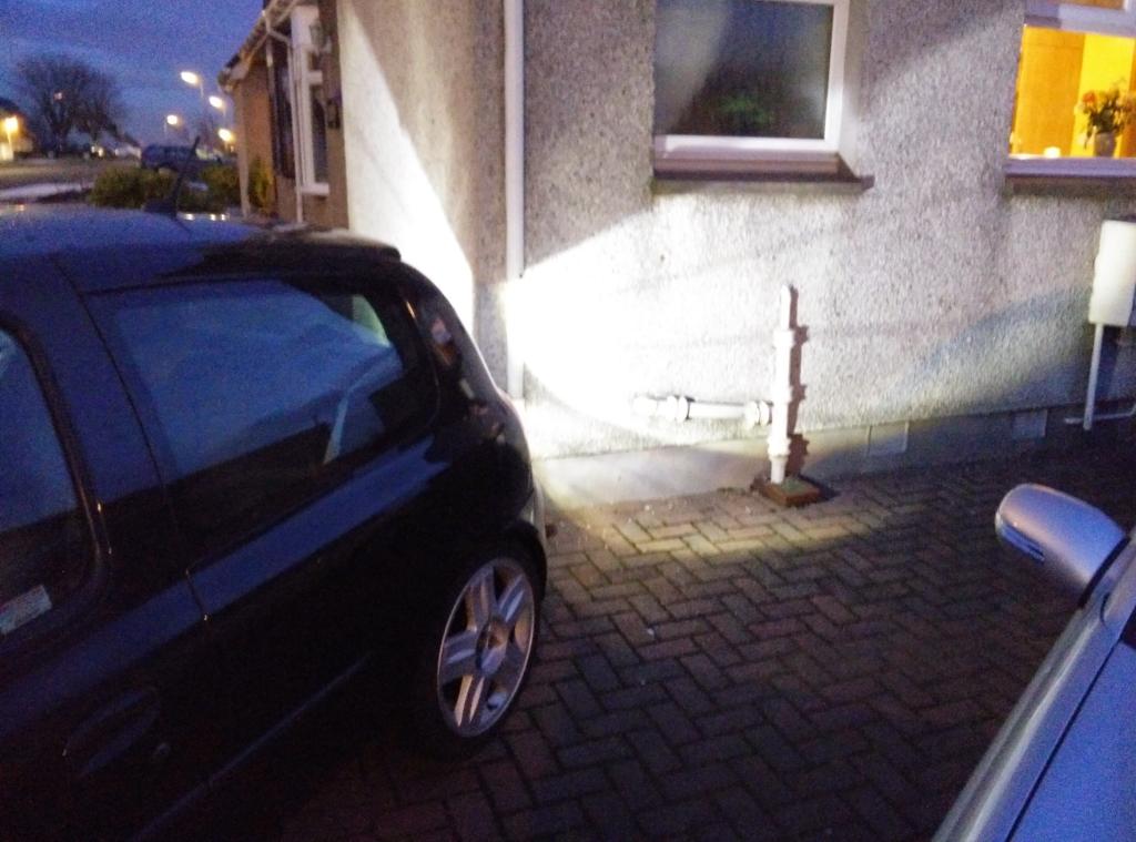

Anyway, I have a few updates! Ordered some LED reversing light bulbs (along with lots of other pointless s**t) one night while off work at Christmas, simply out of boredom. Got them fitted a week or so back after they took forever to arrive (from China, obviously).
These were what I ordered: http://www.ebay.co.uk/itm/121481123769
And here's how they look on the car (left is LED bulb, right is normal bulb):
They're quite impressive. Still really visible during the day too. At night though, they're just awesome.

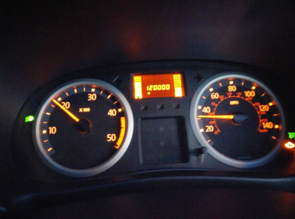

Besides that, there's not been much...car hit 120k the other day!

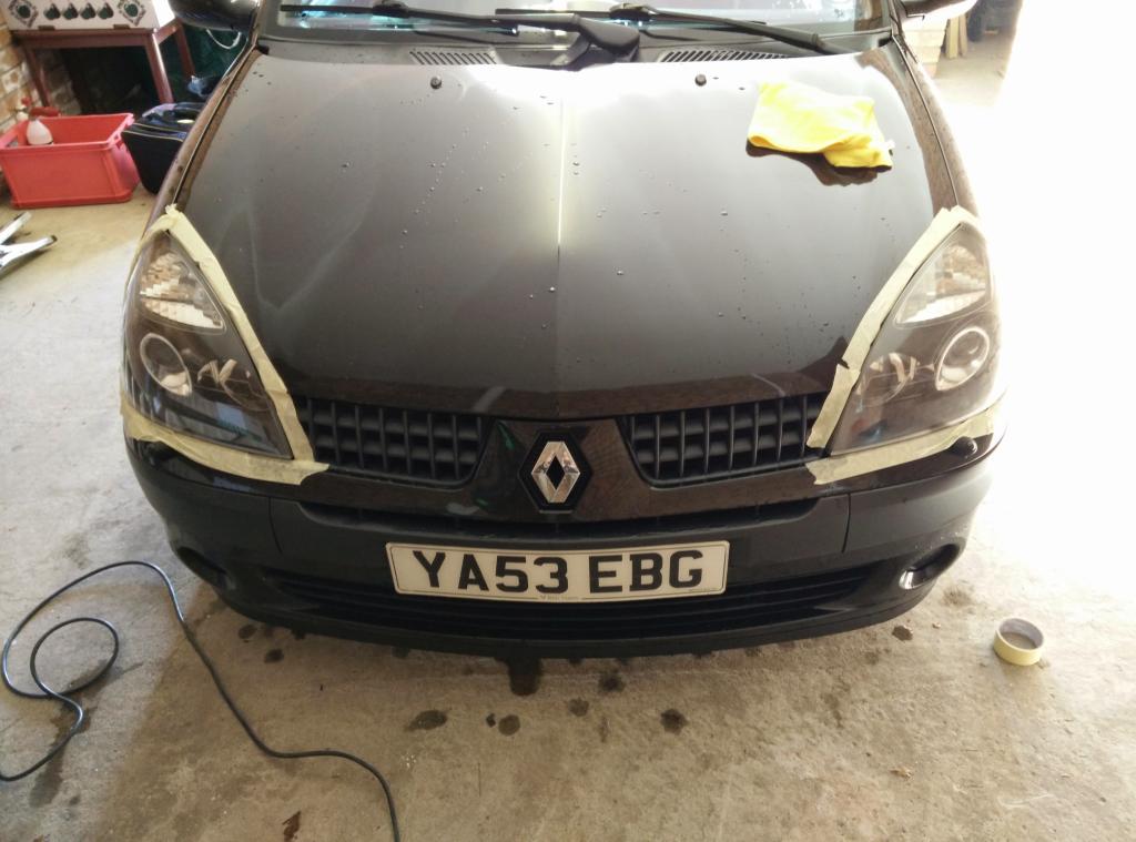

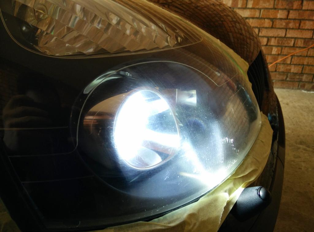

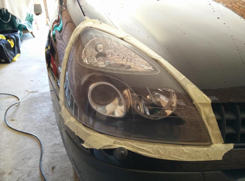

Set out today to clean the car up and get some photos of selling it. Ended up machine polishing the headlights and bonnet and completely neglected the inside!

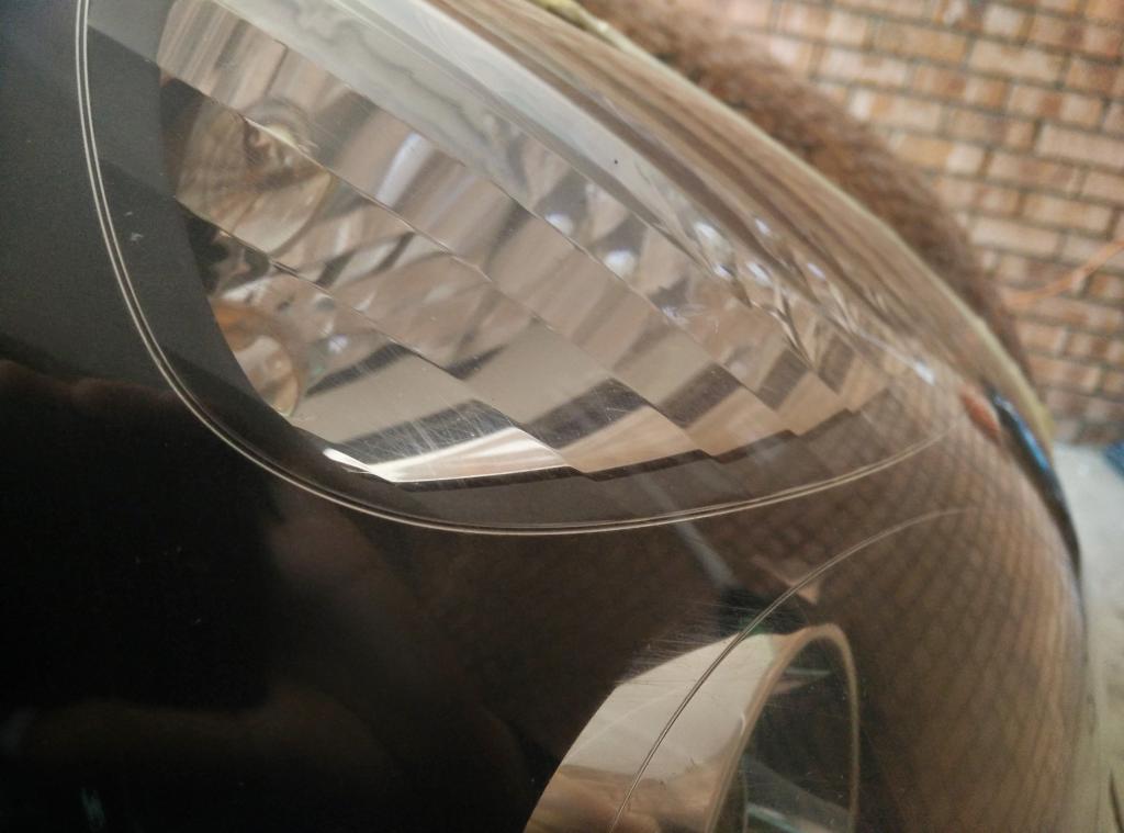

Got a few pictures of the headlights though, they weren't hazed before by any means, but they had loads of little scratches in them from when I'd done a terrible job with a 3M kit, as you can see.
^not in THAT bad condition to start with, but as said, the scratches were annoying me.
Aaaanndd drivers side done:
Then for some reason I forgot to take any actual close up photos of them finished, so this is all I've got:
Considering there were only a few scratches on the lenses, the difference is night and day! Done all this at my mates house, and when I was driving home the beam cut-off was so much sharper. Could really notice it when it was reflecting on signs at the side of the road. Sealed the lights with some Autofinesse Tough Coat for now, will strip that back off and coat them with DLux at some point when I know I'll have a 24hr dry period though. Bonnet also got a layer of tough coat, with Poorboys Black Hole applied beforehand. Don't know how well Tough Coat works on top of a glaze but it's all just practice at the moment really!

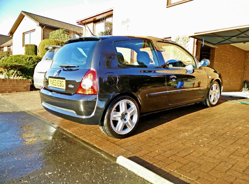

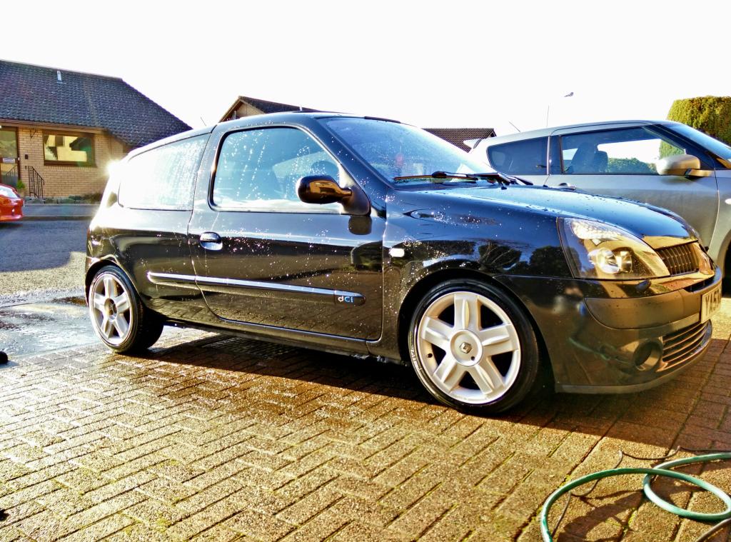

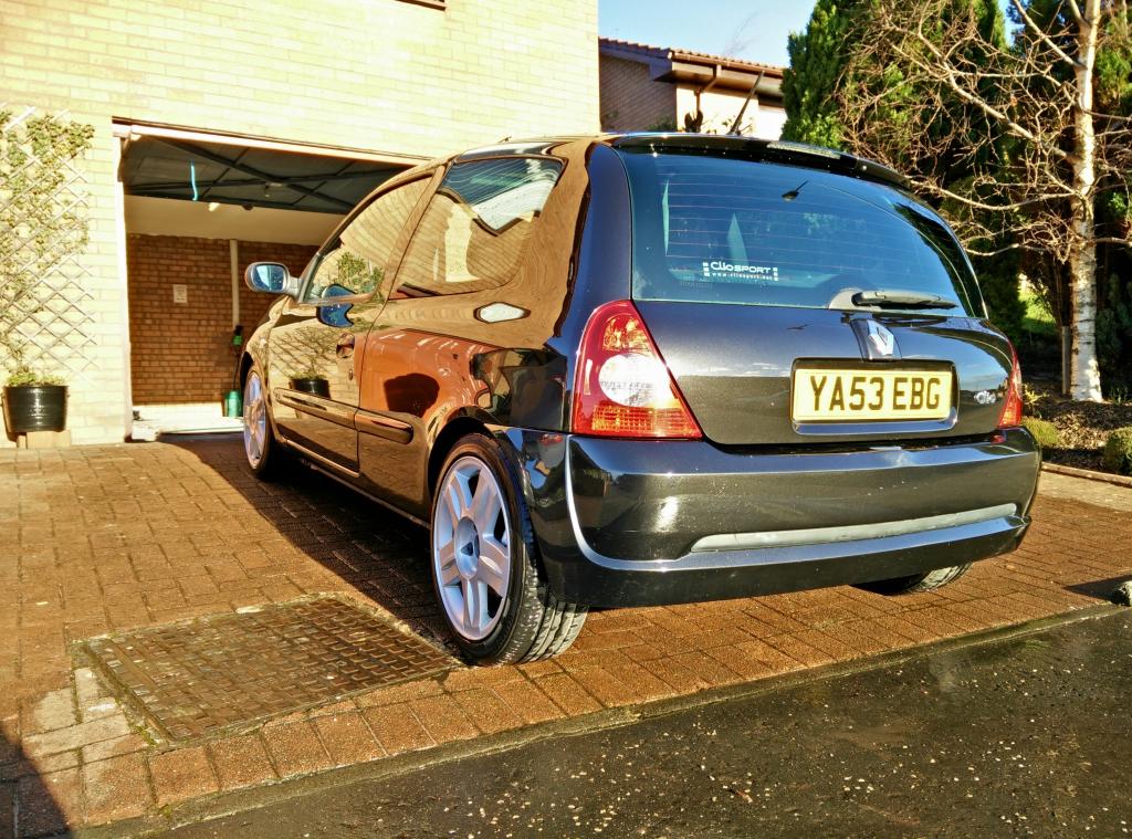

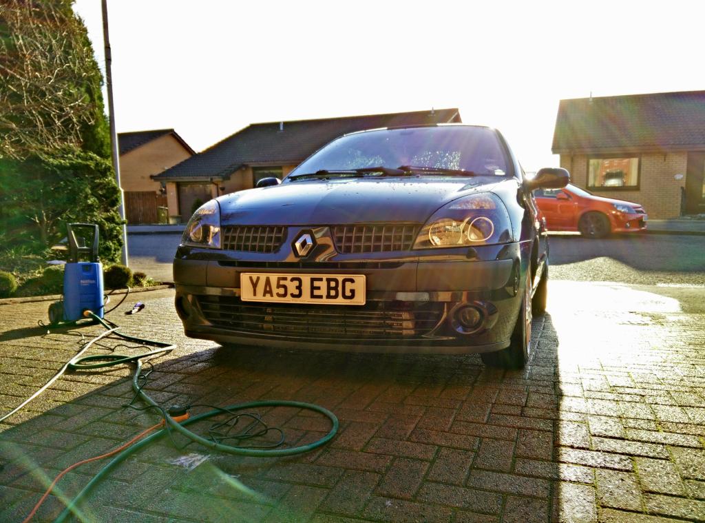

Few more pictures, trying out the HDR feature on my phone. Excuse the missing rear centre caps lol.
^^can really see how flatted the paint on that corner of the front bumper is in that photo. Only thing letting the car down really.
Went round all the plastics with AF Revive after I took the photos. After cleaning it today, I don't know if I even want to sell it any more! Still comes up so well for a 120k mile car.

headlights came up tip top. Need to do mine like that at somepoint! What compound did you use?
ps you want a 123d because the numbers are in a row, it pleases the mind.
I'm sure it was Menzerna 203s, which is now named PF2400. Started off with what I think was a white CG Hex pad (it's so old and used I'm not sure what colour it is now lol!) but it wasn't removing some of the marks so used an orange hex pad (medium-heavy cutting pad), and that done the trick. Didn't spend long on them, so they could still be improved but it's so so easy to remove marks from them with a machine polisher. The orange pad actually managed to remove a bit of hazing from the very side of one of the lights as well.
