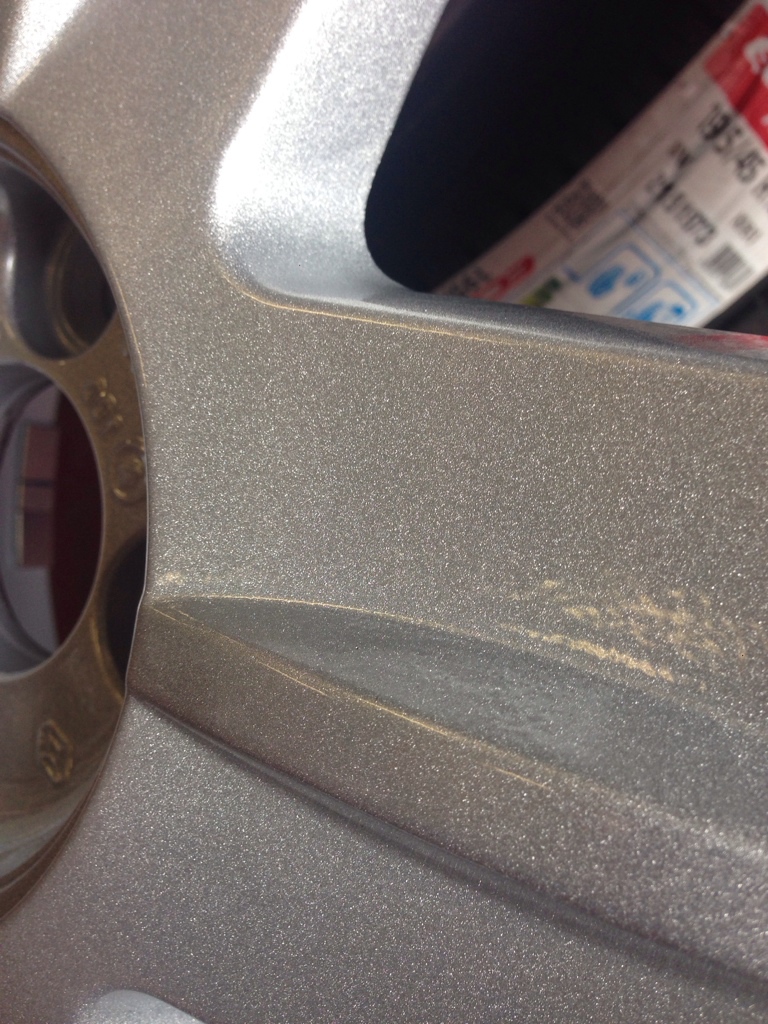

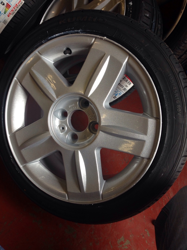

Went in early Friday morning to pick up my wheels. They weren't quite ready, so I waited around a couple of hours until they were out the oven and cooled down.
Definitely worth the wait. There were two of the wheels that were too corroded to repair fully, so there's a slight pitting in those, but overall the wheels look fantastic! Guy told me if I can find another two better condition wheels that I can replace the bad ones with, he would refurb them for me for nothing. Can't say fairer than that! Would definitely recommend them.
As soon as I picked the wheels up I went and got a set of tyres on them and got the wheels fitted as I was driving 180 miles up north that day and really needed new tyres. Got 4 Kumho KH31's on them, and so far can't fault them for the price. £270 fitted for the 4 of them!
Anyway on to a few crap iPhone photos
Shiny!
And fitted, minus the centre caps
Going to try and get some proper photos later in the week, rather than terrible iPhone ones!

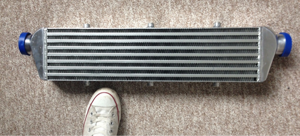

So I bought this
Going to get the pipework ordered this week and hopefully get it fitted at the weekend.
