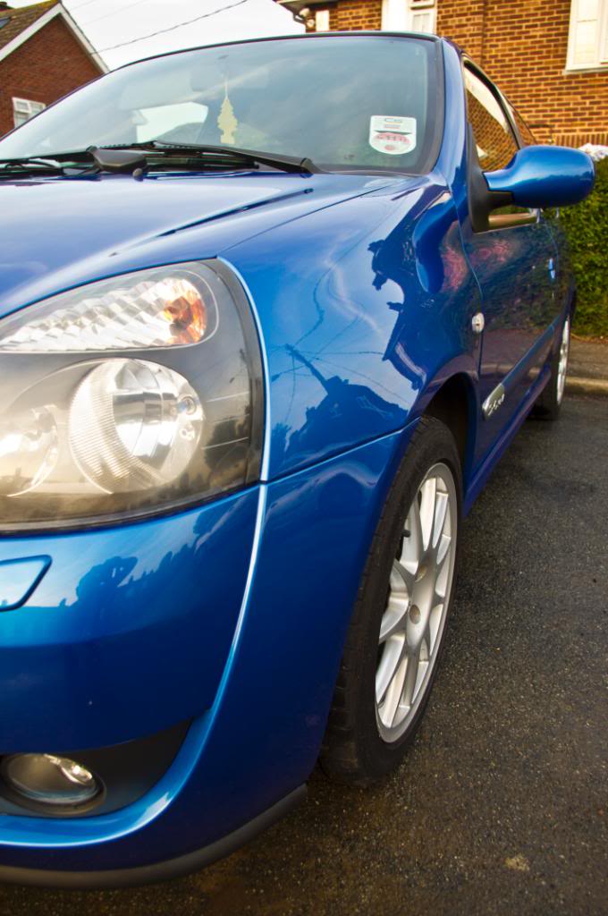

First job was a thorough clean and once over, I didn't get many Photos as only had my iPhone on me but here is a couple;
Cleaned with Auto Glym shampoo 2 bucket method, clay bar'd, polished with SPR, and sealed with Auto Glym High Def Wax.

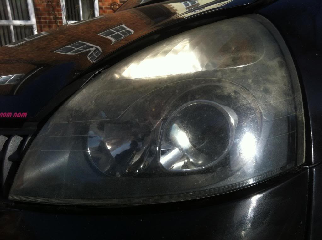

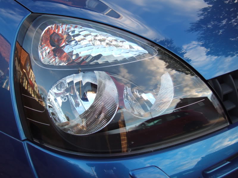

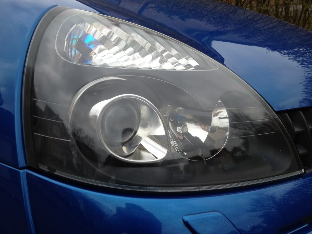

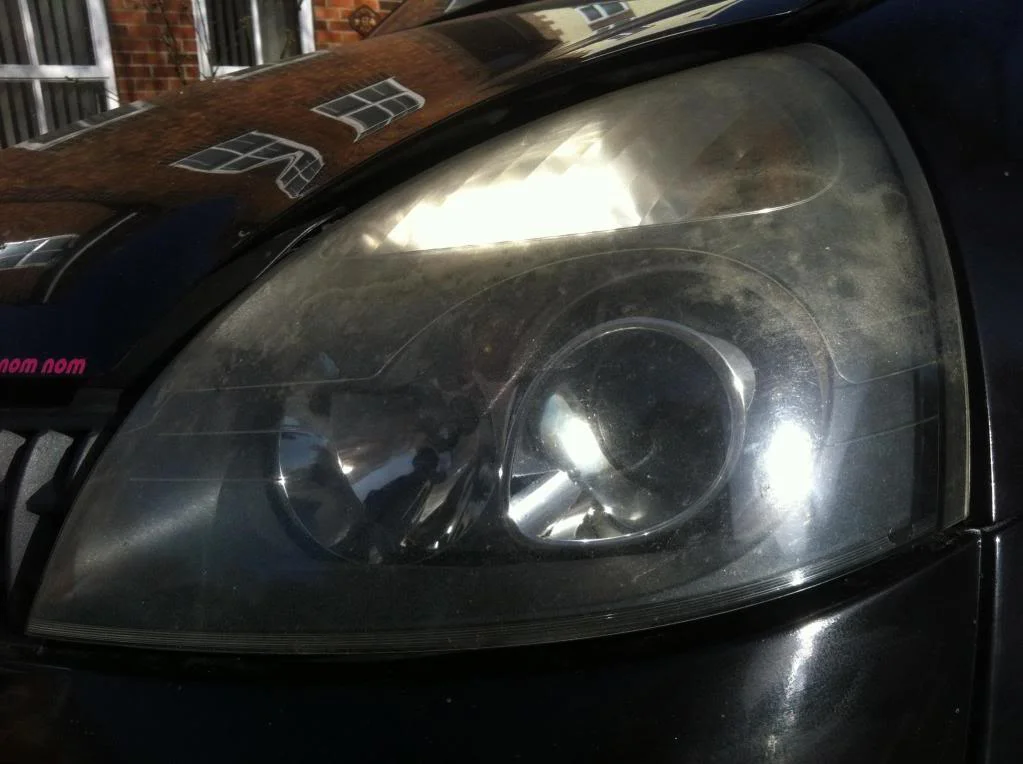

Next job was to sand down the front lights as they were rather cloudy;
Before
After

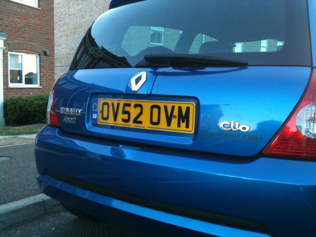

After that I fitted my new 3/4 front plate and standard rear plate that I bought from fancyplates.com
Front before
During
After
Rear Before
Rear After

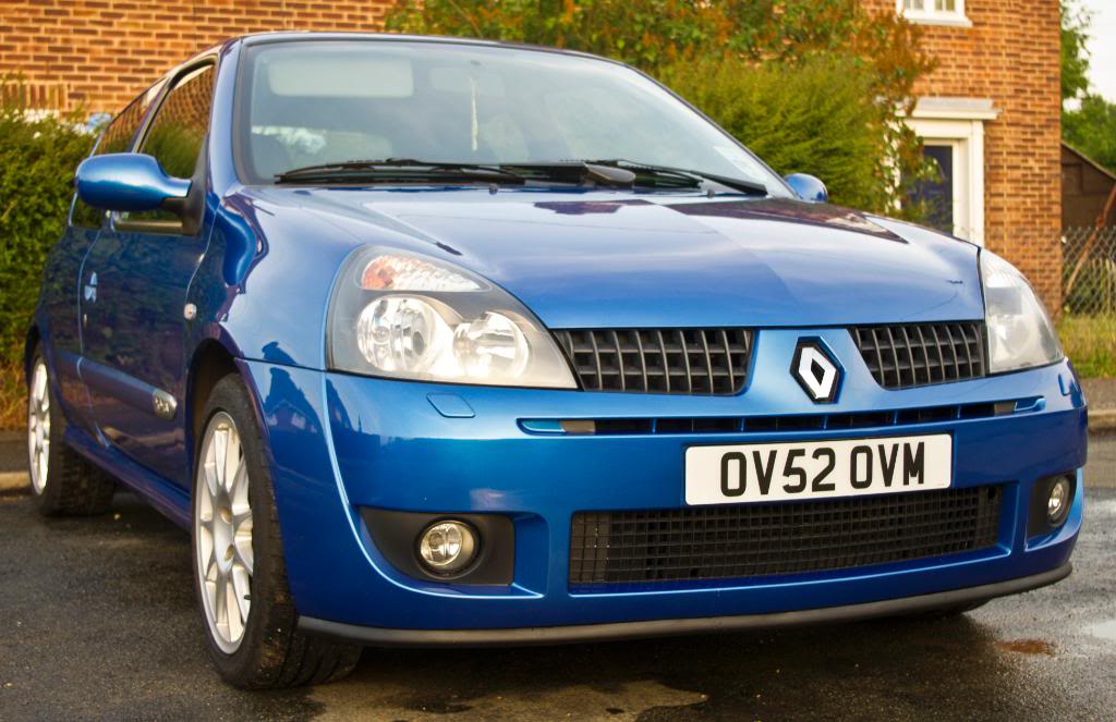

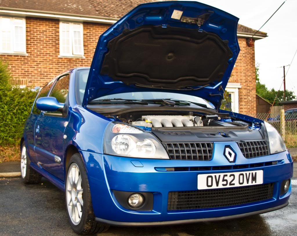

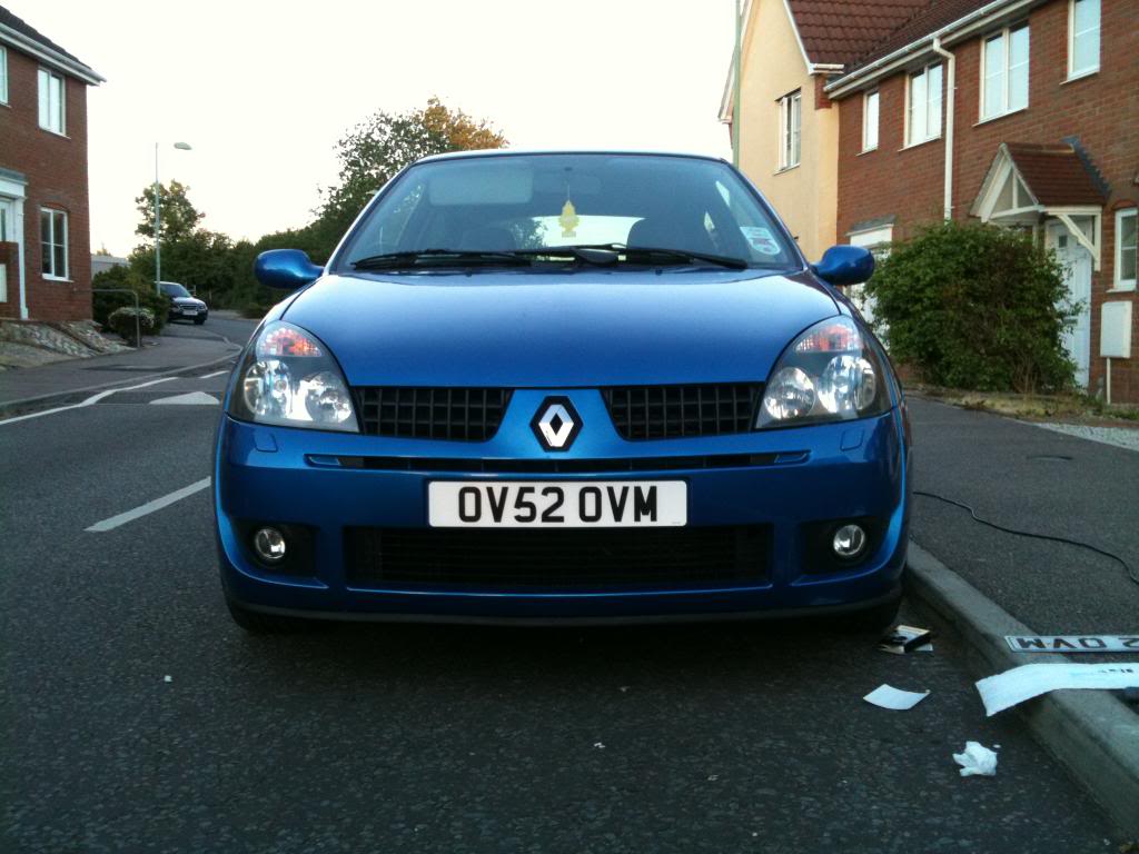

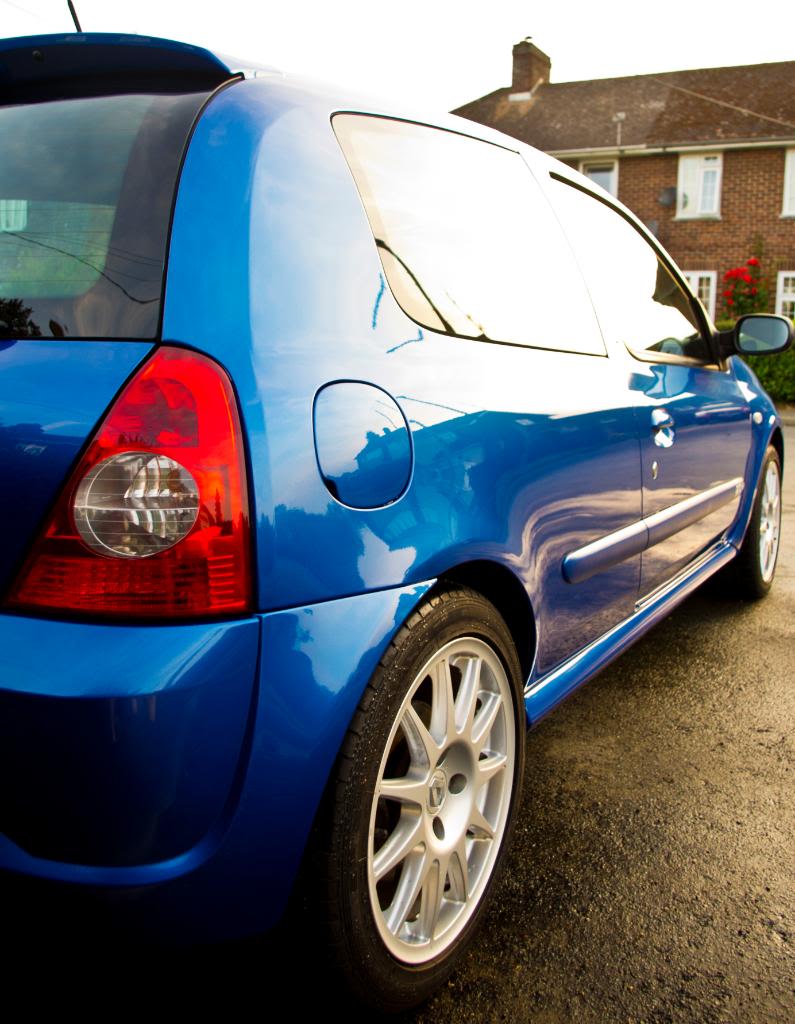

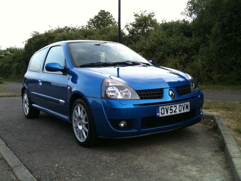

I gave her another clean on Sunday and as I bought a new memory card thought I would grab some quick snaps.
Its green from the reflection of the hedge.

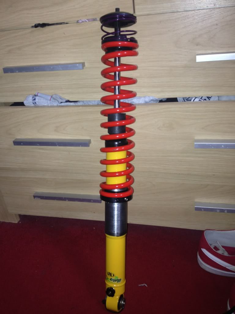

Reading from where we left off I purchased some Sportline springs but never got any Photo's off the fitting process...sorry. But I must say as its been said so many times on this fourms these springs are awesome!

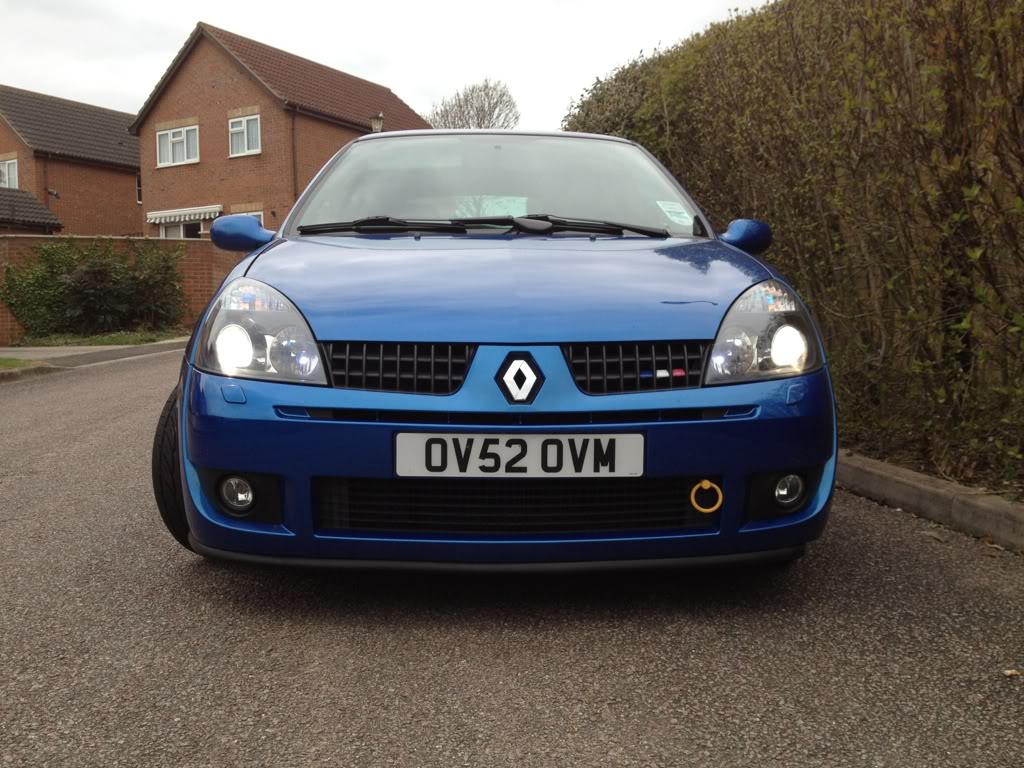

As you can see I fitted an OMP tow eye and well as a French flag on the grill...Thanks Banderson:)

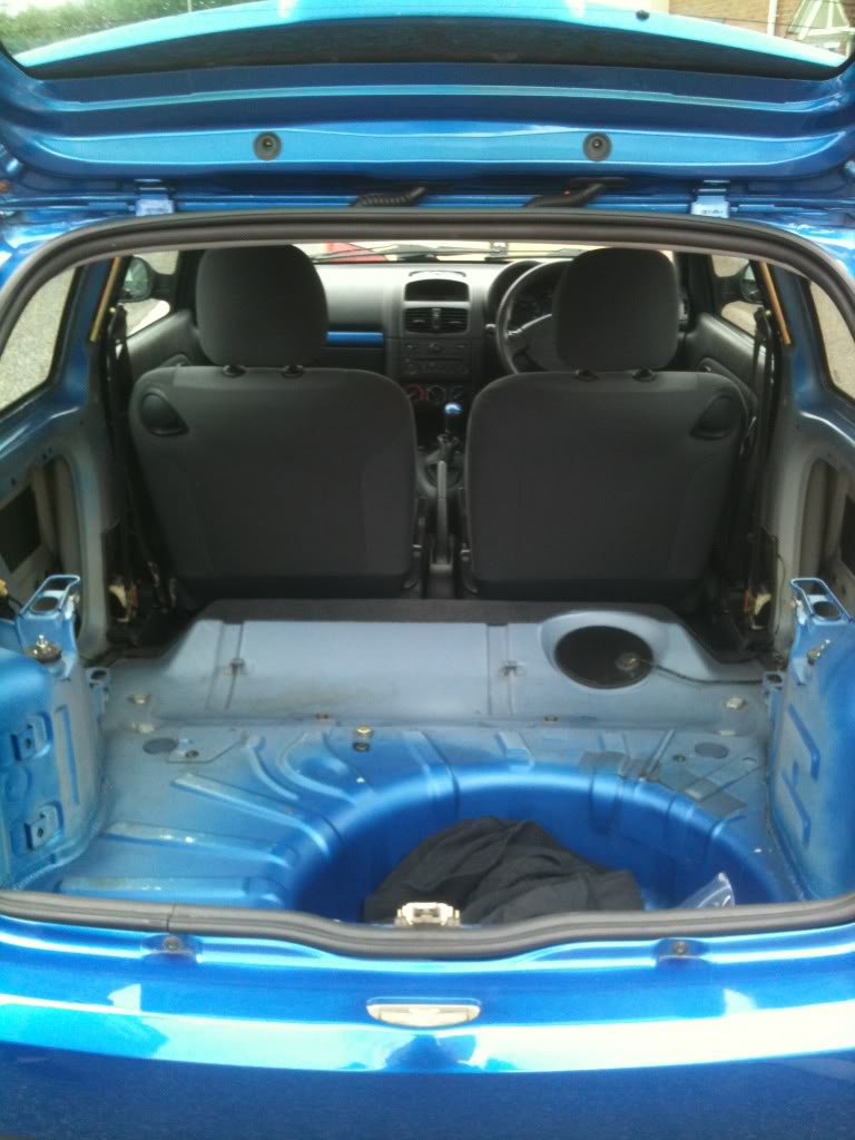

I decided that I wanted to take the rear seats out aswell as the door cars etc. I would call it stripping it but compared to what some of you do its no where near! So one lunch time, bored at work I cracked on. Starting on the left ISO bolt after two or three turns it didn't want to move any more, ending in me sheering it off. I read alot on the fourm that this can happen so tbh it was expected!
Buy the end of my lunch break I had only drilled out one bolt thinking to myself that it may not be the best idea! So using a nut and bolt I secured it back into place.
I then spoke to Rhys and we arrenged for me to go over one evening and we would crack on with it. As expected the right ISO bar bolt also snapped! So the drill came out once again!

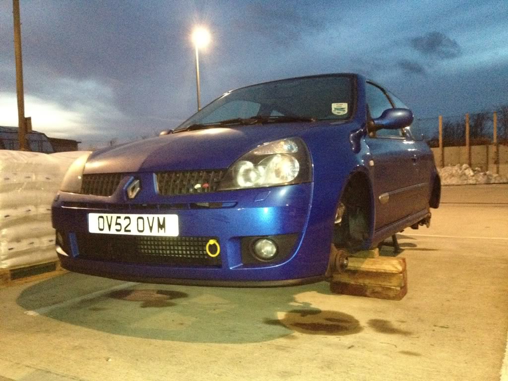

As I work for THE Universty of Cambridge as a Lift Engineer we have to have 24 hour back up for entrapments. This has its advantages as it means 1in4 weeks I get a van for a week so the car is not needed:)

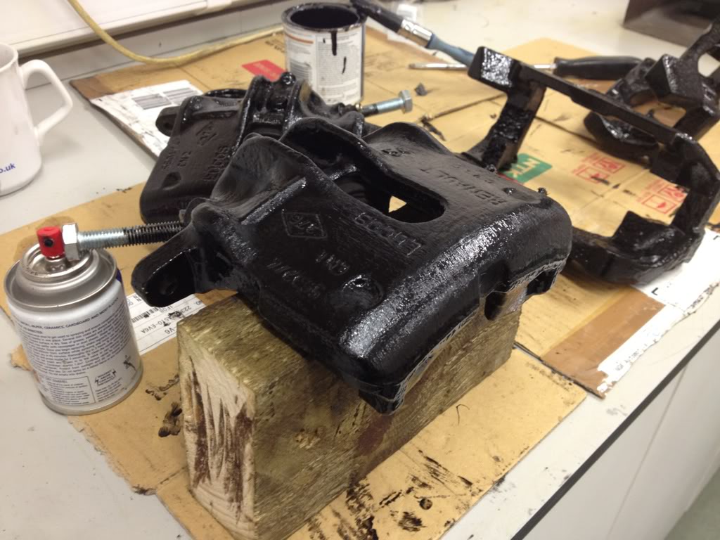

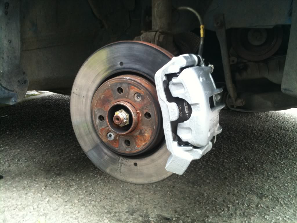

I took this advantage and began installing the new breaks during my week, I done this at work as we have a varity of tools and an ex machnic who is handy if you need a hand. Now apparenlty the big boss was pulling her hair out moaning that it looks like a scrap yard, people where moaning (builders, Plumbers and Sparkys etc, not my men lol) that I was working over my lunch break (I wasen't). Anyway like most managers she didn't have to b****cks to come to me direct and moan so I just cracked on with it and made sure even more I was out there from 1 untill 2.

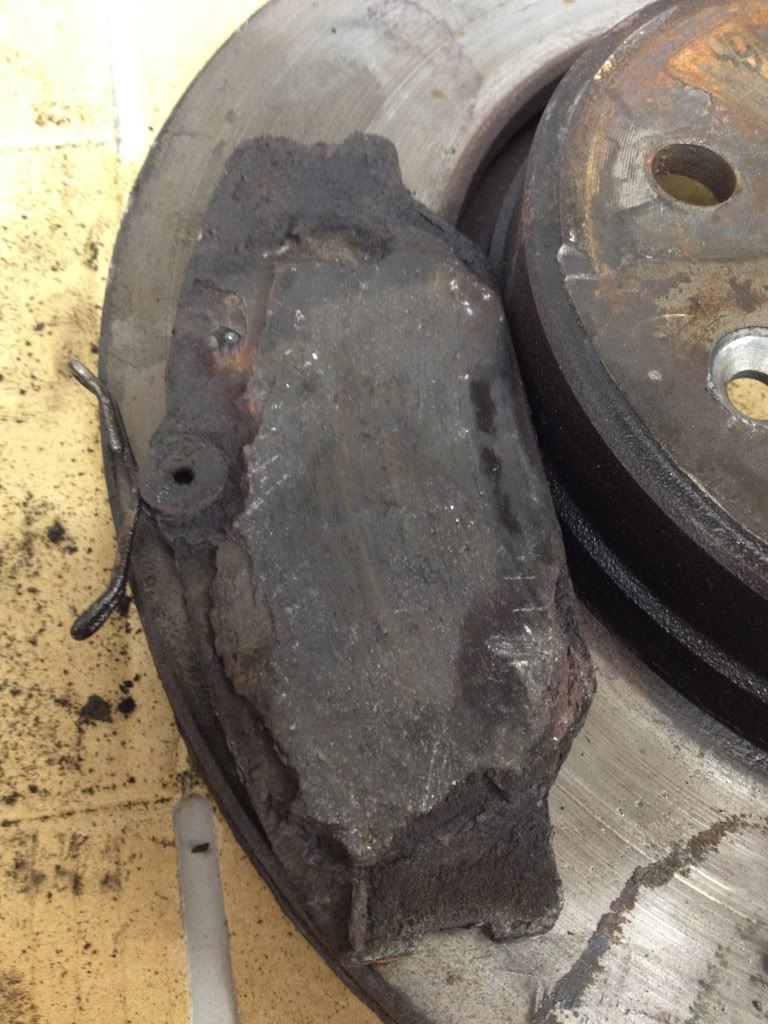

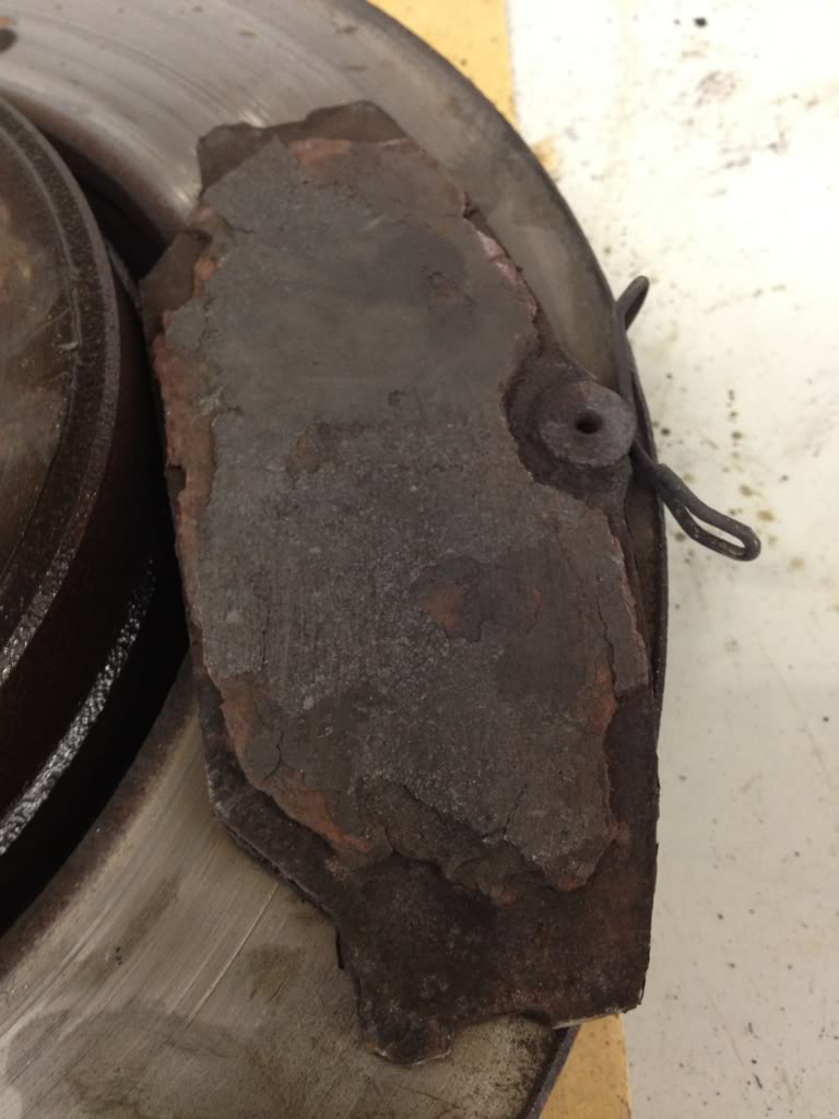

I got them off and the front pads where a mess, tbh im sureprised I stopped!

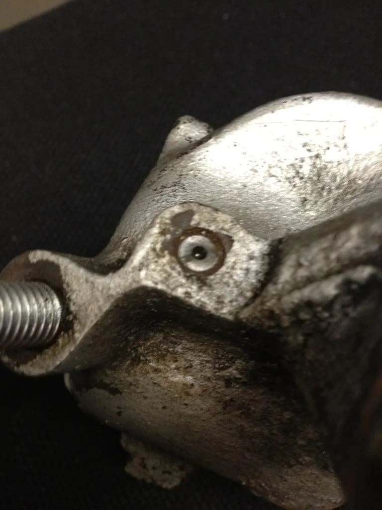

While they was off I had ago at lossening the bleed nipples, but of course one snapped!
This caliper was then taken to the Engineering Department and using there best macheist we managed to get it out! I then ordered some more bleed nipples and away the fitting process began.
I gave them all another lick of paint, but black this time, still not yellow:) Tbh tho I wish I never bothered! Waiting for it to dry and cover the silver was a pain!
Fitting was finally done, I wish I never done it at work, painted them again or infact took the calipers off atall lol.

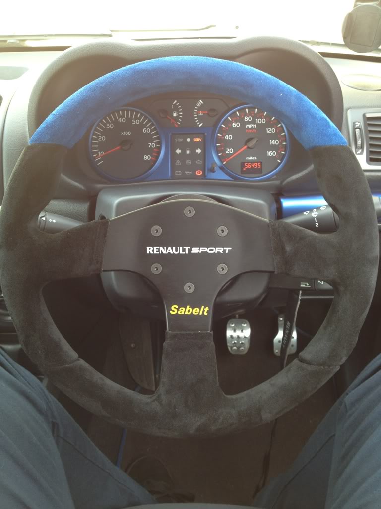

A few days after the brakes where done I decided I wanted a new steering wheel, the standard that I was going to replace was infact in good condition, thumbs grips in tack and the usual melting but apart from that it was all good, I just hated the size of the thing! Clio...more like a bus! This has to be so far one of the best Mods I have done to the car!
Of course I went for a Sabelt wheel, bought from again West Renault. I then bought a second hand OMP Boss from eBay and finally botled it all on.
As I said above its such an awesome wheel and modification but they soon get grubby and the suede wheres fast!

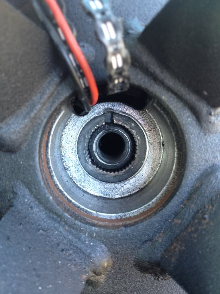

Once it was on I noticed my track was out fairly bad, so I took the wheel off again to have a look at how I match up the boss.
It was dark when I fitted it! Now of course I could of just taken the Boss off and fitted stright, but for the life of me I couldn't! Not sure if this is a commen problem?

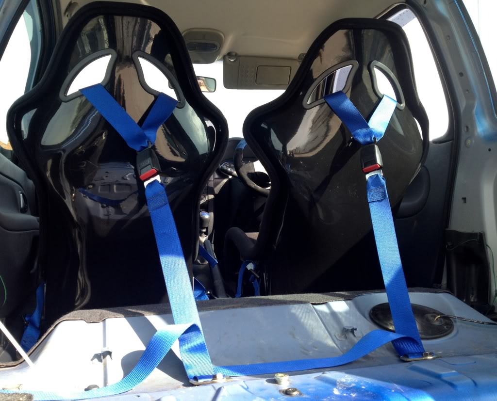

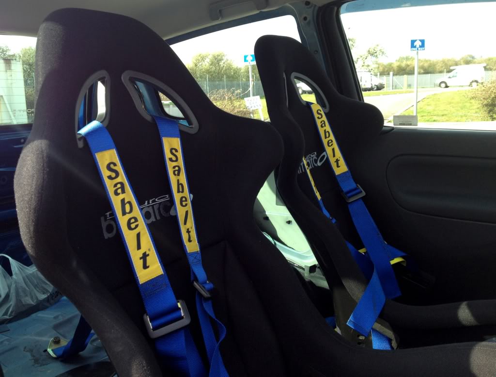

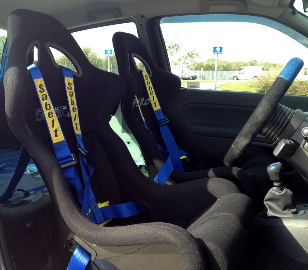

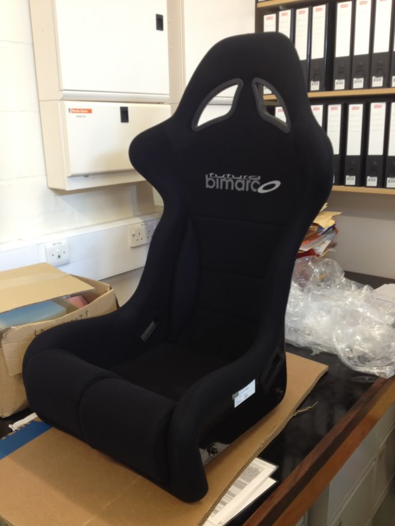

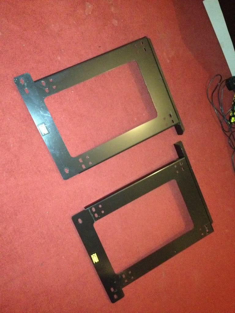

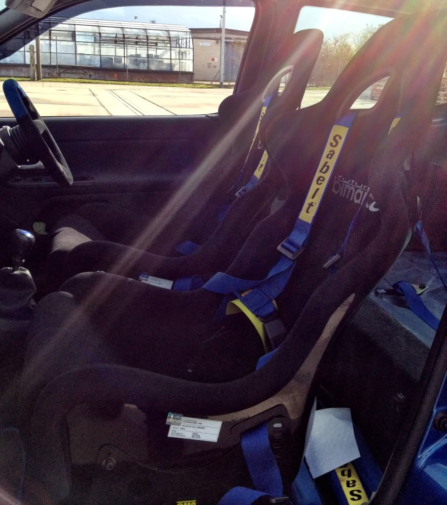

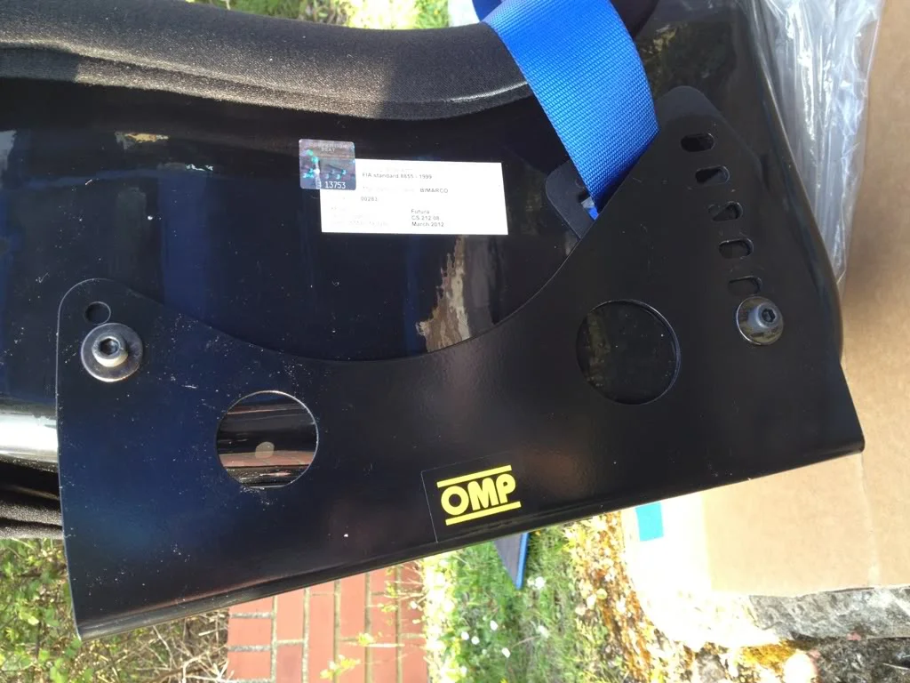

Next I got in the mood to buy some seats and harnesses, after searching around here etc I went for these.
Bought from Poland from Bimarco there self, worked out at around £422 for two inc delivery which took 3 days! Still havent fitted them yet as I'm waiting on sidemounts from YB Racing which should of been posted today. These have taken longer than the seats! There at a very good price £61 a pair, but I should of really gone to Kam or Demon as I'm sure they would of been here by now!
I also bought some OMP Subframes from eBay at £98 second hand but with just a few marks on them.
I then got some Harnesses from Gumtree and of course they have to match the steering wheel.
Just cant wait to get them all fitted! Been sitting in it most nights playing Forza 4!

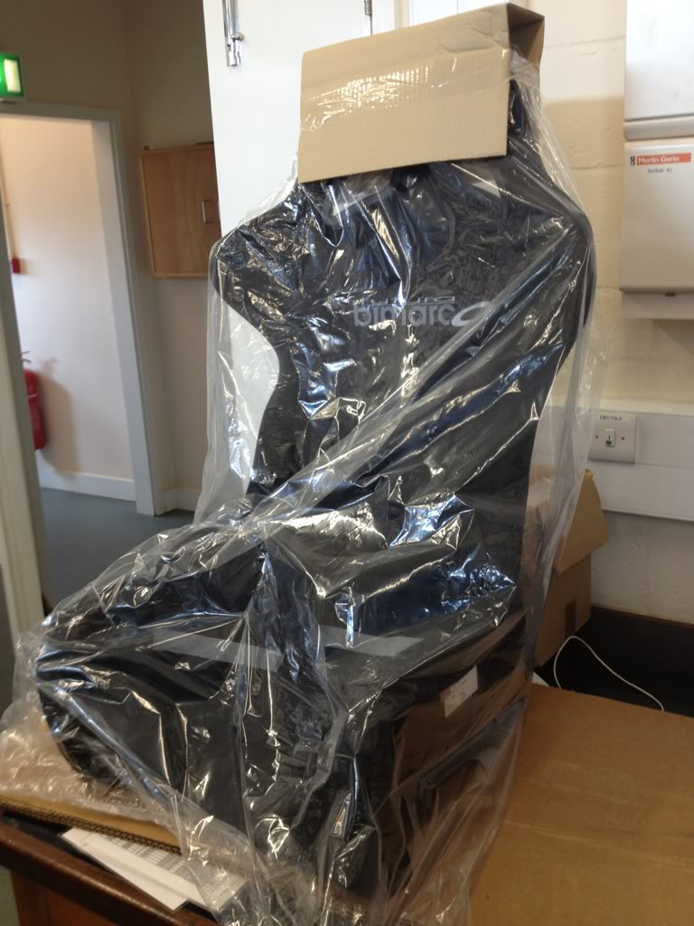

So, update on the seats!
Rang YB Racing today and they where posted yesterday and should be here today via Parcel Force. Only thing is no one is in at mine, so I think they'll get taken back to the post office for collection which closes at 2 today.
Stupid I know, you get home from work to find "attempted deilvery" cant pick it up that evening as closed at 2pm, most people then can't get it before work as it opens at 8am!
Next problem is...I'm back on call out for another week so I will have to van for a week as of tonight, I was planing on taking the car home tonight and cracking on, but no point as I doubt ill be able to get the mounts untill tomorrow now.
So the plan is to pick the mounts up tomorrow morning before work and maybe bring the car home Monday night and fit them.

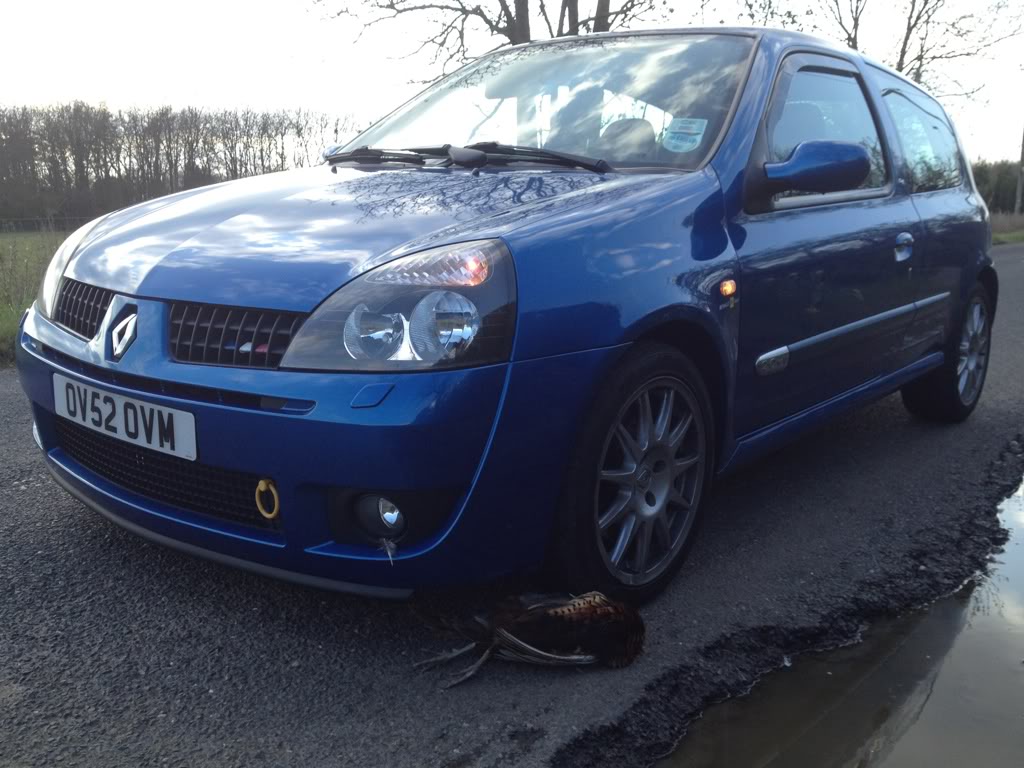

After getting the car back that evening after being on call out I decided to go the back roads on the way home, driving along and a pheasant decides to cross the road in front of me. I don't know why these things run across the road when they can actually FLY!
I pulled over after just hitting it and thought there would be alot be damage than there is, but no it just ripped off the last 20cm of my splitter. So I turned around and possibly thought I might be able to pick it up and fix it.
Parked right infront of the Phensent took some photo's and then looked all over the road picking up bits of plastic as the splitter was in pieces.
Rhy's and Dan will know how dumb these things are around here!
Not sure what I'm going to do about this yet...Skoda time;)

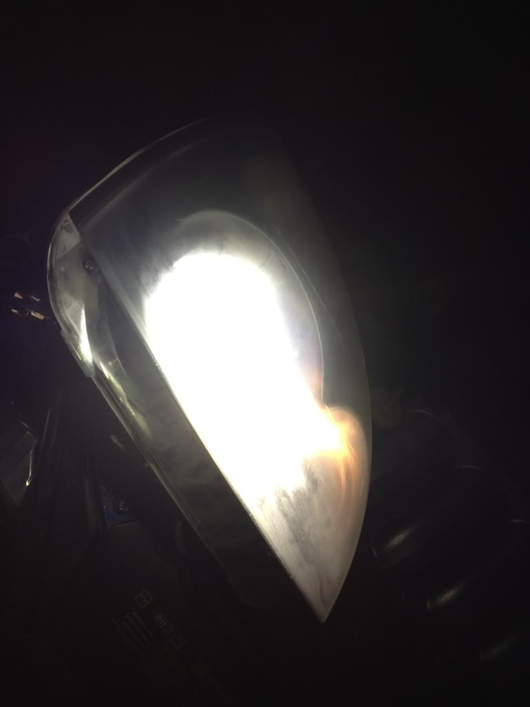

Got them home and just quickly plugged them in to make sure they worked, which they did and as you can see tho they are very hazzy!
Picture's of them on Jake's car before I bought them.

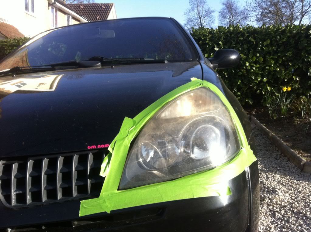

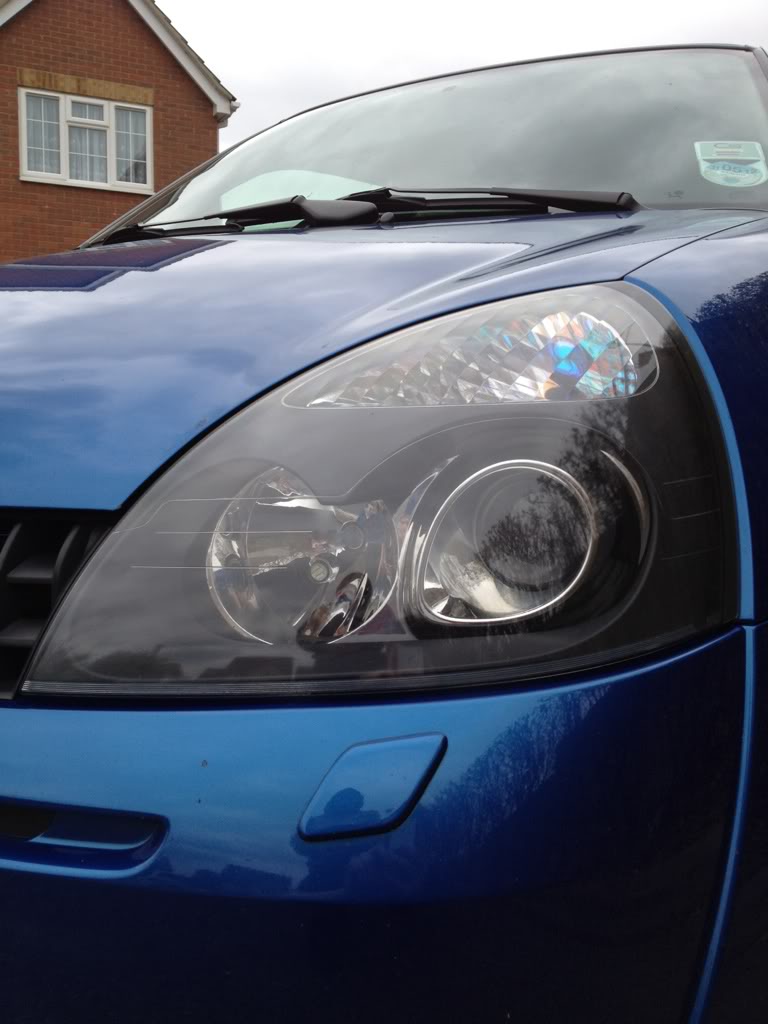

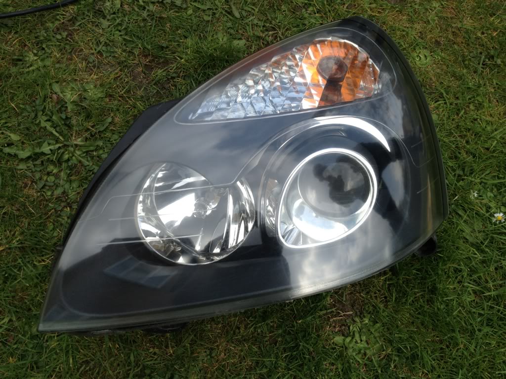

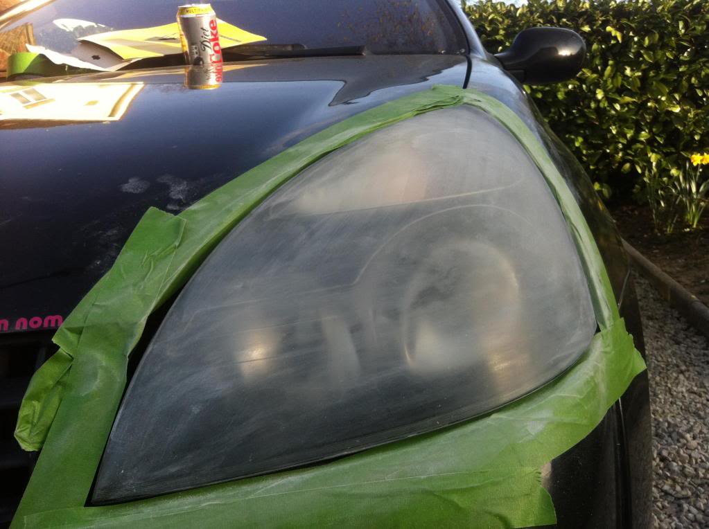

Friday I popped to Halfords and bought some 1500, 2000 and 2500 wet and dry and begain working on them. After 20mins of sanding I got extreamly bored and decided to get out the DA poilisher and some Scratch X.
I was extremly happy with the results and when both lights where cleaned and waxed I set about fitting them so the bumper was taken off and old lights taken out.

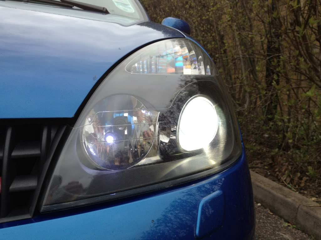

I then removed the Halfords "Ultra Blue" H7 bulbs, SMD side lights and diadem indicator bulbs and fitted them in the xenons. I did say a friend could have the Ultra Blue H7 bulbs, but when I found out the main beam on the xenons was H7 rather than H1 I decided to keep them:)
Next I had to remove the adjusters from the standard lights and place these onto the xenons as I bought them with no adjusters but I didn't see a problem with using my own.
Xenons where then fitted, tested and bumper was fitted back on, sorry no photos of fitting process.
They look alot better than standard lights and 1000 x better than HID's! I hate these things!
People may say there still illigal on my car as I have no auto leveling or washer to clean them, but there not pointing up into the sky and they also wont scatter light all over the place like HID's in reflector lamps! Who needs washer anyway, my cars always clean;)
Seriously tho these light up the road so much better than standard H7 bulbs and look awesome to!

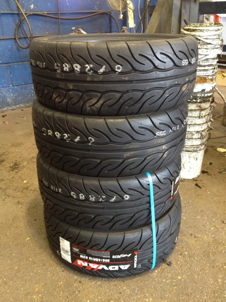

4 New tyres came today:) Going to run them through summer and for track days and then stick the Sport Maxx TT and hankooks V12 for the winter.

Those seats are excellent value for money direct from the supplier, about to order some myself from ebay as well to be honest. Where will you be mounting your harnesses to?
  LY Megane R26

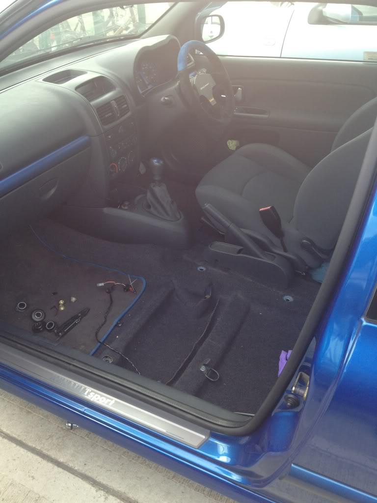

Well it's update time,

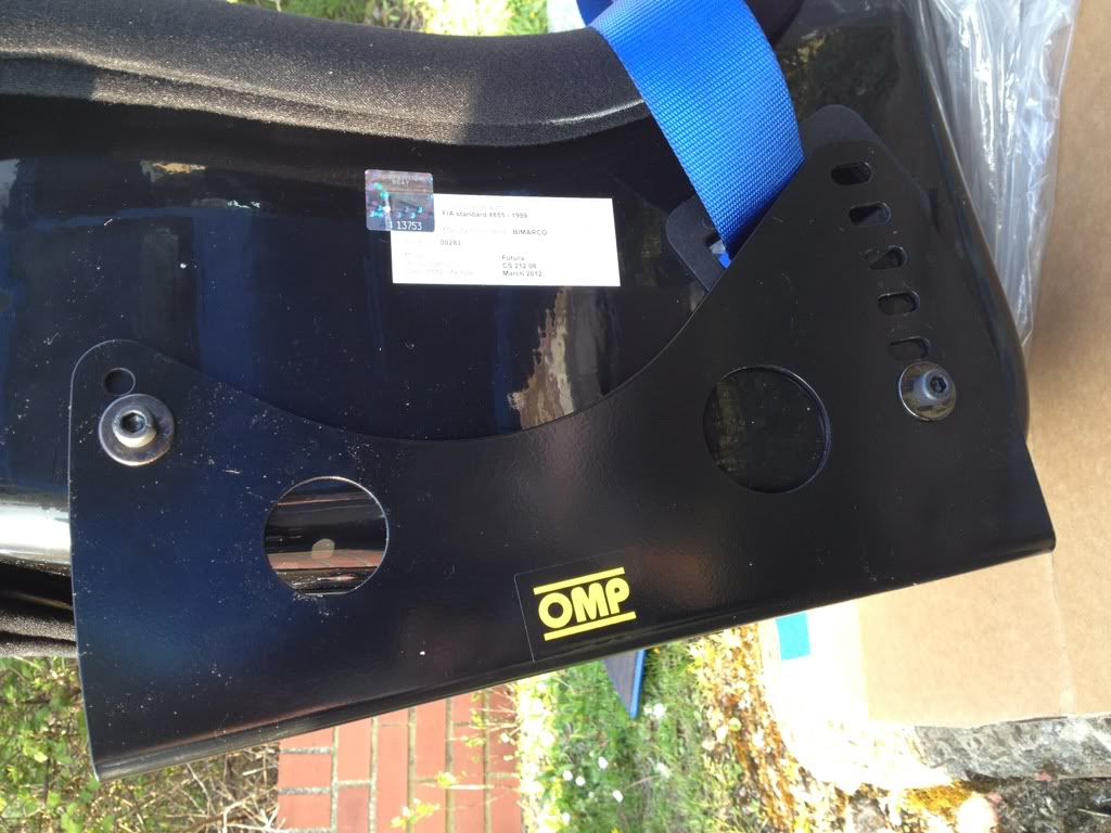

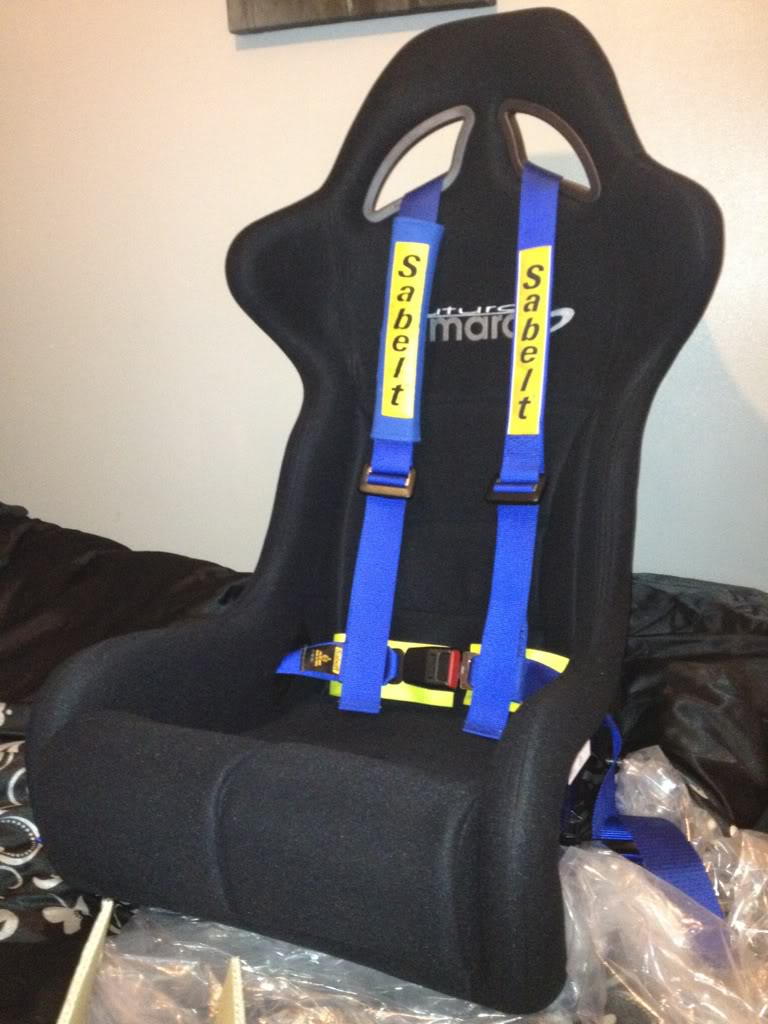

There finally in! Fitted them last Friday the 13th and it went very well:)
Started around half 5 and where in by 10, removed the passenger seat first and fitting the subframe to the floor using 12.9 high tensile hex head bolts, for the rear hole near the handbrake I fitted a M8x50mm eye bolt so I could clip the harnesses to this with a nyloc nut holding for a more secure fixing.
As I was using black hex head bolts I didn't want to use silver washer as thought this would be an eye sore againts the black metal, so a few days before fitting I sprayed the washers black at work:)
Now Im not sure if Iv fitted the seats correctly onto the side-mounts so I'll run through the problem and hopefully somone can help:)
I fixed the side-mount onto the seat with the slotted holes at the front of the seat and the fixed holes to the rear (if you understand that?) whichby searching on the fourm a lot of cars have it this way? I then placed the seat into the car and roughly fixed it onto the subframe and with some aid I sat in the seat in the car and it felt high, higher than standard, even with the seat mounted onto the lowest hole at the rear!:/
I decided that to get it lower it would mean to drill a hole further down the mount underneath where I have mounted it at its already lowest position, or to turn the side-mount around and mount it with the fixed hole and the front and the slotted holes on the rear of the seats as shown in the picture below:
As you can see this seats the seat a lot lower but the mount also covers up the hole slightly for where the harnesses come through.
I then placed this into the car with the mounts this way around, sat on the seat and was very happy with the position!
Now with the seat this low I couldn't get my hand under the seats to righted up the hex head bolts, so I mounted the seat onto the mounts at the highest possition possible so I could get my hand under them. The mounts where then fixed to the subframe again using 12.9 high tensile hex head bolts and nyloc nuts and homemade black washers.
Now as I said if I fitted them in the position as picture above I wouldn't have much room for the harnesses to go through so I fitted them before I lowered the seat.
I then undone the rear of the seat and lowered it down onto the lowest hole and secured it, again doing this to the front of the seat until I got the correct angle I wanted.
With the seats secured down and the harness passed though the seat holes I started fitting them. As said above I secured the rear handbrake of the subframe down with an M8x50mm eye bolt so that side of the harness was clipped onto that.
The other side was clipped into a M10 eye bolt which was screwed into where the bottom of the front seat belts rail is fixed.
Amd for the rears these where screwed down into where the rear seat belt clips would normally be using the original bolts.
Hrnesses where then adjusted with length etc to get them fitted correctly, now I'll stop rabbiting on and let some pictures do the talking;)
I'm starting to get used to them but first of all they felt very weird, being lower, not being able to turn your body when reversing or checking your clearance with the curb when going through tight places etc.
I also kept sitting in them with the harnesses behind me so would be a nightmare trying to get my arms through, now I place them over the seats and then sit down which makes it a lot easier to put the harnesses on.
I am over the moon with them! So comfy, suportive and look awesome too!
Any feed back on the mounts and the way they are fitted would be great tho:)
On the Wednesday before I fitted the seats I ordered these which came next day on the Thursday and where fitted on the Saturday.
Awesome tyres! Can push the car so much more than the Hankooks I had on the fronts before!
Was at the garage getting them fitted and once they was on I sat in the car and done the harnesses up, lent forward to close the door and couldn't reach it! So with everyone laughing at me I finally managed to reach it:)
I also done it again one day in the week but this time I just reversed and braked sharply which helped me close it:)

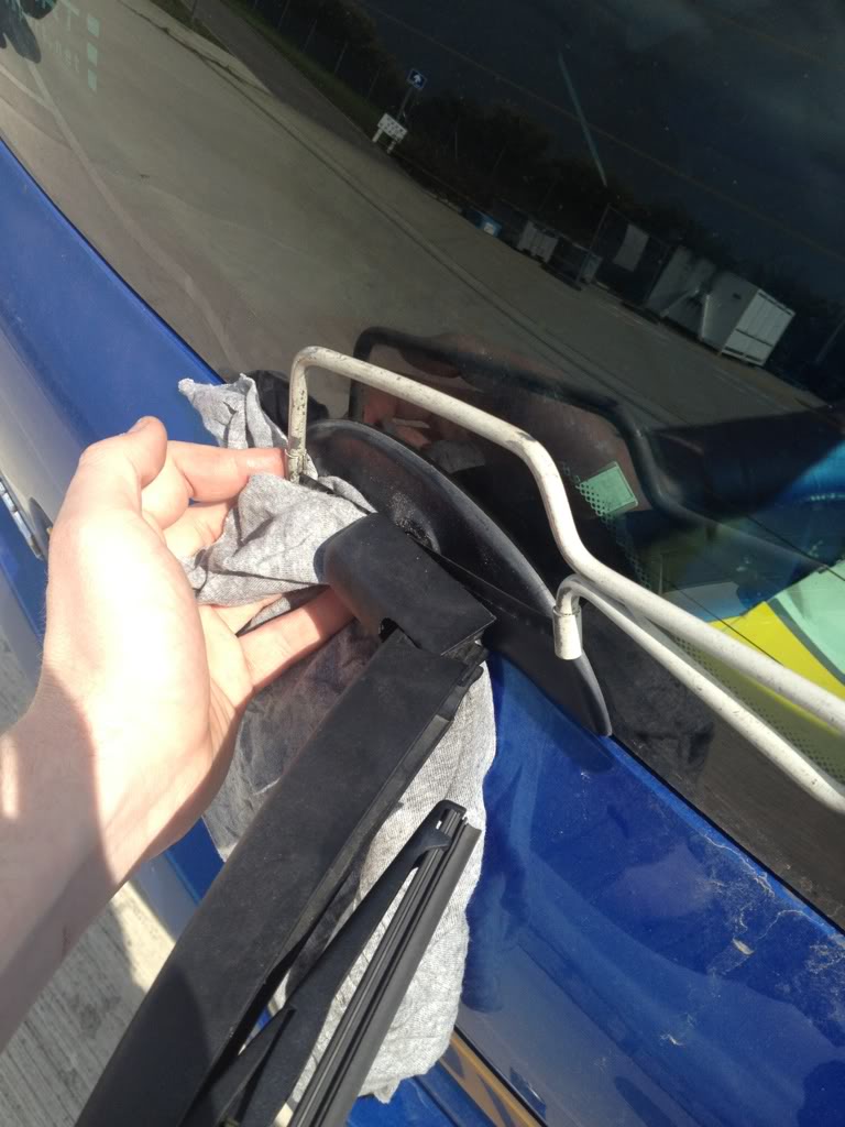

This Friday at work I decided to remove my rear wiper, undone the bolt which holds the wiper onto the motor arm and of course it was pretty much welded onto the arm, after a a tug and a pull I got fed up and out came the hacksaw!
And the finished product.

Wiper off looks much better.

Looking mint mate!! I like how they look, mine should be with me early next week. Are they comfy? Im planning on removing my rear wiper as well, what did you use to cover the hole after taking it off?
They are really comfy mate! Haven't got miles but back and forth to work all week at 50 miles a day and no back pain at the end of the week:)

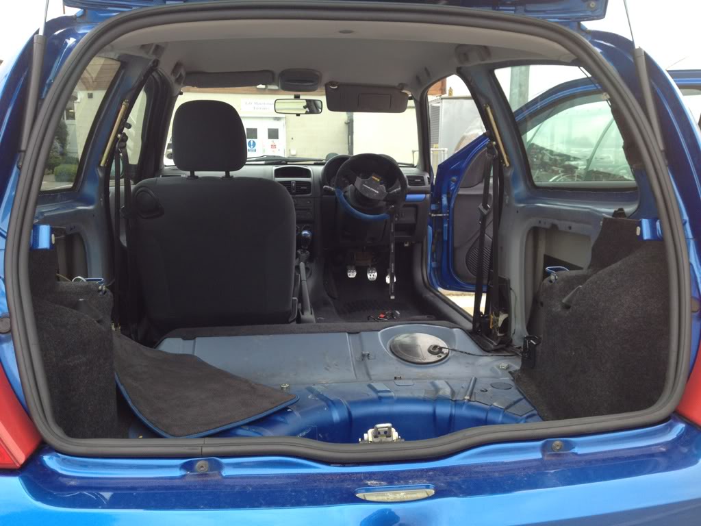

Did you see where I mounted the harnesses to as I see you asked a few posts back?
I just used a grommet from work mate, not sure on the size but fit perfect. I'm sure a hardwear shop would sell some, or I believe someone said halfords sell some and one of them will fit it:)
Makes the back end look more mean in my eyes, and I hate the line they leave between the clean and dirty part of the screen!

I noticed where you put them, are the lower staps actually connected to an eye bolt thats attached to the subframes? Thanks for the info, did you just glue it on? I must agree it looks much better without!
They are mate, it's an eye bolt that's 50mm in length so it can go through the subframe and the floor of the car using a washer and nyloc nut underneath the car.
Nah no clue mate, they secure them selfs on as its rubber and seals around the plastic, hard to explain lol.

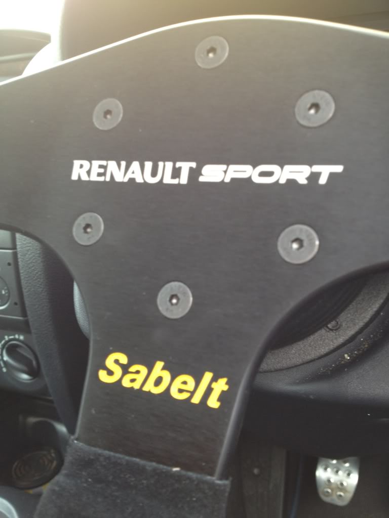

What did you use as the horn button when fitted the steering wheel?
Thanks mate,
I bought a indicator stalk with a button for the horn on the end. Think they came from certain ph1 clios, they can be found on eBay etc and just plug and play:)
The one I bought comes without a switch for the front fogs tho so these arnt working at the moment, think there coming out soon for more air into the brakes anyway;)

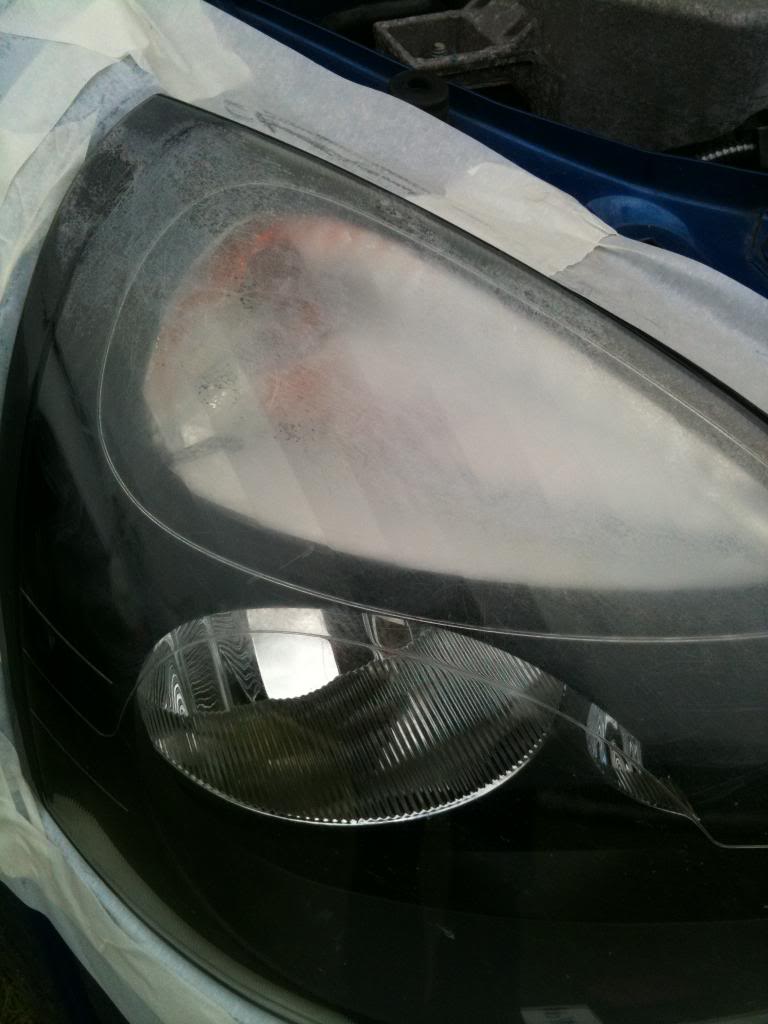

Hiya Scott what did you use to sand the front lights down as mine are looking pretty doggy
cheers

These came today!
SPAX RSX with the outboard rear coilover type. Ordered them end of last month and was told they would take a month to come as SPAX where waiting for delivery of parts.
They turned up today to my surprise.
Built up one rear just to show.
Cant fit them this weekend as on call for work, so hopefully I can fit them next weekend with Rhys Beal, as well as track rod ends and ball joints. Should be like a new car!
  Trafic 140dci
Spax look good mate, I'm seriously considering them for the 182 (if they do cup pack kits!?) so let me know how you get on :)
