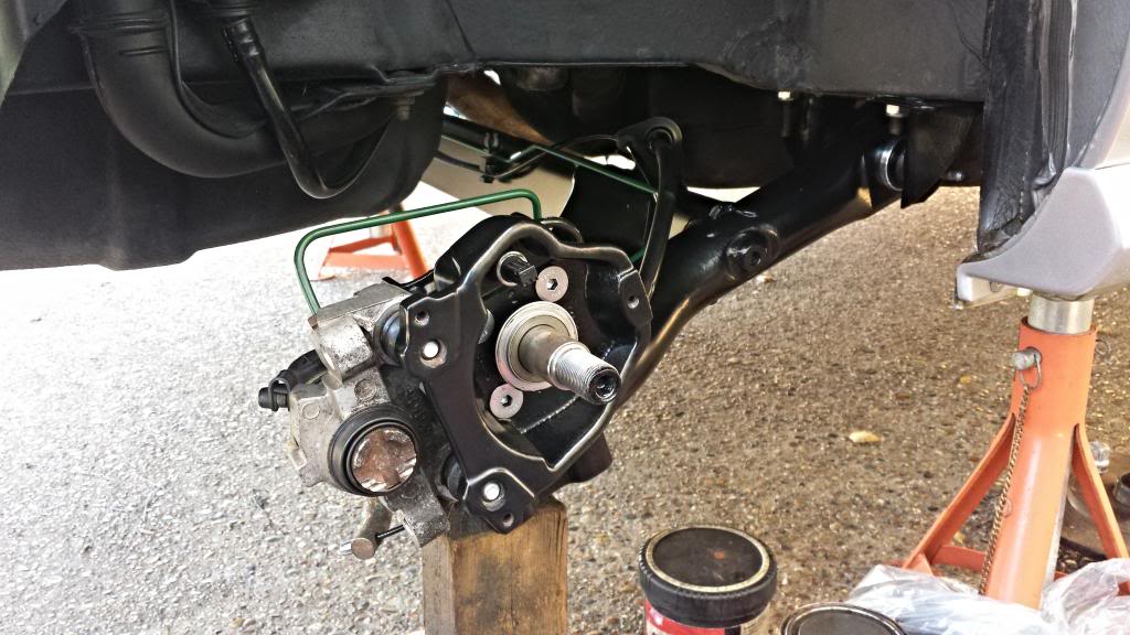

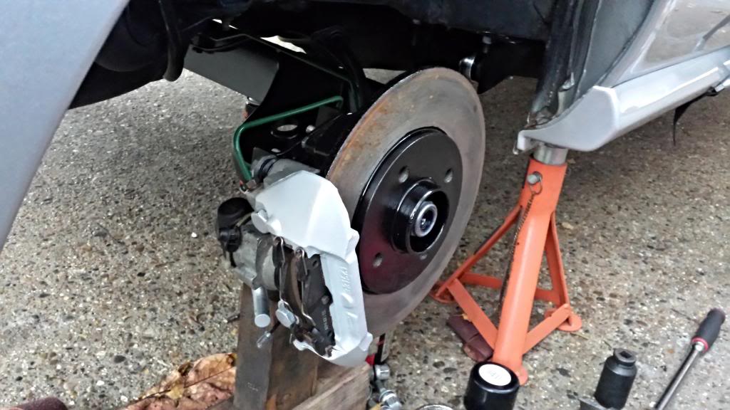

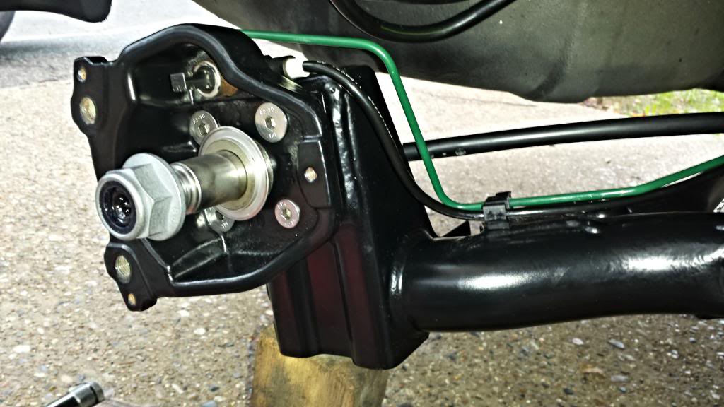

I also made a start on fitting the off side rear hub back onto the beam. This is taking a while as i have to clean off the powder coating in the places its not needed.
That's going to be the fun part haha.
Are the heat shield kept on with spring nuts? Mine are brittle so wouldn't risk trying to remove them. How are you going about refitting them?
What's next to be powdercoated ;)

I have bought new spring nuts from Renault which are not that expensive, theres no way i would put new stuff back with rusty/broken bits anyway.

Managed to spend a bit more time on the car today, sat out in the cold isnt very nice though. :(
Just been taking my time as im in no rush, car wont be used untill the winters over.
So, just finished off getting one side back together. Might get the other side done tomo. :)

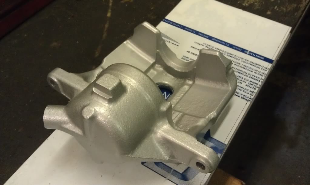

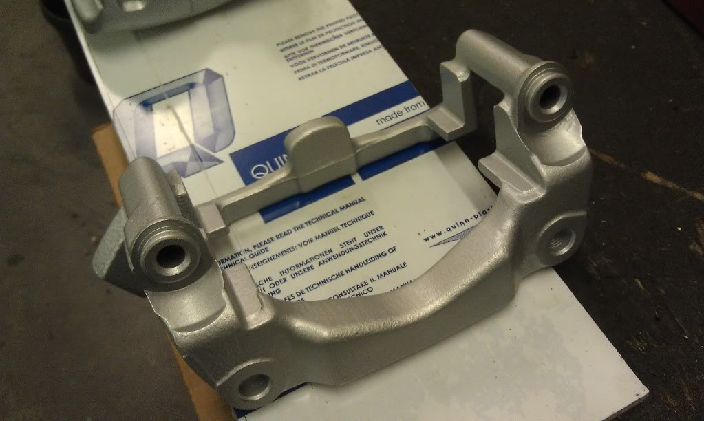

Dr Jekyll i removed them and cleaned them up. I masked up the caliper piston/seal and then spray painted them with Hammetite smooth sliver.
You dont need all of this VHT/high temp paint stuff mate i have done it this way for years, even when i worked on the Astons we did it this way.
Spray it dont brush it on as the finish is loads better. My rears where done in the same way but it was only because i was doing the rear re-fresh that i got them powder coated.
Oh and when doing the fronts make sure the caliper piston is pushed all the way back and that you put some tissue in the brake pipe hole/nipple hole so the fulid dosen't affect the paint.

How the he'll did you get the Bush back in the rear beam for the roll bar?
I'm having a good time trying.
Lots of lube, lever the bar over to one side then get one side of the rubber in. The lever the bar over to the other side but this will be a bit harder as your trying to compress the rubber.
Its not to bad to do, my beam is fixed back into the car so im working up side down. I am old but quite strong so i guess that helps. :D

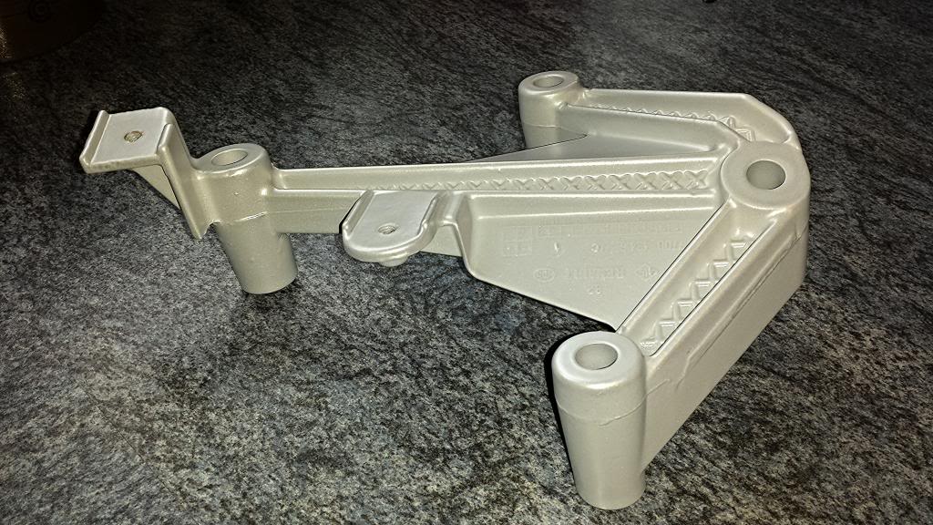

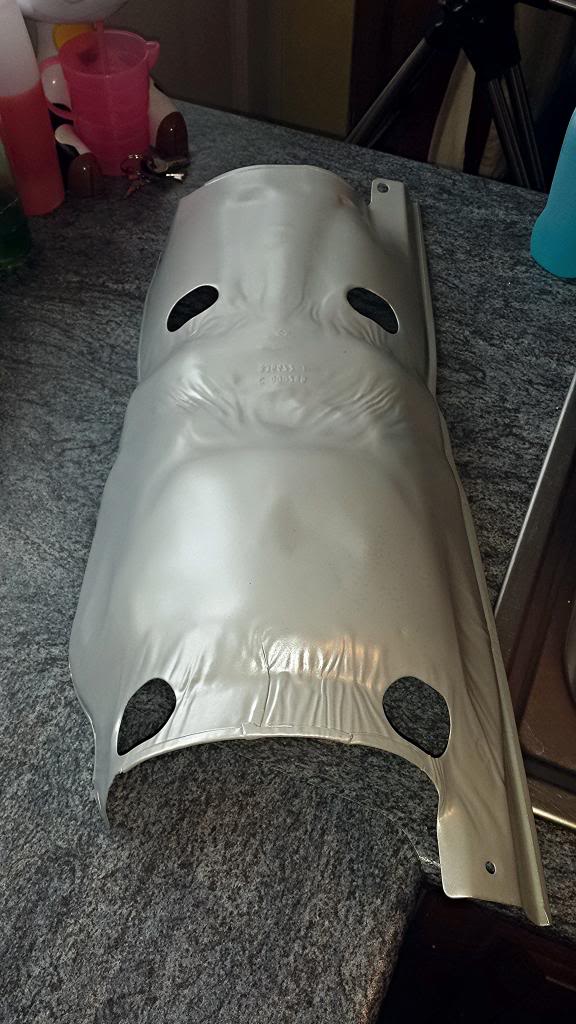

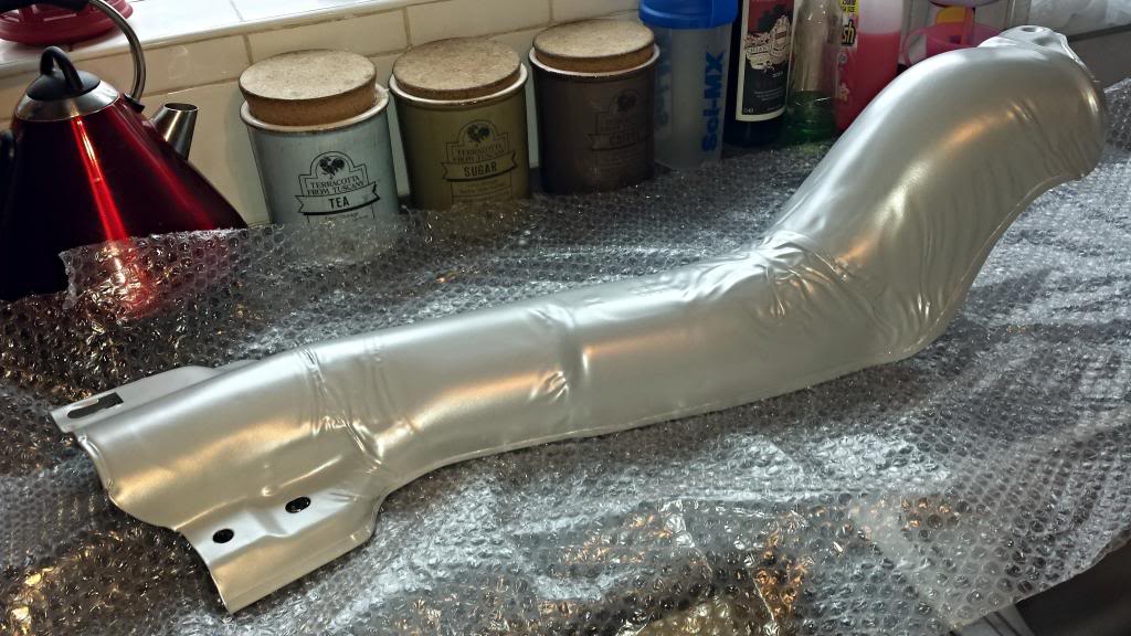

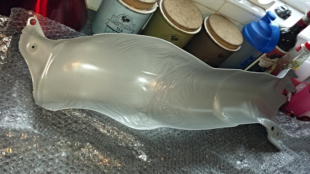

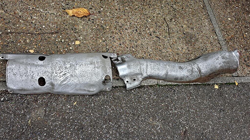

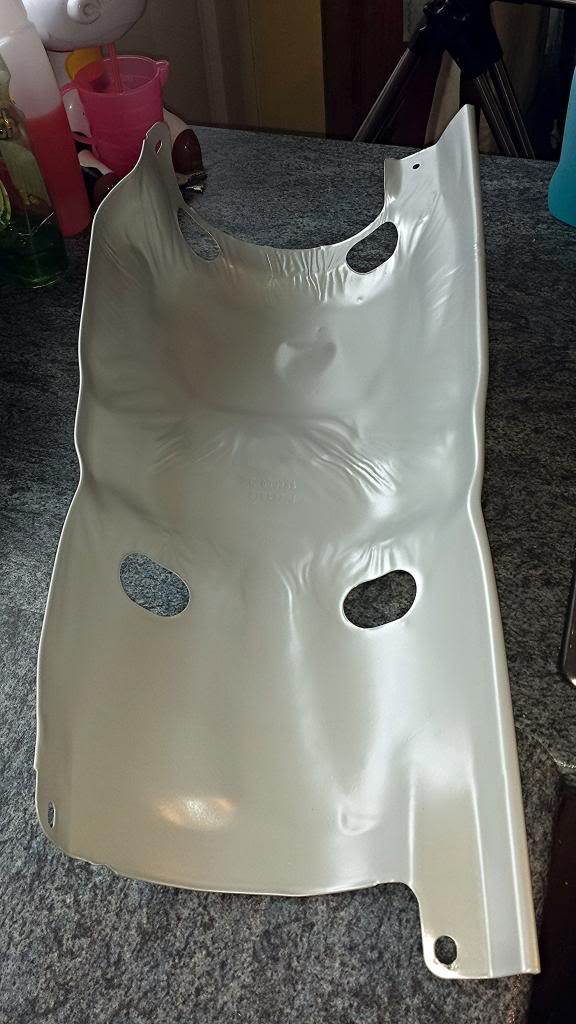

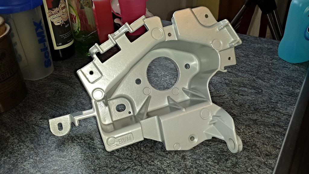

Little up date.
I sent the exhaust heat shilds away to be powder coated over a month ago as they where looking a little tired, got a phone call from them yesterday saying that my bits where ready for collection.
I also bought a spare gearbox/battery tray brakets from Chris @ Detail me so i could send them away to be done.
Before.
After.
Just need to find some time/better weather so that i can fit them back to the car.
