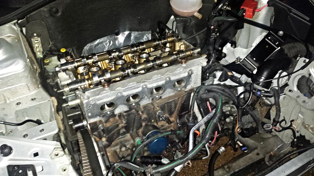

I did a bit more work on the car today but after a nice lay in bed i didn't get outside untill 2 ish.
Anyway i took the rad out along with the coolant hose's as they are going to be replace with black Samco one's.
I also removed all of the alloy bracket's so they can go off for powder coating in sliver. :D
Head is ready to be un-bolted in the morning, i'll take it to work with me on Tuesday to give it a clean in the de-greasing tank before its sent off to Andrew @ ALD for its porting work.
While its away the bits will go off for powder coating and of course the nuts and bolts will go off to be plated, ill also be giving Adam @ Renault a call to order the gasket's etc.

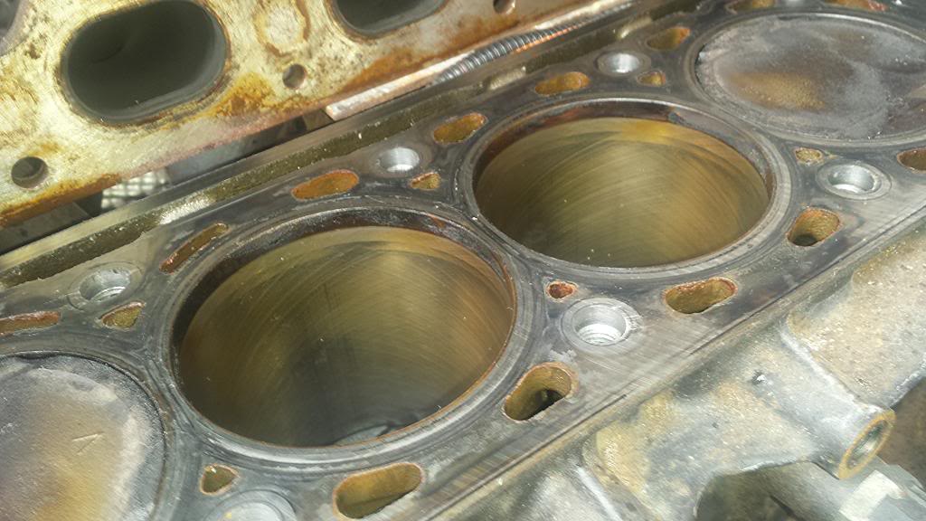

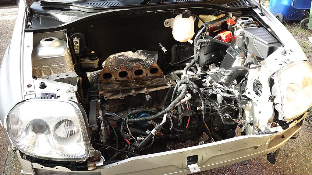

Yesterday morning i got the head off, took it to work with me today to give it a quick clean before i packaged it up ready to be sent to ALD.
Cars looking proper sad for its self. :(
Bore looking fresh, which is good news.
After a little clean, ready to go for its porting. :D

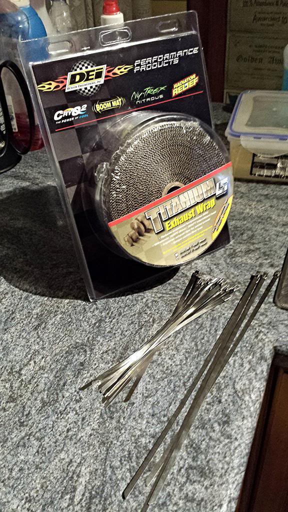

The DEI exhaust wrap i bought is titanium so no nasty fiberglass making me itch.
Ive been watching some youtube videos on how to do it so fingers crossed it will be fine, the misses will always help if i need an extra pair of hands. :)

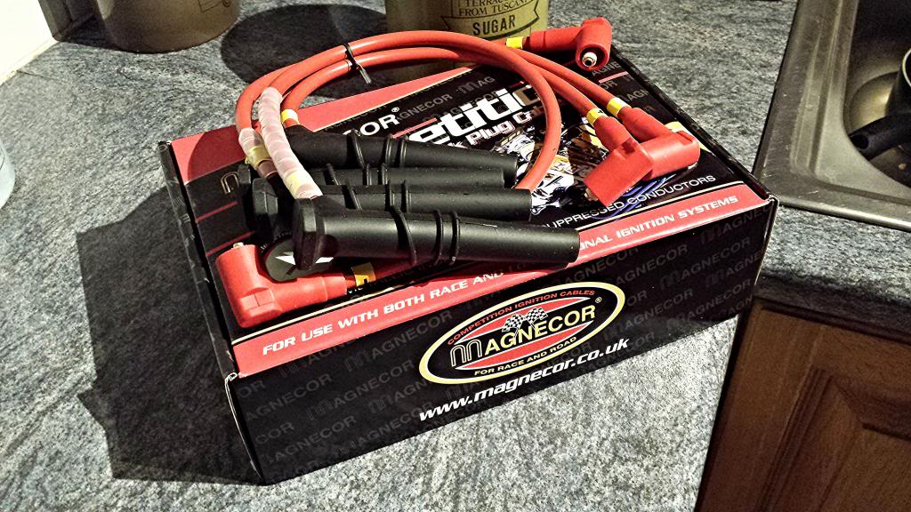

Are the Magnecor leads recommended Scott? And what's the difference in coloured ones?
This is going to be EPIC when its all complete, more so than now.
Cheers mate, i have no idea if im honest.
In my thinking at the time was my leads are 14 years old so i wanted to replace them, yes i could have just bought Renault ones for half the price but i thought sod it. :D
I didn't use the fibreglass stuff either, its just the routing of it all.

Oh yeah i see, i yet to work that bit out.
I don't understand how you work out how much you are going to need for each pipe, otherwise you have got to run 50ft around and around.
I can see this job pissing me off.

Thats the problem! I suggest using cable ties to start with rather than use the metal clips supplied, means you can do it as many times as you like, and you'll do it 3 or 4 times.
Take your time doing it and have fun lol
Good thinking Batman, cheers. :D

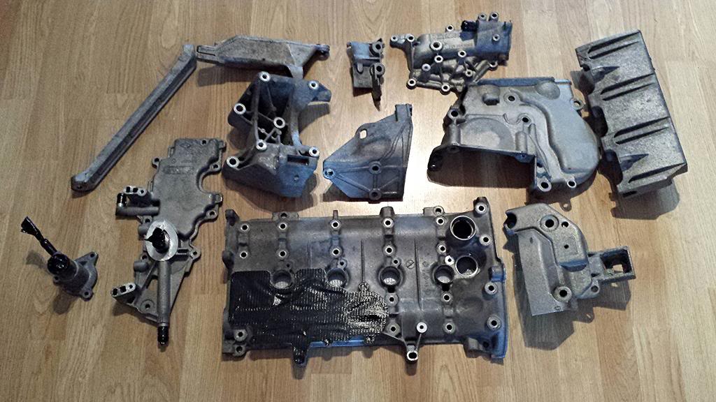

Bits already for powder coating in sliver.
The misses will be dropping them off tomo. :D

How much does it cost to get that powder coated out of interest? Looking to get a few bits done in the near future :)
Not sure on this lot but id image about £150 - £200.
My rear beam, heat shields and upper gearbox mount came to £200
Thats blasted, zinc primer and then coated. (Some just blast and coat which will be cheaper)
Because the bit's are going sliver you have to get a few bits together to make it worth there while (black will be easy as it's always being done)

That would be the better way to do it.
One thing I will say though, that if you do get it blasted 1st then you need to make sure that the bit's are going to be coated asap.
Otherwise your bits will soon start to rust very quickly.

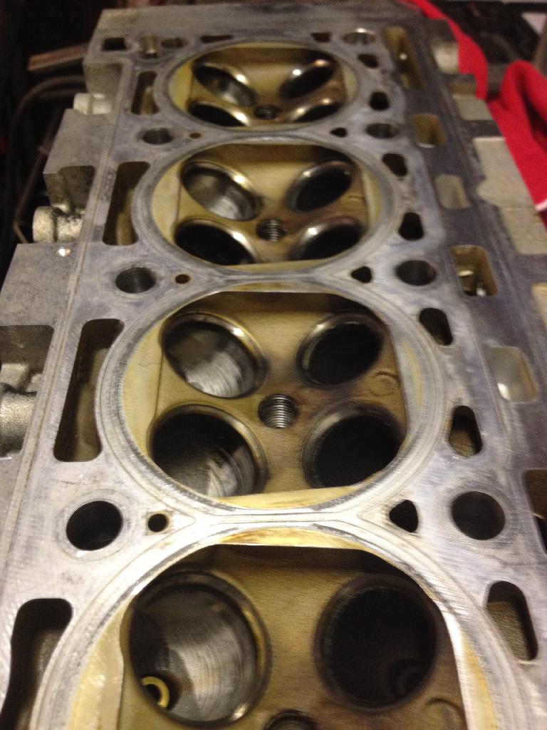

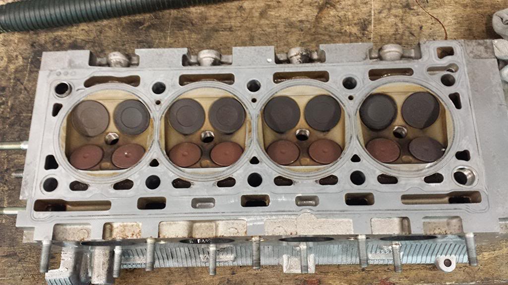

Got delivery of Scotts head today
Its been stripped and inspected, going in for x-ray tomorrow to make sure there isn't any cracks, They don't normally get cracked but its alway good to make sure
Standard ports
Big gouge in the head face but i'm sure it will skim out

Good stuff Andrew, god knows how that happened. Maybe when i took it off???
Anyway, i packaged it up well so good to see it got to you in one piece. :)
Apart from that, in good condition??

Head needs all 16 valve guides replacing. :(
Andrew puts this down to the car only being used for short jouneys.
