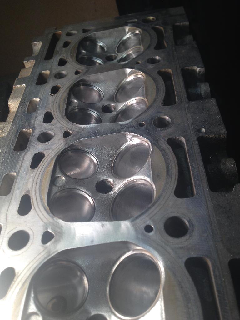

All done mate, finished cleaning up the combustion chamber, just need to get its skimmed then its just a wait for your valves.

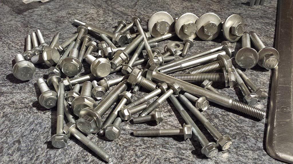

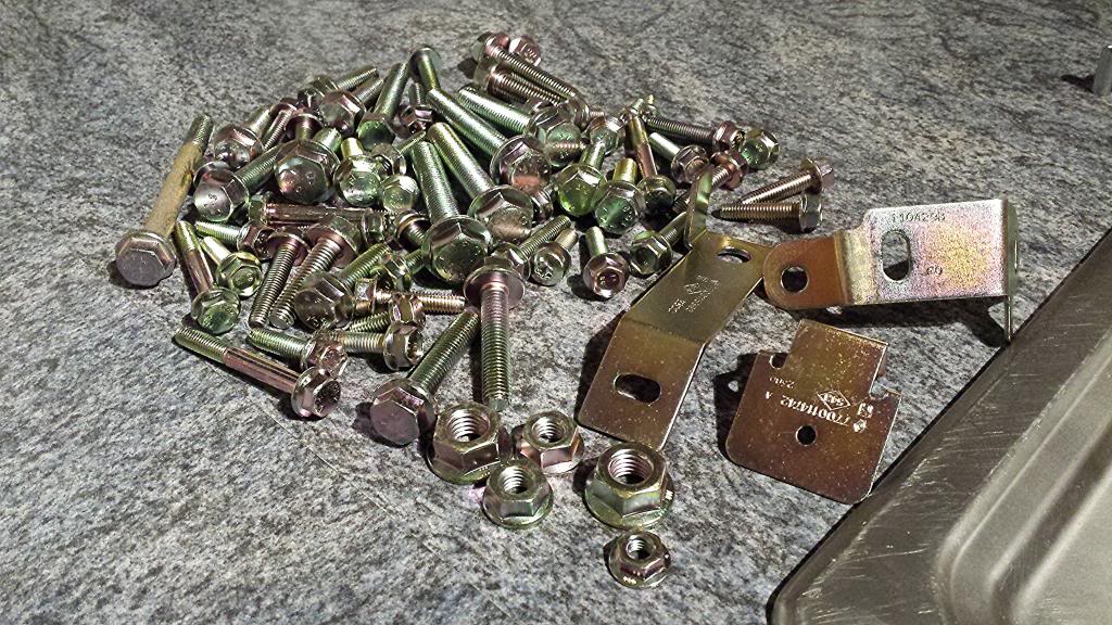

Misses collected my 2 bags of plated nuts and bolts, they look bloody great.
So happy i got them done. :D
Only to work out the compression ratio on Clio heads but if I do work to them like valve shrouding, smoothing, highly polish or any work to the chambers etc then I will cc them to balance the chambers.

Misses collected the bolts i sent away for plating.

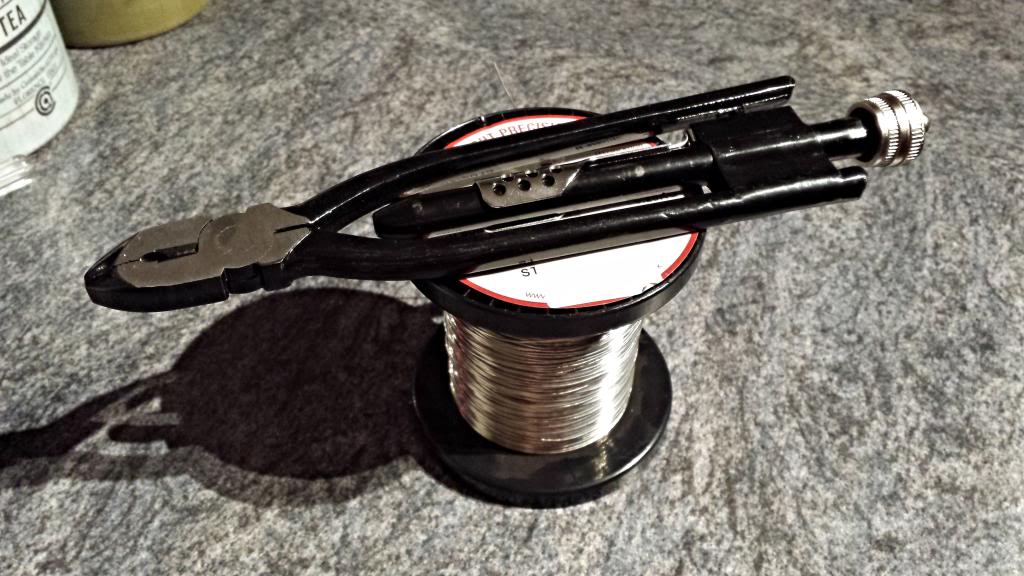

I bought some 0.8 stainless steel lock wire and pliers from Tweeks, i couldn't get the exhaust tie wraps to work and if im honest i think it looks lots better. :D

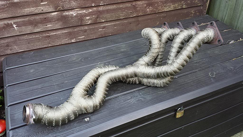

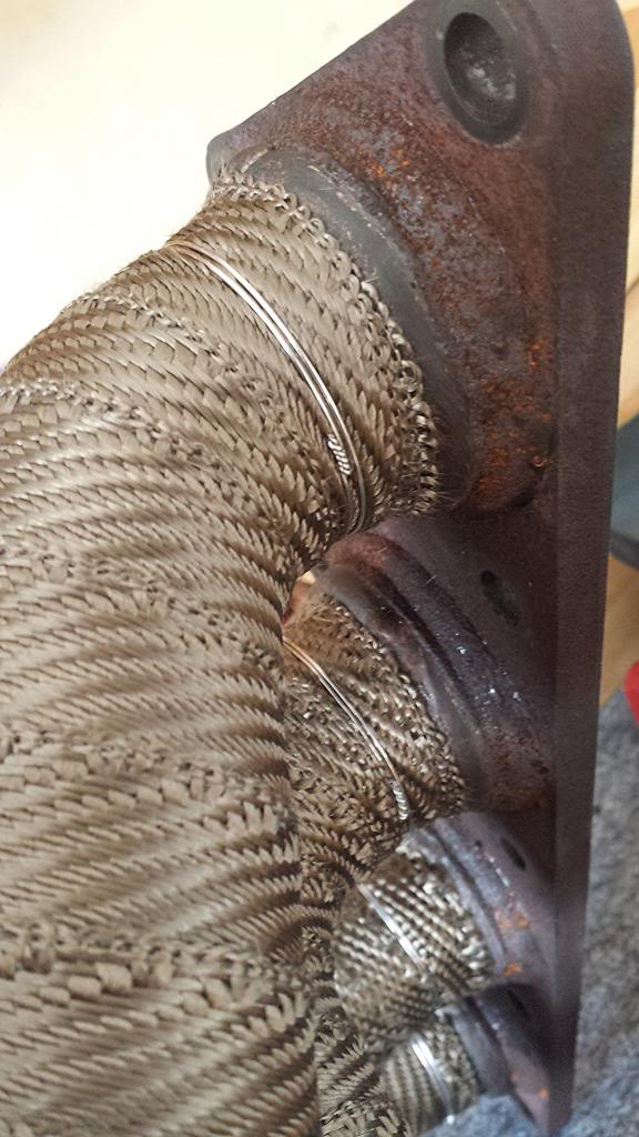

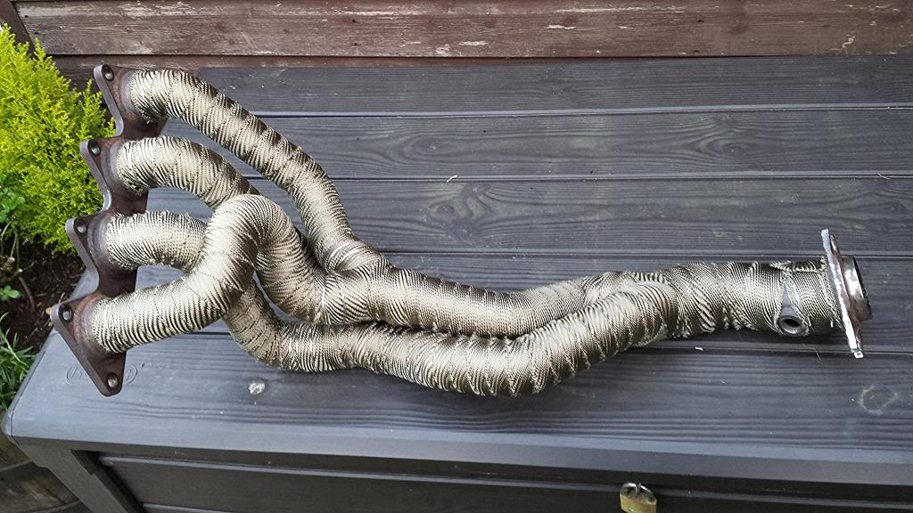

At last got the manifold wrapped, what a long winded job to get it looking right.
I hope it helps keep the engine bay temps down a bit.
  Cup In bits
You have made a proper job of that mate, I ended up wrapping the the 'y' piece as one piece as my 2" warp just wouldn't follow the lines. That looks like 1" wrap though.
My my pliers also broke during it :(

youll lol find those twist lock pliers come in handy for loads of stuff!
Used to use mine as a sparky
Cheers Mate, it is the 2" titanium wrap.
I have seen a few done in that way but wanted mine done like this as i saw that there was just about enough of a gap.
Proper pain though but i think worth it. :)
  Cup In bits
Yeah you have done a proper job anyway, I thought mine was tidy but you must have spent hours on that.
Also is the manifold you have the one with the little indent for the subframe, if so stick some lock wire there so if it rubs through it doesn't uncoil.

Picked up the head from the machine shop after its skim.
Just waiting for the valves now then recut the seats.

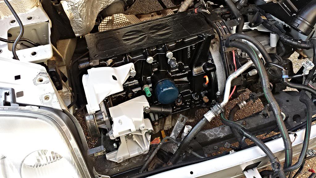

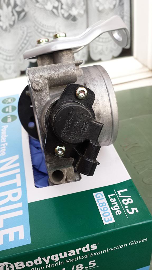

Spent a little bit of time giving the gearbox a little clean, i also loosely fitting some powder coated bits onto the engine just to see what it looks like.

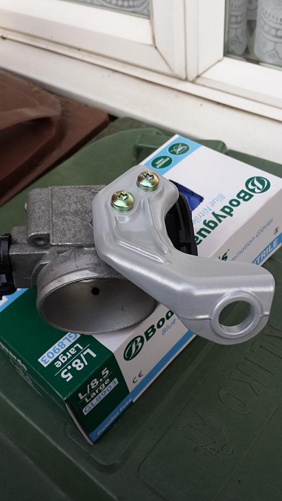

I gave the TB and clean with carb cleaner and then fitted the throttle cable bracket along with my plated bolts.
The TB could do with a better clean, i was thinking about getting it glass blasted but didn't want any grit to get into it. Maybe its best left alone.
The brakets are sliver but they look white in this picture.

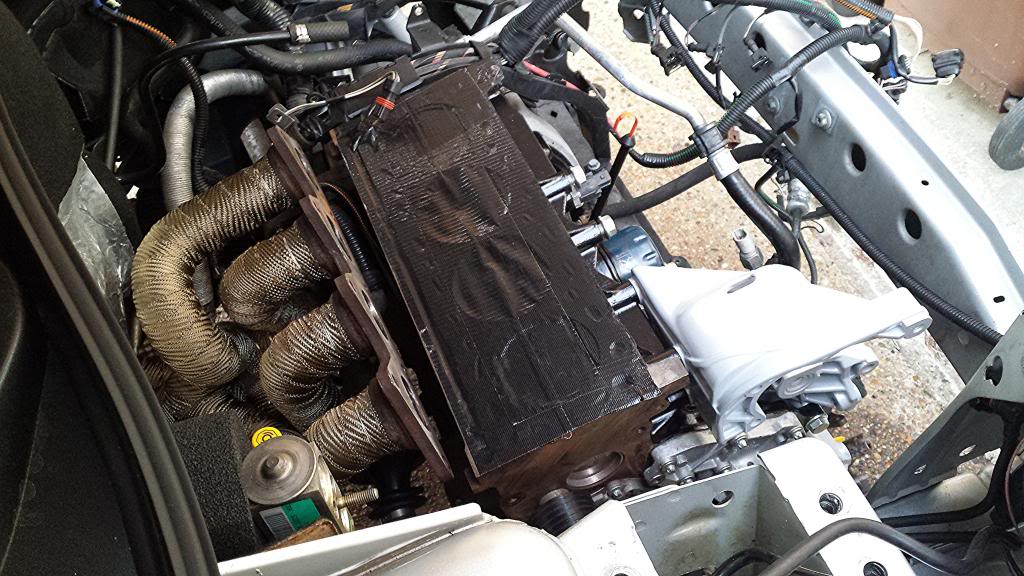

Fitted the 182 manifold while the head is off, i need to fit the cylinder head using the old gasket and bolts then ill bolt the manifold to the head to see if its going to hit the subframe.
My manifold hasn't got any dents in it and im using Ktec engine/gearbox mounts along with a poly dog bone mount, fingers crossed its going to be ok. :)

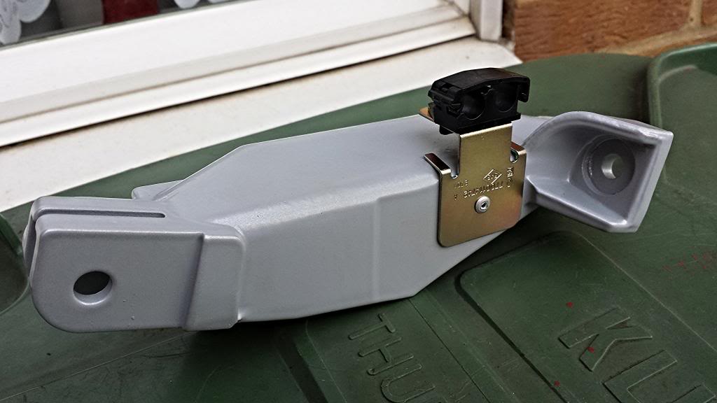

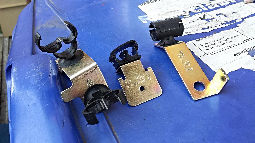

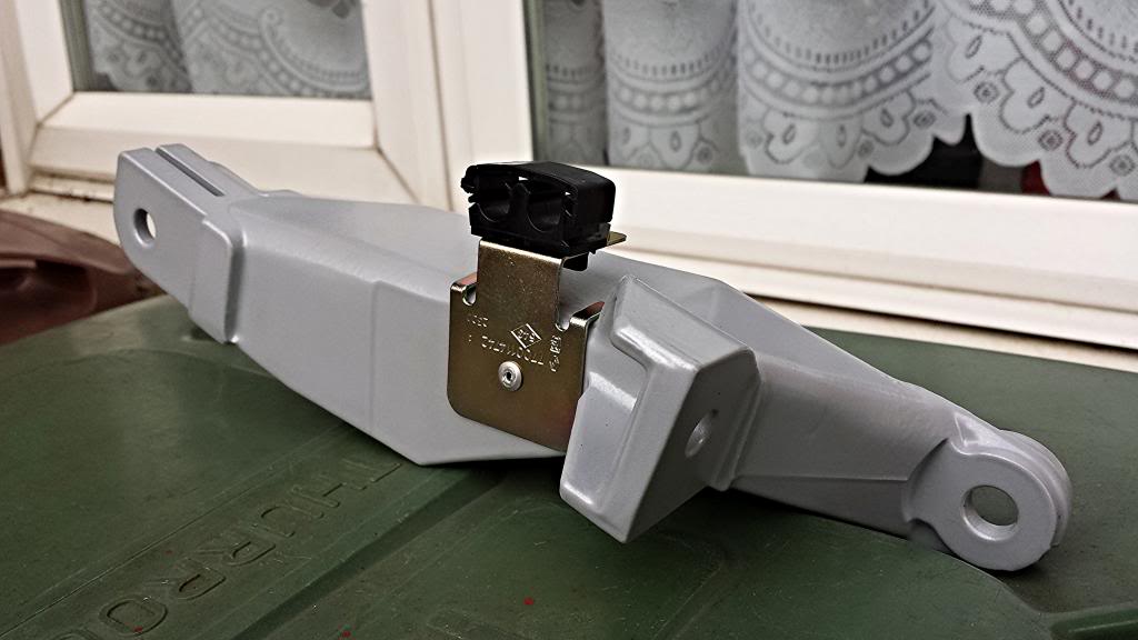

Fitted the plastic clips to the plated brakets, shiny. :cool:

I missed your question about the dents in the manifold mate. It seems the dent was added to certain or later manifolds just to give a bit more clearance so you should be fine. Some French guys say its a Renault sport part without the dents. I just think its an evolution thing.
There is a good bit of engine adjustment to be had as I'm sure you know by having all nuts and bolts loose on all engine and box mounts with the uprated stuff so you will be fine. Just fire it all back together first time, no need to do a dry run IMO.
Ta very much mate, that was my thought as if they hit the sub frame then they would all be dented.
Ill get it all back together and adjust it to suit.
