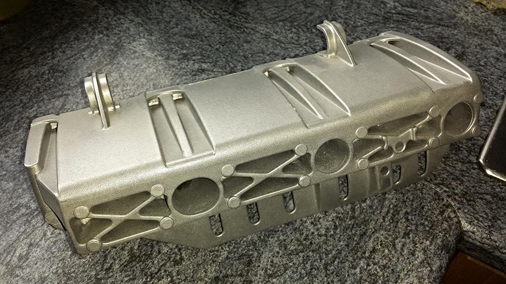

Great work! I bet the manifold took and age to do, certainly worth the effort though :)
Sorry if it's been mentioned, but when are you hoping to have it all back together and running again?
Hey Joe, yes mate it took ages. I did it over a few days tbh.

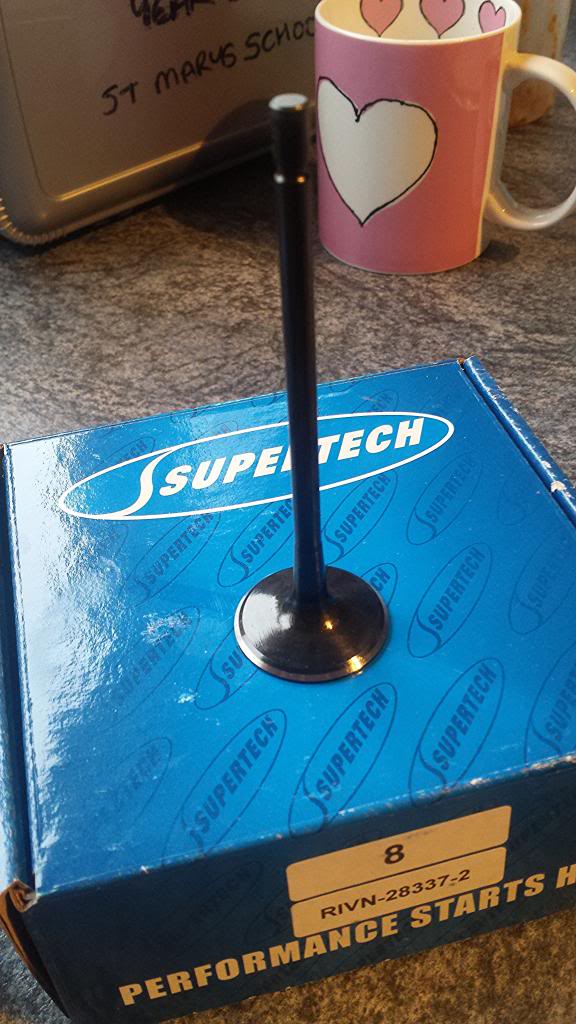

So my valves arrived on thursday from the usa after a 8 week wait. :( Sent them off to ALD on friday so that they could be fitted to my head and the 3 angle valve seats could be cut.

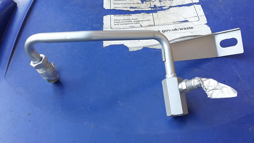

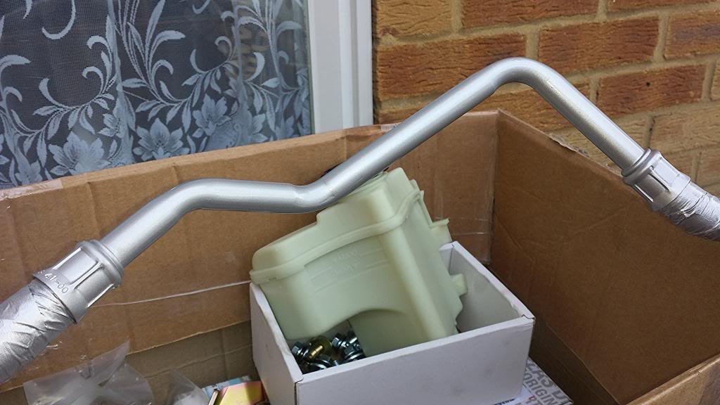

PAS pipe was looking a bit sorry for its self.
Lots better.

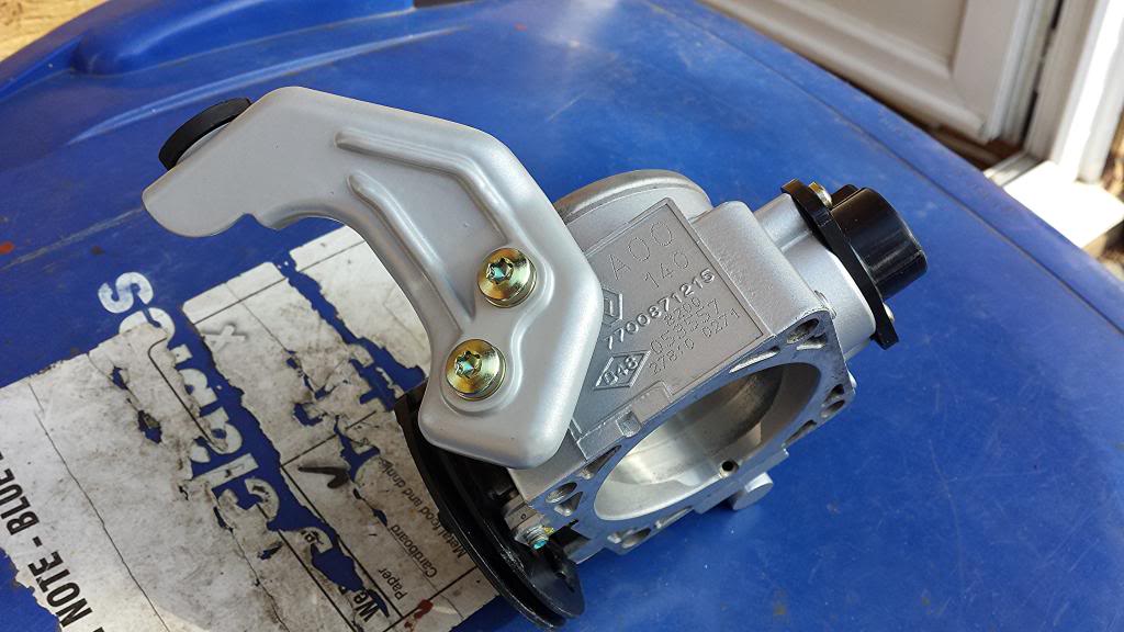

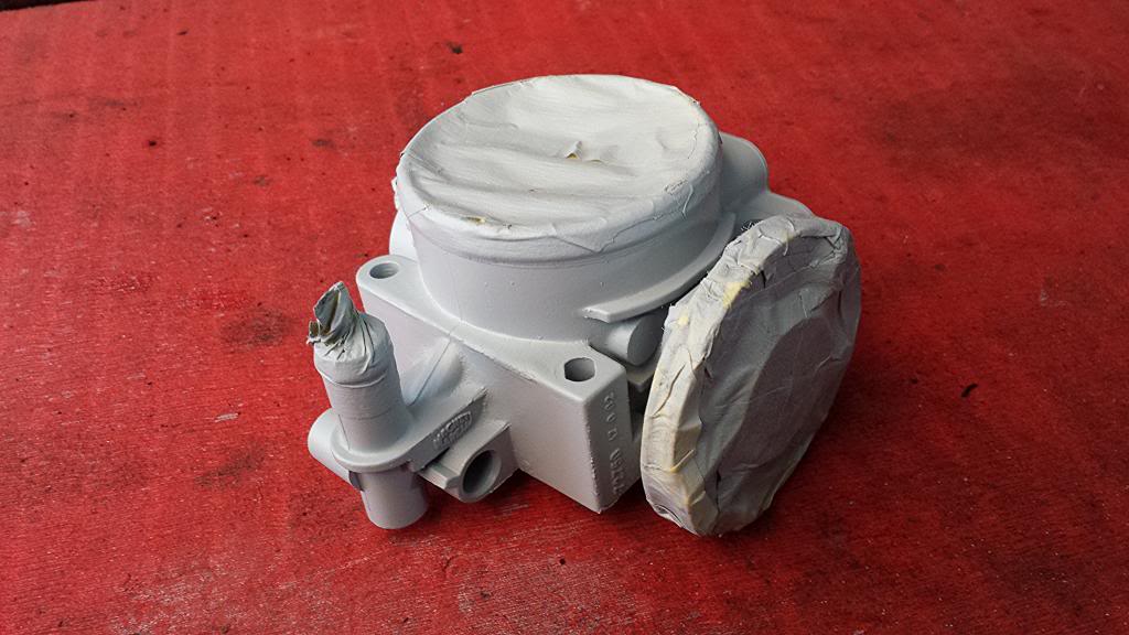

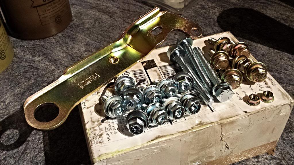

Id put the freshly plated bolts and powder coated throttle bracket back onto the TB, but the TB looked crap.
Gave it a paint and it looks like new now, much better. :)

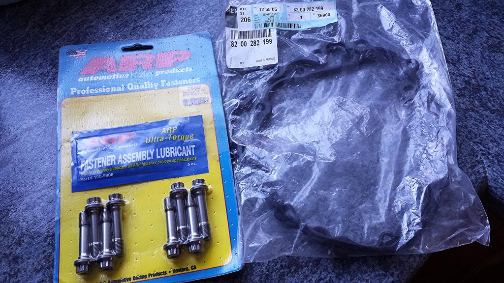

A set of ARP rod bolts and a sump gasket came up for sale on here, rude not to.
Sent a few more bits away for plating.

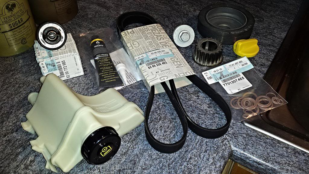

Placed an order with Adam for a few bits, i bought the Meg 225 crank pulley which has a key way also my crankshaft damper was showing signs of cracking on the rubber. Didn't want to have to replace it at a later date so while its in bits a new one will be fitted.

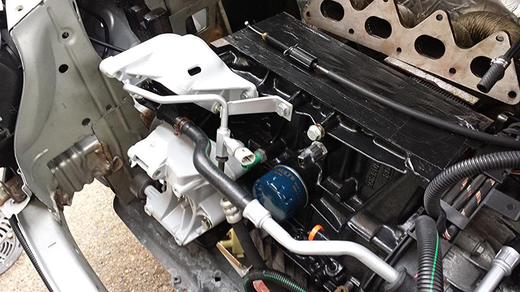

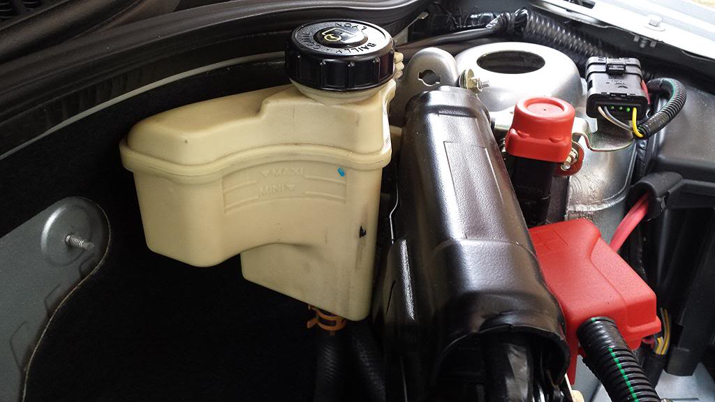

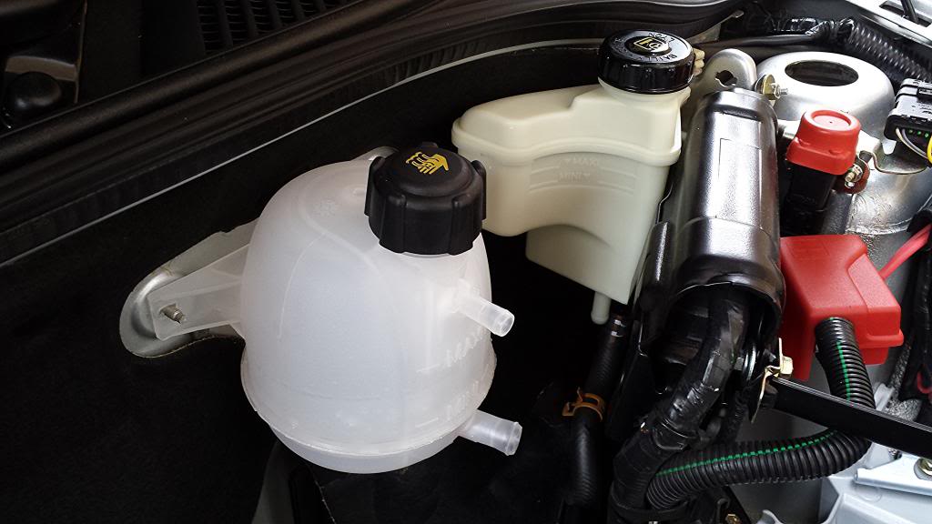

O rings for the AC pipes and a new aux belt (the kit has only done 1000 miles) The PAS resivour was looking yellow so i bought a new one to freshen up the engine bay, wasn't very expensive.
Old PAS resivour

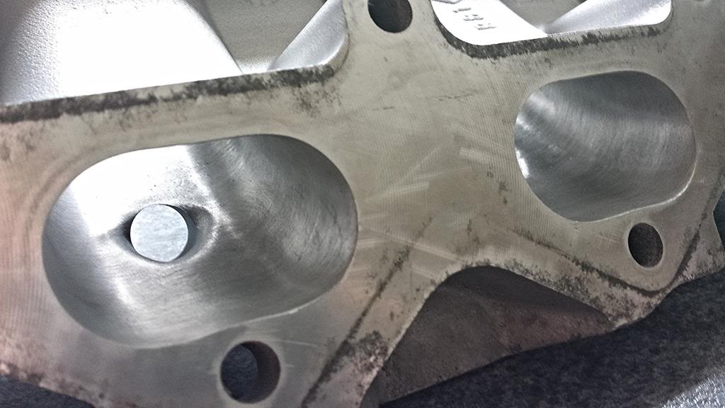

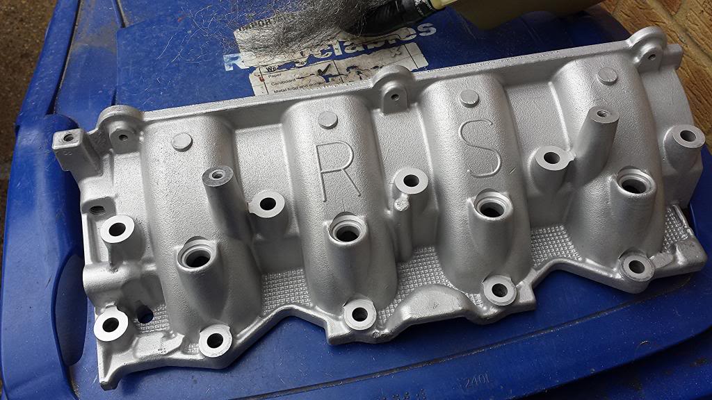

Other bits that needed to be sorted was that the lower inlet and fuel guard need to be glass blasted so that they could be sent away for painting.
Blasted, ready for paint.
After Andrew @ ALD has ported my inlets.
Fuel guard blasted.

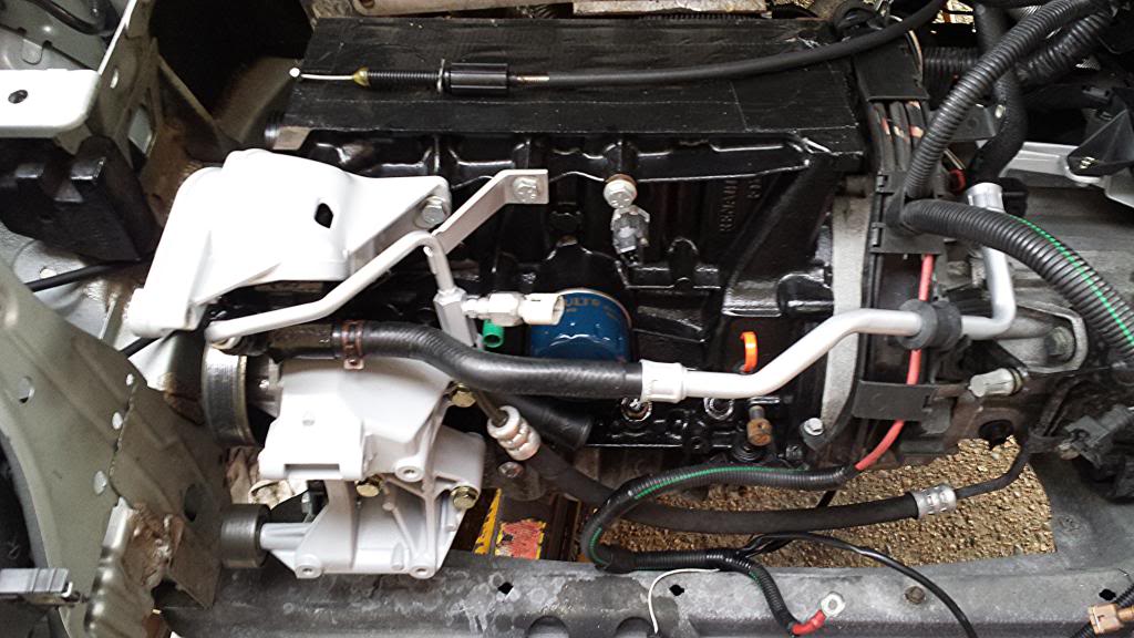

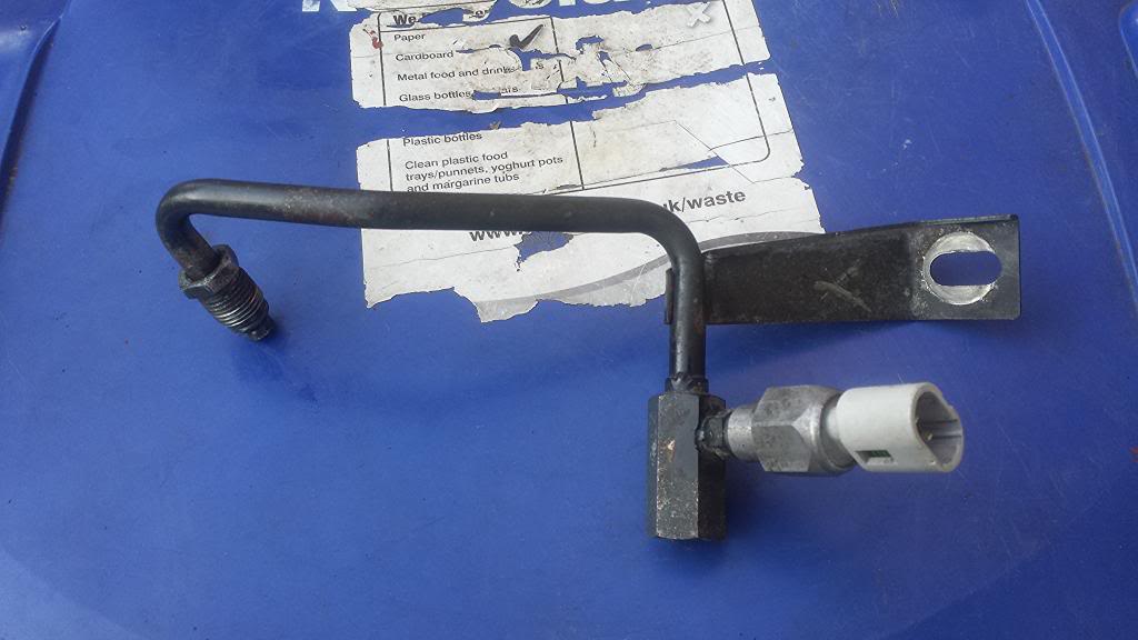

The low pressure PAS pipe was looking a bit sorry for its self and after Adam saying that a new one was almost £90 i gave it a paint in sliver.
As its stands at the moment, looking lots better.

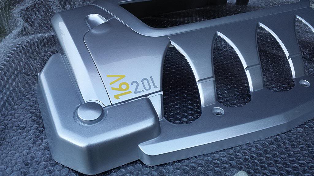

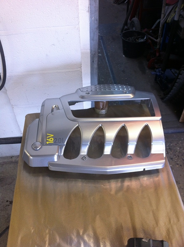

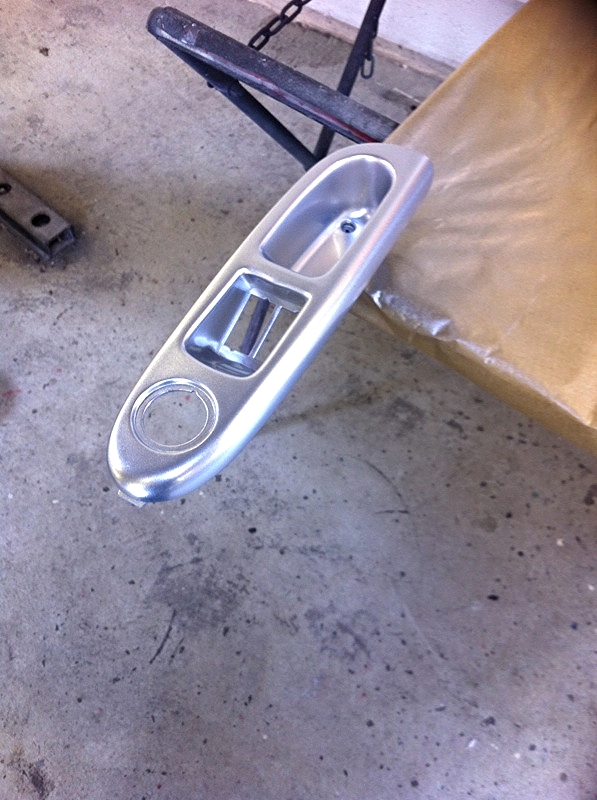

I wanted the engine cover and inside shut handles painted in titanium body colour, after a few pm's to HMS Derv Destroyer the bits where sent off to him.
Not got them back yet (should be monday/tuesday) but these are the pictures that he sent me.

sunglasses on if you take the cover out in direct sunlight! about blinded myself :)
pleasure doing those mate, makes a change from painting side outs on cars !

Looks bloody sterling work there, what's the colour?
I went for body colour mate, titanium.
Im trying to keep it factory oem. :eek:
Inlets/fuel guard are being done in Luner Grey, im hoping the two colours will look good together??
Drove me and Andy bonkers doing tit'um
90 odd% flake ( think that's what Scott said... )
looked white in places, but out in daylight it's covered superbly. His grab handles look that amazing , I might have to do myself a set :)
it's had a light coat of light silver , 4 coats of colour( low pressure passes ) and double lacquer.

I wish I had replaced my pas and coolant resovouirs, looks much cleaner.

Much awesomeness! !! oh and reservoir ;)
My spelling is s**t, cheers Chi. :eek:

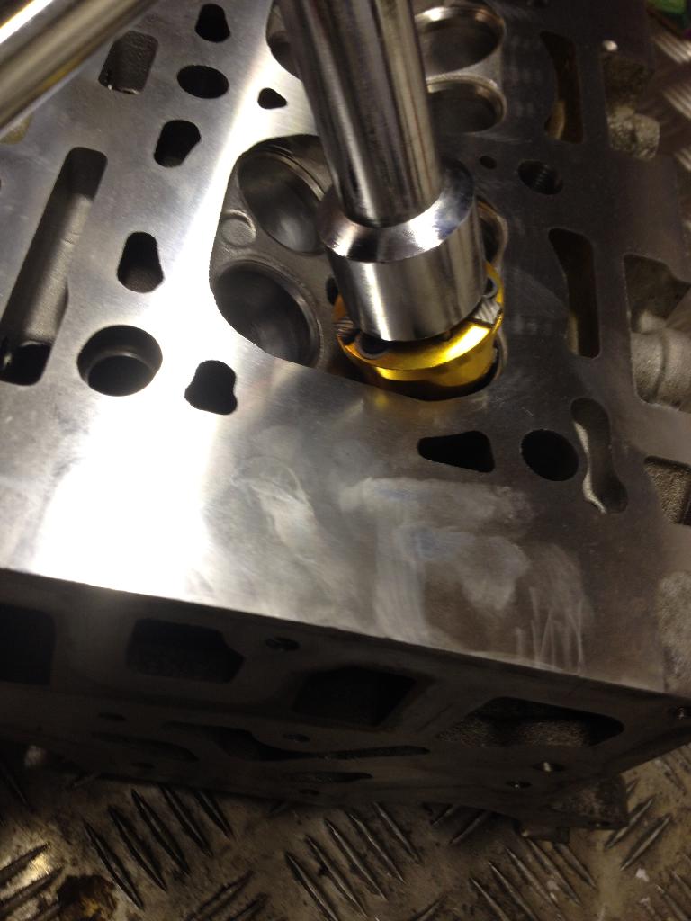

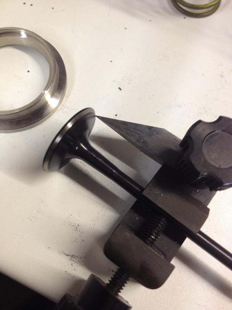

Took a few pics of the valve job
Setting the gauge for the seat cutter
Cutting the seat
Cracking work as always mate.:approve:

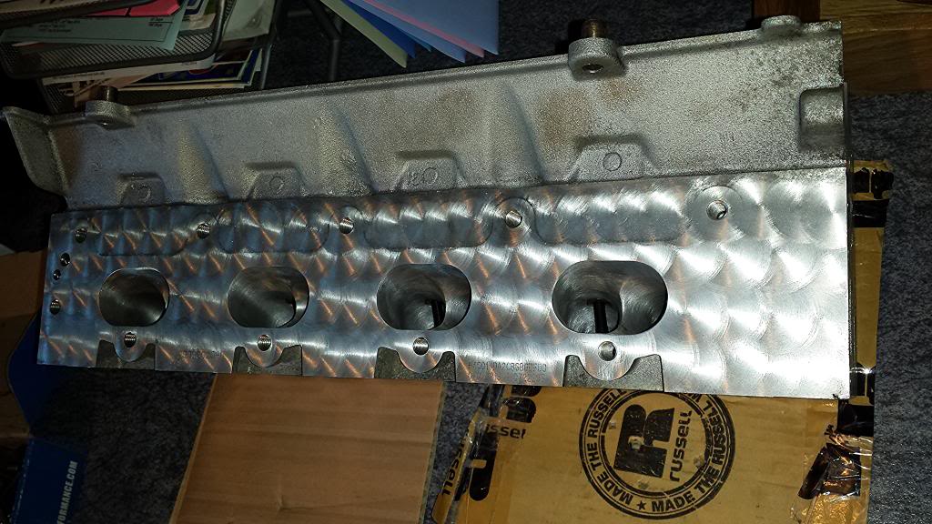

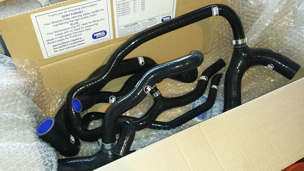

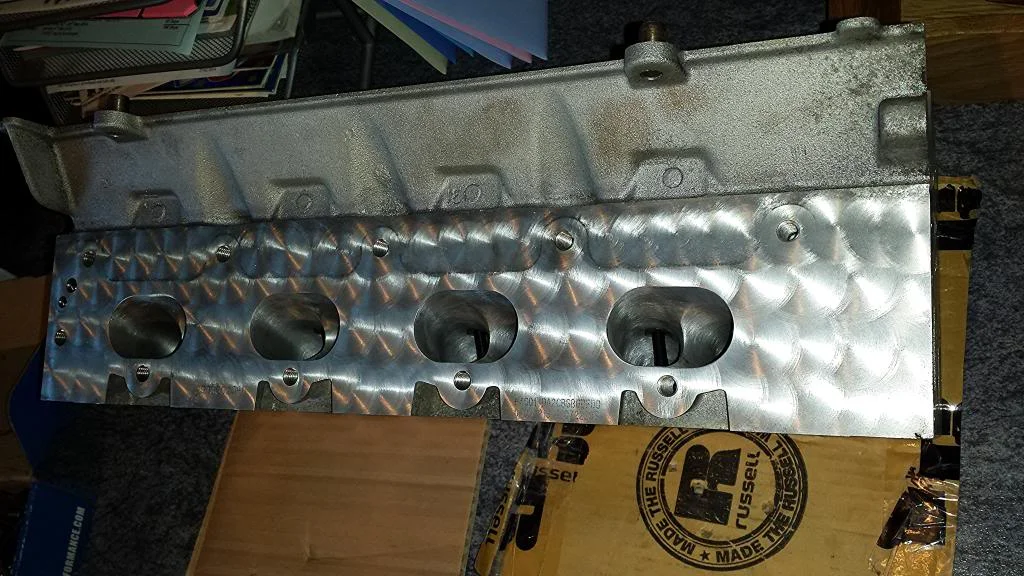

So this week the head came back from ALD, the Samco hoses got delivered from Demon Tweeks and my painted engine cover and door handles from HMS Derv Destroyer.
Heads been ported, new valve guides and super techvalves fitted.
Sorry for the crap picts.

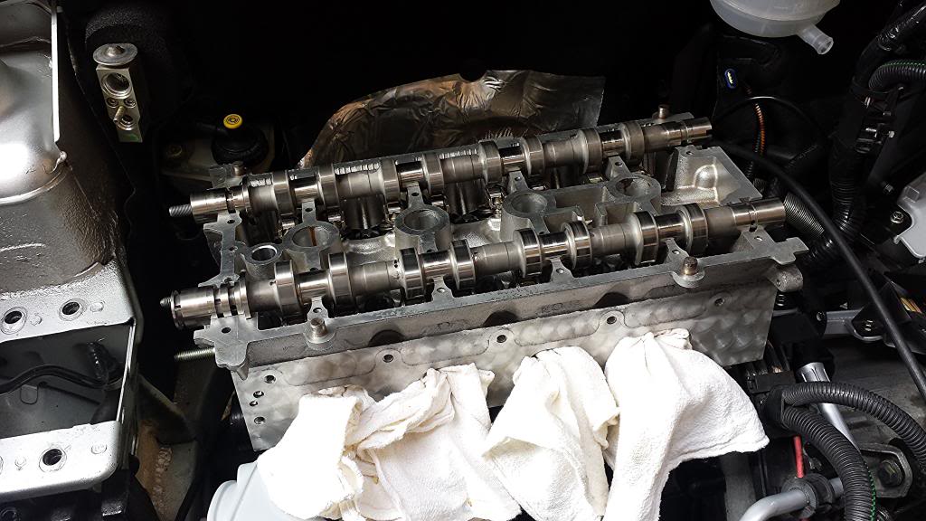

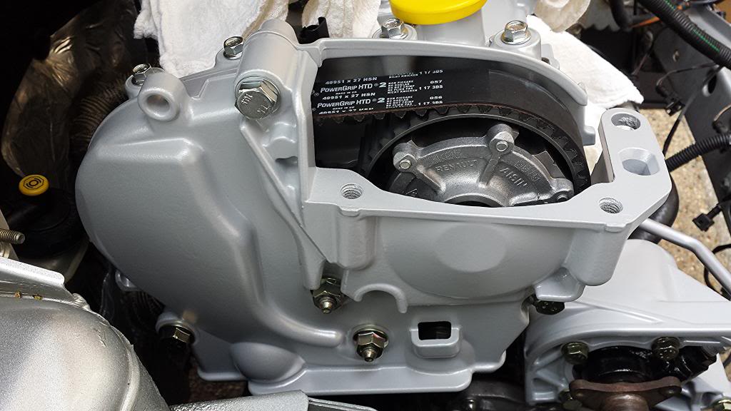

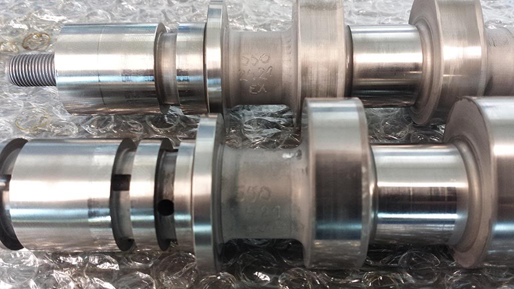

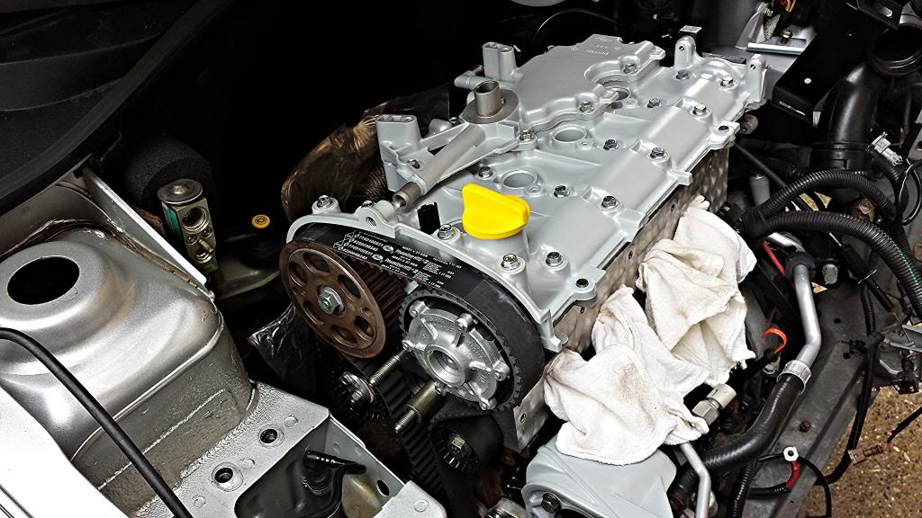

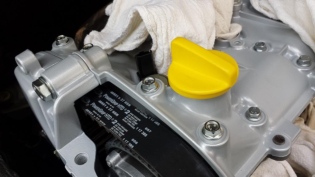

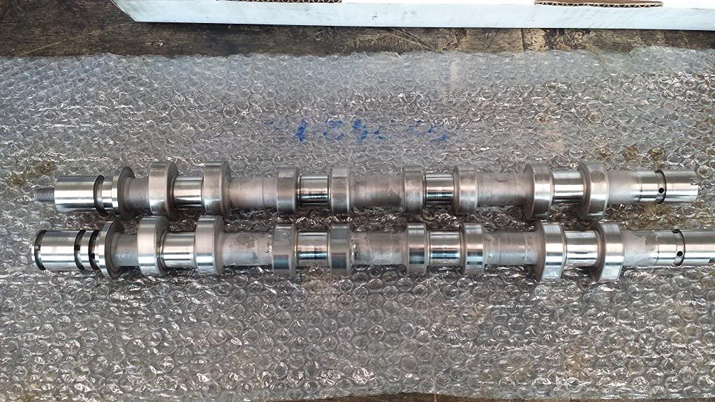

So today i got @AlexW over to give me a hand fitting the head and timing the 421's up, got the head fitted along with the cams.
Fitted the Meg 225 crank pulley along with a new dephaser, when AlexW tryed to set the cam belt tensioner he couldn't get the tensioner to sit in the correct poisition as the head has been skimmed 8 tho (shouldn't make a difference tbh)
Anyway i gave Fred @ BTM a call as i heard he does a bigger idler pulley, bigger pulley has been ordered and should be with me by next weekend so the fun can continue. :)
Cams nice and clean.

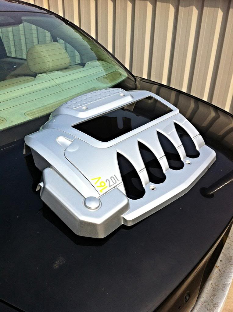

I know the cover is not ready to be fitted but i got excited and wanted to see what it looked like.
New oil cap, had to be done.
