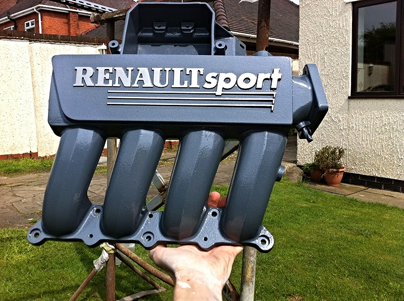

Inlets have been painted, very happy indeed.

Some bloody work gone into that peice alone !
Andy sat at night watching TV whilst carefully sand polishing the renaultsport logo ! :)
new found favourite rite colour that D60 is!

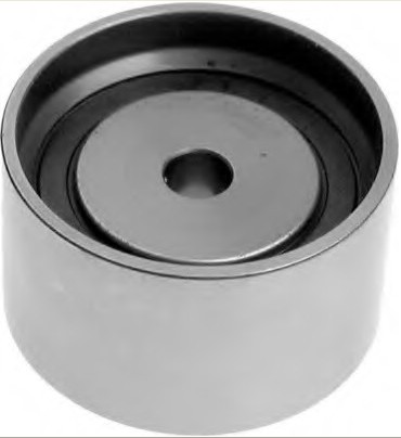

The new pulley needs to be 4mm bigger than the one i alreay have, mine is 54mm x 32mm wide with a 17mm center hole/bolt hole but there is a spacer that drops it down to a M10.
The cambelt is 25mm wide so as long as the new larger pulley is 25mm wide it will be ok.
Freds one looked something like this

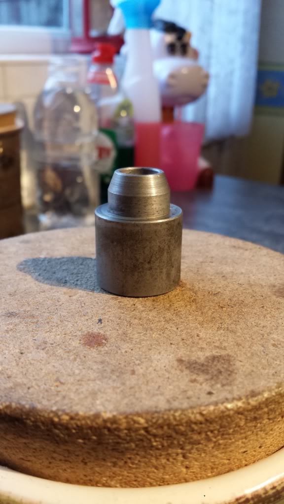

When i was at Freds he did give me a spacer off of a F4R.
This
Now he told me that a bit needs to be removed from the top part of the spacer so it fits inside the new pulley bearing he also said that some would need to be removed from the bottom so it sits inline with the belt.

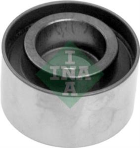

After a bit of searching i have found this.
Now from that picture it looks like the top part of my spacer will fit inside the bearing, the only problem im having is trying to find out the sizes of this pulley.
