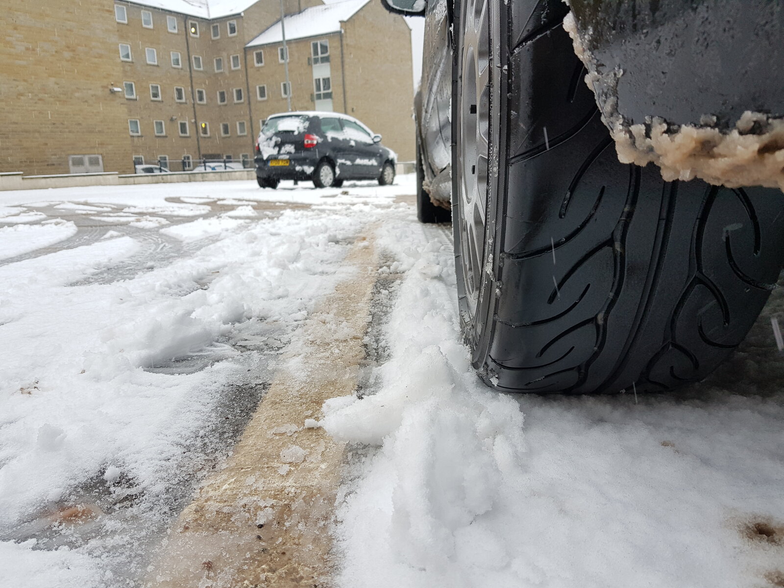

Just got the a048 swapped over for these new made this year, when do they get good lol. I only gave it a bit of a go anyway but they are light.. hadnt checked pressures though so garage could of given them 40psi

You won't scrub them in, in this weather unless it's fully dry.
Are they the newer AD08RS?

@JamesBryan No not the new S version. I thought Id remove the semi slicks that were around 10 years old so I could use the car a bit of the winter, should of left them on, they were very grippy, Im going to go out when its a bit more dry and see again

Never had a problem when i used AD08R's, even in the snow.

So turns out they are the new ad08rS and I was out for a while yesterday so was able to come to the conclusion that they are pretty damn scary lol. Im disappointed, I know its cold but the a048 were so grippy when they were stone cold, more grip than the new tyres when they have a bit of heat in them! The wheels look good wrapped in them at least :p

You can't compare A048s to AD08Rs though. One is a track focused semi slick, the other is a fast road tyre.
I have AD08Rs on one set of wheel at the moment. Fine for a summer road tyre, but pretty poor on a dry track in my opinion.

You've gone from dedicated soft track tyres with 60 treadware that don't need lots, if any heat to grip to a hard road/track tyre with 200+ treadware that require lots of heat to work properly. The dry/damp grip difference will be massive.
I really don't understand why people run these half arsed track/road tyres on the road in winter, they are lethal when cold and are very hard to get up to temp on light cars like a Clio.
Could you not just get a set of cheap wheels and throw some new Rainsport 5's on them, probably cost you less than £300 all in and give you the piece of mind and safety for winter driving.

Lack of experience and trusting the internet reviews! I was just under the impression theyd be okay from cold. And its not like im daily'in the clio but I will be using it few times over the winter so didnt want get dedicated tyres as to just keep using the 'performance' tyres into the summer

The ad08rs is a new compound. I'm yet to read good reviews on them

Update! They were at 35 psi which the garage put them to, lowered to 30 and put new lower joints on and can safely say they are perfectly fine! Am confident to drive them in snow now like @Louis lol
Crazy how tyre pressure makes such a huge difference! Good to know they feel good. Please keep updating when you start pressing on as I'll probably be looking at getting a set next year!
