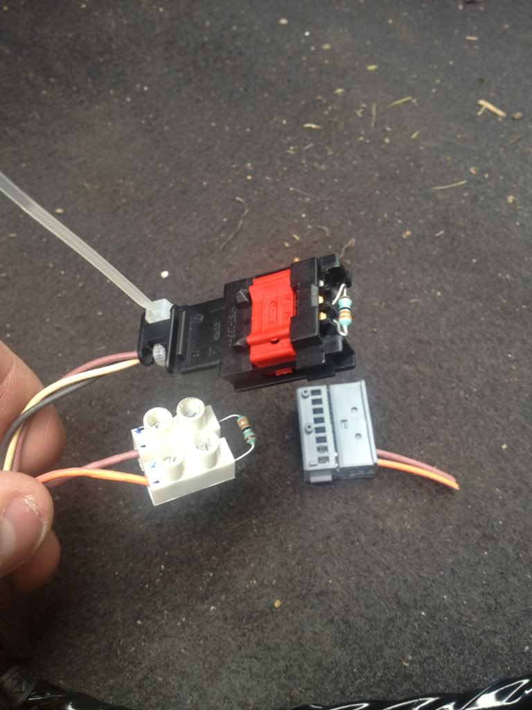

I have fitted to my car a Sabelt steering wheel which I placed two 3.3ohm resistor's between the two airbag connections I doubled over the resistors to make a good connection.
My car is also stripped out at the rear so I have placed two more 3.3ohm resistors on the two rear seatbelt pretensioners.
I have also fitted aftermarket Bimarco Futura seats not using the orignal seatbelts and harnesses instead.

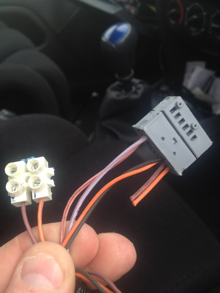

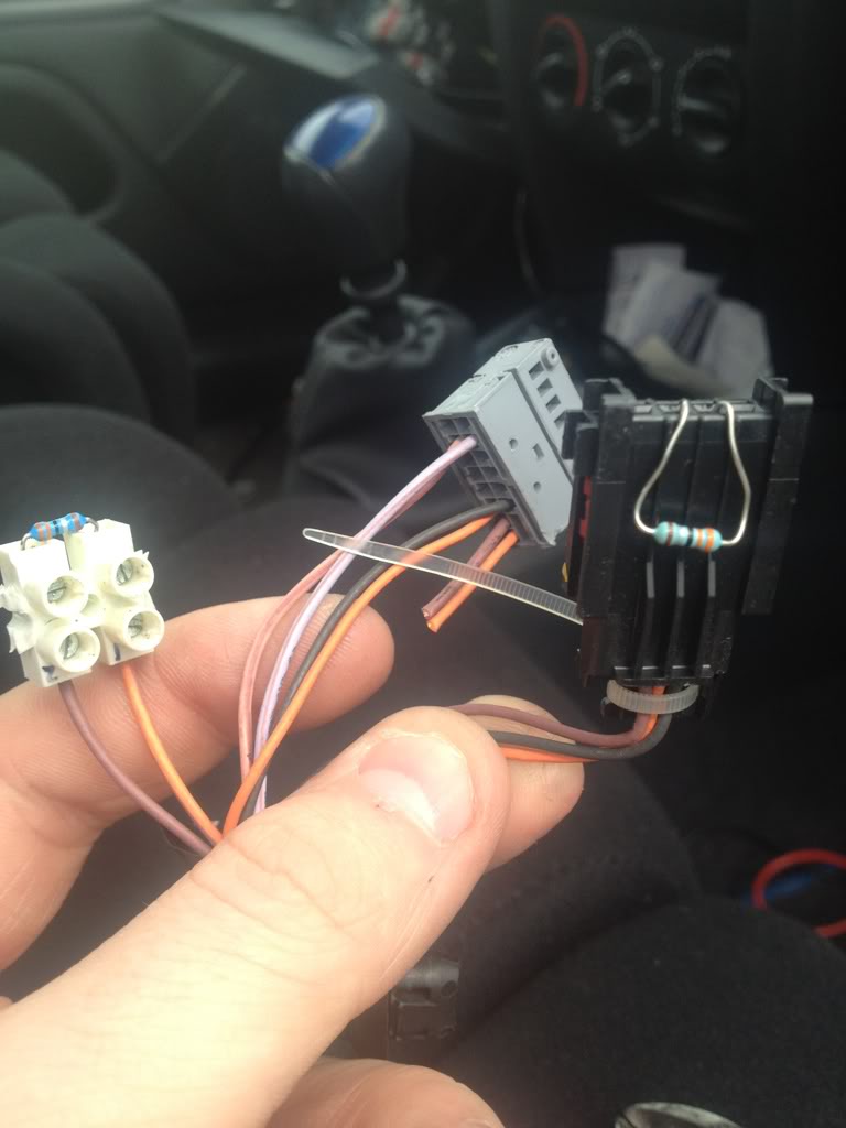

On the drivers side, one resistor is connected between the ORANGE & BROWNwire's on the BLACK/RED plug. Once the resistor was placed into these connections I used a meter which read 3.3ohms between the connections. Which I take it, it has made a good connection?
The other resistor was placed between the ORANGE & BROWN wire's again on the GREY plug. I cut off this plug from these wires to get a better connection using a coch block. Once the resistor was placed into these connections I used a meter which also read 3.3ohms between the connections.
As shown below:
The passenger side was done exaclty the same and 3.3ohm was read between the connections.
The rear seatbelt pretensioners where also tested and read 3.3ohm between them so these must also be working correctly?
