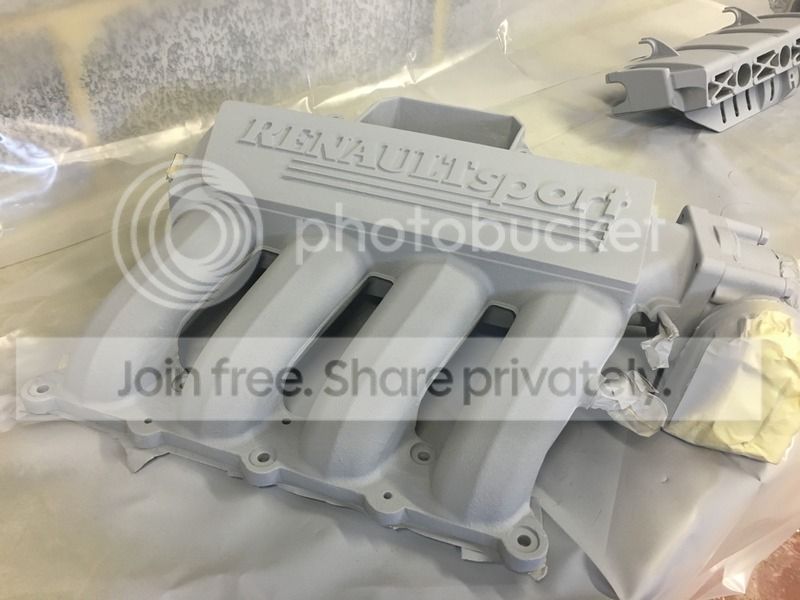

With the wheels off, I'll have a bit of time free so the inlet manifold and fuel rail removed, not decided on paint or polish yet.
