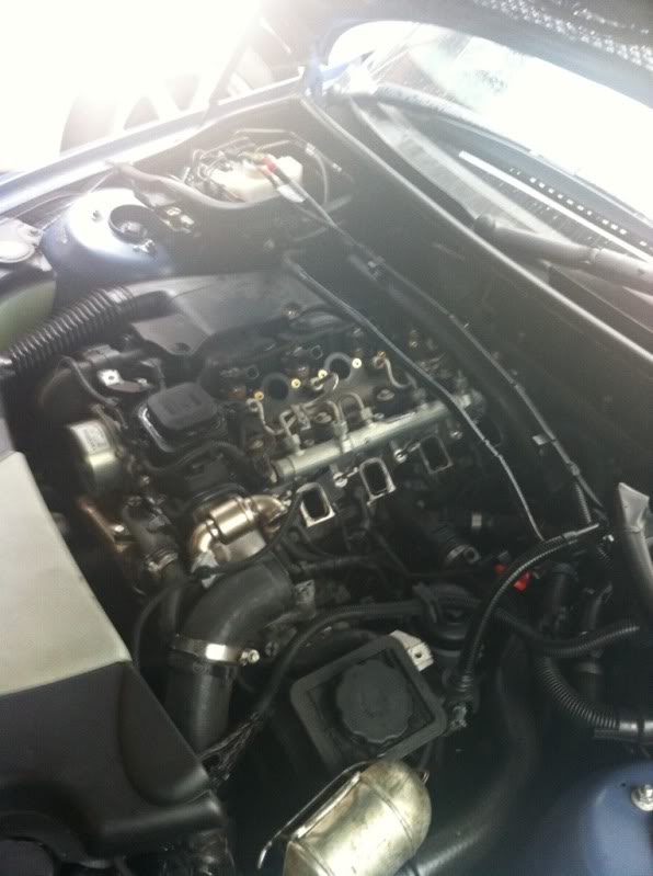

Right ho, time for a little update.
On Saturday, i popped over to Sarah's parents house, complete with a big box of new parts, my toolkit, a laptop full of 'how to' guides & a huge dose of mechanical ability ...
After 5 hours, the swirl flaps were removed, the EGR valve cleaned, the pollen/air filters changed and most importantly, the swirl flaps were in the bin! Didnt take many photo's during the procedure as i was covered in dirt & didnt want to get my iPhone grubby :eek: but i did make sure that i took one with the engine i bits, just to prove to Budgie, etc that i had actually done something myself, without their help ...
Yup, i was a little concerned at this point, i've only had the car 2 weeks & its already in bits ;)
To be honest, it was a little fiddly, but the guides were spot on!! Now i've done it once, i reckon 3 hours max. if i have to do it again. Worst bit was undoing the pipes/sensors under the manifold (with it in situ) so that i could pull it off, along with the airbox, what a b4stard getting that thing back on lol :mad:
Once it was all back together, i had a beer, just to calm my nerves before switching it back on again (just in case something had fallen off & it ate itself, on Sarah's drive, & left a huge pile of oil/engine parts outside their garage). Thankfully it was ok, started 1st time with no odd noises & drives exactly the same as it did before. Winner.

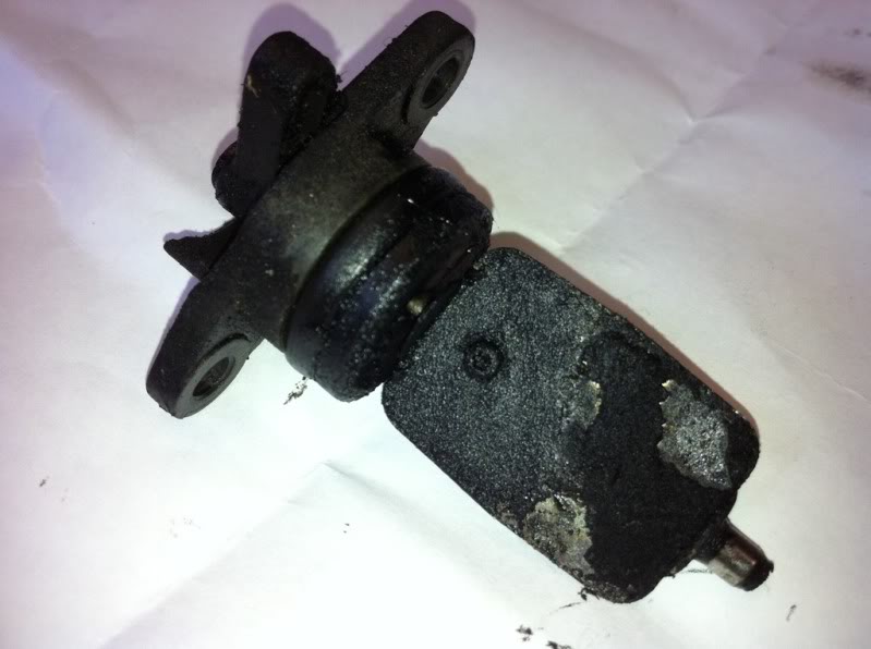

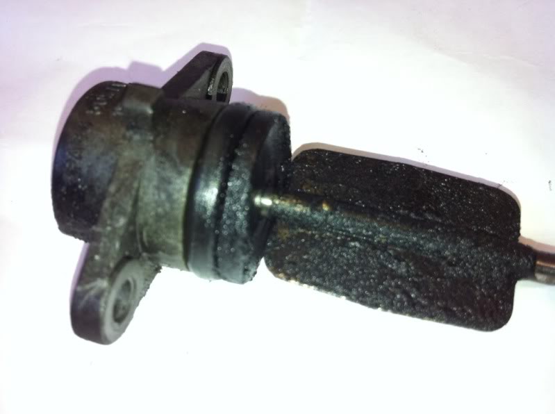

Having removed the swirl flaps, thought i'd do a quick write up, in laymans terms to explain what they do/how they fail, etc.
The flaps are designed to create a 'swirl' or 'tumble of air' to aid better combustion under light load and subsequently help with driveability in low load conditions. They are controlled by a vacuum/solenoid actuator and are closed during light-load operations, ie idling at traffic lights, changing gear & deceleration - to maximise combustion efficiency, fuel economy and emissions performance. The flaps are fully open during higher load conditions to maximise volumetric efficiency and power output.
Unfortunately, having sucha device on the inlet manifold is potentially disasterous, ie if parts break/fall off, the debris will be sucked into the engine.
This is obviously bad!! and the broken pieces have been known to either stick in the valve port, jamming it open (causing the piston to collide with the valve), or fall into the cylinder itself - causing the piston and head to become damaged.
How they work:
The flaps (tee hee, flaps ...):
After removal (note how minging & black they are!!):

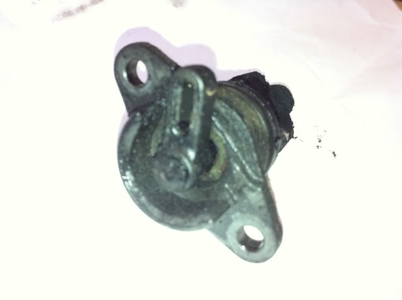

Actuator side:
Showing the small screw, which 9/10 falls off & into your engine:
Essentially, you remove all the above, probably by following this guide, and fill the remaining holes with swirl flap blanks:
