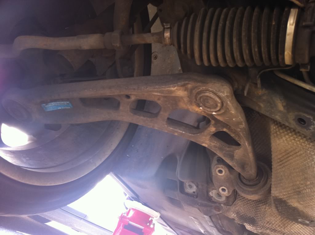

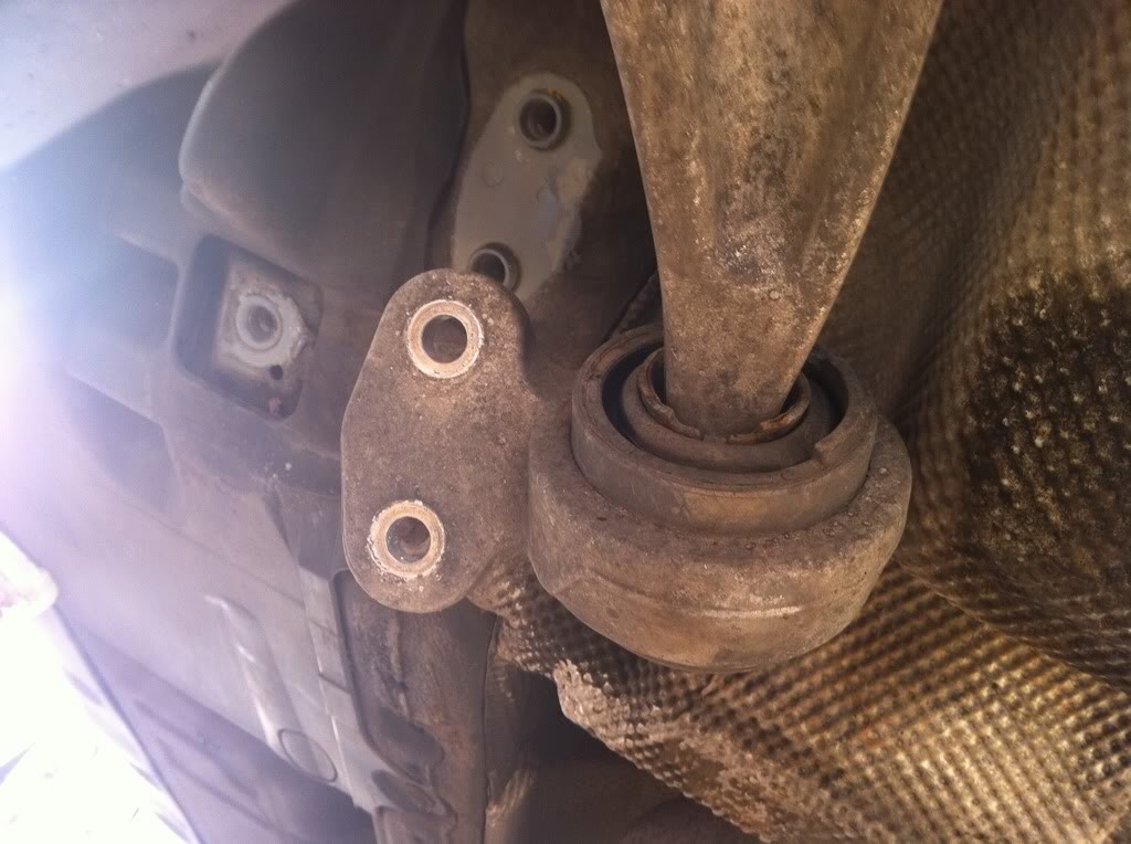

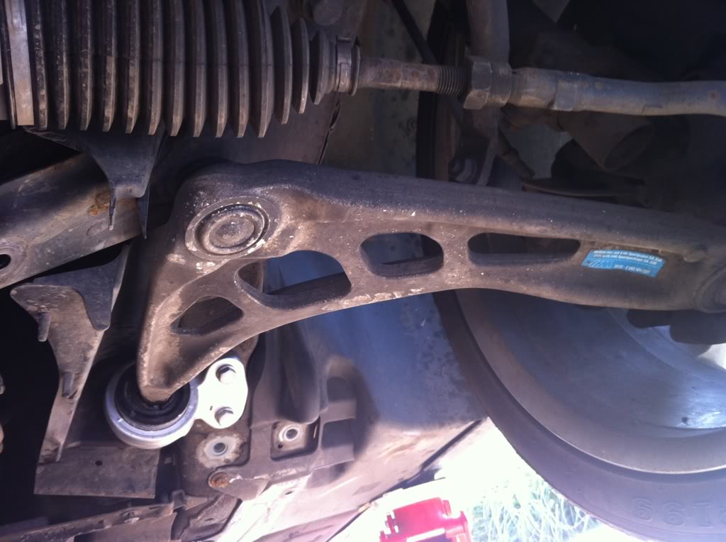

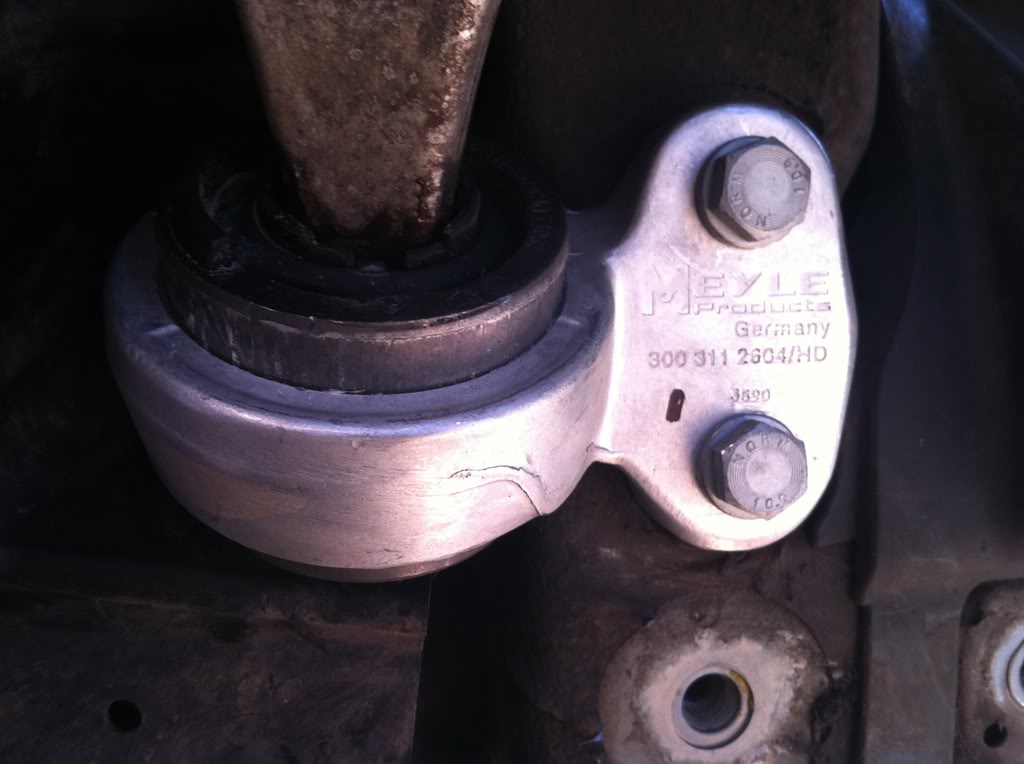

With it being sunny yesterday, i finally managed to swop the rear bushes on the front wishbones. They'd been gradually getting worse since i bought the car, so really needed to sort it out!!
Symtoms - shakey steering wheel at 35-45mpg, 'loose' sensation around the straight ahead & lots of vibration when braking (similar to warped discs).
Solution - change front wishbone rear bush to either OEM BMW ones, or purchase the uprated Meyle ones from C3BMW. I chose not get the Powerflex ones as i couldnt be bothered with getting the bushes pressed into the 'lollipops', the Meyle ones come ready to fit, & are uprated over standard, so should last longer.
As per usual, i had access to one of the fantastic guides from bimmerforums: http://www.bimmerforums.co.uk/forum/f3/how-to-fit-e46-front-wishbone-rear-bushes-t20306/, and had bought a new bearing puller for the job.
The following video gives a more detailed overview of the issue & the remedy:
2 hours later and i had gone from:
To:
Total cost, inc. bearing puller = £100.
