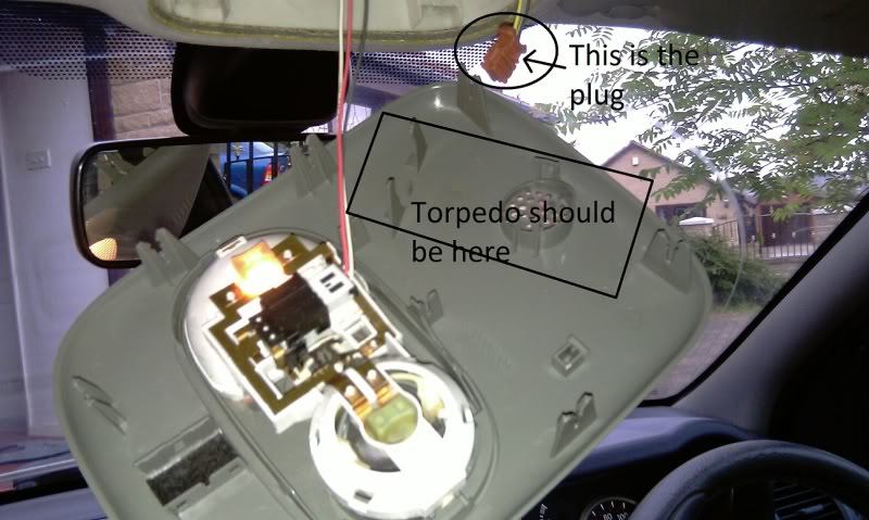

Never mind guys, previous owner had disconnected the interior light CC sensor, plugged it back in made a s**t load of noise when turned on but now just blows hot air where it used to change and reset from and engine off, now even with that sensor unplugged its just constantly hot :(
Ho well, ill get another interior sensor and go from there!

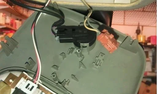

Should I have something attached to the red connector, and if so would it be a sensor thingy to get my climate control to change temperature?

thats completley different to mine mate.....my climate sensor is like a large torpedo, I dont have that other black thingy you have there mines a ph2 172..
I don't know what the black thing in my photo is for, it's got a small blue bit that shows up in the cabin.
As for the torpedo shaped bit, I don't have a space like that where the small vents are.
Mine's an 05 182.
It's all too confusing for my simple brain :S
hmm i think you have the new climate control sensor, much more improved than my version i.e it doesnt need a fan and therefore doesnt make a racket (like mine did before replacement) you just need to pull the black thing out and find a part number on it, also may be worth asking someone with a 182 to pull thiers down and have a look, ours is very different! but defo looks like your missing something there mate! for a start looks like theres 2 screw holes there for something to attach to!
