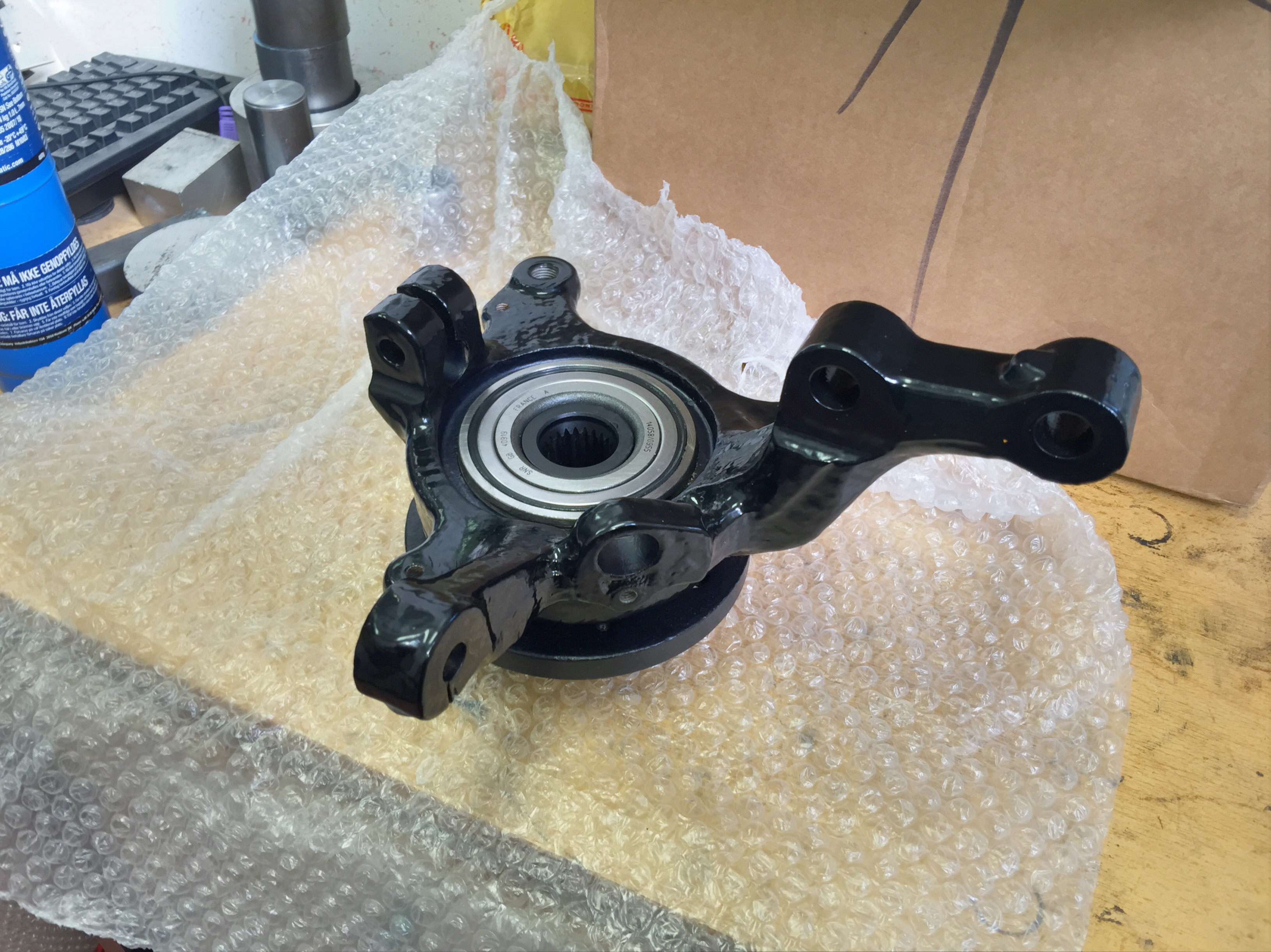

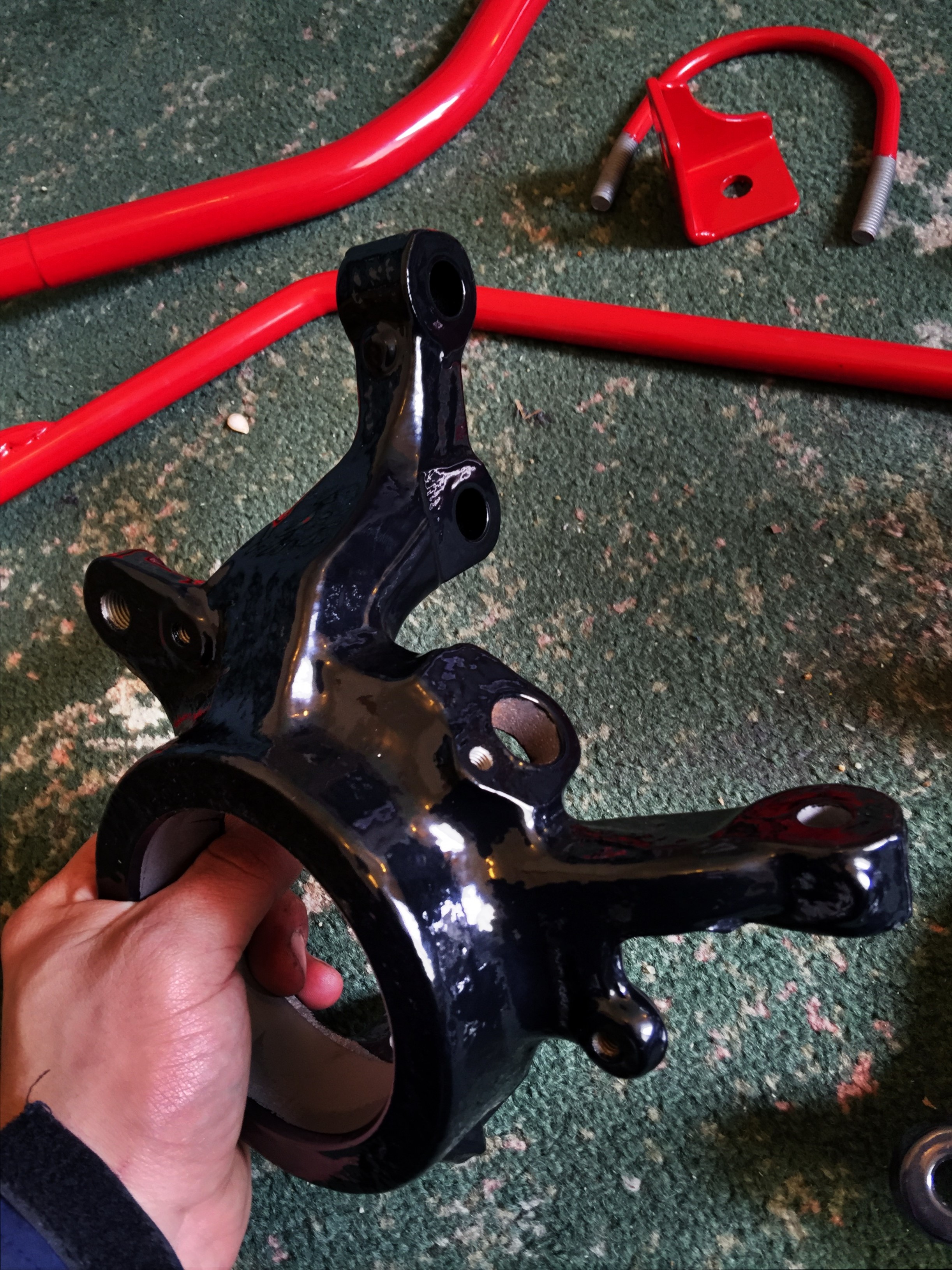

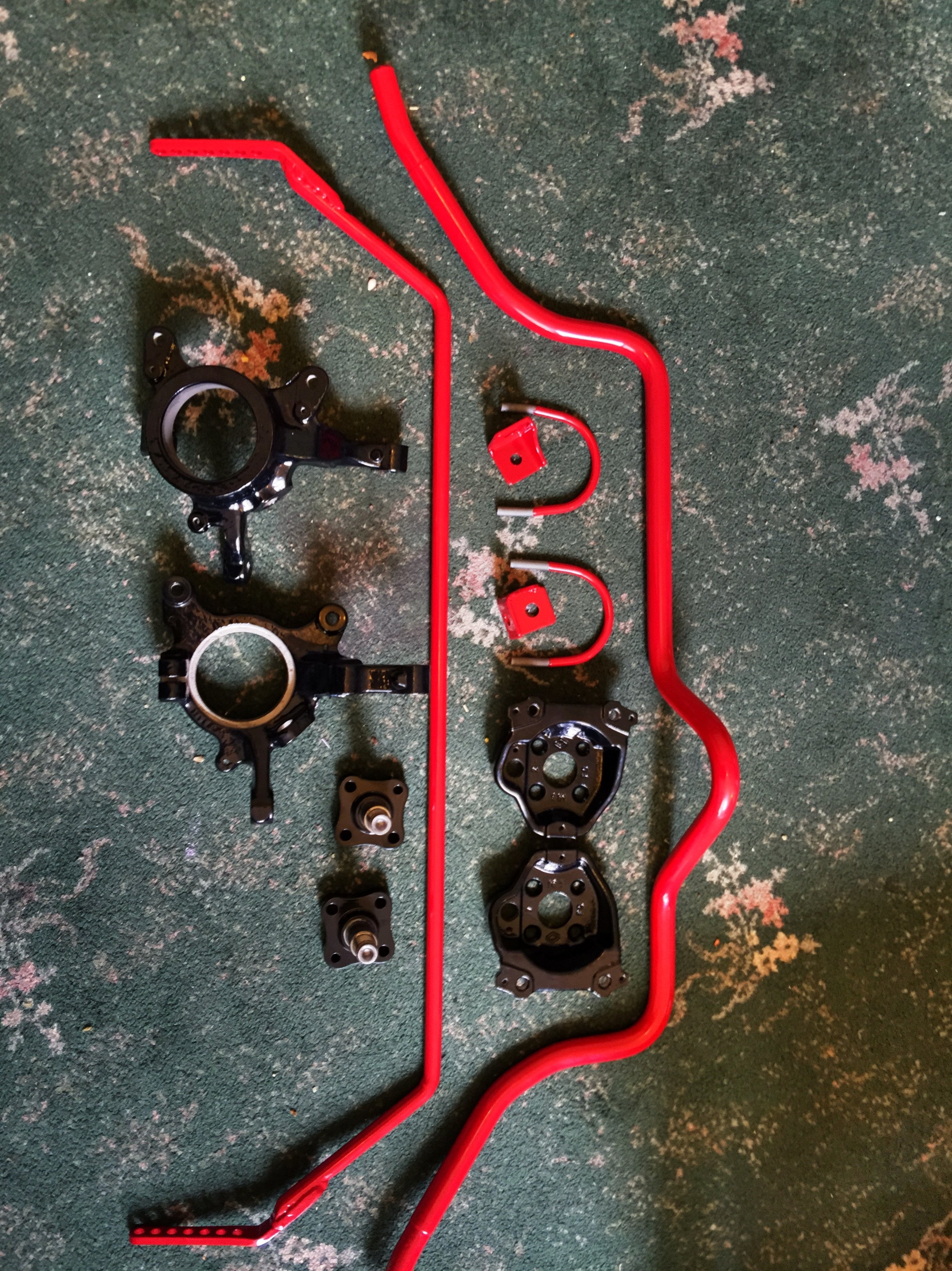

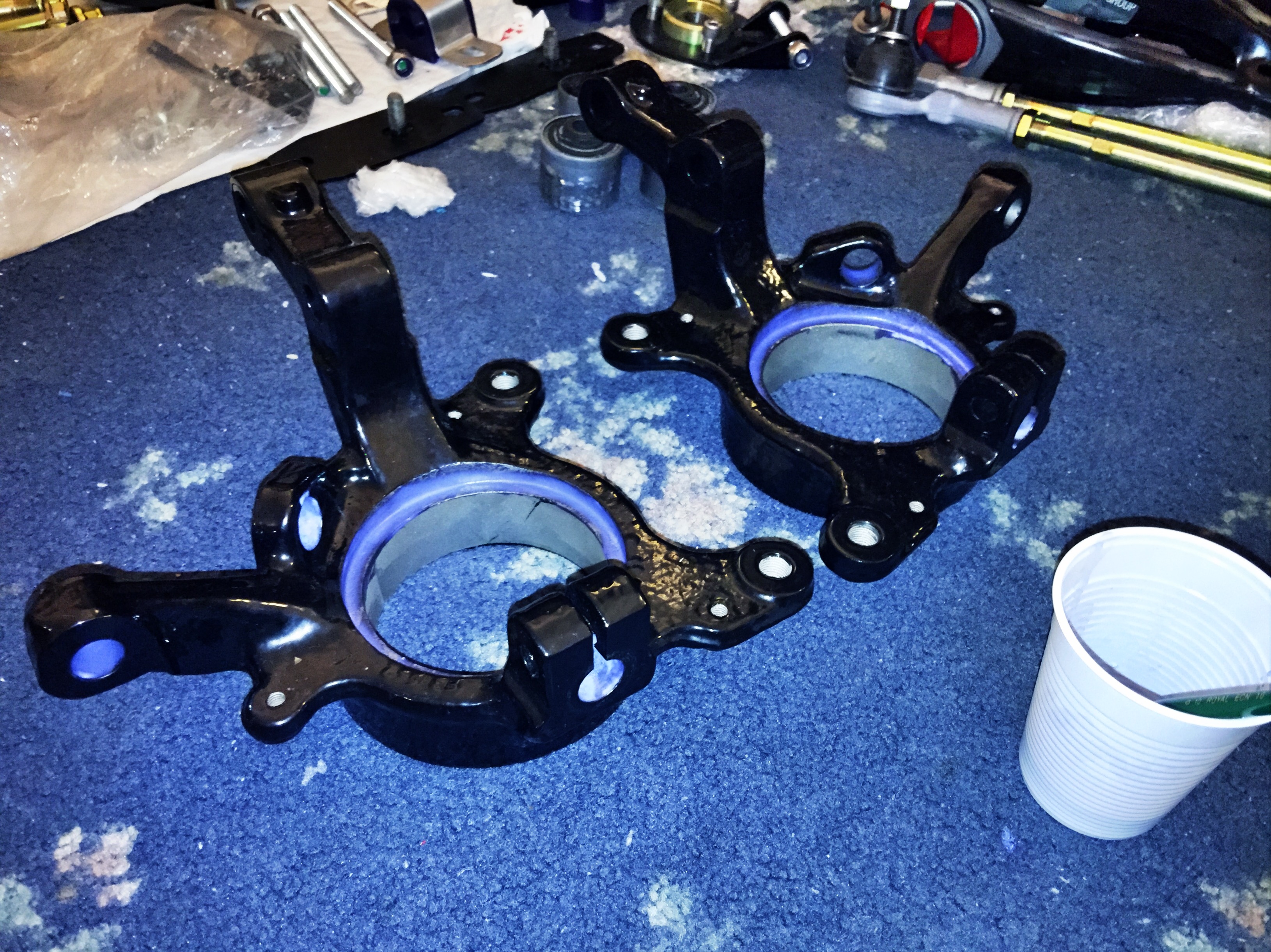

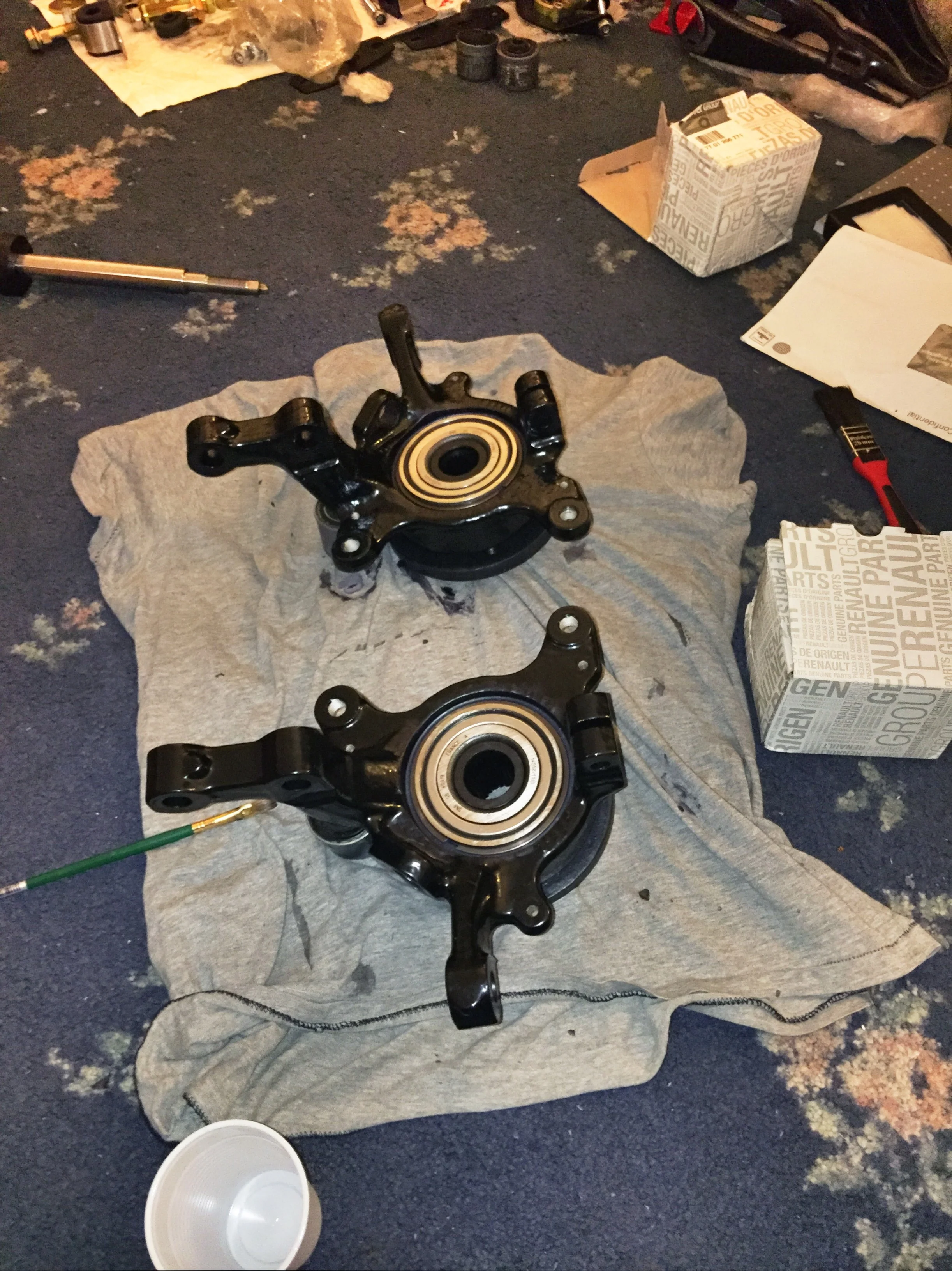

Got a load of parts back from being powder coated and a few more waiting to come back...the results were fantastic!!

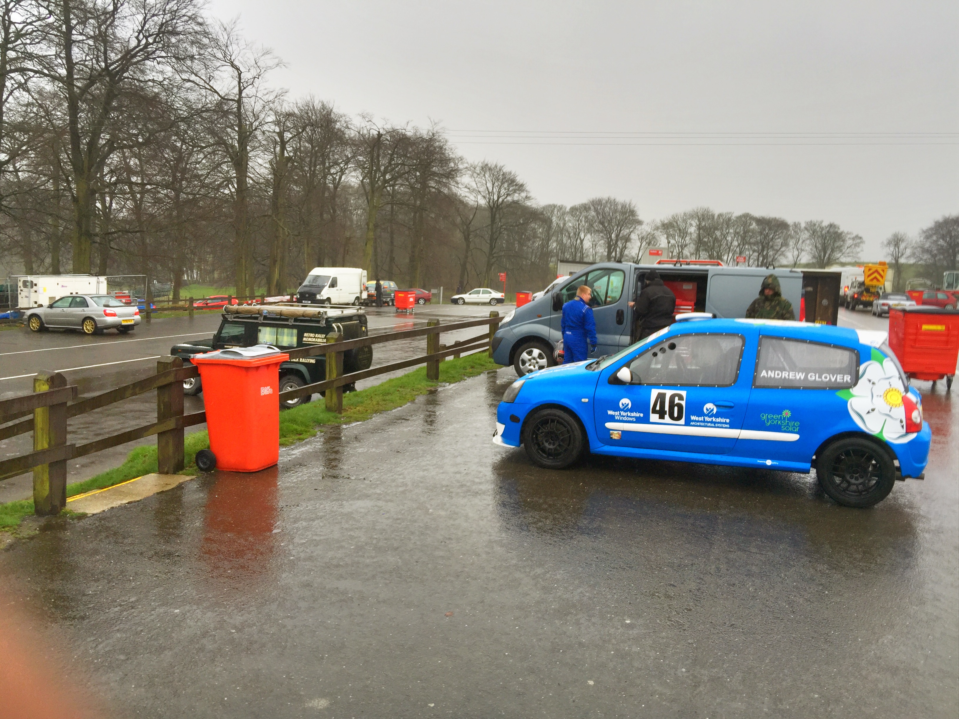

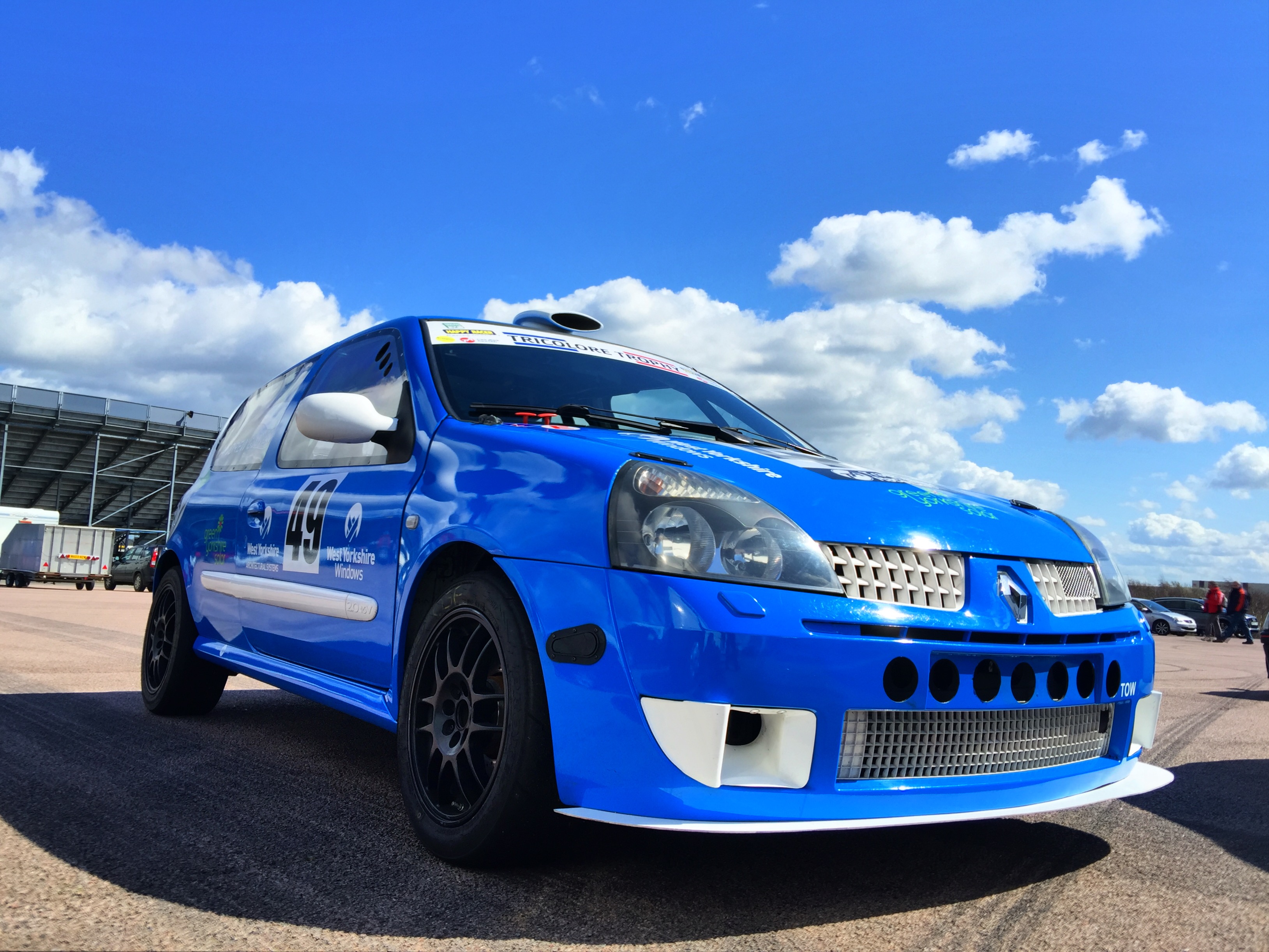

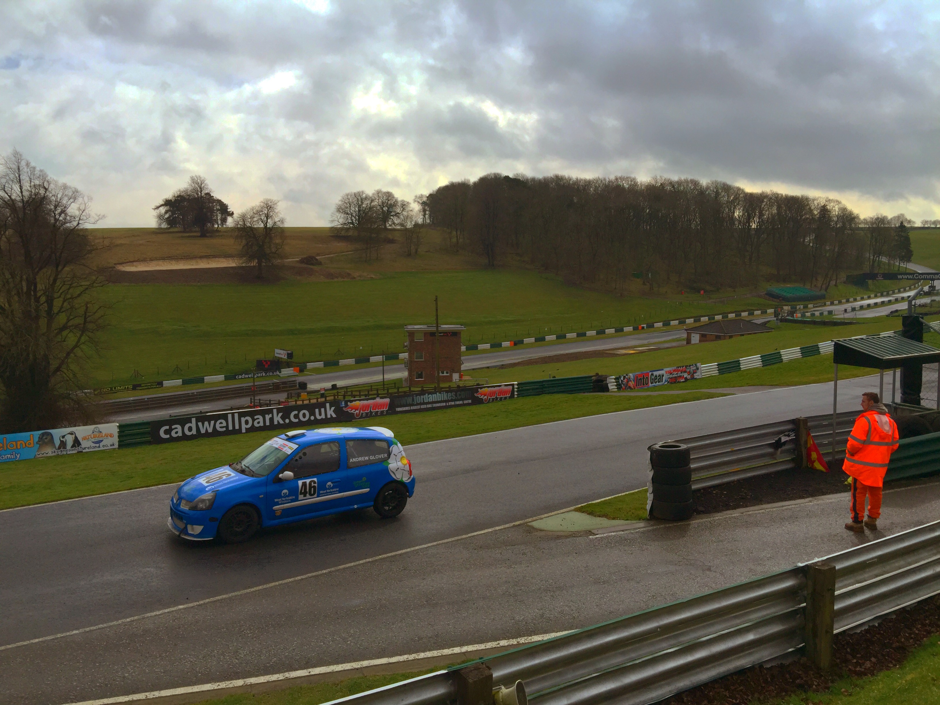

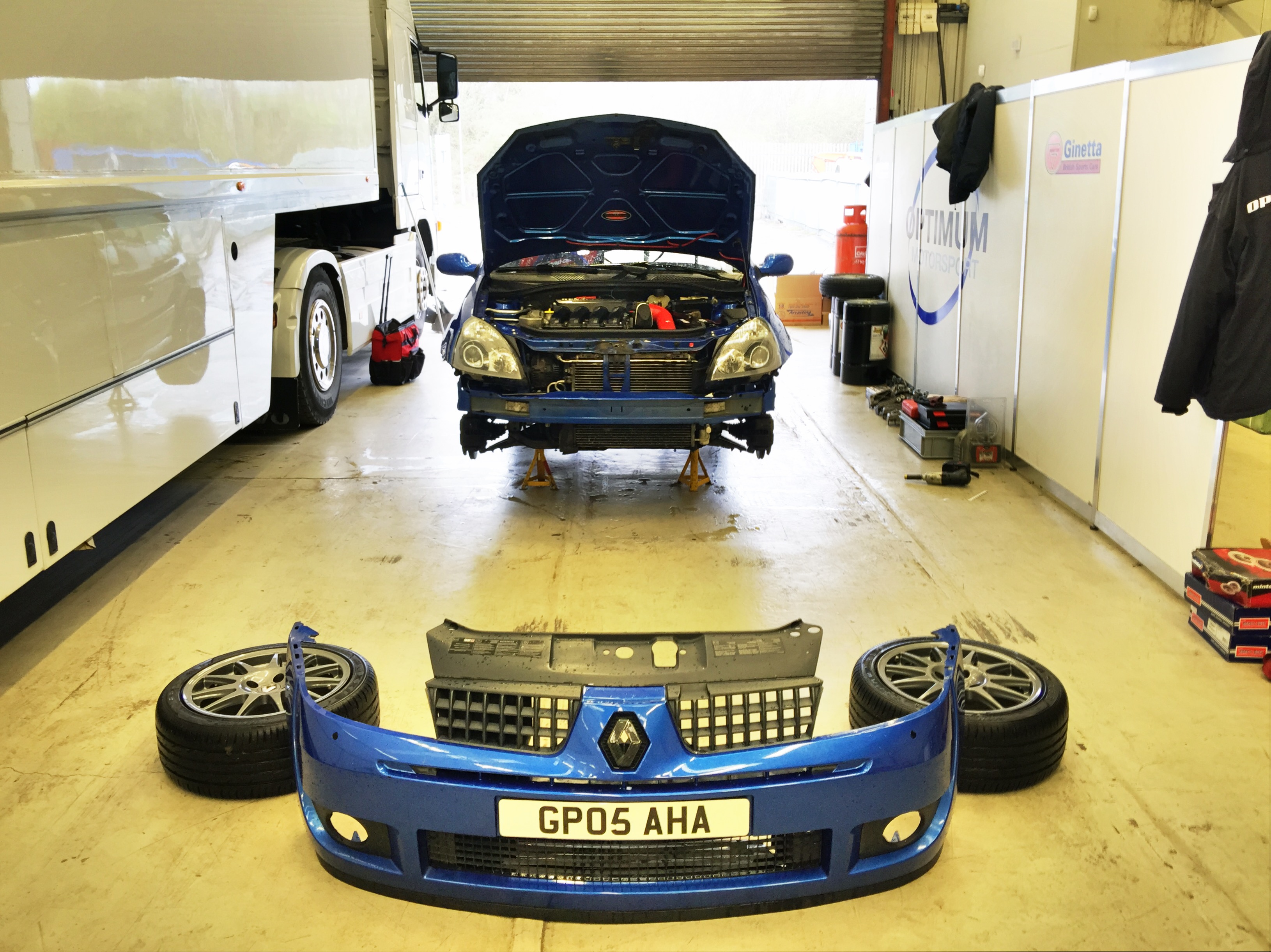

Venture out at Cadwell with my good friend @Apg100 with a very wet morning but ultimately an awesome day and an awesome car!

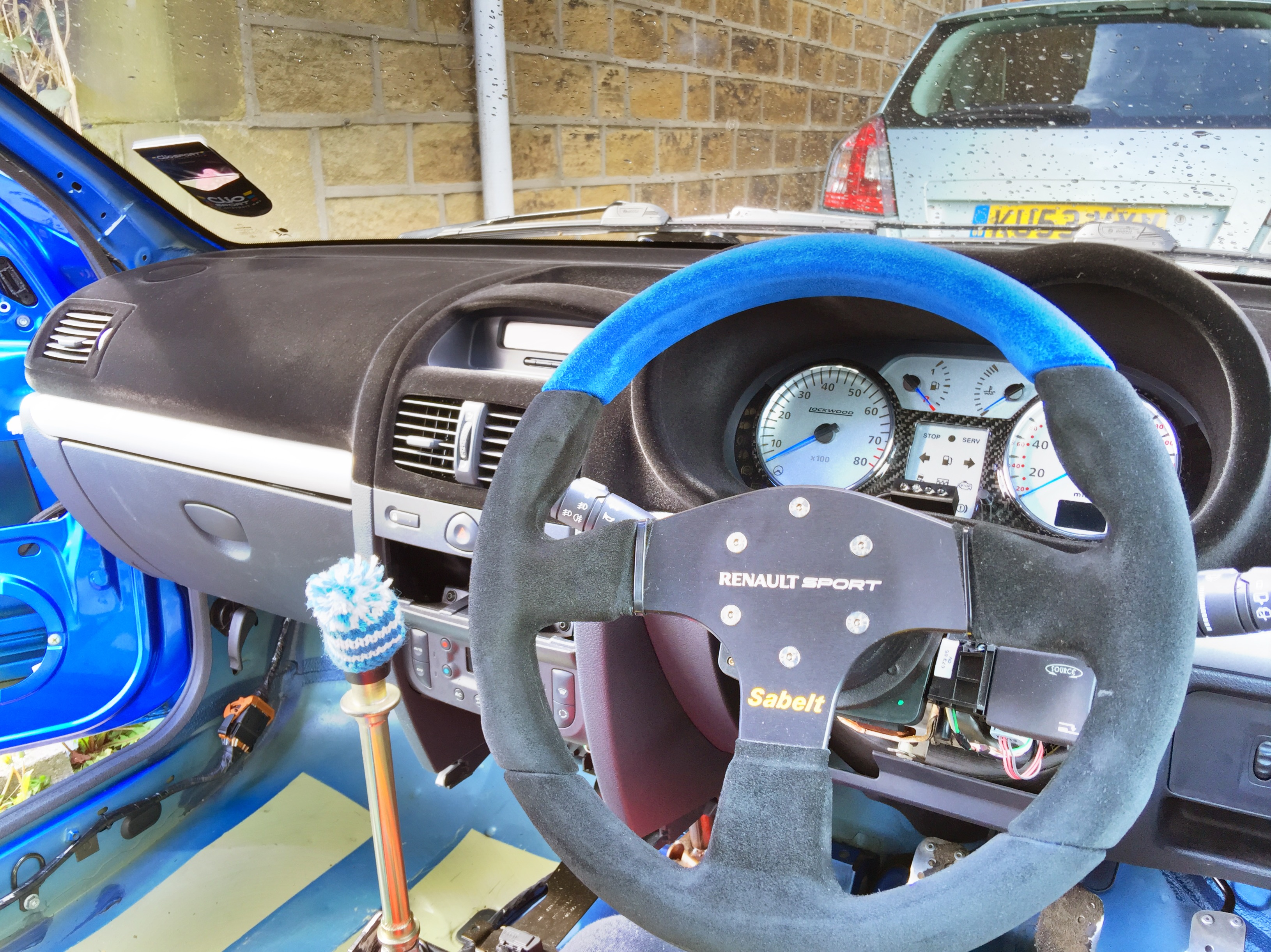

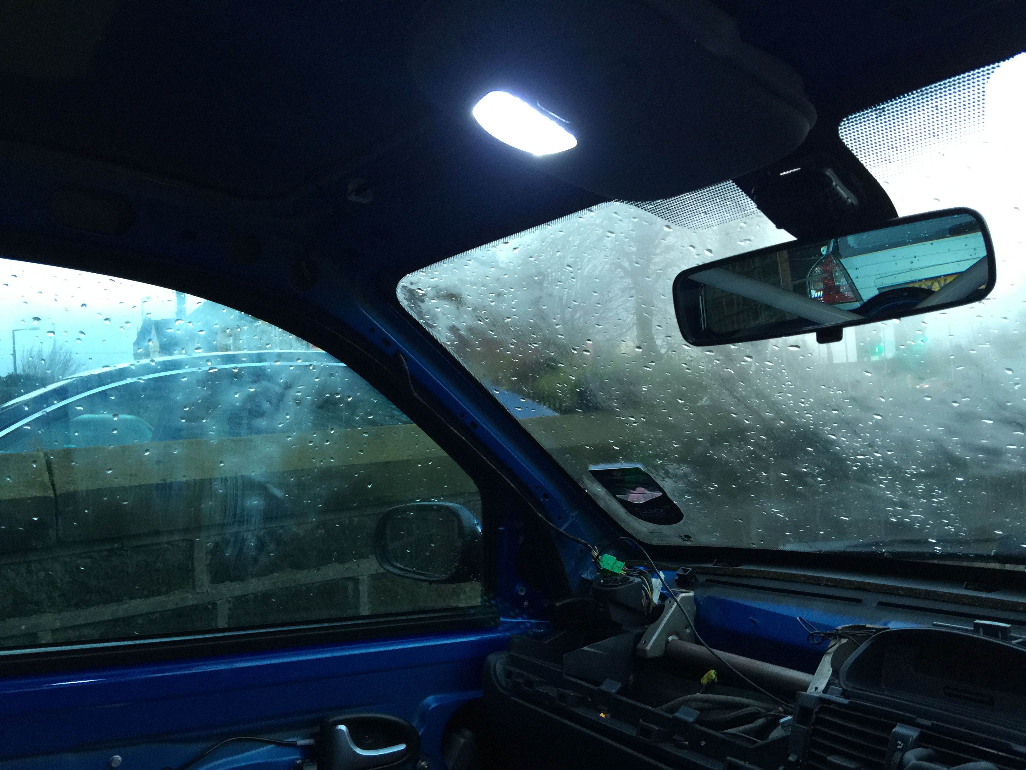

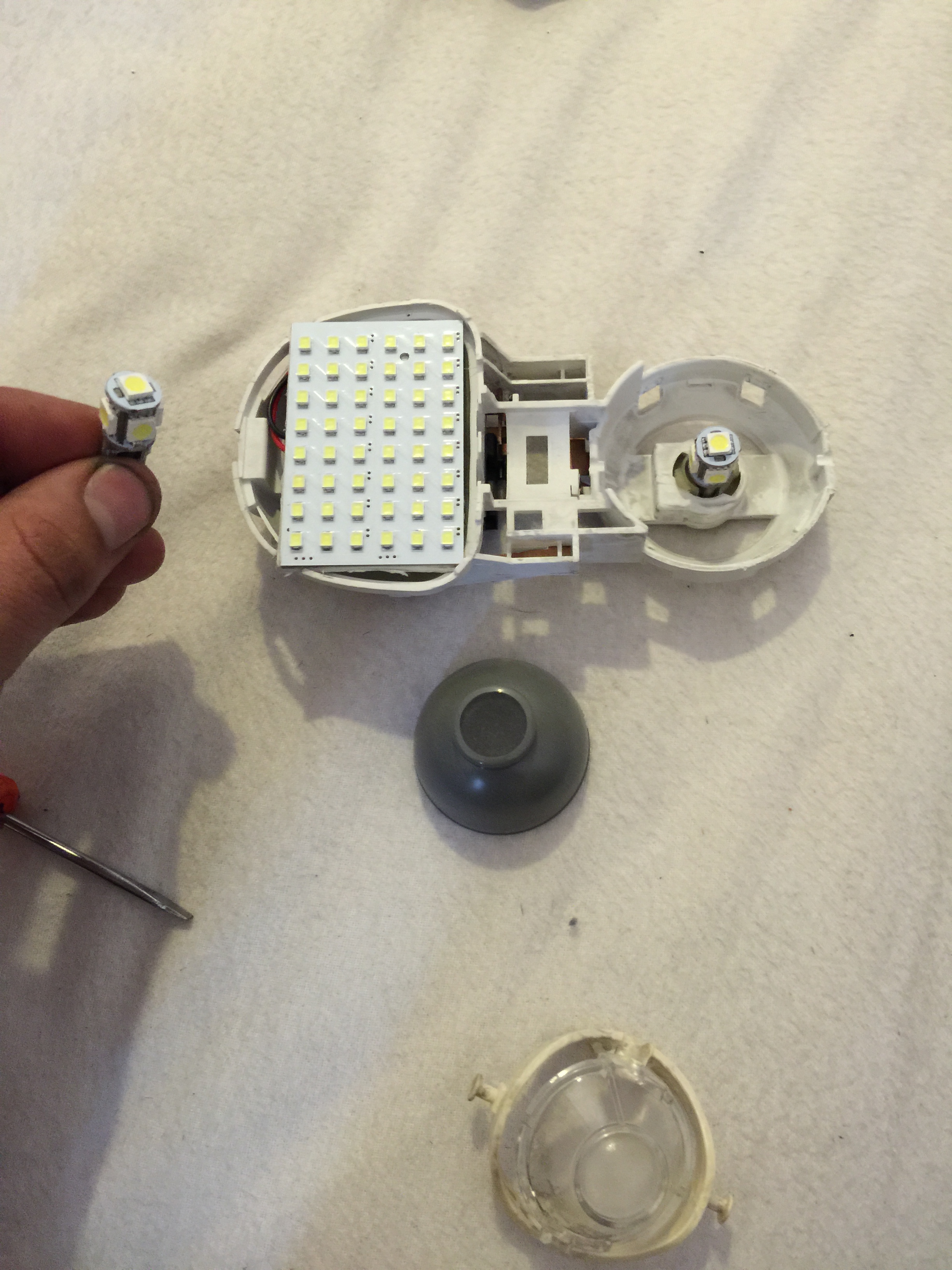

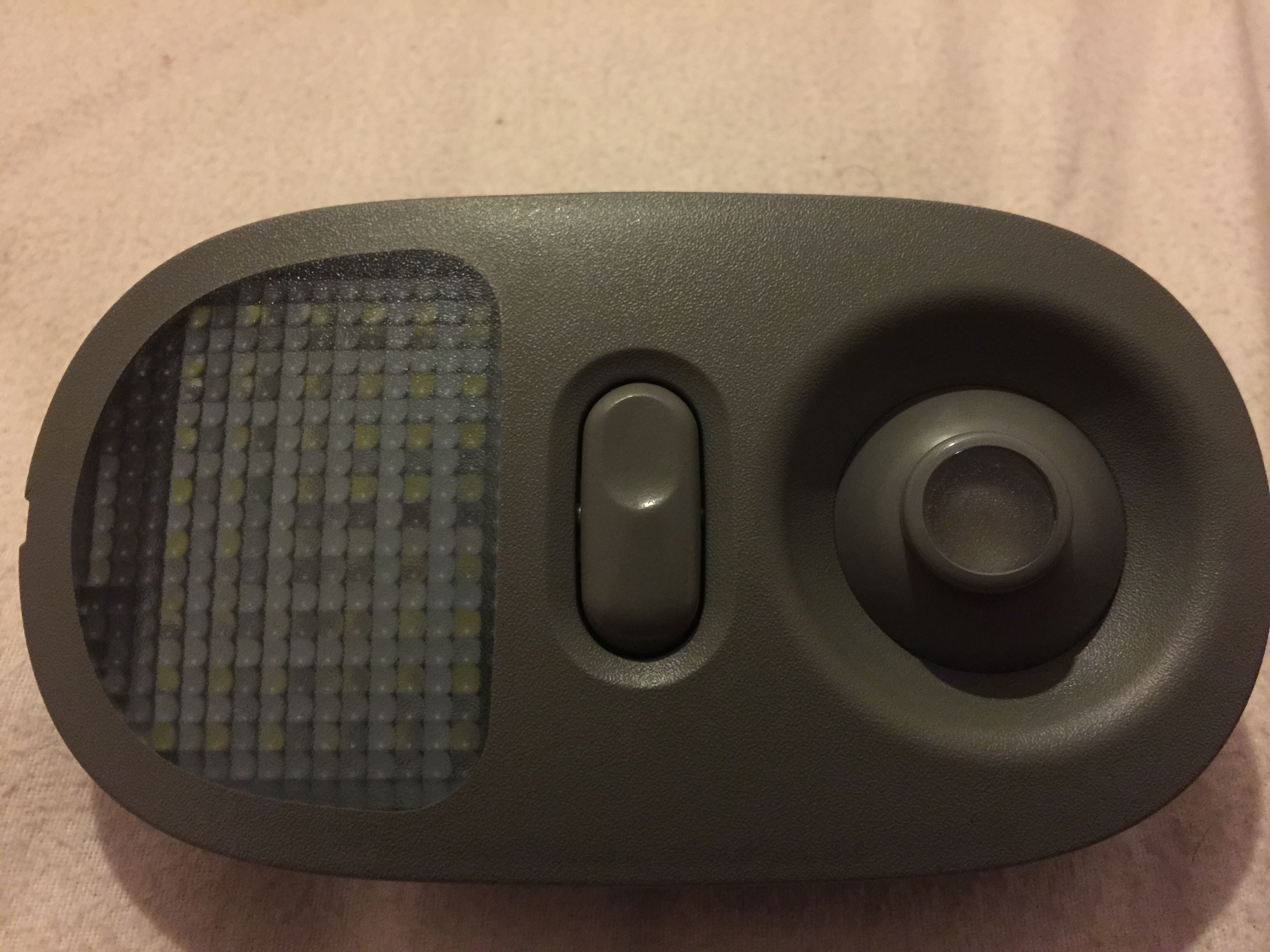

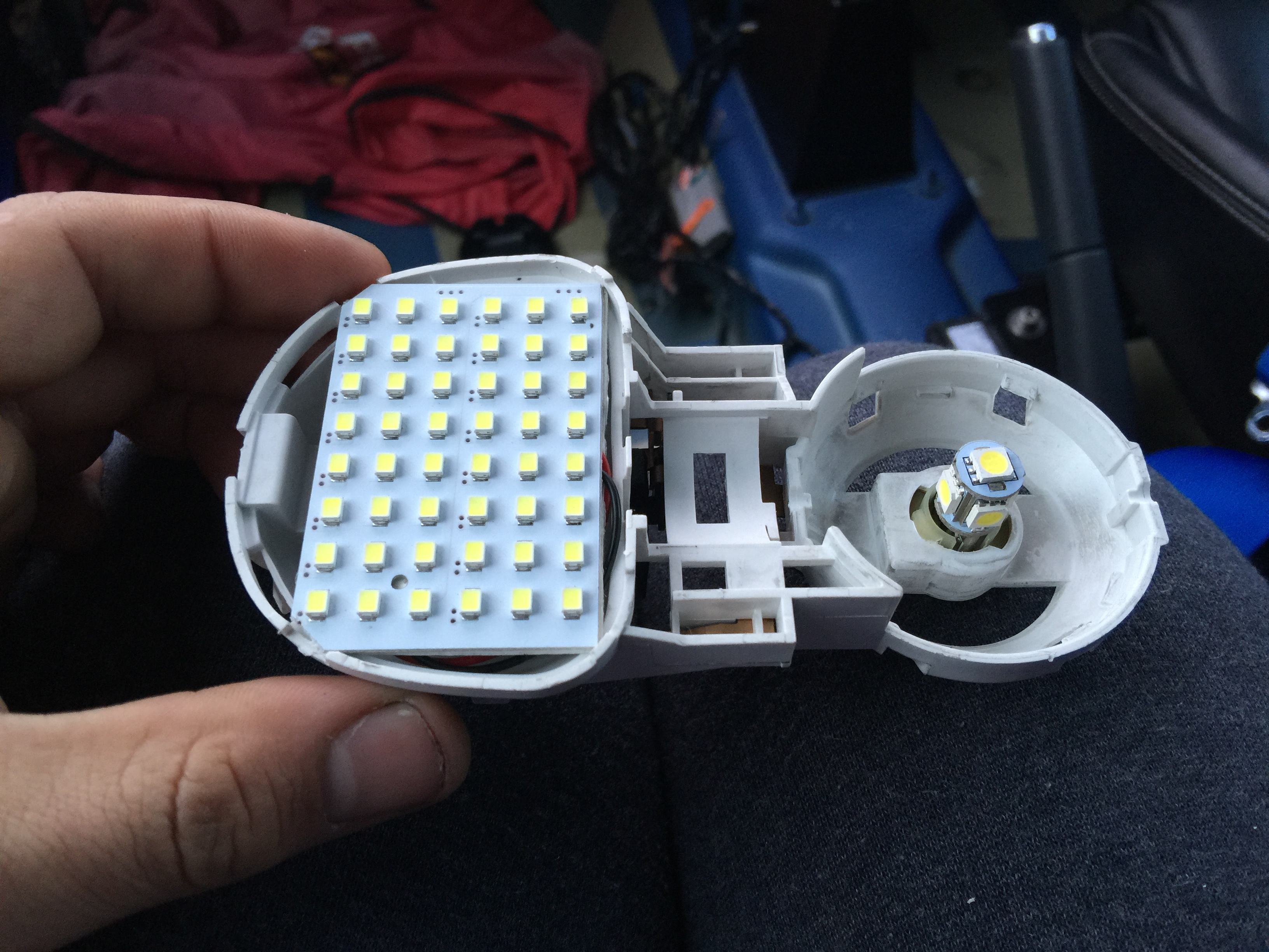

God bored one day so decided to refit my light back into my car as I missed it after pulling it all out so went a bit mental and took out my 4 SMD slight and fitted a 42 board instead haha! It works haha! Love the way when I unlock my car it illuminates my sexy white cage!!!

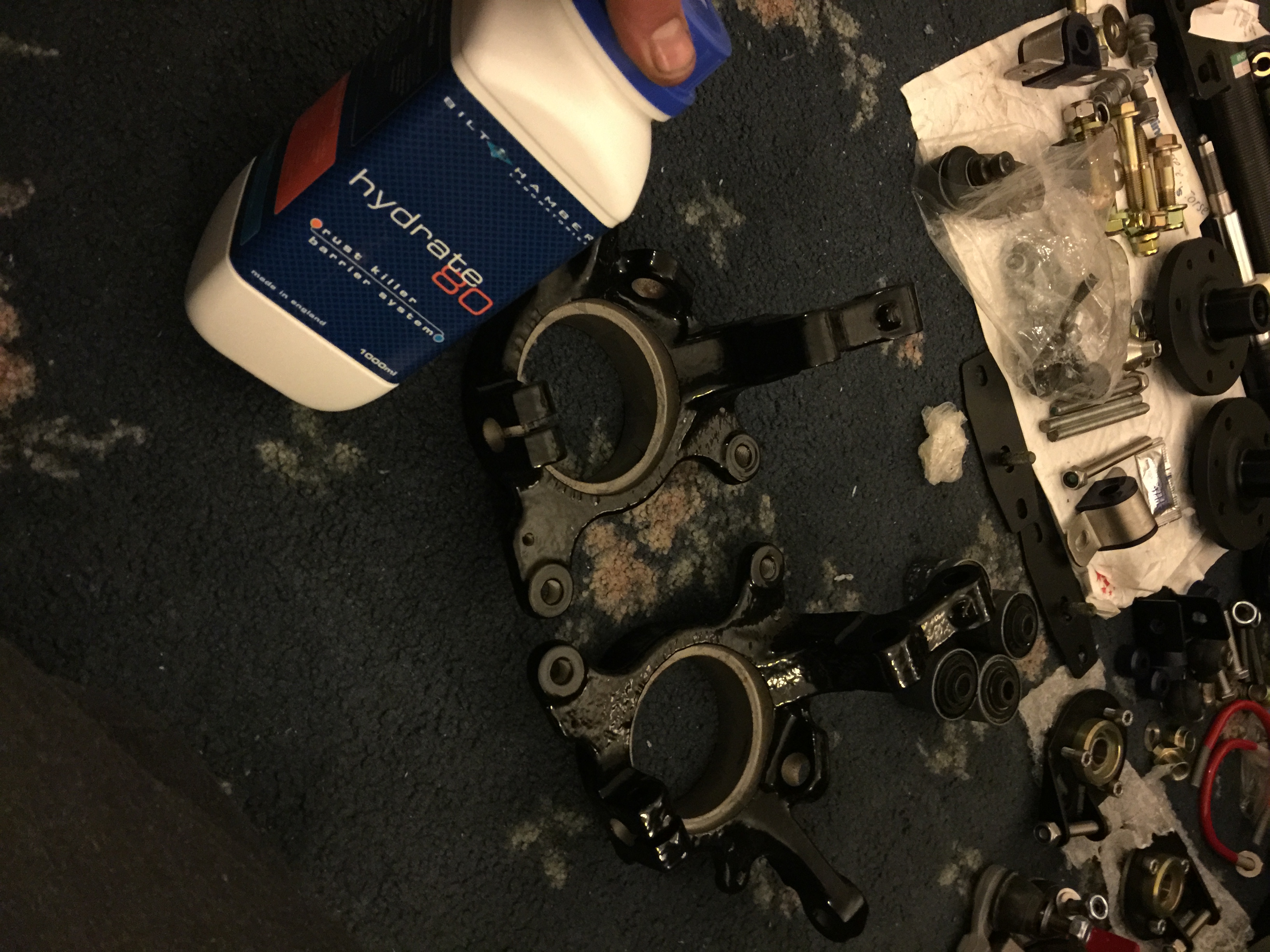

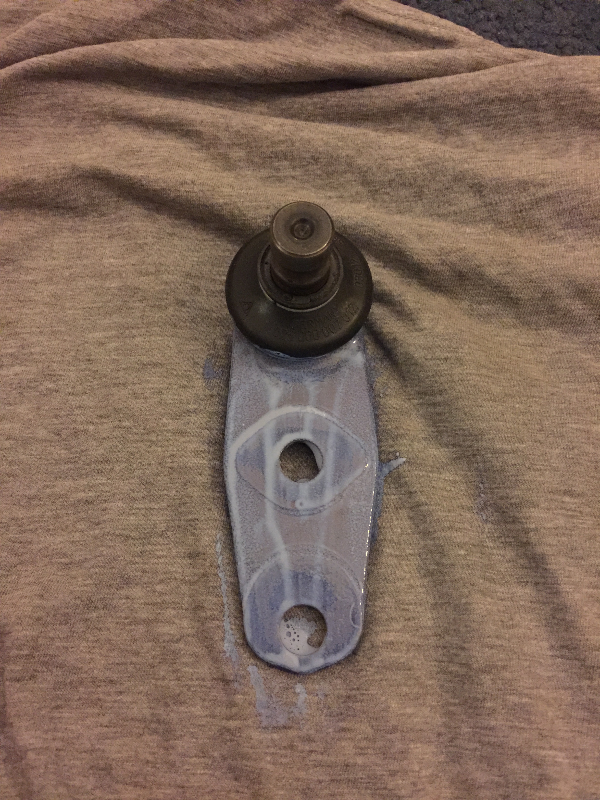

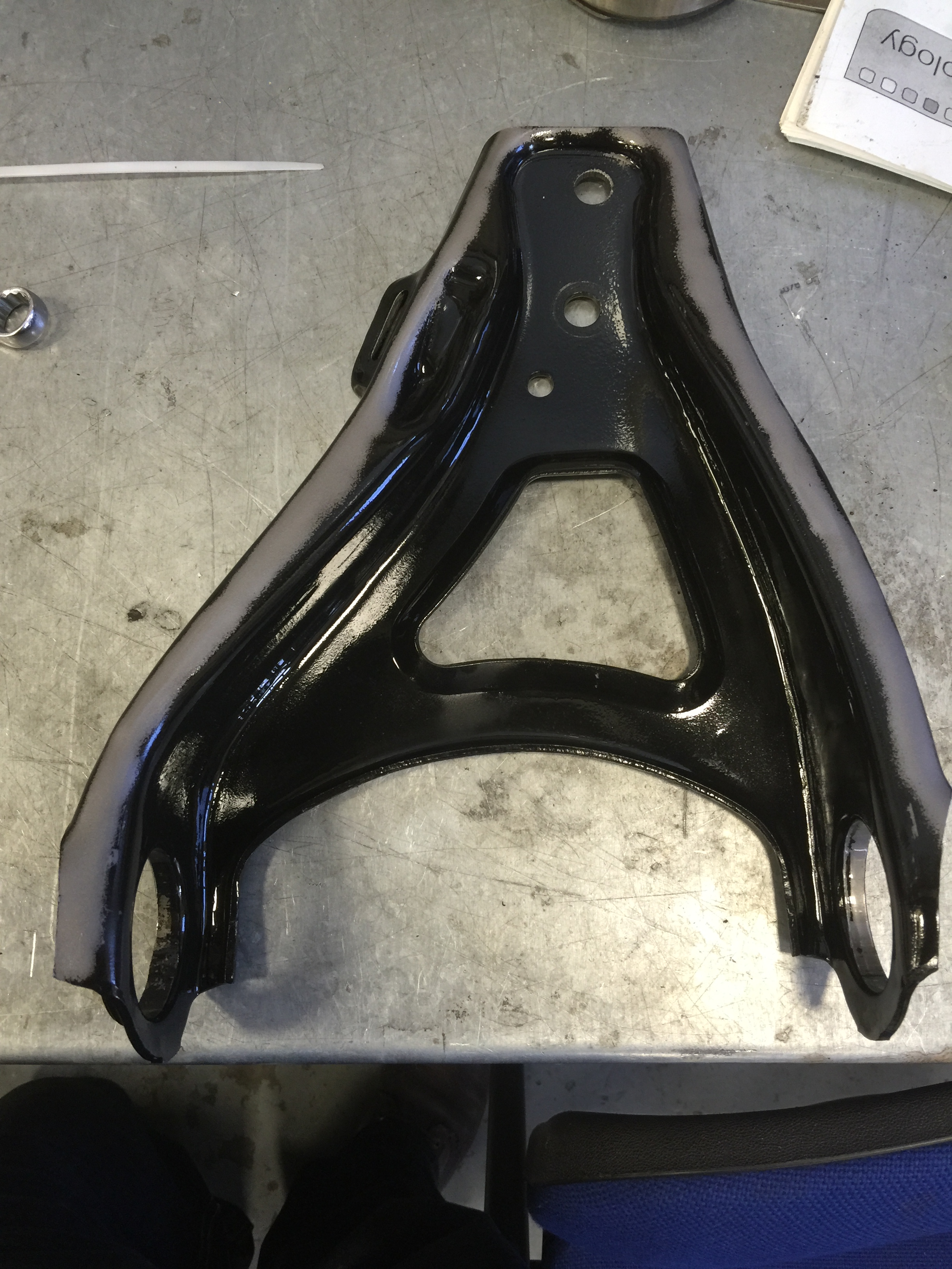

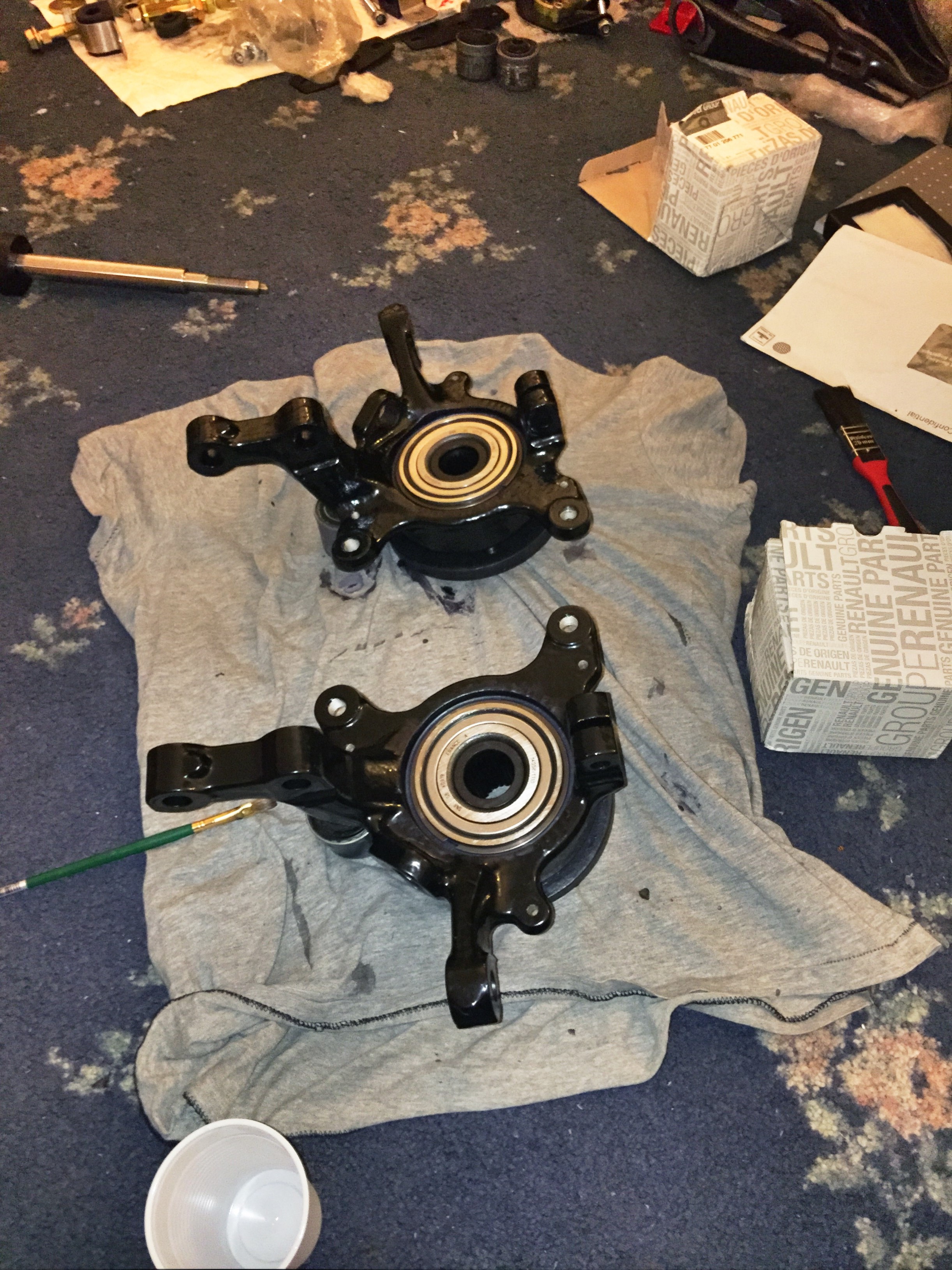

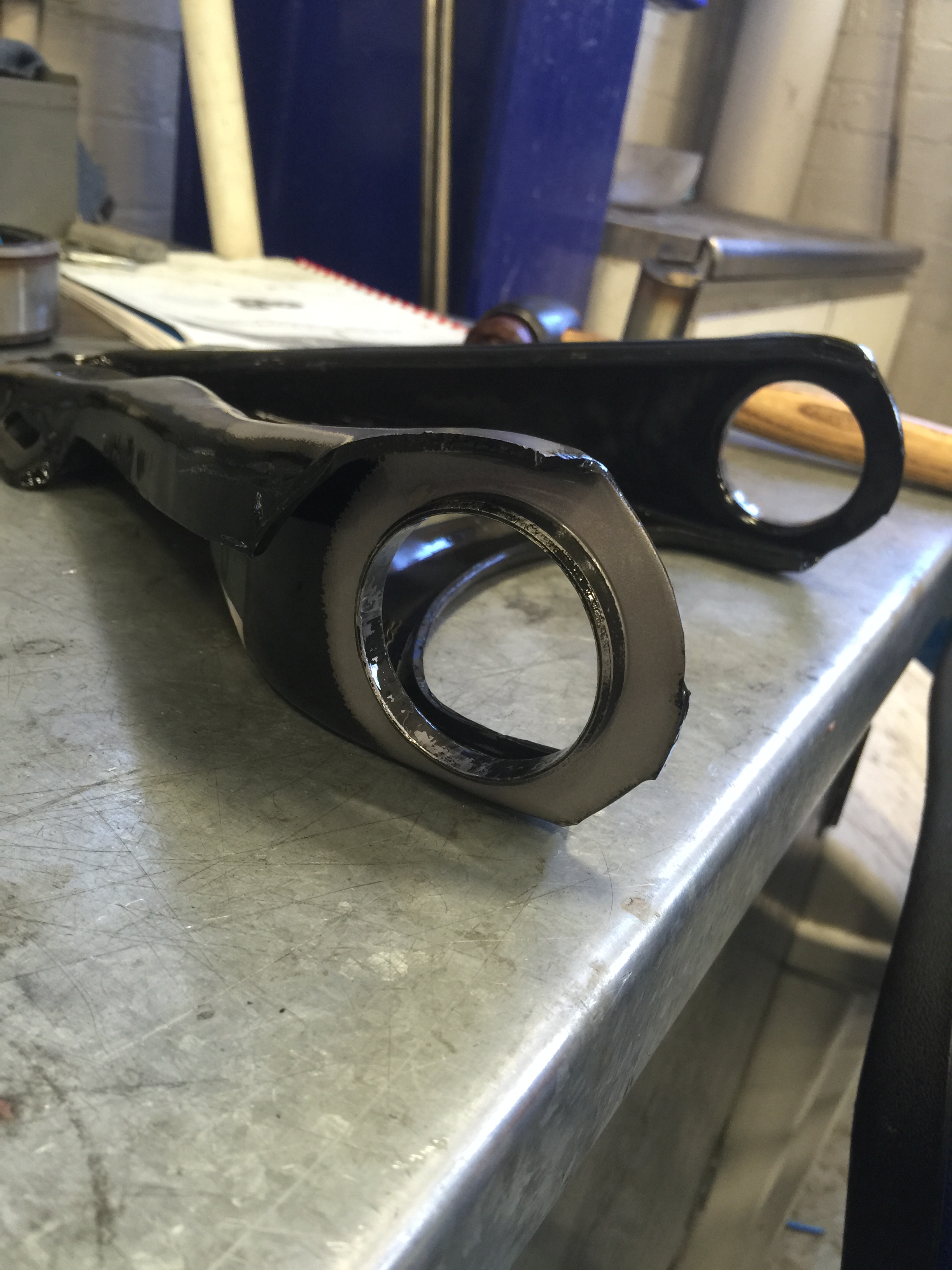

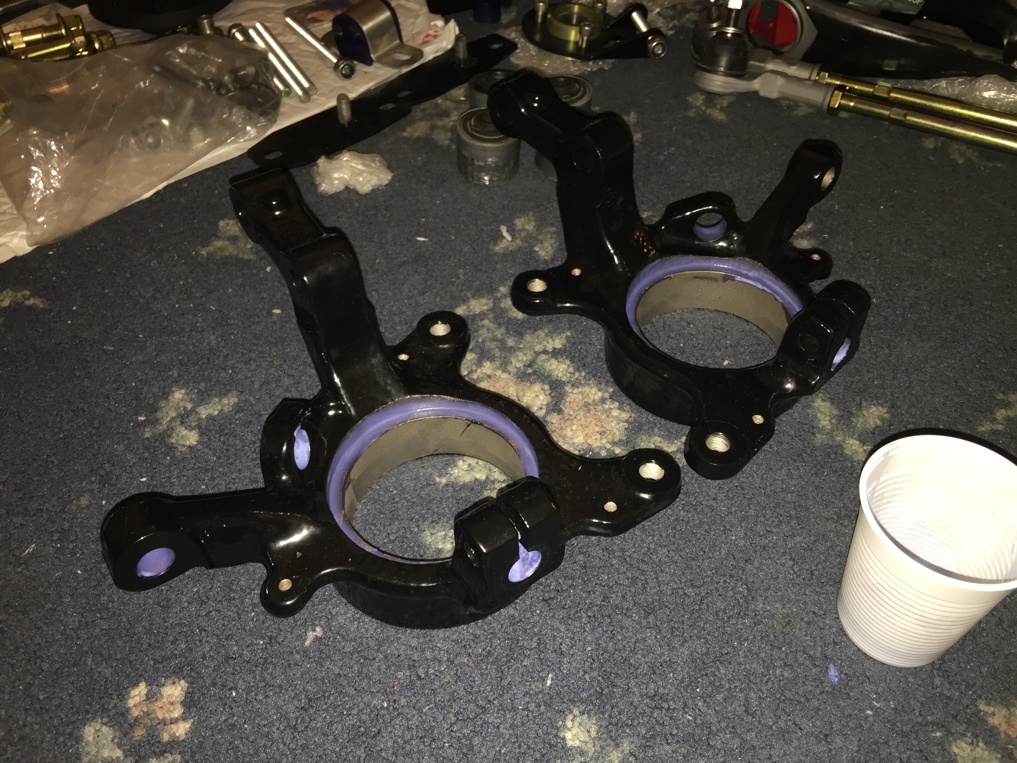

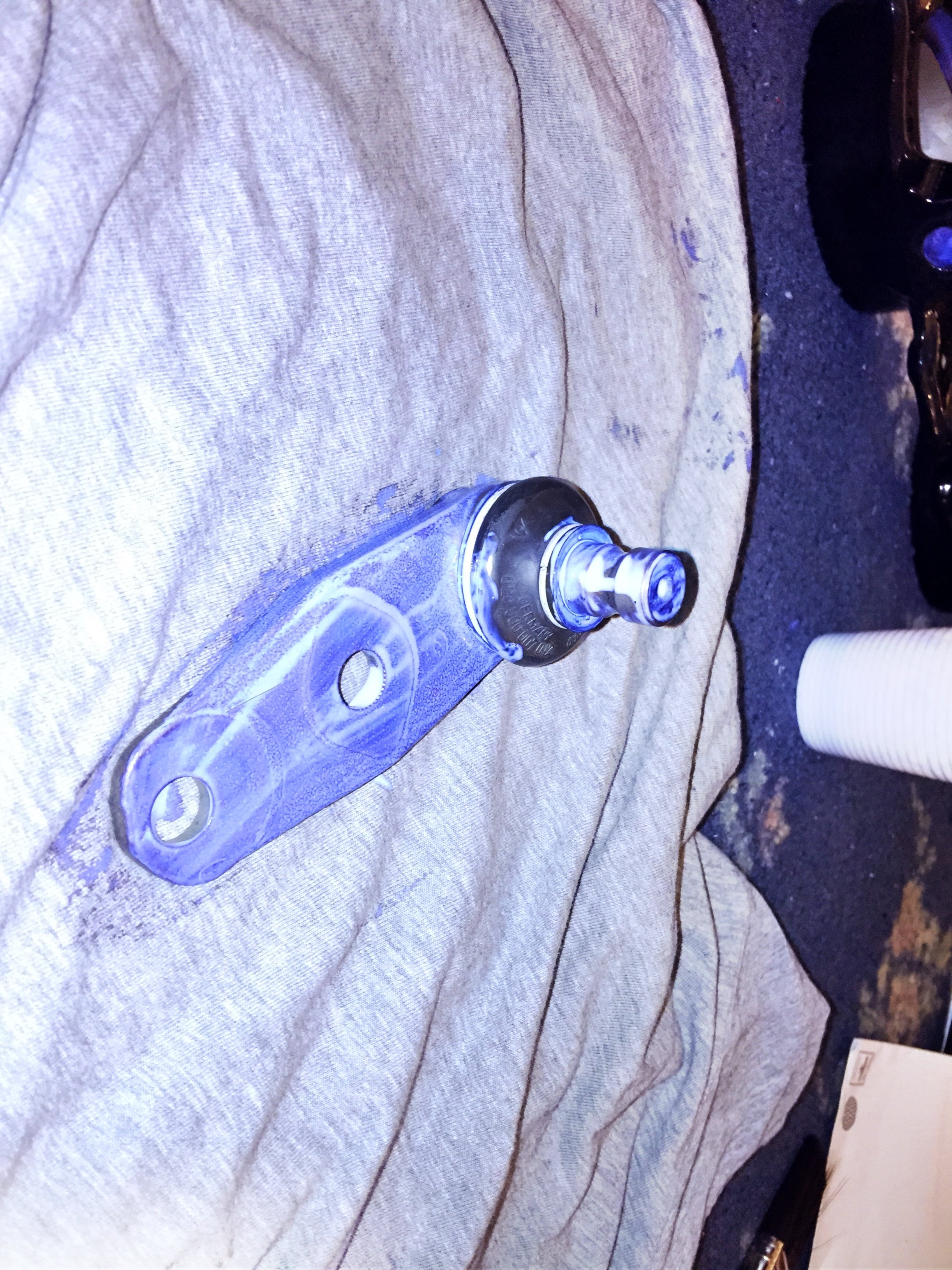

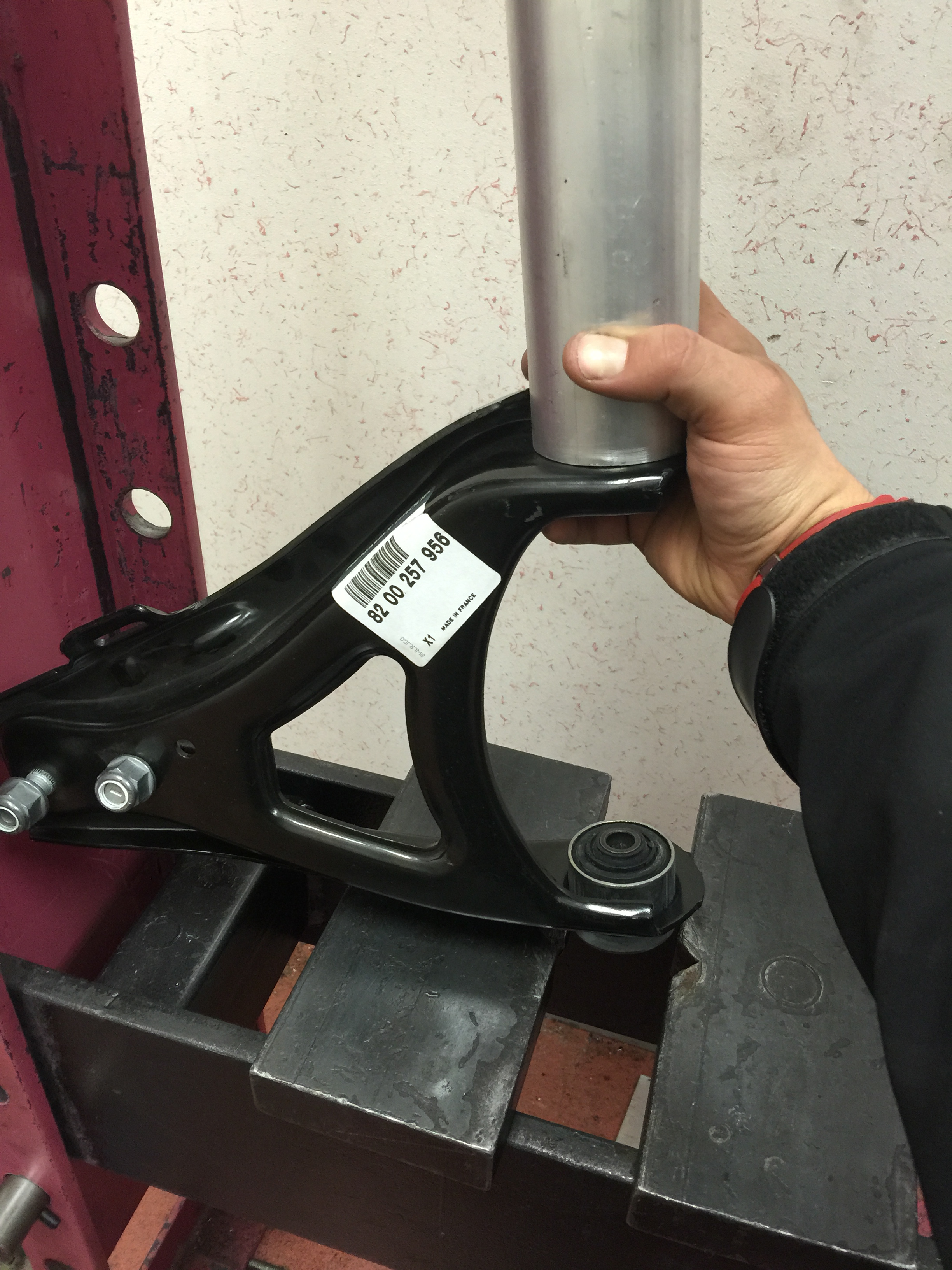

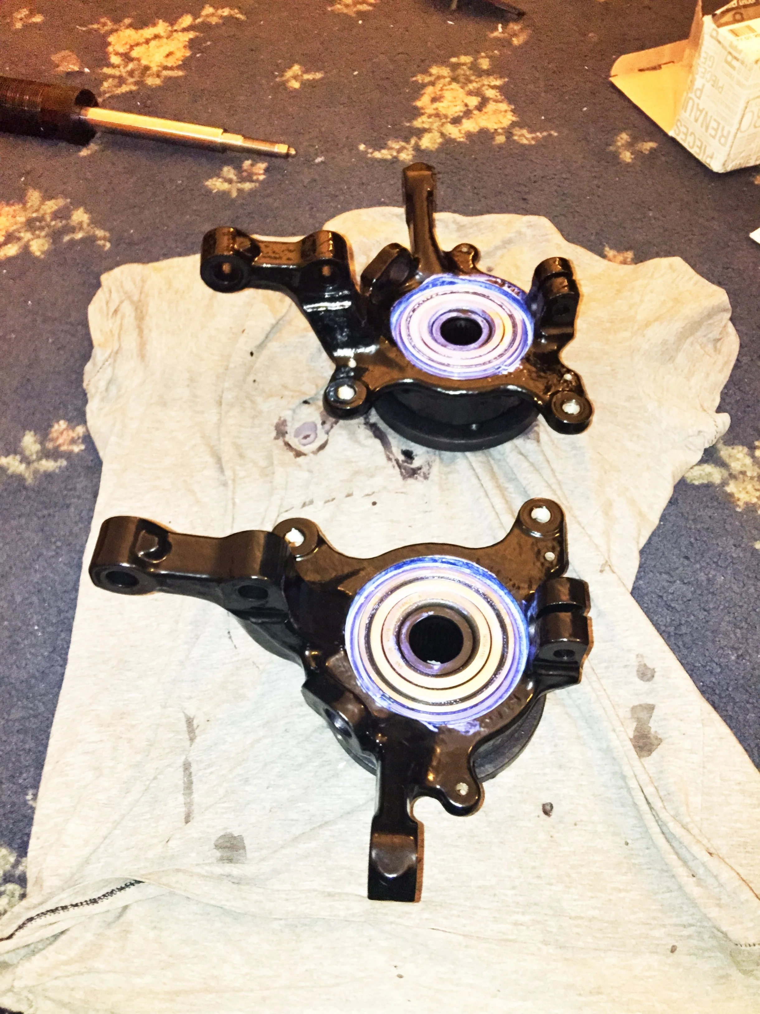

Bit of Bilt Hmaber on the exposed and deliberately un powder coated circlip area to prevent rust before the bearing is fitted.

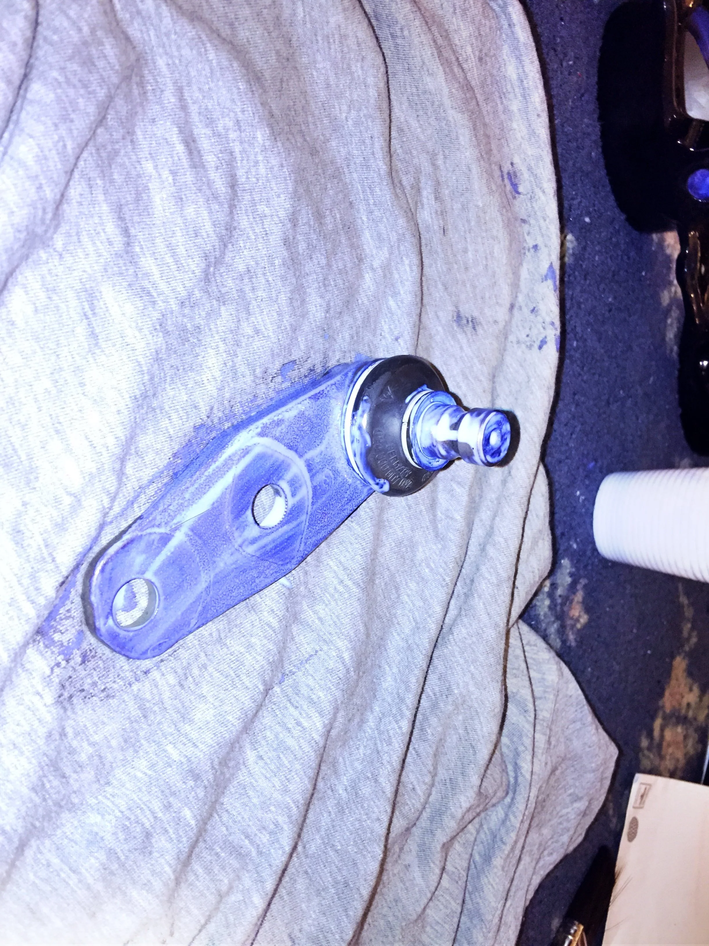

Bottom ball joint treated too
Goes on blue dries black. Awesome Stuff. Love it!
All built back together!! The results speak for themselves but wowwwwwww!!!!

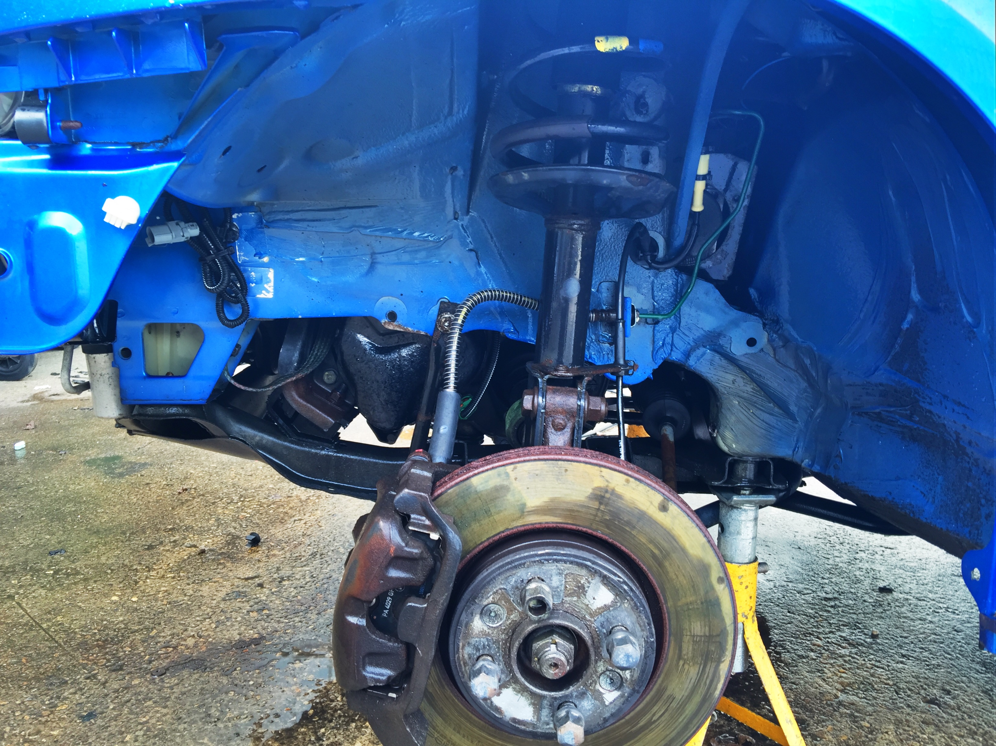

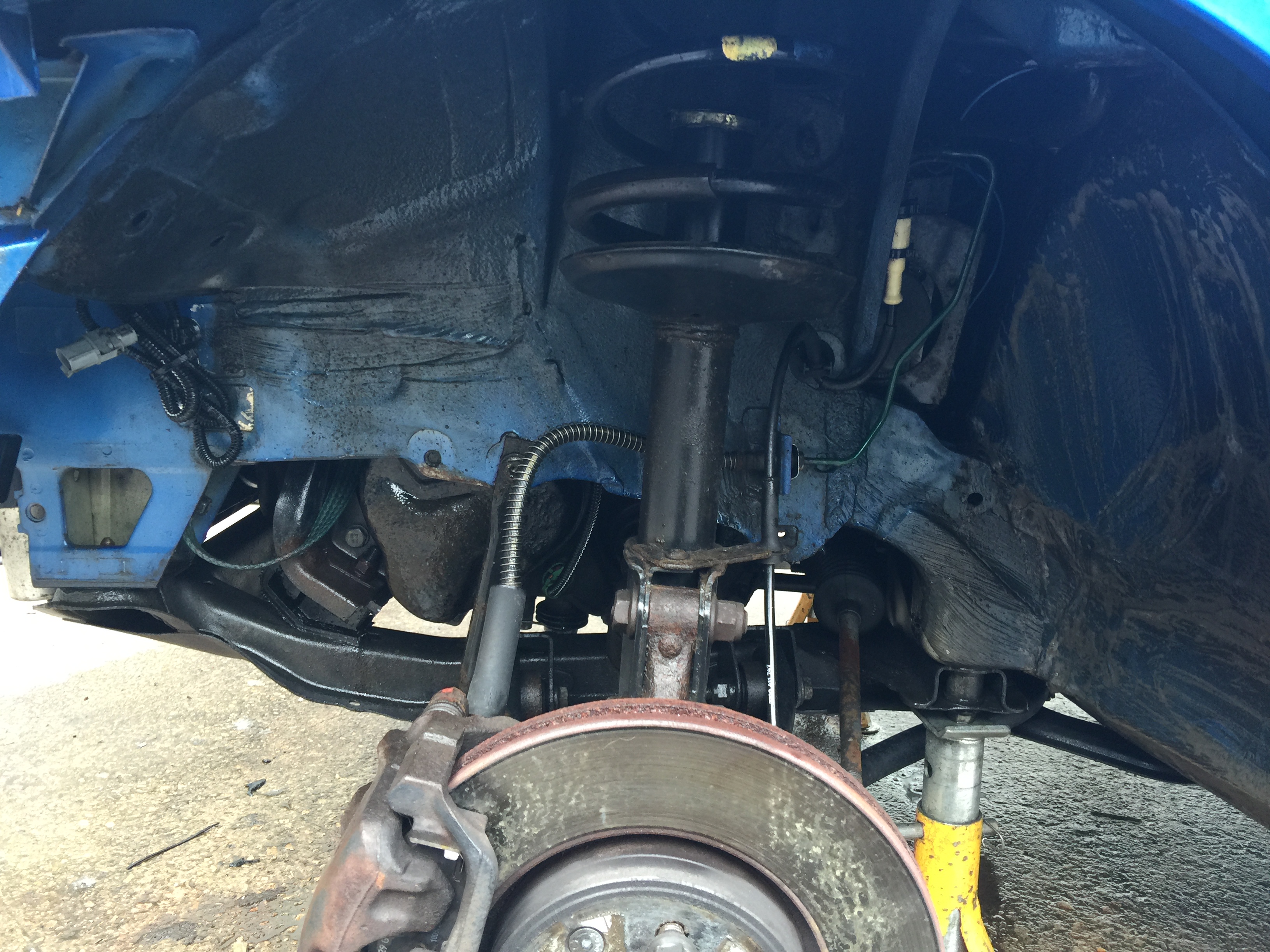

Arch after a clean and de-grease the before shot was the dirty one above. The difference is quite dramatic. The plan is to get it all as clean de rusted as possible ready for the new components to go on.

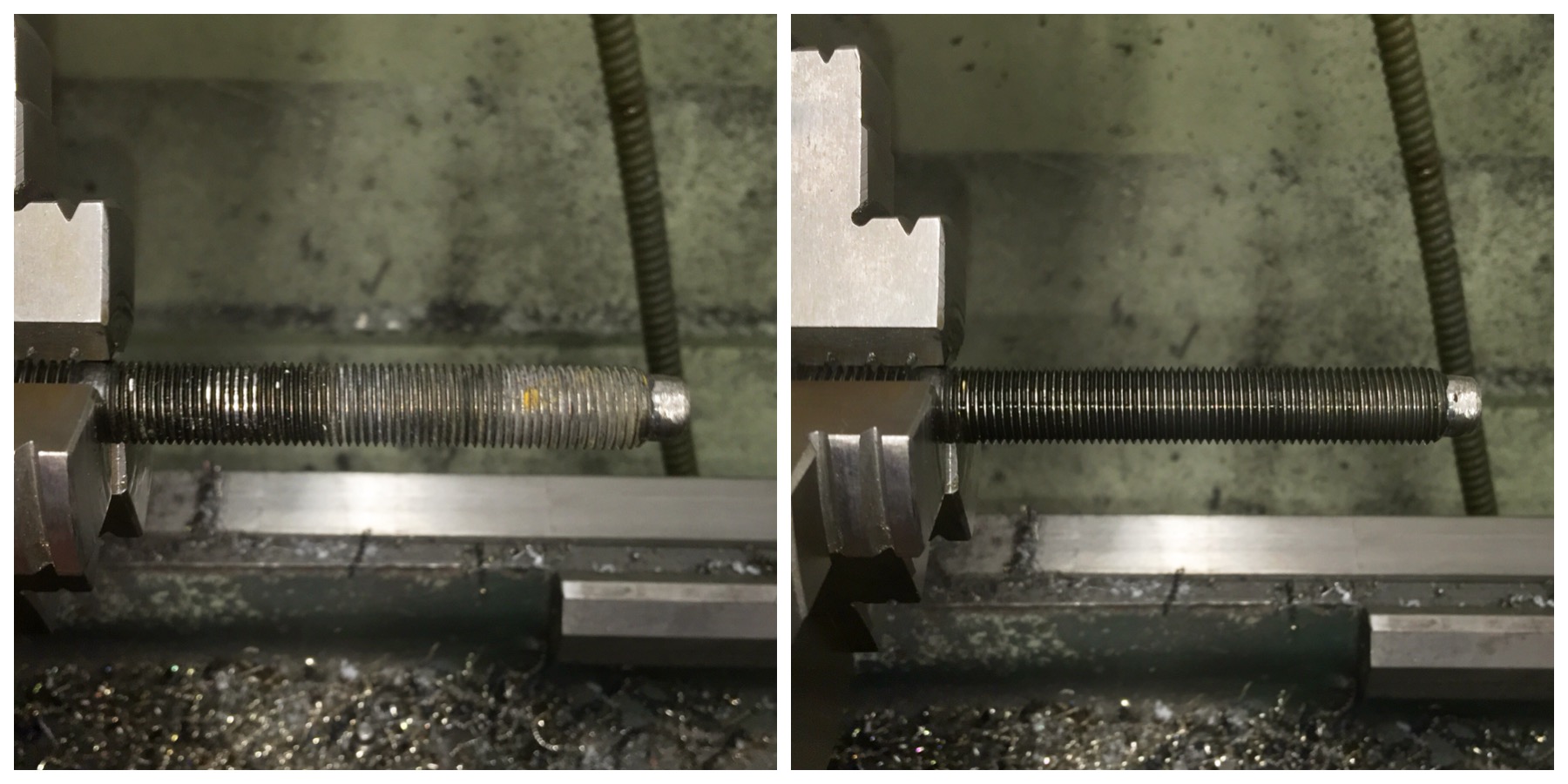

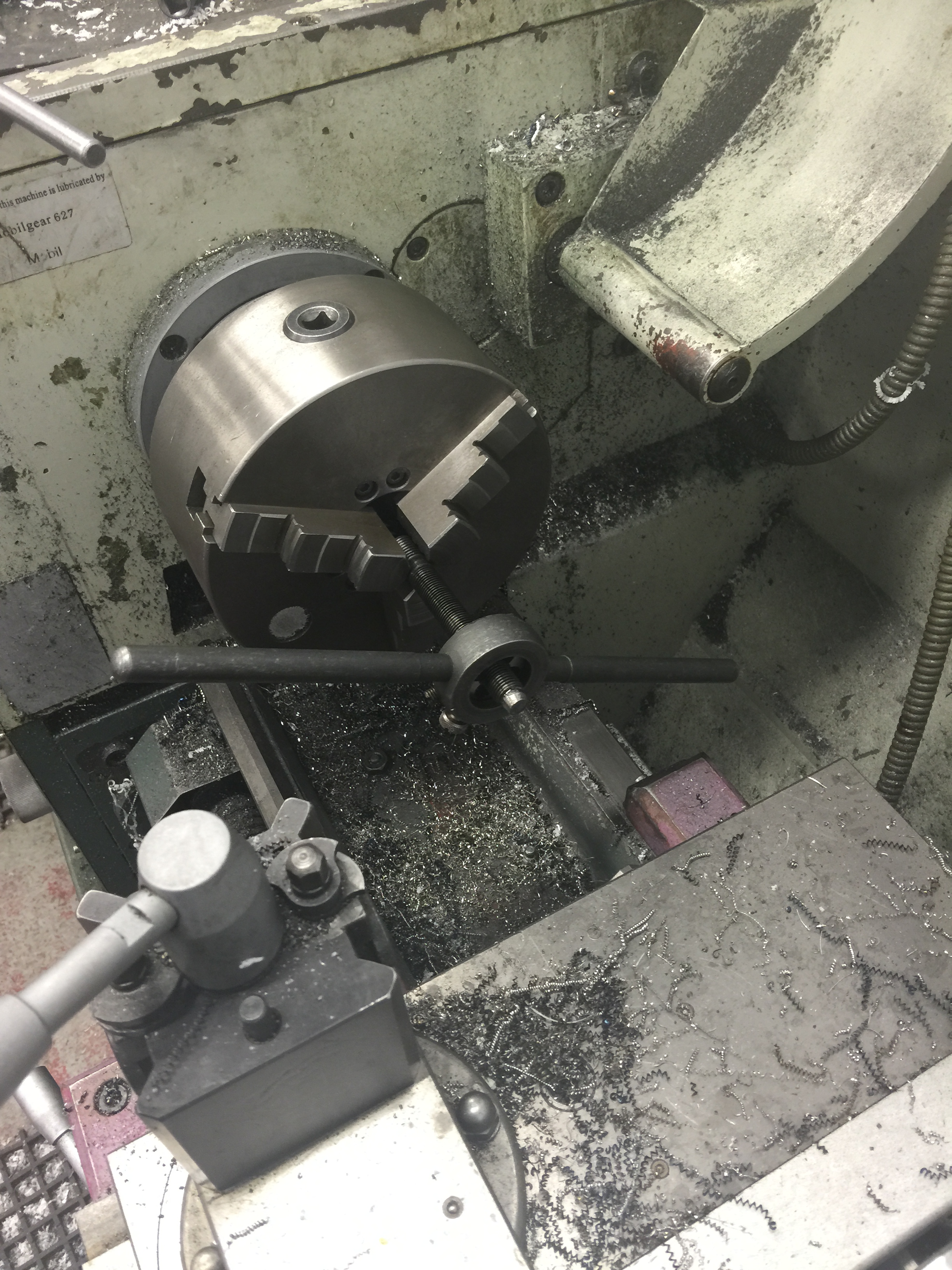

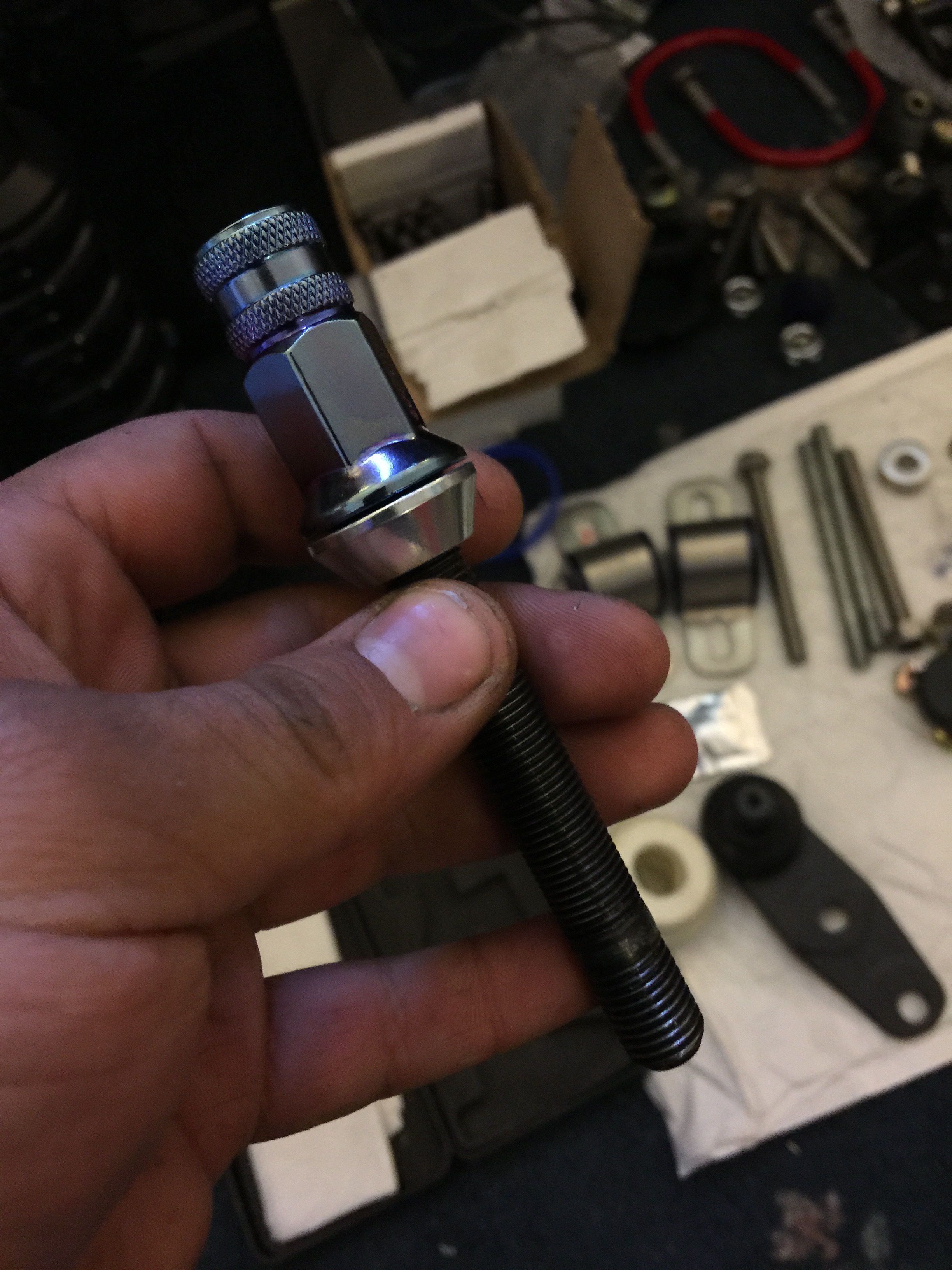

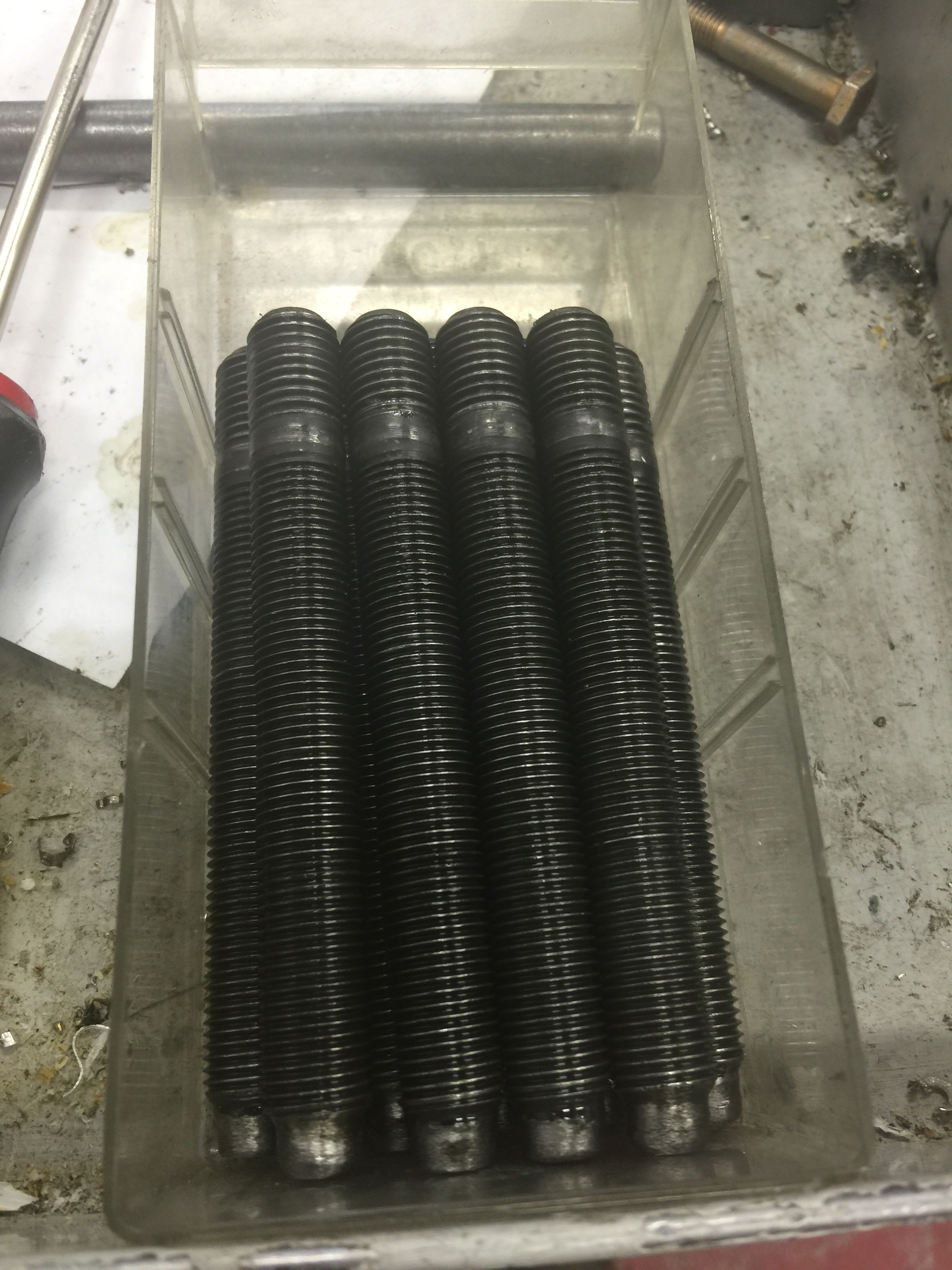

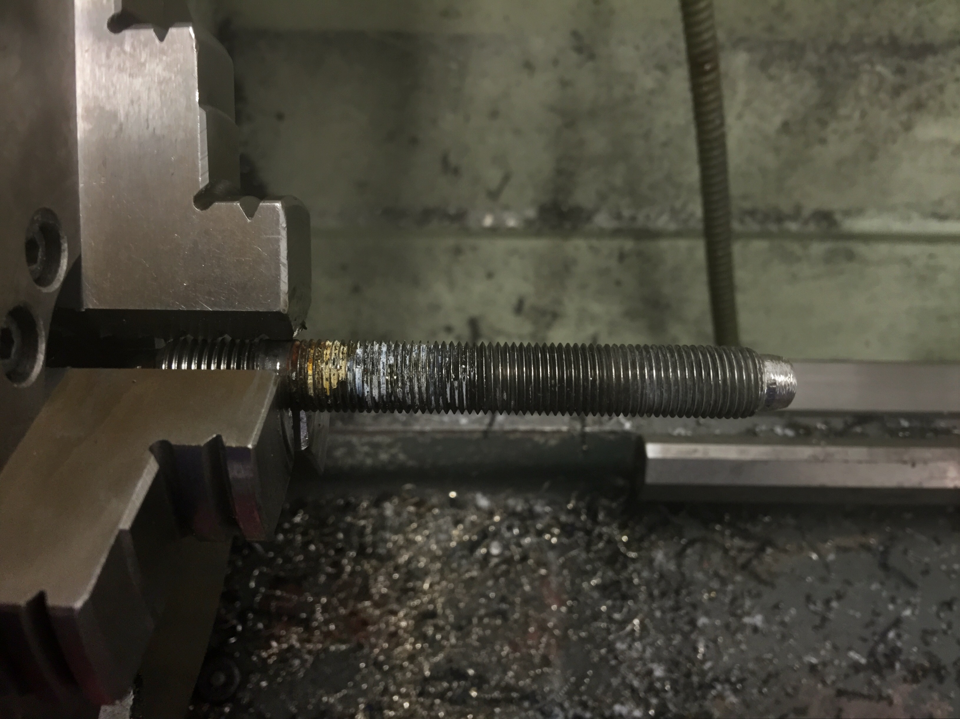

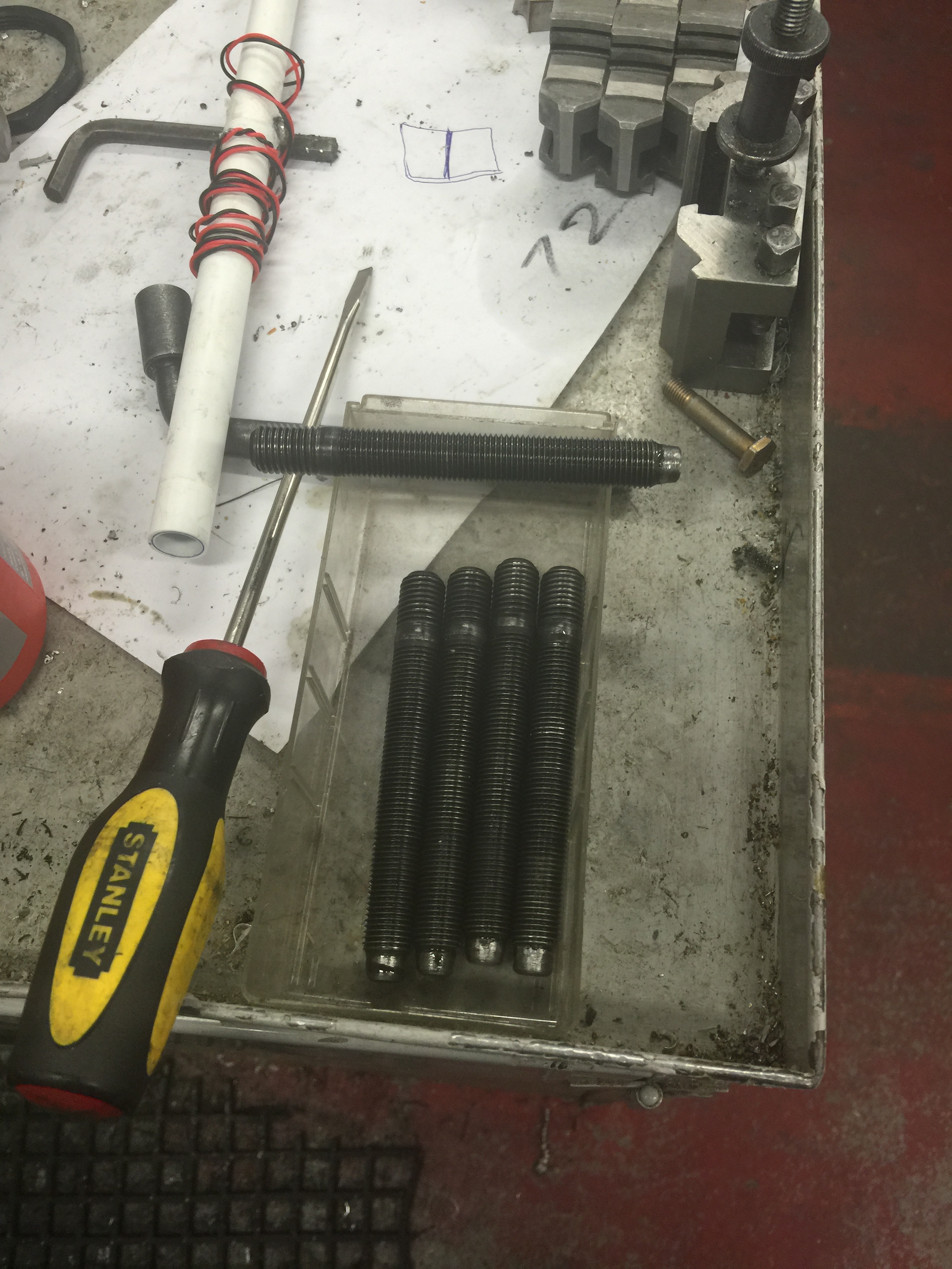

Some apparent low mileage wheel studs which were pretty shocking to be fair so re chased them down with a die, will also have the re blackened.
One of the scabby ones the pikey before removed them with his teeth!
After
This was a particularly bad one also!!! Dont even know wtf is on this!!

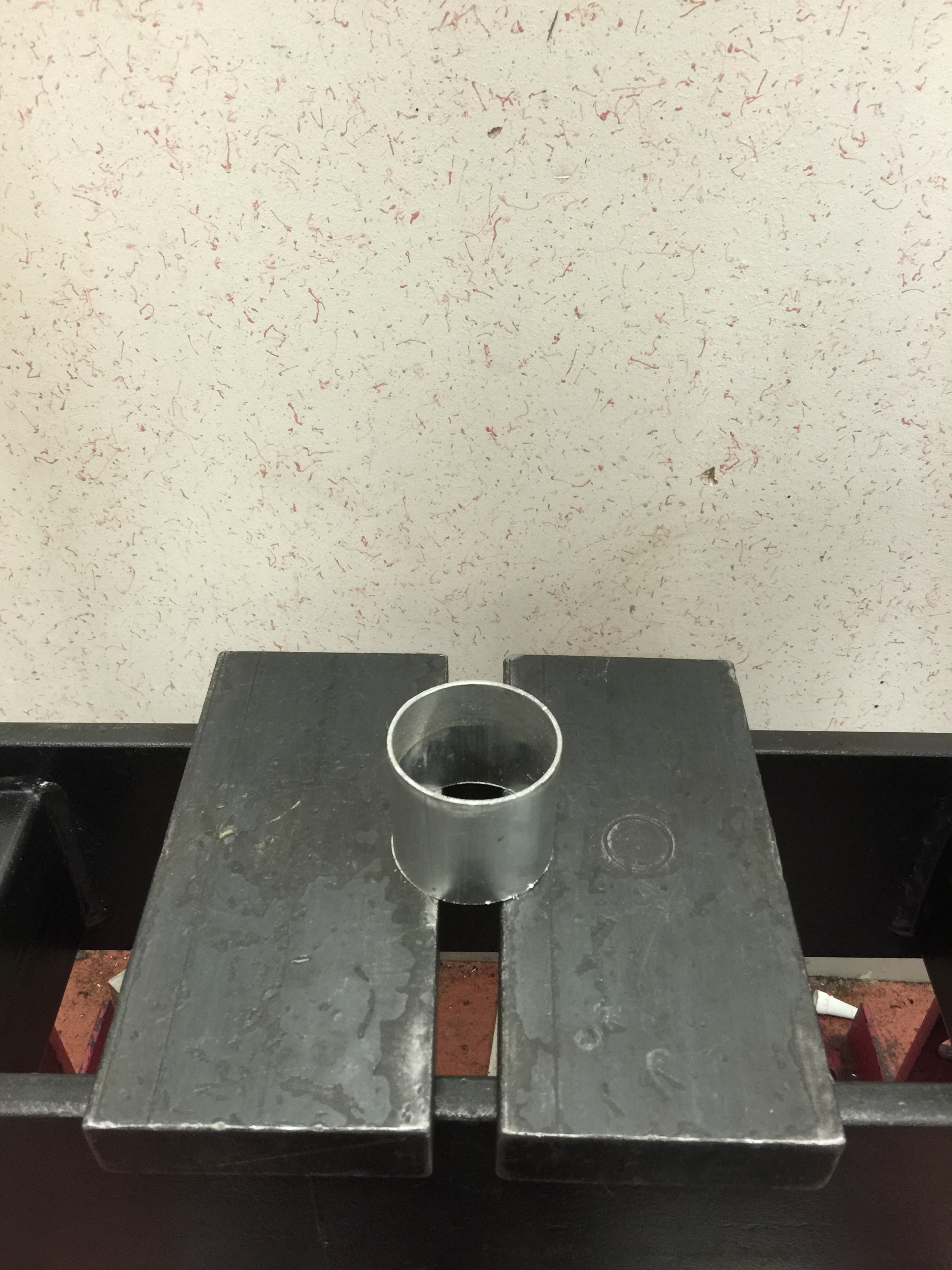

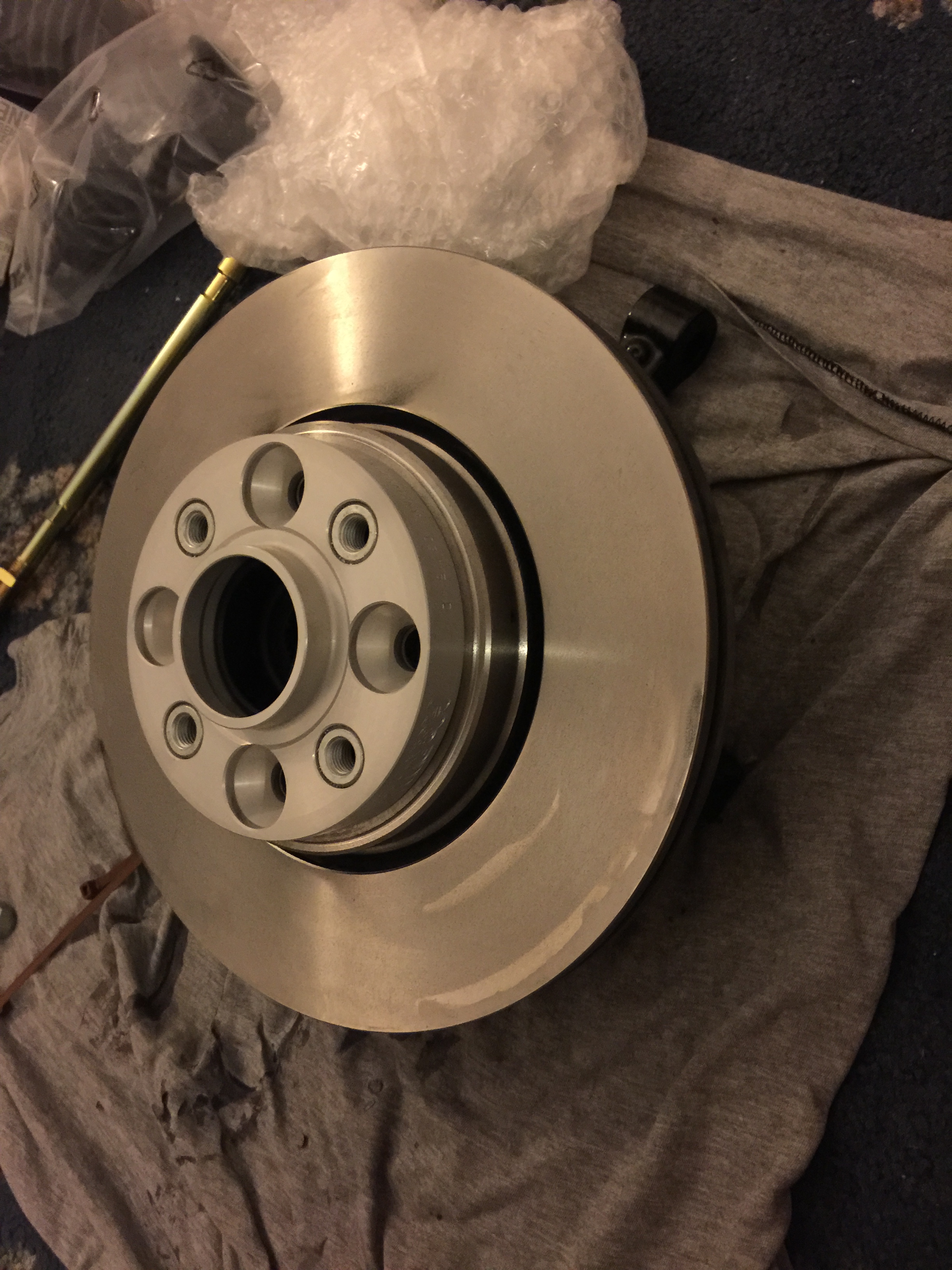

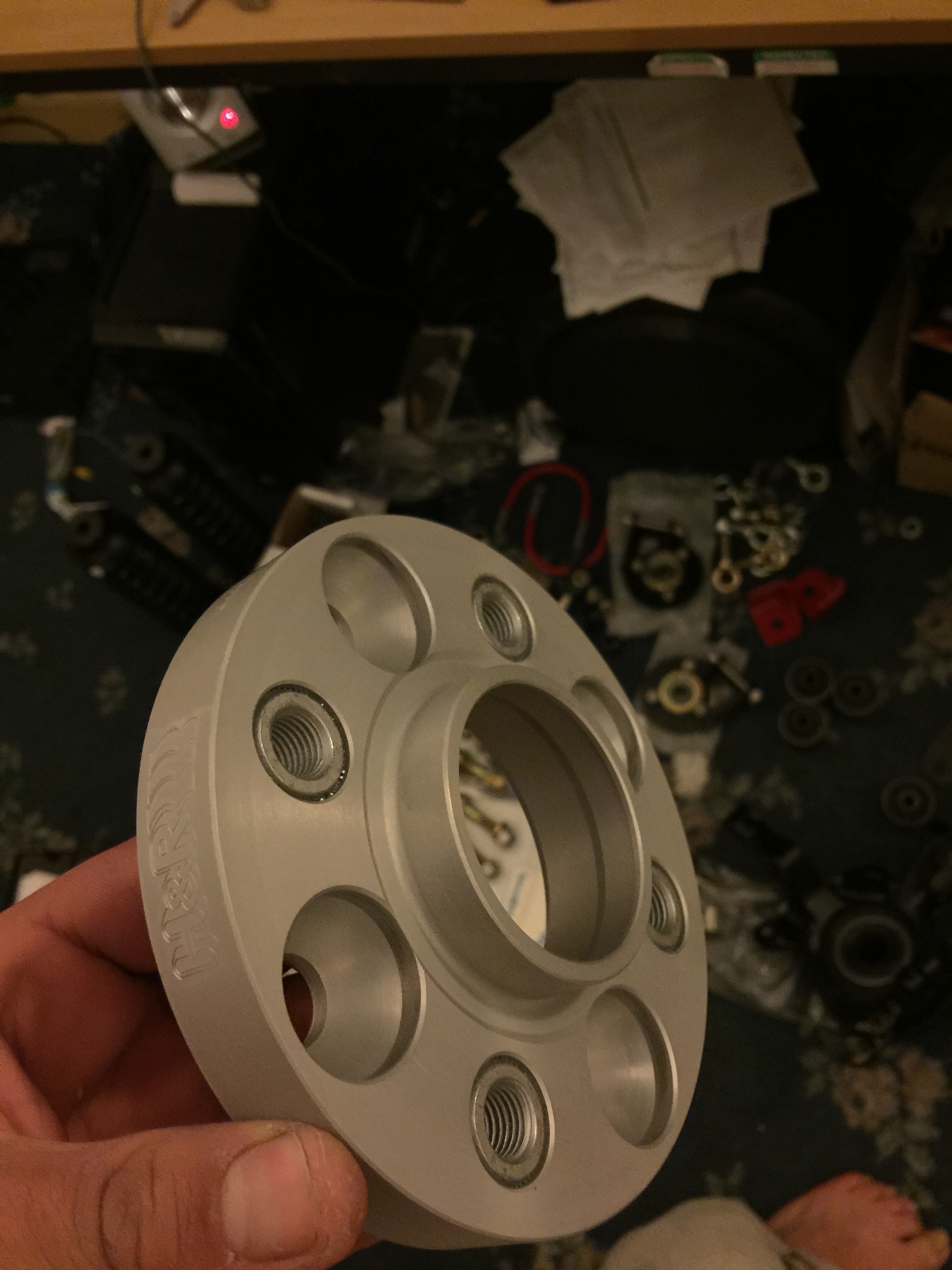

Magnesium Alloy 20mm spacers big boys!!! Youll see why soon!!!

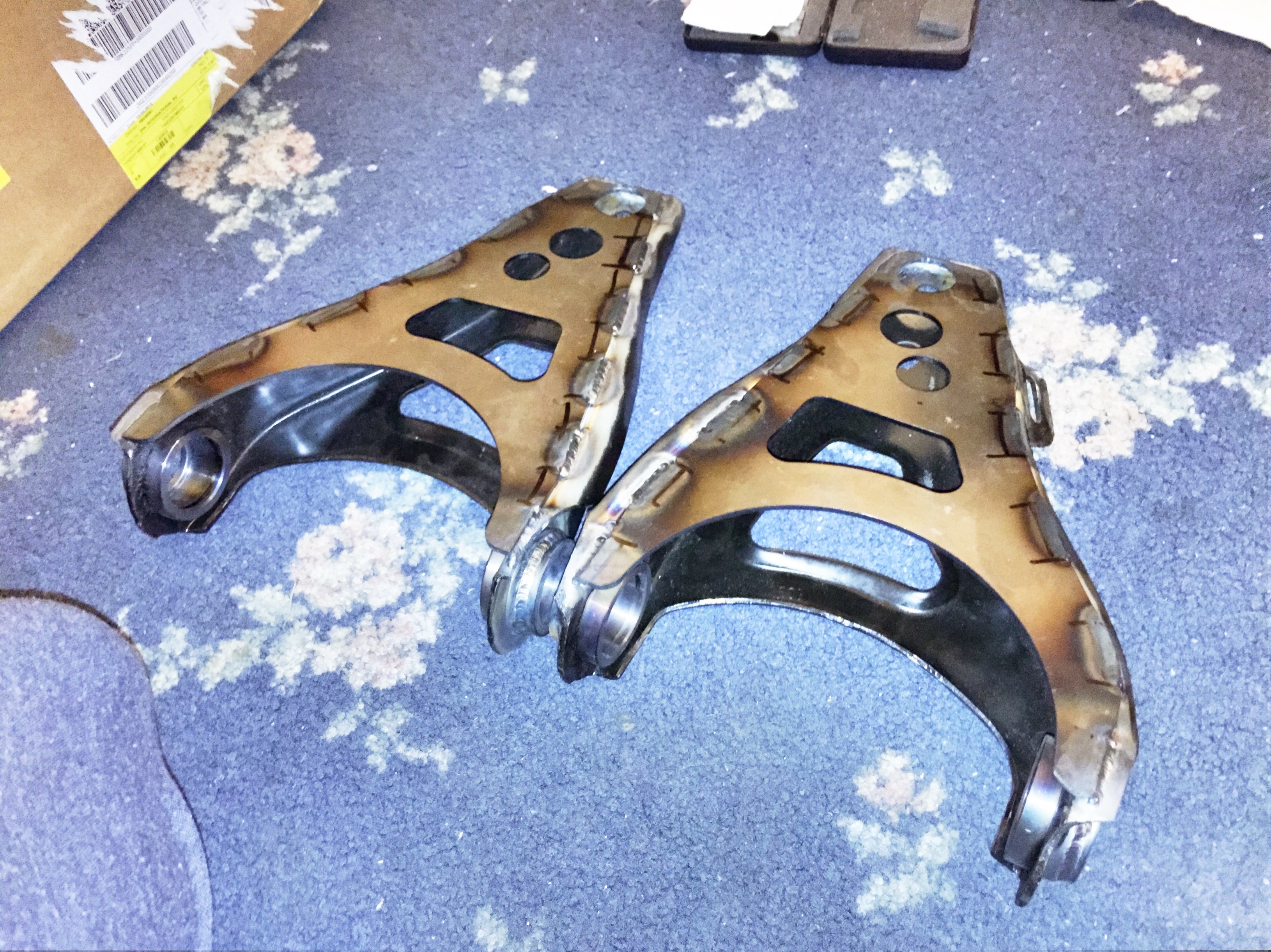

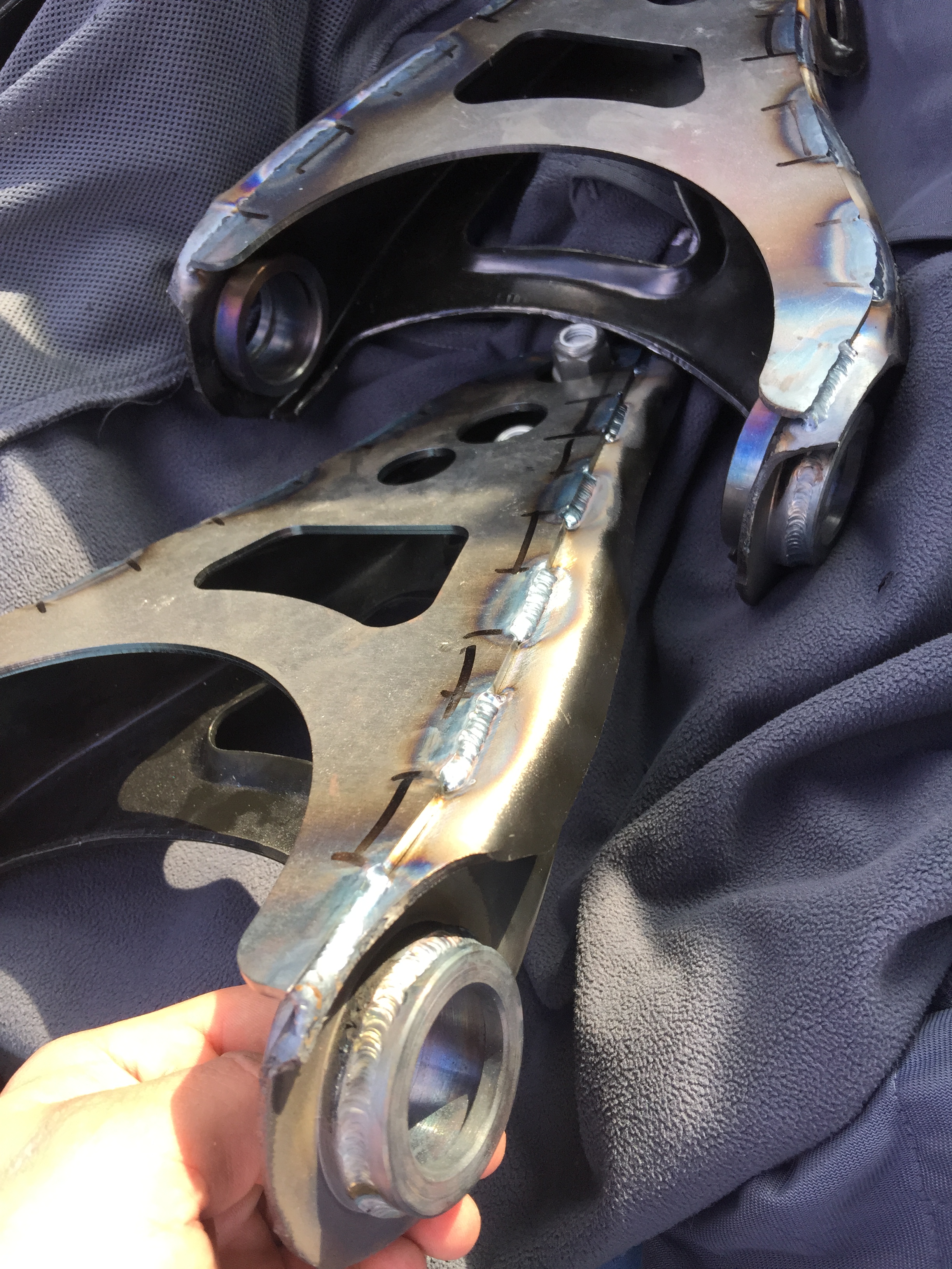

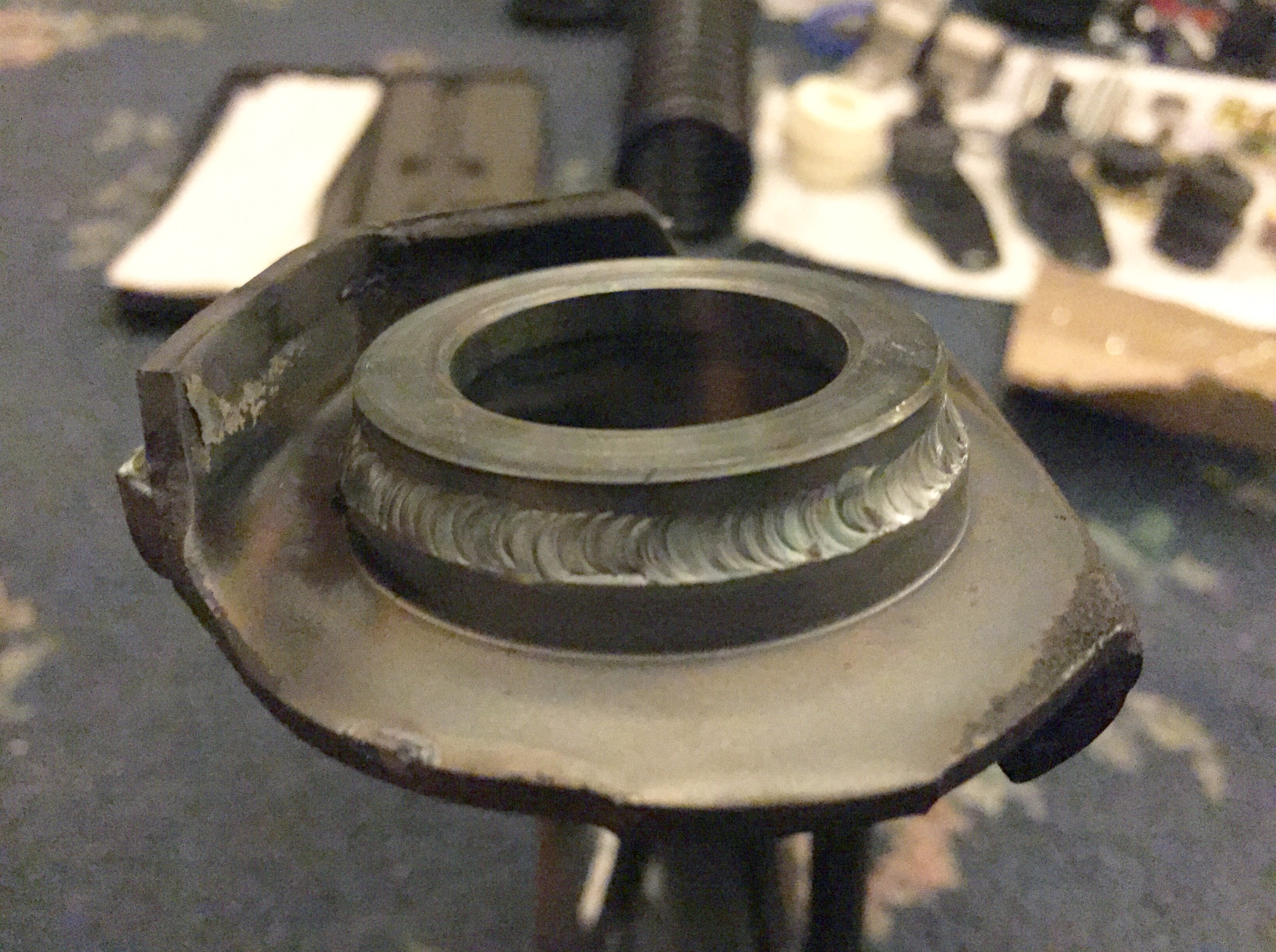

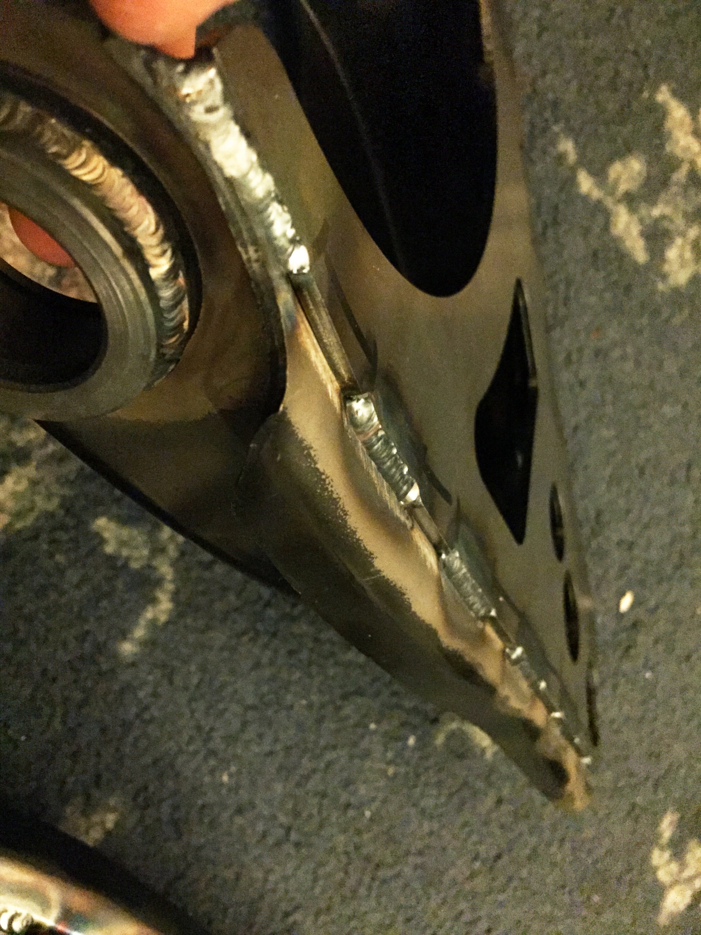

Wishbones back and all welded up!!! Some bloody superb TIG welding!!! Yummy!!!

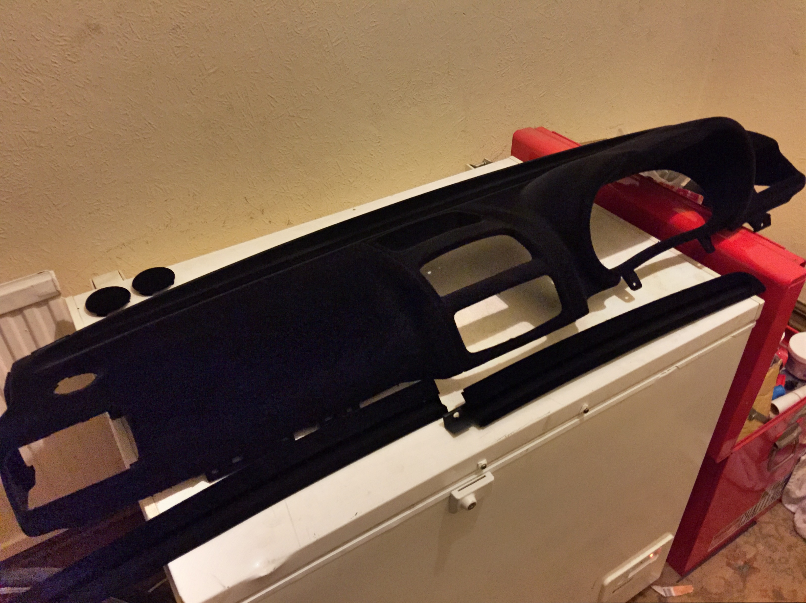

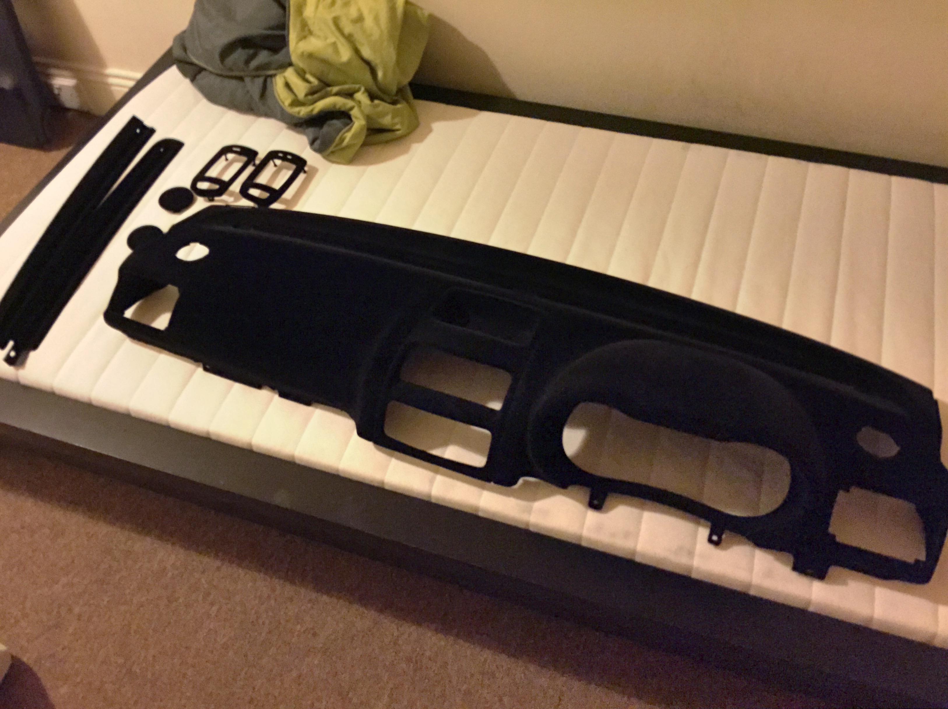

Some lovely interior goodness whilst the wishbones and several other items are being welded up!!

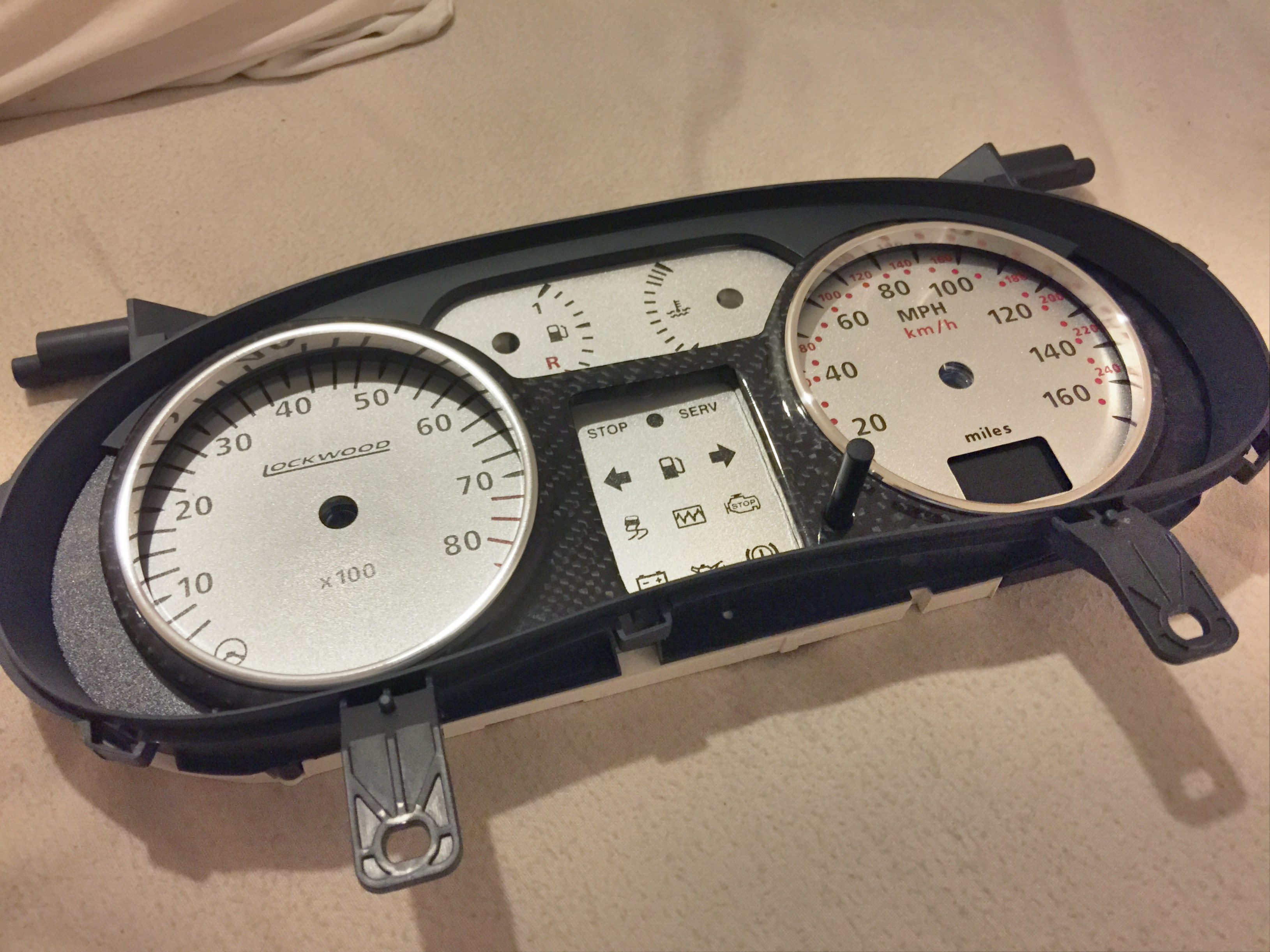

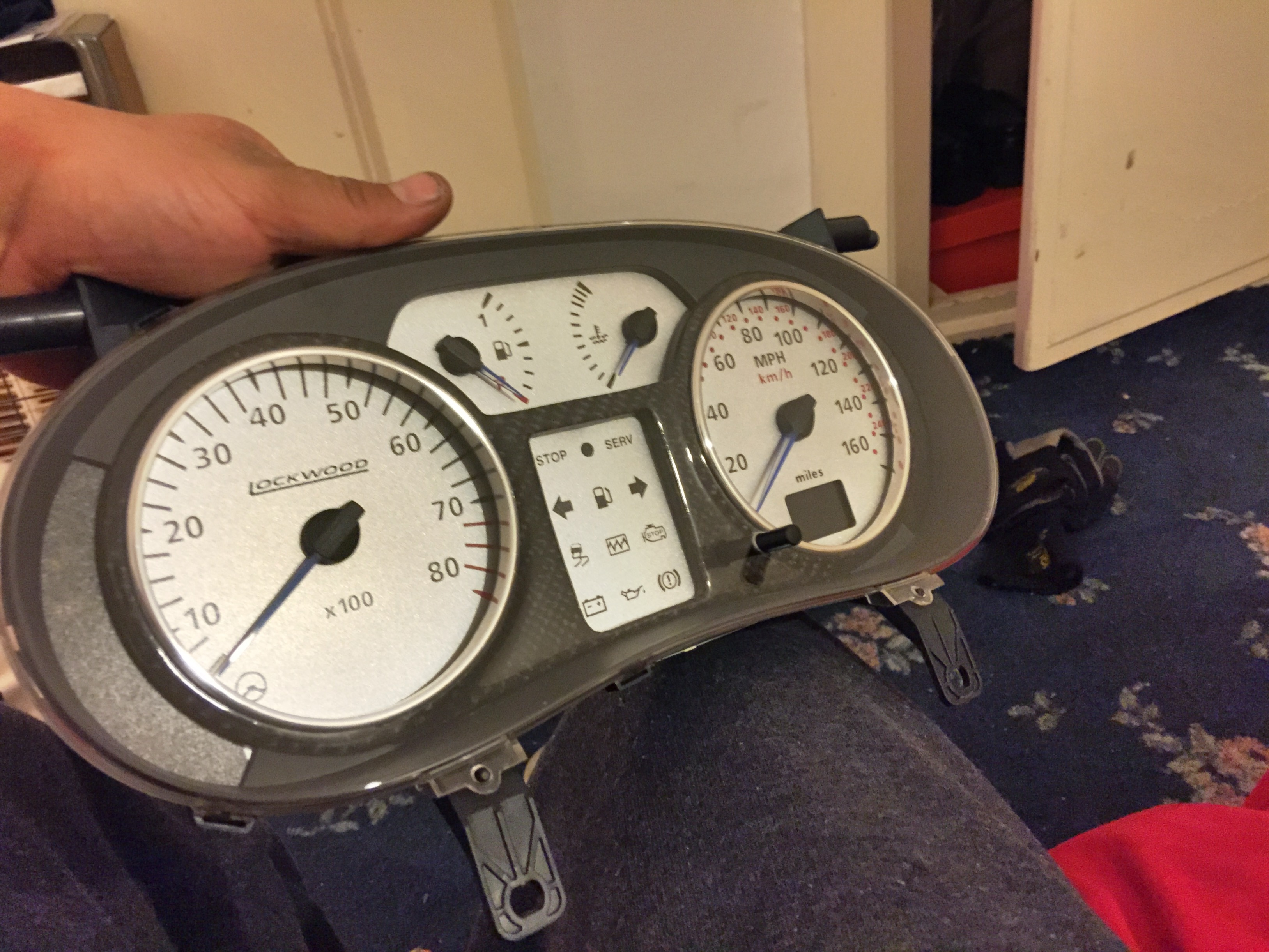

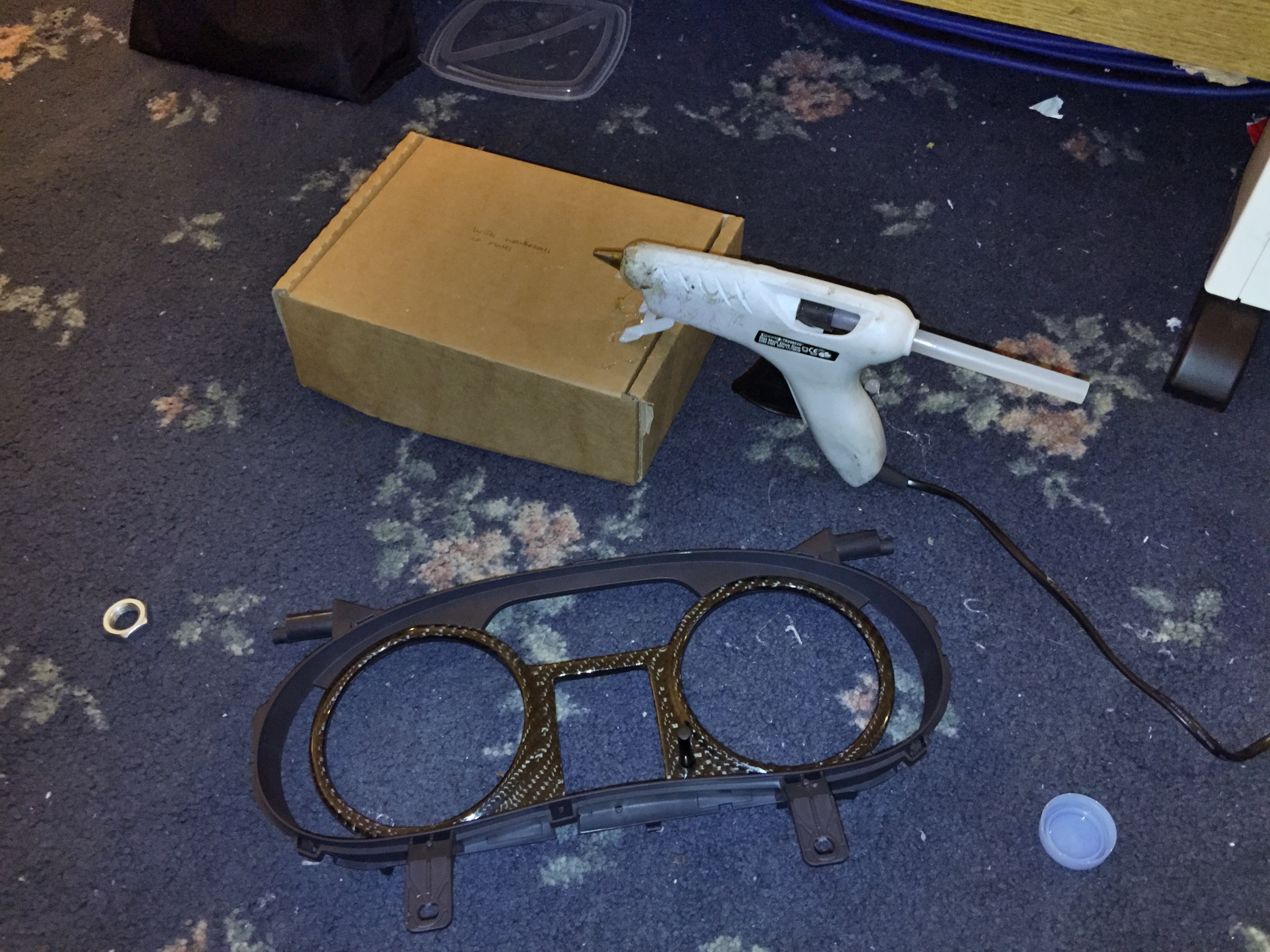

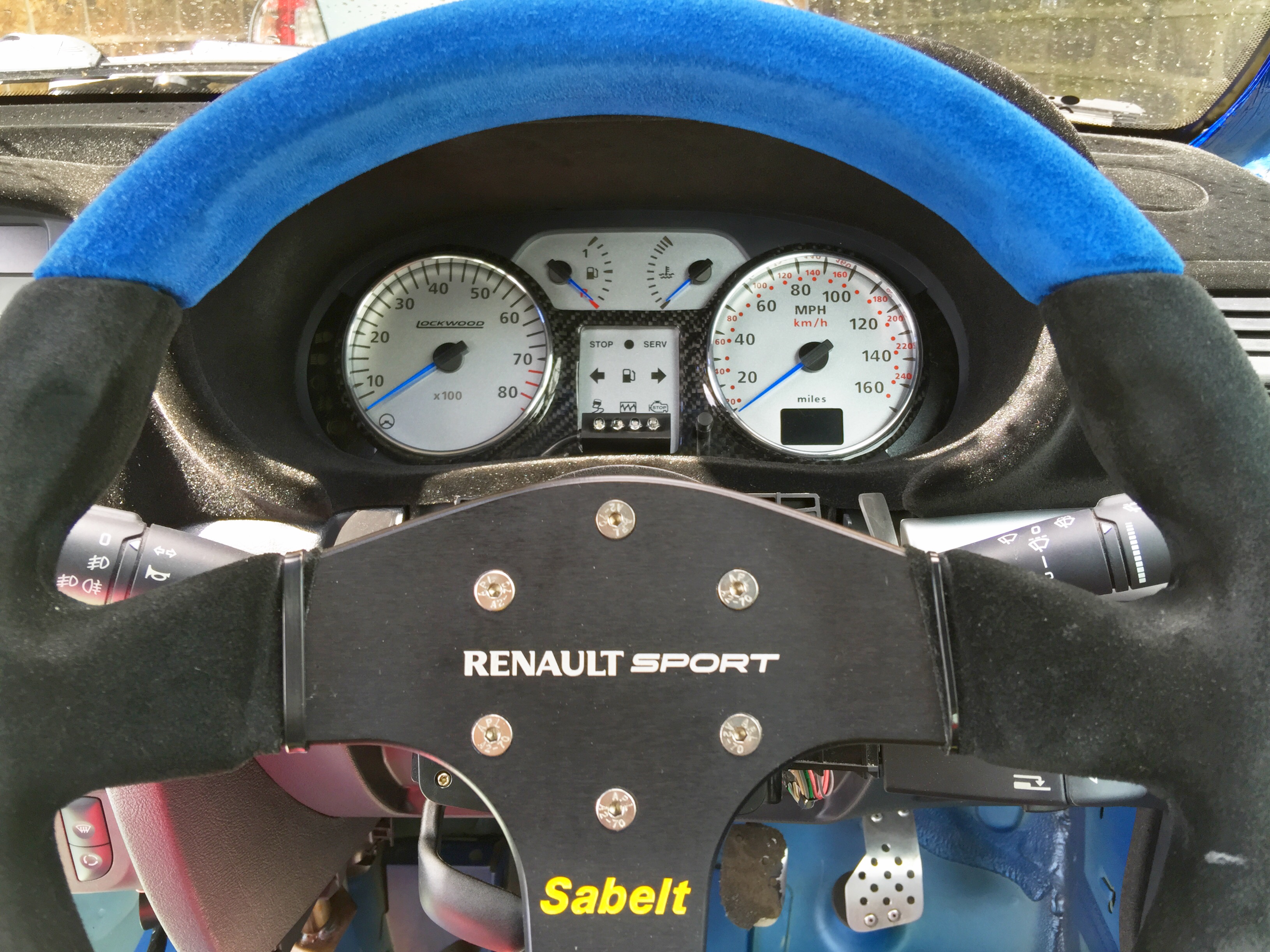

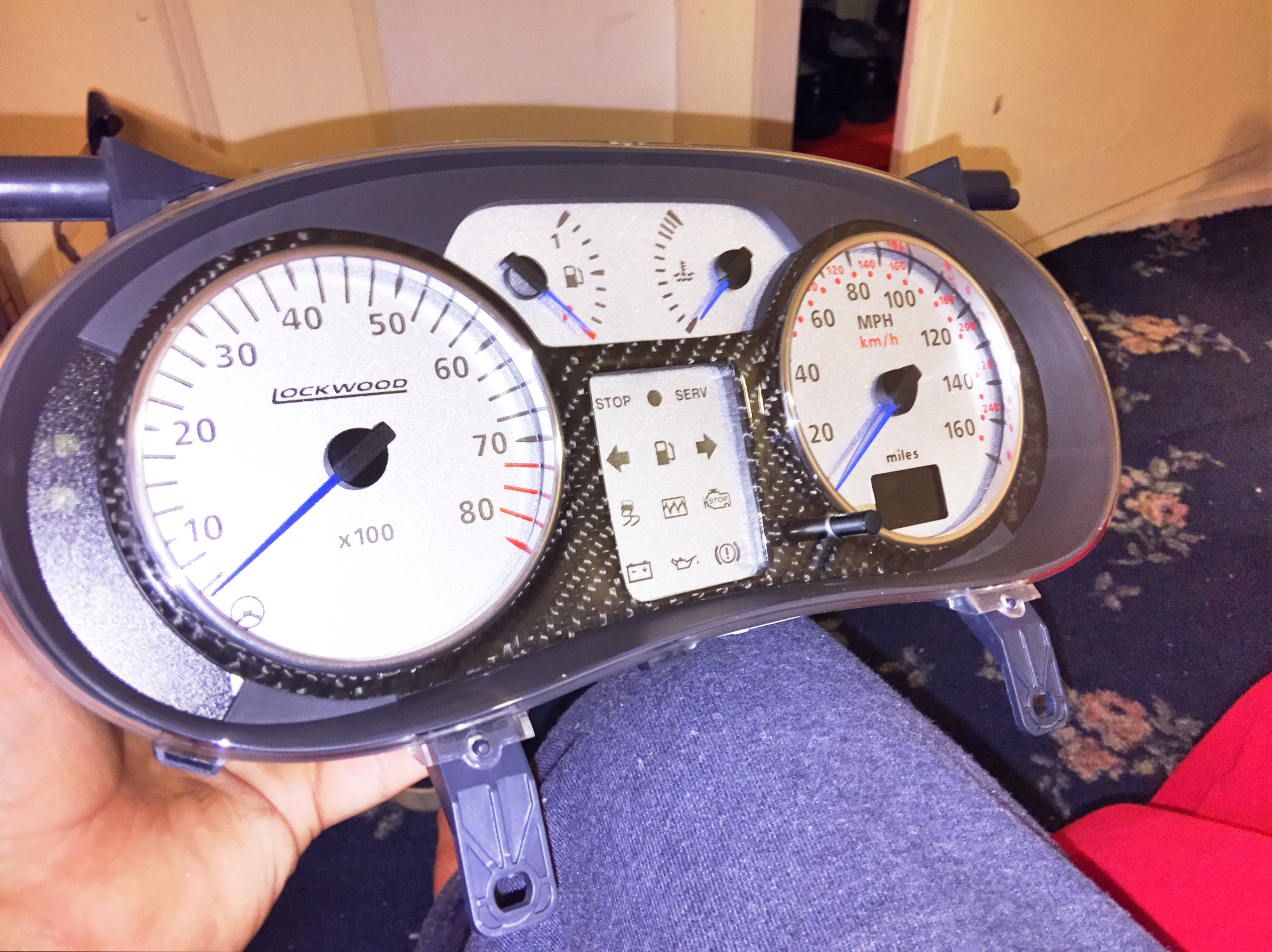

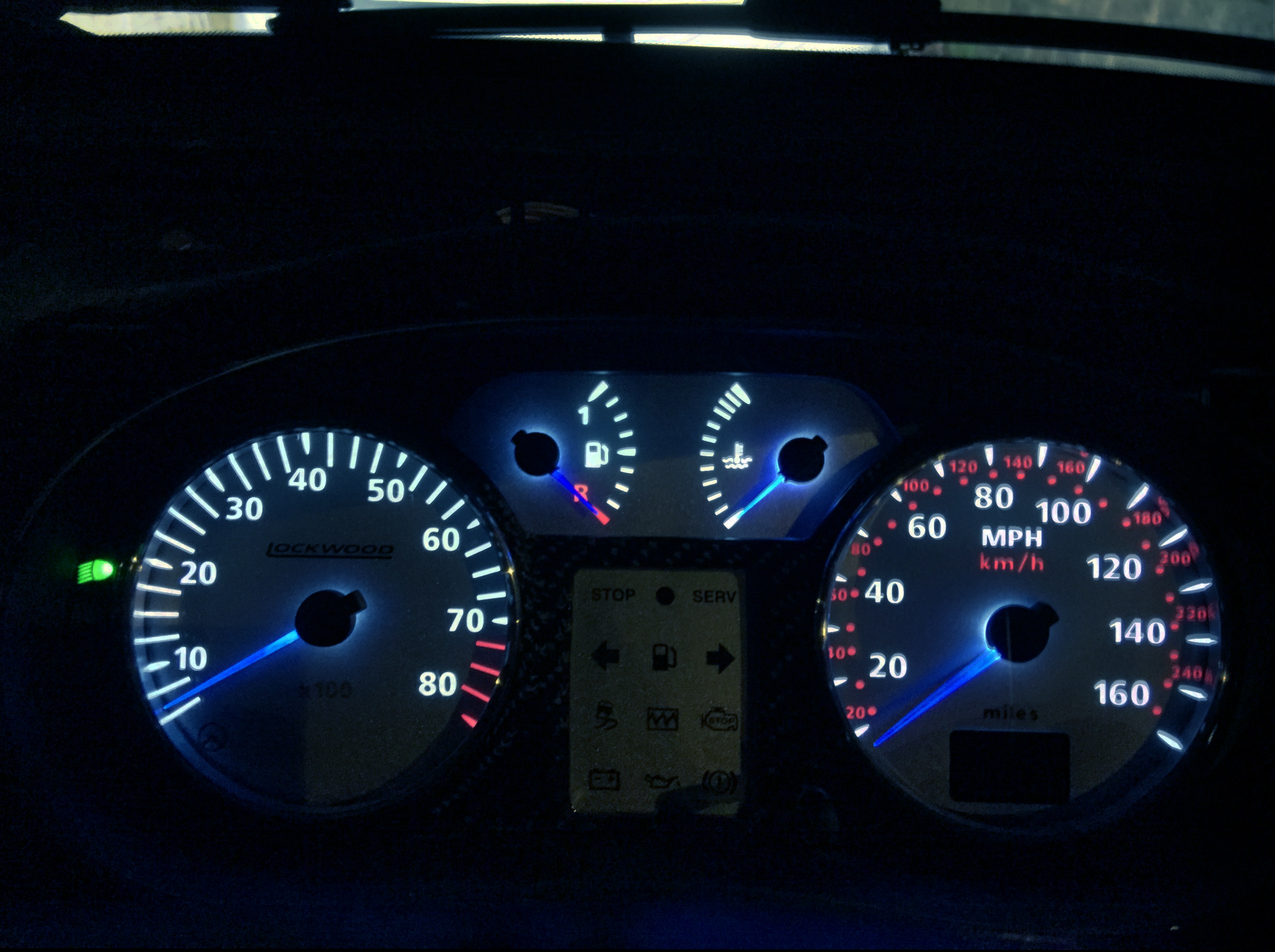

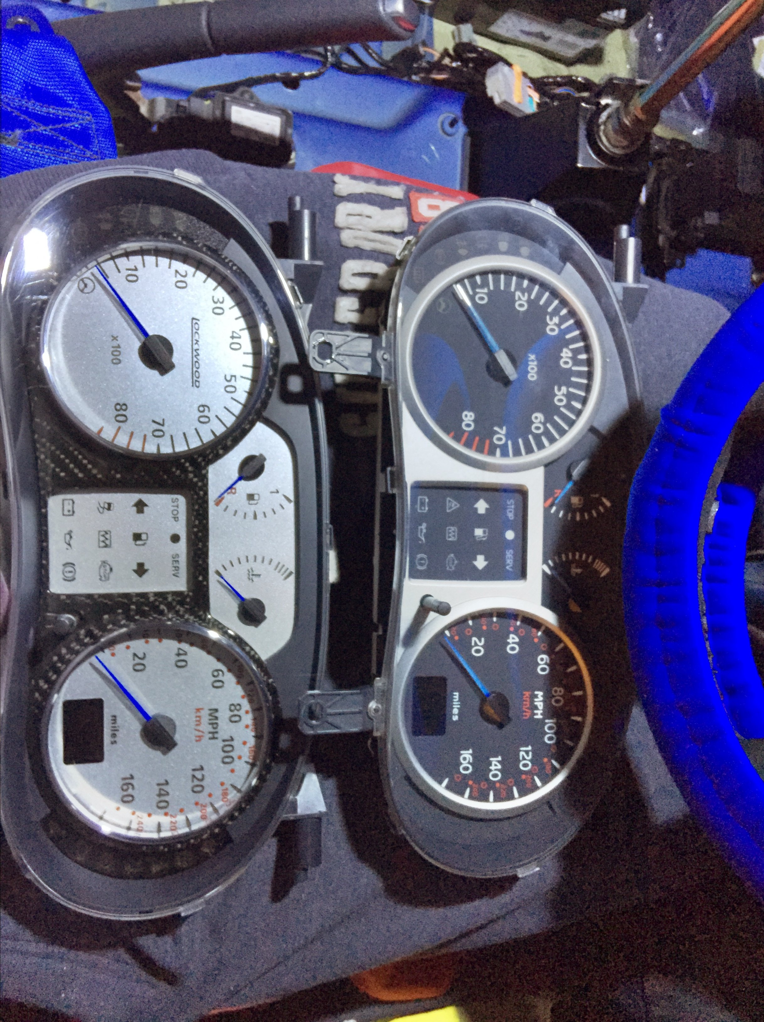

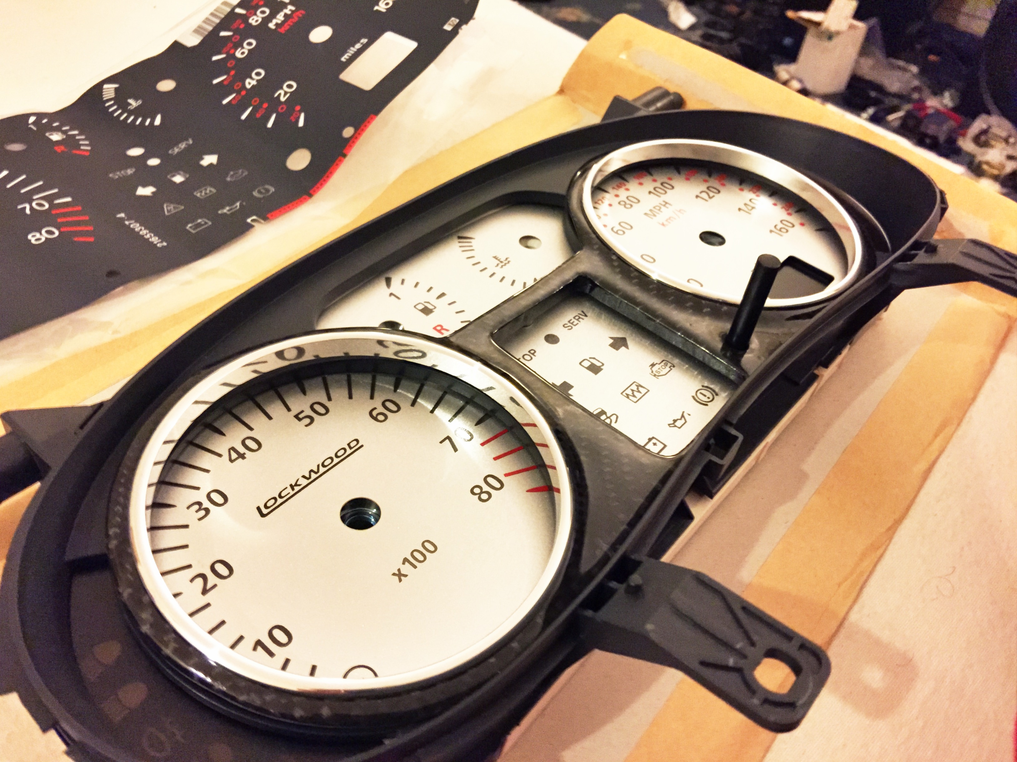

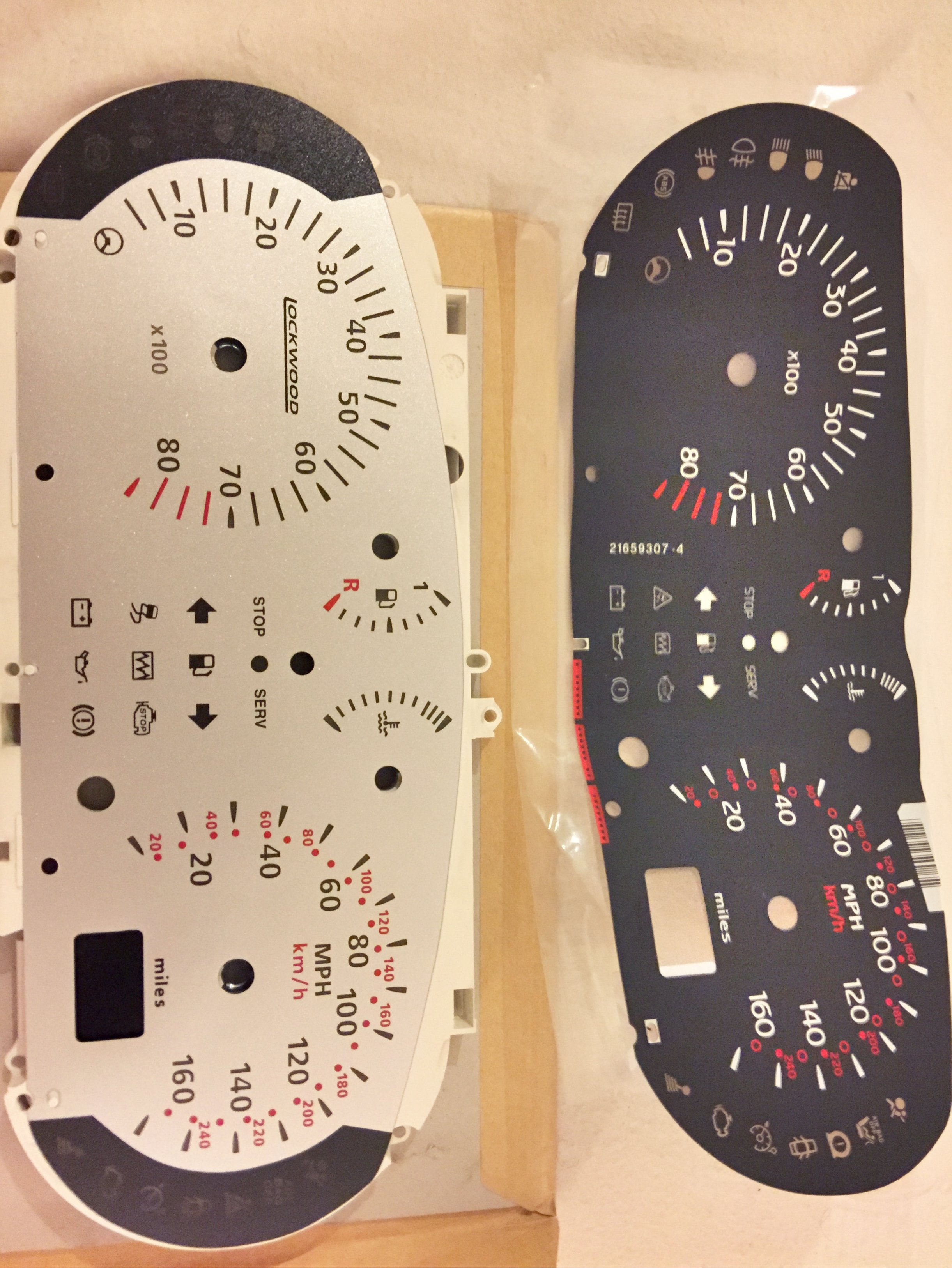

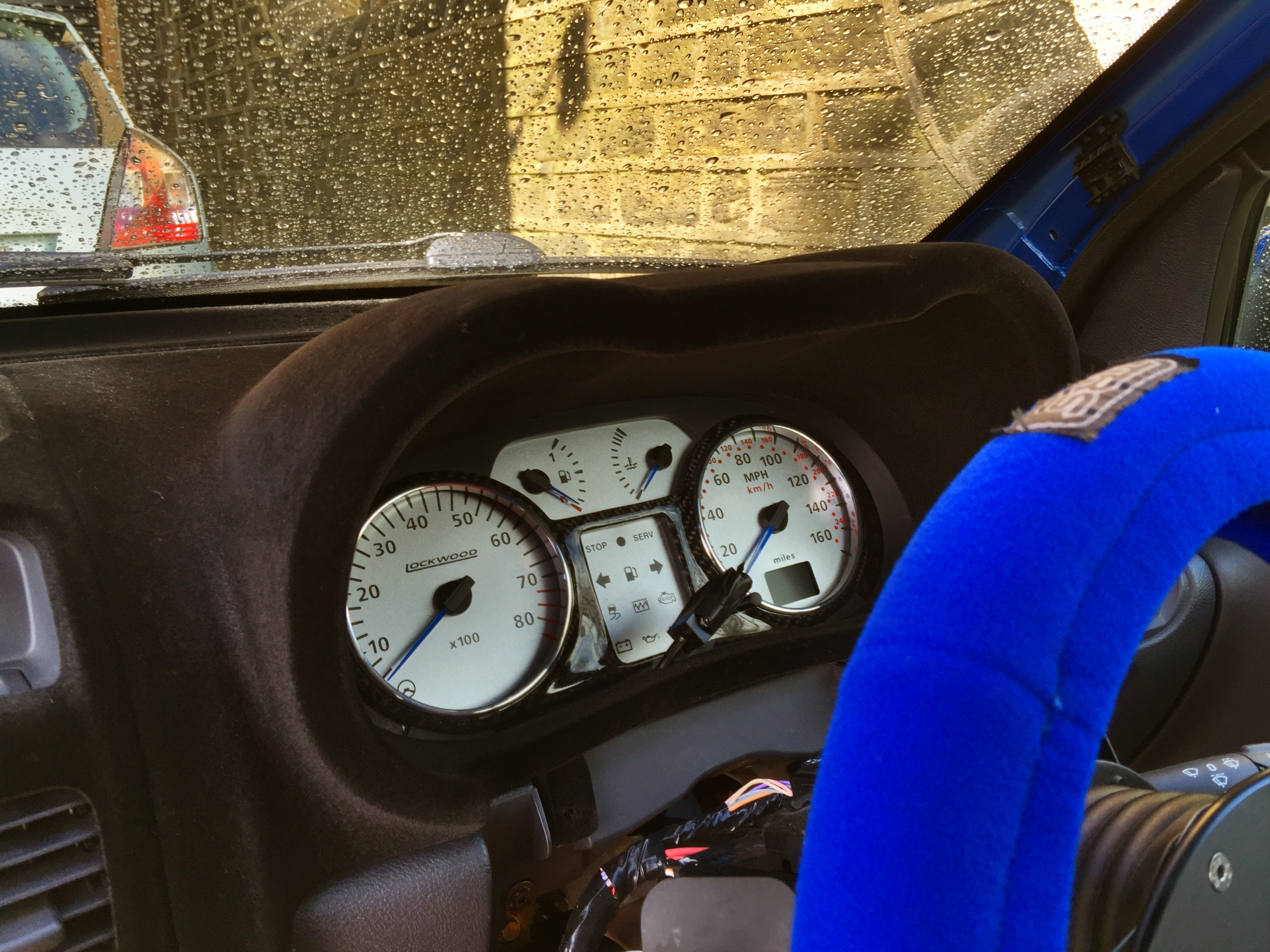

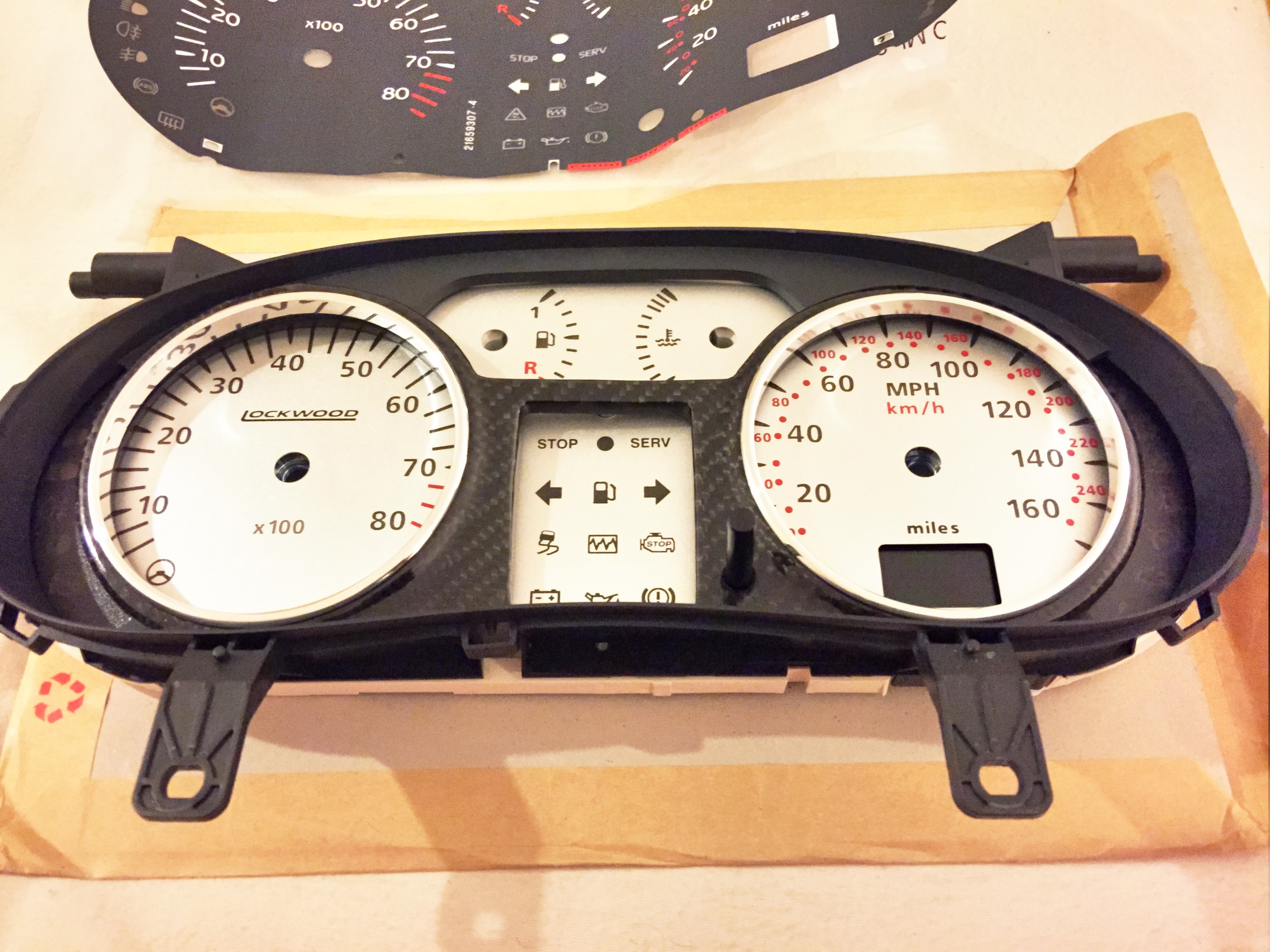

Prototype needles next my finalised ones!! the blue really pops on the new ones!!! well happy shame my smd display/ computer is f**king playing up now arrrrrghhhhhhh!!!!!
Photos do not do it justice at all!!!!
The flock looks shite on these pics it really does look better I promise!! haha The HDR didnt do kindly on it
Cheeky shift lights

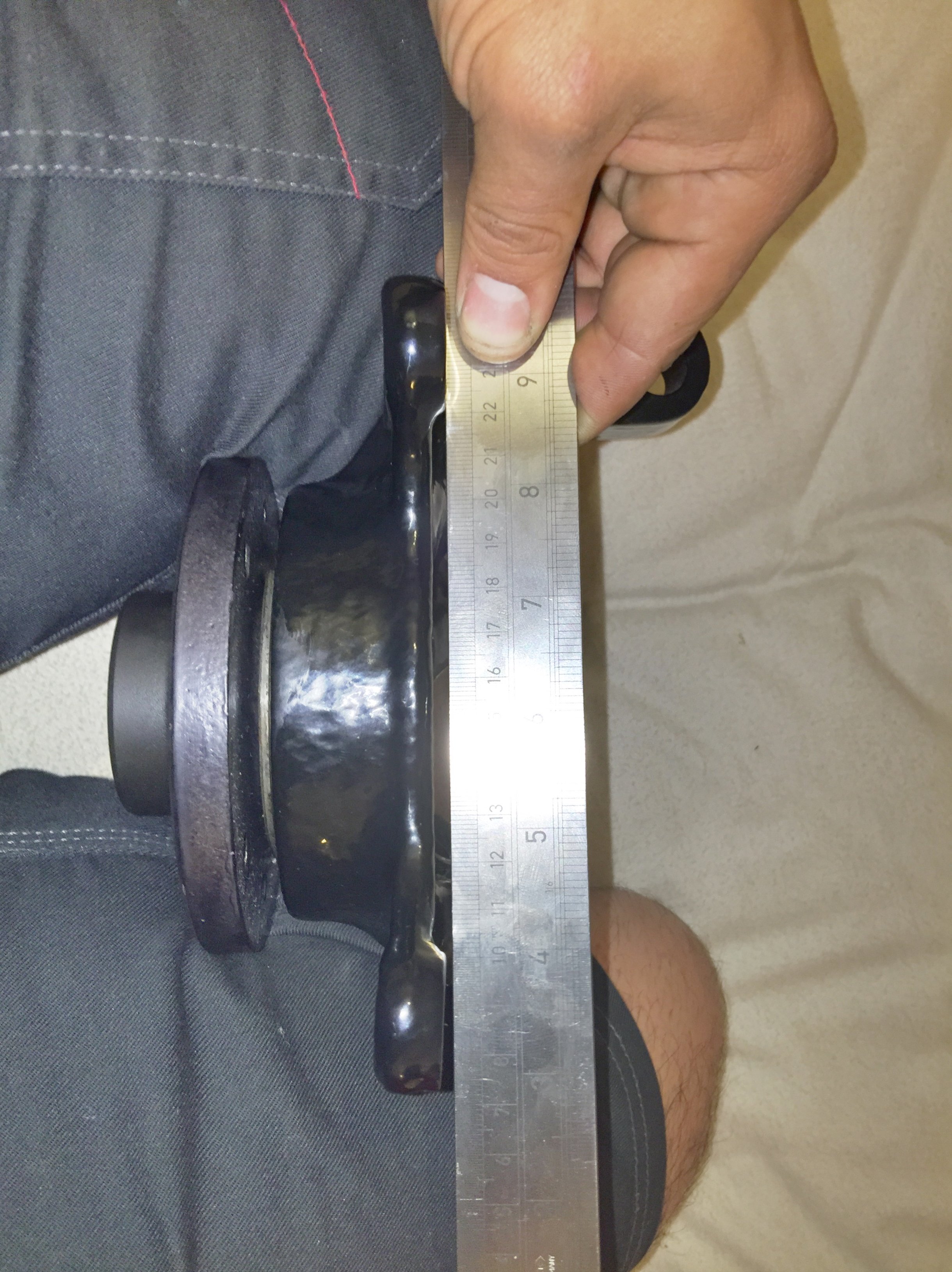

I feel your pain mate. What can be done ? can be bent back?

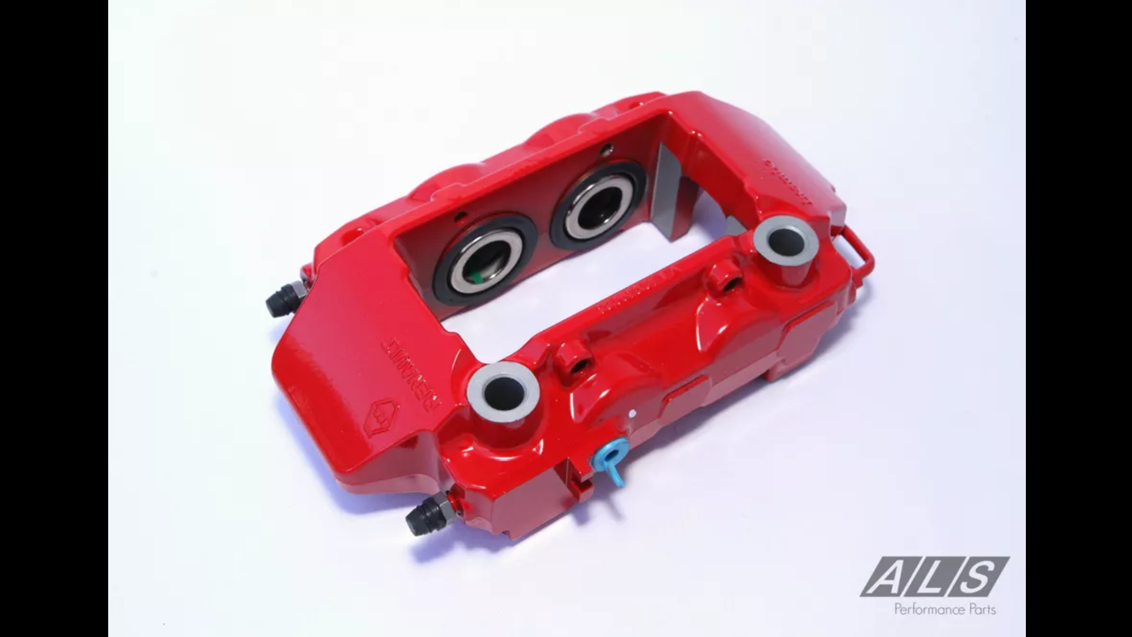

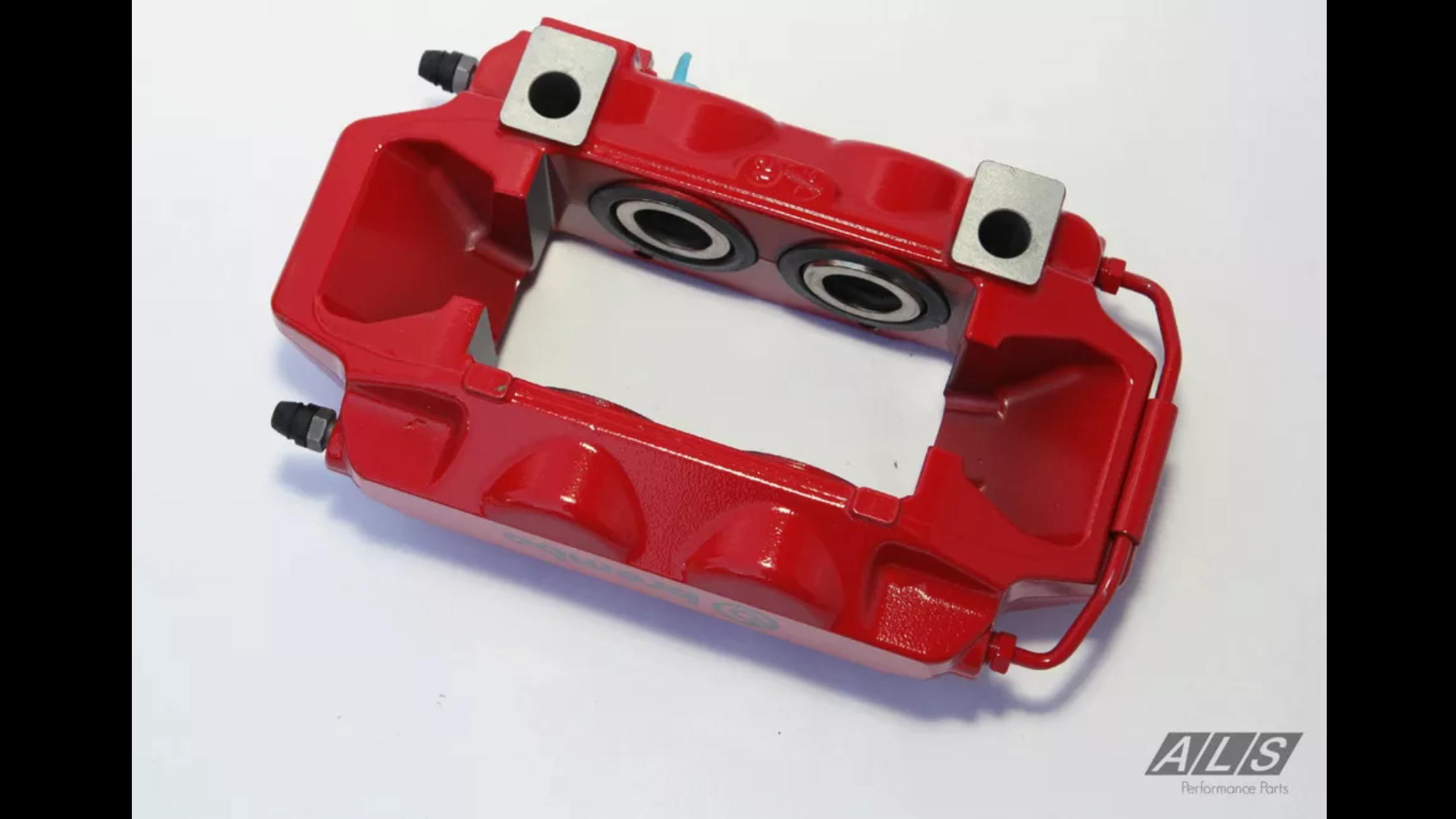

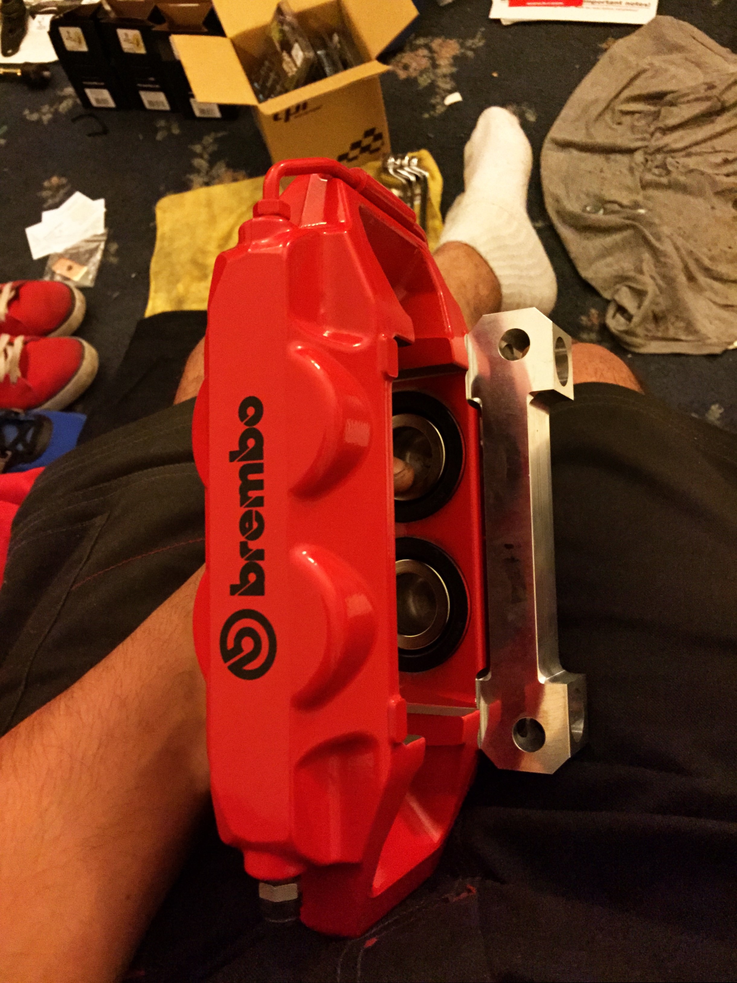

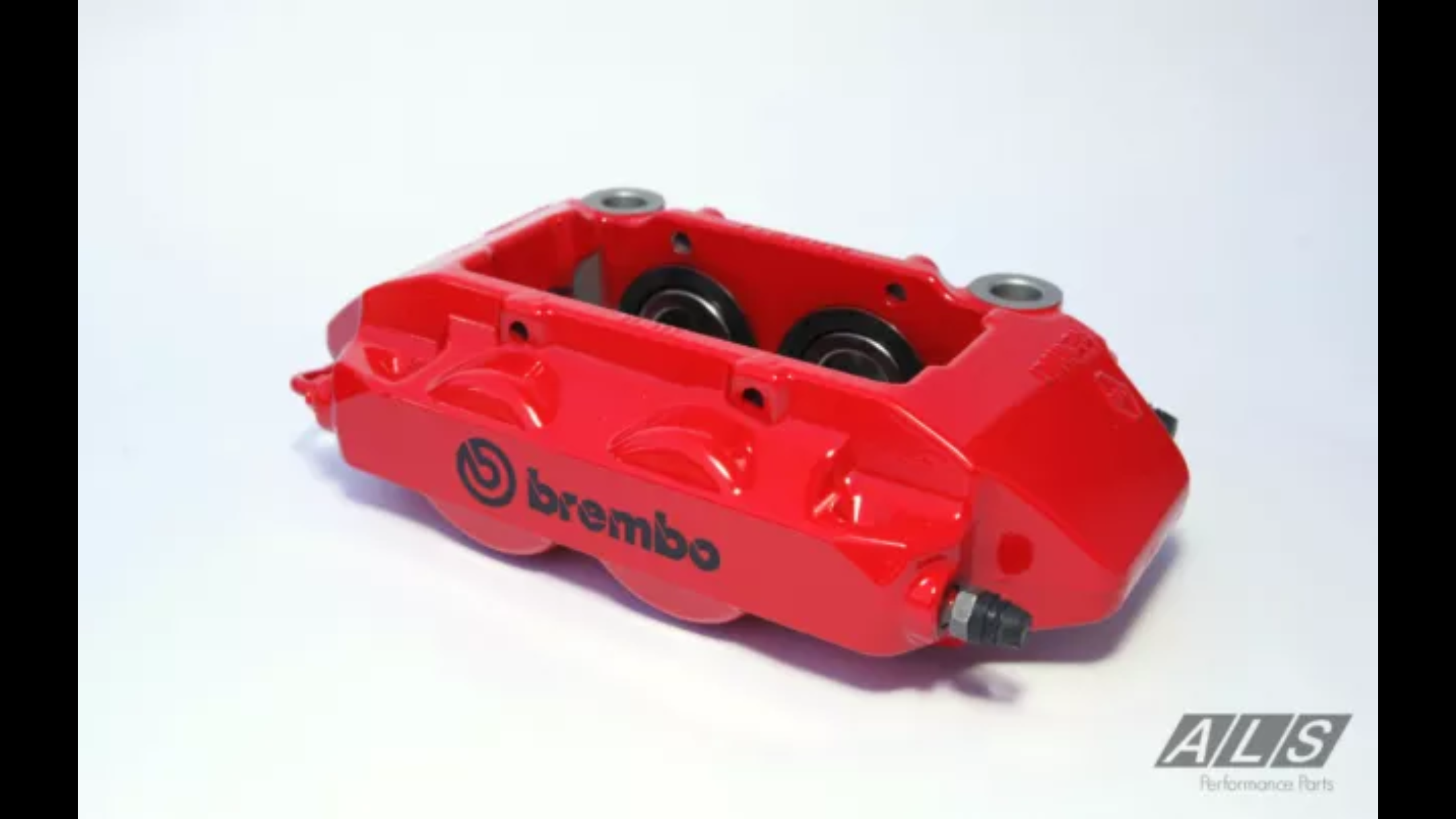

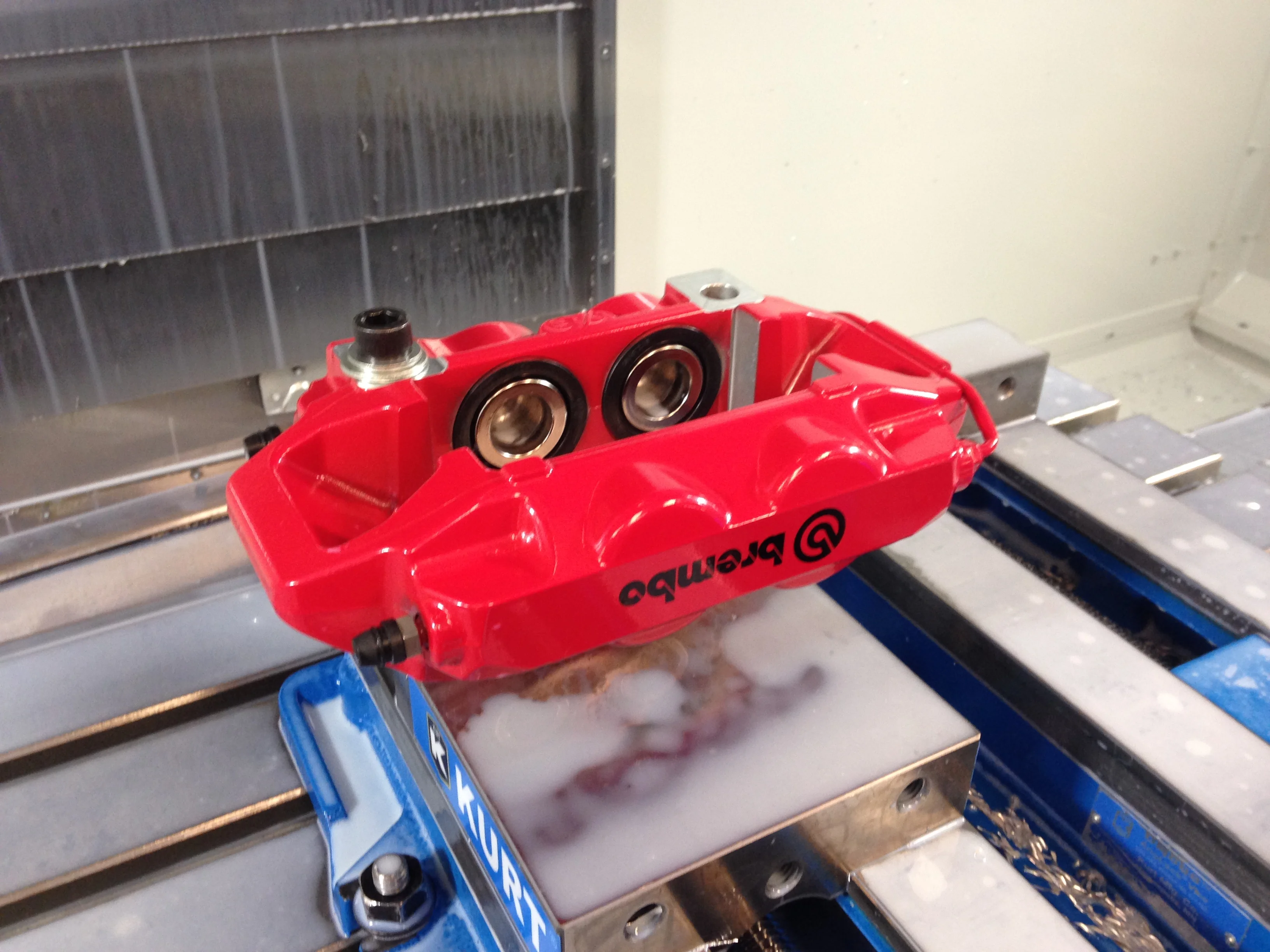

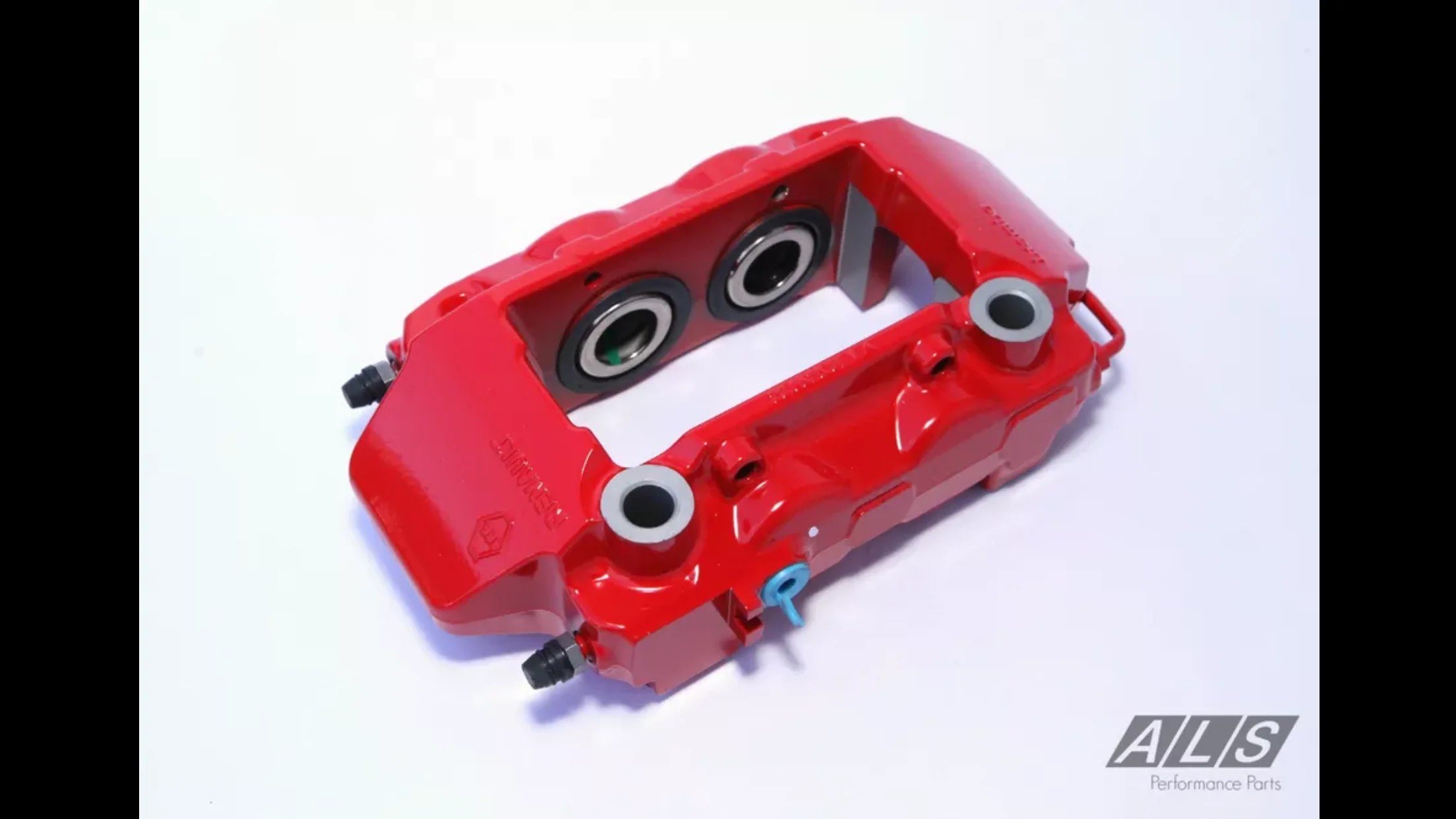

Love the brembos - got some myself off ALS - really good price. What pads and discs are you going to go with.

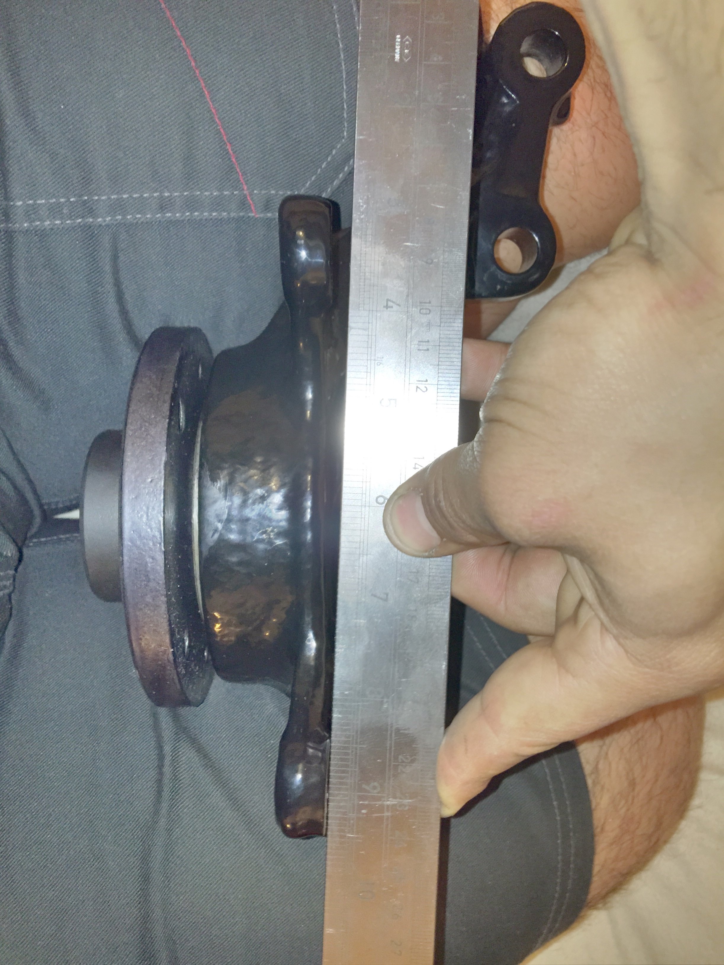

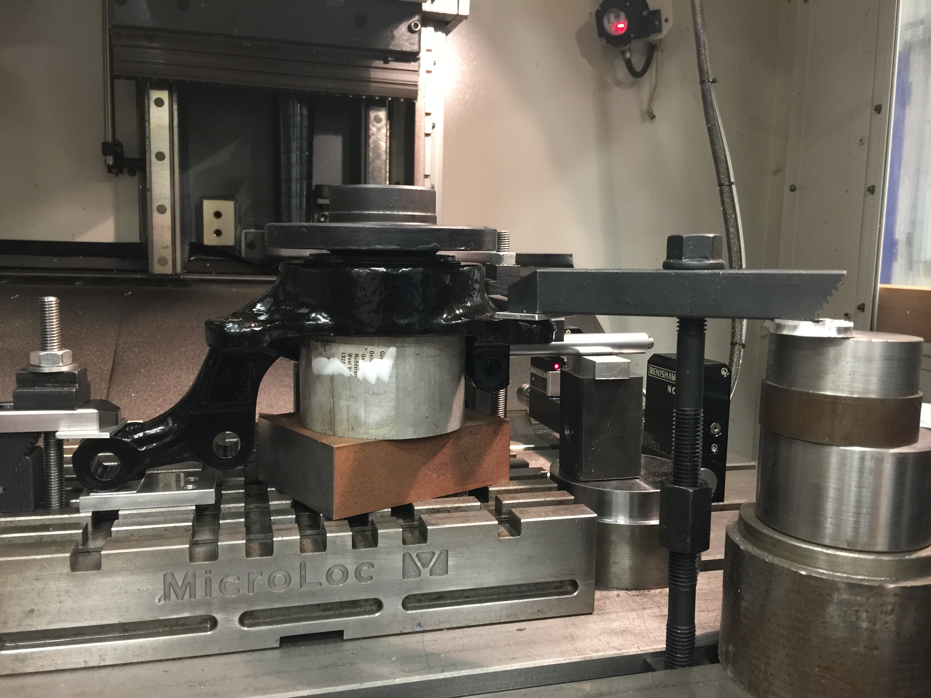

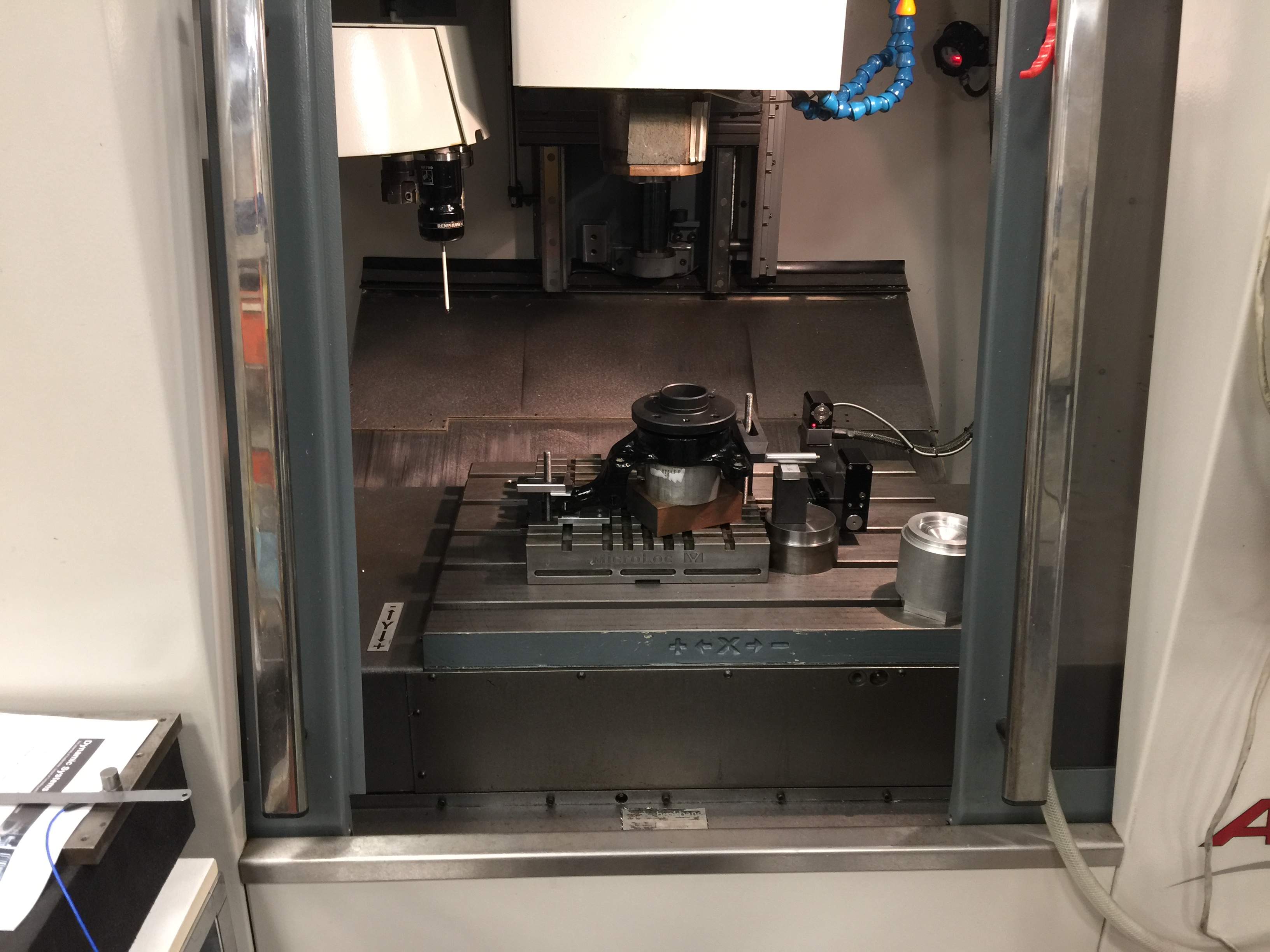

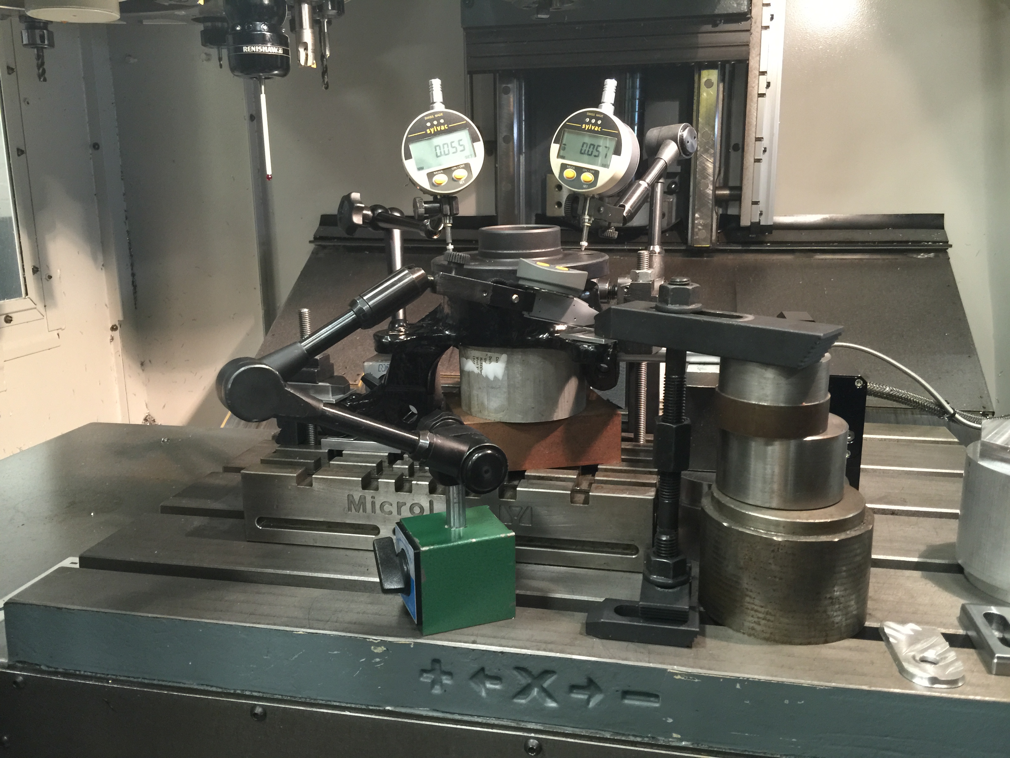

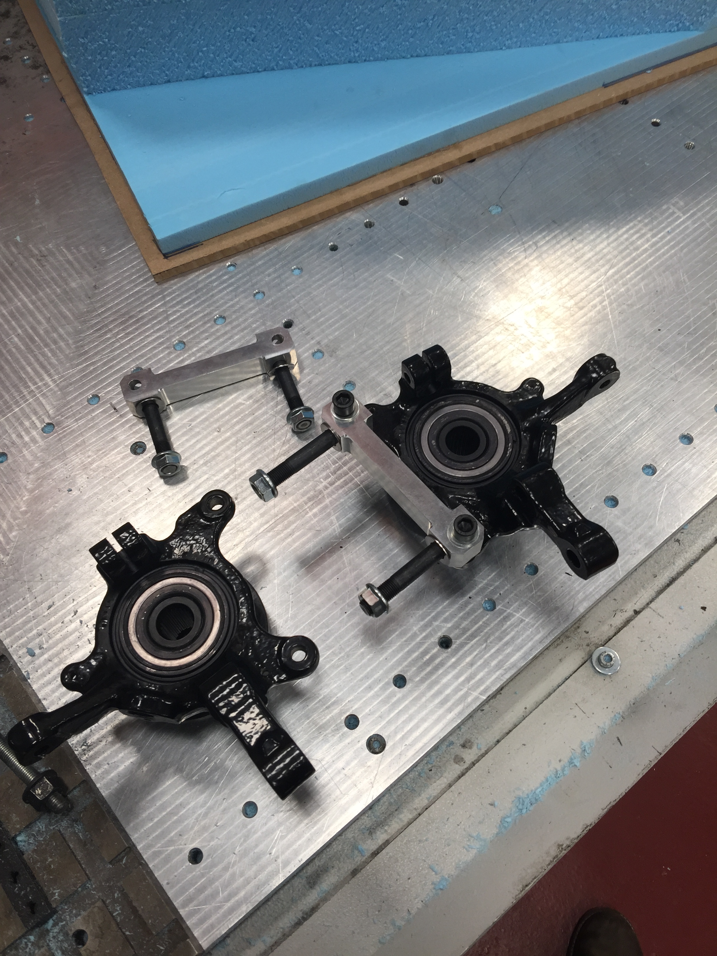

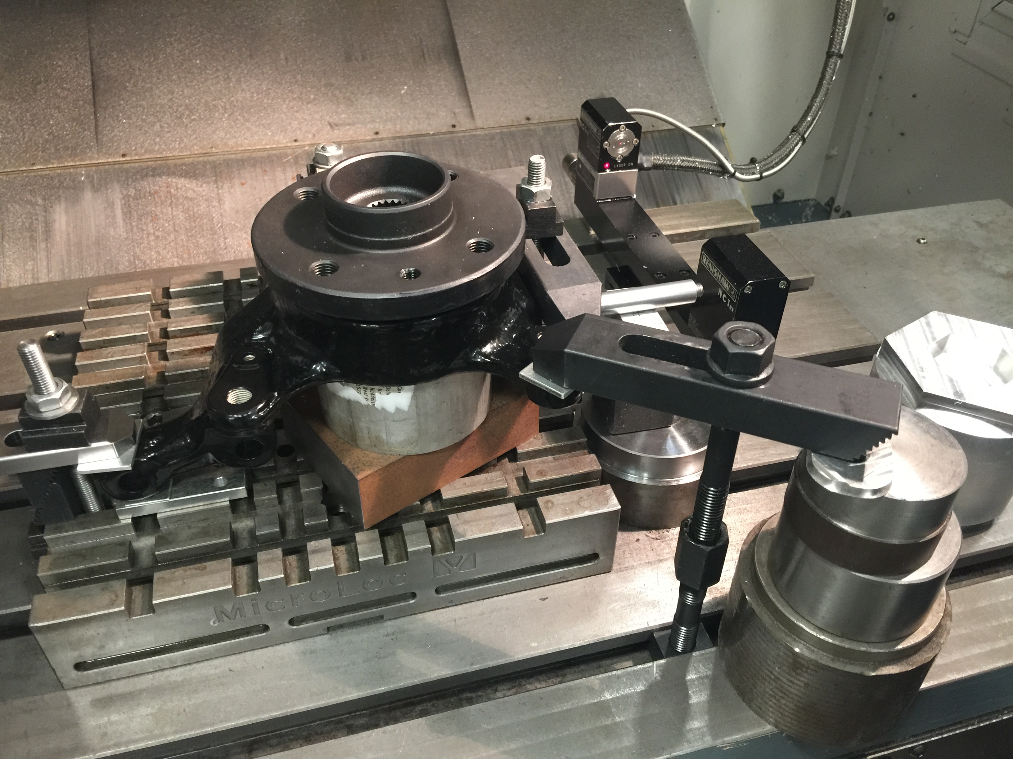

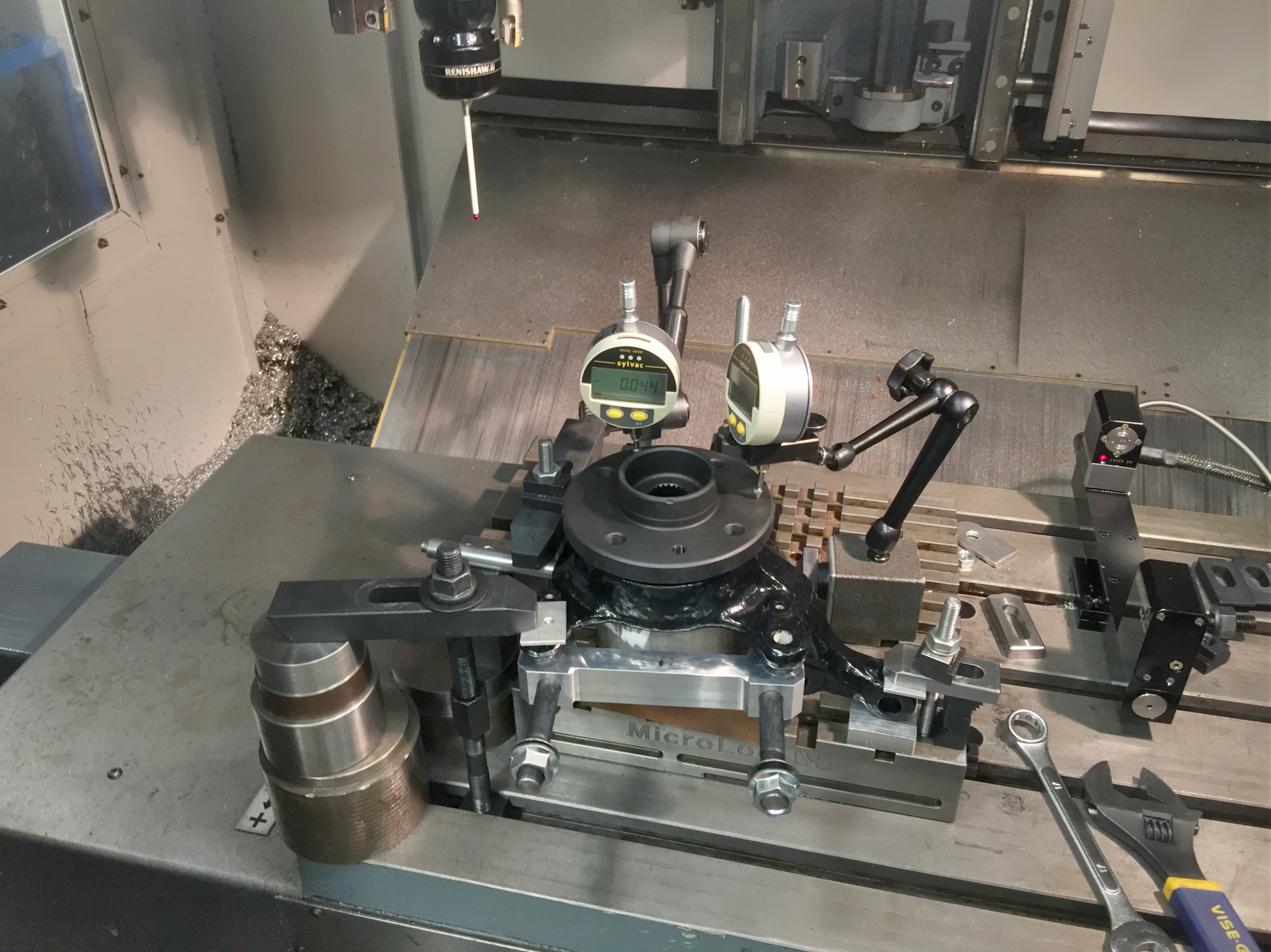

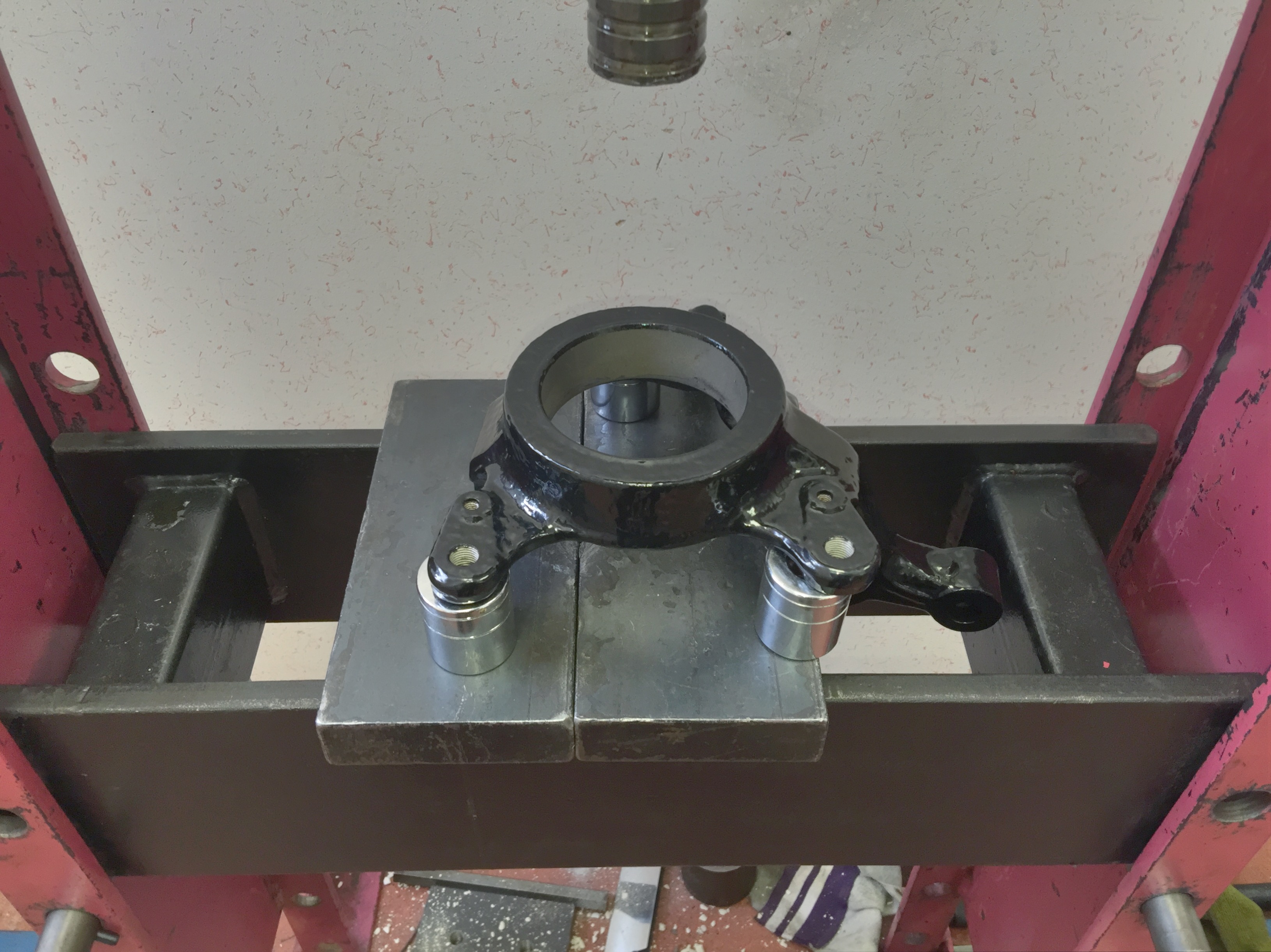

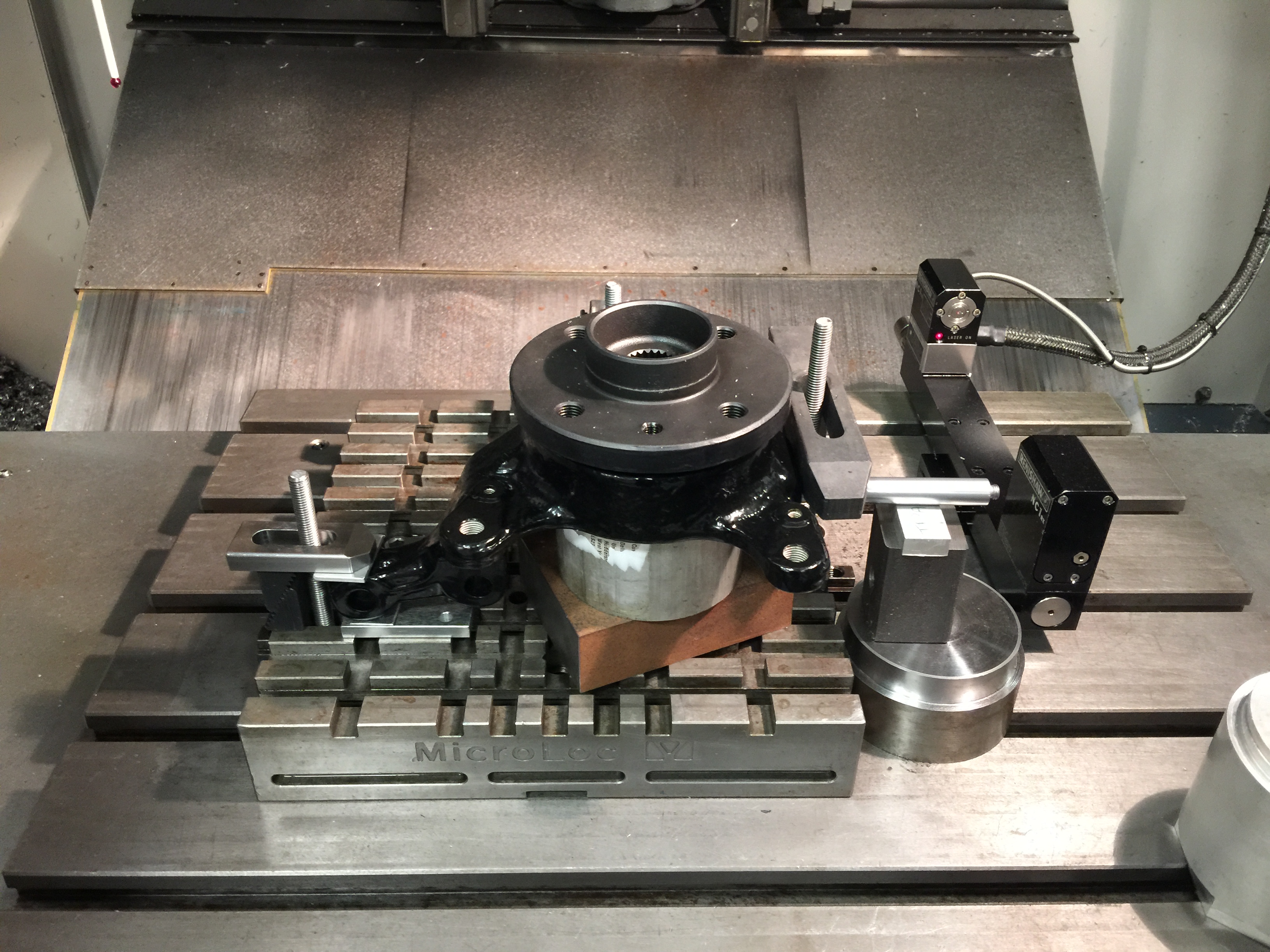

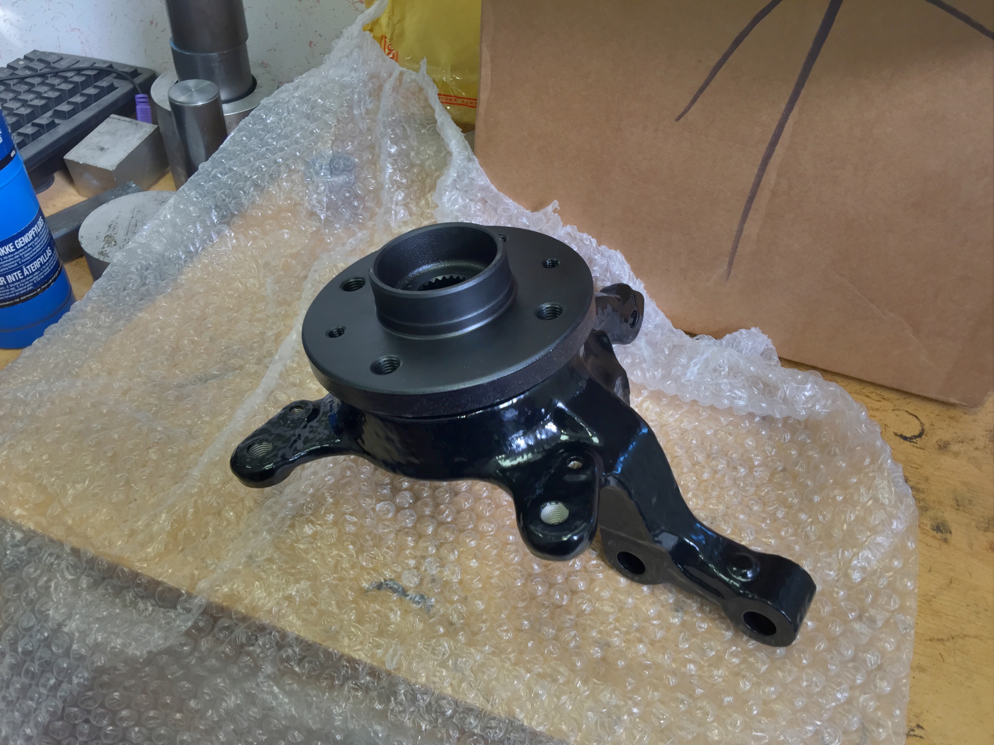

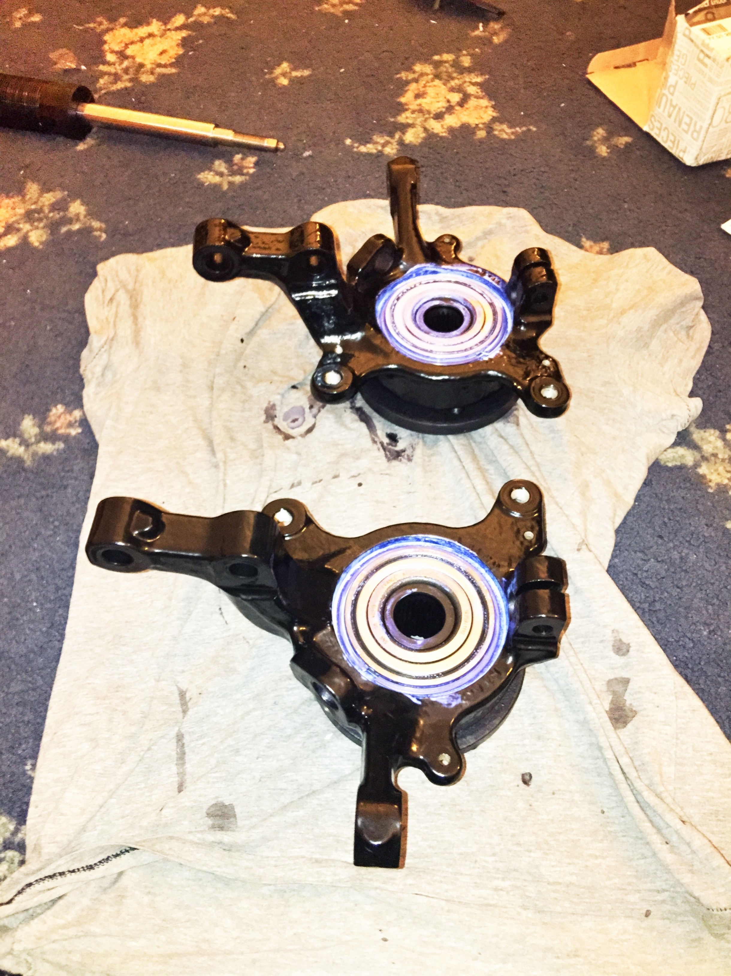

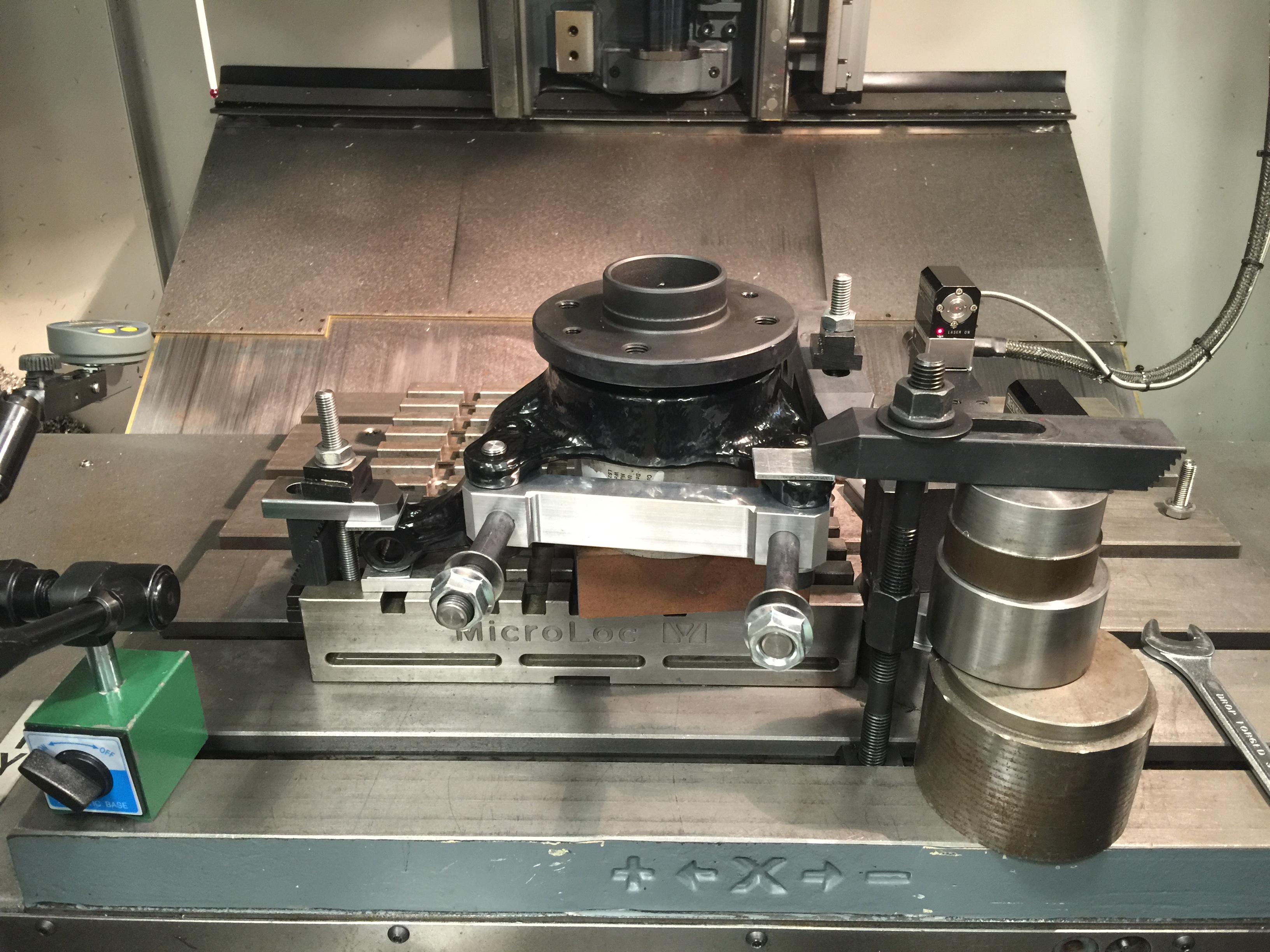

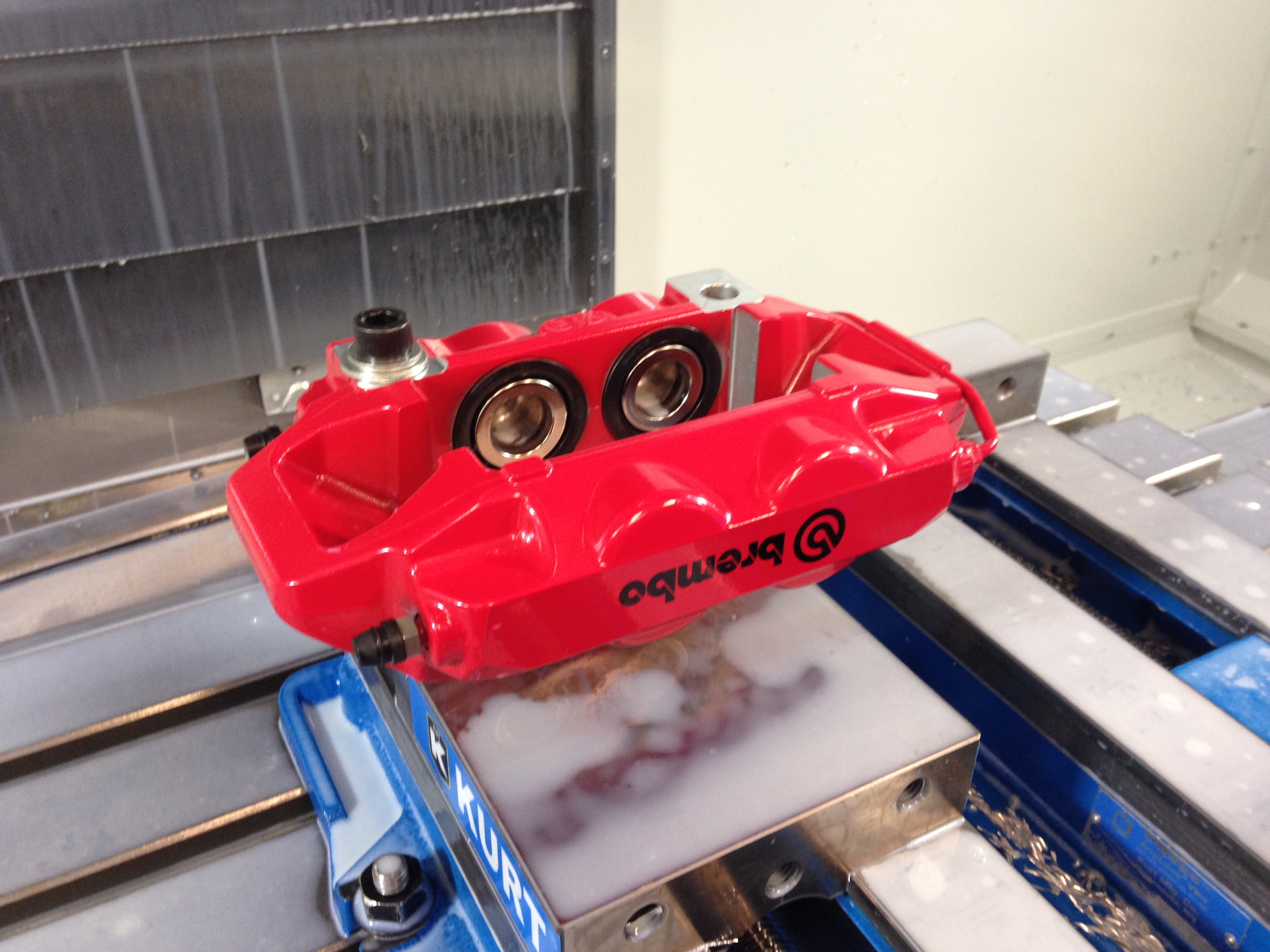

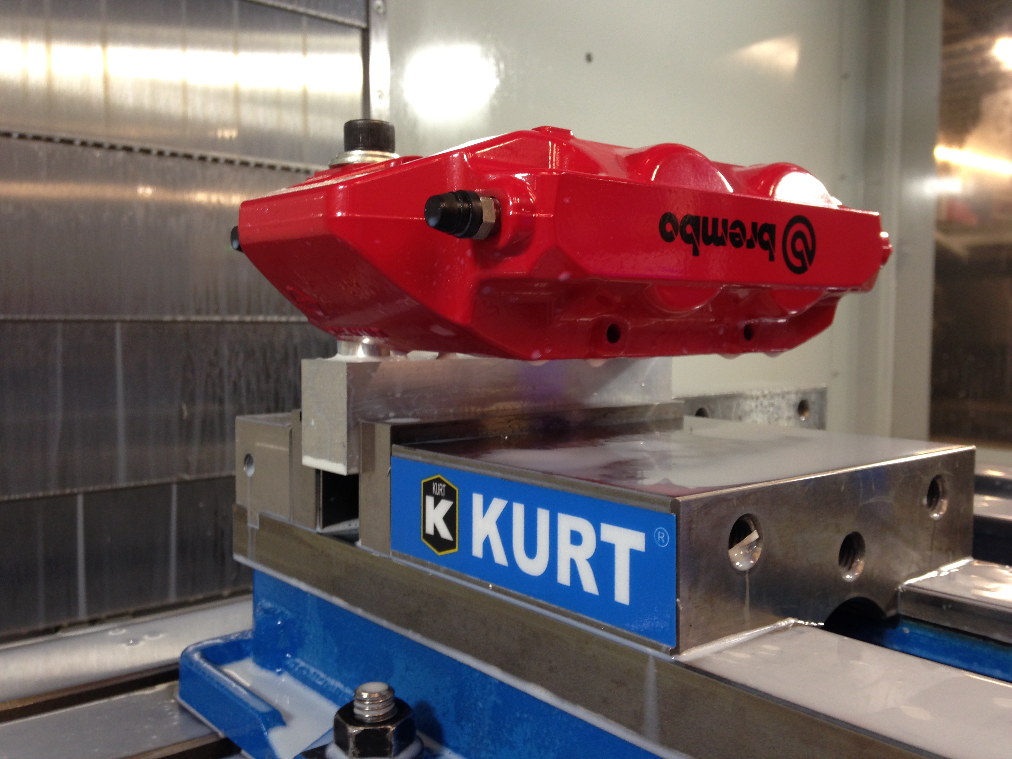

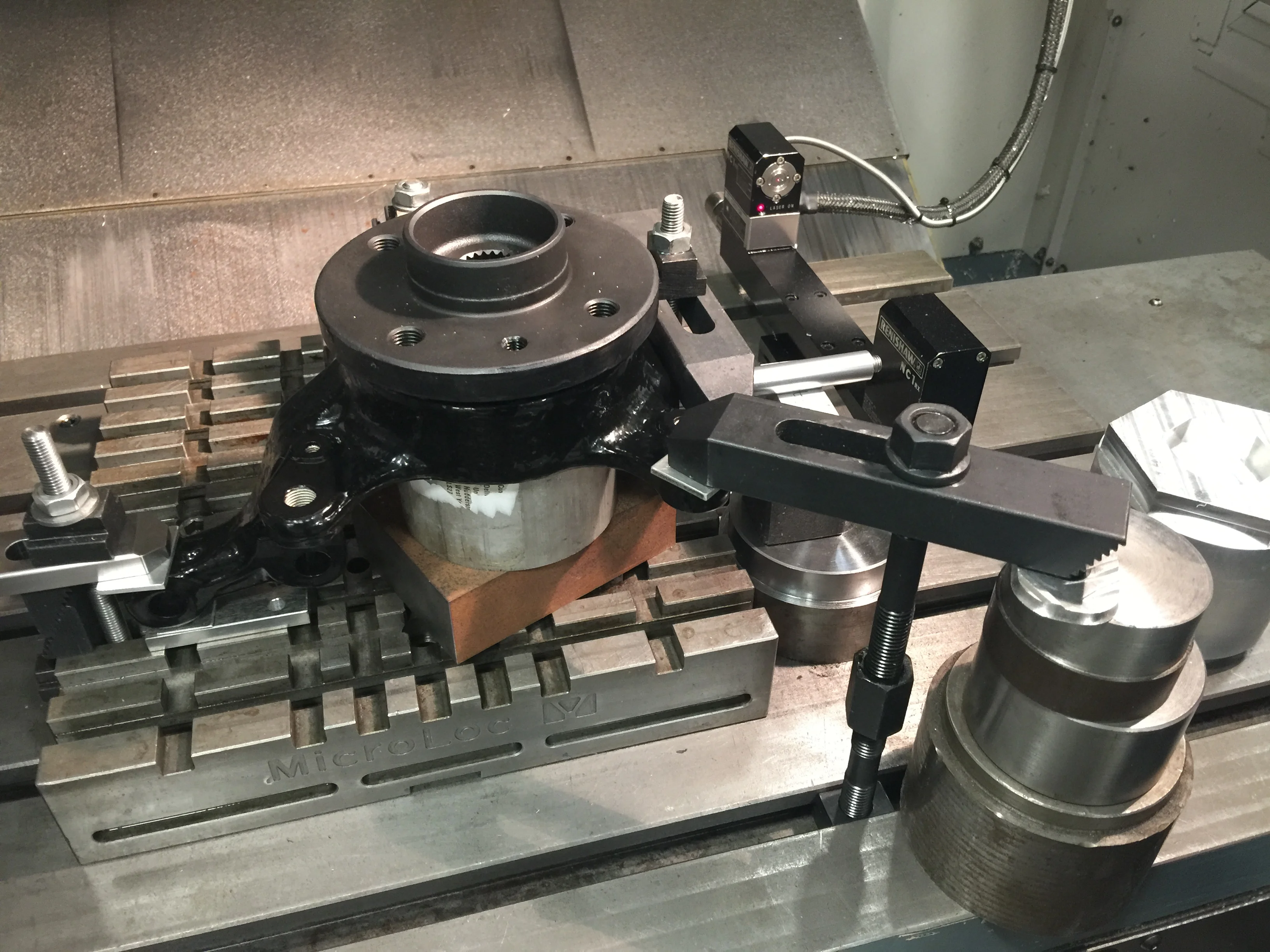

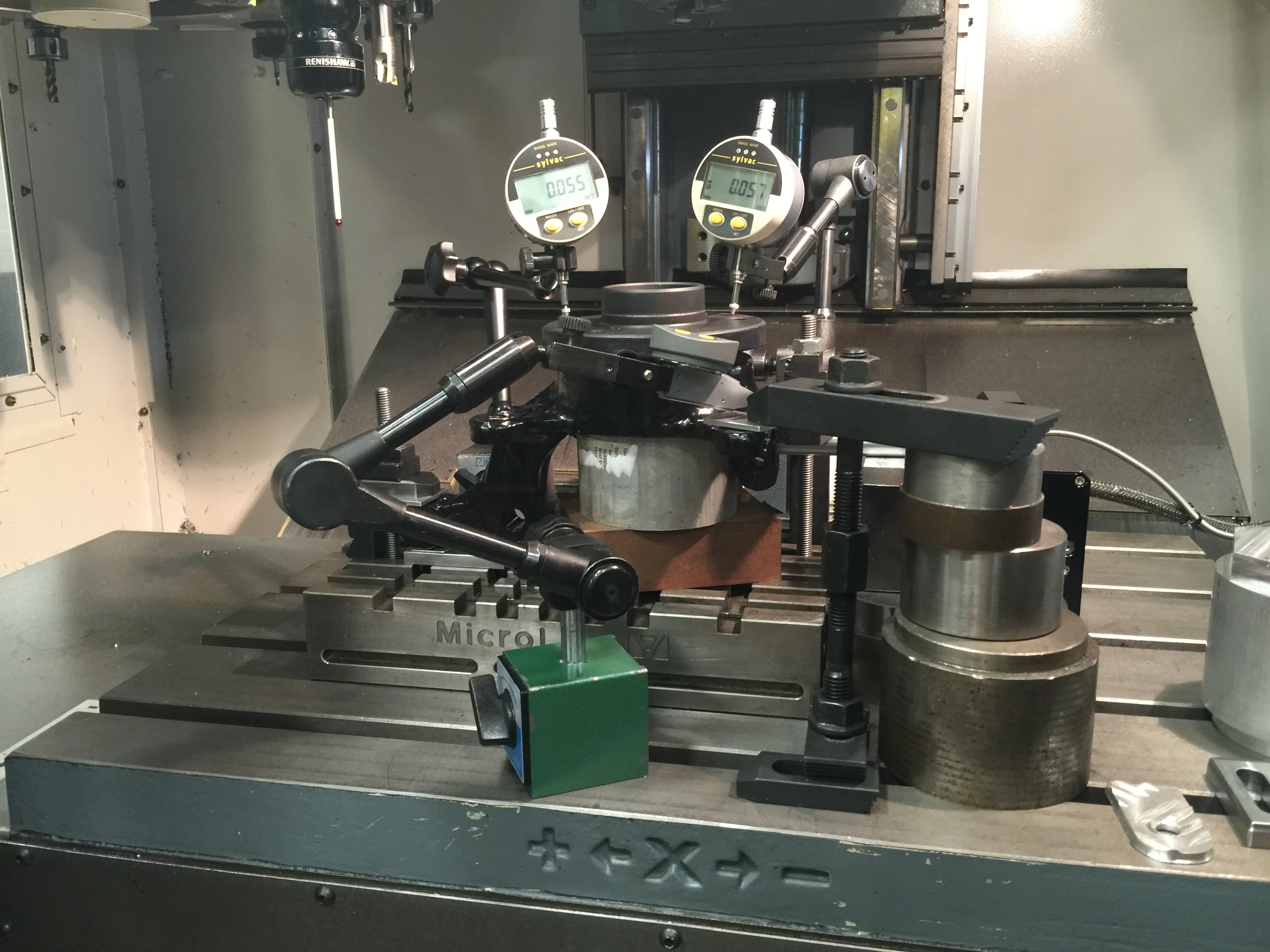

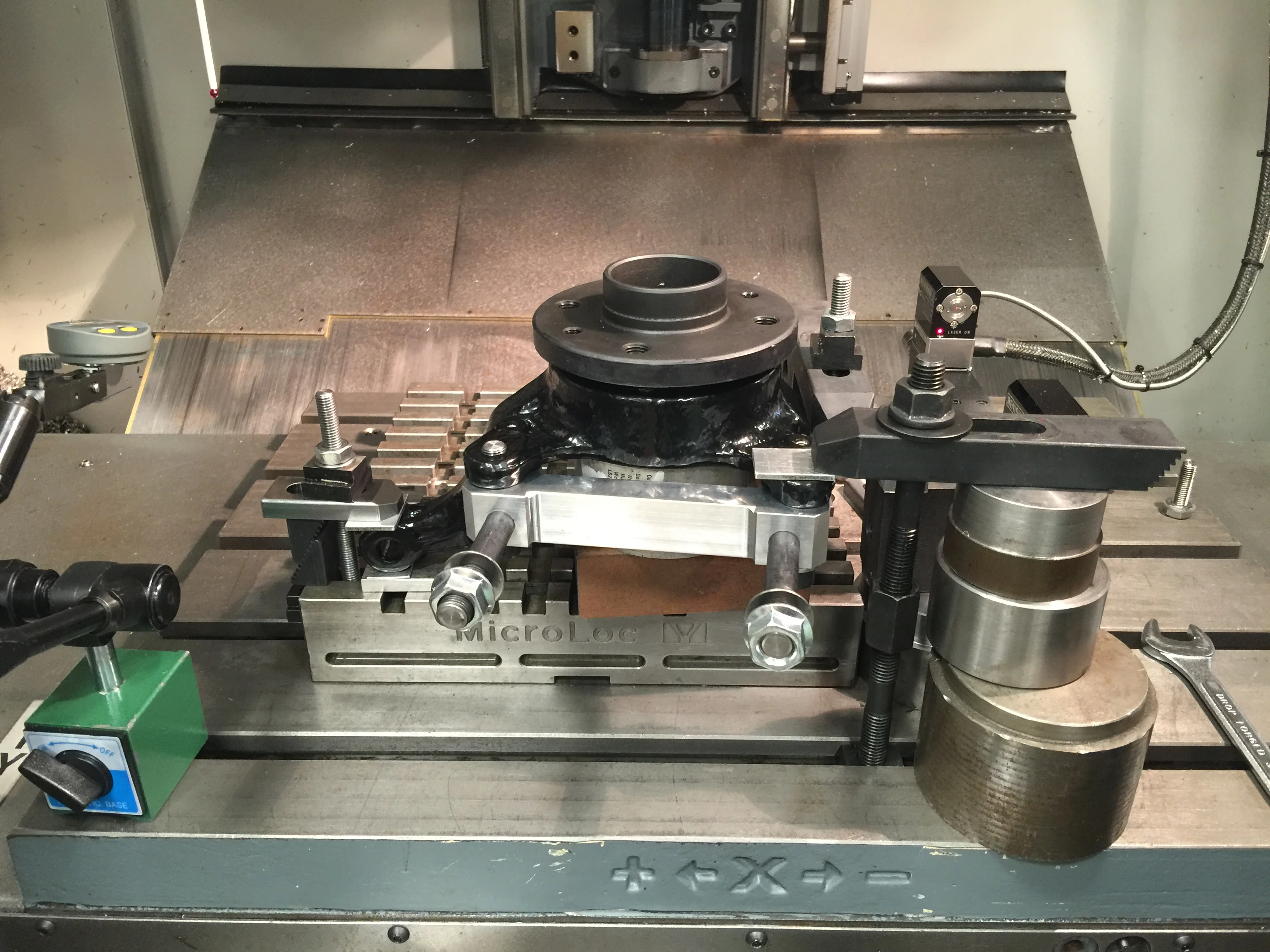

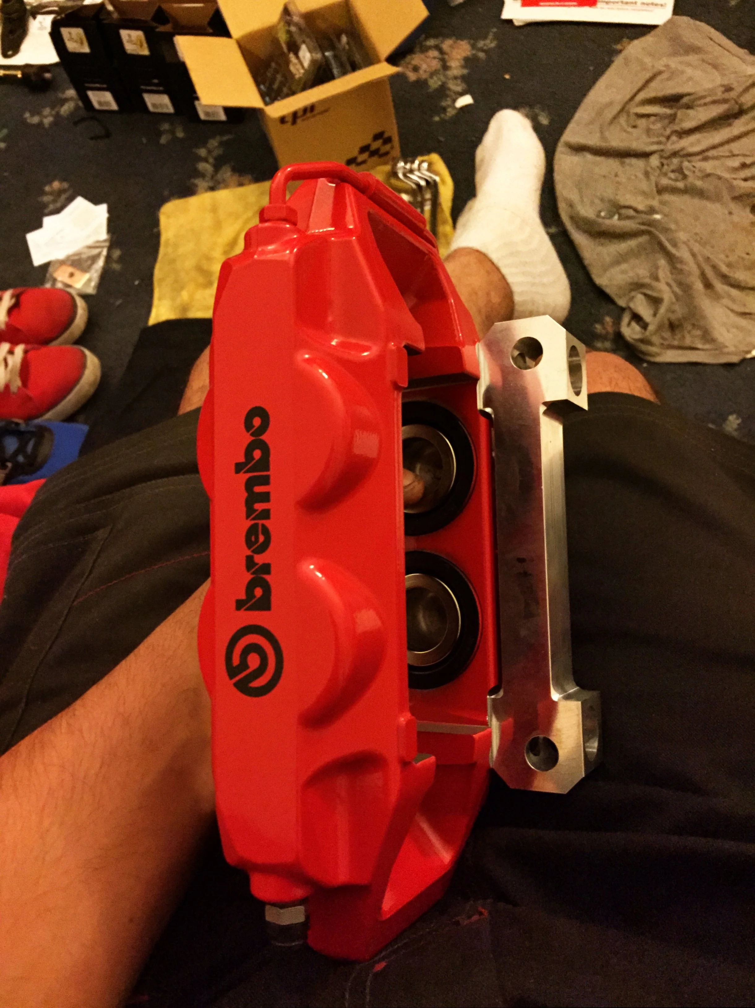

As you can see!! The top caliper mounts are parallel to the hub but sadly the bottom mount is quite severely out of line!! These hubs were now potentially scrap!! Untill I had a genius Idea!!! Mwahhhhh hahahahaha
Held the upright down securely using aluminium plate (also aided shimming it and actually saved the powder coat too) and then on the offending caliper mount, the one with the hug clamp on it!! Squeezed it back into alignment!!! Was severly a massive bum hole twitch moment!!!
Certainly can haha!! Spent ages doing it today the trouble with second hand stuff really you live and learn!! will not be making that mistake again!! Will be swapping with my uprights in the future
Just using OEM 197 pads for the time being mate. and HC discs couldnt justify the cost of silly pads atm not after the outlay

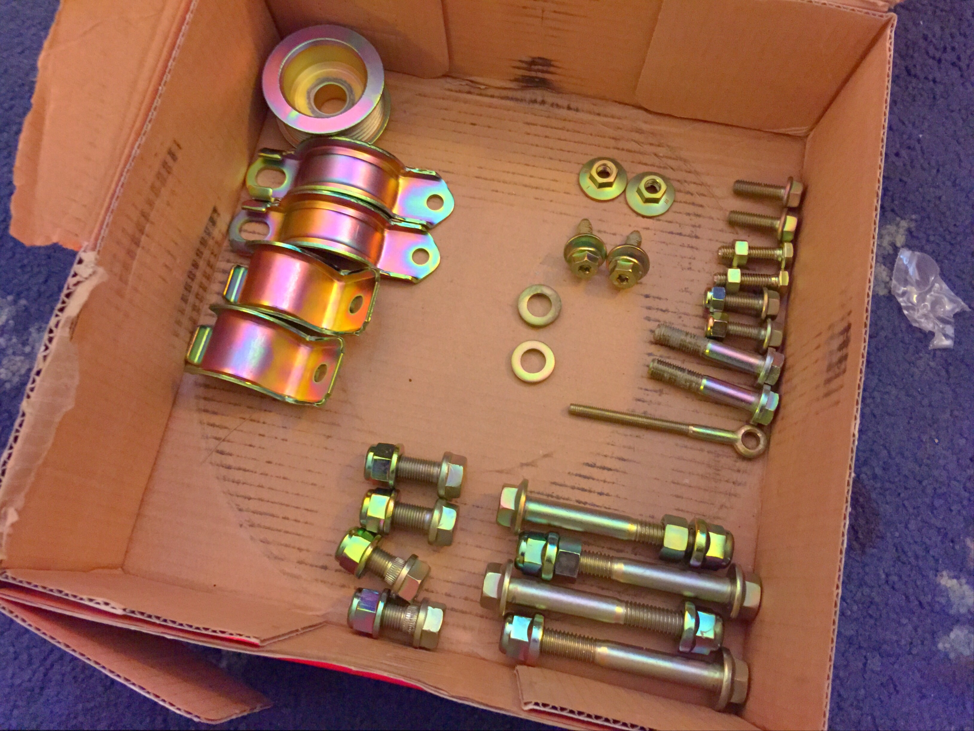

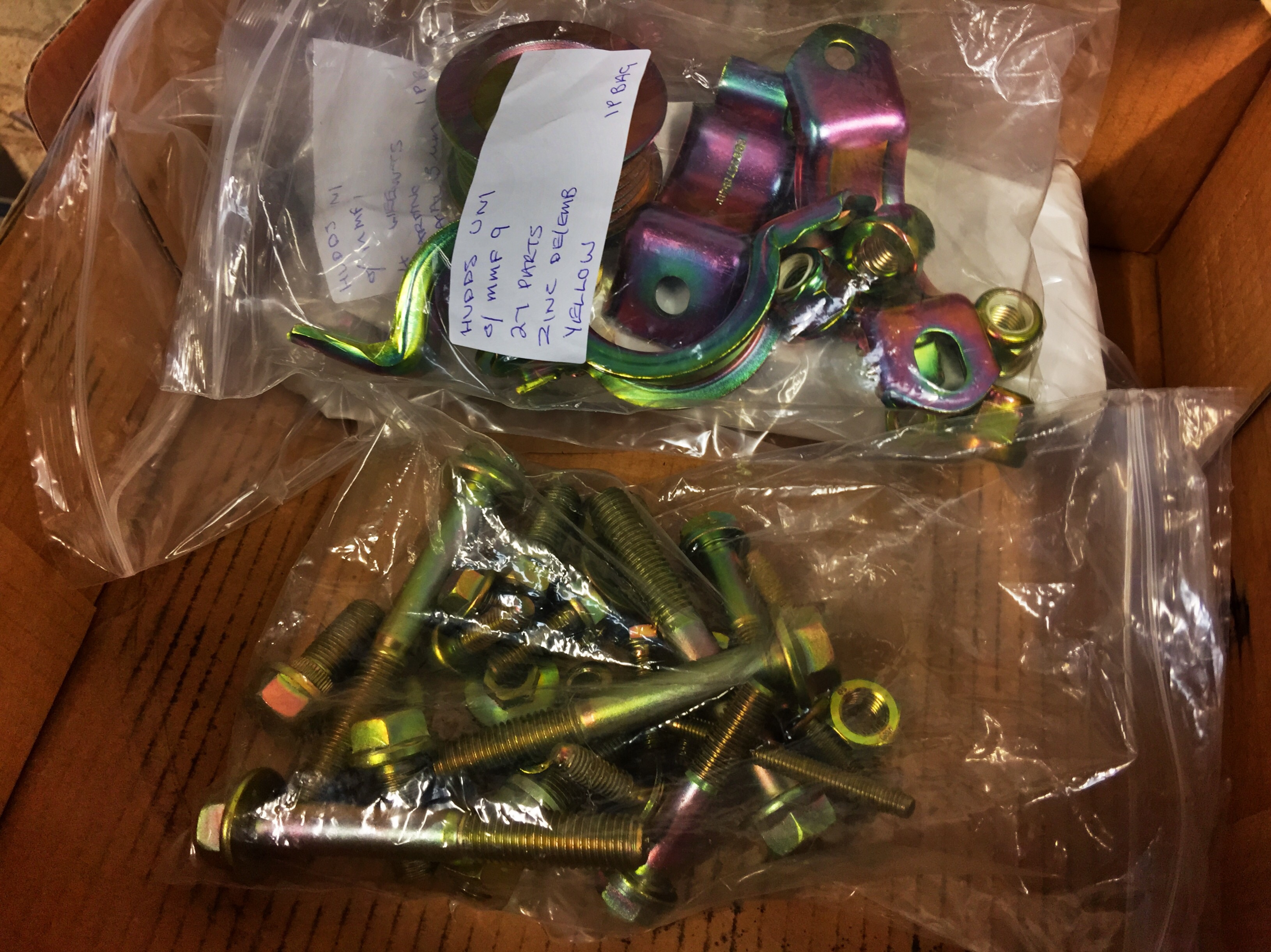

Massive sorry for the late reply mate it's been a mad few months for me finishing uni and competing in the formula student events. Think I've got a few photos tucked away to upload will need to remind myself where I've left off haha! Got some more bolts back from moss metals t'other day which I know is a new one haha! I have and OCD thing about bolts haha!!

Yeah the look incredible! Picture never quite does them justice!! These have come out almost purpley!! Which is awesome yet bloody annoying as the previous batch was less purple and more yellow! Which is annoying because it won't match dammit!! Haha! I really need to keep telling myself they are only bolts!! :unamused:😅

out of interest how much is it to plate stuff - this batch for example, how much was it?
It's usually around £30 a batch no matter how many bolts tend to go in. As long as it fits in his basket. These are all hardened OEM bolts so they de-embrittle them all too which a lot of plating places do NOT do! As usually the zincing process reduces the grade. So they re treat them too included in the price.
Check out their site Will probably explain it all better
Moss metal finishers
