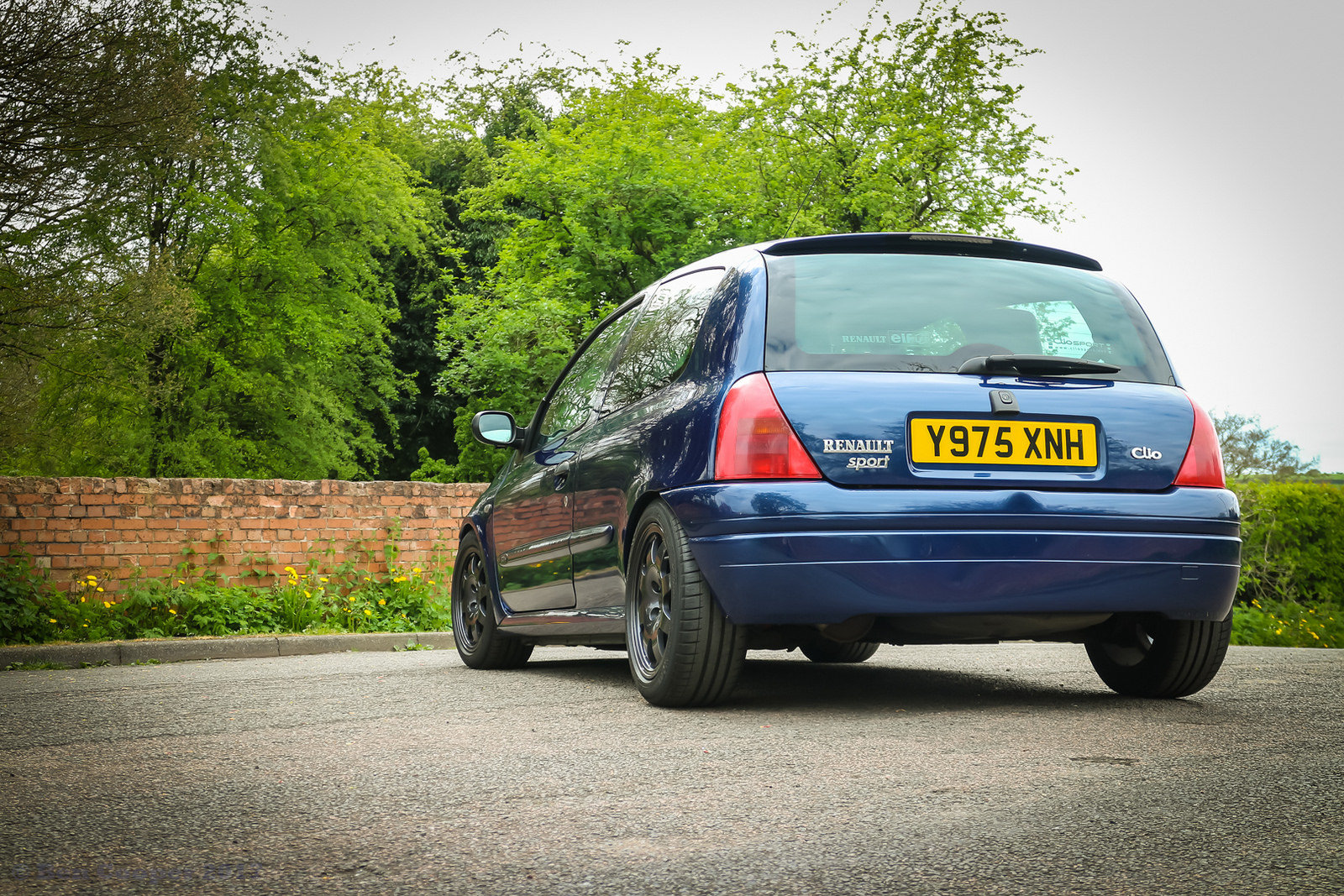

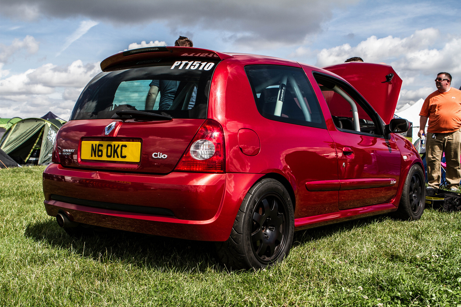

Spax RSX Coilovers, 10mm rear Stub Axle Spacers, 16mm front hub centric spacers with genuine Renault 15" Oz F1 wheels
20mm fronts..
20mm rears..
20mm all round on cooksports and oem cup alloys...(slight scraping at the rear over huge speed humps or more than one passenger in the back)

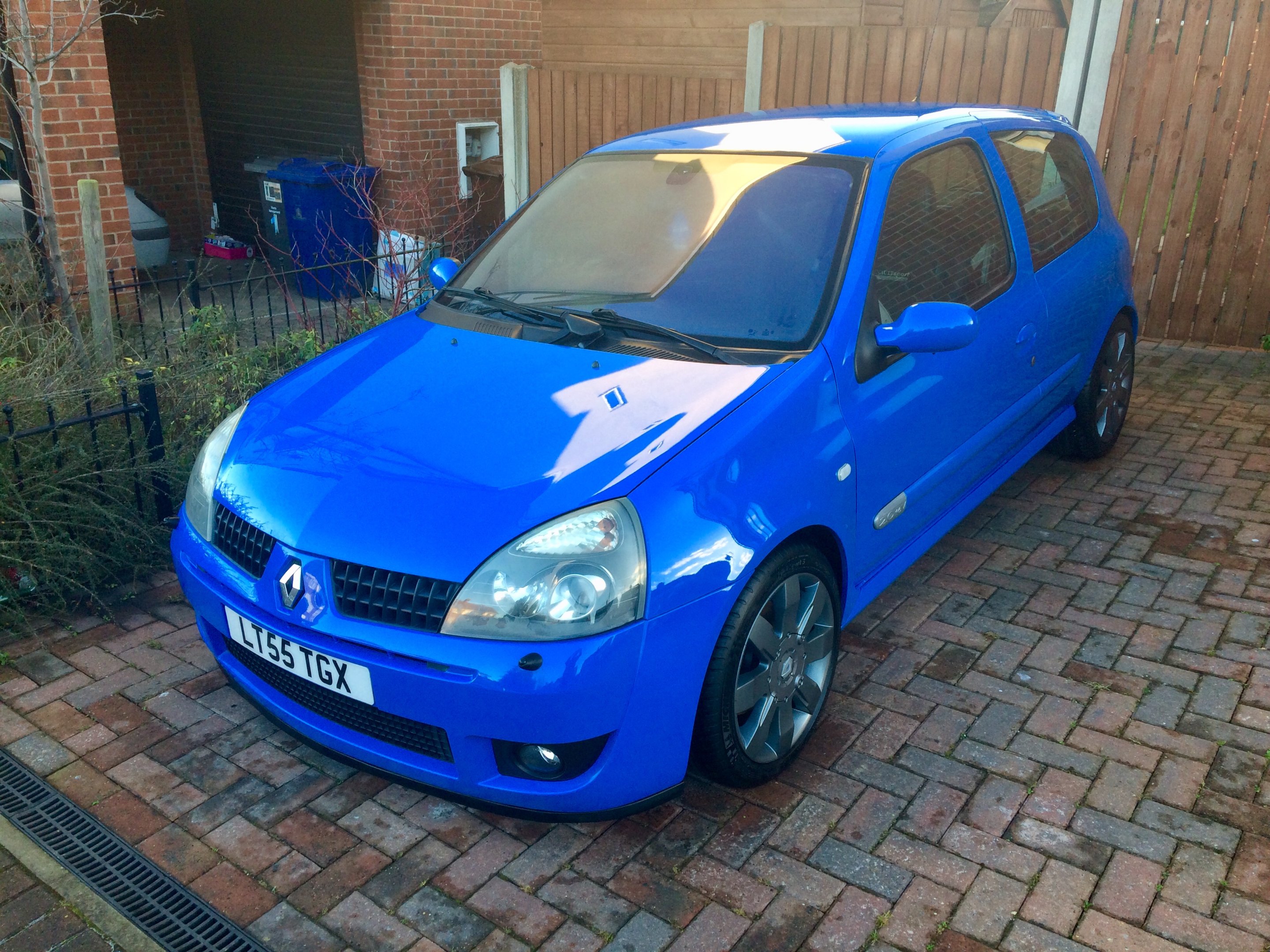

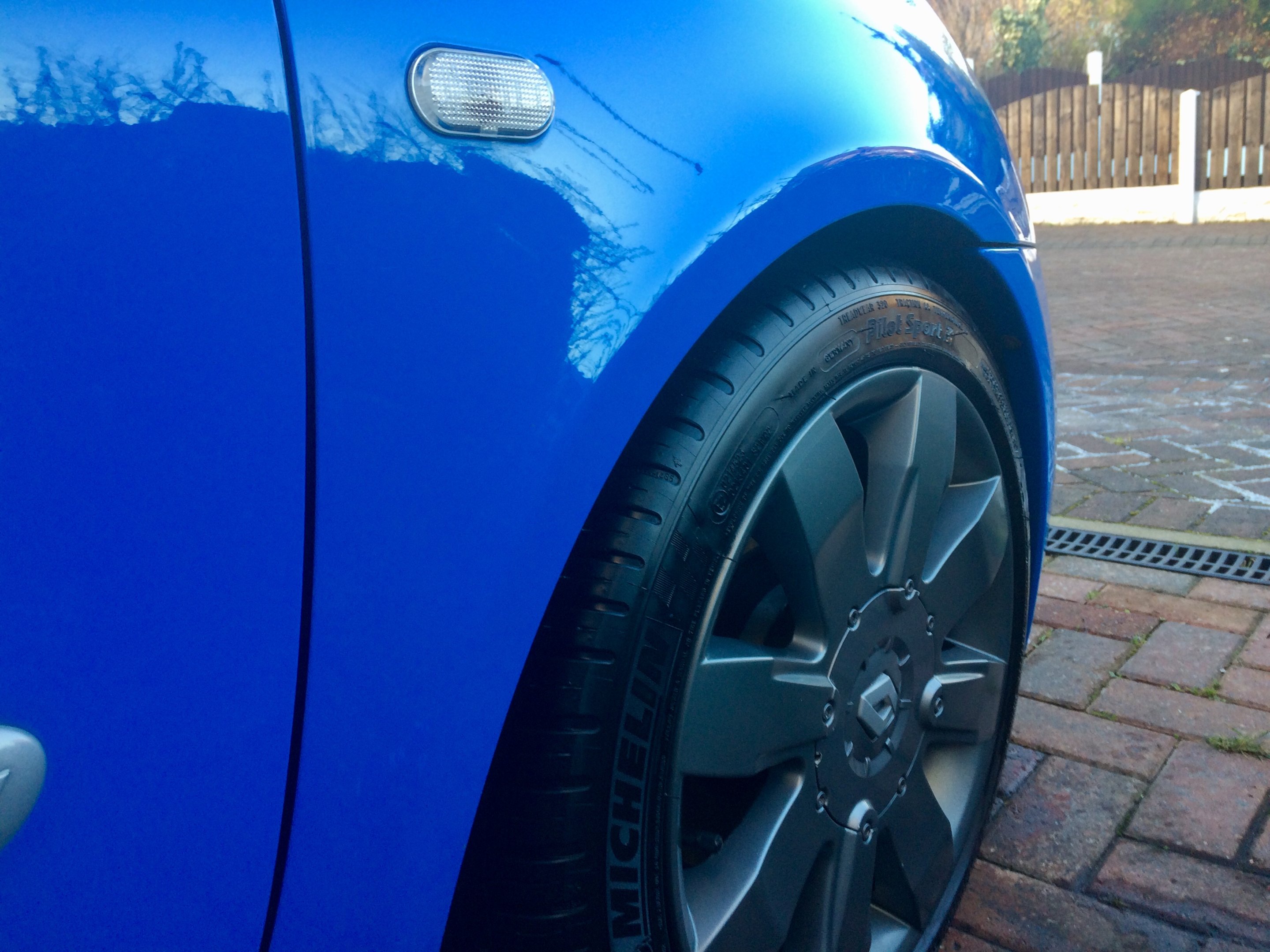

Okay so my turn to join in the spacers chat.
Car is Cup packed, with et38.5 Turinis and Eibach Sportlines.
Tyres are 205/45/16 Michelin PS3.
My initial thoughts were PMS 10mm axles for the rear and 17mm hubcentric S for the front. However I hear the scrub at the front with this setup. I can’t be doing with scrubbing, so any other thoughts or do I sack off the spacers idea altogether?

You could sack the front spacers off, or swap to 195 tyres on the front. I have 16mm front spacers with cup pack, 38.5 turini's and low on coilovers and don't scrub on 195 rubber.
Tyres are almost new so not up for ditching those. Plus I don’t want to drop tyre size as that’s a backwards step in performance to my mind.
My concern is the fronts scrubbing on full lock.

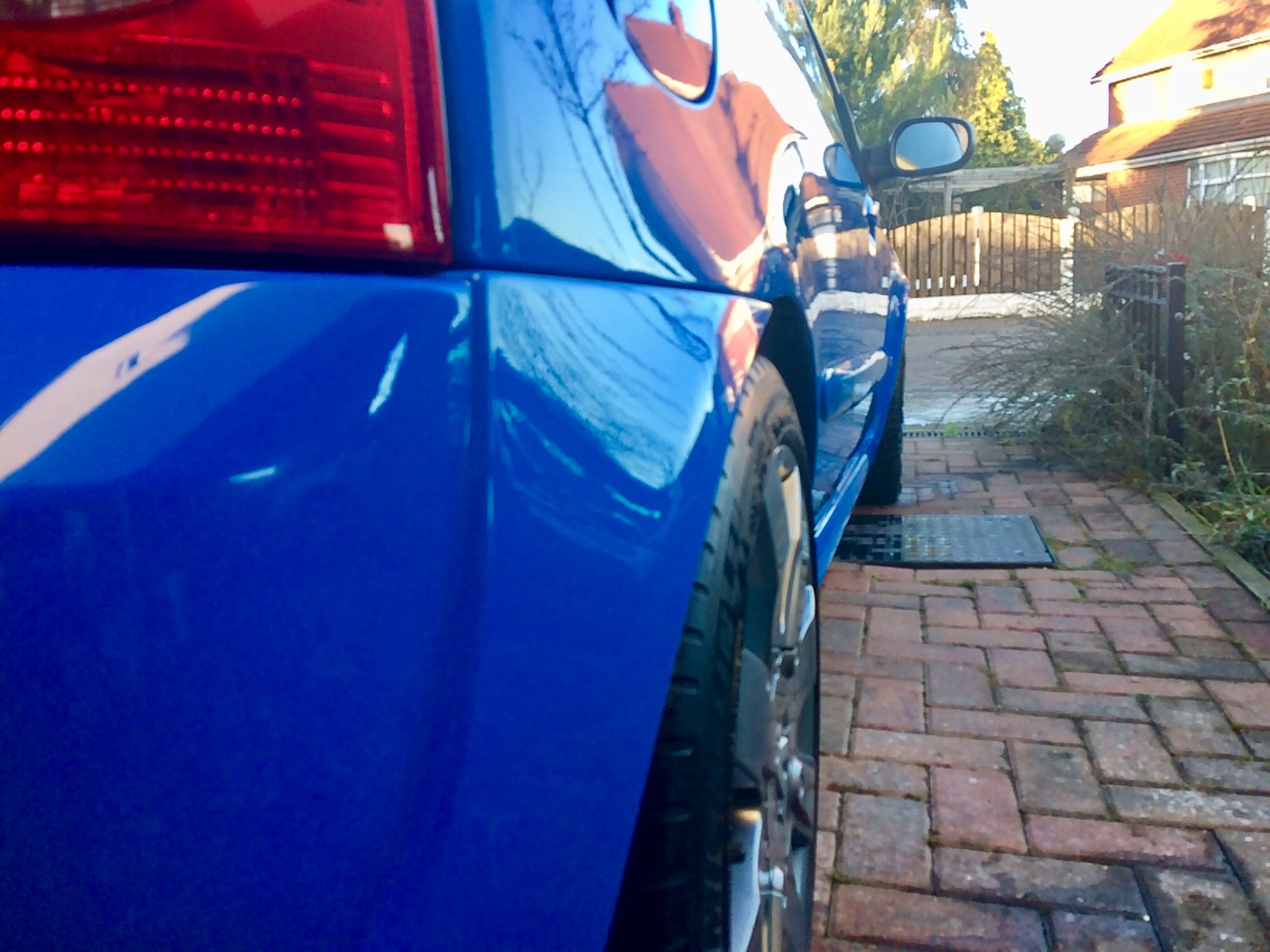

I was cleaning the 182 today and for the first time in 8 years of ownership I thought "f**k me this car needs spacers..." I don't know why but it looked odd to my eye today... :unsure:

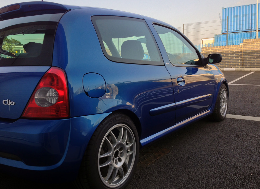

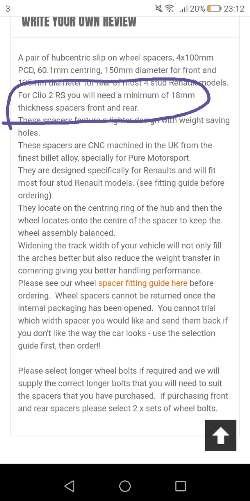

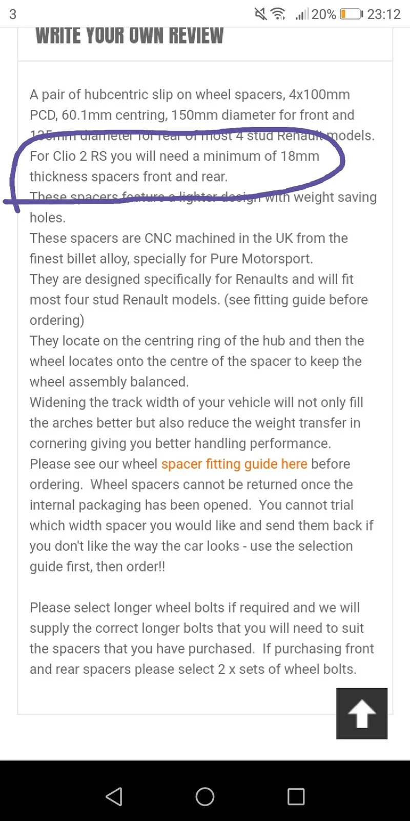

It's a cup packed 182 on Eibach Sportline springs, can anyone confirm or have pictures of the Pure motorsport 18mm Hubcentric spacers fitted with the factory cup wheels? I emailed pure motorsport and they suggested 18mm all round but I just wanted to see what you guys thought... Car is just a daily and not driven hard at all really, it's purely a cosmetic thing for me.....
Cheers, Gaz.
Not sure I'd put 18mm on the rear. Think I would prefer 10mm hub spacers for the rear over wheel spacers. 18mm also seems a tad much?
Up front the 18mm will be good though.
I agree. I put 20mm hubcentric spacers on the rear of my 172 Cup with standard Turinis and it doesn't look quite right. Planning to swap to 10.0mm hub spacers

Maybe I misunderstood then, I'd still like to have 2 people in the back if needed as well, does that make it not possible with some spacers on the rear?! I'm only looking for a quick bolt on job so hub spacers doesn't flait my boat to be honest Dr Jekyll...

Yeah? I just took the dog out for a piss and had another quick look and I never realised how tucked in the wheels actually are...!!! It could be because I've just fitted aftermarket winter wheels to my old man's Volvo Xc40 and they are 11mm further out than stock and mannnn does it look good.... :cool: Maybe that's what's done it to my eye..... :unsure:
Also mentions 18mm here, not really sure what it means...
I originally tried fitting 15mm hubcentric spacers on the rear but they do not sit flush against the hub. The centre boss in the spacer isn't deep enough to accommodate the circular central lip of the hub. That's why I ended up buying 20mm hubcentrics instead - but as mentioned above... IMO these don't look right. But no problem fitting 15mm hubcentrics on the front... and they look right...!

Do you think the rear issue is why they are stating 18mm requirement?!
