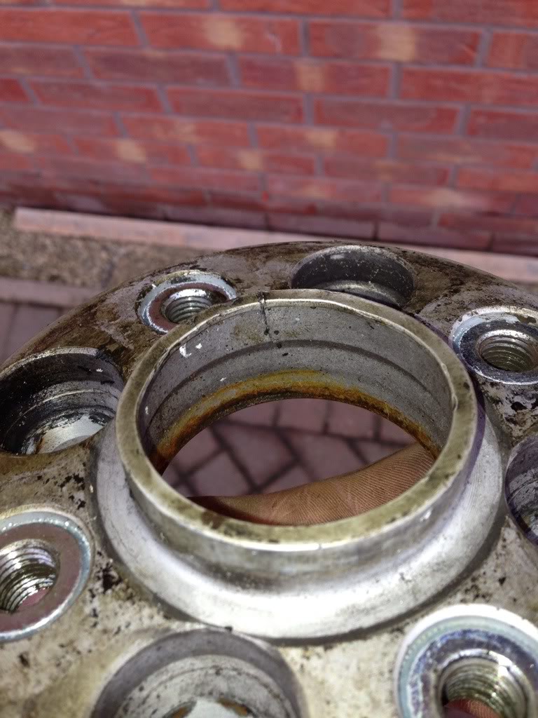

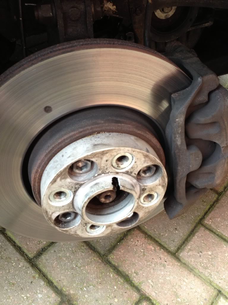

A 17mm socket fits round the spacer bolts so did that with a breaker bar come straight off where as I was using the Allen key socket to try and get them off,, anyway here's the pics ones worst than I first thought..
And the crack in the other one
These were brand new eibach spacers so no cheap crap
HOLY s**t! I'd be on the phone to Eibach demanding a refund. That looks slightly bigger than a crack.
When I noticed it first it wasn't that big but that's shocking I'll be into them first thing tommorow and be emailing them pictures can't imagine they will rush to deal with me though
hard to tell from the second pic, but if the crack doesn't run all the way through they would still be usable no? (at least until you get replacements...)
aslong as it is only the 'spigot bit' that is damaged, because that is mainly for locating the wheel bolt holes when putting wheels on no? (it appears as though that is the only bit that is damaged to me)
surely same as running wheels without spigot rings that have a slightly larger centre bore?
Spacers are not something you "Need" to drive a car, So i wouldn't be running them if in any doubt. It's a massive crack.
So you don't think that's too bad :/ ...to me it's shocking
ah no, fair play, was just saying if he wanted to continue running them until the replacements got there it would only be do-able if it was only the 'locator/spigot' that was damaged
dan: not saying its not bad mate, just noting that it only appears that the 'locator/spigot' bit was the only bit damaged...
