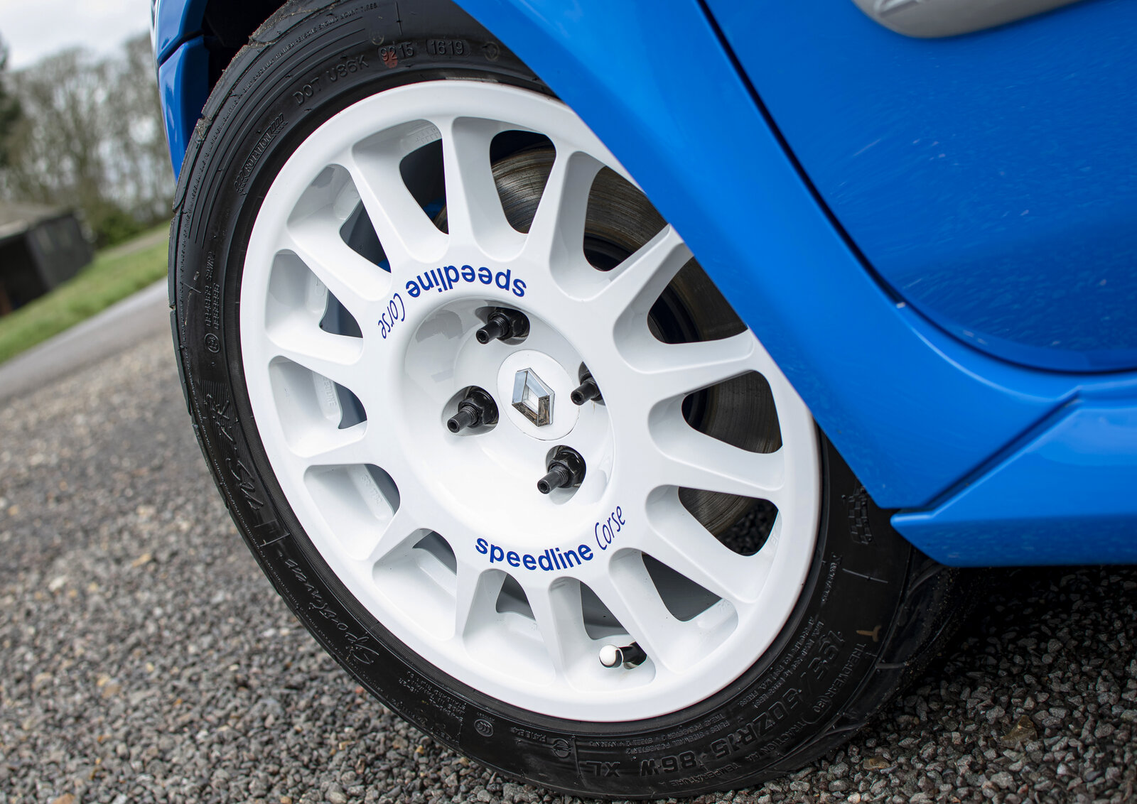

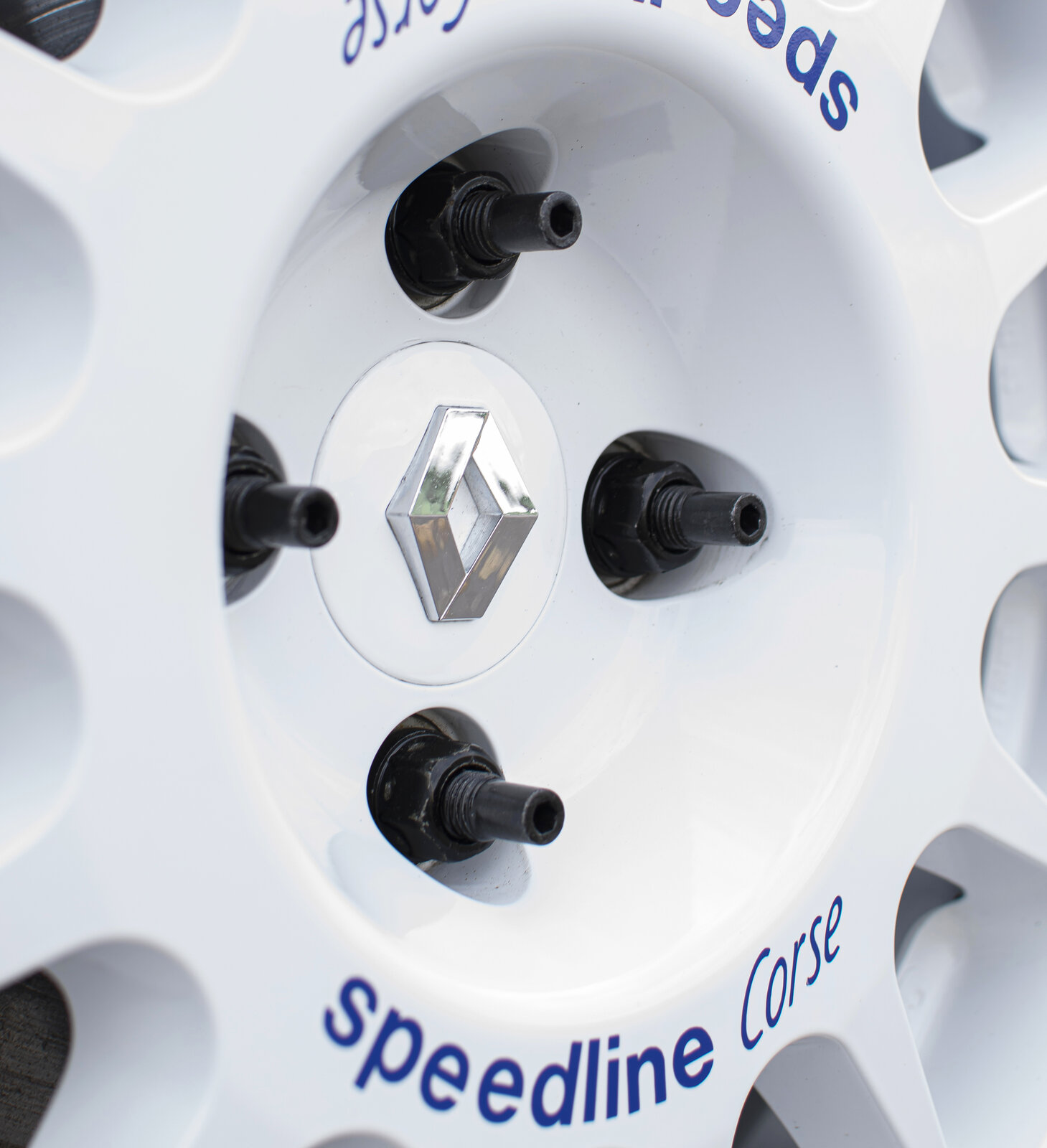

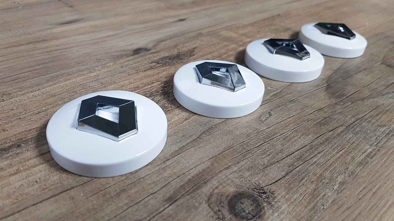

Made some center caps for my 2118s using some "Renault" caps off ebay and some 60mm x 2mm perspex tube. I measured the gap between the hub lip and the edge of the wheel, which is 9.5mm. I aroldited the rear of the caps in rings once the tube was cut at 9mm (wanted a little gap) Filled and flatted down, primed, flatted down again and the paint/lacquered. Once dry, I fitted them into the wheels. Came out pretty good and looks OEM I think.

Just my opinion, I like the white caps but think the silver diamonds clash with the wheels. Looking at the close up of the 2118, studs and nuts all Motorsport it just seems a bit out of place and a bit much.... But that's just me, appreciate the effort in going about making them.

I think I agree, the clash of OEM and motorsport for me just doesn't quite work. As mentioned though, mega effort and as ever fit and finish superb Mark

Obviously not taking away the effort gone into these, there will be a call for them for many a 2118 owner to cover the unsightly hub nuts at the front. To me Motorsport is about minimal, weight saving, and taking away the unnecessary, so the diamonds are fighting against that.

@Ricardos @Coops Mk1 yes I can see what you guys are saying. It's a tough one as if I had done them flat with no badge, they would have looked to plain and would "need something" in the center to break them up. The hub caps I ran before had various grooves in them so wasnt flat and that worked.
A few reasons I went down this route... i fitted new studs as i had 90mm already in my toolbox, but needed to run a bigger spacer so there wasnt too much stud showing. My hub caps pmsat out too far in my new PMS spacers. And I wanted to remove the rear 5mm spacer which would give me the same issue as the fronts.
I also have a silver badge on the front and rear of the car so felt this would work with the caps. Now that I know this setup works, I can have a go at doing a few more if I want, but I'll leave it for now.
