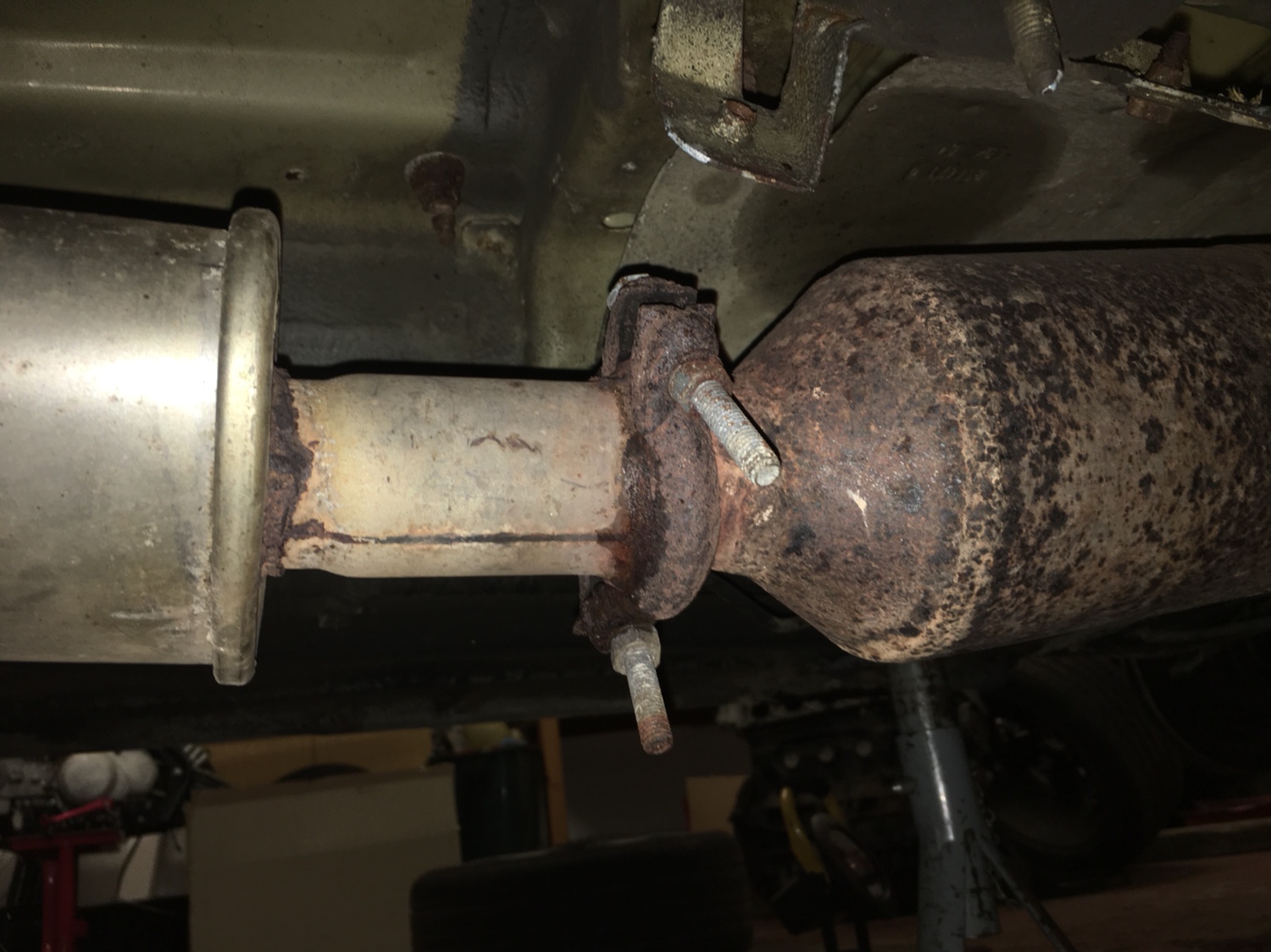

Hi all,
I have a bit of a blow where the mid pipe meets the cat.
The top part of the flange has corroded. Rest of the pipe is fine but its blowing here as its not sealing correctly against the cat.
Whats the best solution? Car is still on full standard exhaust which isn't actually in bad condition apart from this.

Got any photos? Is it the olive joint?
If so, get it cut and sleeved. If you Google 'cat mod 182' it'll bring up some photos of what I'm talking about.

It’s at this joint. I took this before I removed the clamp and seen the bit of the flange missing.
Yep, that's the olive joint, prone to leaking. Best way is to take it to a proper exhaust place and get it sleeved.
Or you could buy a new centre section, however you may still have the blowing problem as the joints aren't great.

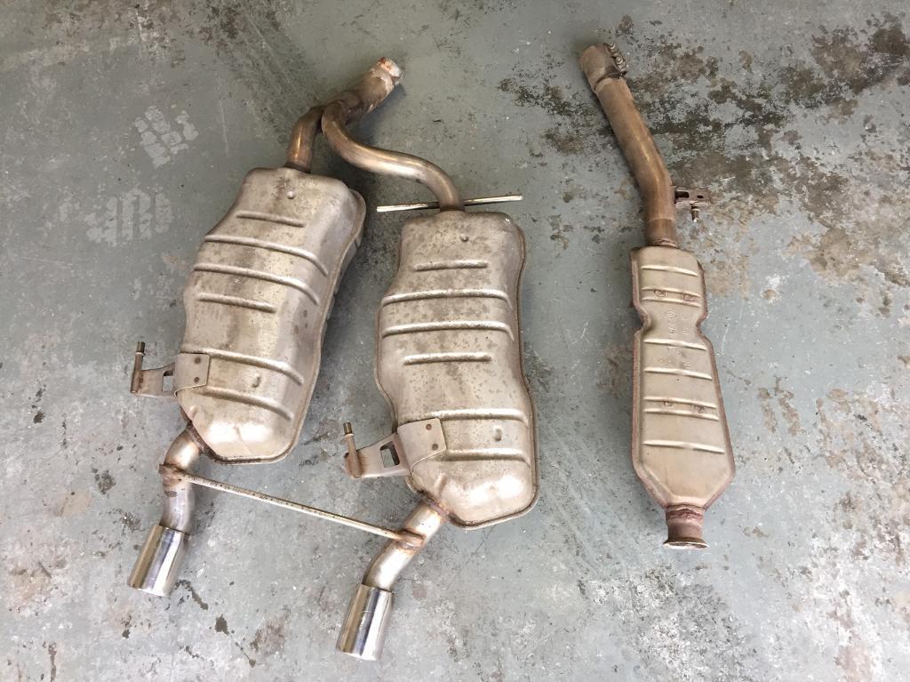

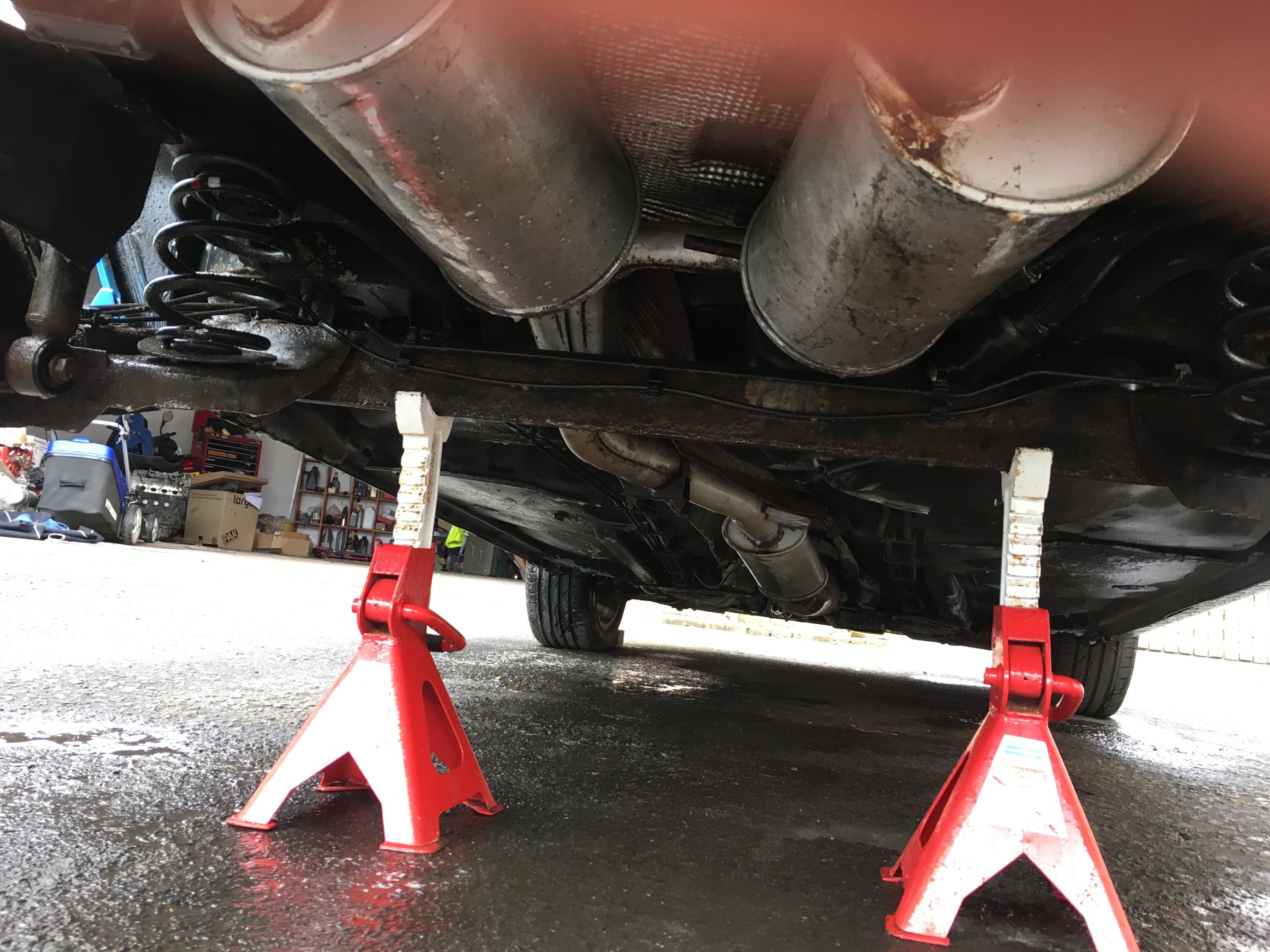

The blow has gotten worse as I can’t stop driving the thing since I got it on the road lol.
The standard exhaust is one piece from the cat back from factory? Given I don’t have a standard mid pipe means it’s been cut to suit the replacement?
So if I get a new replacement what’s the chance my existing cut in the back box will suit?
If I do replace the centre pipe and then the back box starts to blow then what are my options?

Drive down to an exhaust shop and they’ll chop and sleeve the joint for you. It’s common enough.
