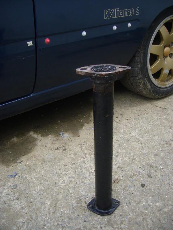

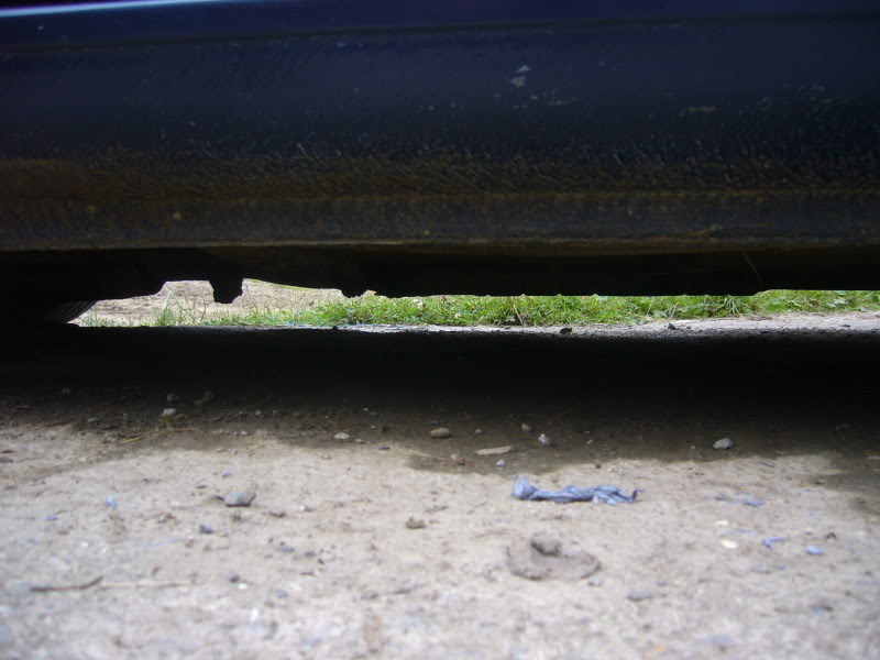

Ive ordered some paint,and new decals all round for later on. My firstr job is to take off the exhaust thats on it and do somthing about the ground clearance,I bodged together the cat and system thats there at the moment,it does the business mot wise,but hangs way too low for my lane.
Ive got a new standard valver system,which im going to add the extra williams hanger on (just behind the cat) and ive made up a link pipe as I have the very early predator stianless manifold which wont line up with a standard cat.

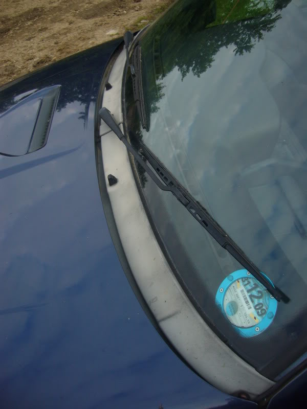

Next up is the scuttle under the front windscreen:
Its very faded,so thats coming off for a respray in black.Its making the front look very tired at the moment.

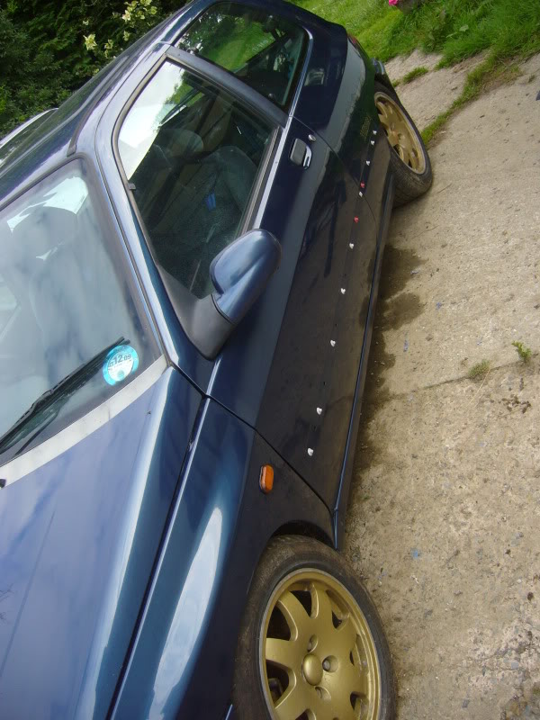

Just for the moment aswell im giving the car a quick polish...just a once over and not a full on detail yet! thats a way off.But il take the trim off and tidy that up too.

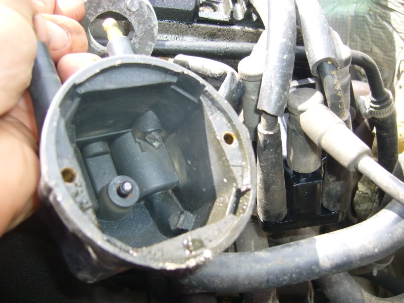

DuF wasnt ticking over too smoothly when I picked it up after the mot (thats the only time its been on the road since I started this again) so I have just fitted a new dizzy cap and rotor arm.....the old parts looked fooked tbh,so this should help.

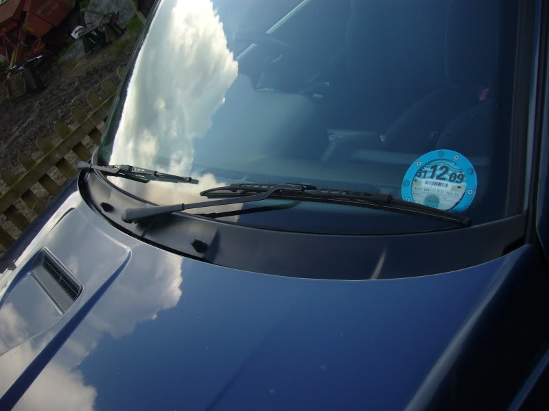

Heres the scuttle,repainted and refitted. Simple enough to do,but has made a nice difference:

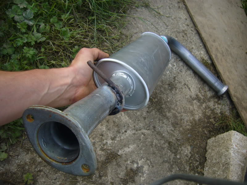

Exhaust is now on aswell,not road tested yet but it sounded sweet enough on tickover. Its a standard copy part(a cheapy) valver system,Home made de-cat pipe and stainless tubular manifold.
Heres the extra williams Hanger I had to weld on:
as far as I can tell,thats the only real difference between that and having a williams standard part. Was going to be hard to get a copy williams system at a sensible price without going to a dealer,so I went down this route.
