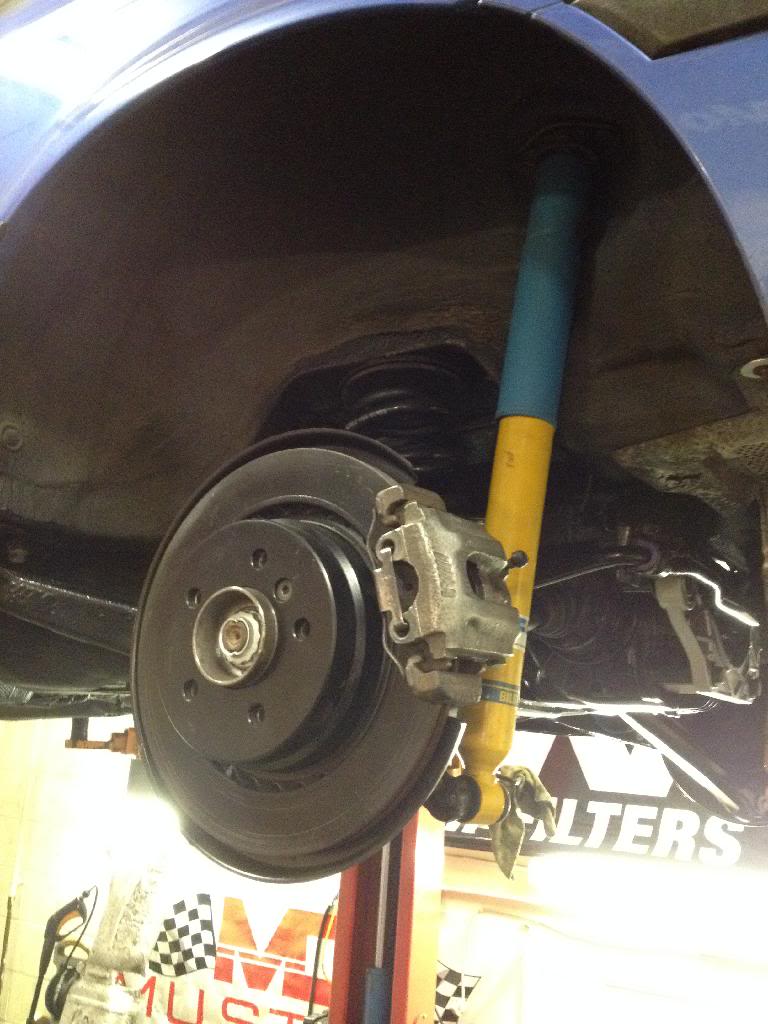

Ive currently been gathering parts to start on the car.
Currently have :
New rear discs and pads (G172) :approve:
original cup turinis (will be re furbed by Russ at midlands car care shortly)
vmaxx coilovers
front and rear strut braces
new engine cover
new filters and oil
new leads
new coil pack
ive also bought myself a powder coating set up and new compressor and shot blast cabinet for When I start stripping the car down.

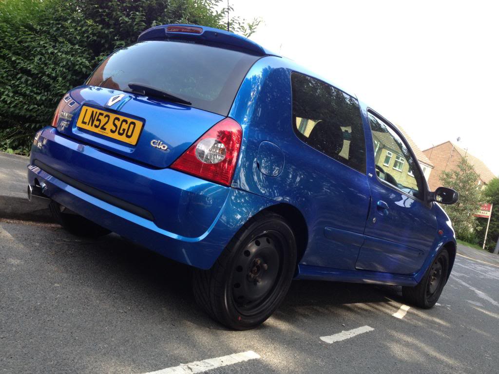

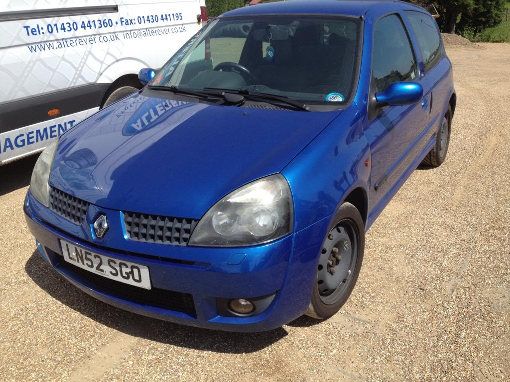

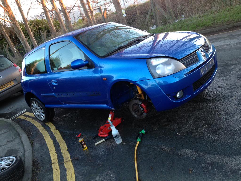

This is the car when I first went to see it. Looking a bit sorry for itself
So as soon as I got it home it was washing time to see what was underneath the grime and dust
Not to bad overall. Some bad scratches and a few dents but came up pretty well

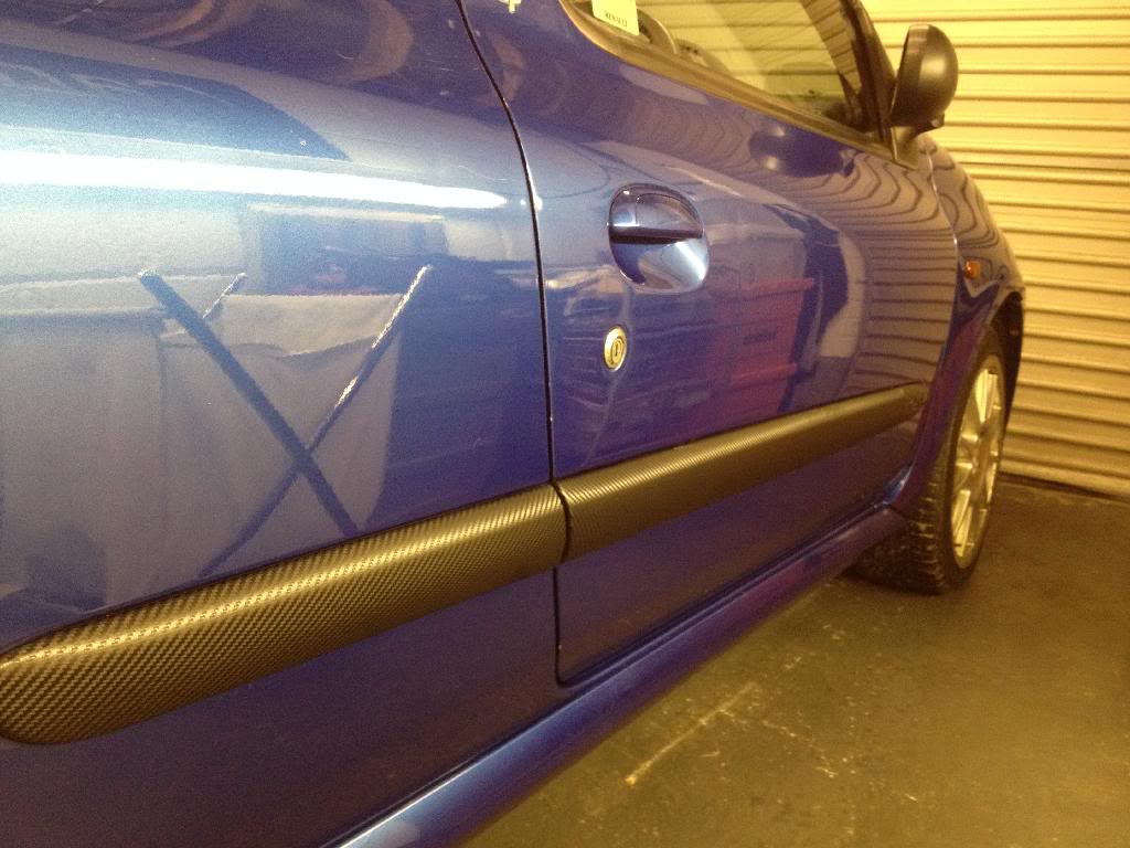

I also wrapped the side mouldings to see what I thought. Still not sure on these.
Think I might get them re sprayed the original blue.

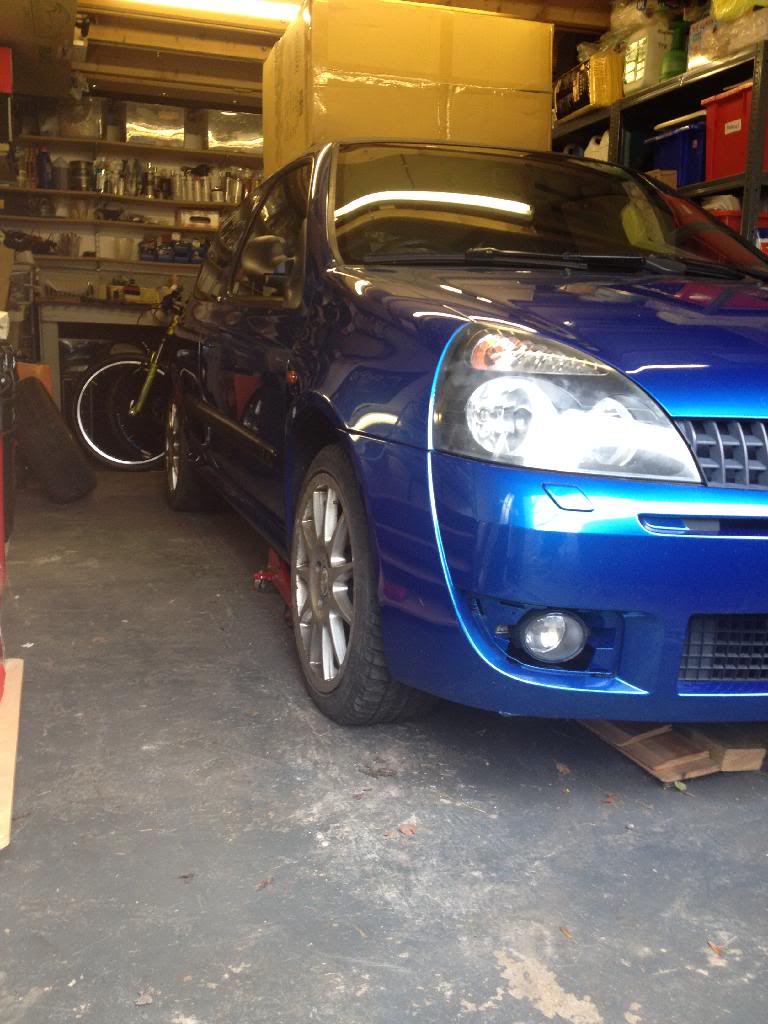

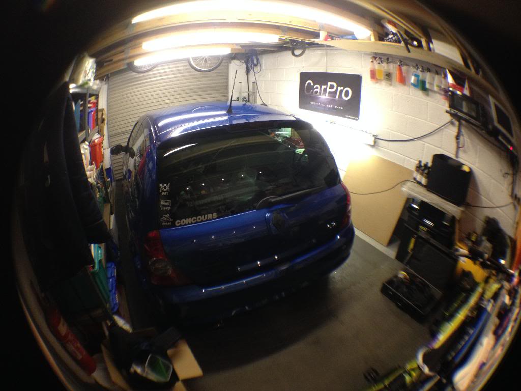

This is where the cup is currently hibernating over the winter

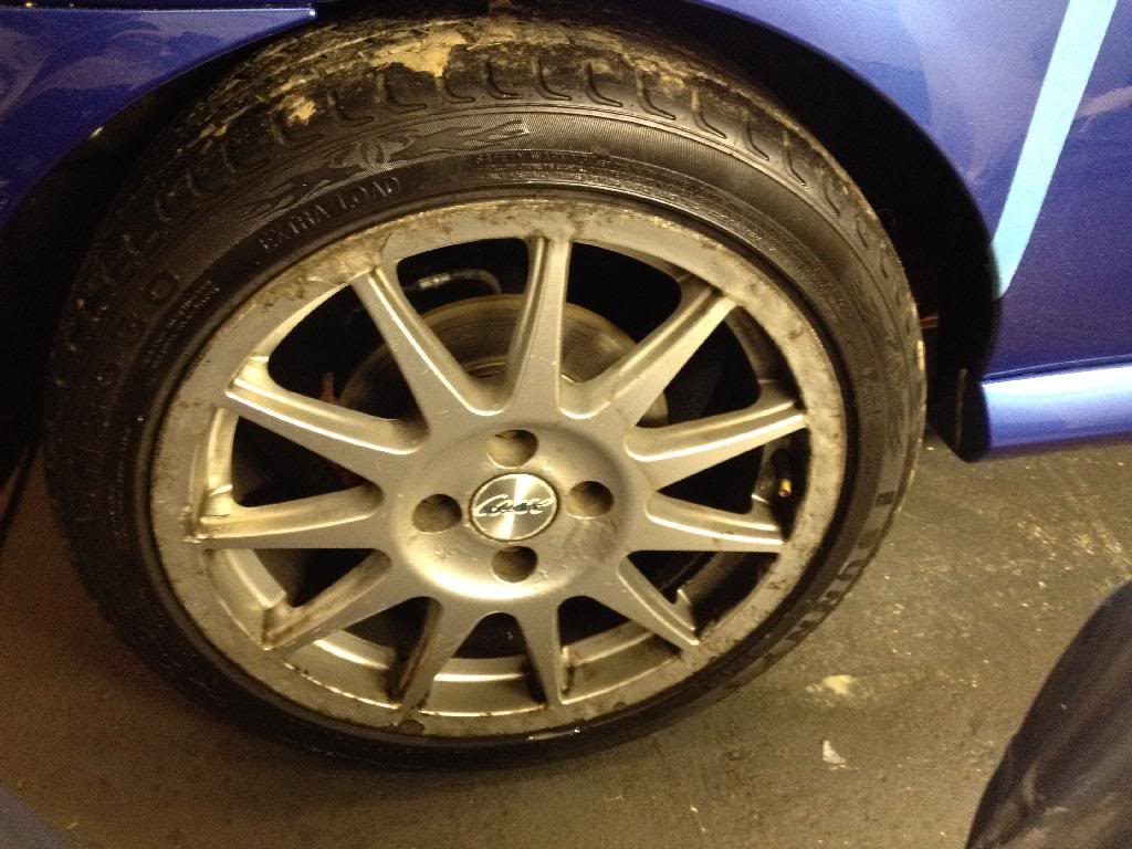

Got my turinis fitted on the car.
As you can see they need quite a bit of work! Also they are fitted with a worrying budget brand tyre. I certainly wouldn't drive it with them on.
195 45 16 recommendations are welcome by the way.
This is what the carbon wrapped trim looks like for now. I'm not sure whether to keep it like this or get them resprayed the original colour.

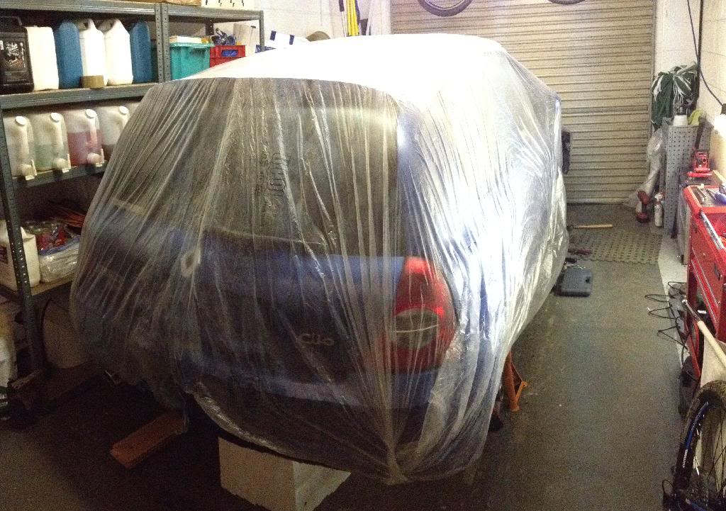

This is where the car is currently sat for the bad weather.

I'd personally colour code the side strips and get the turinis done in the brightest silver they have
Tyres wise the contisports contact they come with are decent and the Michelin pilot exaltos 2 are very good tyres ime.

I have Yokohama S drive because they are cheap. In the wet they do a job - you should drive to the conditions anyway and in the dry they are quite good. Don't make too much noise but after a trackday and 400 miles they are a bit fecked..
For £50 quid a corner I can't see you getting much better value. I'd rather screw them then PS3's or Contis. Something a bit more grippy for track next though

I got my Turinis refurbed recently, and the guy who quoted me said that the colour was called 'glitter silver'. I'm not sure whether that's the OEM name for paint or not, but it perfectly matches the original colour on the centre caps :)

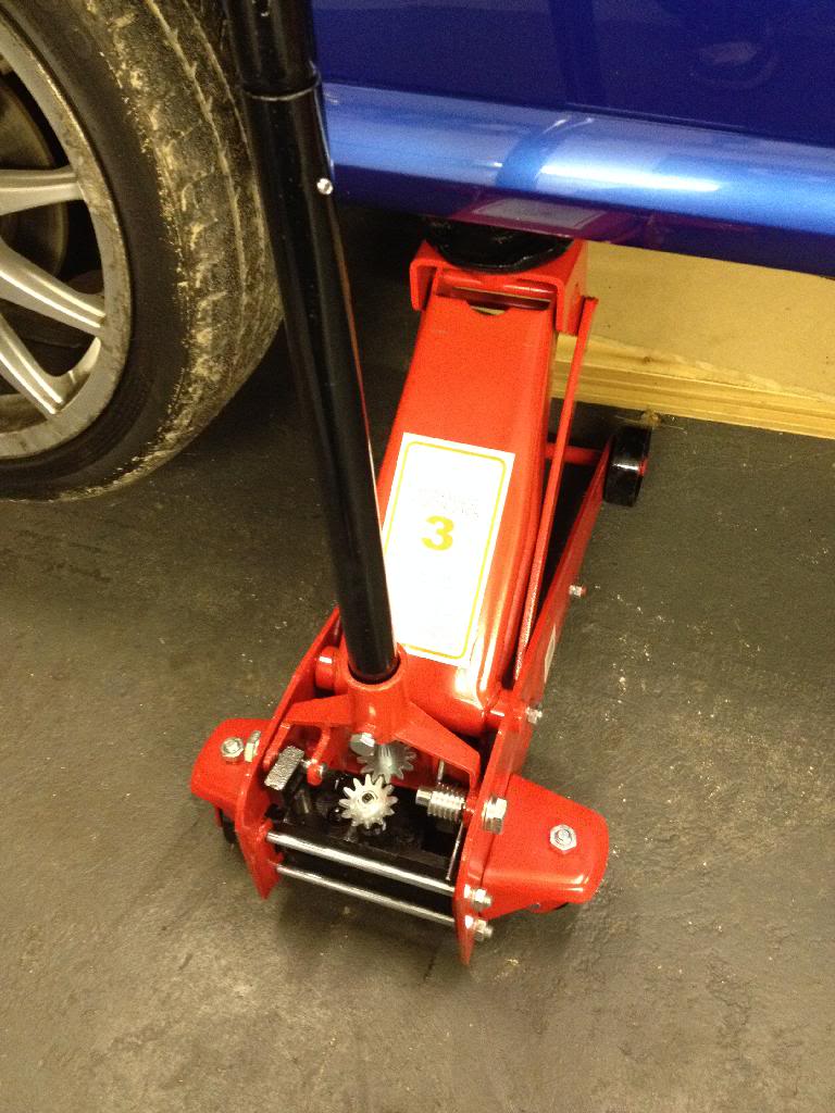

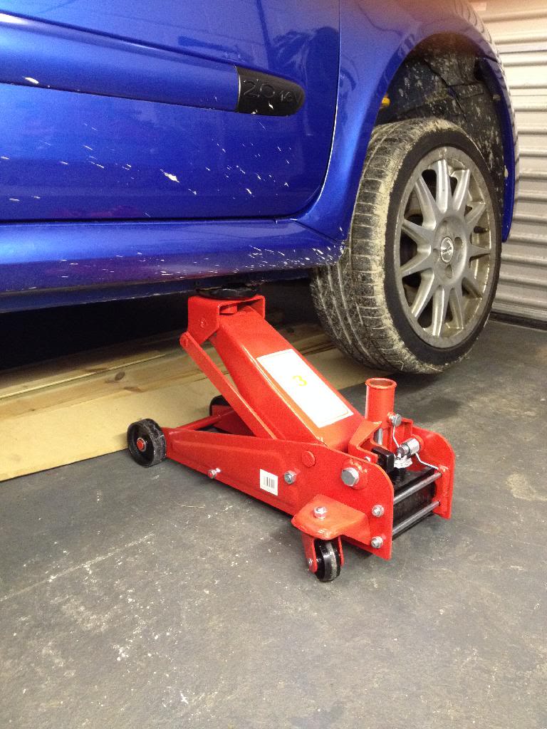

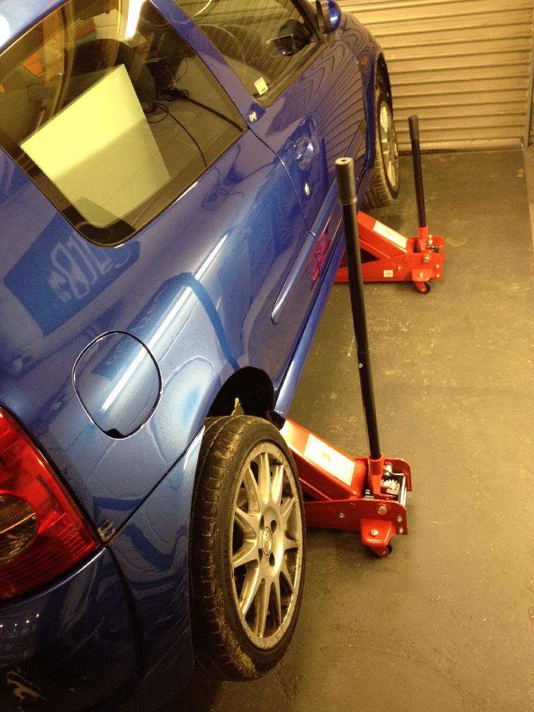

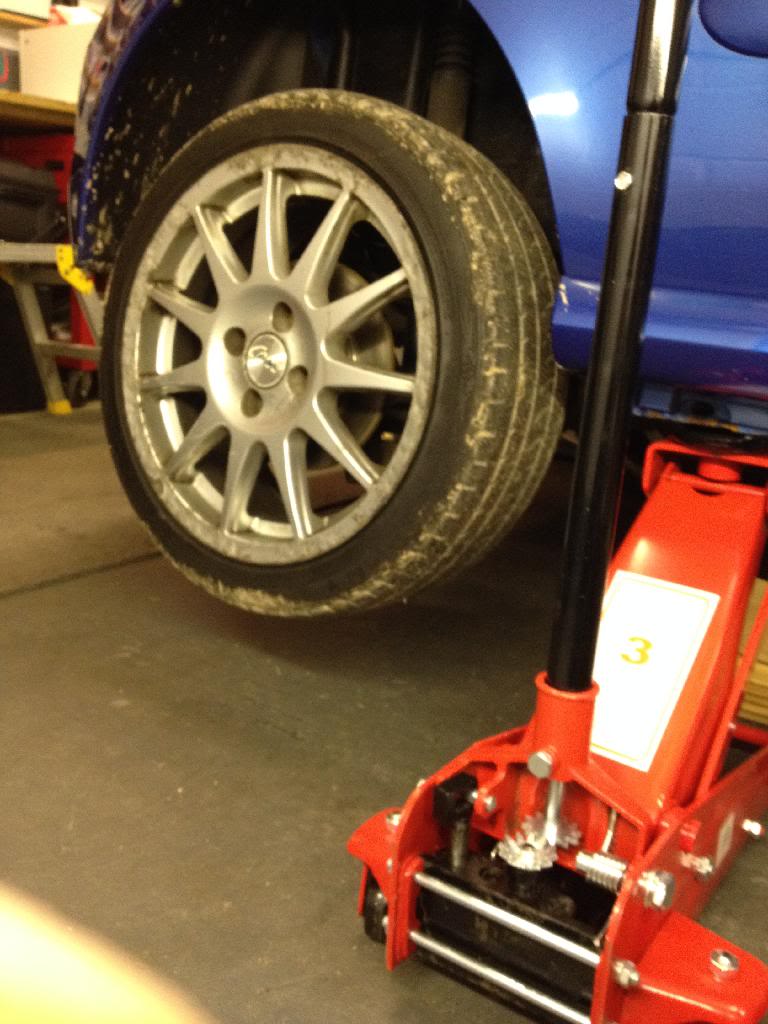

Also treated myself to 2 new jacks. Got them for a bargain price of £48 each!
They are 3t lift and a sturdy piece compared to your halfords type.
Lift stupidly high as well

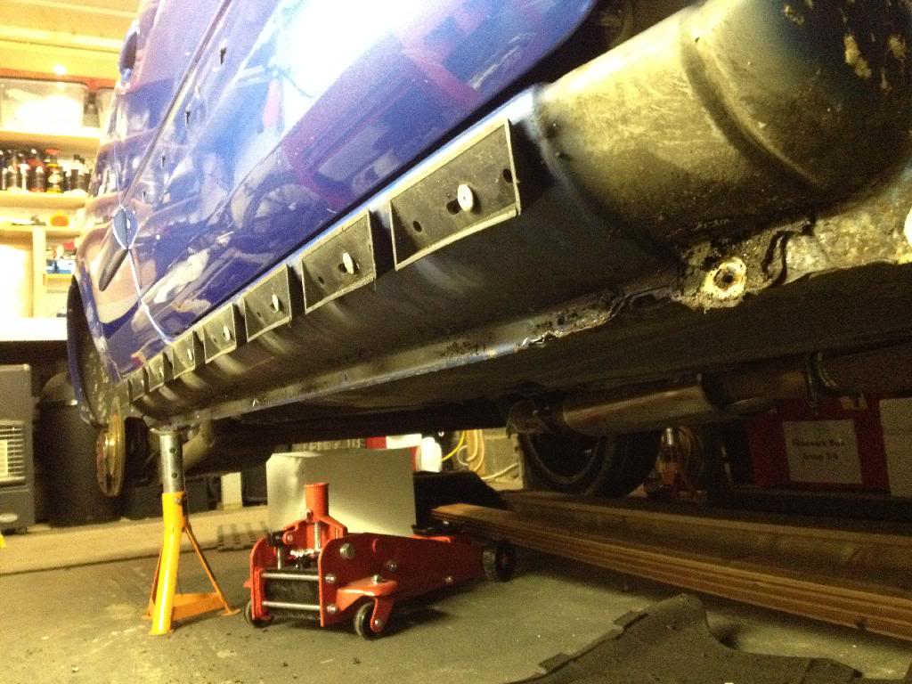

7/1/14

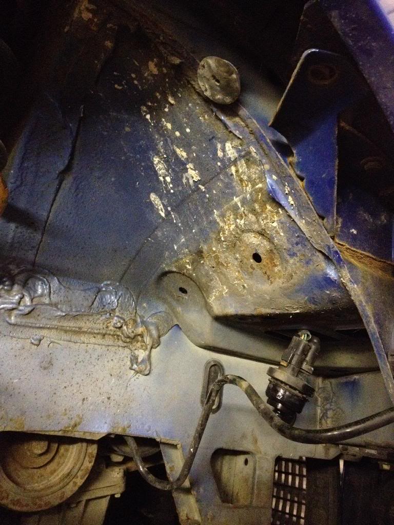

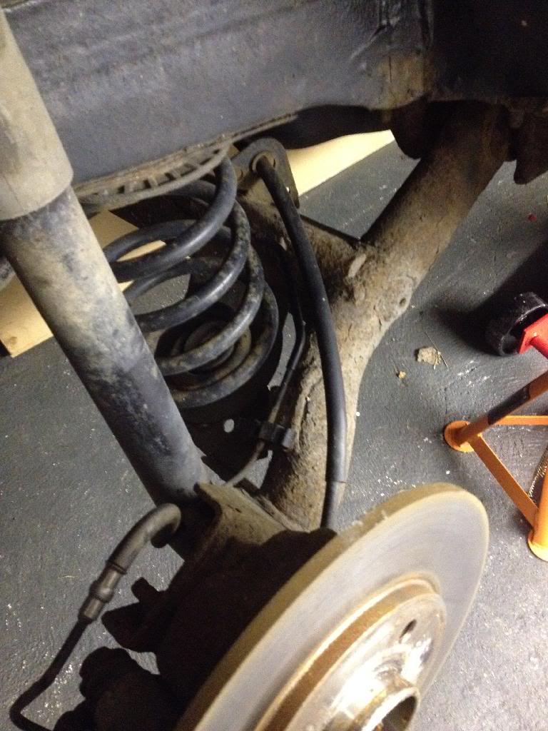

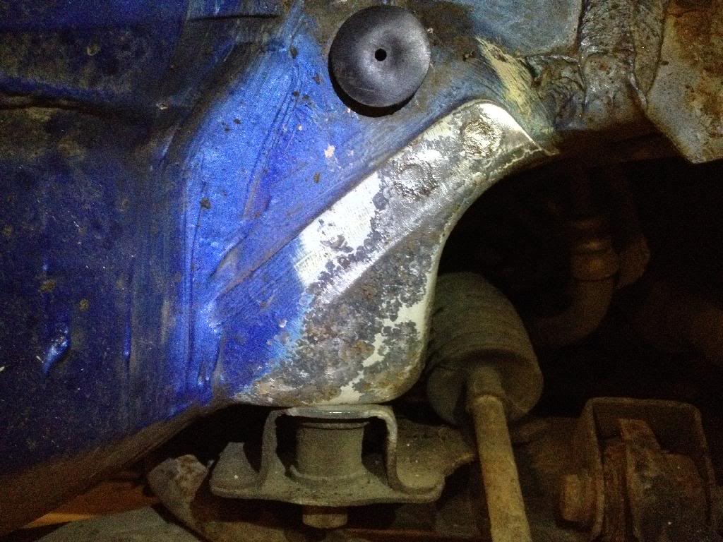

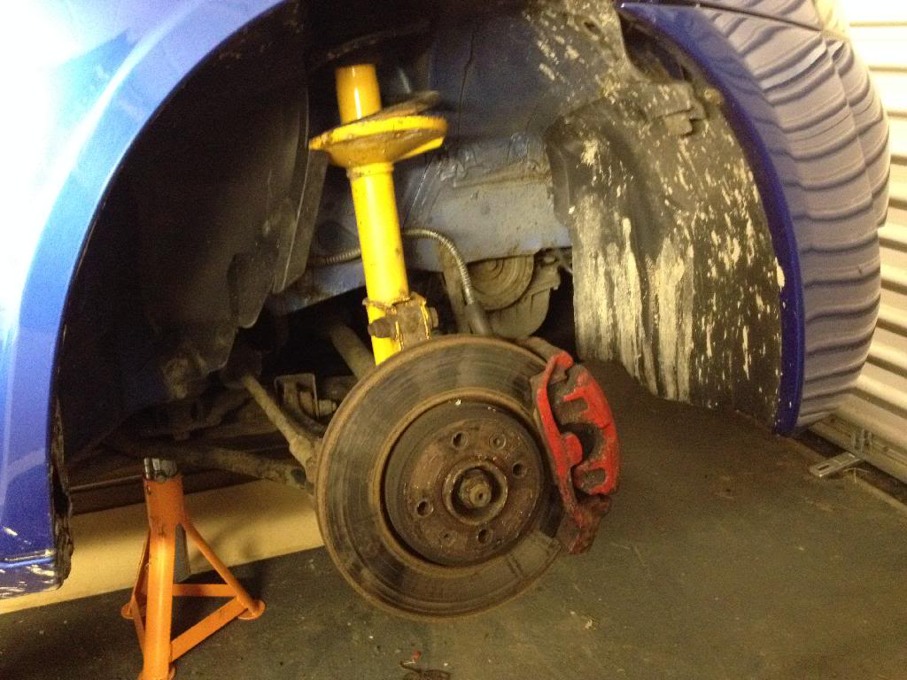

I'm starting by stripping the arches and running gear as I want to clean everything up and paint what I can and powdercoat the rest.
As you can see it's needing a good clean and paint.

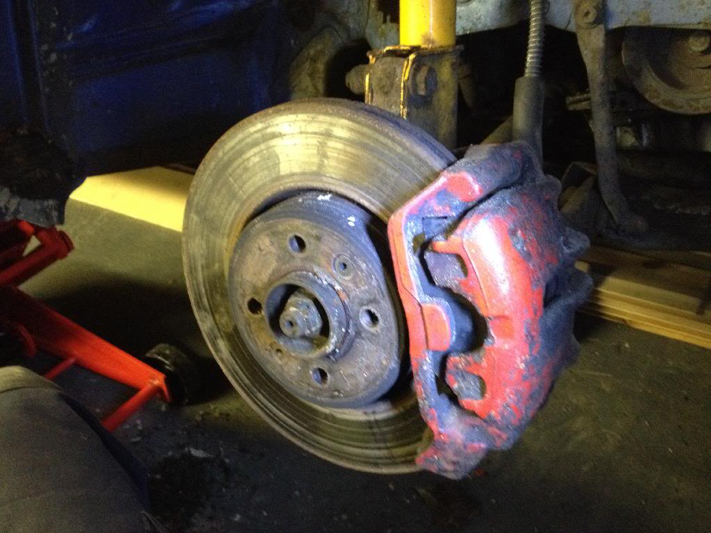

Calipers will be getting stripped blasted and powder coated then rebuilt with new seals etc as the rears are sticking slightly.

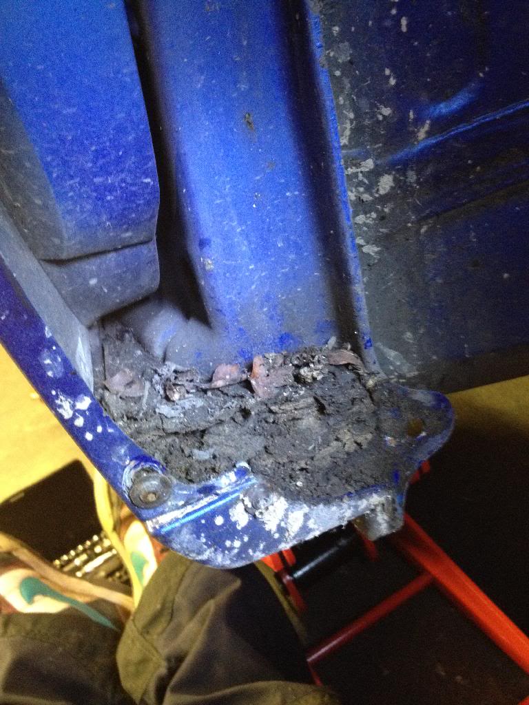

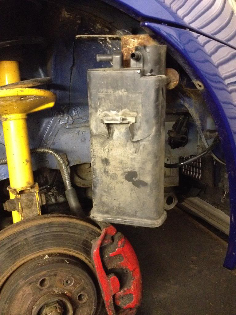

Stripped the inner arch lining so I can get inside the full arch to paint.
Couldn't believe how much crap was behind it!

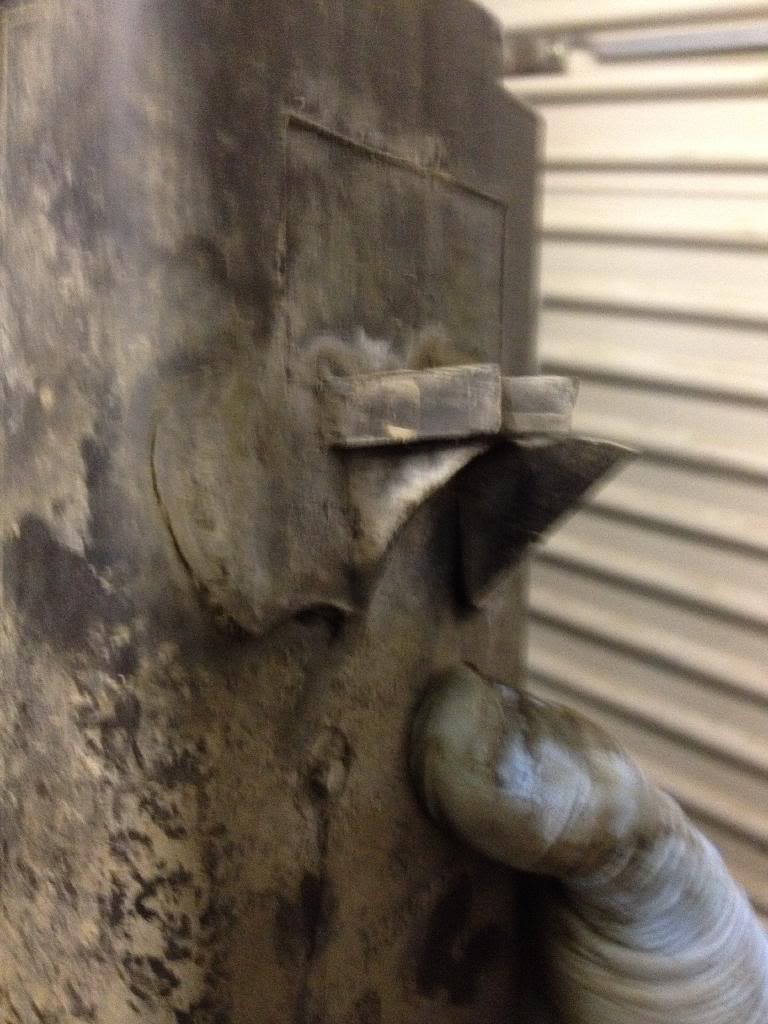

After I'd taken the crap out I noticed this
Had no idea what it was but now know it's a carbon canister purge valve. Catches fuel vapours
Unfortunately it's cracked and damaged though so a new one will be needed:wall:

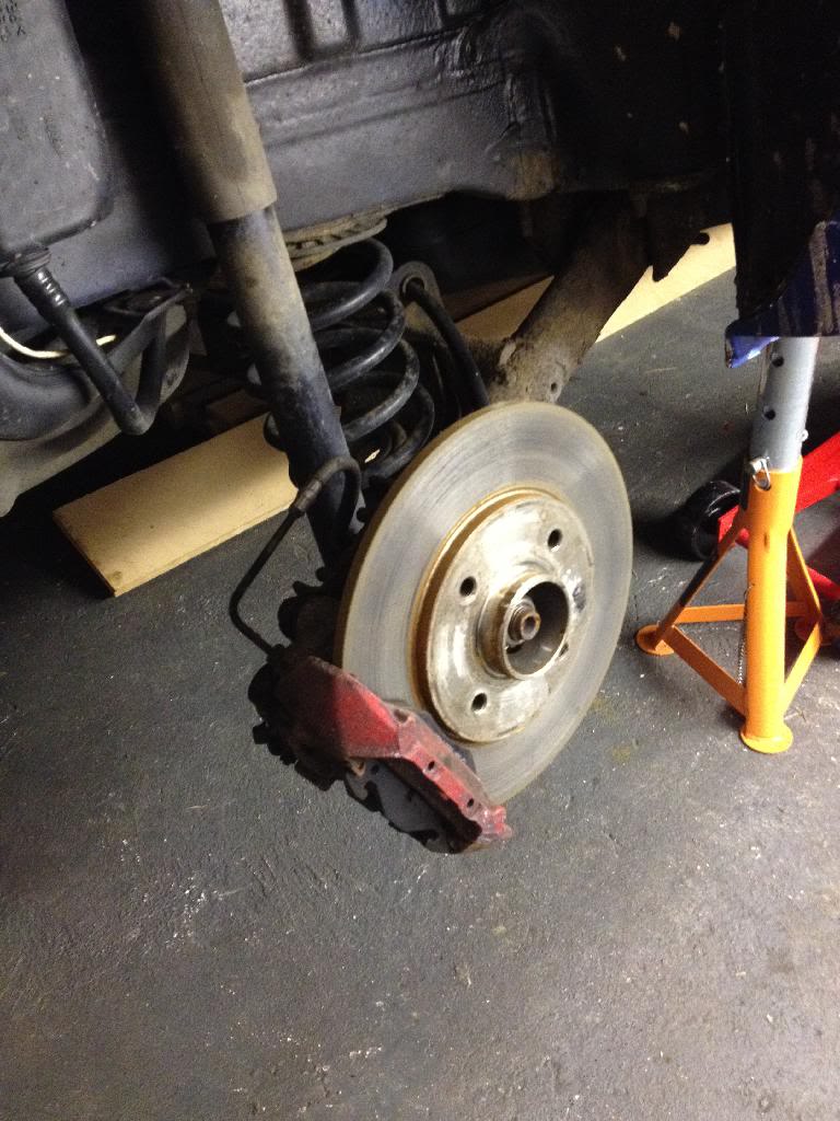

The rears are in pretty much the same condition and will need the same treatment

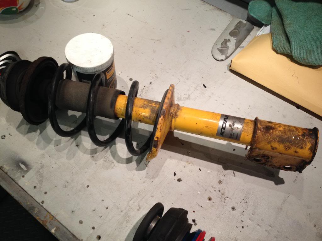

Update 9/1/14

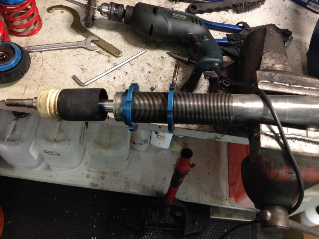

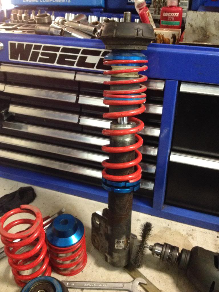

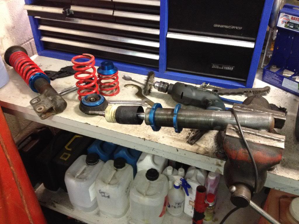

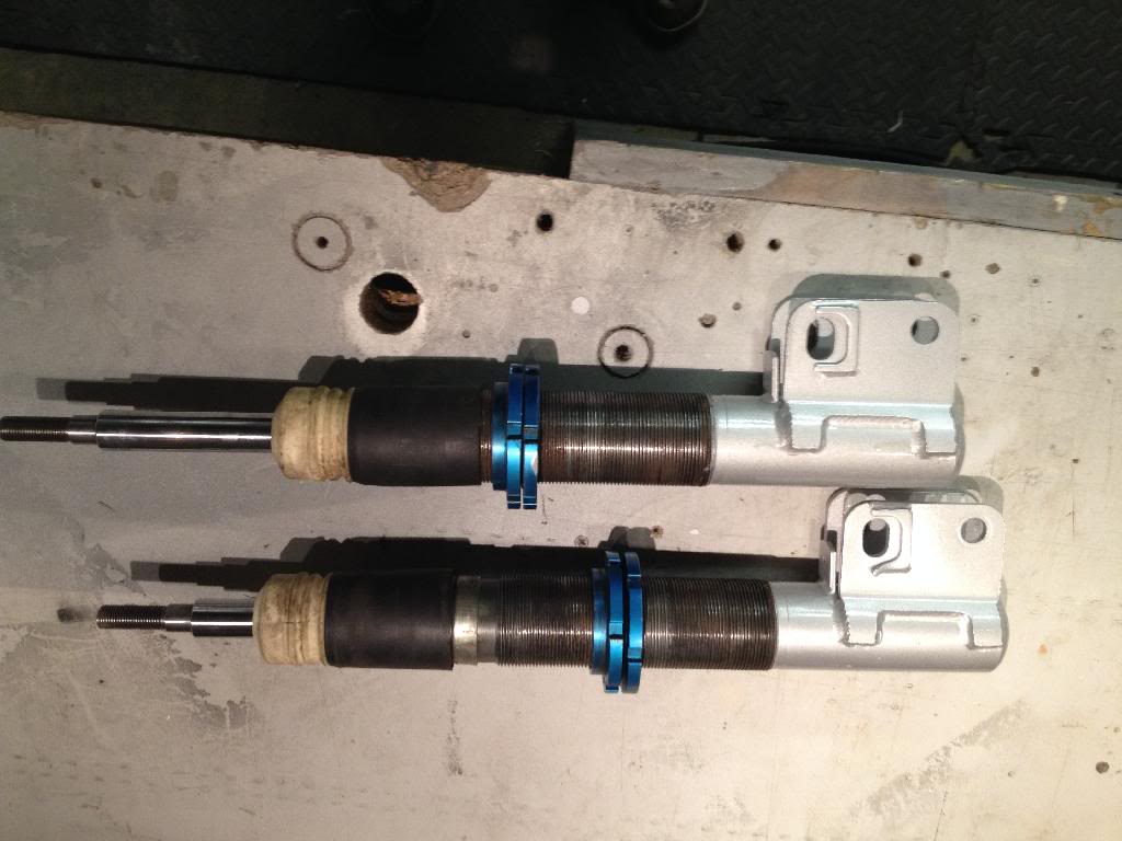

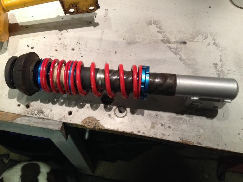

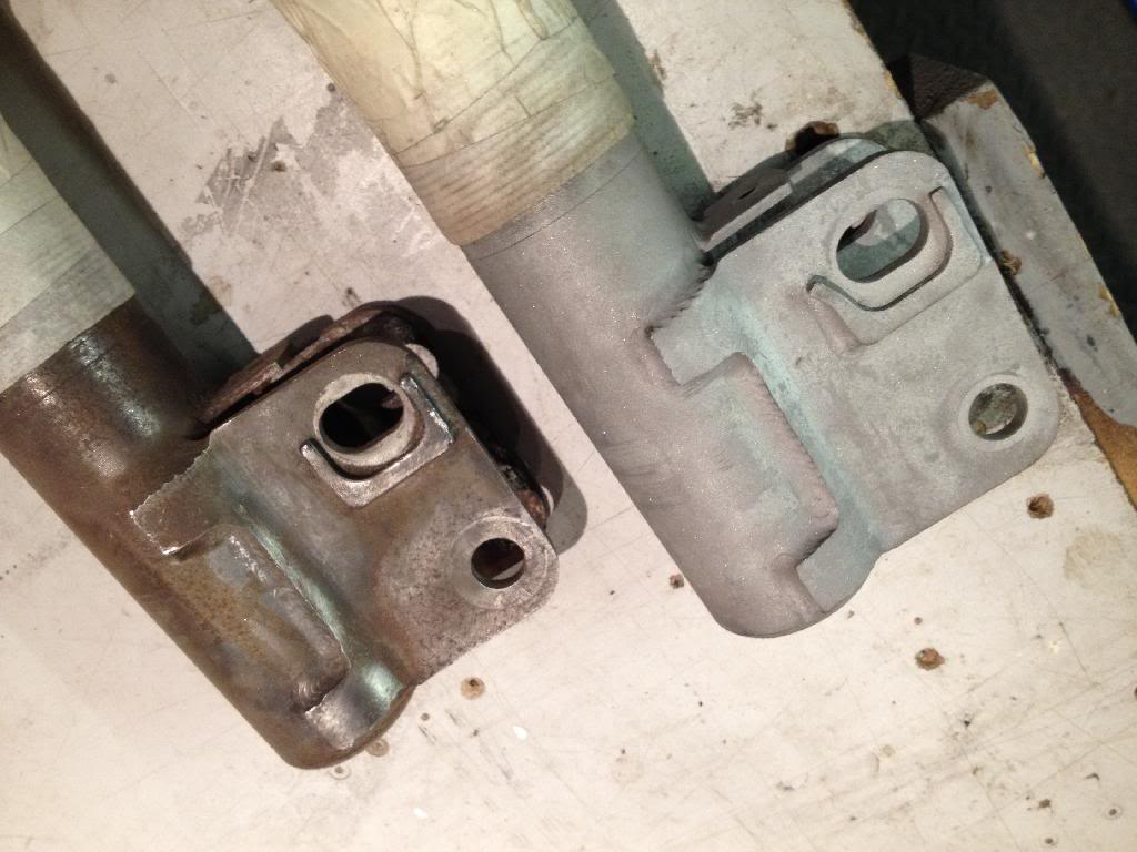

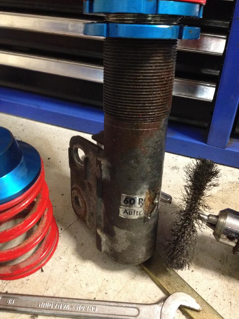

Was at my friends workshop yesterday and stripped my coilovers.
The night before I soaked them both in penetrant/ release agent
As you can see they are fairly rough in the threads
Got them stripped fairly easily due to the fluid doing its job
I used a drill and a wire wheel to clean up the threads and it worked a treat to get the corrosion out the threads
For the bottom of the unit I will be taping up the seals and then putting them in the shot blast cabinet to clean up before I paint them.

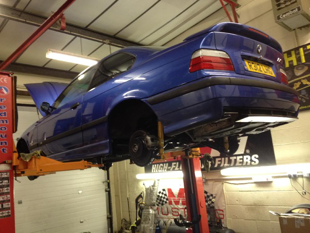

I also took some pictures of what the guys in the workshop are working on because I thought you all might like it b:thumb:
It's the owners M3 that is undergoing a full underbody rebuild and restore
New suspension, bushes, re painted etc. looks amazing so far.

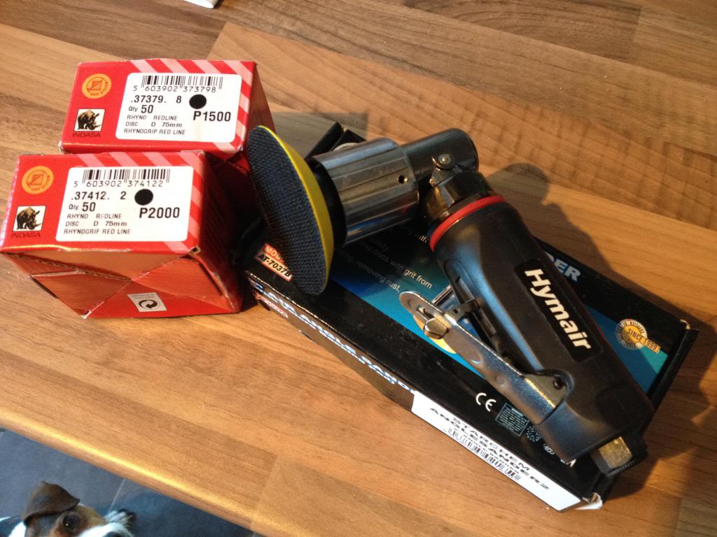

I also picked up a mini DA to do my headlights and some deep scratches on some of the car

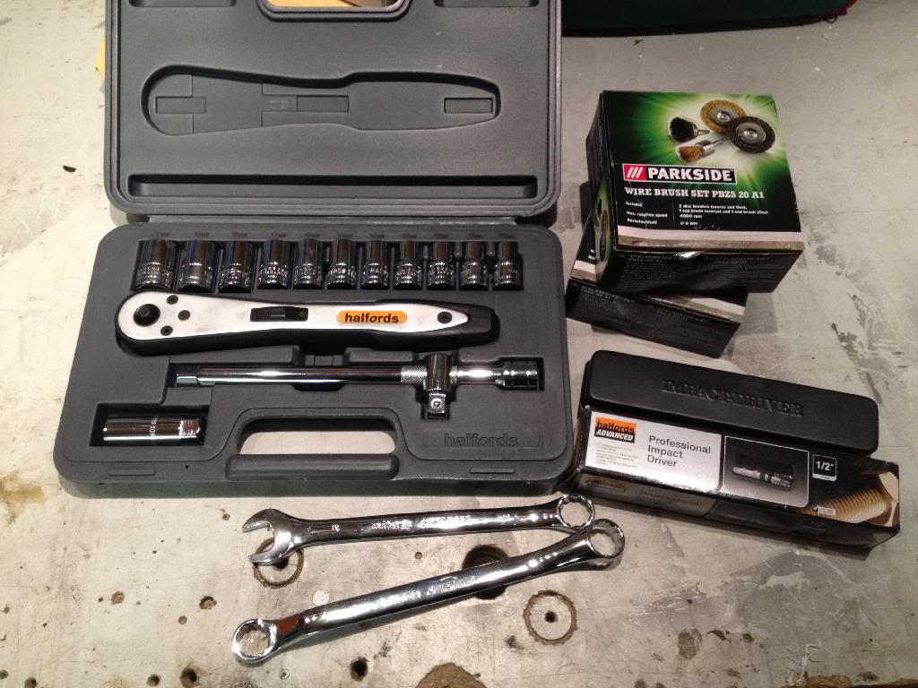

Went to my local halfords and Lidl today to get some more bits to carry on with the car
Socket set was a bargain at £8 and the drill was £14.99

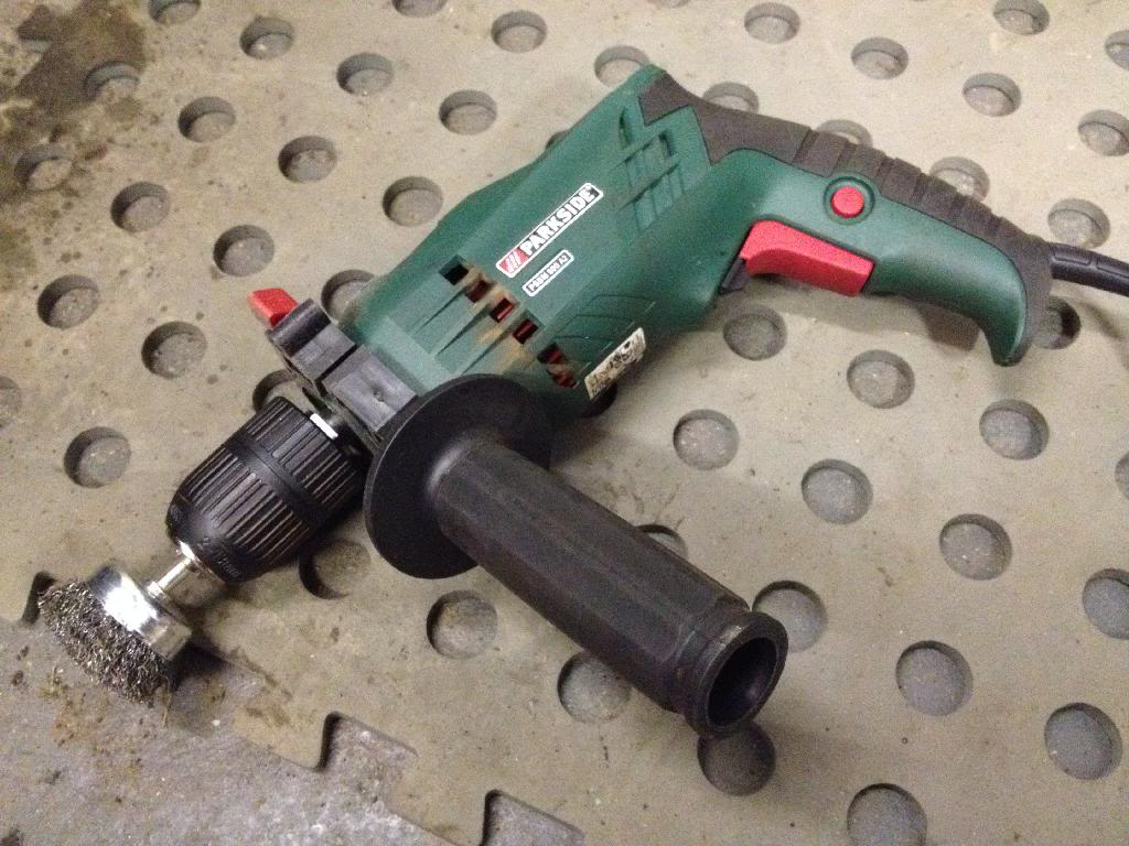

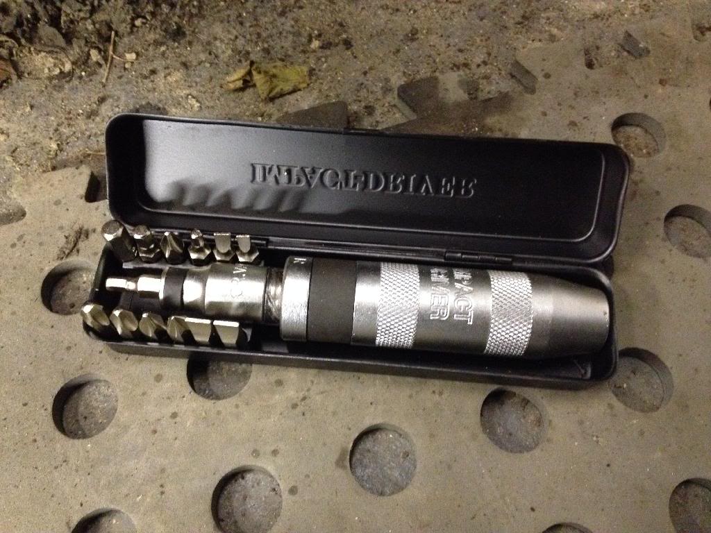

Also picked up an impact driver because there was no way the brake disc retaining screws we're coming out without it :doublesho
Drill works a treat with the wire wheels on to get rid of the surface rust

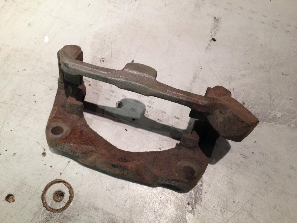

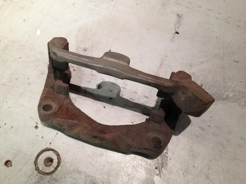

The hubs are fairly rough, will need to strip these and get them professionally shot blasted as they are a bit far gone for mine.
I've started blasting the caliper carriers
Will need another attempt but they are coming on nicely

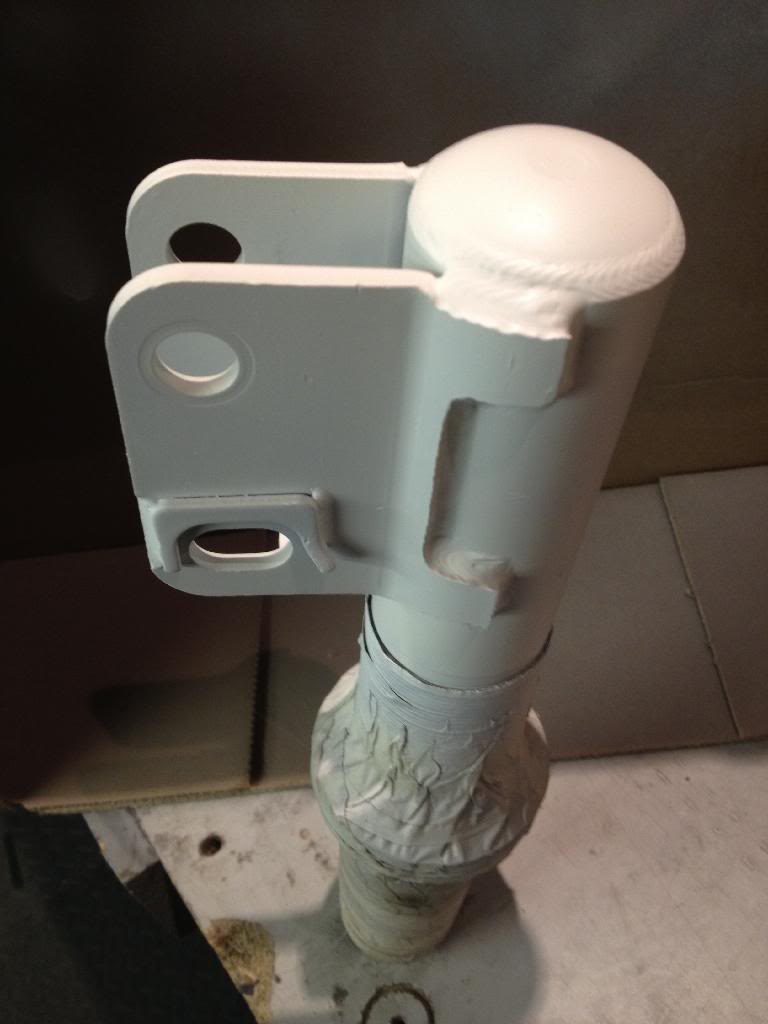

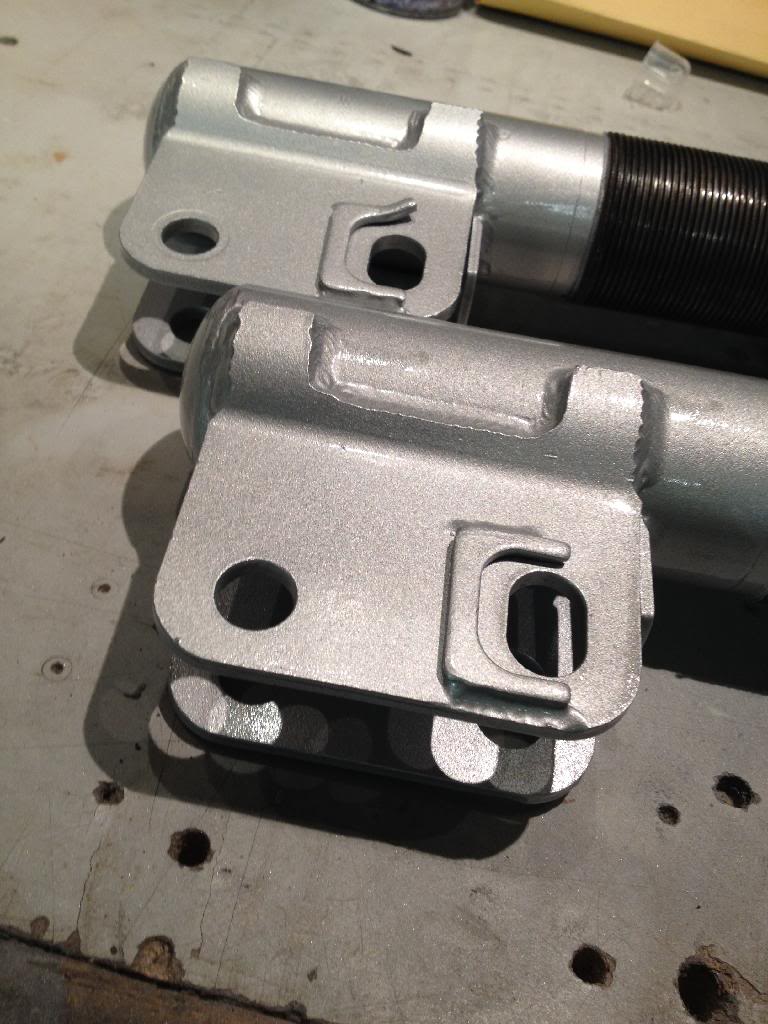

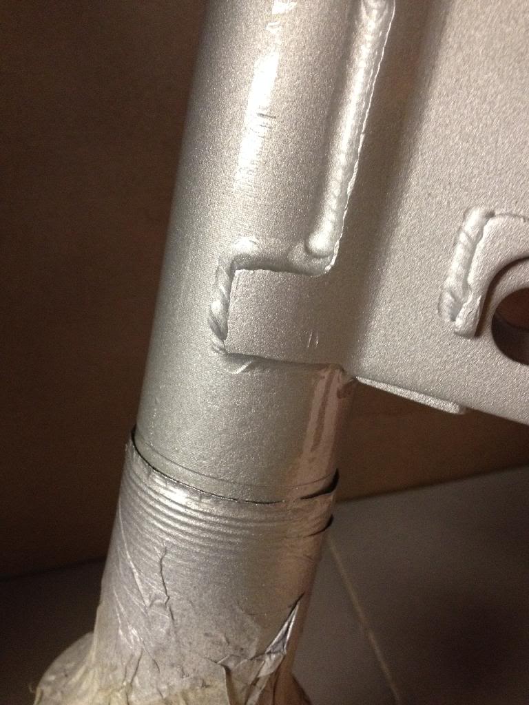

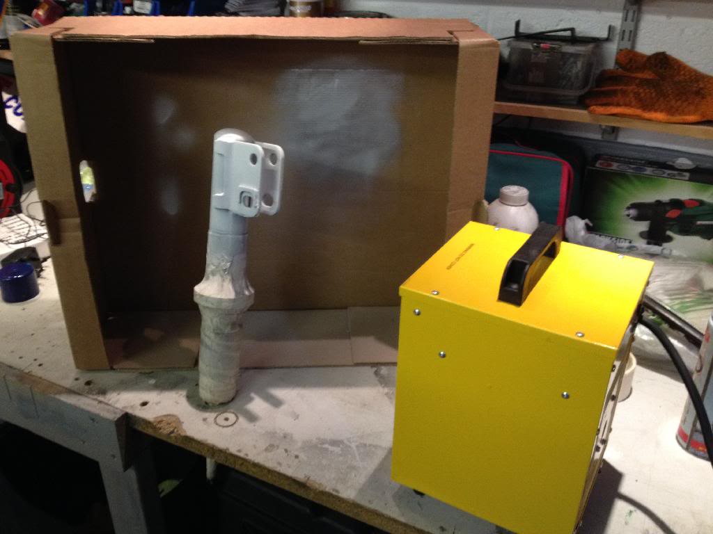

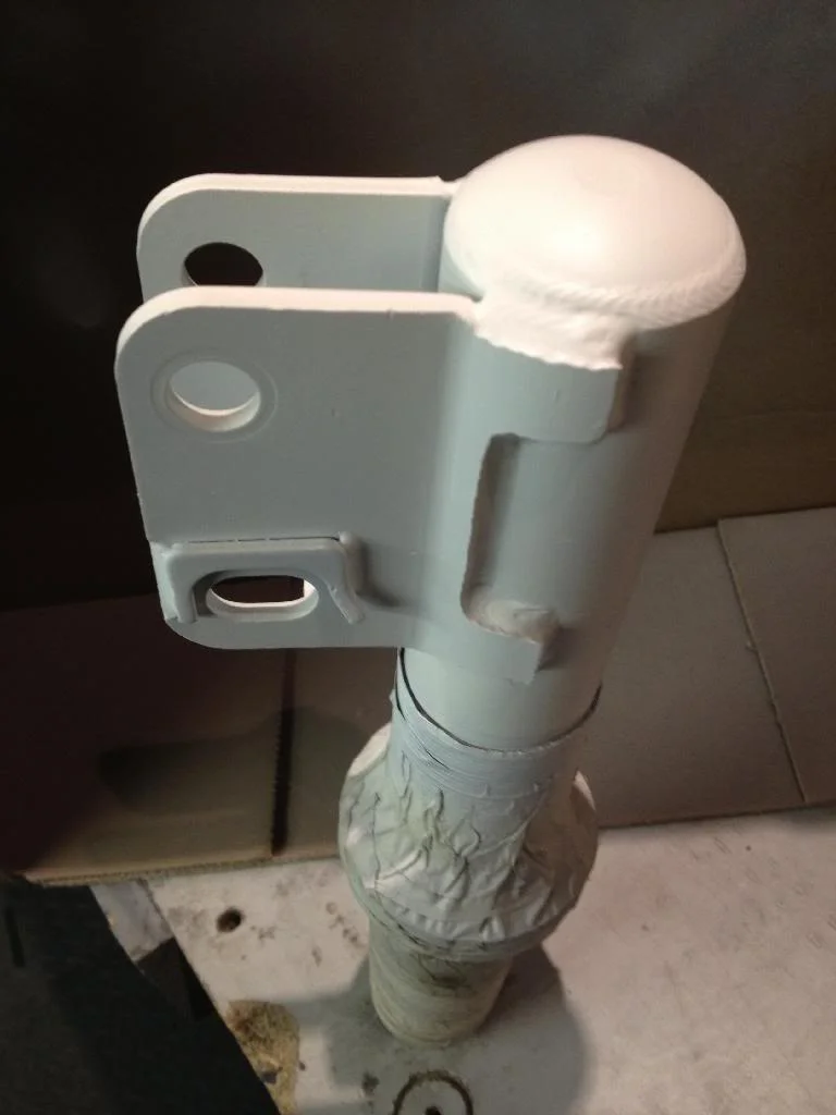

Decided to clean and paint the coilovers, taped them and managed to fit them in my cabinet. Made a big difference to the finish after shot blasting them.
Left is unblasted and right blasted
Once I'd done both I did two coats of white primer and heated them to dry
Debated what colour to do them but decided on a wheel silver so they look original.
Two coats of silver followed by three coats of lacquer and I'm pleased with the finish. :thumb:

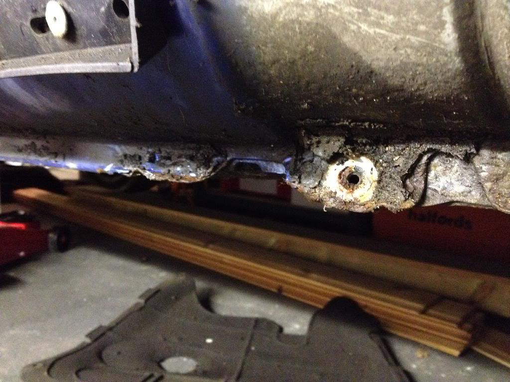

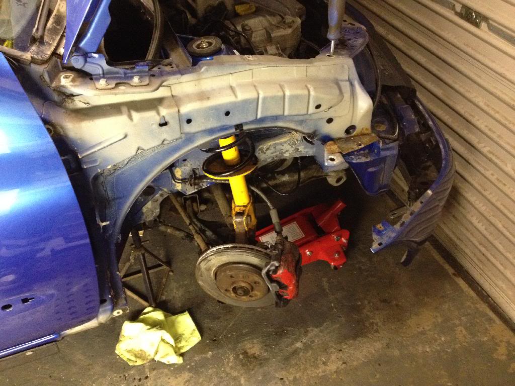

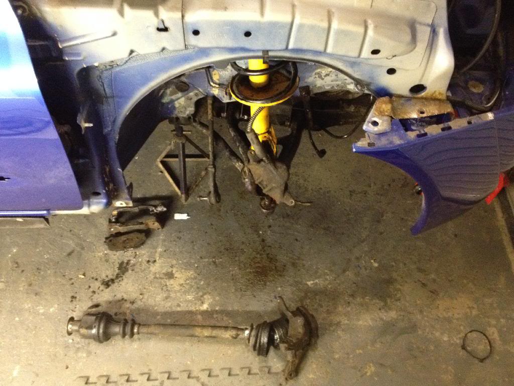

After doing the shockers I carried on stripping the NSF
Got the wing off after taking the headlight out and one side of the bumper off oh and the bloody side skirt! The skirts do need painting though so would have come off anyway.

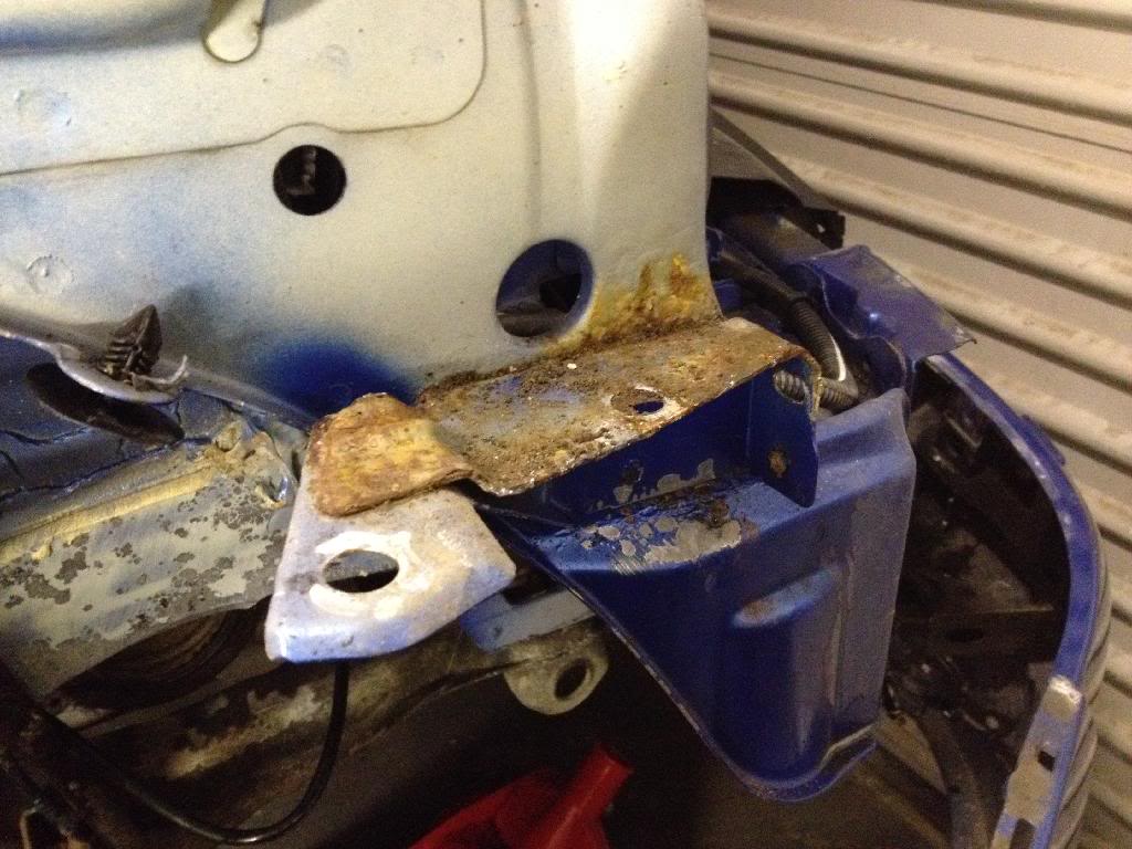

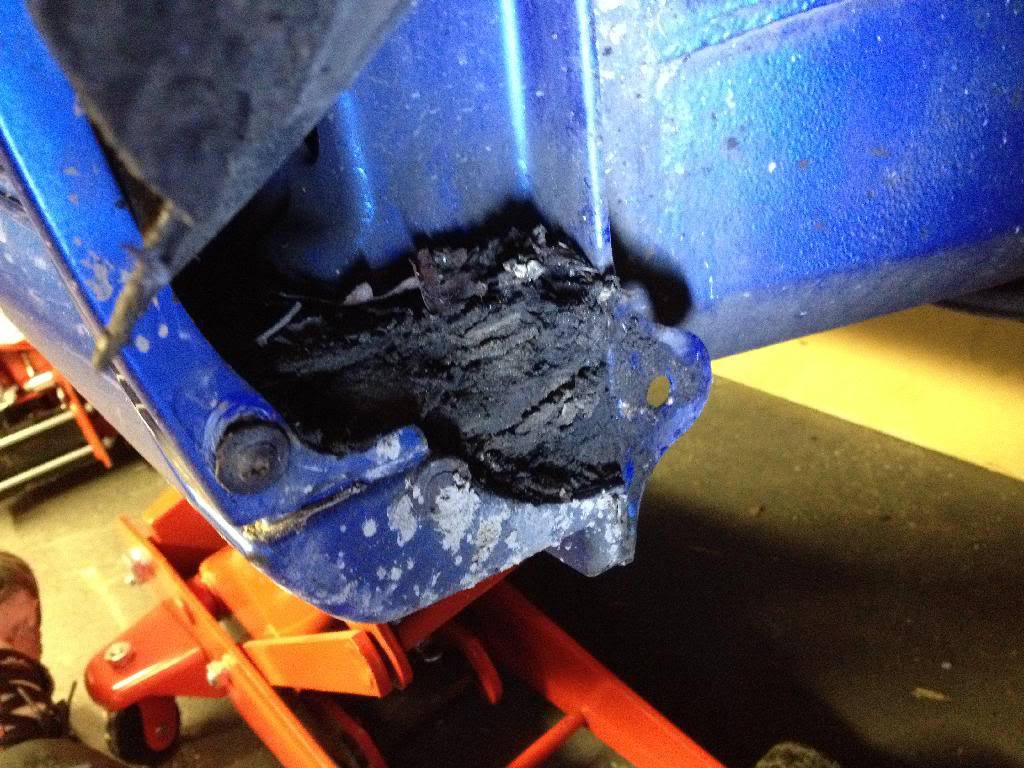

After taking the wing and skirt off I found some more rust and also a damaged sill

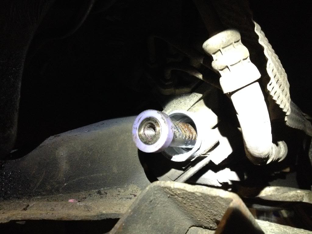

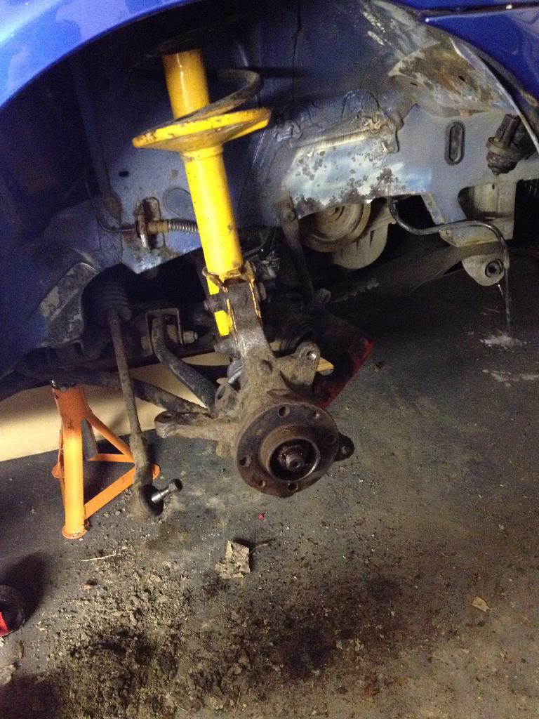

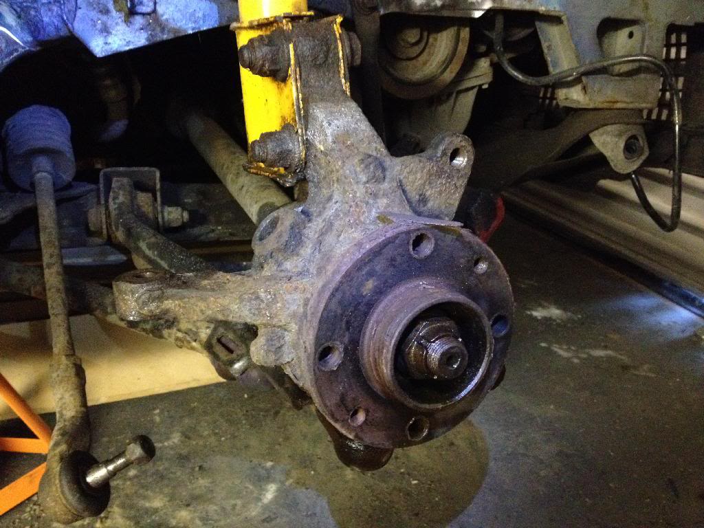

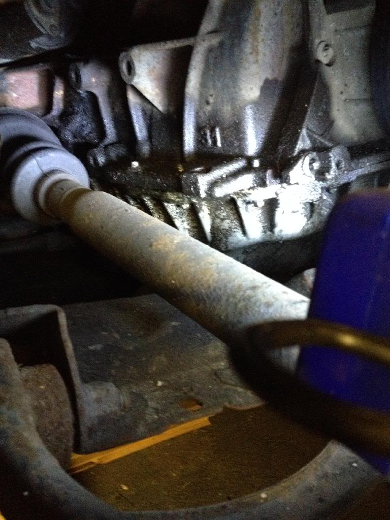

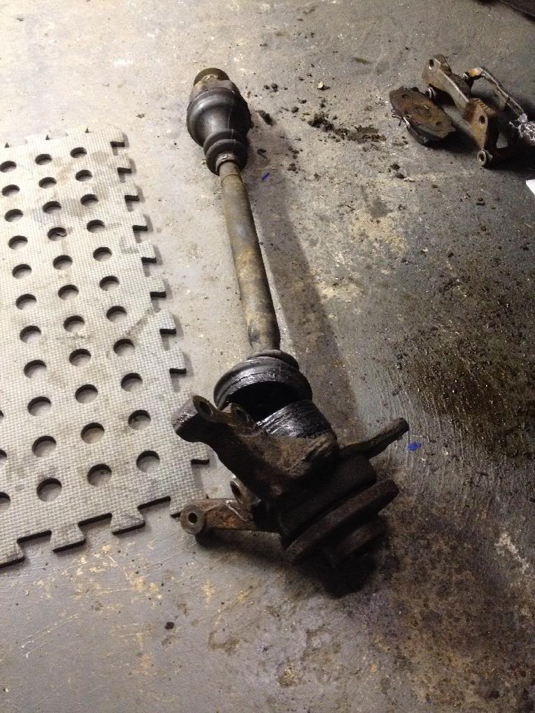

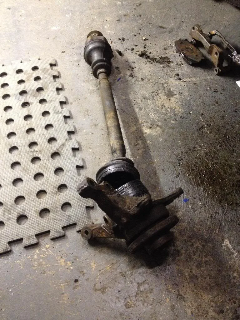

Got the hub and driveshaft out as well. No idea how to get the 30 mm nut off the end without the shaft turning?
A closer look shows that the shaft has had a boot off a while and the grease is massively contaminated. X2 new ones of these as well!
One plus point is that someone has power flexed the anti roll bar

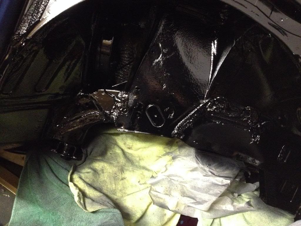

Update 20/1/14

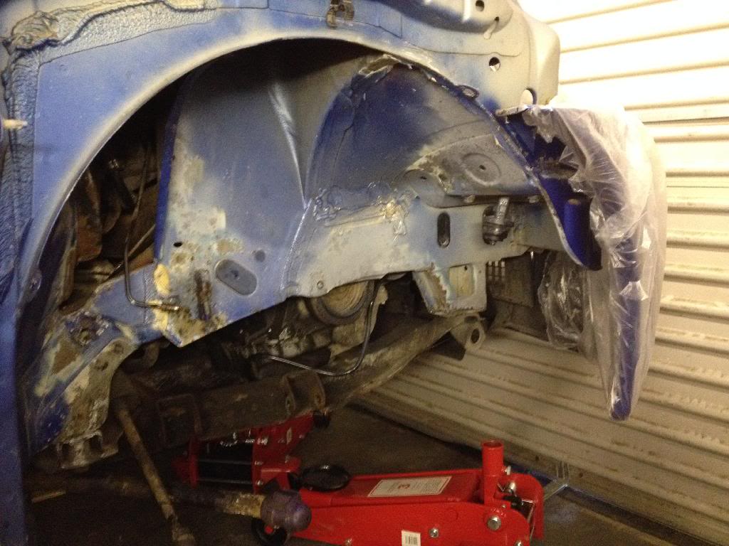

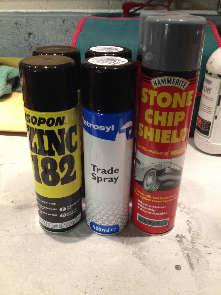

Been to local bodyshop place today and got some paint to do the arches
Got a can of stonechip to give it all some good protection then some gloss black to cover it all.

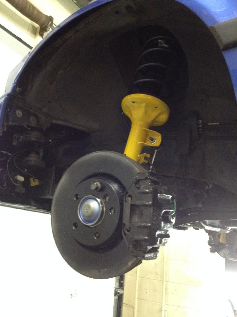

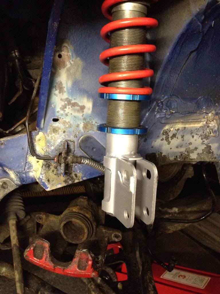

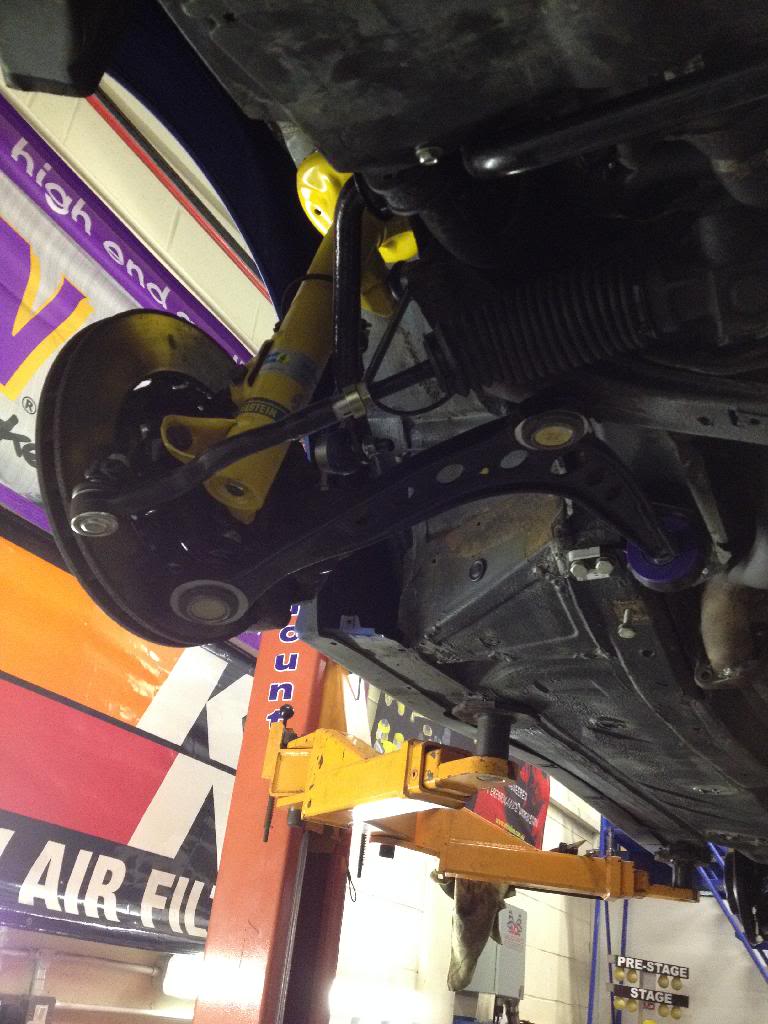

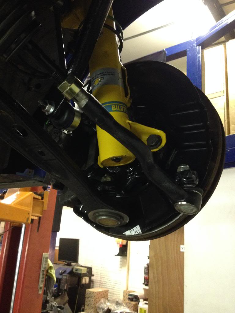

Also got front shocker and bottom arm off.
Top mounts are still ok so can re use these.
I rebuilt the suspension unit to trial fit and make sure it's right.
Update 23/1/14

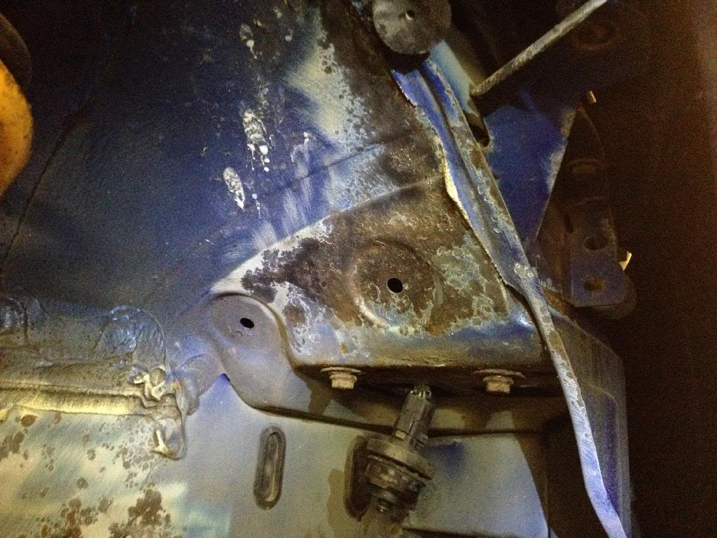

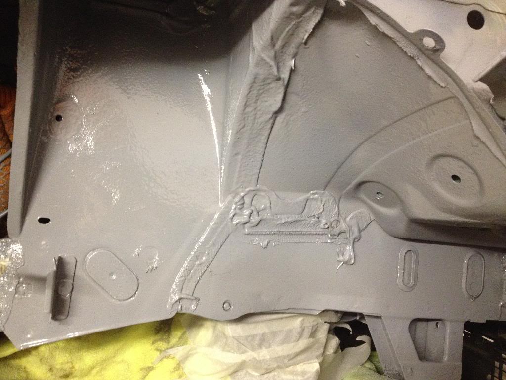

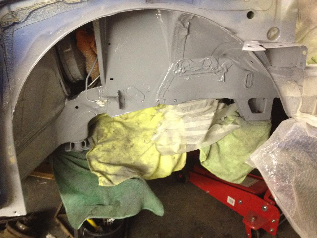

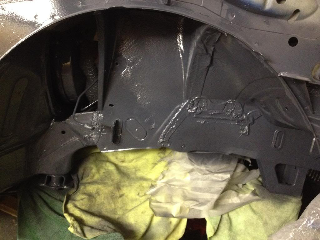

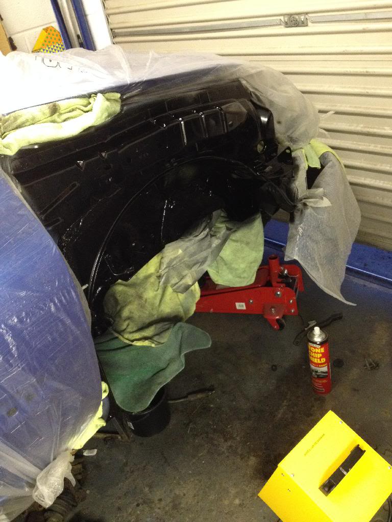

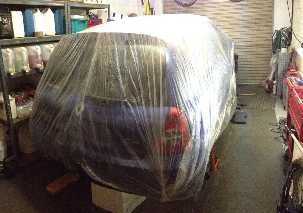

Finally got some paint on the car yesterday. Was chucking it down so seemed an ideal day to do it.
This was before I did the wire wheeling on the last parts of rust
Car is covered to stop as much overspray as I can
This is after 1st coat of zinc primer
Then 2 good coats of stone chip to minimise impact damage
Then 2 coats of gloss black to seal the stone chip
Looks a lot fresher and will hopefully stop any rust developing in the future.

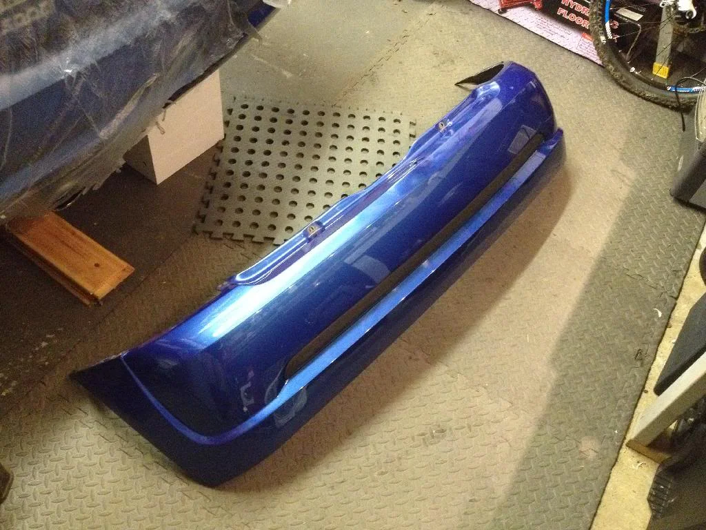

Update 25/1/14
Went to collect the parts from the clio cup at Newark today.
Got some great bits!
Haven't got pics of everything as some are still in the van.
Rear bumper is in good condition (no cut out for exhaust) :thumb:

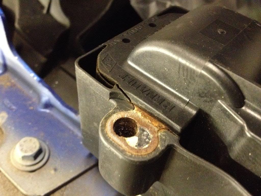

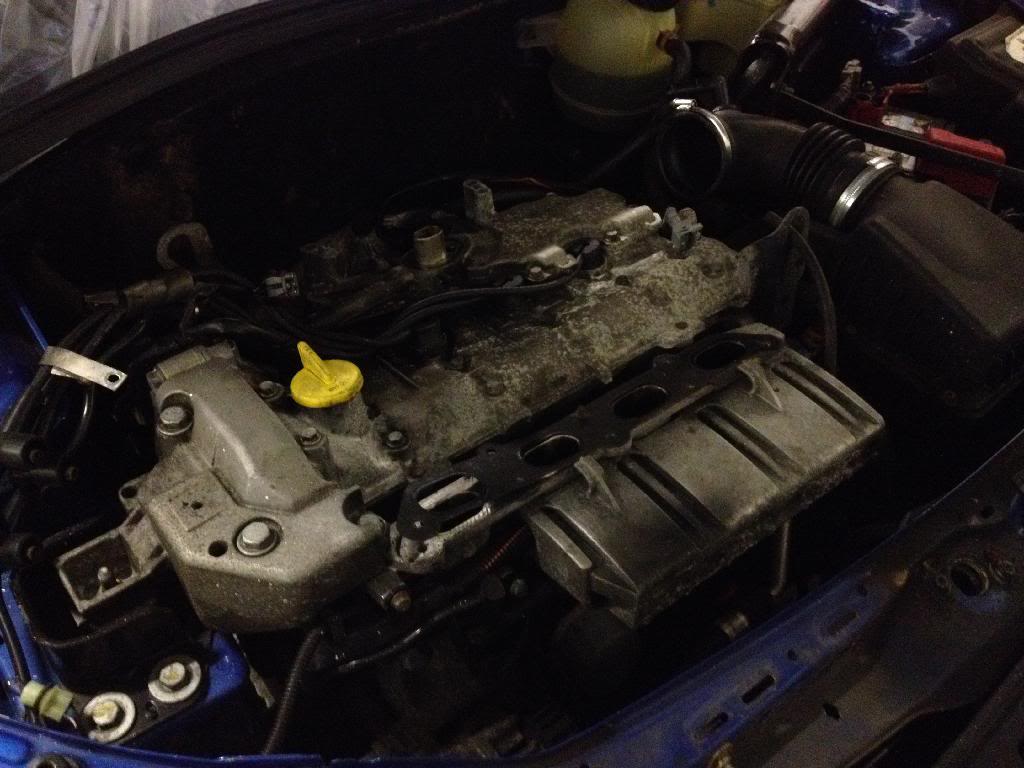

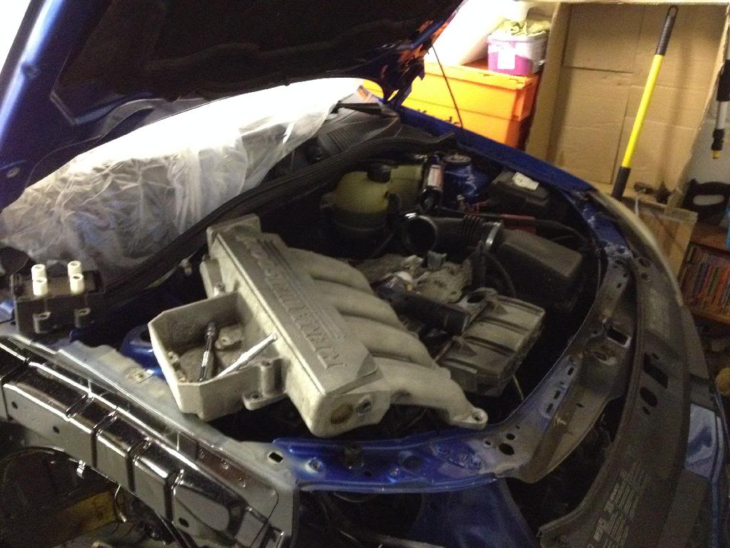

I've also stripped the inlet manifold, ht leads and coil pack off.
After taking the coil pack off I noticed its split in two places and looks like rust which can only mean it's had water in it!! This might explain why it was running like crap! :wall:
I'm pleased I got the coil pack and leads from the car in Newark. :thumb:

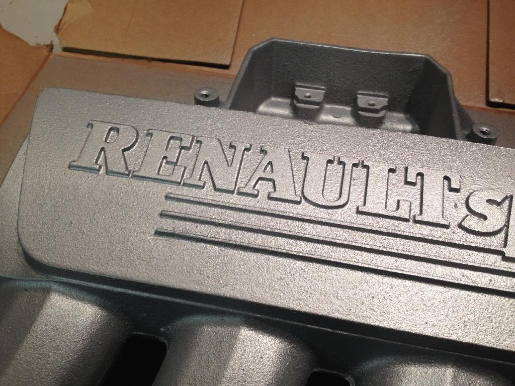

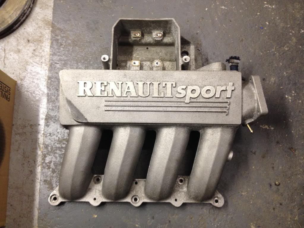

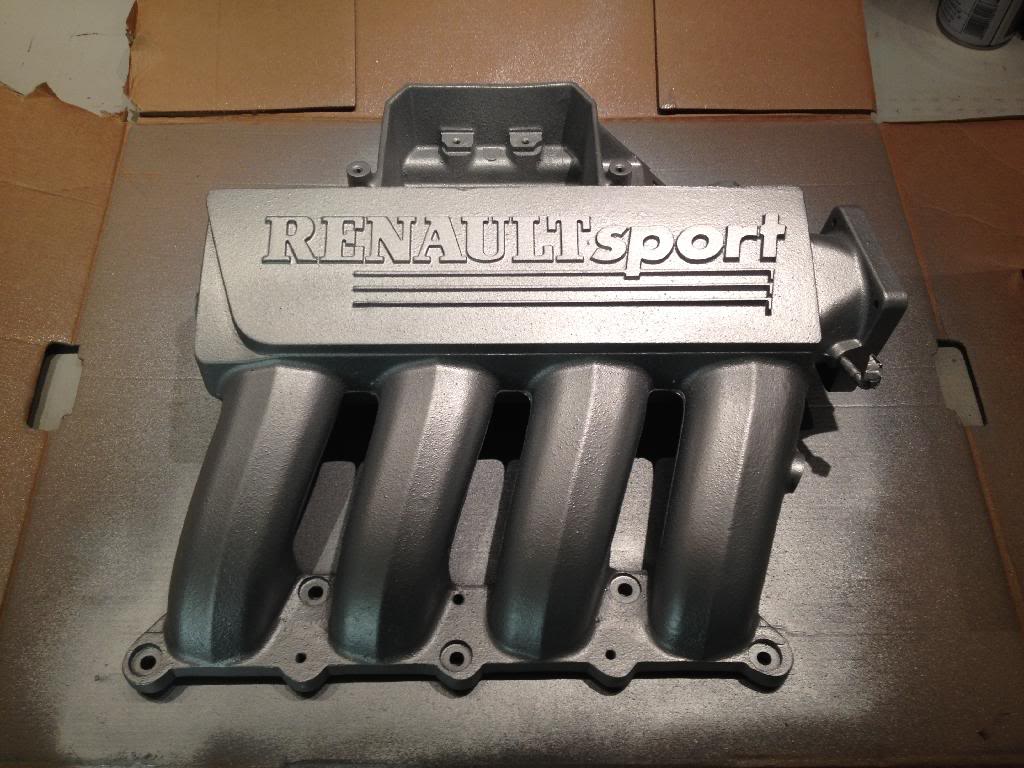

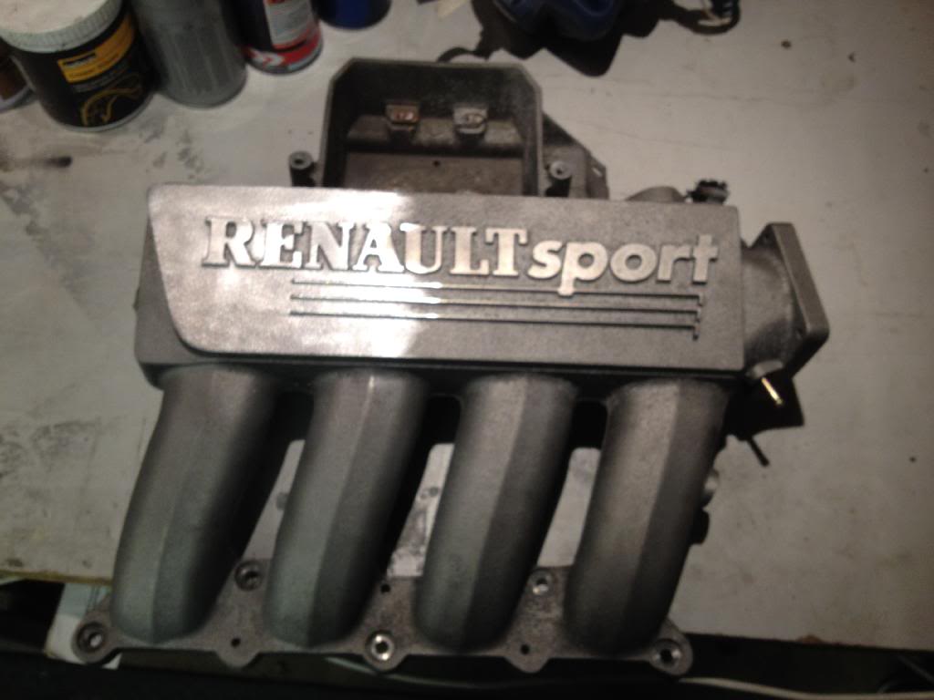

I'm going to paint the inlet manifold as well so I tried the wire wheel on it.
Should leave a better finish for painting.
Not sure colour wise what to do it?
Either black or the similar wheel silver I did the coilovers?

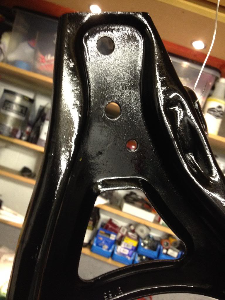

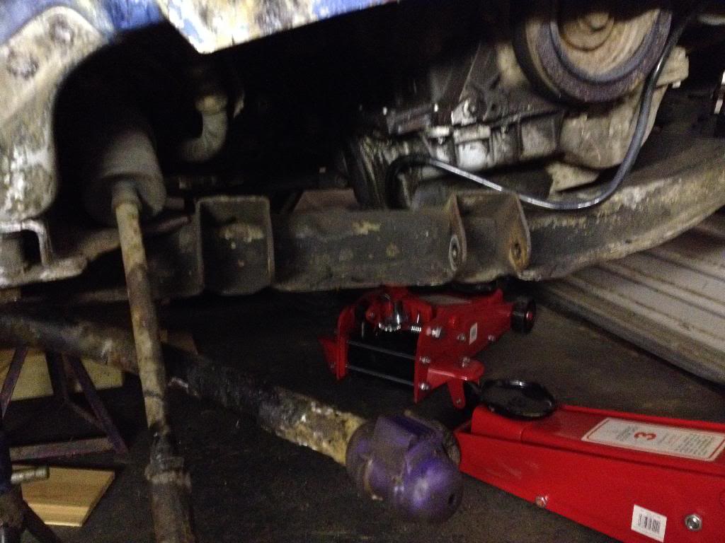

Update 30/1/14

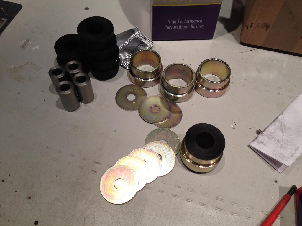

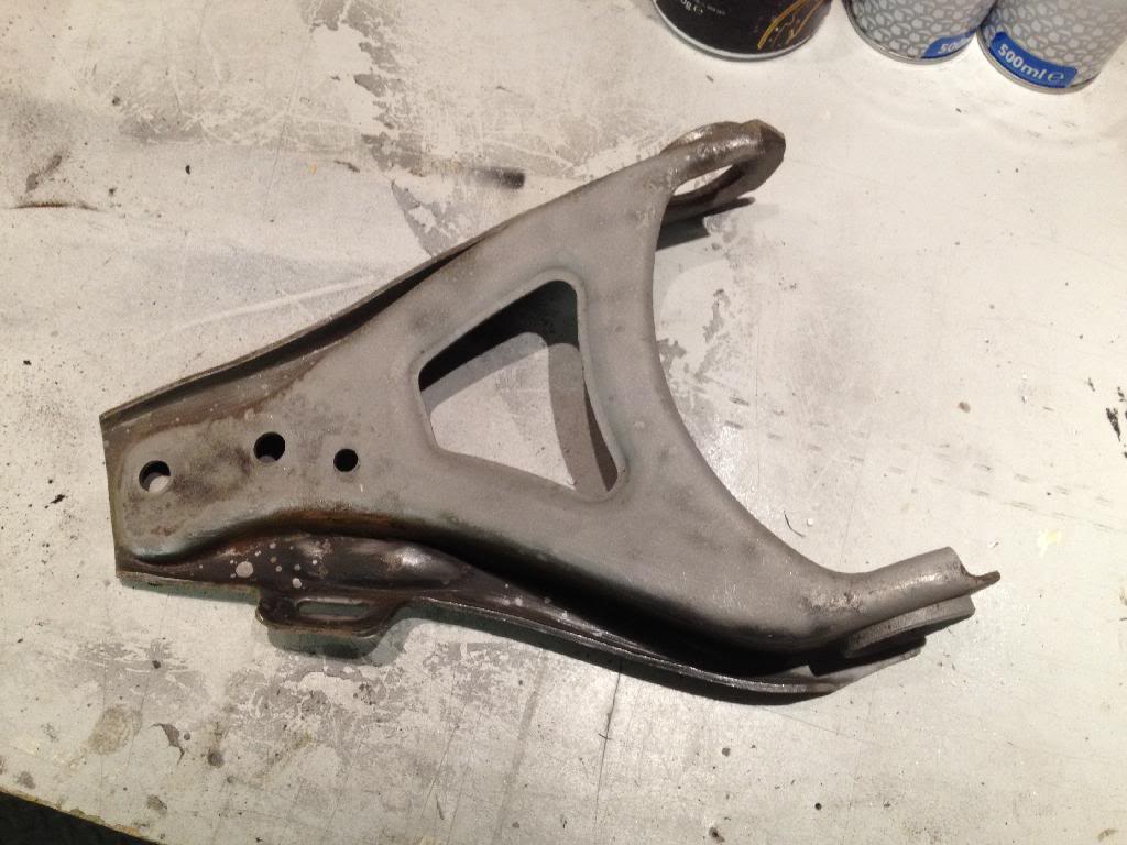

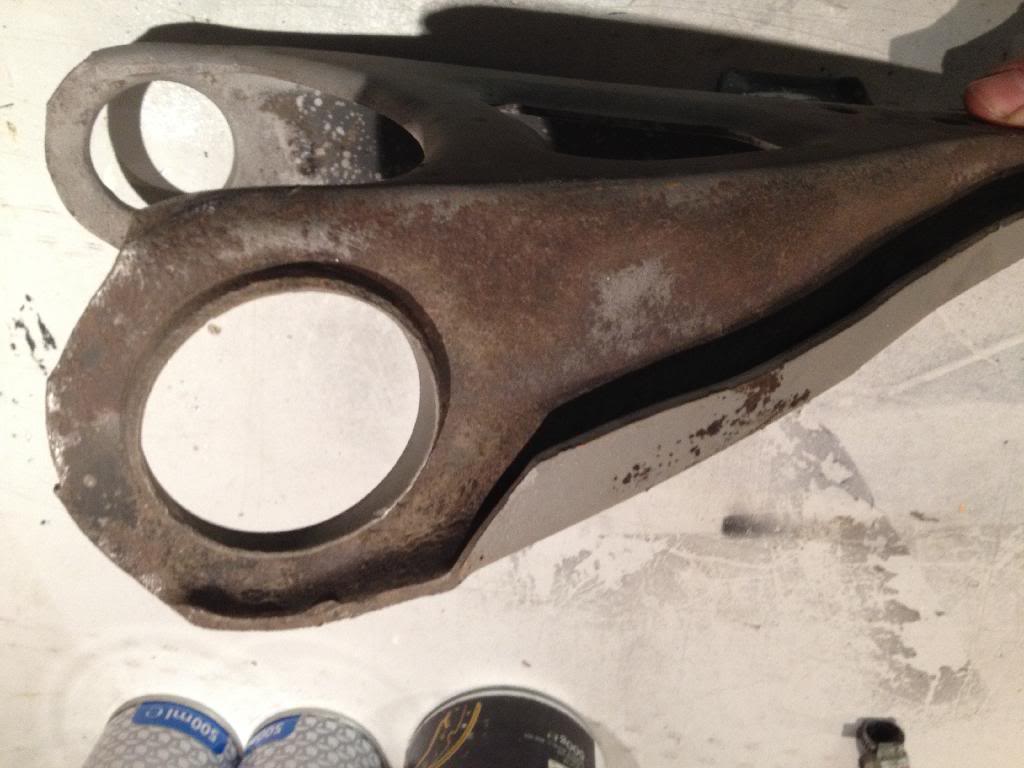

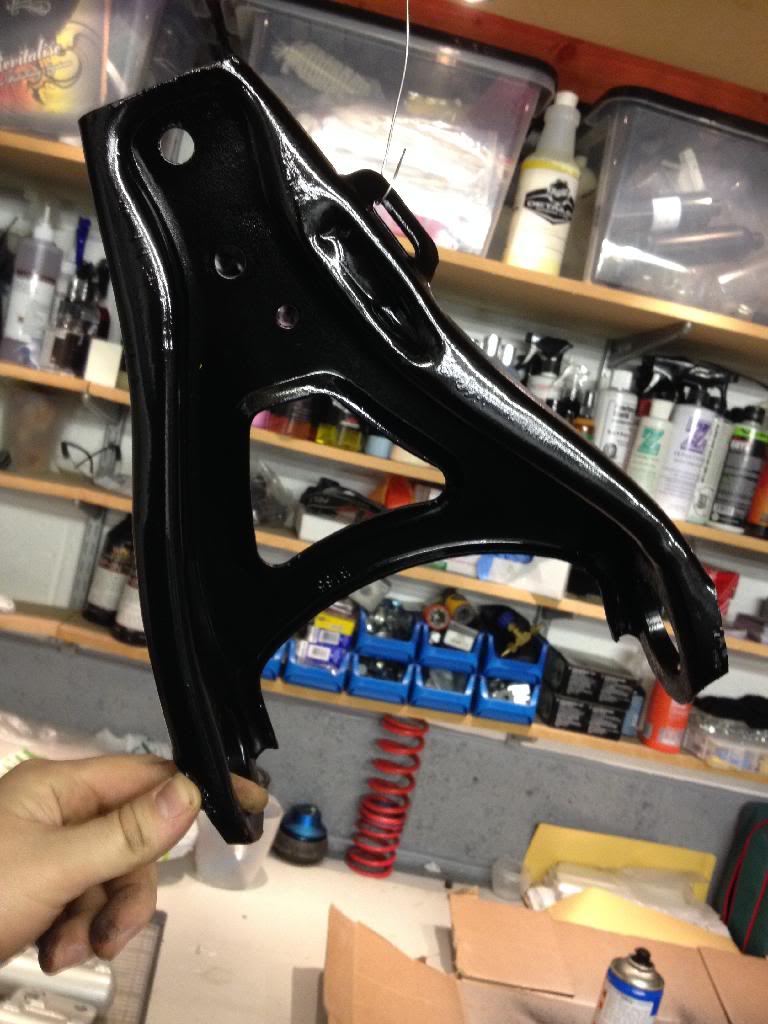

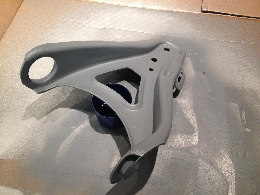

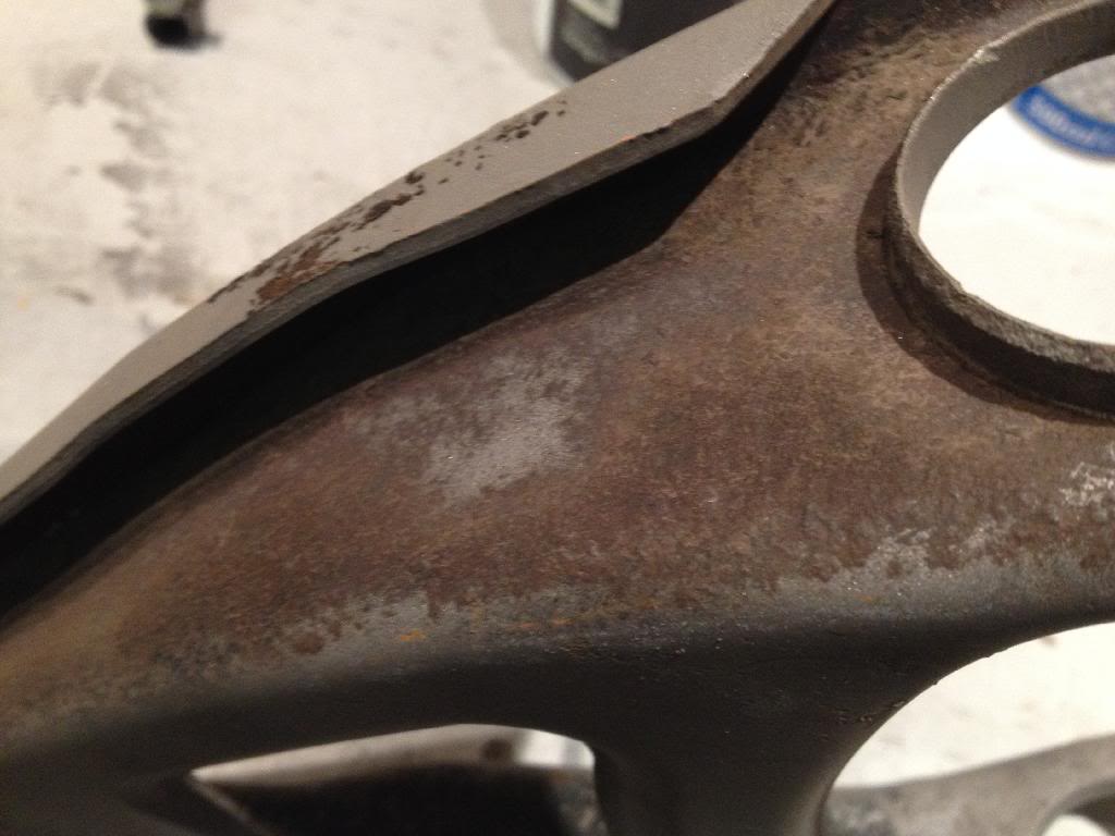

I've ordered my bottom arm powerflex bushes and not far off being ready to put everything back together.

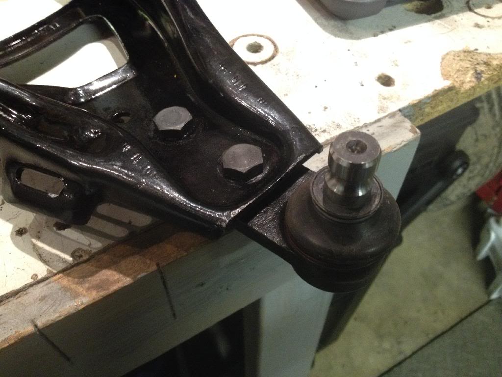

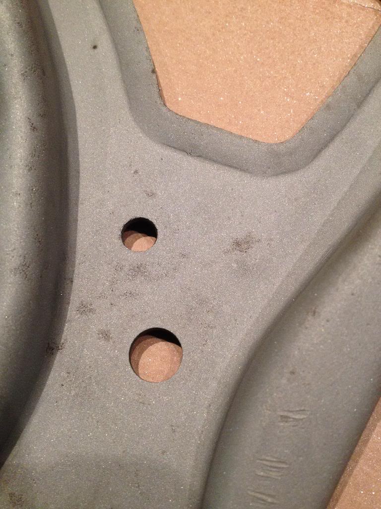

Shot blasted the bare arm ready to paint and put the bushes in
As you can see these we're fairly bad, heavy rust and old paint on them.
This was after a trail to see what my cabinet would take off
Then this was after doing the full arm.
All cleaned and then primer applied
Then finished in gloss black, looks a hell of a lot better.

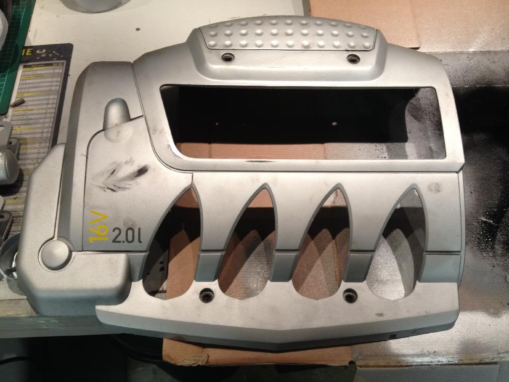

Finished wire wheeling the inlet manifold as well so thought I'd paint it at the same time.
Finished it with the wheel silver to freshen it up.
Got a good condition engine cover as mine was missing. Needs a clean but will look good over the painted manifold.

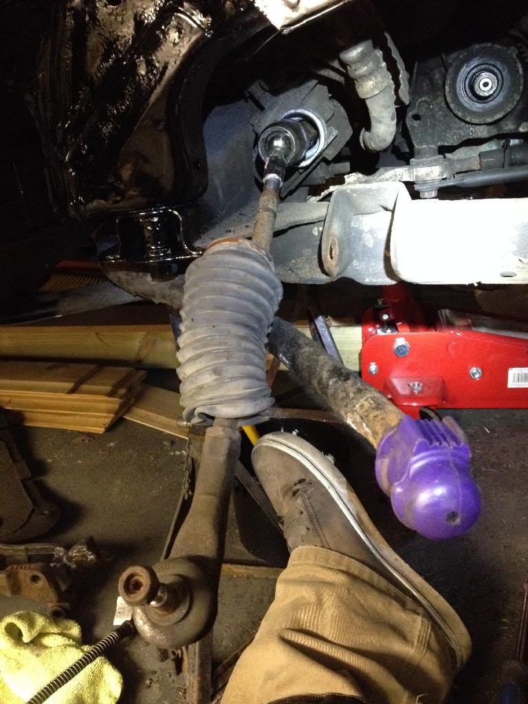

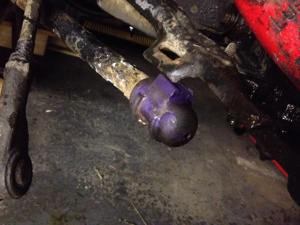

Update 30/1/14

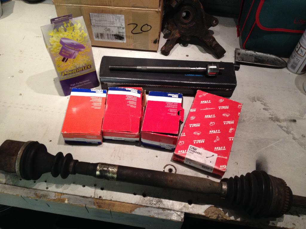

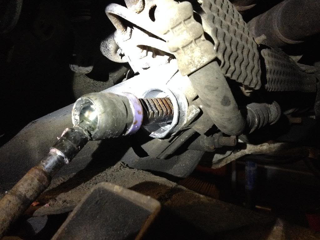

Well today was new parts day, much more fun than stripping down :lol:

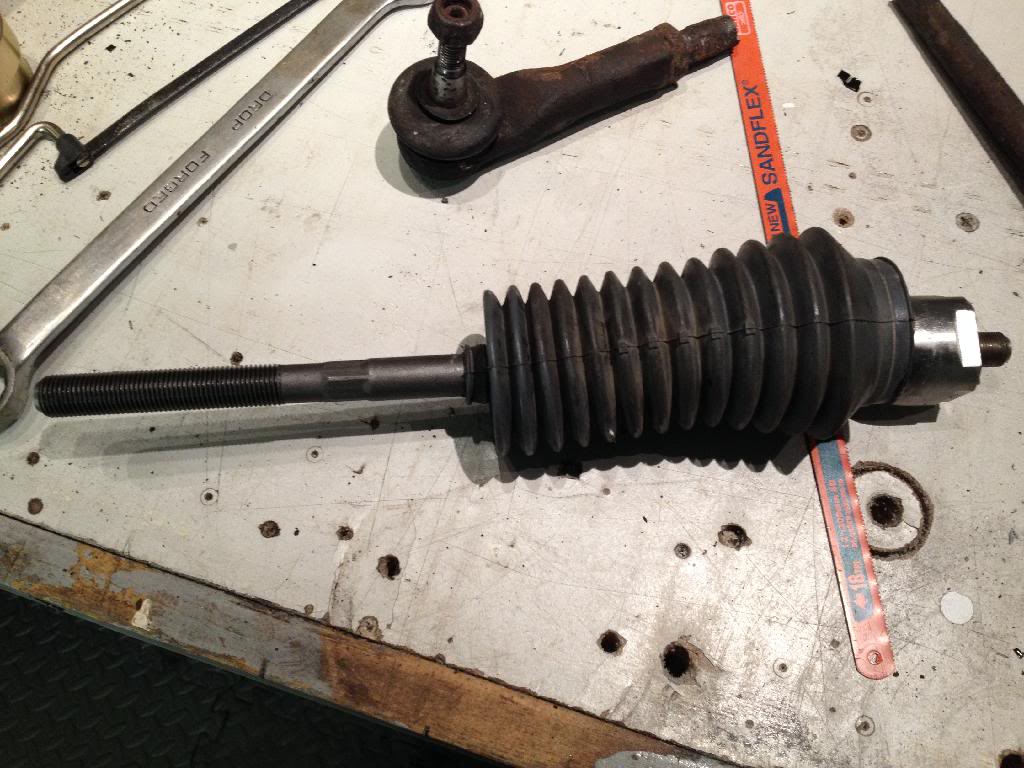

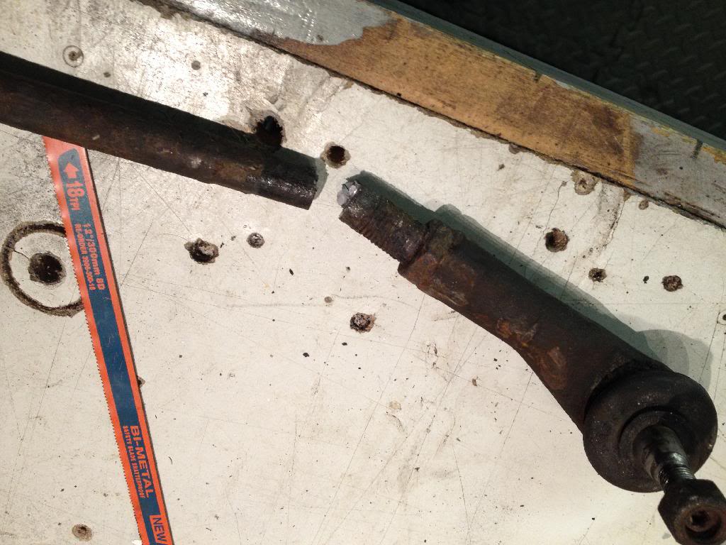

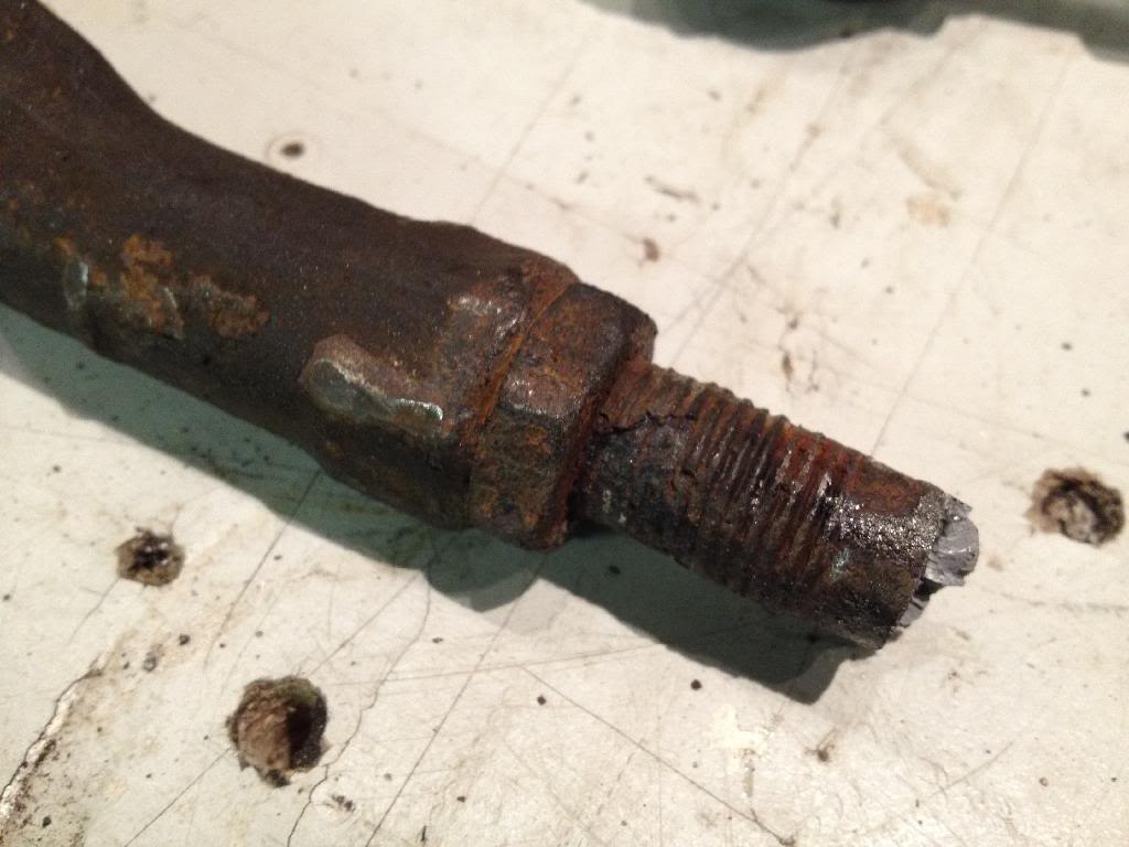

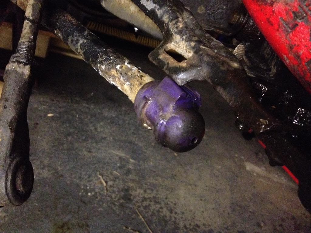

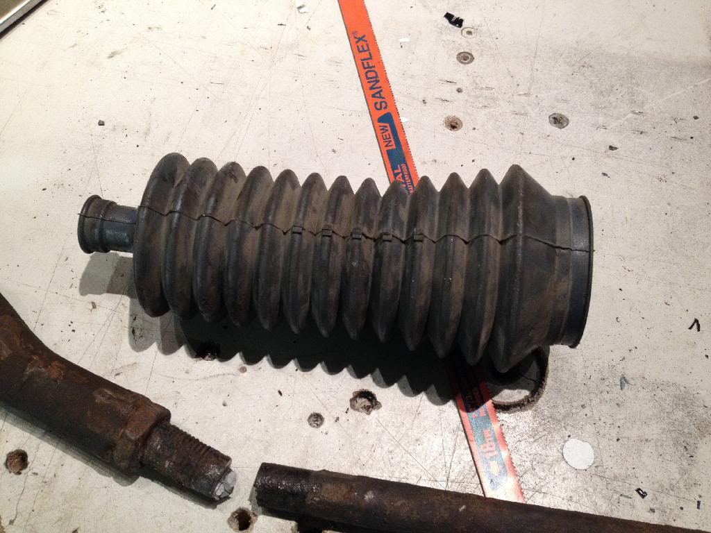

Track rod end, the actual rod itself because it's so badly corroded, powerflex bushes, new brake line and the newer driveshaft.
First thing was to remove the steering rod so pulled the rubber boot off
Not sure how free the little ball joint should be on the shaft but it was slack as hell!
Nice surprise though is the steering rack bushes have already been done with the powerflex ones.
I needed the original boot from the shaft to put on my new shaft but as you can see the threads are massively corroded!
There wasn't a chance these we're coming off so out came the hacksaw!
Meaning I could slide the boot off.
Put onto the new shaft to re fit to the rack, can't fit it yet as will need a new nut to hold the track rod end.
I did manage to get the new ball joint fitted and tight ready to back on :thumb:
