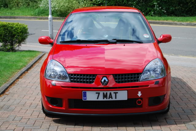

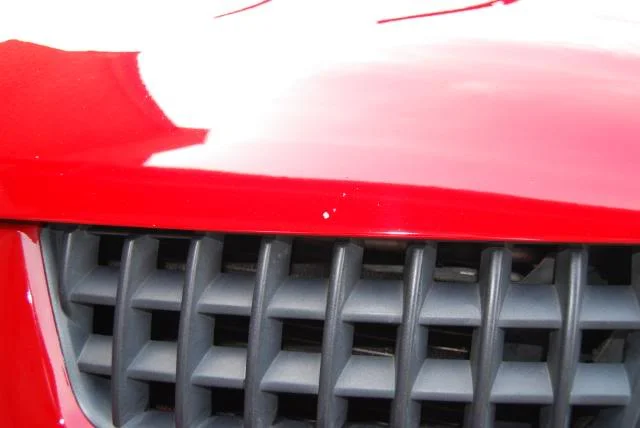

I have never known a car as bad as the clio for collecting stone chips, my bonnet and wings were in a terrible condition.
Purchased some paint from paint4u, great service arrived next day. Unfortunately the colour match was not the best.
Example of stone chip before painting

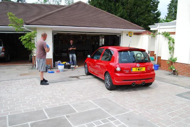

The line up on the day

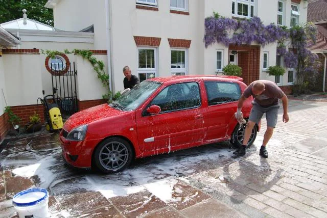

Car was foamed up with snow foam, rinsed and re-foamed with Britemax Clean Max and then washed down.
Then all three of us clayed the car using some Zaino Z18 clay, before drying.

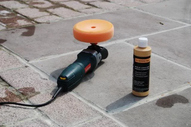

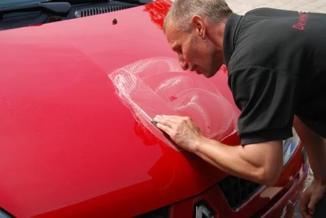

Bryan then gave me a demo on wet sanding using both the PC with Abralon discs and by hand with some Meguiar's Unigrit paper.
My first attempt wet sanding by hand ;)
Rob then set about the roof using Britemax #2 pad and #2 polish.

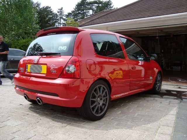

After correcting all the stone chips, we set about polishing the rest of the car. I sorted the bumpers with a PC with Britemax 4" pads, Bryan & Rob did the rest.
Car was wipe down with IPA (now a stock item), and then we applied a layer of Britemax #5 Extreme Elements - the guys were very impressed with all the Britemax compounds and loved the polymer sealant.
Then Bryan couldn't help give the car the once over with some #6S Spray & Shine QD spray. Tyres were dressed and exhaust cleaned and polished with Easy Cut and then followed up with Final Shine.

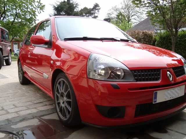

Some of Rob's photo's

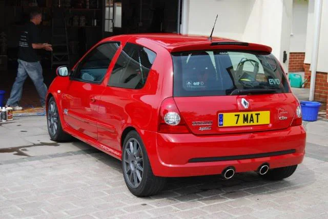

This is my folks place, made sense to meet up there as close to junction 6 off the M25 and has the added bonus of a large driveway to work in.

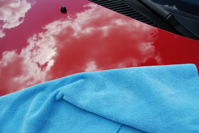

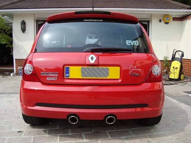

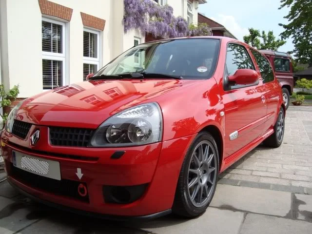

From a small distance the repair looks perfect, unfortunatley as mentioned the paint was not a great match.
Here's a pic of one of the larger repairs on the bonnet, its just above the microfibre cloth in the middle of the shot. The surface is as smooth as a babies bottom but you can still just see the darker paint from the repair.
