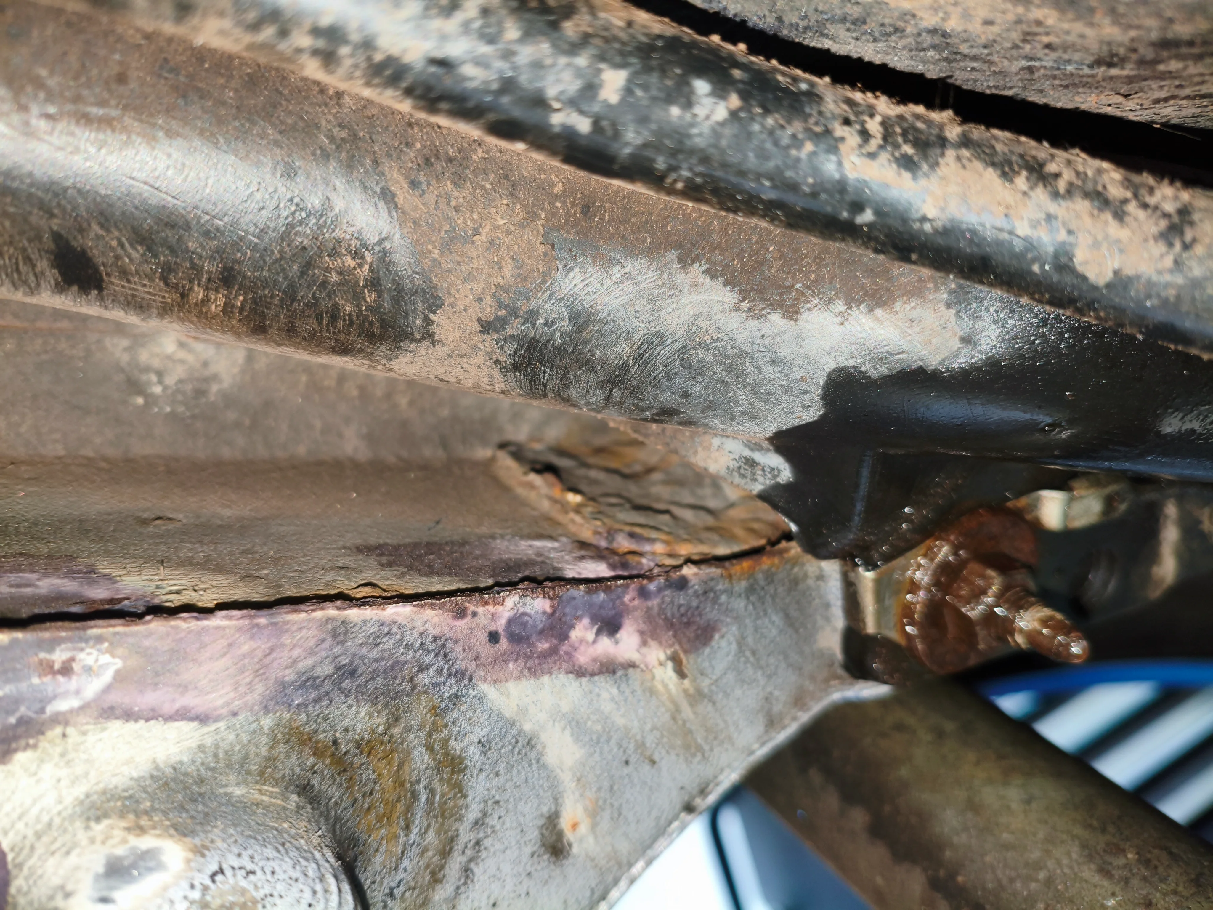

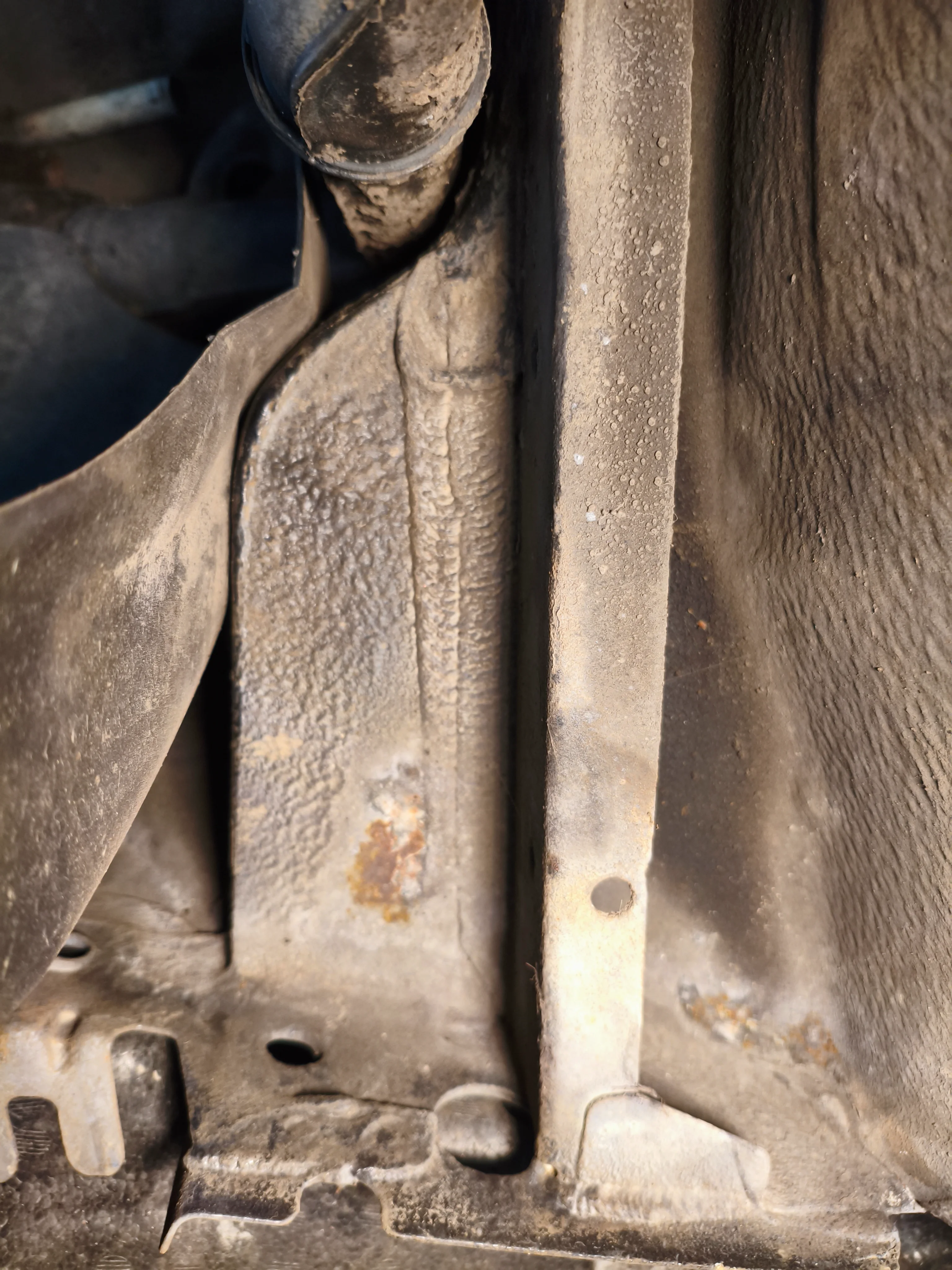

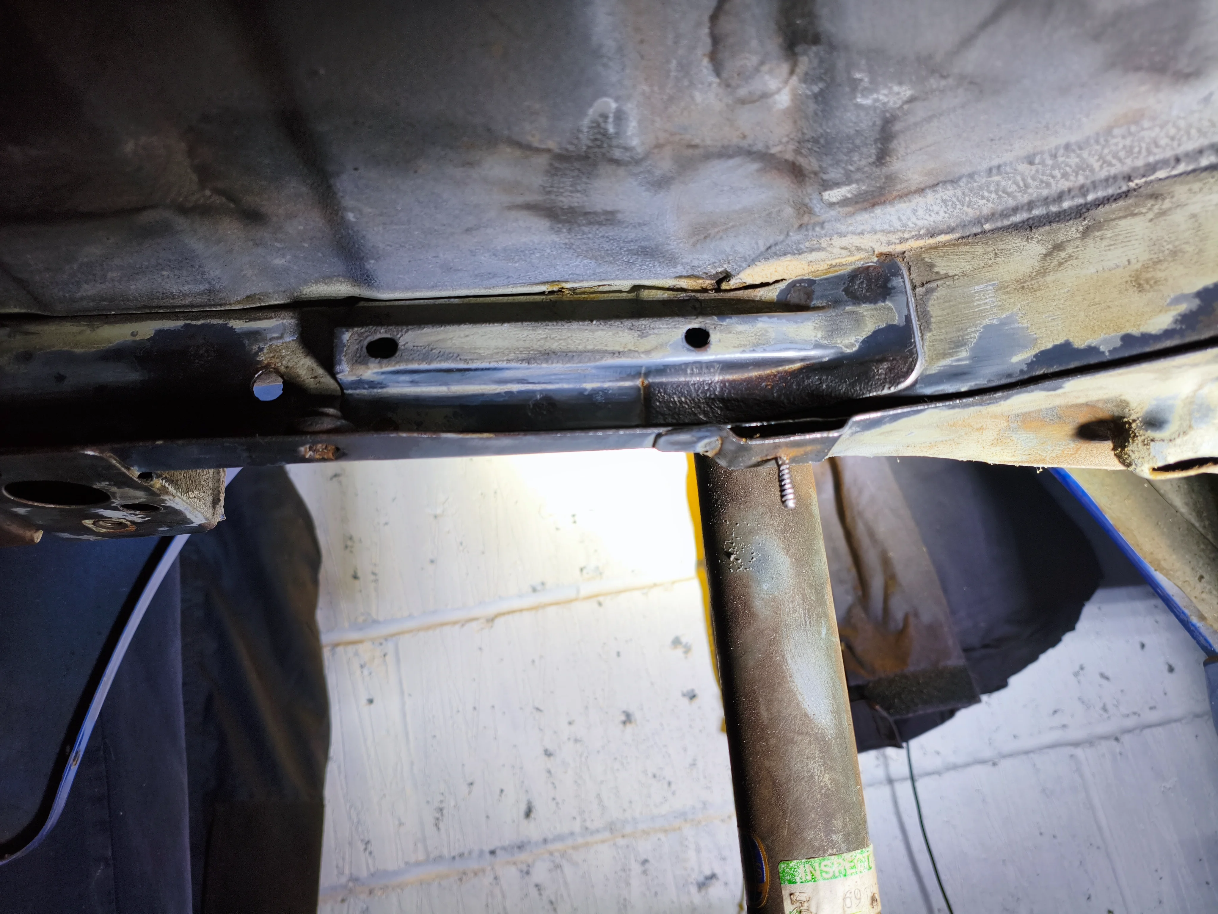

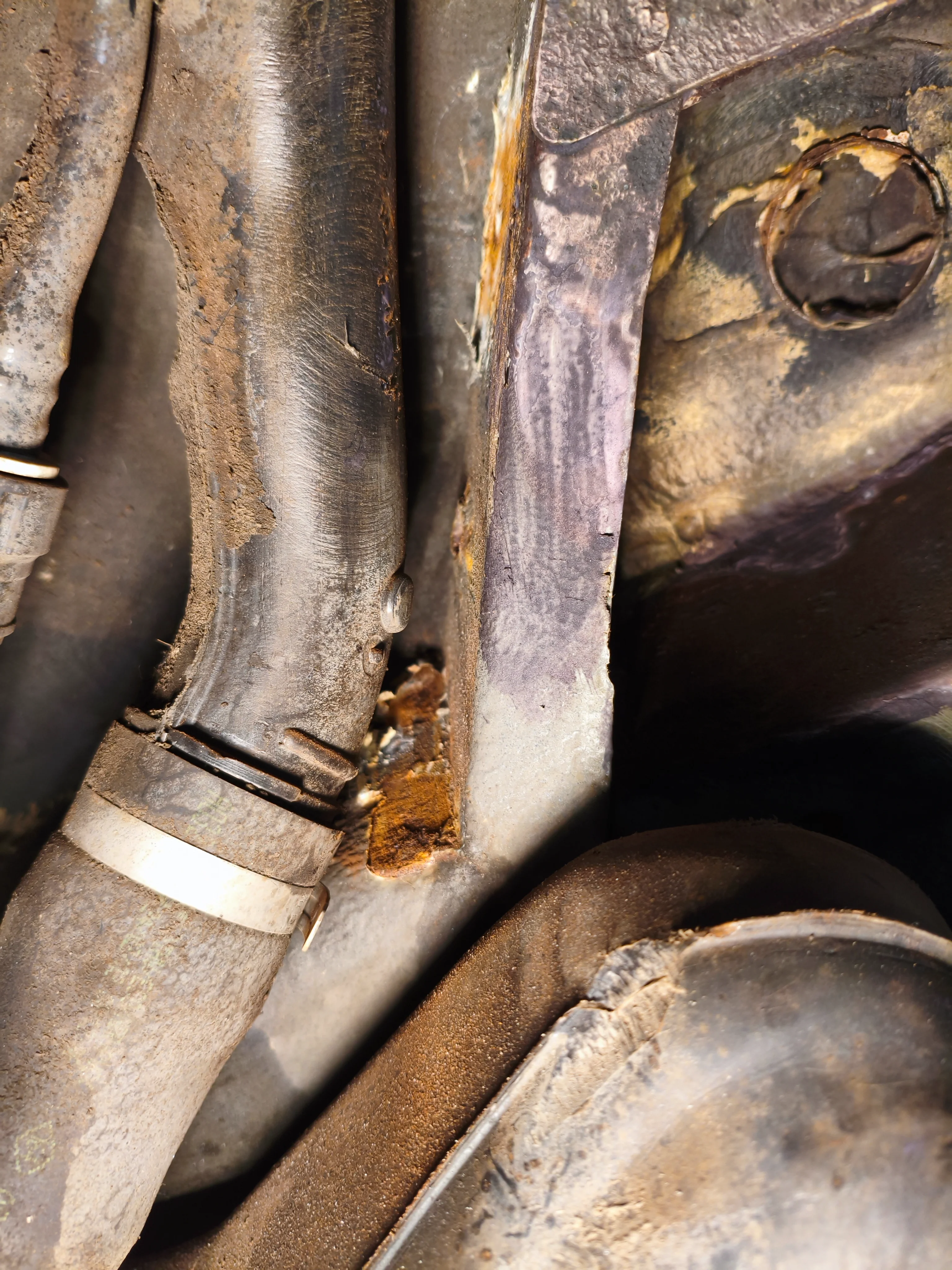

Cleaned up this bit of surface rust on the chassis cross member between the axle mounts

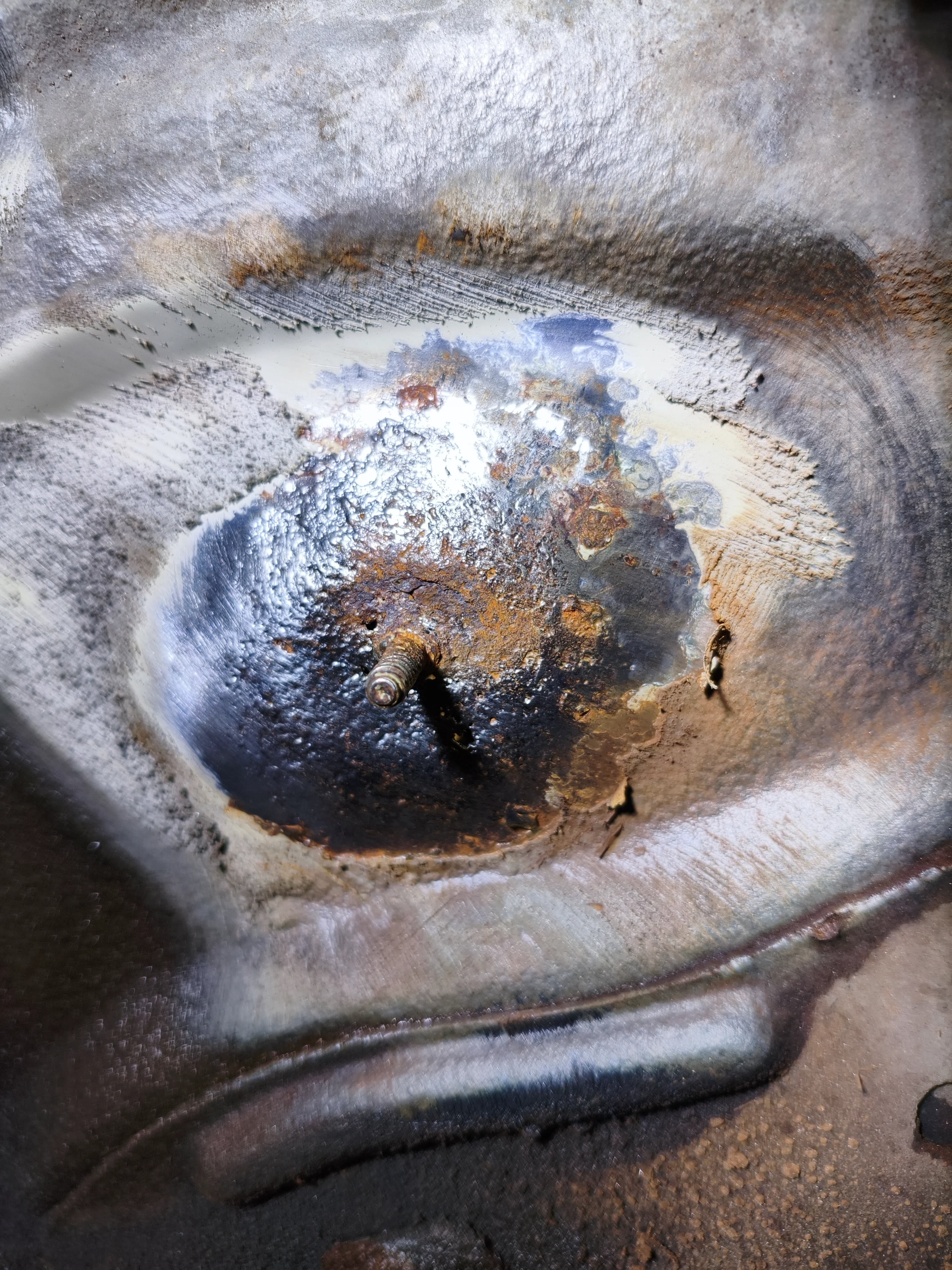

I dropped the back box and heat shield, the forward most heat shield mount was very scabby, basically turned to dust with a knot wheel and it's going to need cutting out and a patch welding in, not a massive issue, I'll get some steel ordered.

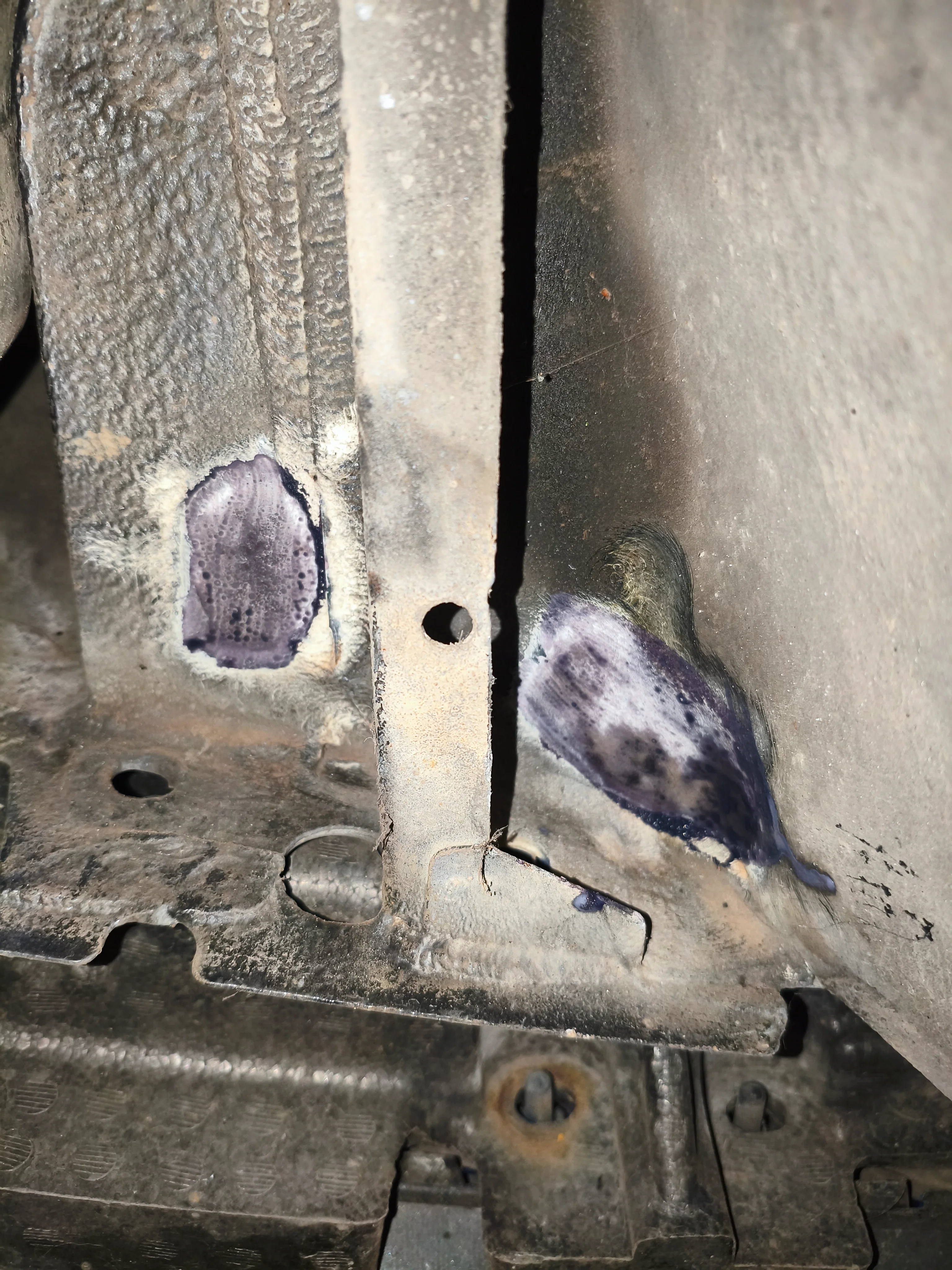

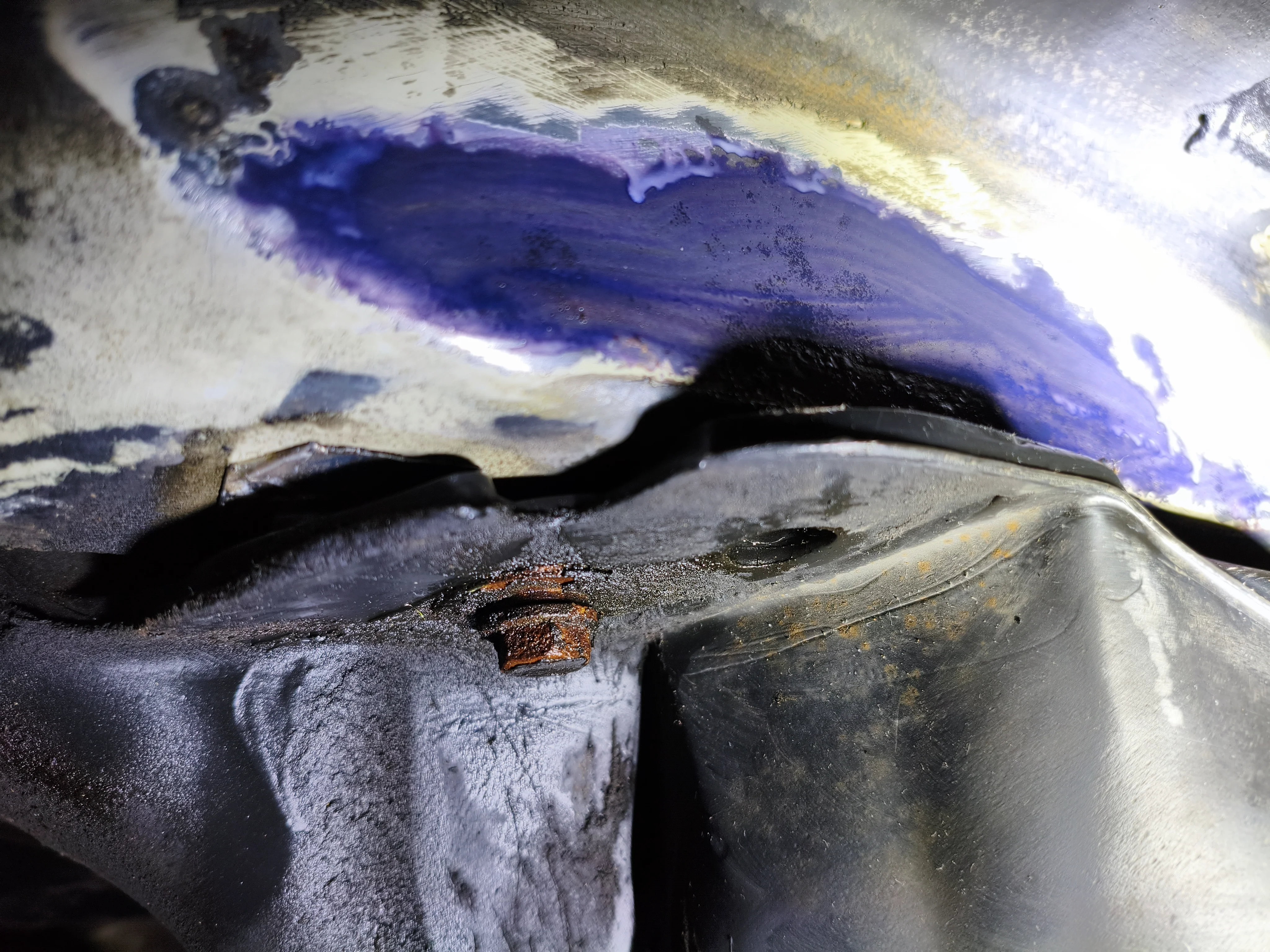

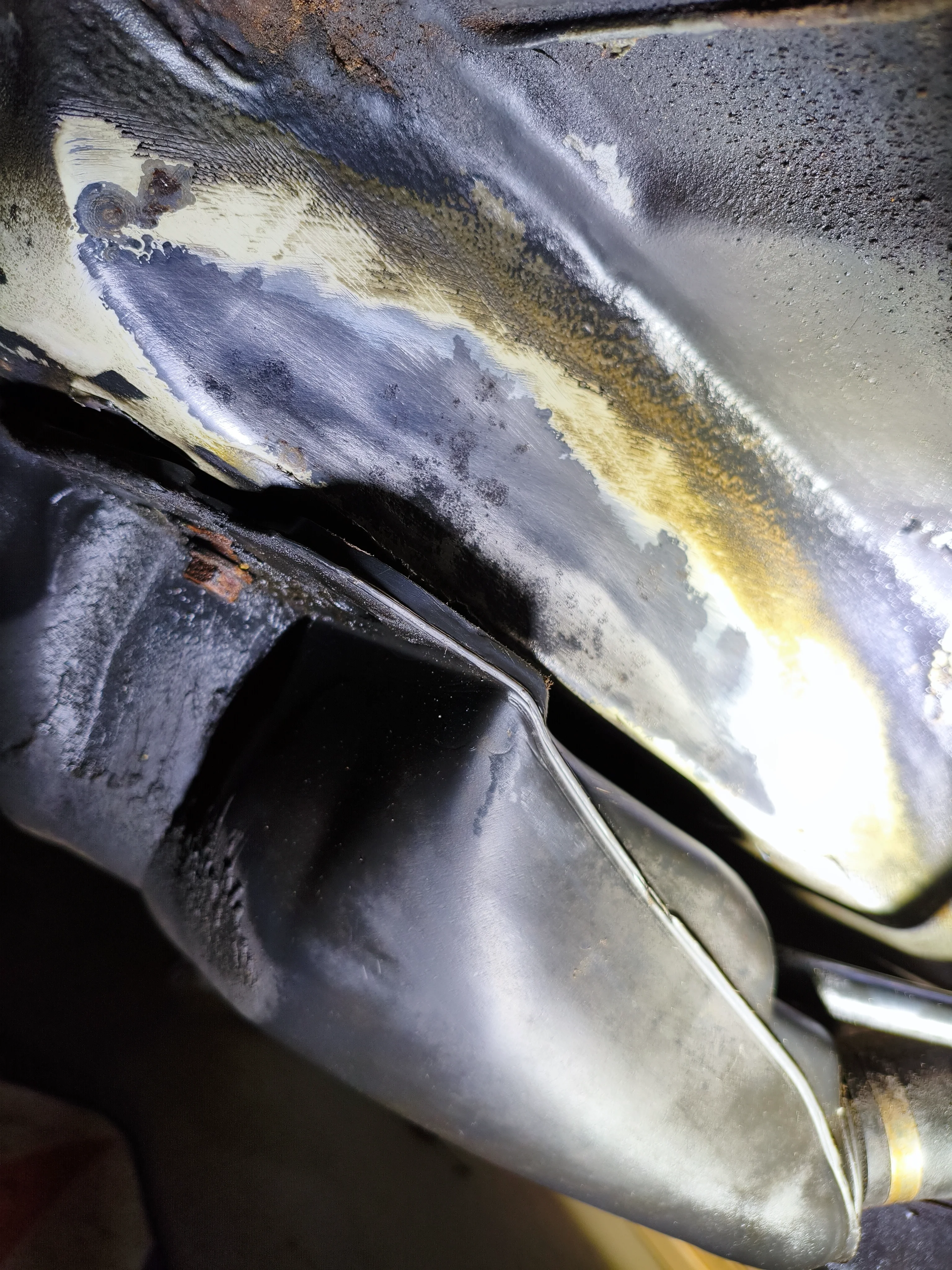

The section aft of the axle mounts had some surface rust on it, including under the exhaust mount so that was wheeled off and rust converted

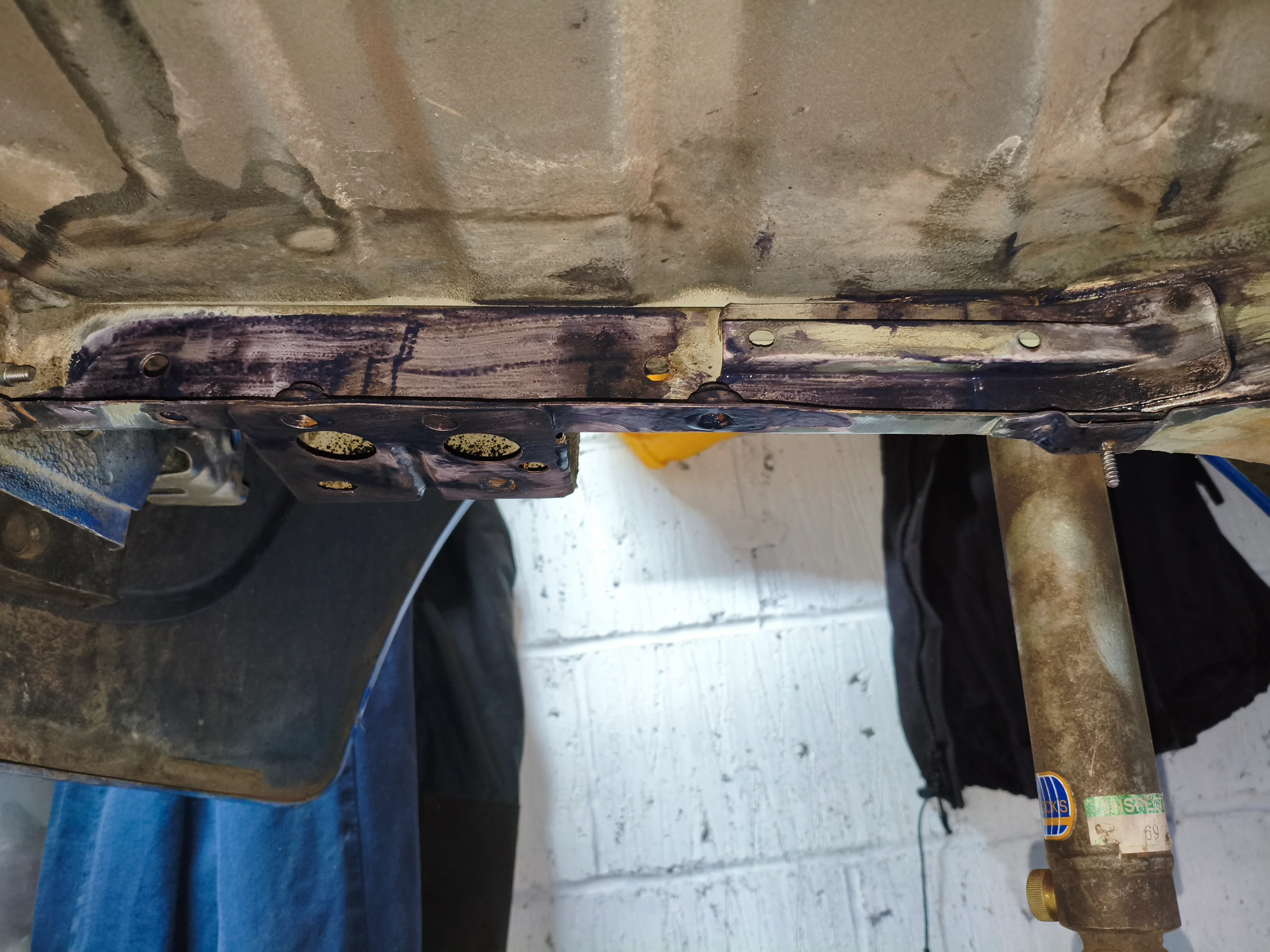

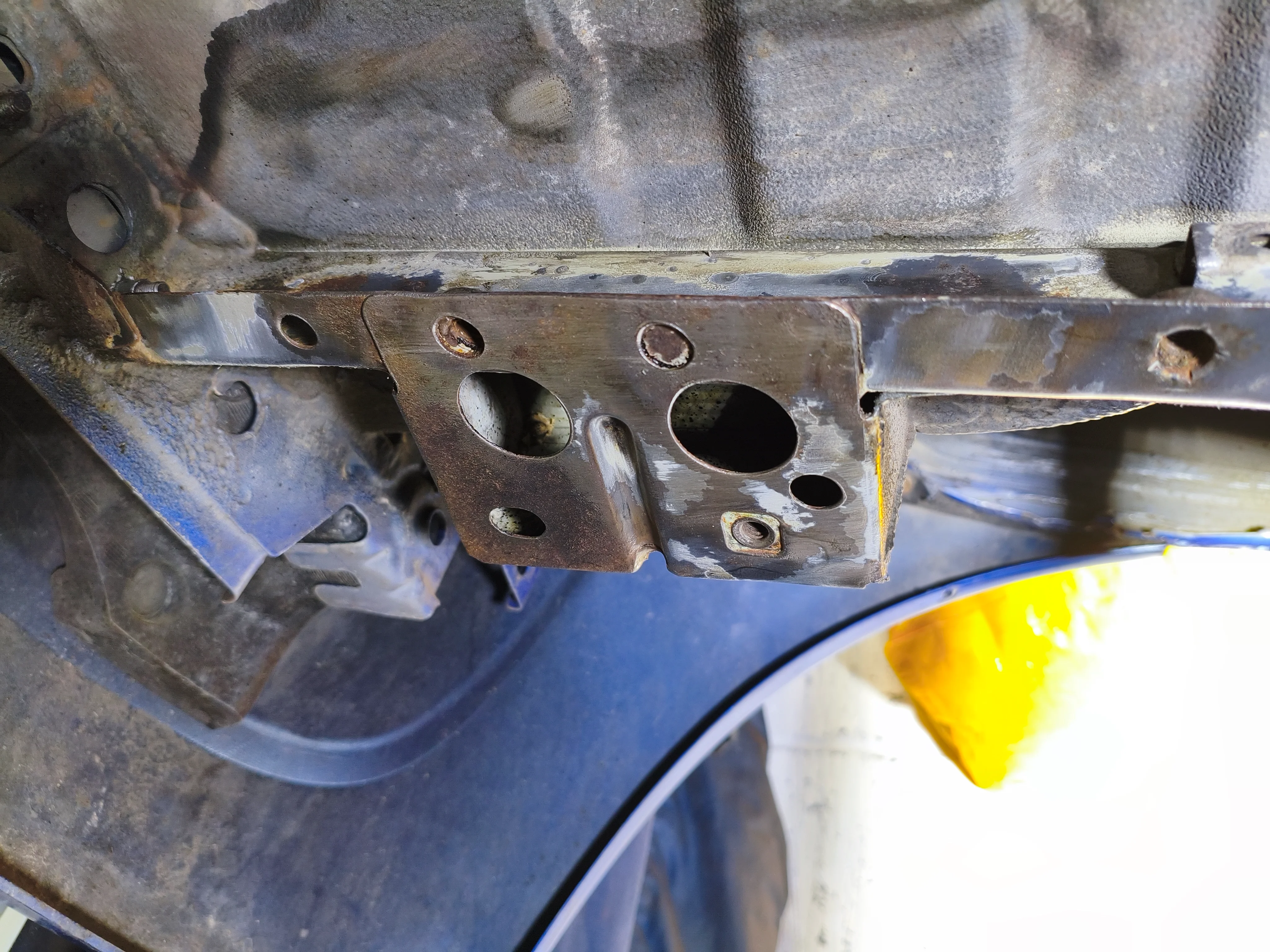

The other side is pretty much the same, however to get to it I need to remove the tank and filler neck

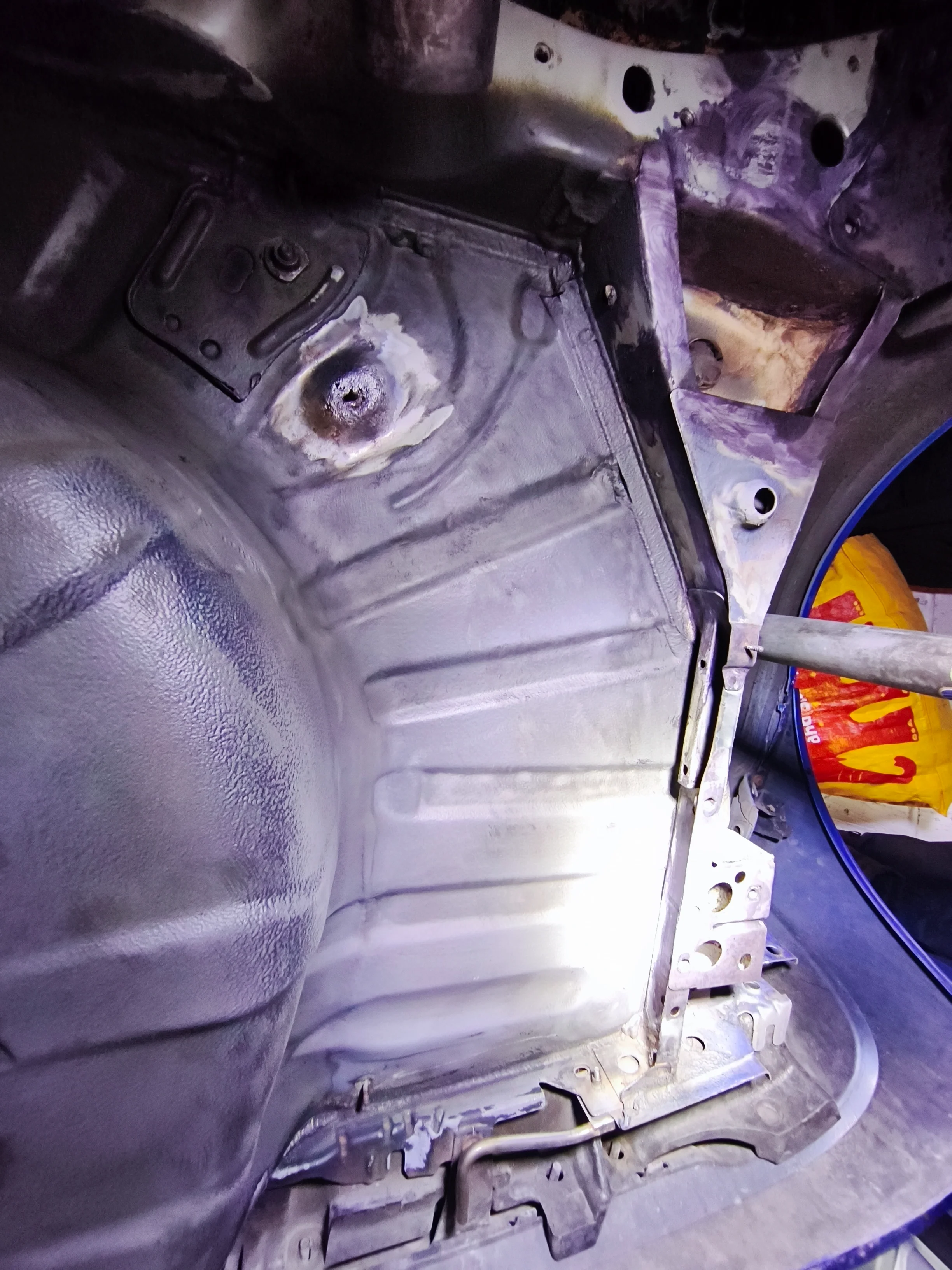

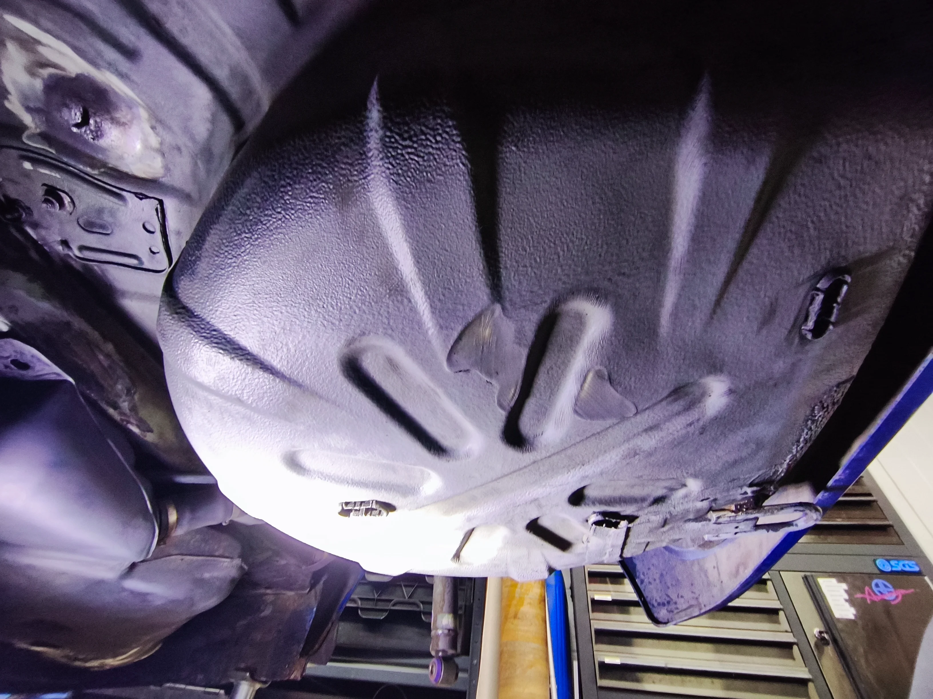

Caught another couple of scabs on the spare wheel well and inside the rear arch
So I think I'm at the point where there's enough spot repairs that it makes sense to drop the tank and refinish this area at least

I removed the back bumper and got the aft end of the spare wheel well cleaned up and keyed for painting

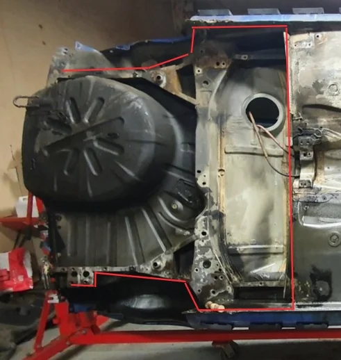

I've always known the rear jacking points were a bit frilly, the drivers side being worse and also a bit deformed from previous owners careless jacking too, if I'm painting the rear half of the floor it's an ideal time to sort it so I removed the side skirt and started poking around
Balls..
Not great, but also not the worst I've seen by a fair margin, I think the sad truth is unless it's never been out in the rain or has already been done all Mk2's are probably like this now.
I've supported the car on the front chassis rail but I need to get a significantly taller axle stand I can sit under the axle mount before going any further, I've ordered a pair of outer sills too.

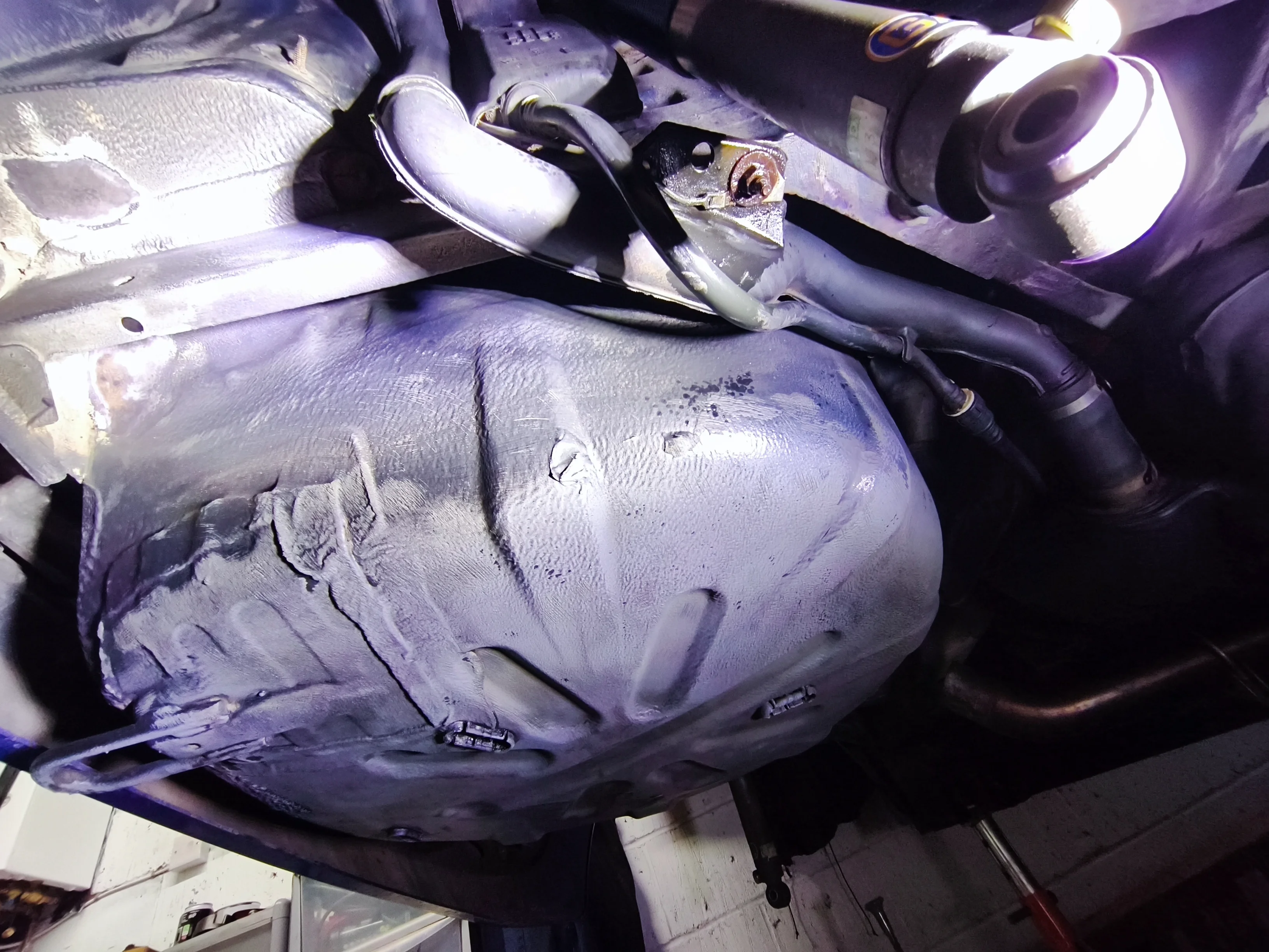

Good few hours in the garage today, got the tank and filler neck out, there was about 10L of V power left in it which I've chucked in the Volvo, bonus!
It was pretty good under the tank, just dirty and plenty of sticky black bitumen underseal
Hours of cleaning later, it looks loads better
I've also been at every little rust spot I can find with knot wheels and the finger sander, then rust converter.
