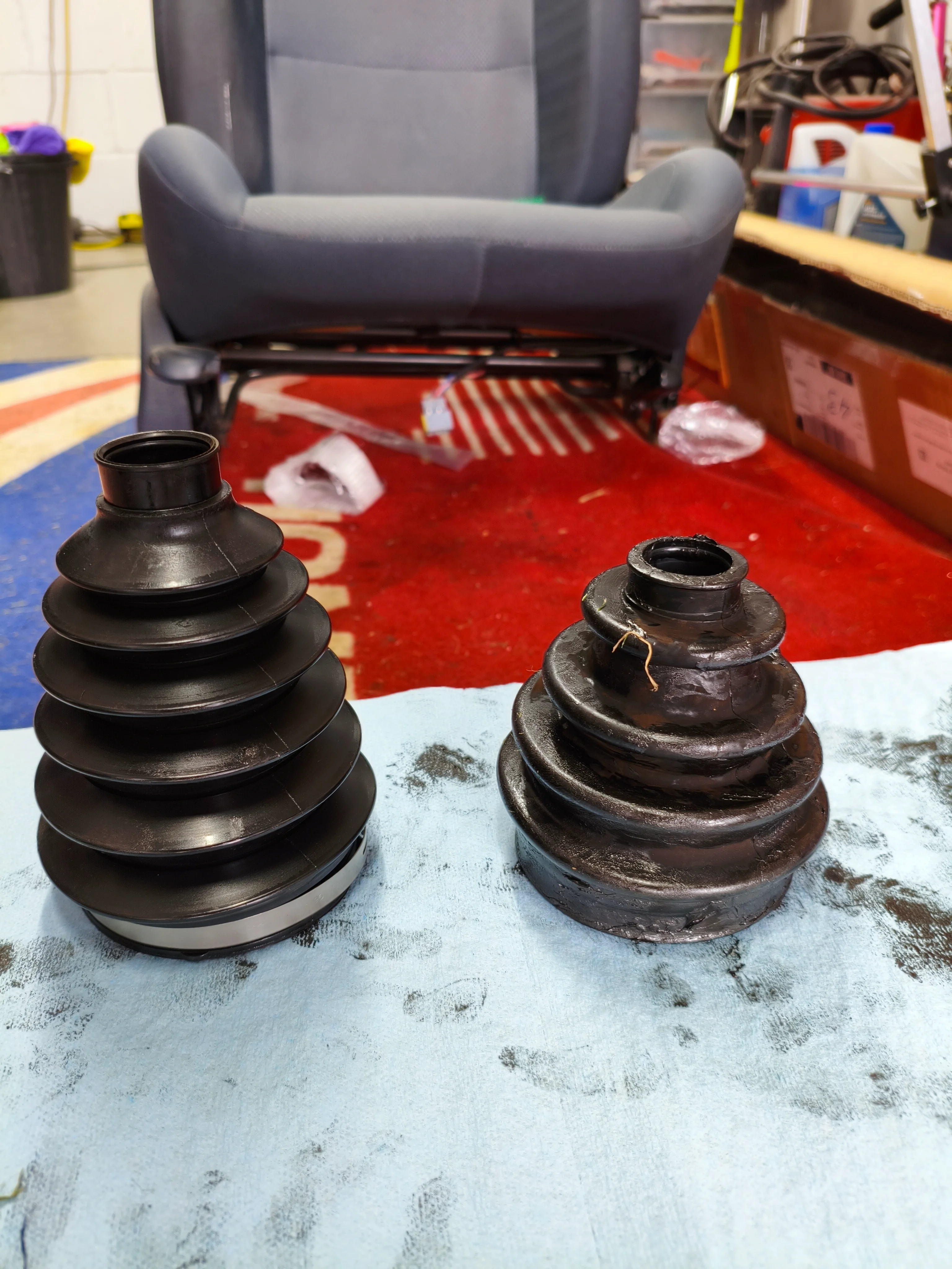

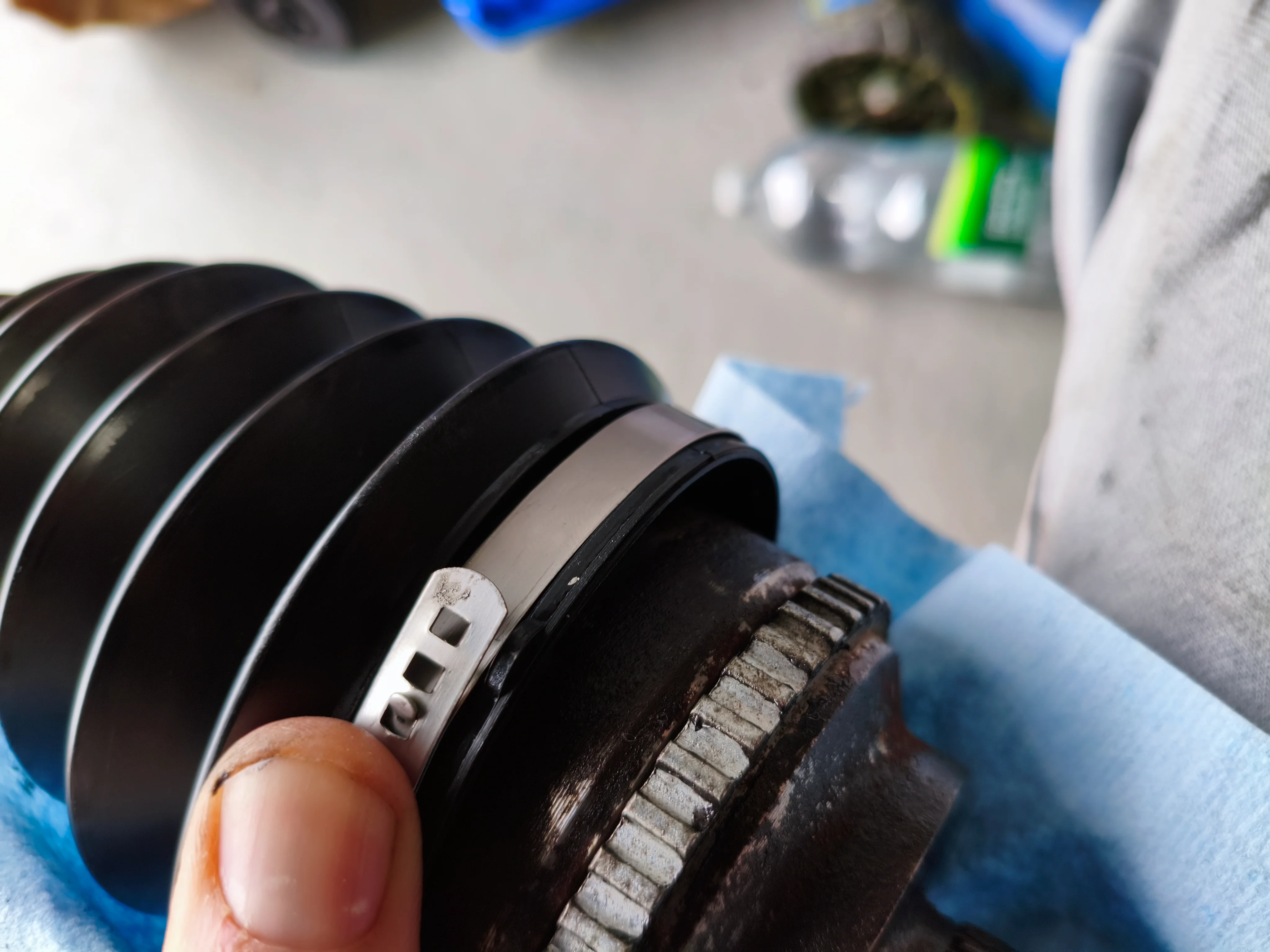

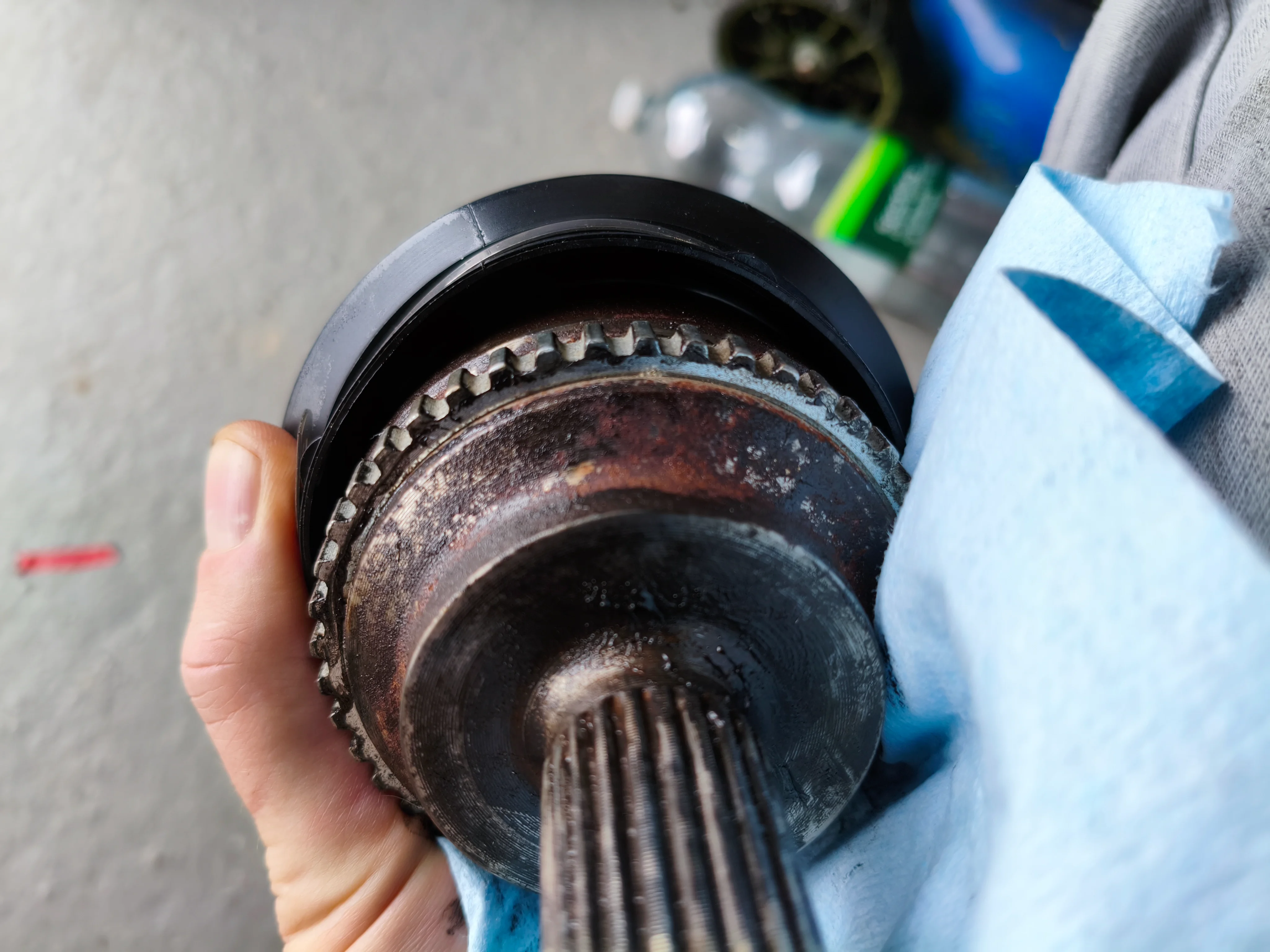

Had the day at home today so did a bit more with the car, when I was checking it over last Sunday I spotted a little split in the outer CV boot on the passenger side.

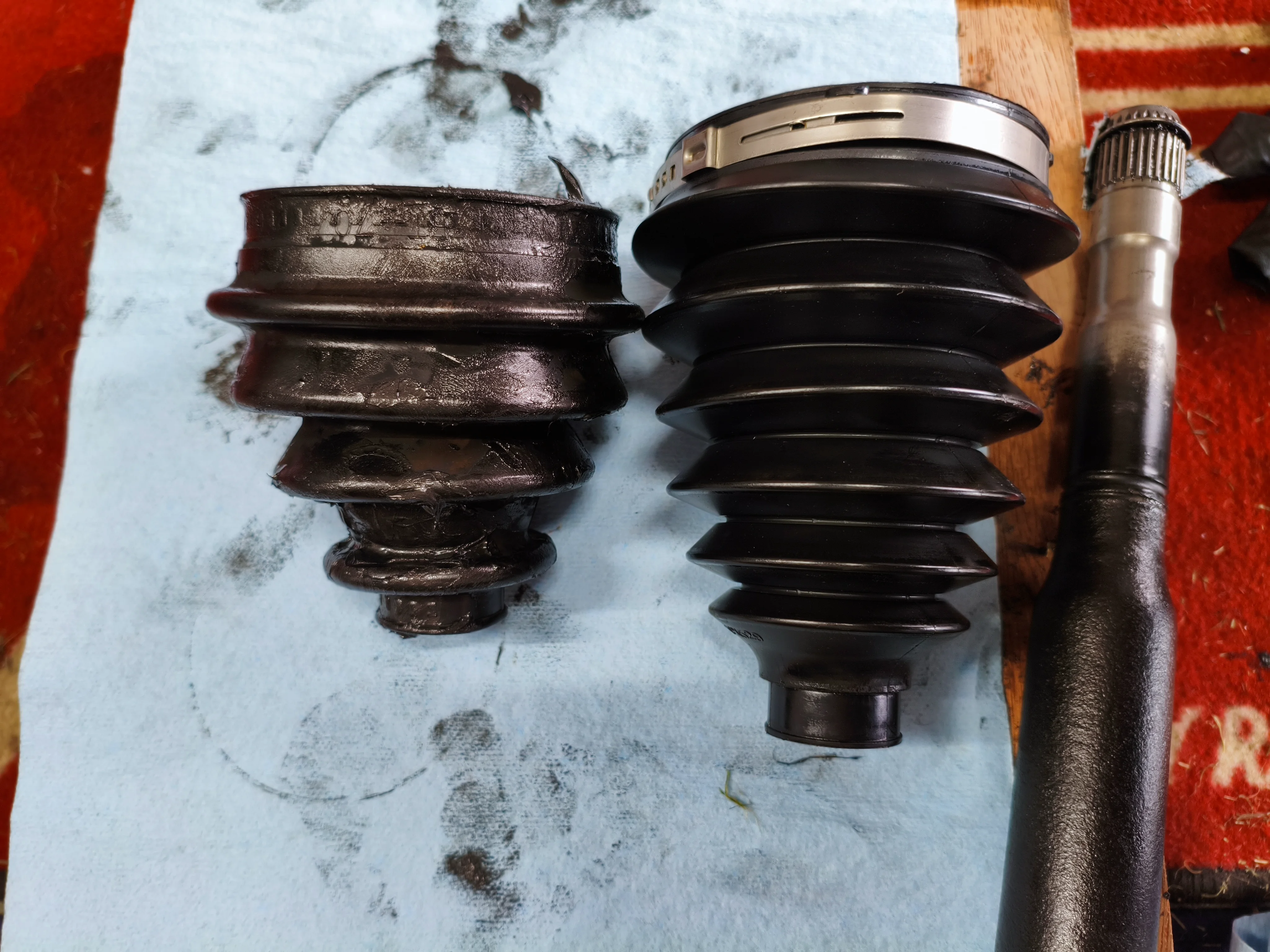

I ordered a Febi one from partsinmotion during the week, which turned out to be as much use as tits on a fish, incorrect in every dimension.

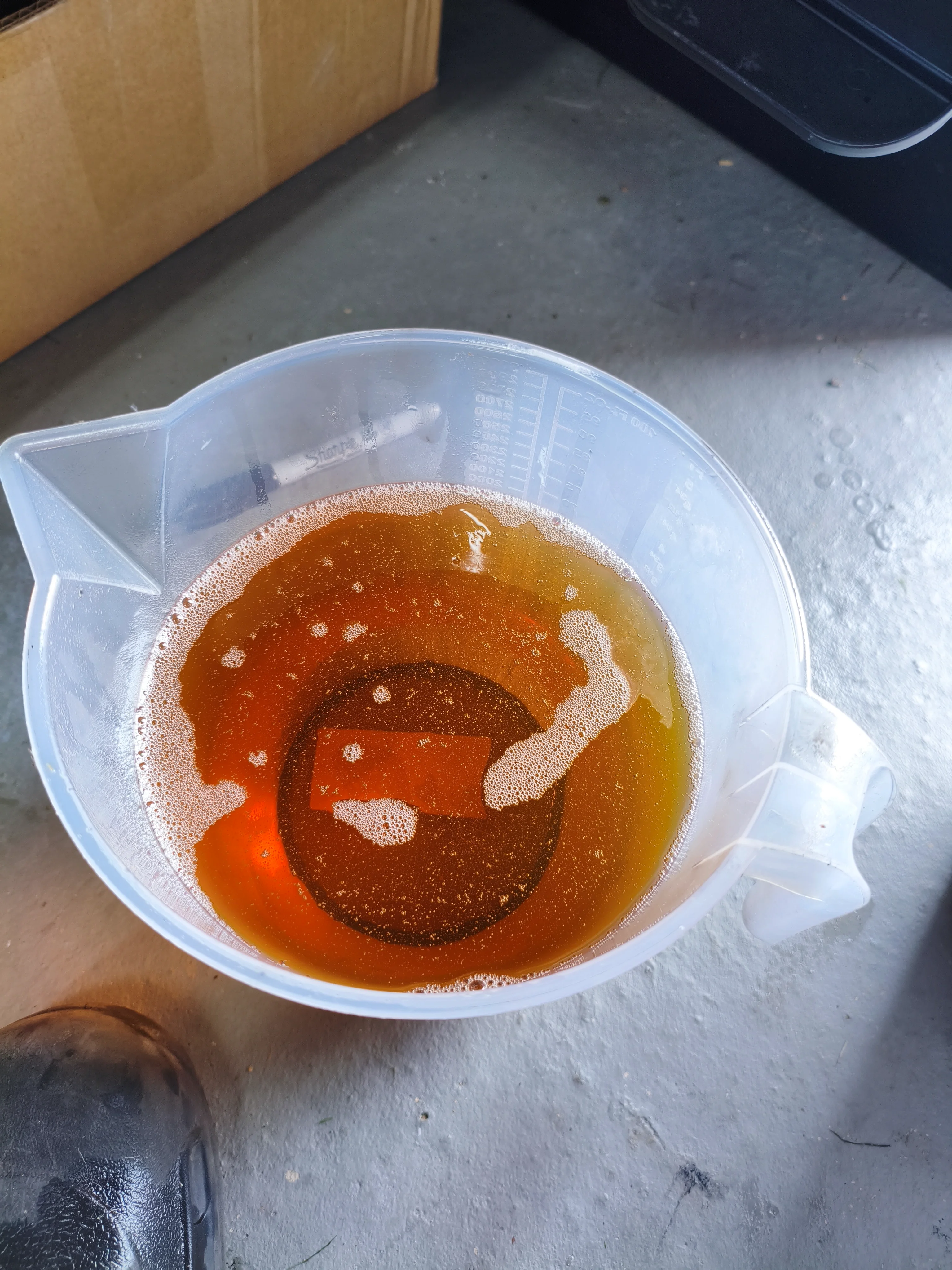

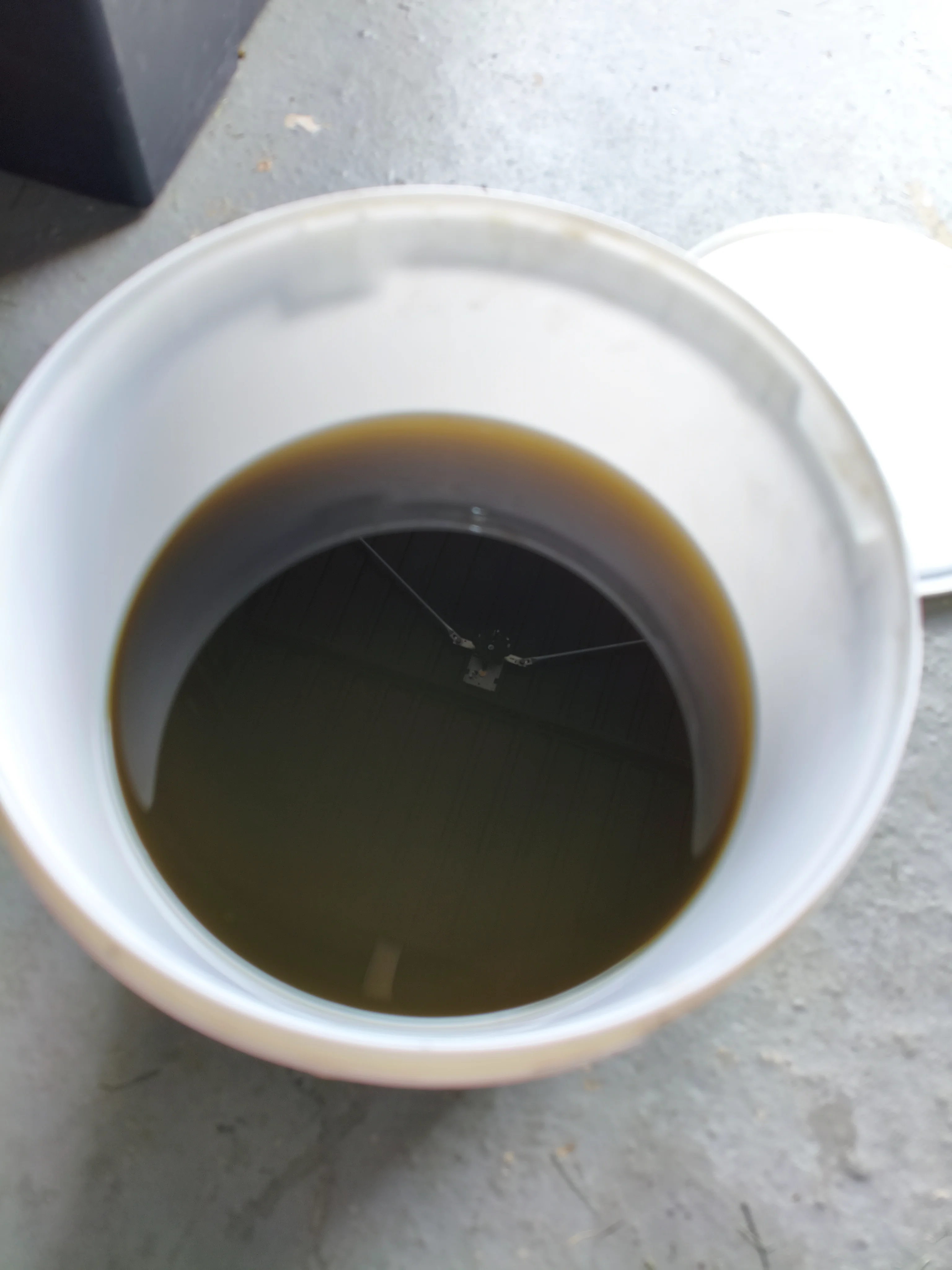

So I resorted to a Sealey universal stretch boot from ECP which fits perfectly TBH, obviously I had to drain the 2 month old gearbox oil to fix it, I was planning on putting it back in so I caught it in a clean 3L measuring jug and strained it through a 190 micron paint filter into a new clean bucket
There were no bits of gearbox in the strainer which was nice, but I just couldn't put used oil back in, despite it having only done about 600 miles.
I had 2L left of the 5L bottle of Millers CRX gearbox oil so that went in instead

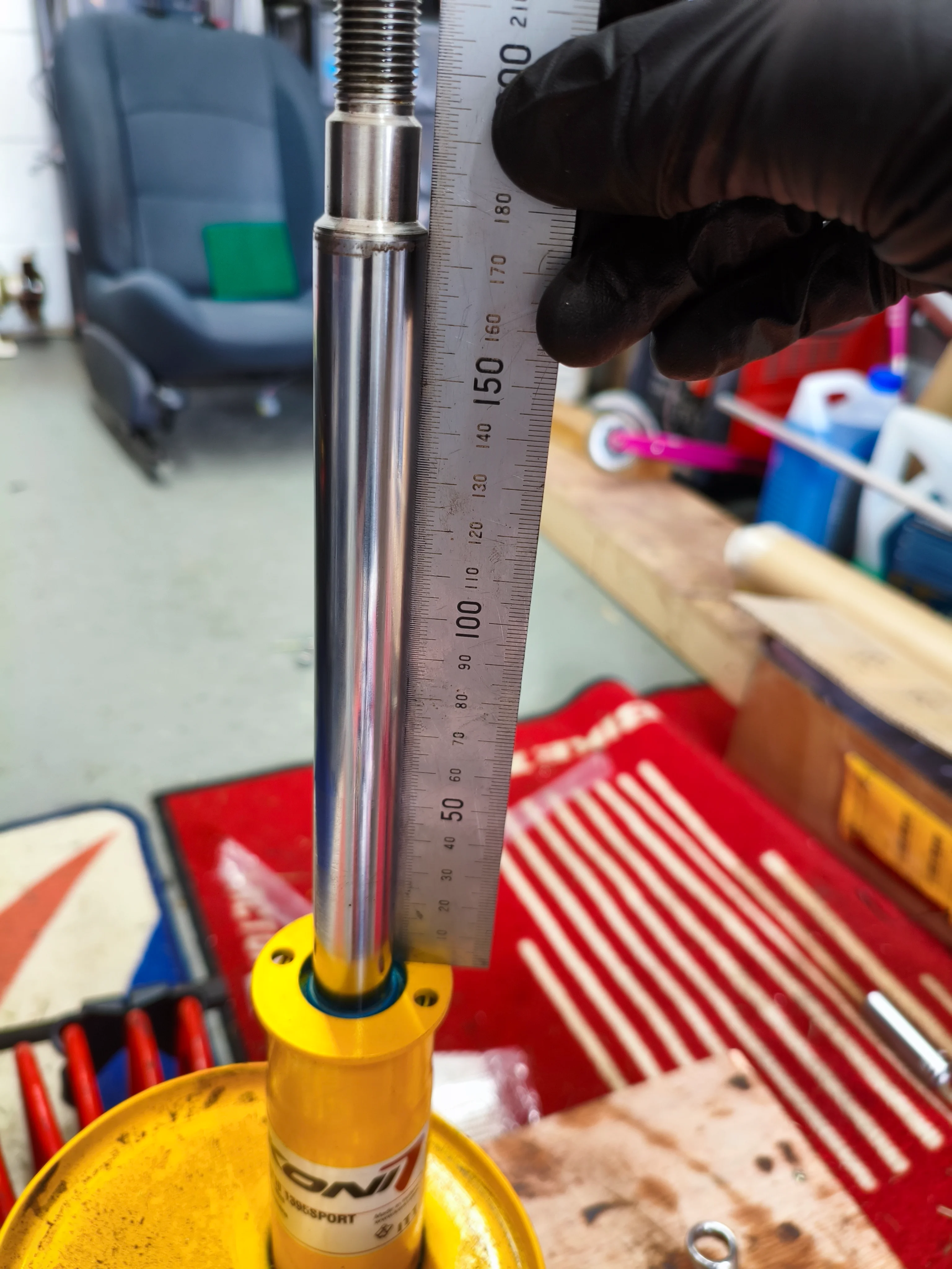

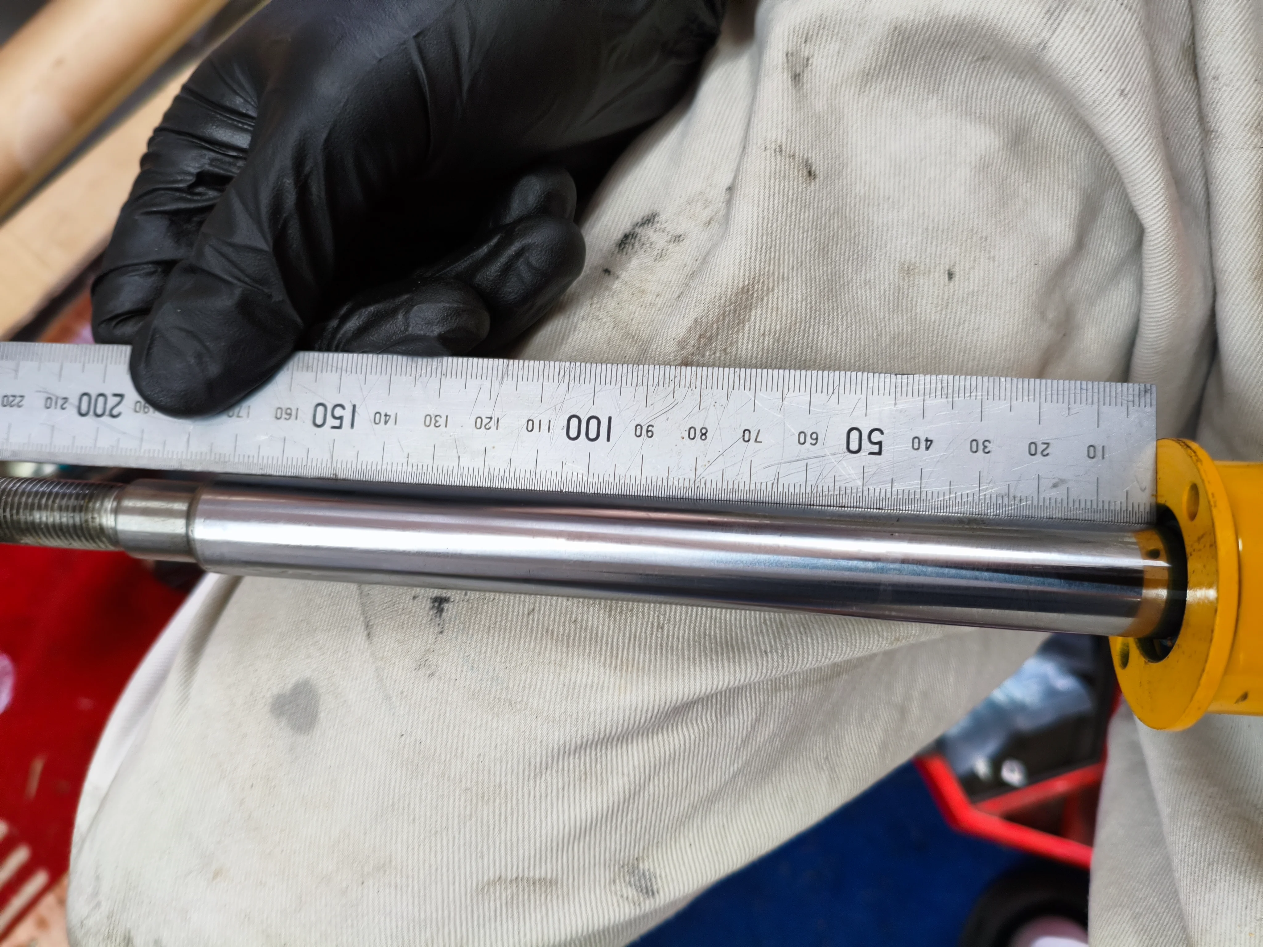

After @NorthloopCup made a very realistic suggestion that the damper rod could be bent at cadwell it gave me the fear so I've had that apart today too and thankfully it's perfectly straight.

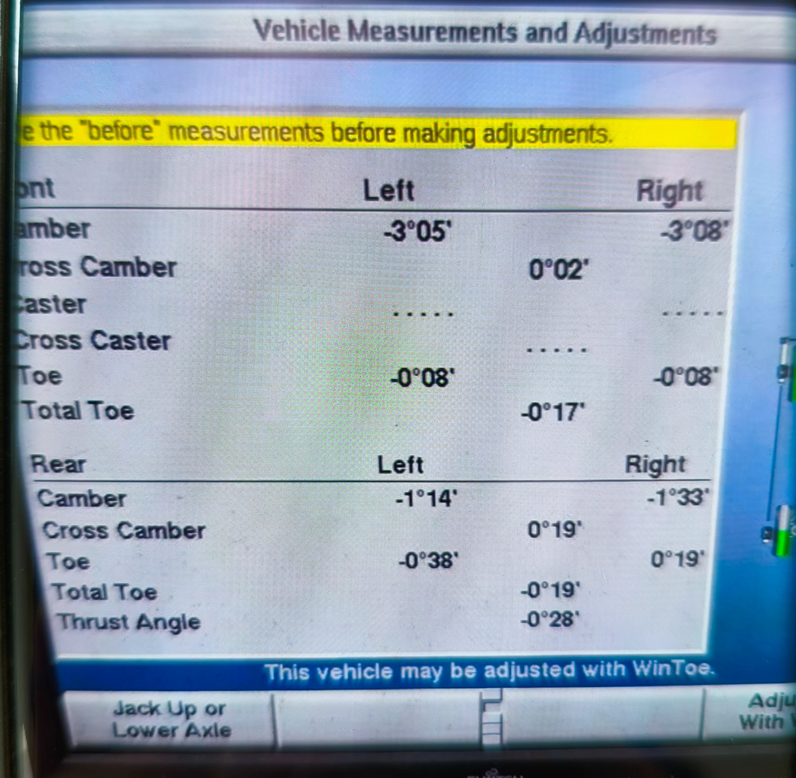

Had the car in for a check over and alignment this morning, front only needed minor adjustment but the rear beam is bent and/or moved over on it's mounts. NSR is toeing out 0.38' and OSR is toeing in 0.19', I was planning on getting the beam blasted and powder coated over winter anyway so I'm not too fussed.

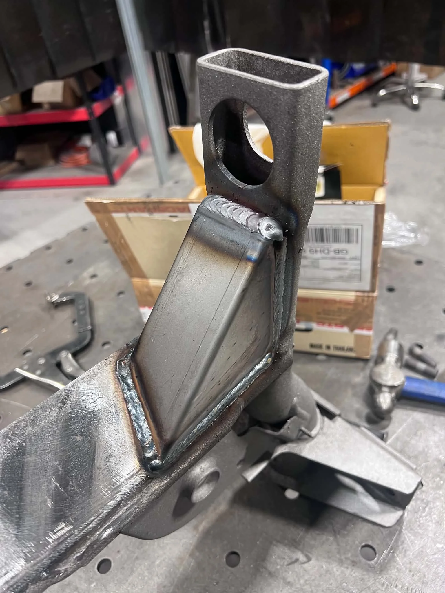

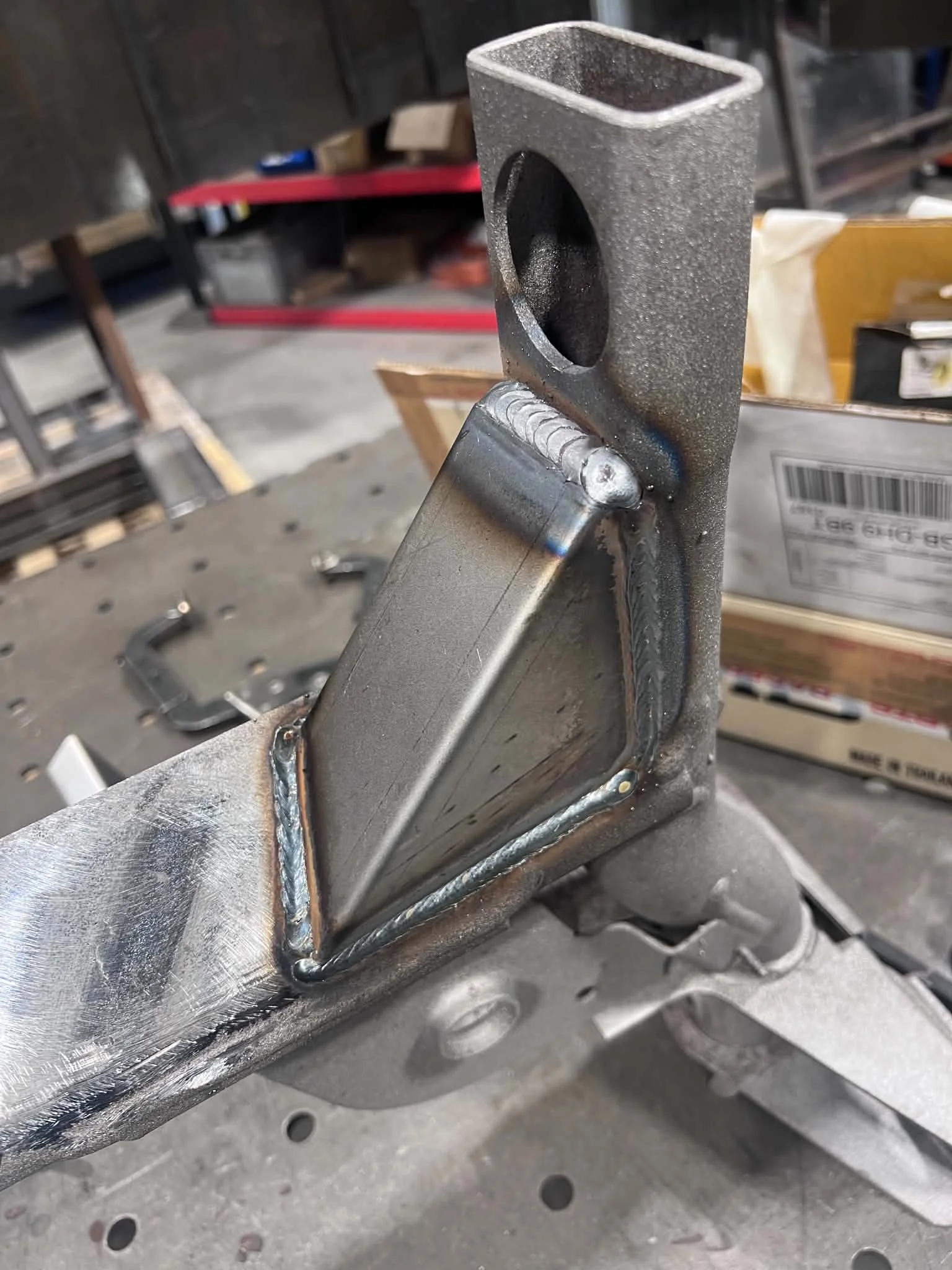

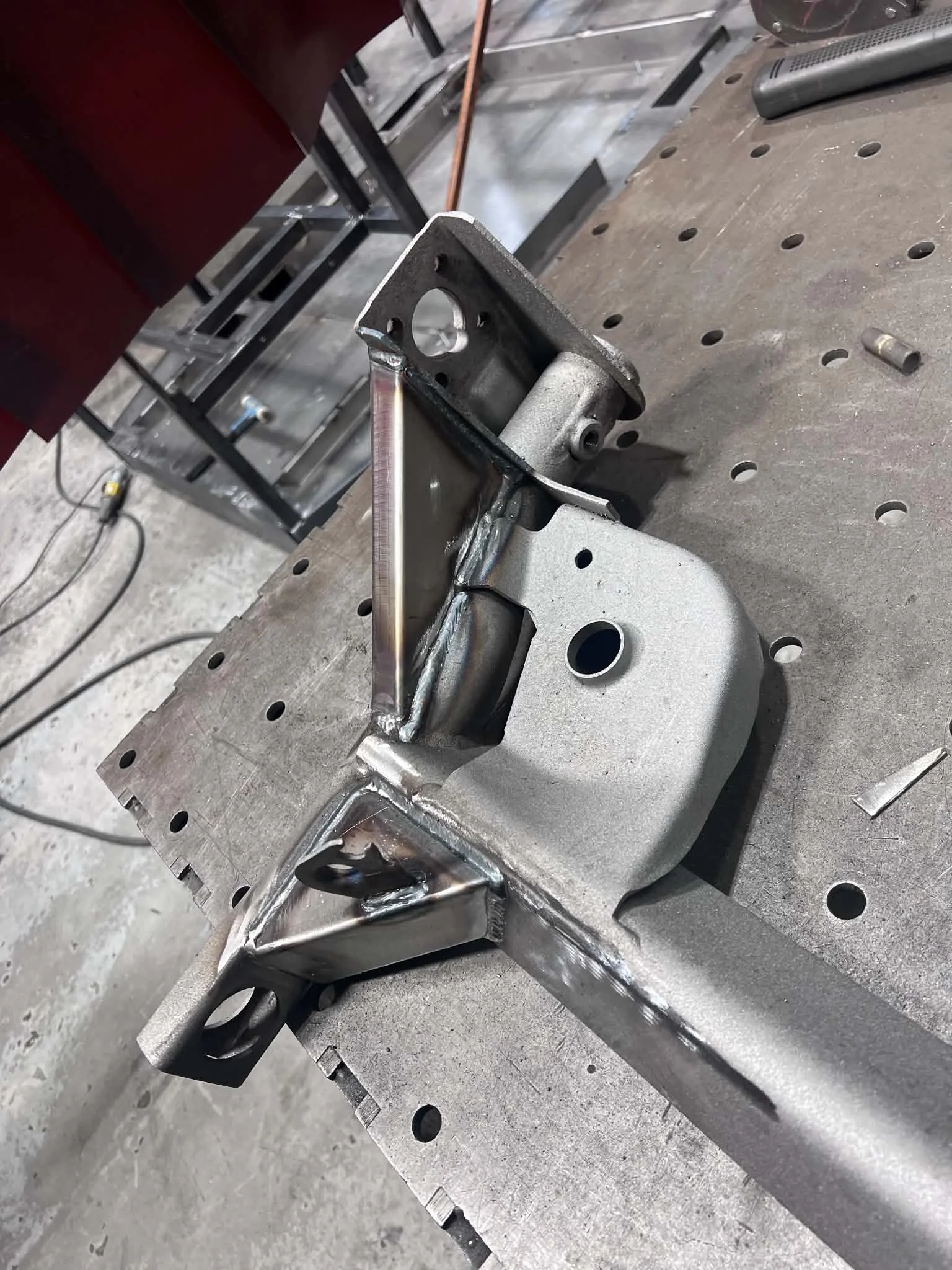

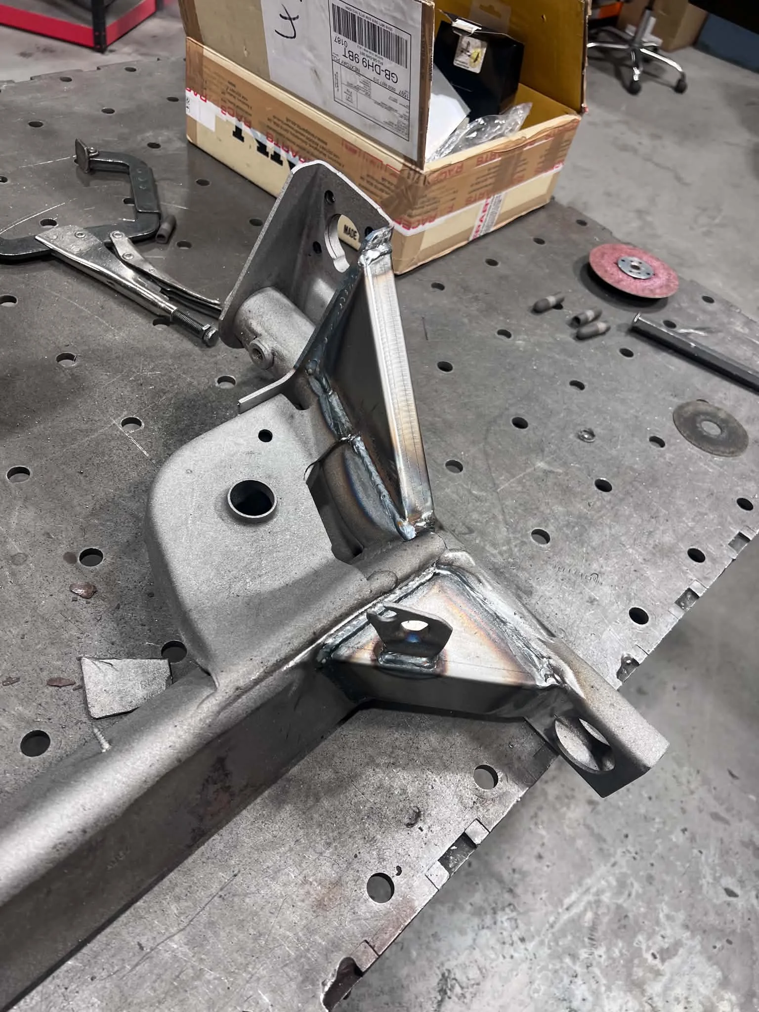

Picked up this 182 rear beam today, which is a bonus as it's got the thicker/wider stub axles and the additional factory bracing under the spring pans
I've got it all stripped down and bushes out already, hopefully I can 'wfh' on Friday and get it over to the blasters before getting the gussets welded in. I have got a Mig welder at home and can weld to a decent standard but I honestly can't be arsed, I've not used it since I made an engine stand for my last bike build and for what my fabricator charges it's not worth me getting some more gas, another spool of wire and doing it myself.

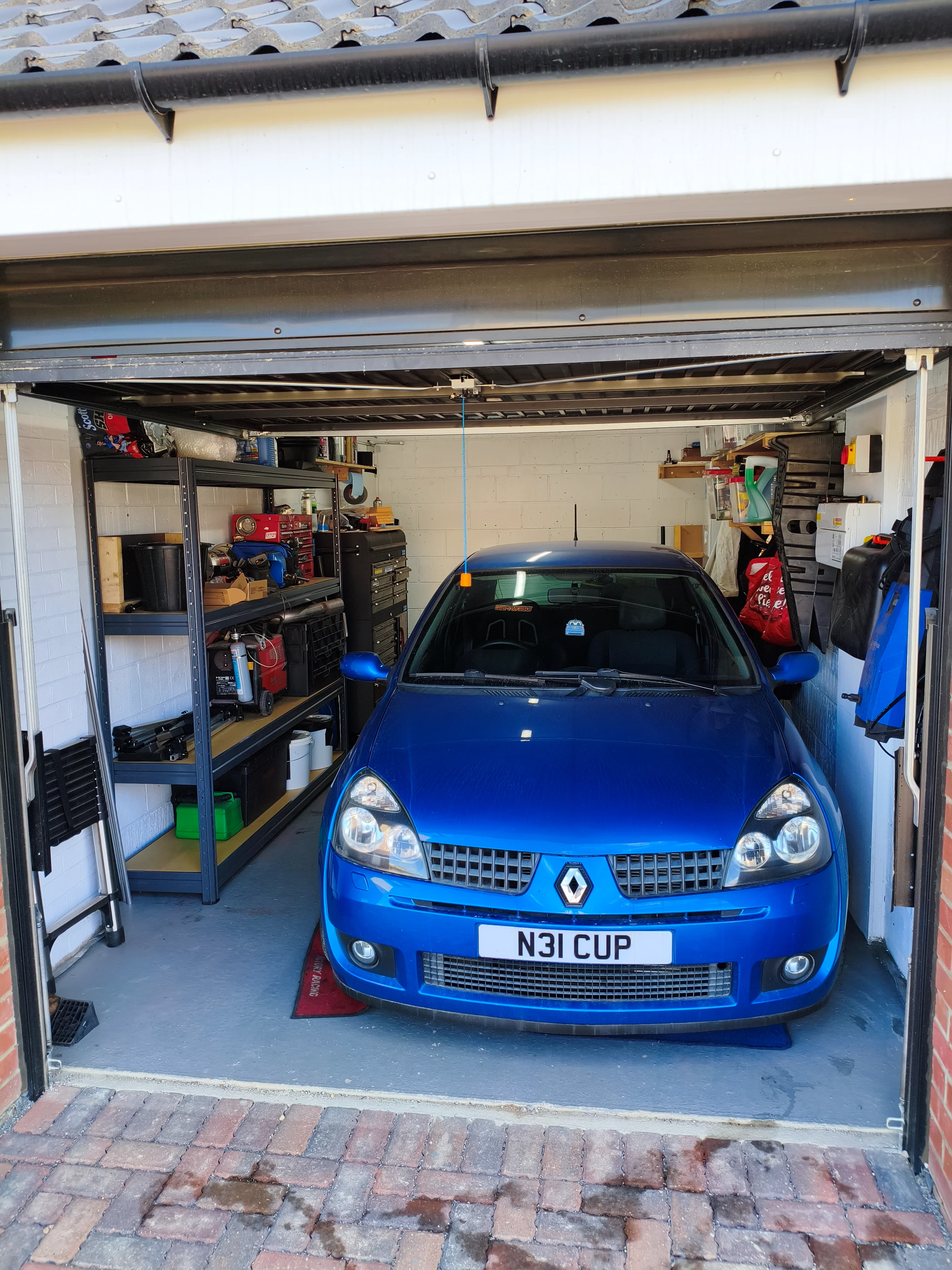

The Clio has sat outside collecting dust and cobwebs since I had the alignment checked and found out the axle was pointing in the wrong direction, I had a message off the fabricator yesterday to say the rear beam is nearly done, he's just got the shock mounts to do then I need to call over there with my one piece brake hoses so he can tack on some cable tie saddles to secure them to the rear beam

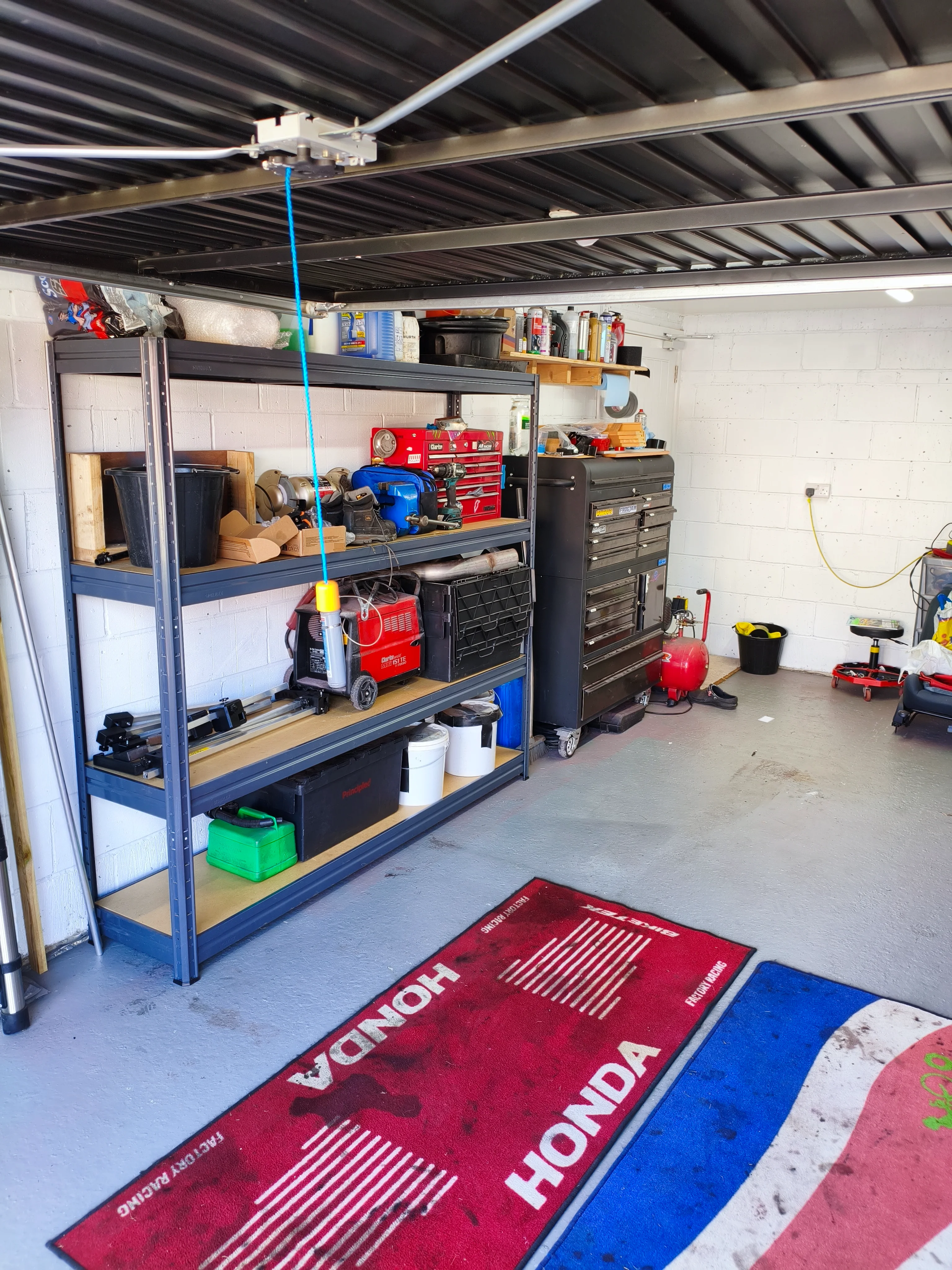

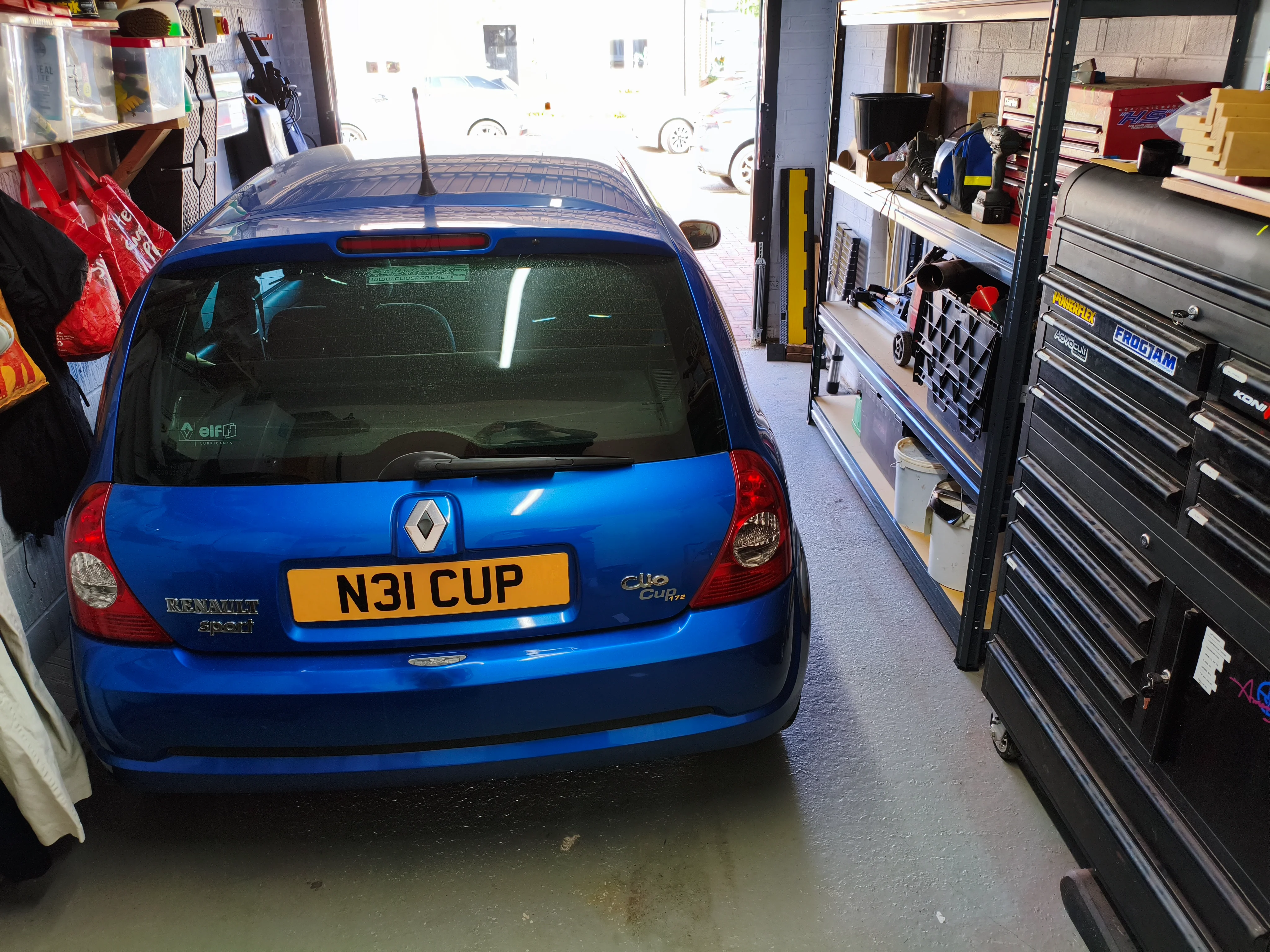

I've also managed to get a decent sized (12x8ft) shed built so my engine crane, engine stand and bicycles etc are now out of the garage, I've bought a new shelving unit too so there's now space to get the car inside
There's a couple of metres space behind the car too, next job will be to build a new workbench along the back wall like I had in the previous house.
I'm going to whip the two scuffed wheels off and get them over to the powder coaters next week, then send the beam and brackets off when I get them back.

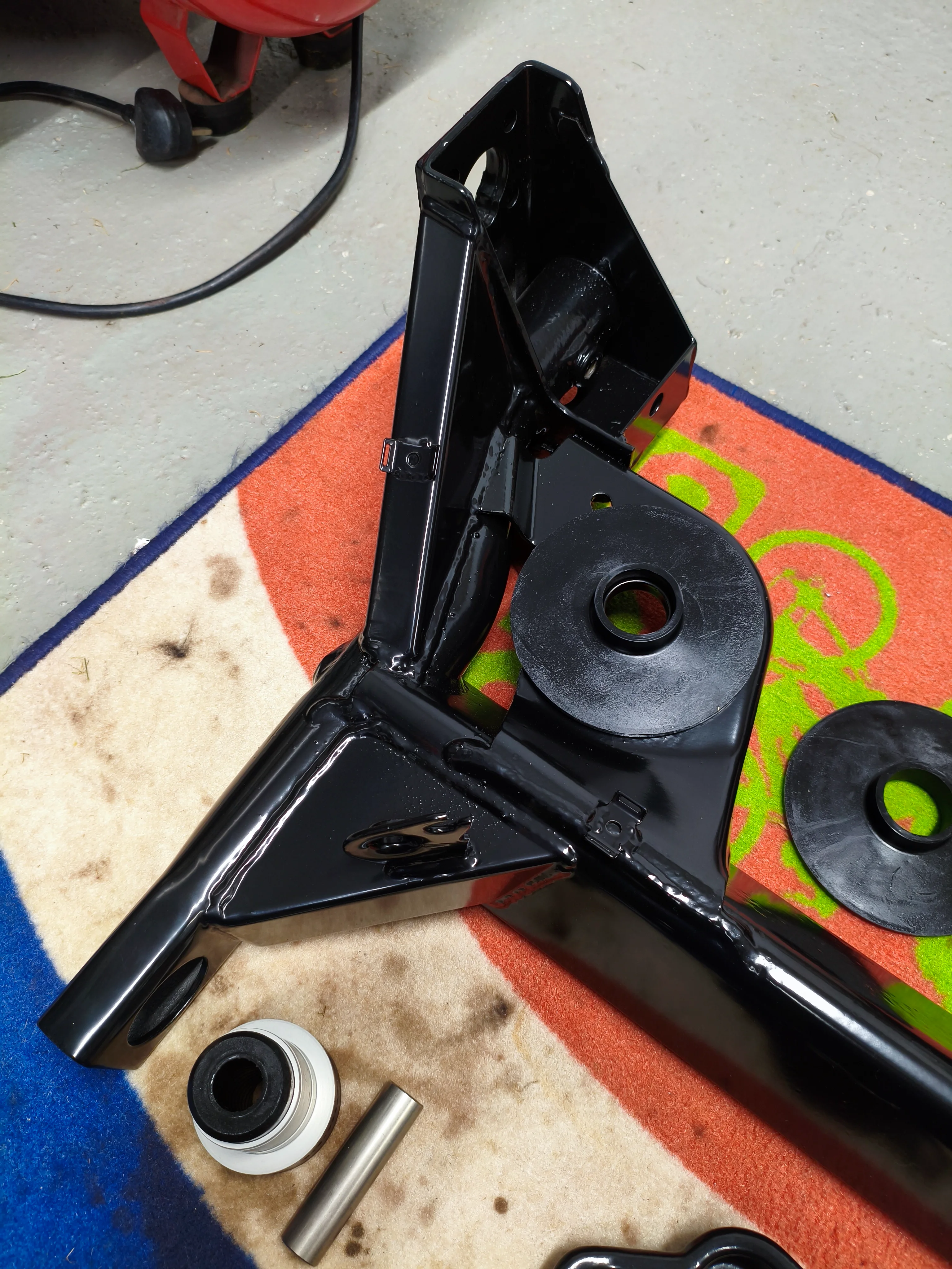

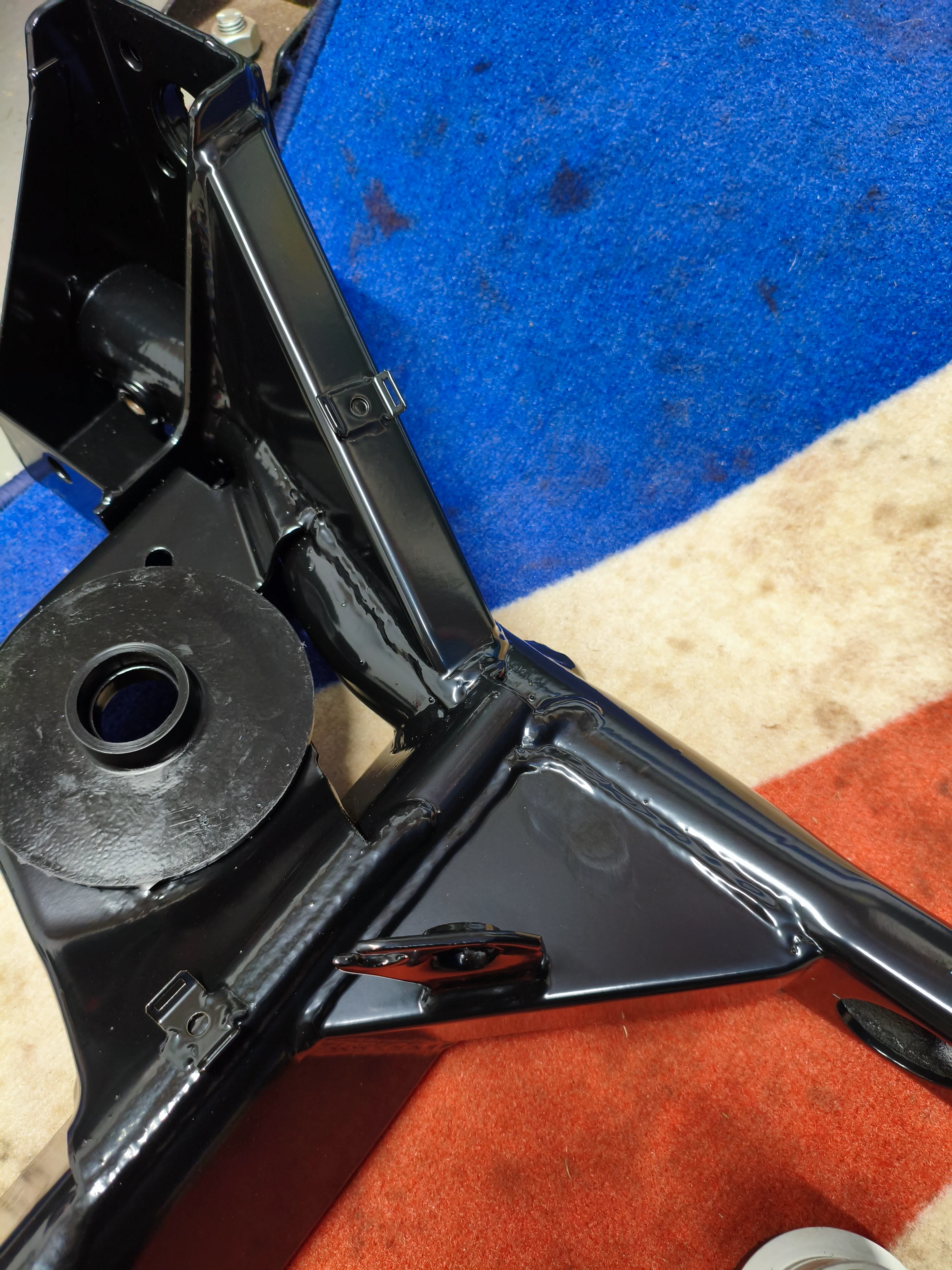

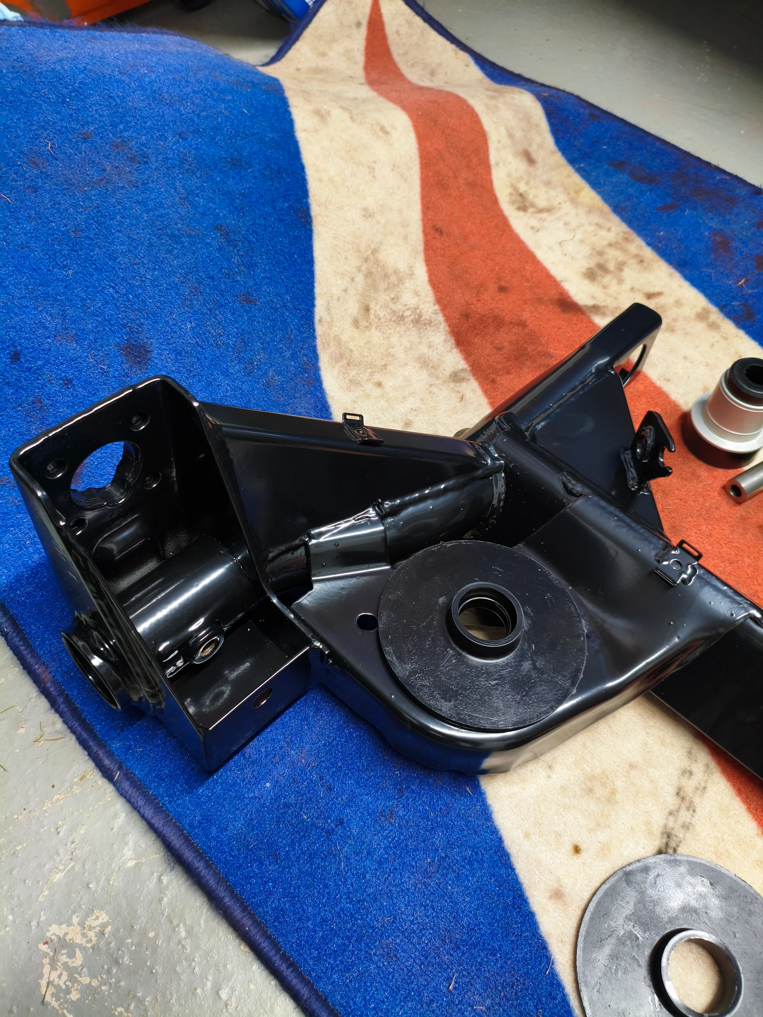

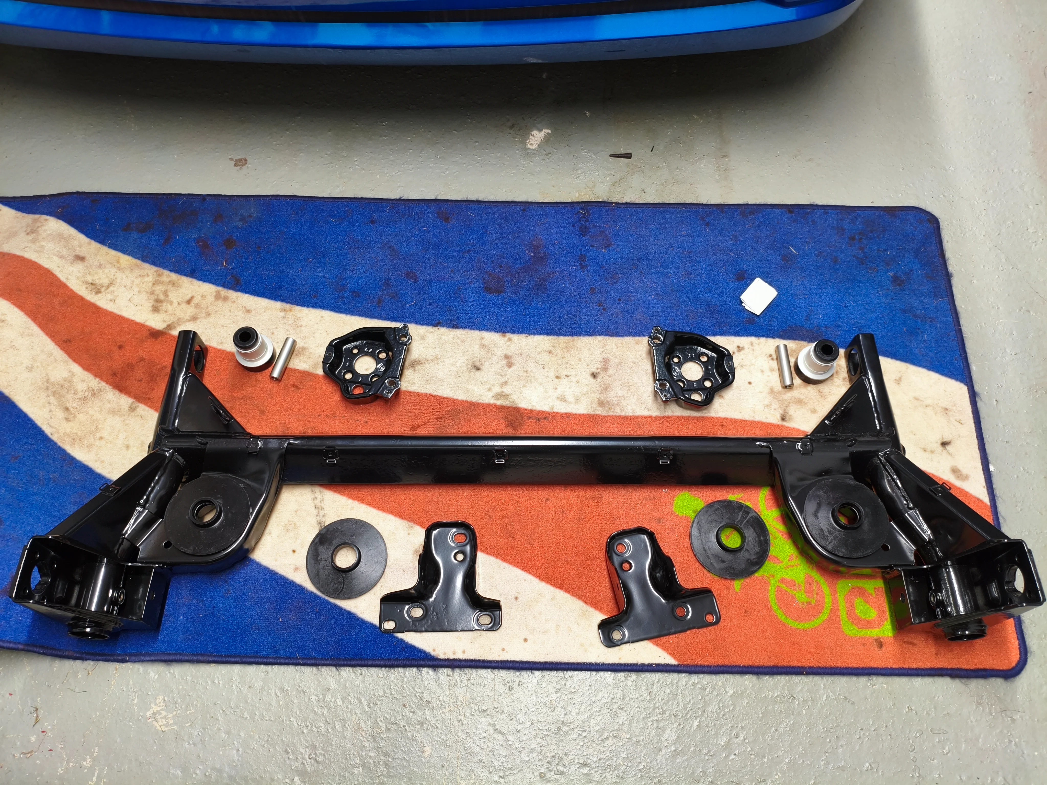

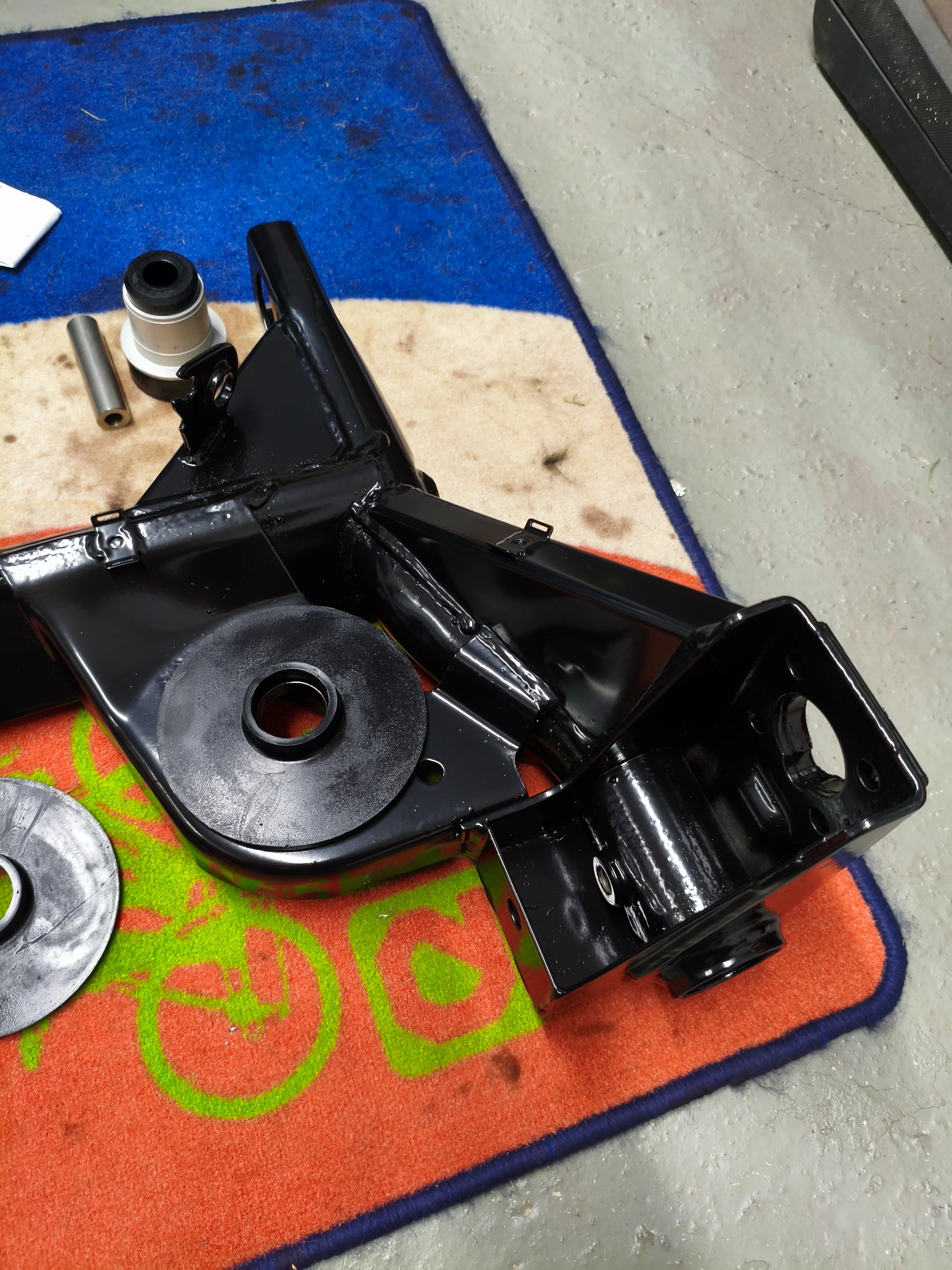

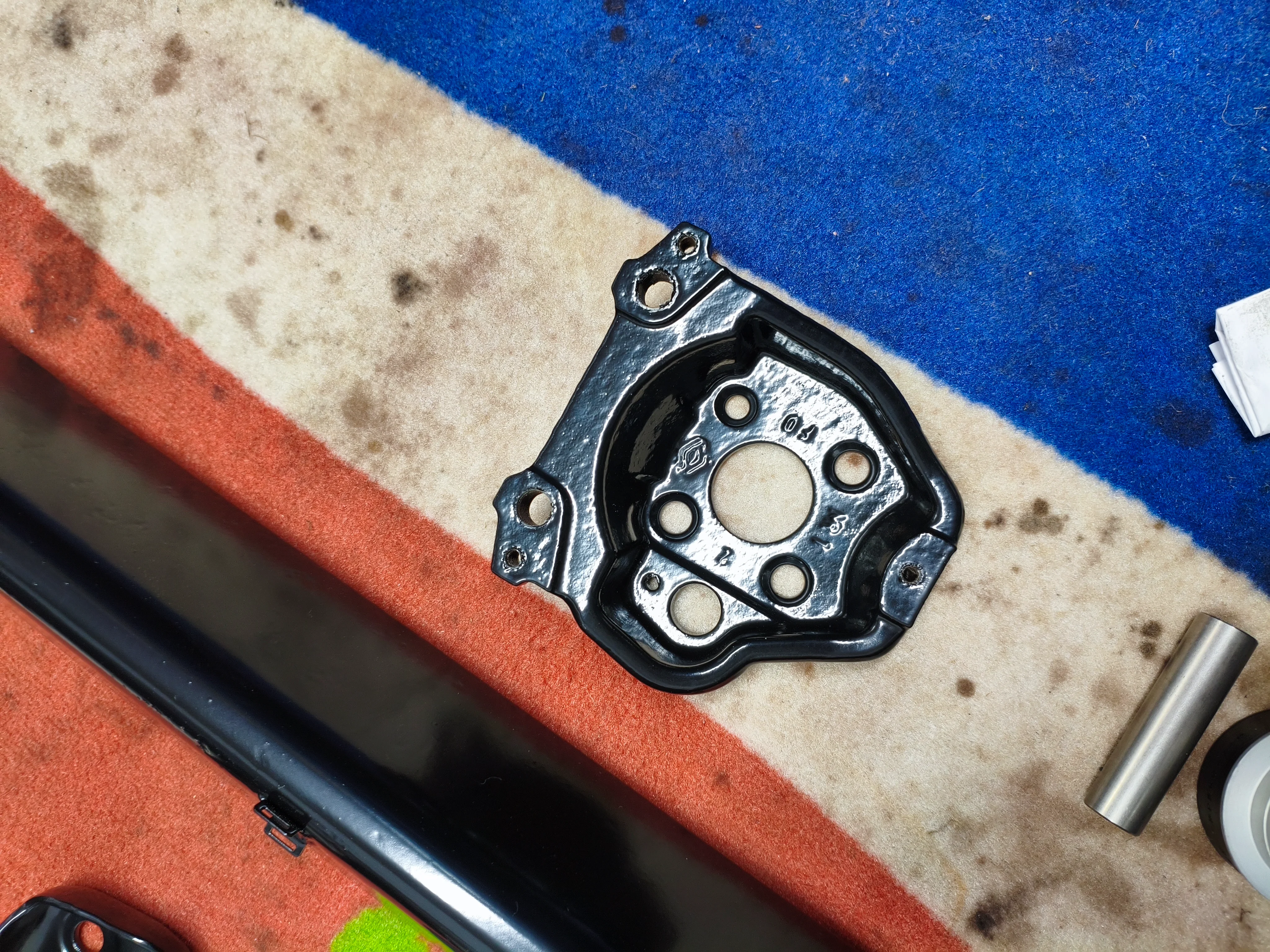

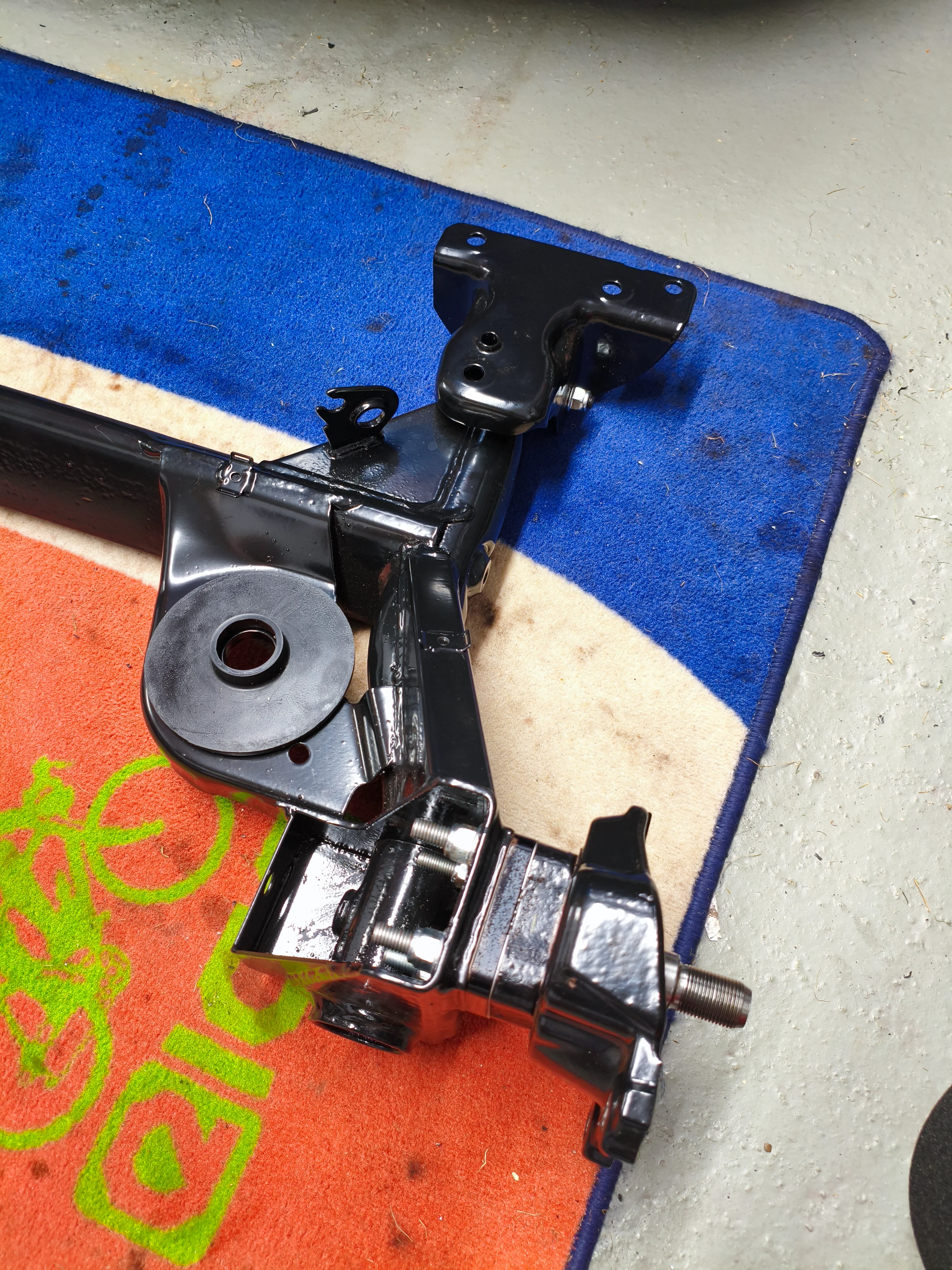

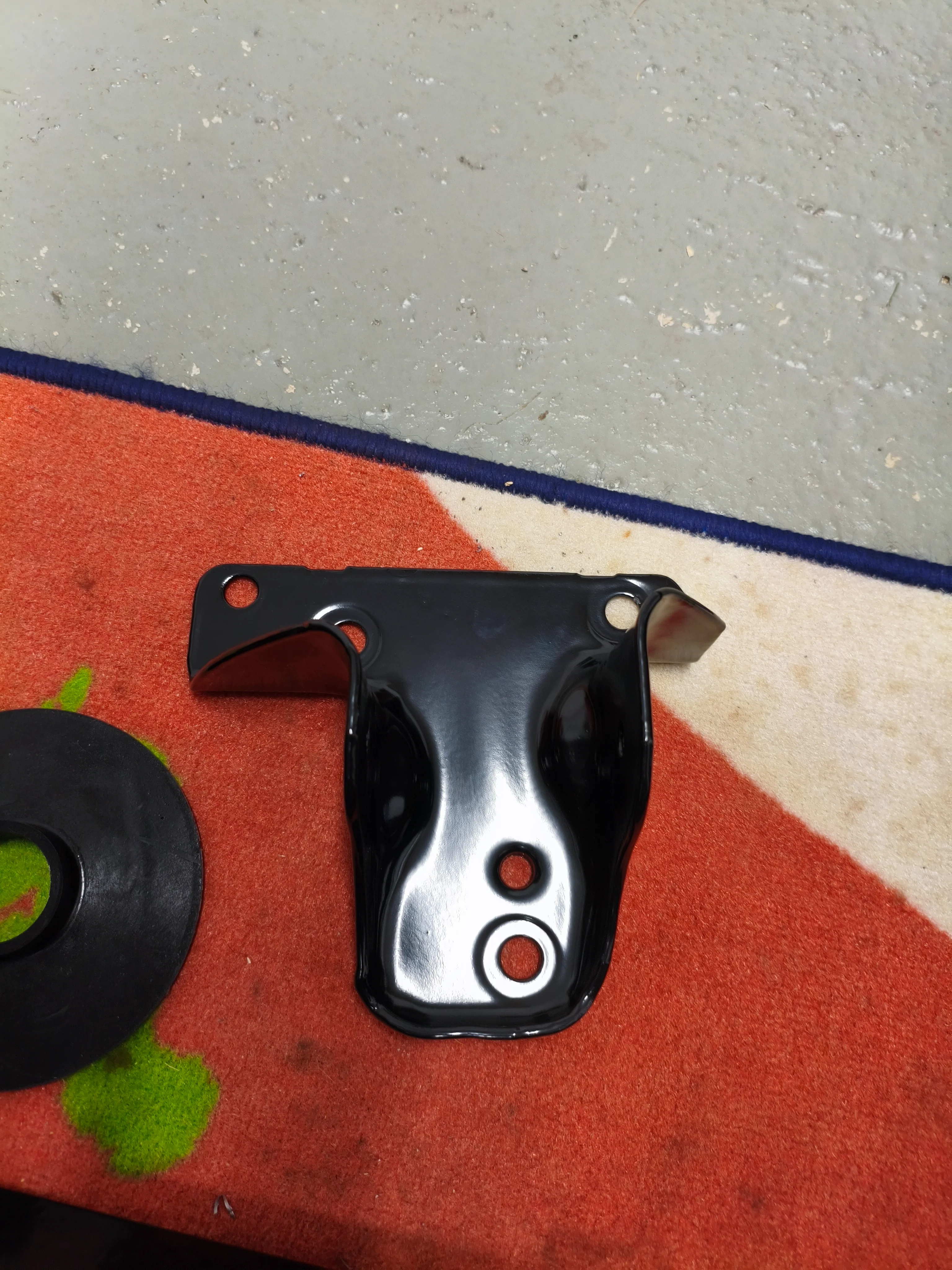

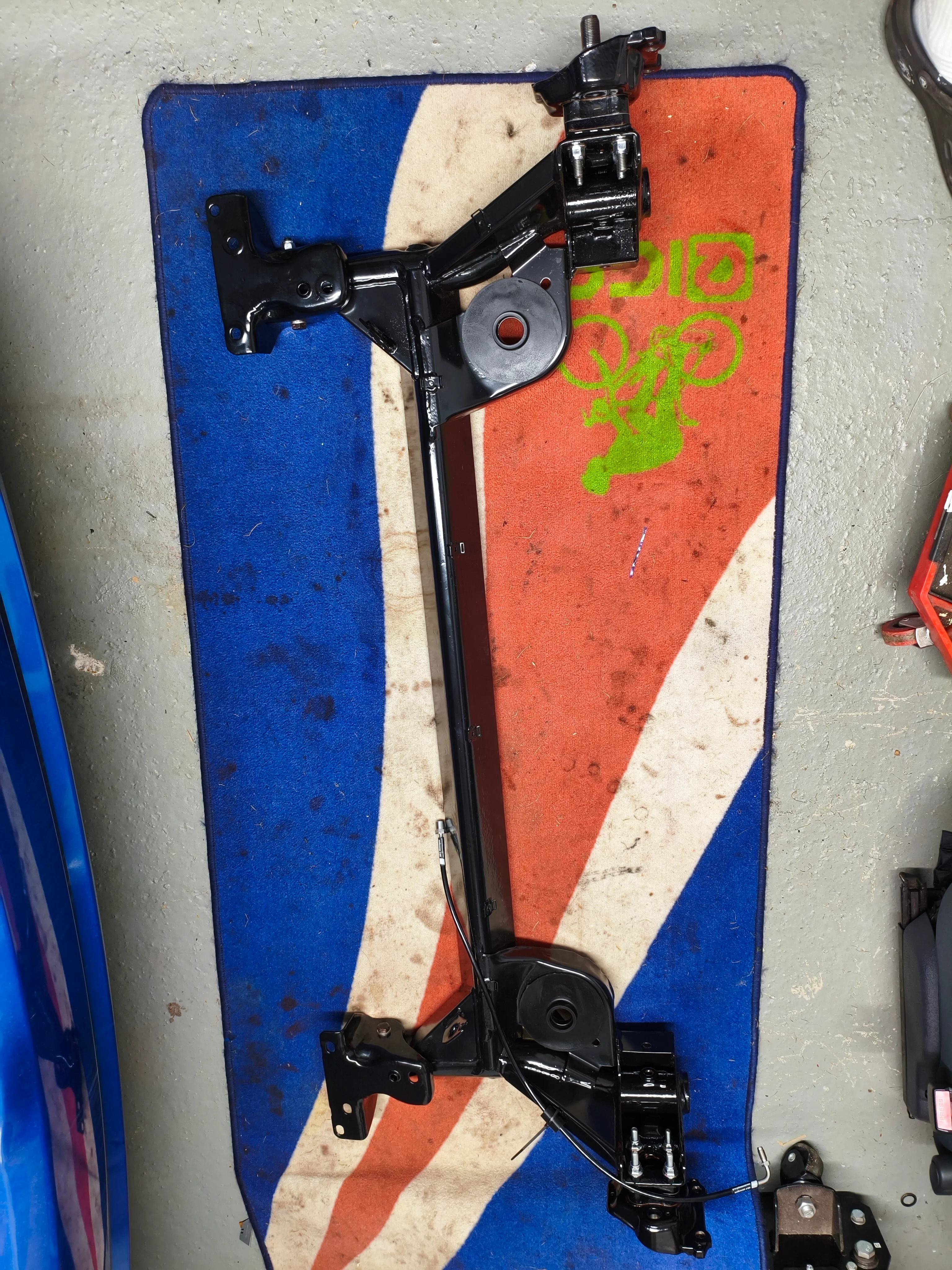

Picked up the rear beam this afternoon, really happy with how it's turned out. If I get time before I go back to work I'll get the bushes in, there's some bits of powder coat to take off - inside the holes for the stub axle bolts, counter sink areas on the caliper mounting brackets etc
I also need to paint the exposed part of the stub axles, I probably should have sent them for powder too but I didn't want them blasting the bearing mounting surface/threads. I'm also not sheeting off the garage to spray 2K for two tiny parts so they'll get some 2k epoxy primer brushed on, followed by some of the grey 2k I did the engine block in.

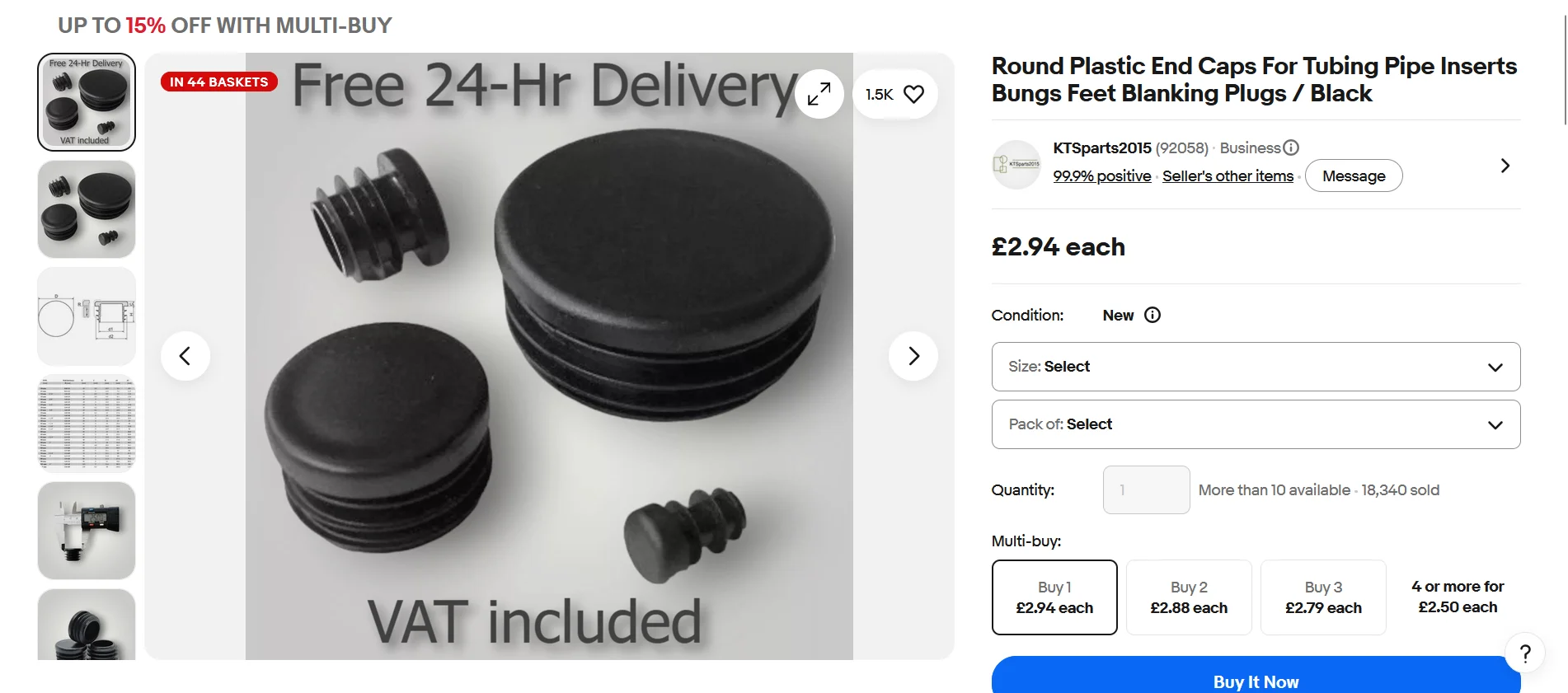

That rear beam looks amazing. Just a small tip - when I did the same a few years ago I used plastic caps on the round and rectangular bits on the rear beam. Its a good idea to absolutely coat the inside hollow of this with Bilthamber dynax or similar to prevent internal rust then use caps to seal it.
Ebay sell the caps - just search for ROUND PLASTIC BLACK BLANKING END CAP
Thanks, I had planned on pumping it full of cavity wax, great suggestion with the plastic caps 👍
Fairy difficult checking the stub axle mounting faces relative to eachother without a jig, I've got a couple of laser tools for aligning motorcycle sprockets so I can check it when I get it back.. but in reality it's just going to be a case of fitting the beam, getting it aligned and shimming the stub axles as required, which is pretty much what everyone does
I was mainly thinking for up down left right warpage from all the welding. You cant tune it all out with shims.
Not sure if factory specs are available in the workshop manual
The OEM manual only has specs for camber and caster which can be set with shims.
If you mean has the centre point of the stub axle moved in the X or Y axis relative to eachother or the centre point of their axle pivot bush, that definitely can be measured, but I doubt it will have shifted, I've certainly never heard of it from anyone else that's fitted the PMS strengthening kit.
Im just interested, not having a go. 😉
I didn't take it that way mate, TBH it's piqued my interest, I was in the garage last night looking at it. With the axle level you can pick up the edge of two of the four stub axle bolts holes at a time with a laser level, and the laser passes through and picks up the edge of the corresponding holes on the opposite flange so I'm pretty happy it's square within the tolerance of a DIY laser level, so probably +/- 1mm?

Got the stub axles painted, used brush on hammerite smooth satin in the end, it's a surprisingly close match to the black powder coating.
Got the Powerflex black series axle bushes in and the brackets on, then got the stub axles, 1° camber shims, PMS spacers and caliper brackets all bolted up
The axle is basically ready to bolt on now, I'm going to try to do it in the garage, as I don't really want to be working outside.

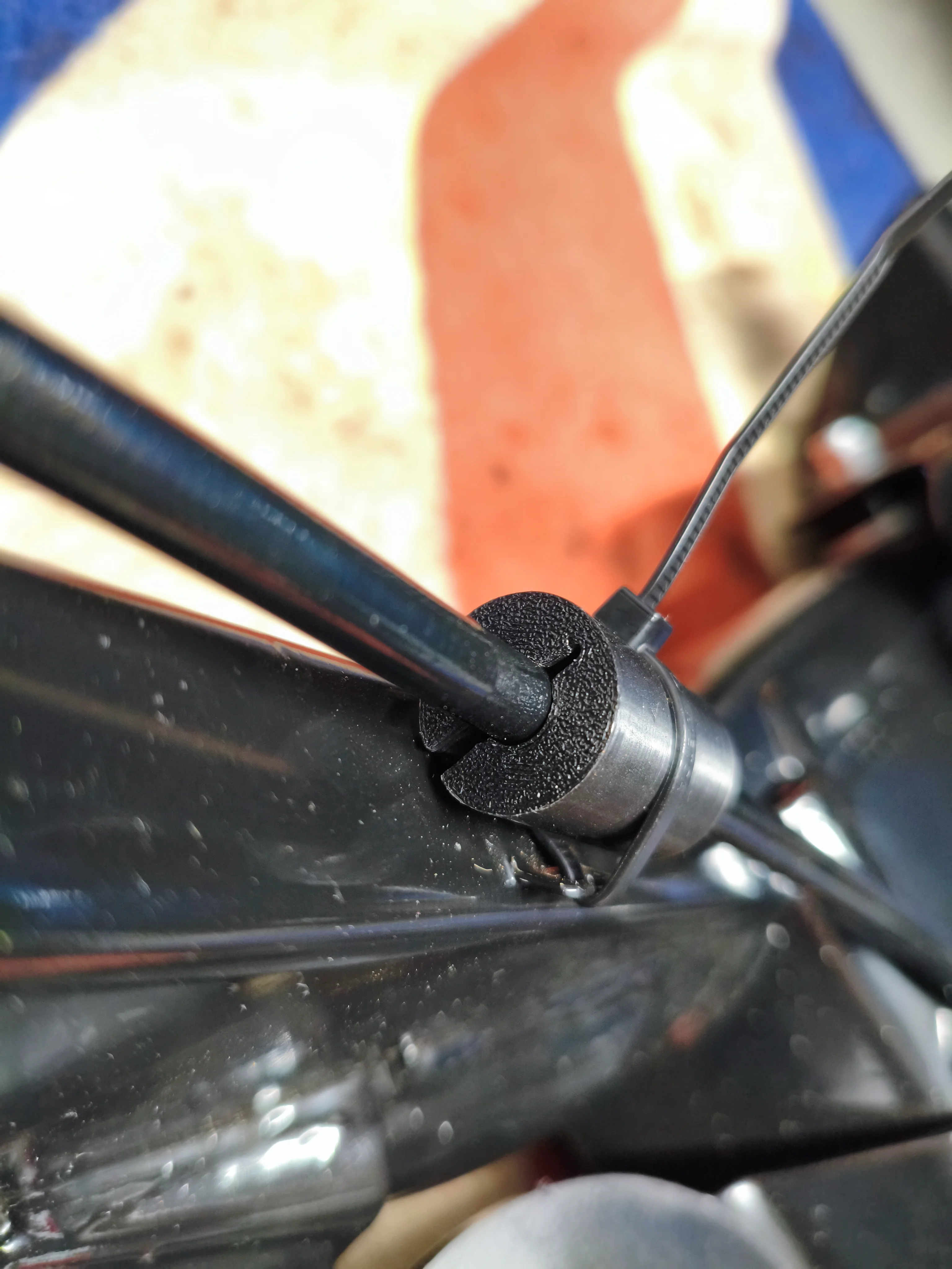

I've also had a lad at work print a prototype for a brake hose mounting rubber, as I don't want to cable tie the hoses against the metal. It needs a final revision (I think it needs to be D shaped rather than cylindrical) before getting them printed in TPU

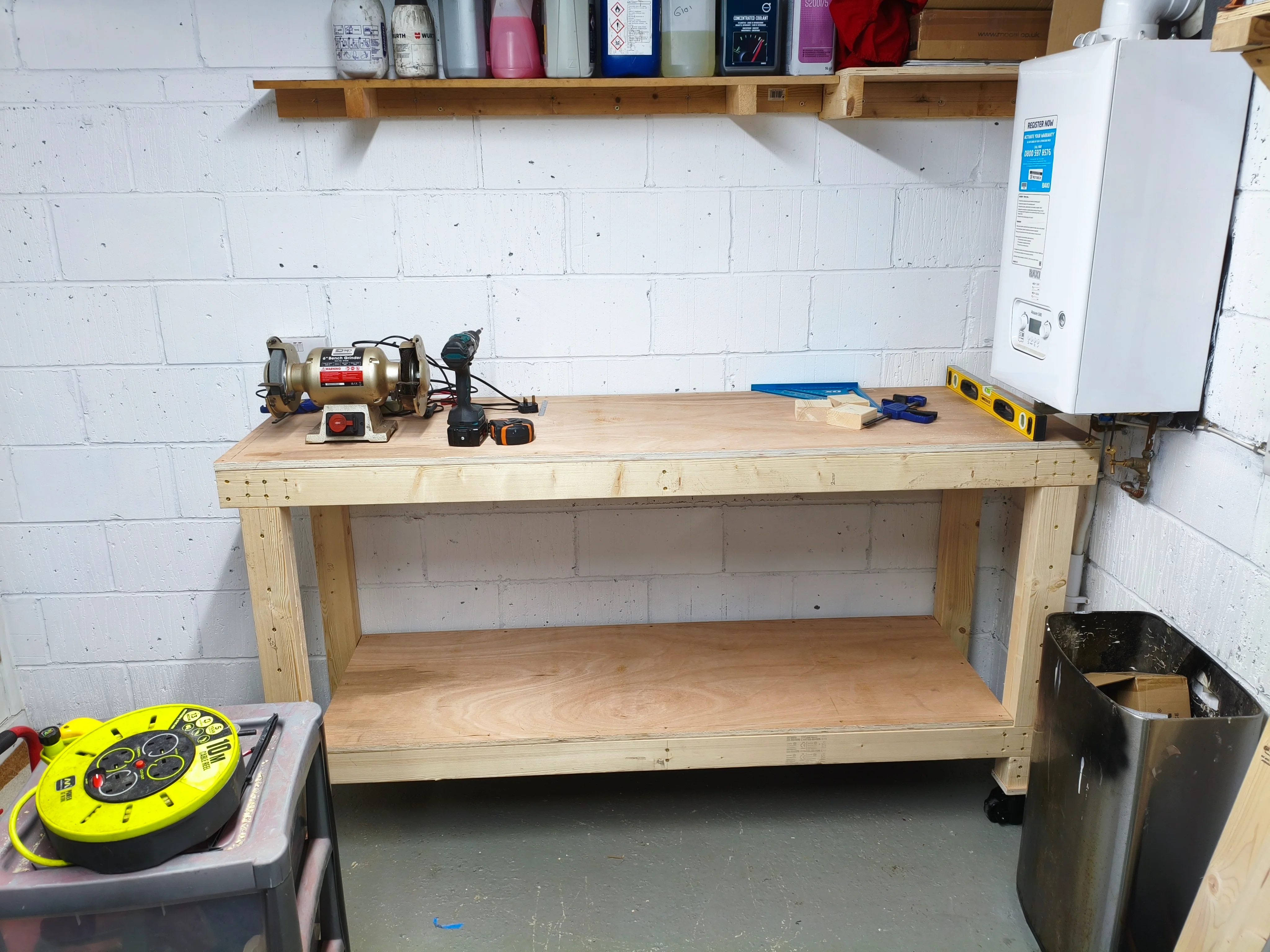

Kind of an update, I've been holding off starting on the car because I needed to build a workbench, which meant having the car out of the garage.

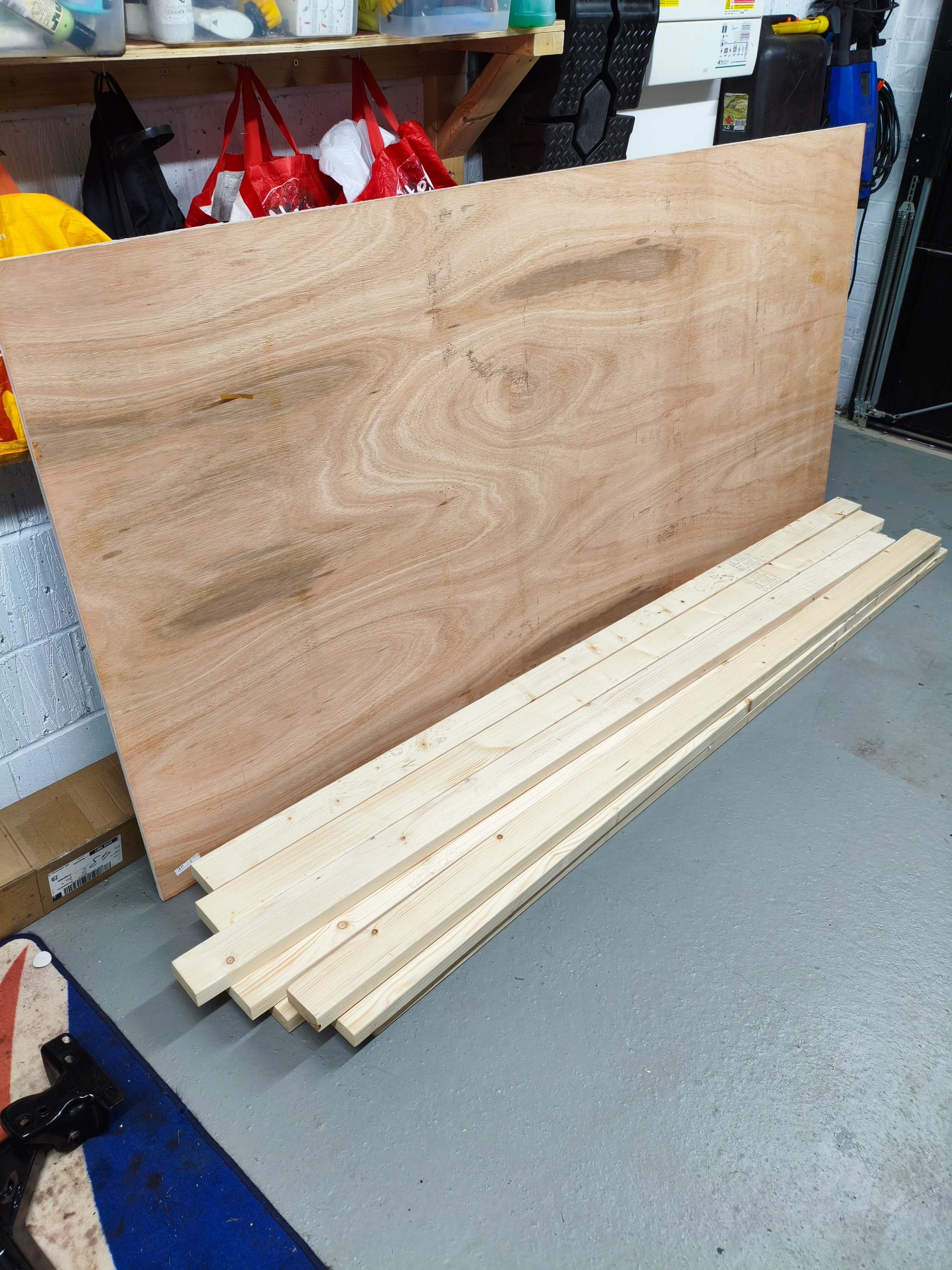

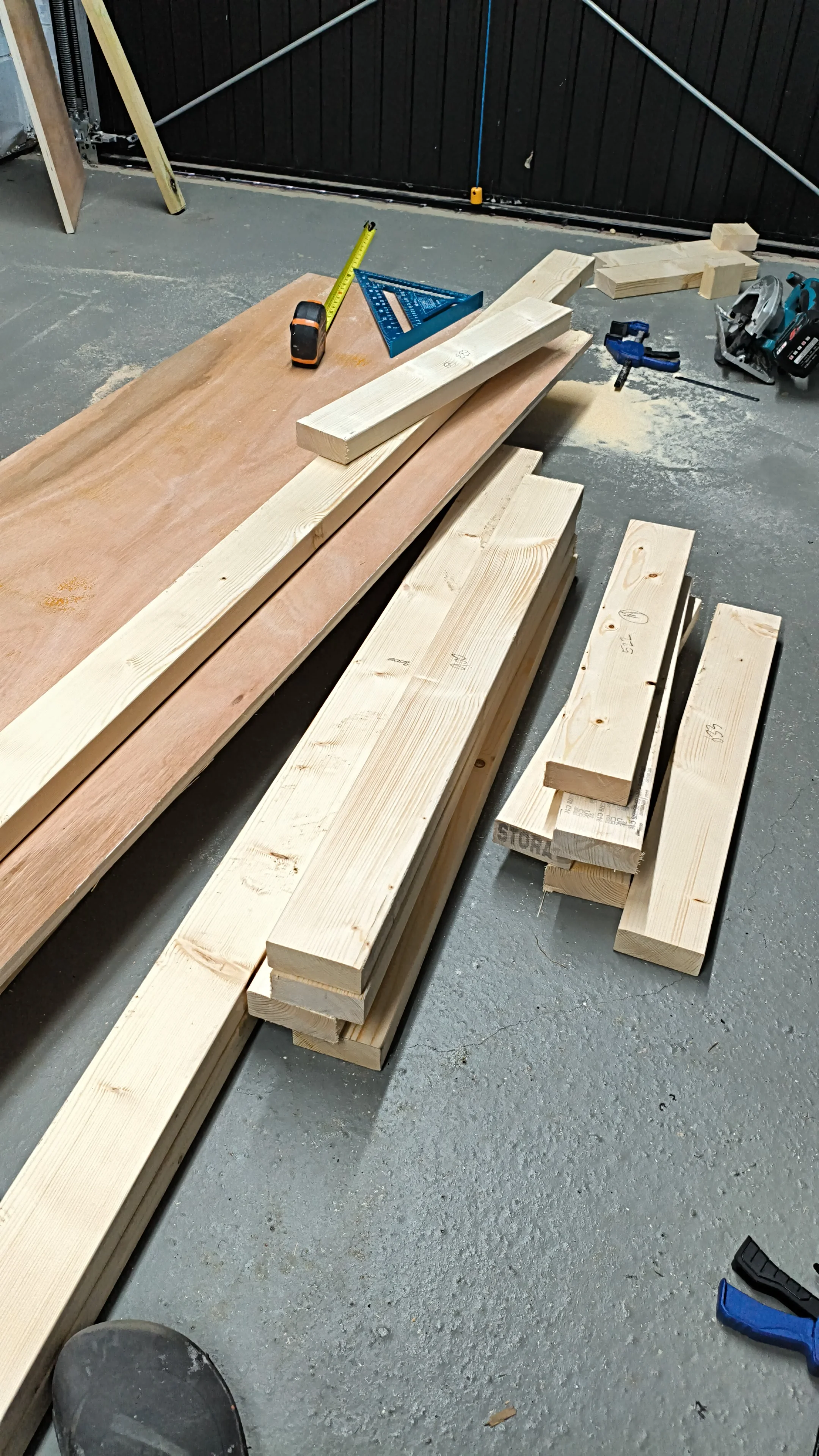

Got some wood delivered this afternoon
Started butchering it

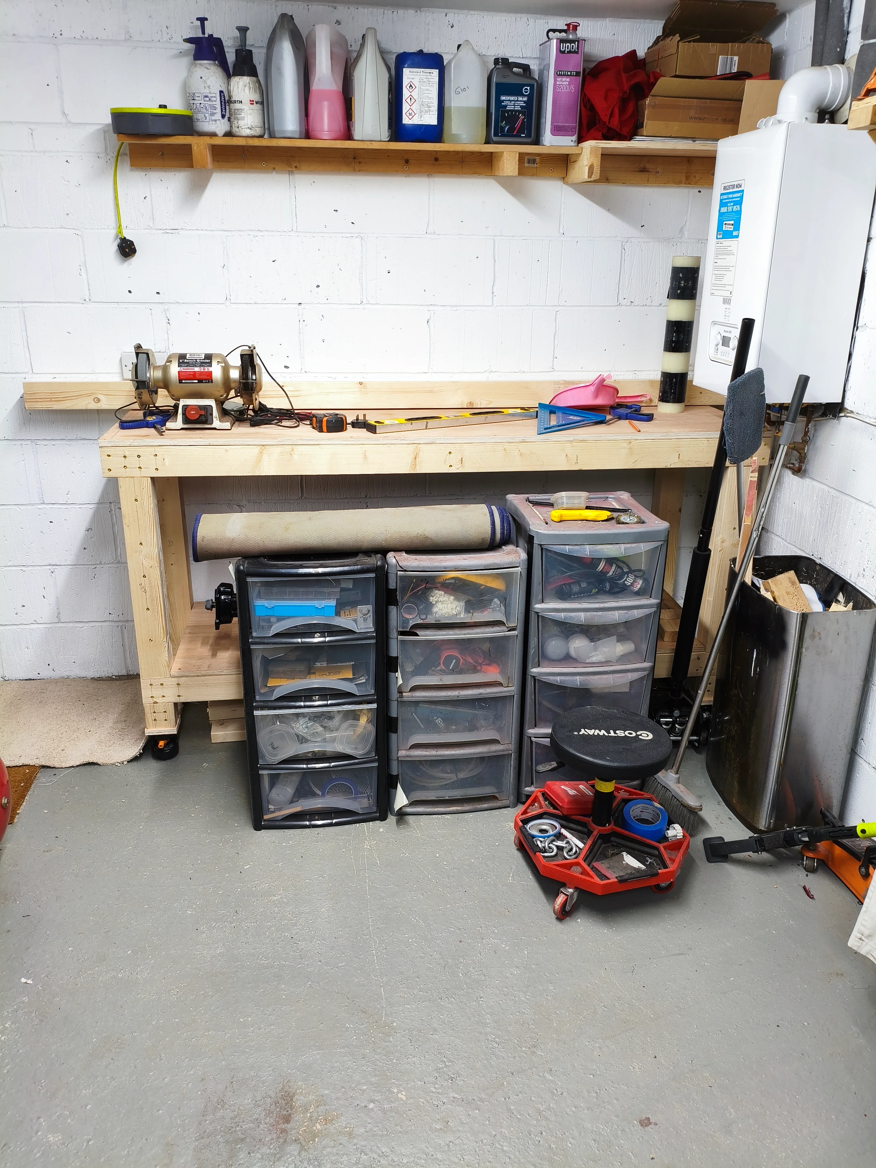

And ended up with this, it's a 2000x600 worktop, and the top is 1040mm off the deck when the leveling casters are wound down. The workbench in the last house was fixed to the wall and obviously felt a bit more secure, but the plan is to fit plastic floor tiles at some point so I wanted it portable at least until that's done then I'll reassess. I'm not going to be hanging off it so it's probably going to be fine.
I need to varnish the ply and mount the vice then I can make a start pulling the axle out of the Clio.

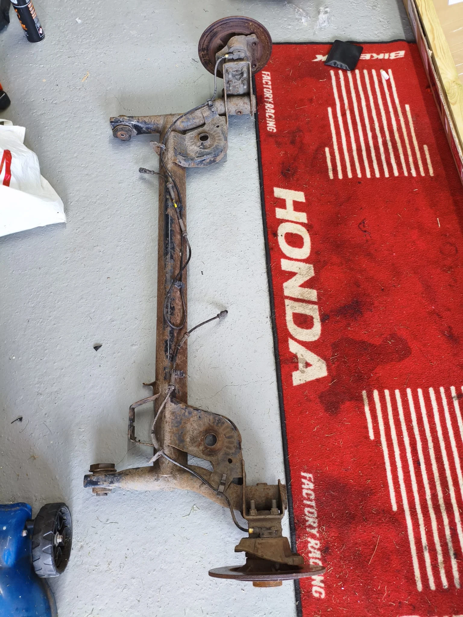

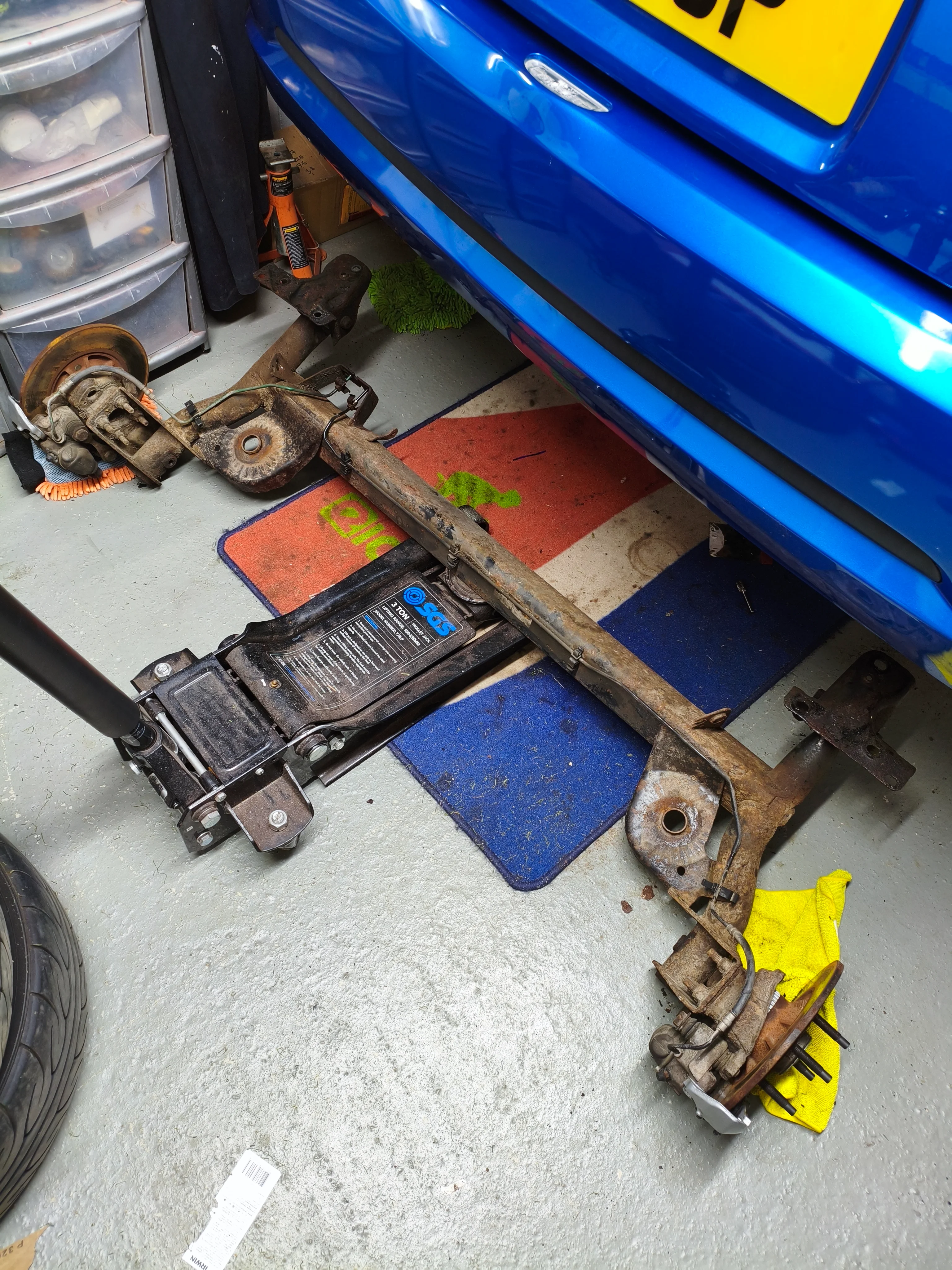

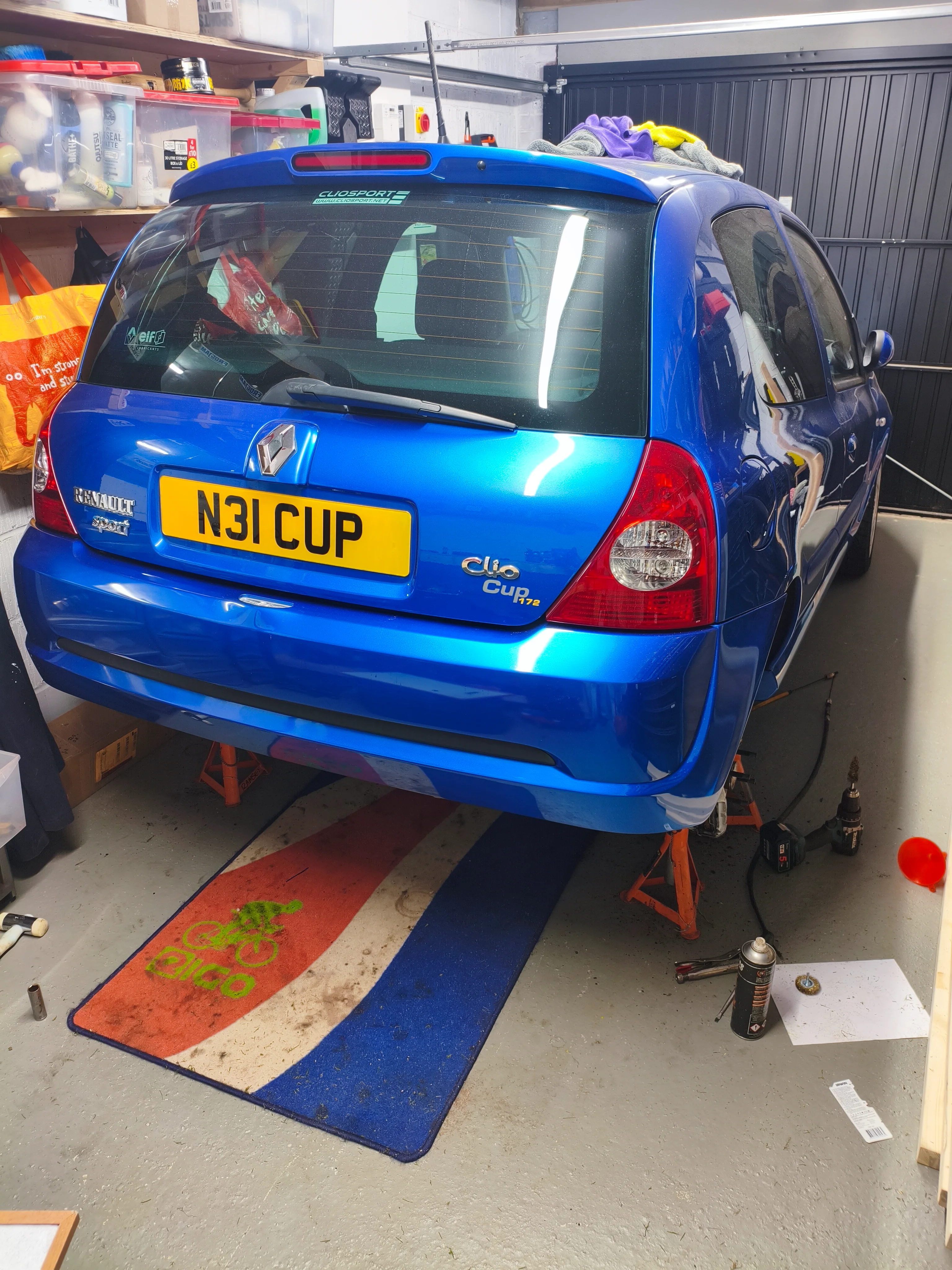

Started removing the rear axle this afternoon.
Got the wheels off, rear ARB off, handbrake cables, brake hoses and rear dampers disconnected. Springs out and axle supported on stands. As expected, Despite being thoroughly wire brushed and soaked in plusgas, four of the six rear axle bracket bolts have span so I'll need to pull the rear seats out so I can get some mole grips on the heads.
I've had enough for today though so that's a job for another day.
Managed to rope the Mrs in this morning to get the axle out.
Need to strip the brakes off it then that can go.

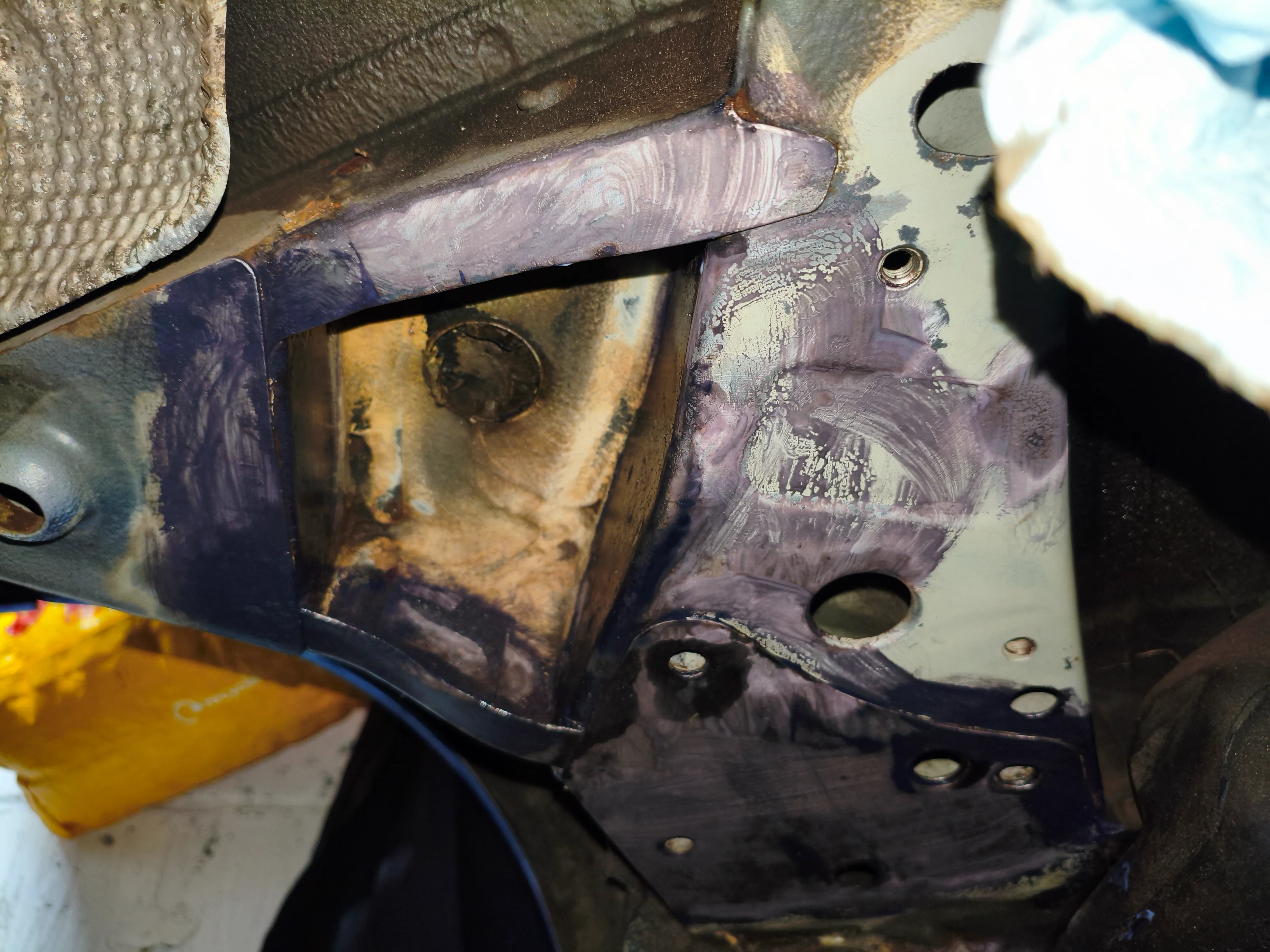

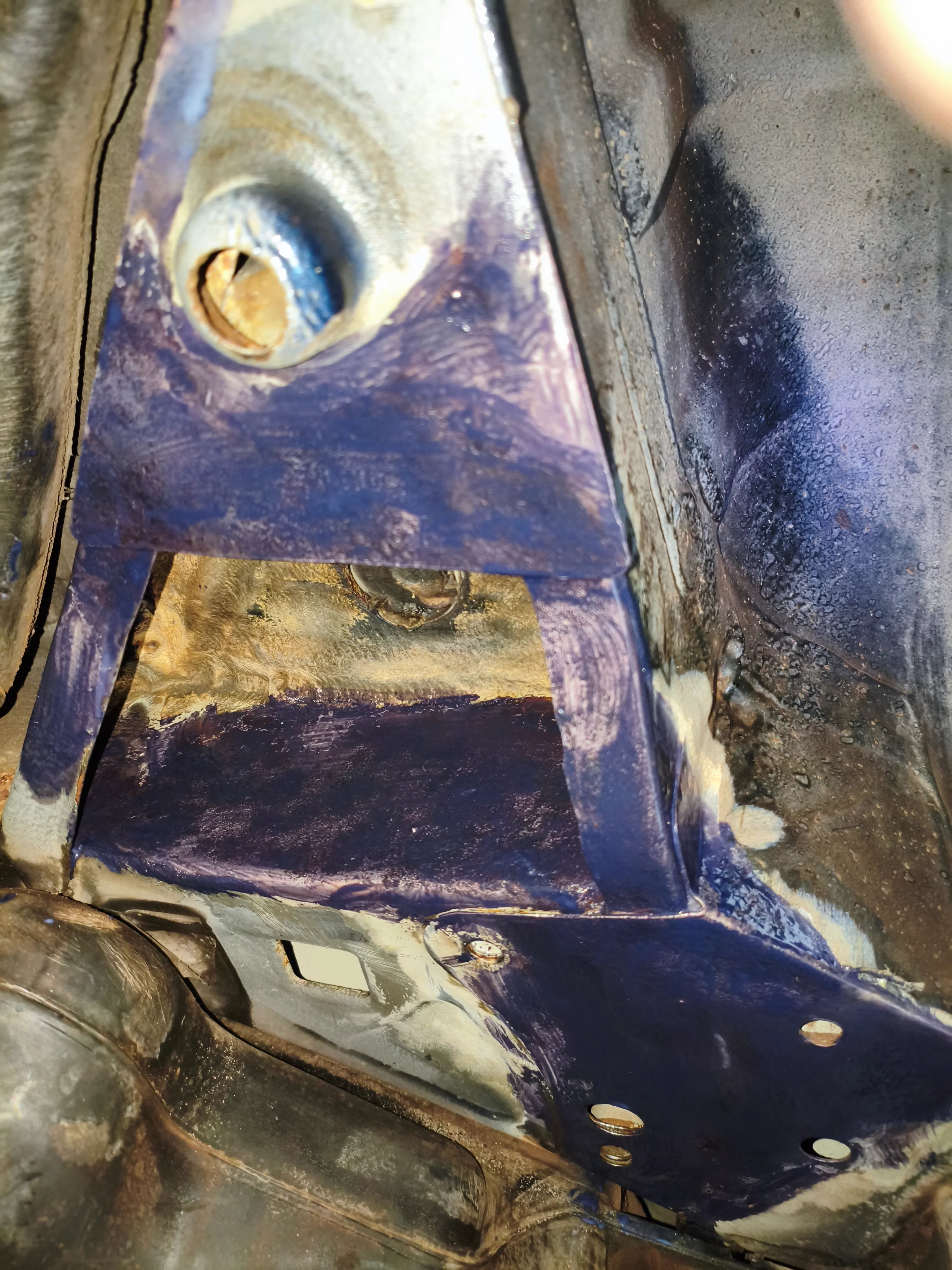

There's no horrors under there but theres a bit of surface rust on the chassis around the axle mounts, I'm going to get that all wire wheeled off and rust converted, I'll just brush on some 2k epoxy and 2k satin black. As much as I'd love to strip it all back and raptor the floor if I go down that rabbit hole the car will still be there in the spring.
Spent a few hours in the garage this morning, got the brakes stripped off the old axle, I need to decide what I'm doing with the calipers, either get them blasted and powder coated then rebuild them myself, or just send them out and save myself the hassle. I'll get a price for getting them done and see if it's worth my time doing it myself.
Got the brake compensator and bracket off the car, I've got a new Bosch compensator to go on and I'll get the bracket powder coated with a couple of other bits I've got waiting to get done. Unfortunately one of the brake pipe unions for the front to rear pipes was stuck to the pipe so that had to be cut, so I'll make up a new length of pipe when it's time to re fit that.
I've got the rust off the axle mounts and chassis box section between the axle mounts and spring pad, that was a massive pain lying on my back with a selection of knot wheels and strip discs on the drill and grinder. It's cleaned up ok and is solid having given it a good stab with a screwdriver.
I've covered it in rust converter for now which always looks awful, looking at the pics I can see I've missed a couple of scabs so I'll revisit them next time I'm in the garage. I need to get some more brushes then I can scotch It down and get the paint on it, then will probably cover those areas in Dinitrol 4941 which should match the factory underseal.
