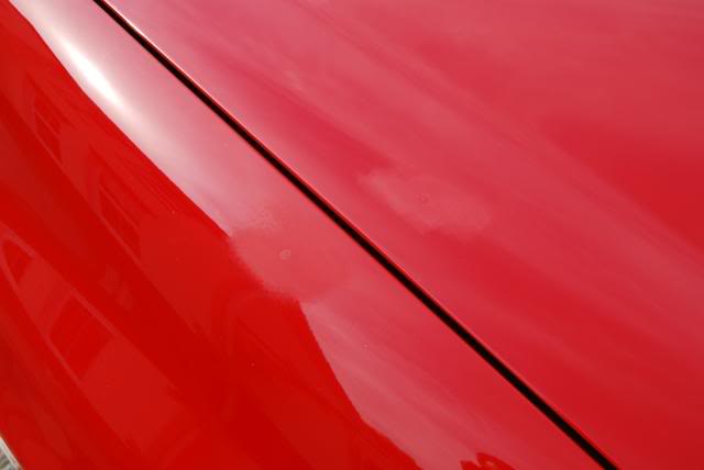

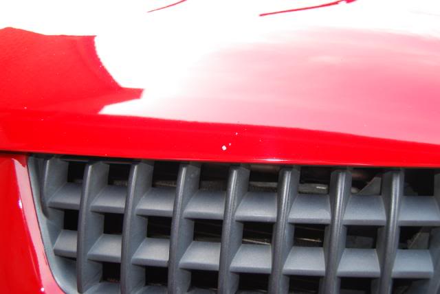

I have never known a car as bad as the clio for collecting stone chips, my bonnet and wings were in a terrible condition.
Purchased some paint from paint4u, great service arrived next day. Unfortunately the colour match was not the best.
Example of stone chip before painting

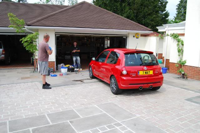

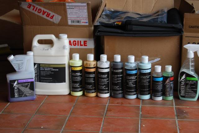

The line up on the day
Car was foamed up with snow foam, rinsed and re-foamed with Britemax Clean Max and then washed down.

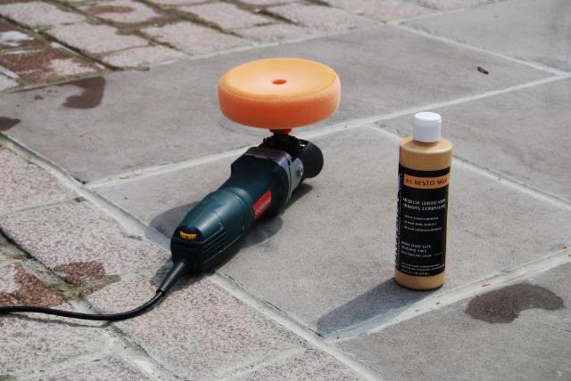

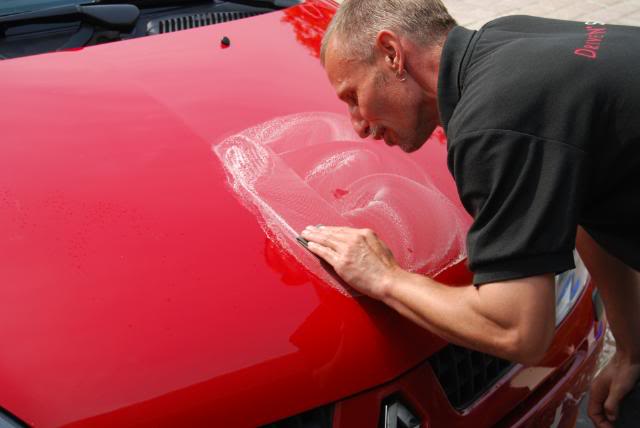

Bryan then gave me a demo on wet sanding using both the PC with Abralon discs and by hand with some Meguiar's Unigrit paper.
My first attempt wet sanding by hand

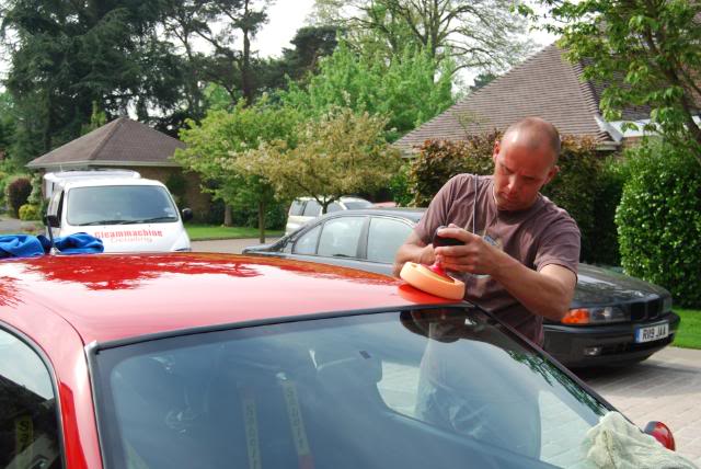

Rob then set about the roof using Britemax #2 pad and #2 polish.

Car was wipe down with IPA (now a stock item), and then we applied a layer of Britemax #5 Extreme Elements - the guys were very impressed with all the Britemax compounds and loved the polymer sealant.

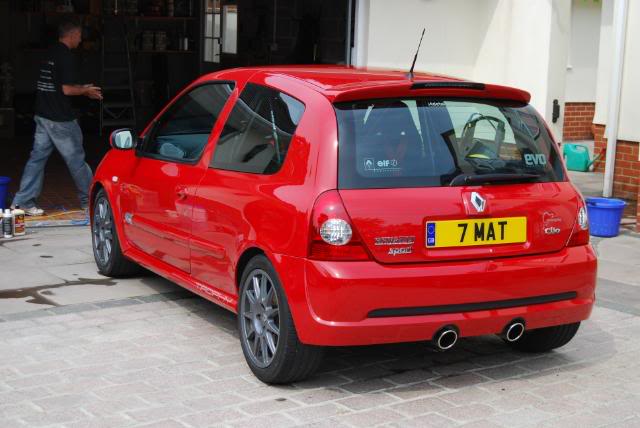

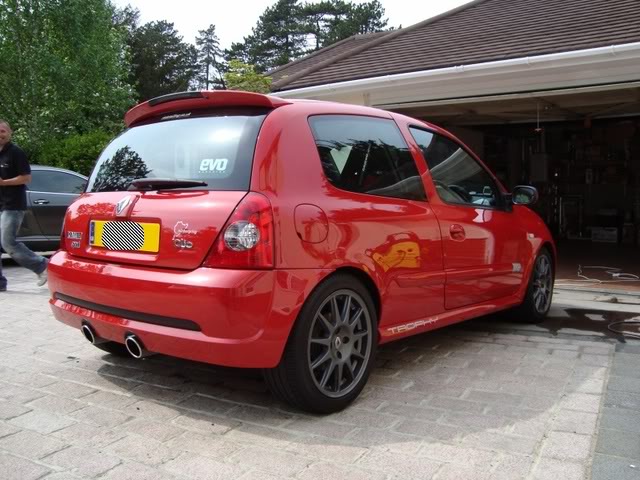

Then Bryan couldn't help give the car the once over with some #6S Spray & Shine QD spray. Tyres were dressed and exhaust cleaned and polished with Easy Cut and then followed up with Final Shine.

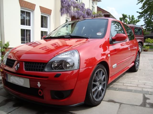

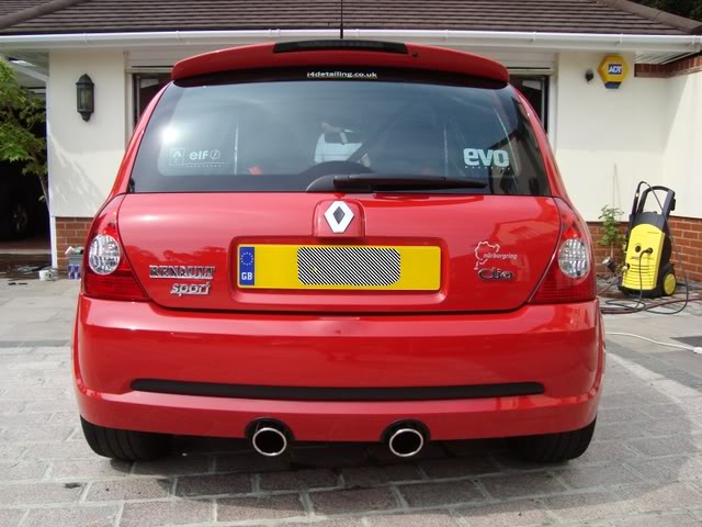

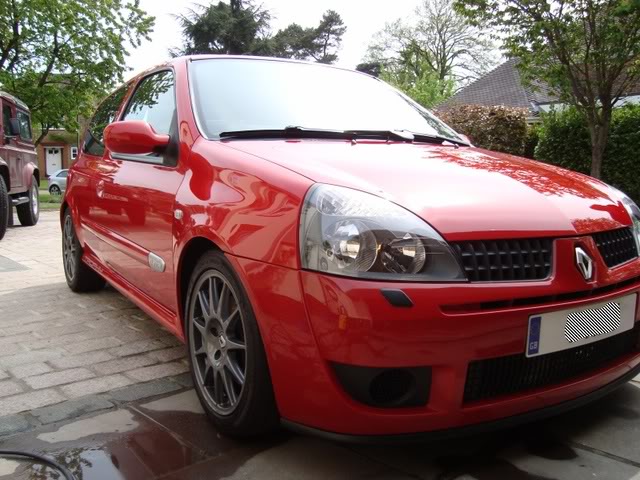

Here's the pics ....
Some of Rob's photo's
