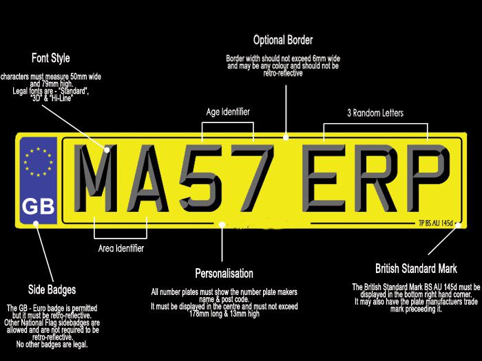

Read below..
PART 1
VEHICLES REGISTERED AND NEW REGISTRATION PLATES FITTED ON OR AFTER 1ST SEPTEMBER 2001 (MANDATORY SPECIFICATION)
1. The plate must be made of retroreflecting material which, as regards its construction, colour and other qualities
If I am right, steel (which I think the plates are made of) is not a retroreflecting material. Did you get a ticket? I think ANPR might struggle to read them too.

As long as they have the post code and BS number stamped on them then they are classed as legal

My pressed plates are retroflective and i got pulled the other week and had my car fully inspected by them and they said nothing..
Don't say nothing about pressed plates on here?
No where in the VOSA gudies does it state what material a plate needs to be made from.
Take it to an MOT center, if it has BS AU 145 on it then get it stamped and post it back to the police.
Or go in and have a chat with a senior traffic officer and ask them to show you where in the law it states you can't have a plate made from metal.

This comment is not made specifically at this thread, as tbh it's great to see people providing links & VOSA images etc to back arguments. But, in the last two threads I've read:
An alarming number of people seem to think "if a single source doesn't say you can't do something, then it must mean it's legal," if they've seen someone else with similar/same modifications then it must be legal, "I've seen a policeman do it so it must be legal," or "I've never been pulled for it" so it must be legal.
