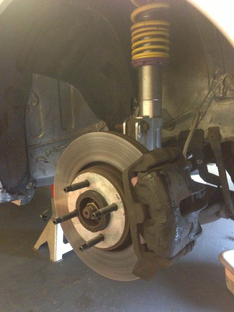

He is on about these
The two triangle shaped frames

I can't see them on the photo above, they were fitted to the subframe in-between the two arms of the wishbones, it looks like they're not actually in the photo but at least on the left-hand side I can see the hole where they used to be bolts to.

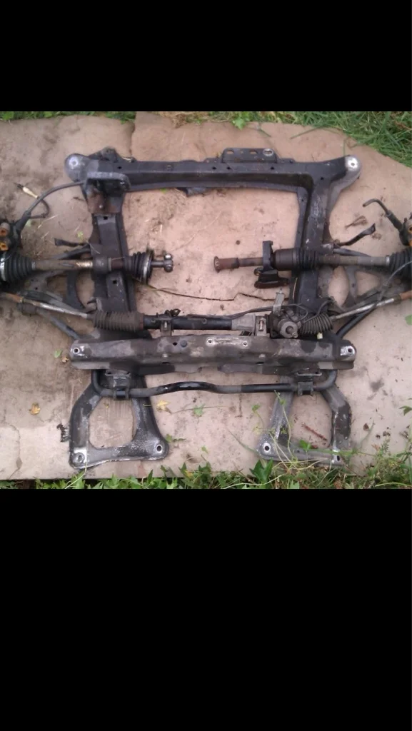

He means the verticals supports at the very right hand side of my picture.
Can't say I know what the do, would of thought they just helped to remove flex in the subframe by bolting it back to the chassis?
  220 Trophy
Again thanks for the help but this is getting ridiculous.... Do those vertical supports sound at all like 4" wide upturned triangles bolted to the subframe in-between the wishbone arms?!

Thanks Matt. I don’t think anything would've been physically attached to them as they didn't have any holes in them (other than the one to fix to the sub-frame), possibly they just supported something like the arch liners? Either way, thanks for your help.
  Clio.
Yep, supports the driveshaft protection liner (the funny shaped plastic part above the bracket in the attachment pic).
