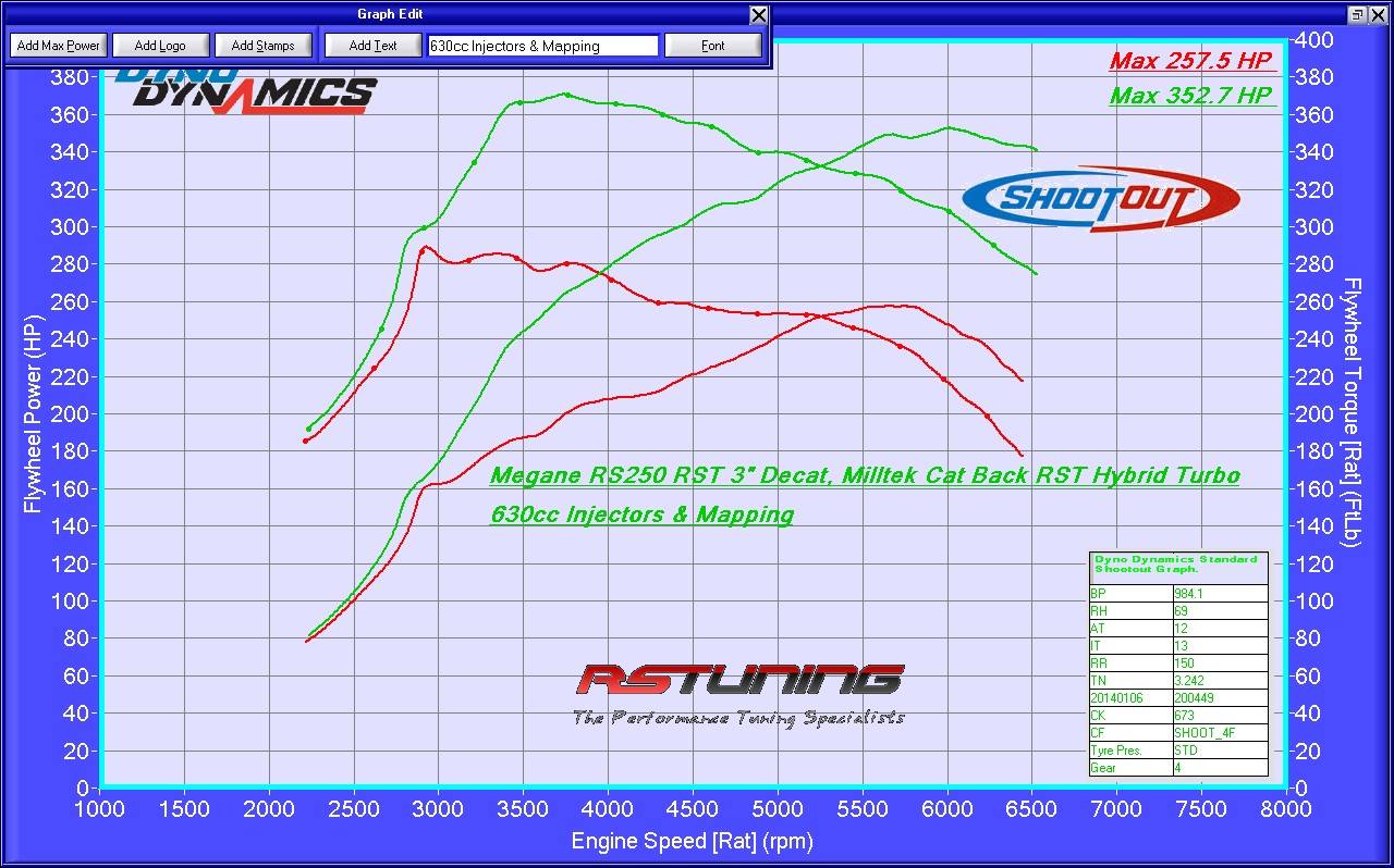

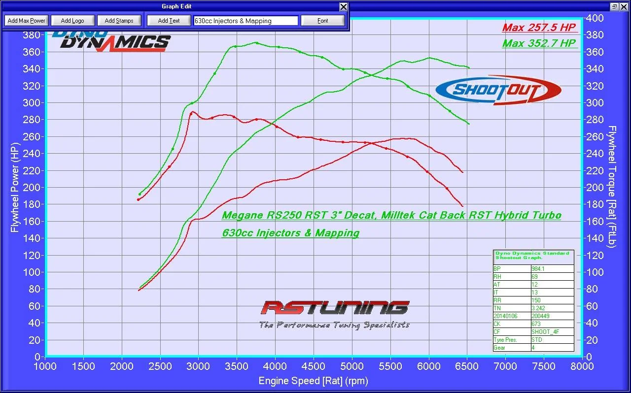

The pistons and rods are stronger but how strong is unknown really. You see some big claims on the stock injectors saying they are 360hp but they max out on my dyno at about 325-330hp!

Yes we did the build on the white 250, what i mean is we don't know how strong the internals are, they physically look better but not sure what the power limit will be.
The graph above was a totally standard car yesterday morning, all we did is bolt a turbo, down pipe, exhaust and injectors on then map to suit. We have another in Malaysia running the same turbo with more boost which is used a lot on track and that has had no issues since mapped in october.
