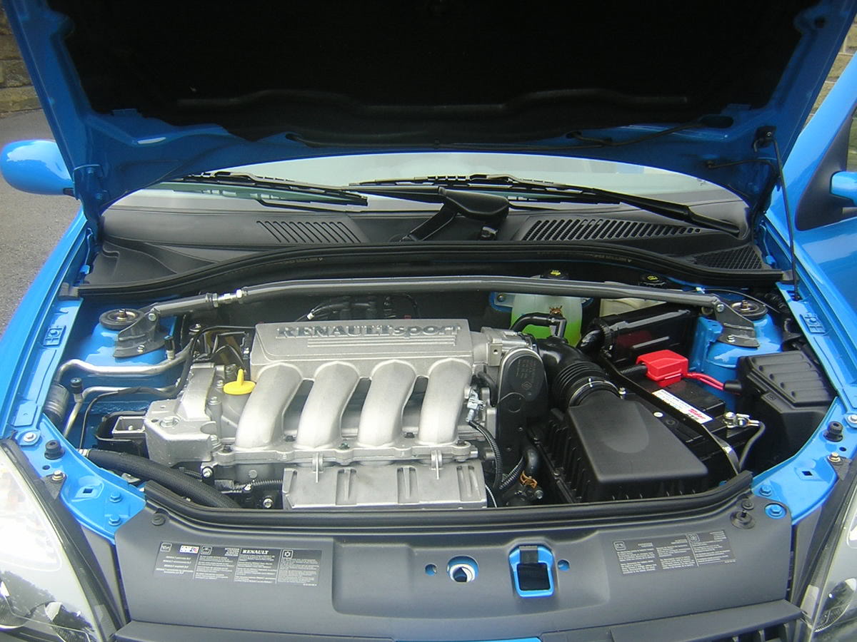

Yeh they didnt get in the way when I fitted my omp brace, the only problem I had was that I had to remove the top bolt (you can just see it in the pic below the strut brace on the right) holding the ECU and file down one side of the washer behind it to get better clearance and then it slotted on no probs

That block almost looks painted as the bolt heads are the same colour.

I cheated with that pic the car was only a week old, the engine looks a little grubbier now!!
As for the bolts, I used the self tappers that come with the brace i didnt go down the nuts and bolts route, might do at a later stage, but it still makes a noticable difference fitting it with the self tappers. Some say the only way to get real rigidity is to weld the brace in but I could never bring myself to weld on a new motor!!
I just marked it, punched it, drilled pilot holes and carefully tapped in the new bolts making sure they were covered in plenty of copper slip to try protect the holes from corroding. The struts and wheels stayed attached to the car and as I said the only complication was with the ecu mounting bolt that was easily modified.
