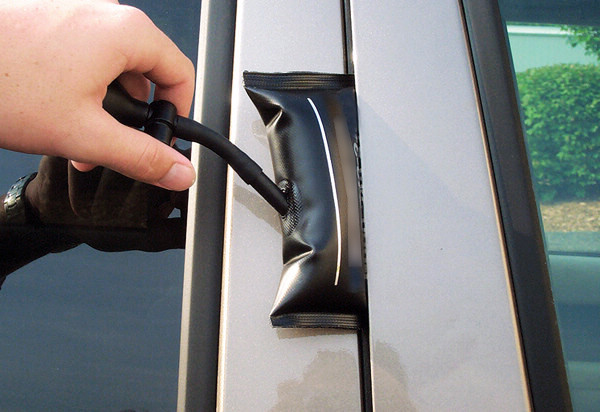

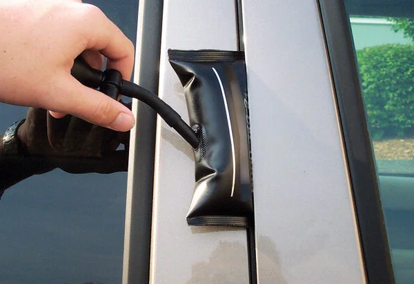

So, my idea was to get a air pump wedge to at least get me into the car.
Like this
Cheap crap one I presume - http://dx.com/p/korea-klom-air-pump-wedge-vehicle-entry-tool-16423

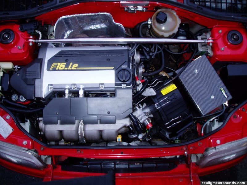

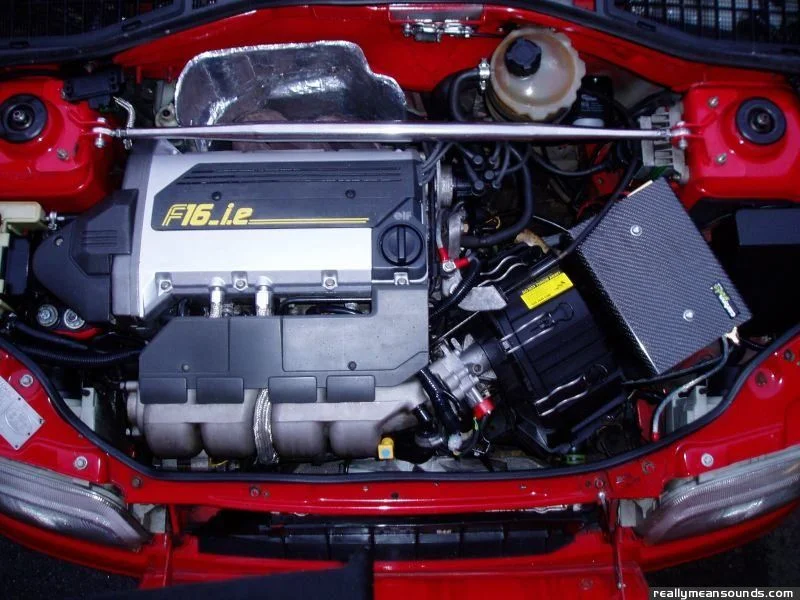

Oh PS the bonnet is locked also. Tried that couldn't get into the bulkhead without going under car.
As gherkin says, just get onto the alternator or the starter motor main positive with a lead and earth to the chassis, and connect to an external battery or a battery charger and then you will have power.
Never even though of that. Will try at weekend. Least it gets me into the car then. Which I need to get it going.
Getting to alternator may be a problem from below also
I don't have small hands so theres problem.
Ill go with the smashed starter motor.
