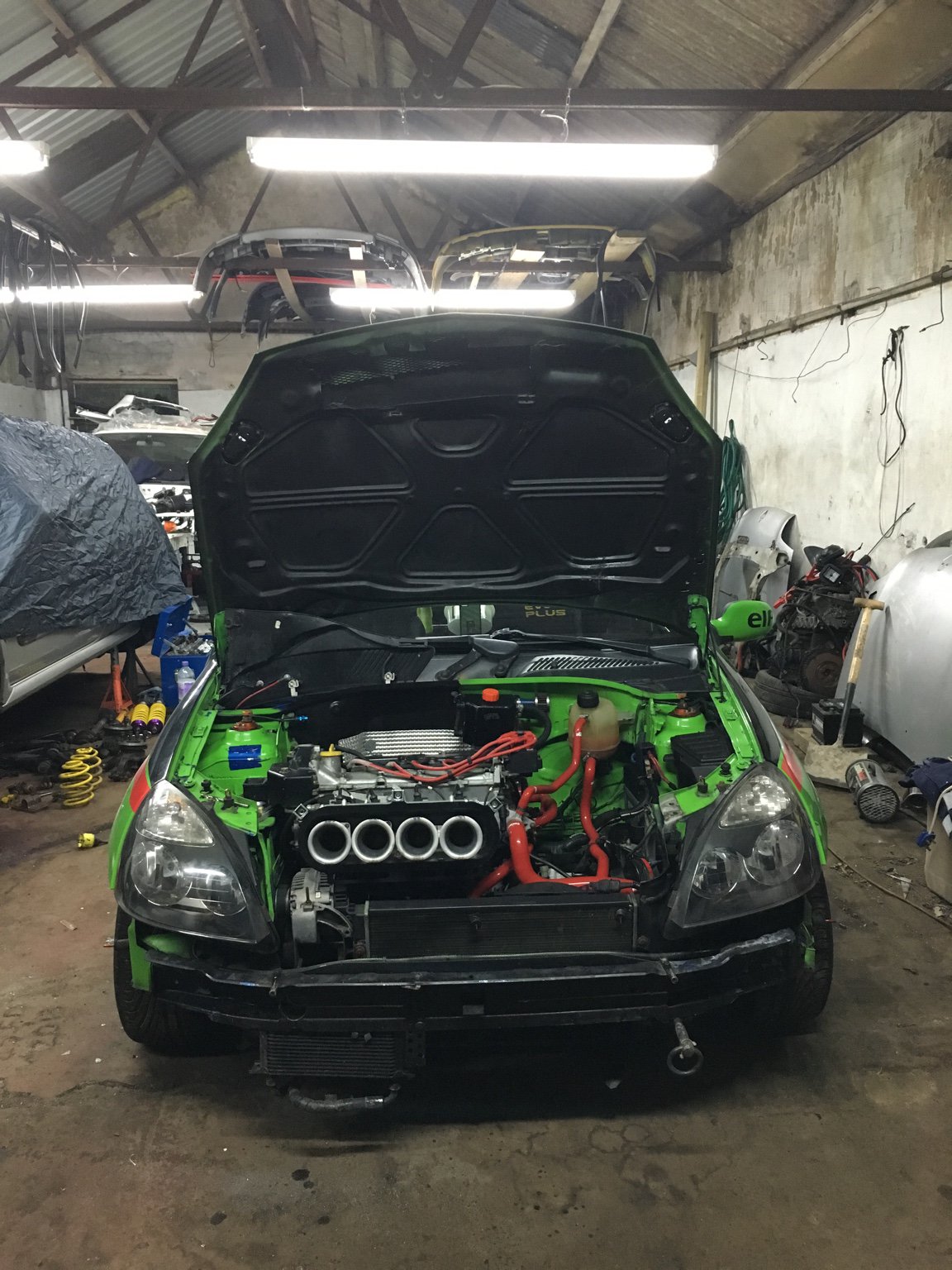

Not sure yet, process of elimination so far. Fuel pump wont stay on when cranking but will purge. Tested the pump which holds 3 bar fine so either the fuel pump relay, crank signal or wiring. The immobiliser keeps staying on sometimes too which hinders progress. I can see me replacing a lot of wiring and relays soon!
Cupman are you still running the standard ecu to power the fuel pump and using the crank sensor for both ecu's? Sounds like a similar problem I had which turned out to be the crank signal to the original ecu. I switched to a ford sensor as it gives a better signal.

Neil, it could still be the issue and not rulling it out but I get a good crank reading on the Adaptronic software (WARI) when cranking. Both the fuel pump and crank sensor are going to the OE ecu. I'm starting to think it is the relays and wiring in the engine bay as everytime I move them something else happens that didn't before so somethings not right in there. Everytime i'm getting somewhere, the immobiliser decides not to play anymore and then I have to go back to that issue.
If I could get ti to a dealer I would get it plugged into CLIP and see what it says. Might gett the AA to help with that.

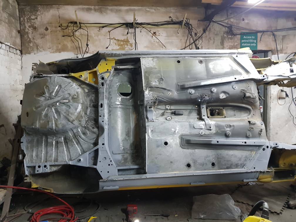

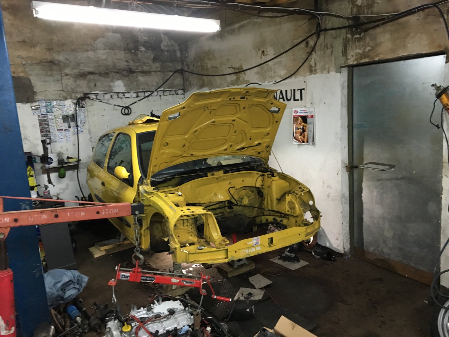

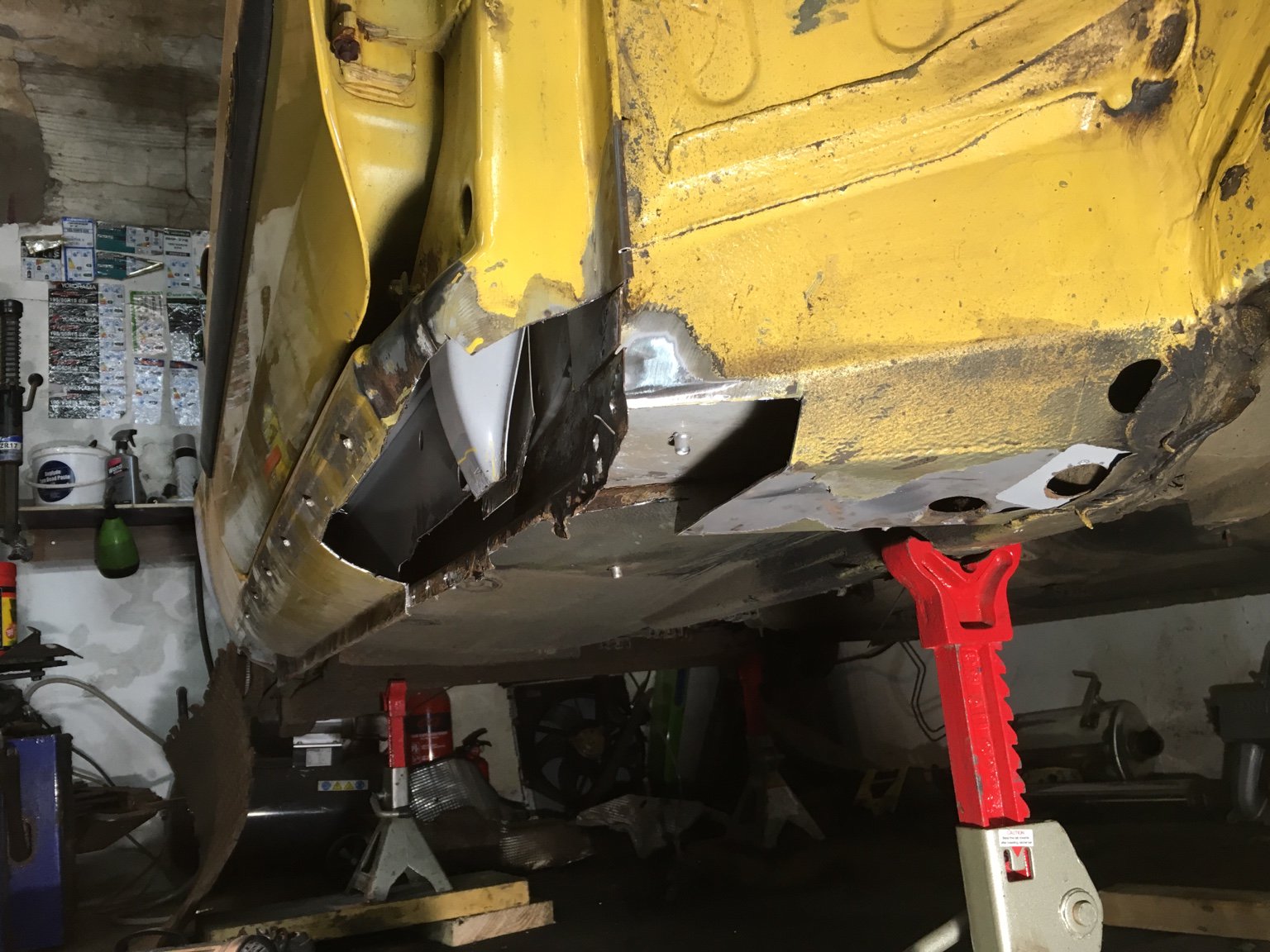

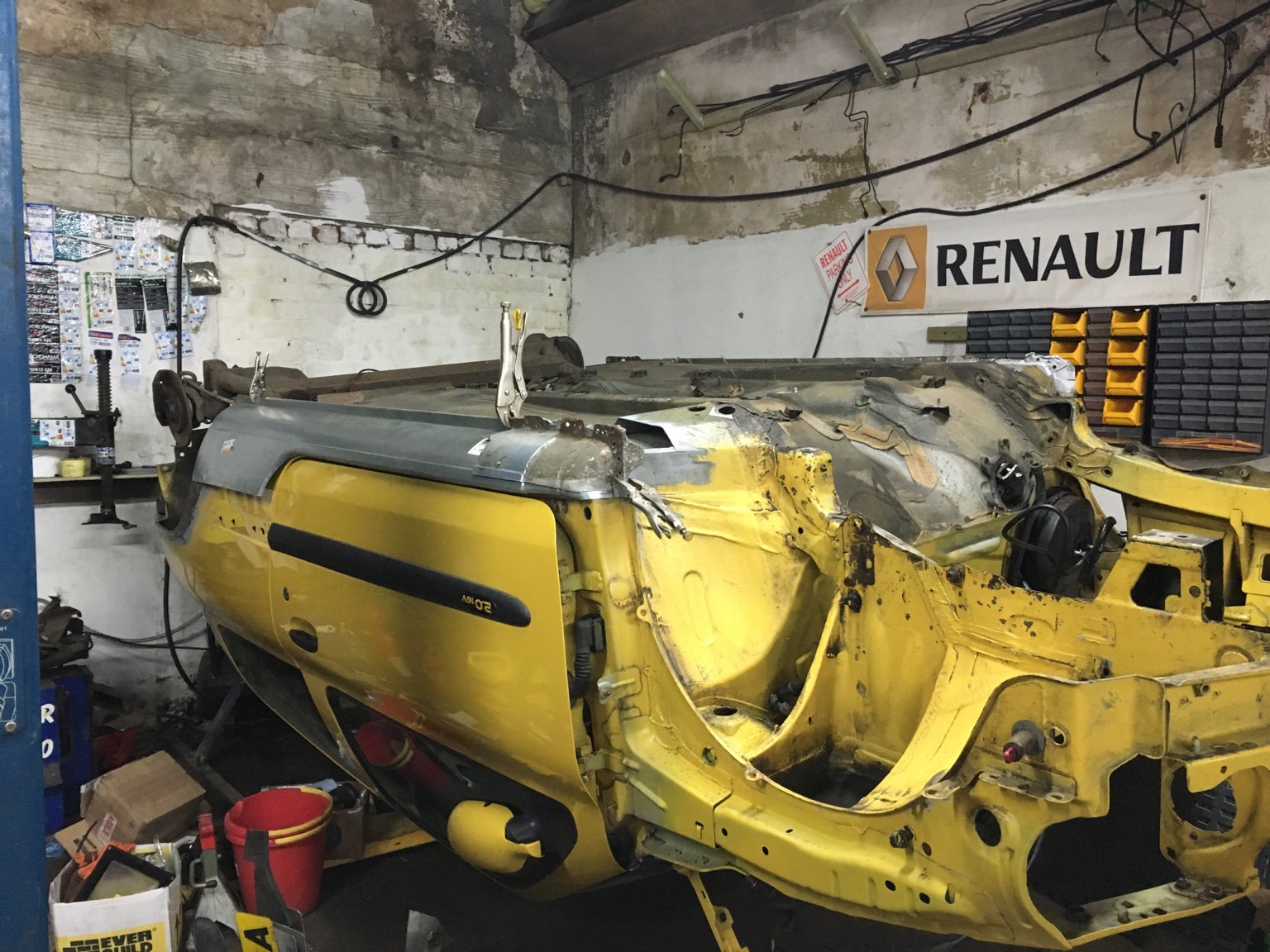

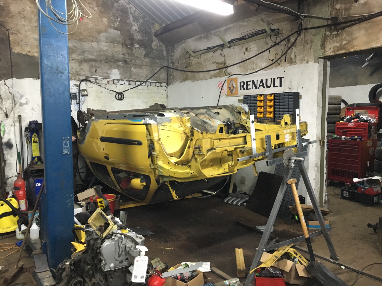

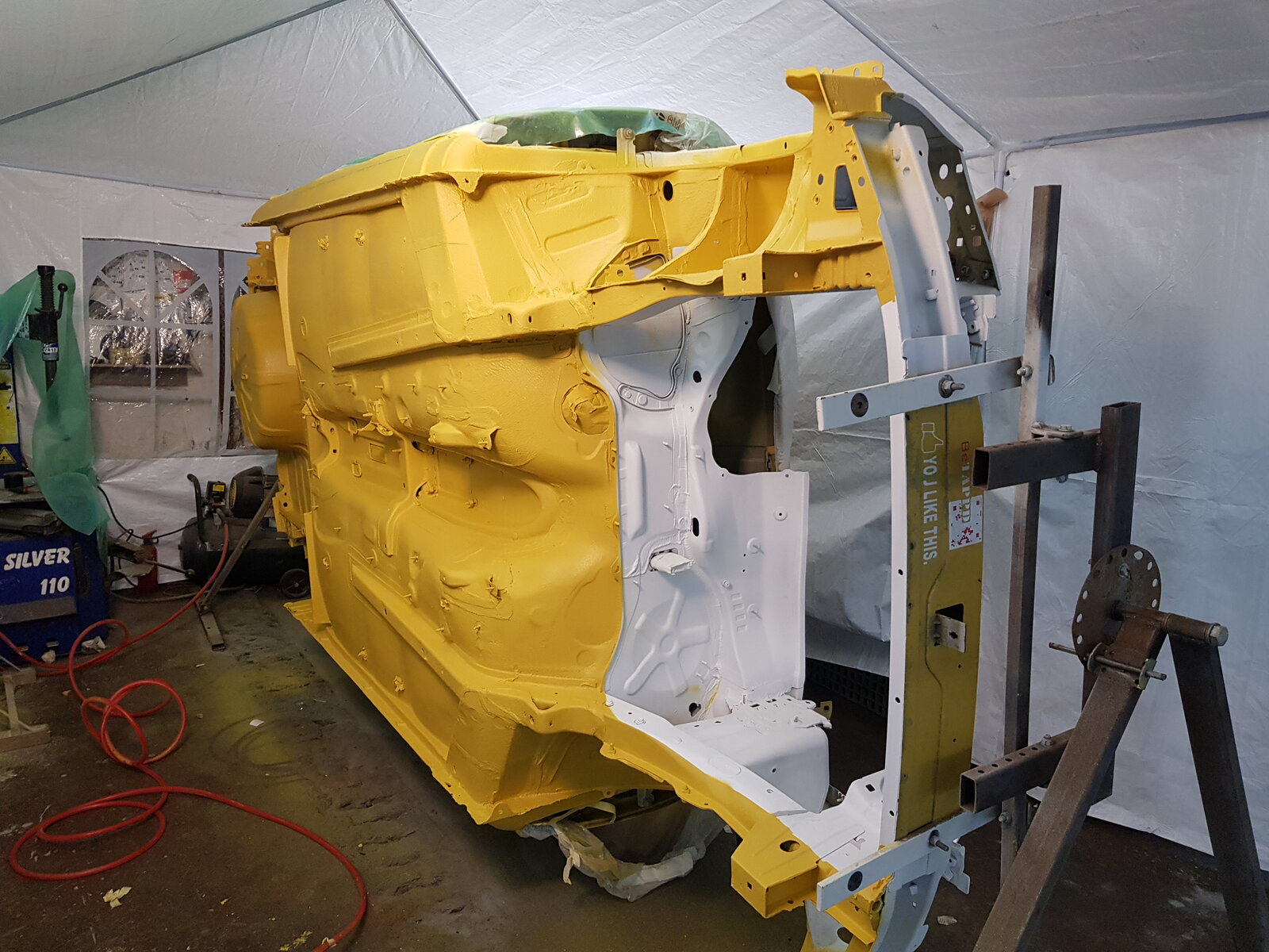

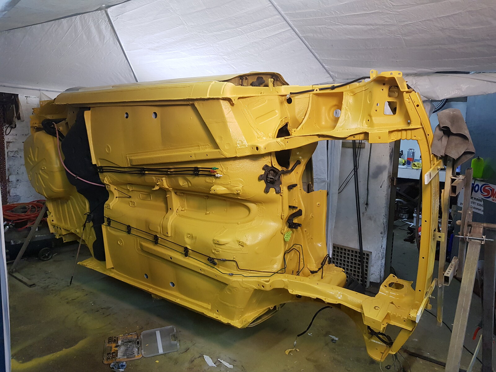

I seem to update this every year or so...not on here much these days. But I have found a bit rust and then the more i looked, I found some more[emoji30] so this is the cars current state.

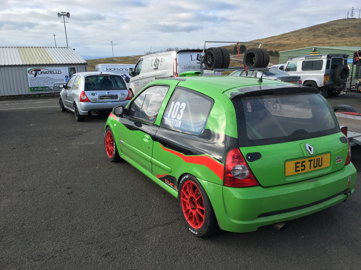

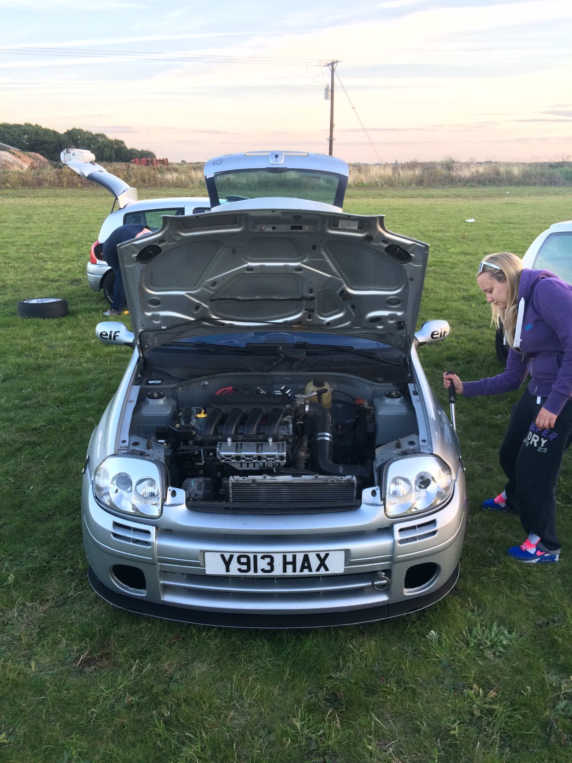

Not sure if i put a thread up about it, but bought back my old ph1 shell (HAX) and made that i to my 'track car'

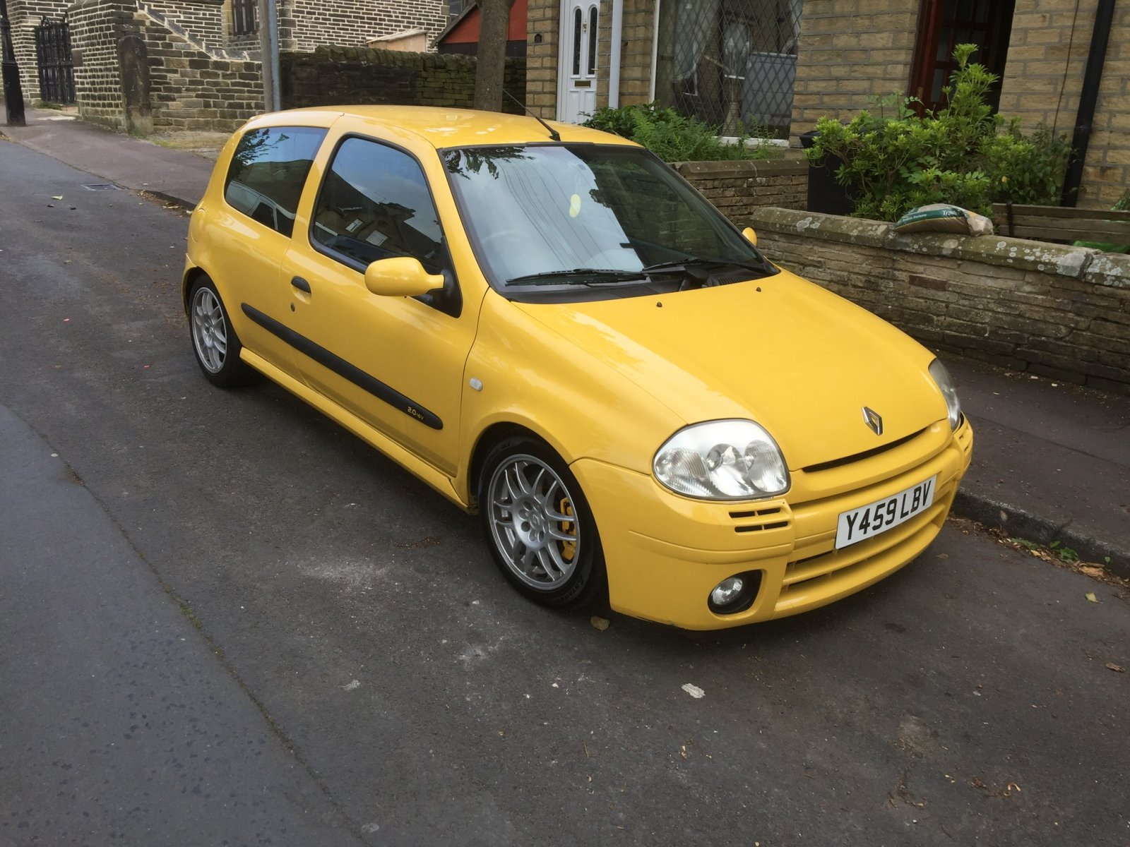

Also bought this well known flower at the start of the year for a run about. Done loads of bits and pieces to tidy it up to my standards.
Sold that and my other sunflower after blyton and bought Neil.A's itb'd cup...which is a riot! Good price for the spec, Hopefully competing in this years Super Lap Scotland with it.

Jesus wept. Full nut and bolt rebuild?
Yeah its pretty much heading that way [emoji23]
Holy sheet this is extreme!
When you doing yours? [emoji6]
Omg.
How do you even niggaflip a car?!
Kudos for the effort you're putting in though!

This makes me scared to look under mine.......
But mega respect for the dedicated rebuild :up::up:
Best not to! Haha, cheers! Hopefully be cool when its done [emoji16]

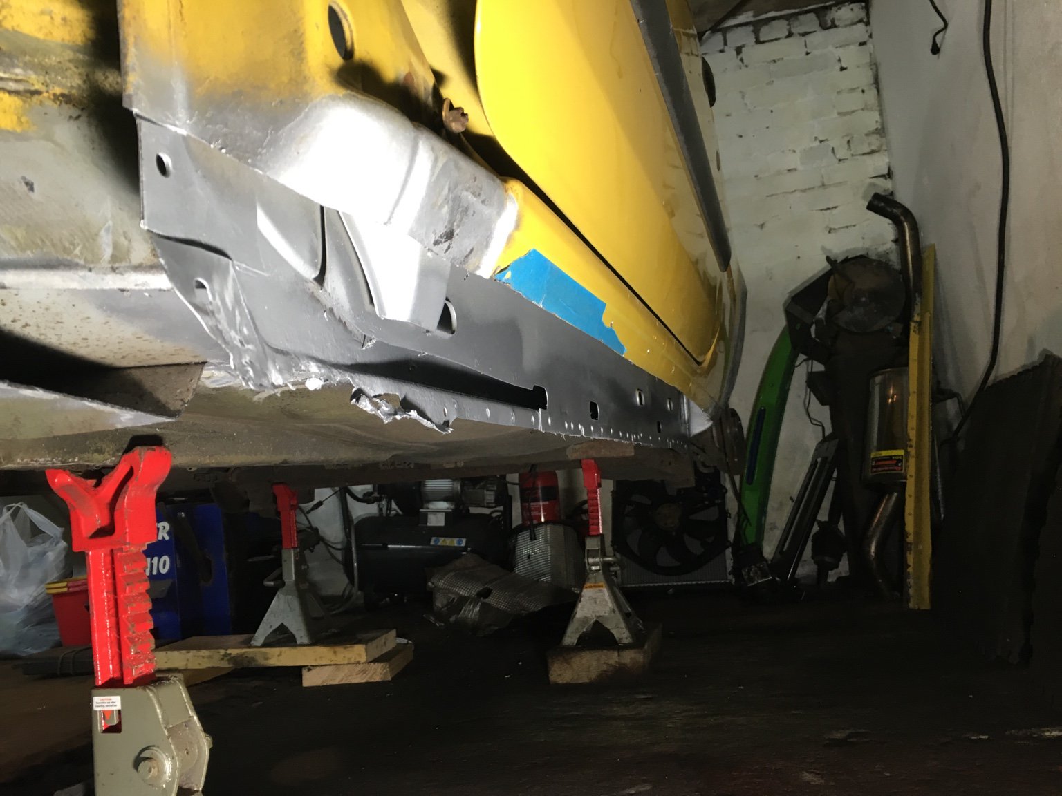

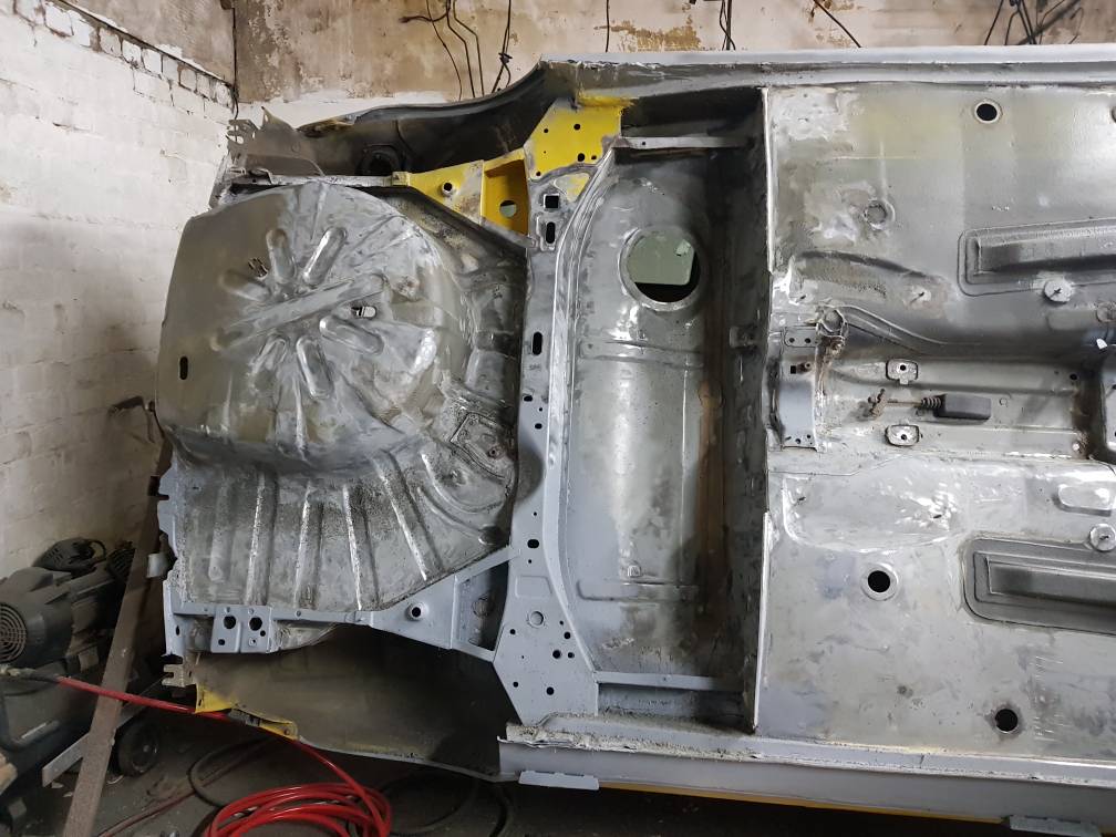

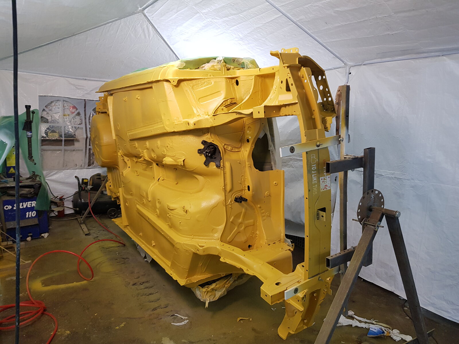

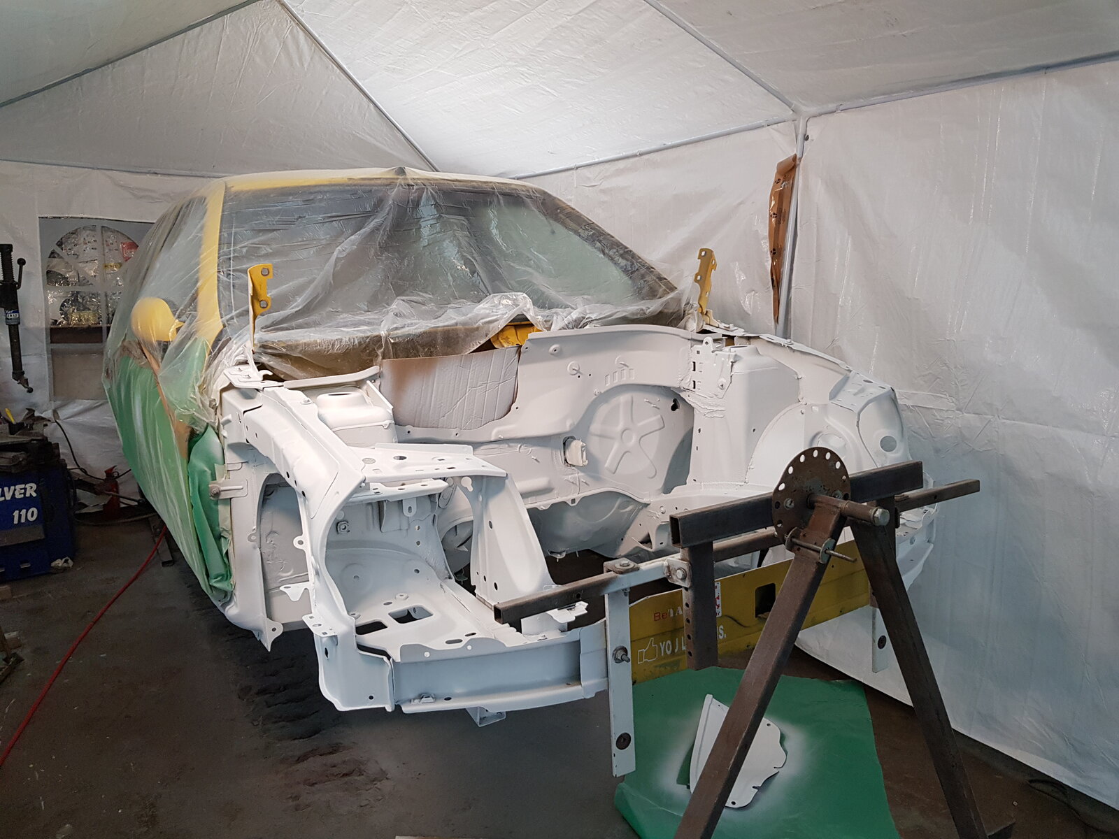

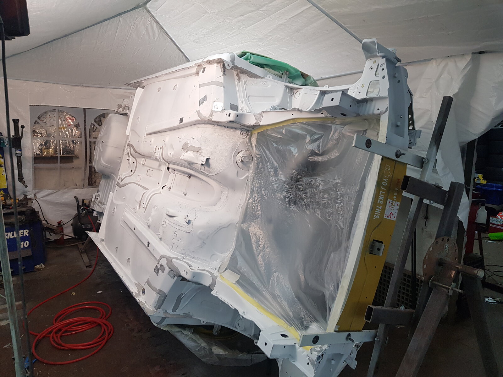

Quick run down, As Arran stated above, got my first house. Finished my second year of superlap scotland. Sold the car. Bought some more ph1's and an m3.....aaaaand finally done some productive work on the sunflower for the first time in probably over a year.
As you can see I've done pretty much nothing since the last update other than some more underseal removal, Hopefully I can keep the enthusiasm going for more than a week this time to get on with it a bit more. If not i'll maybe update the thread again in a year or 2 [emoji8][emoji8]

That's a whole lot of work! Wish I had the space to do something like that.

JESUS!! This has gone through a series of seriously insane processes!
No wonder my project doesn’t get a comment! There’s loads of extreme stuff happening elsewhere on the forum 😂

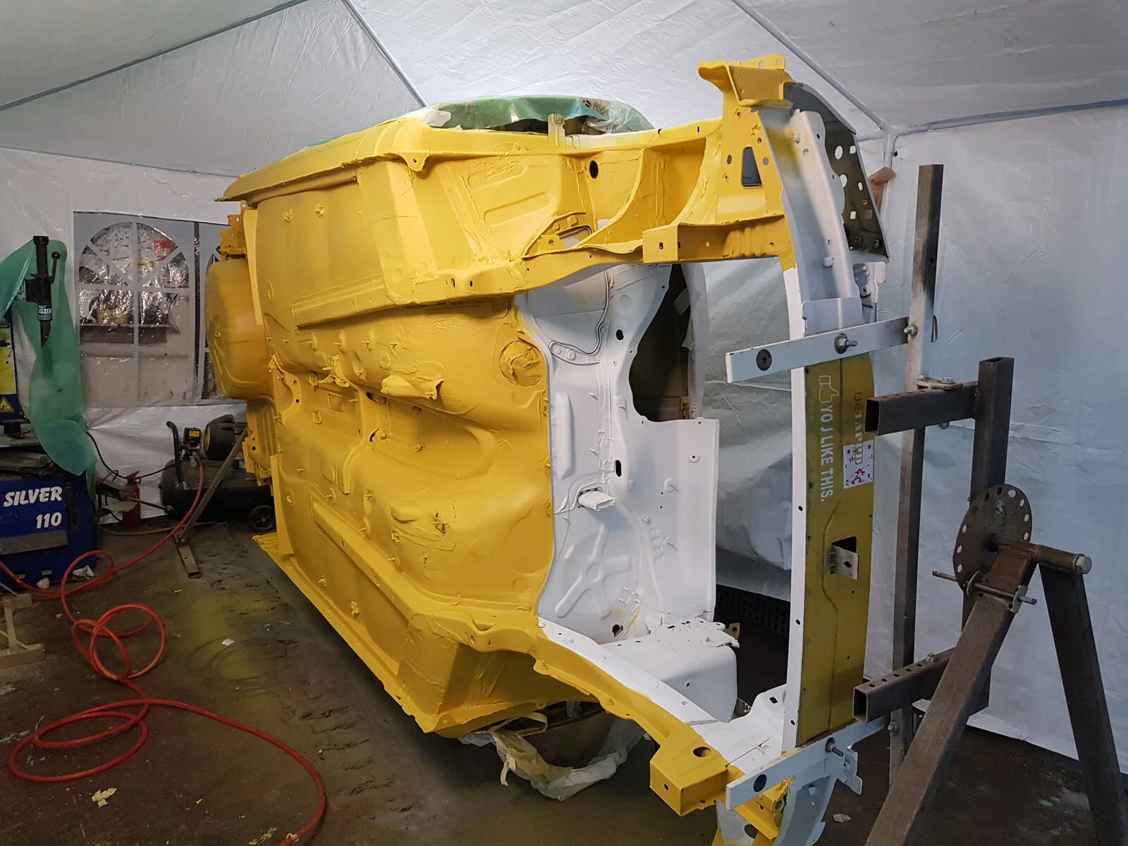

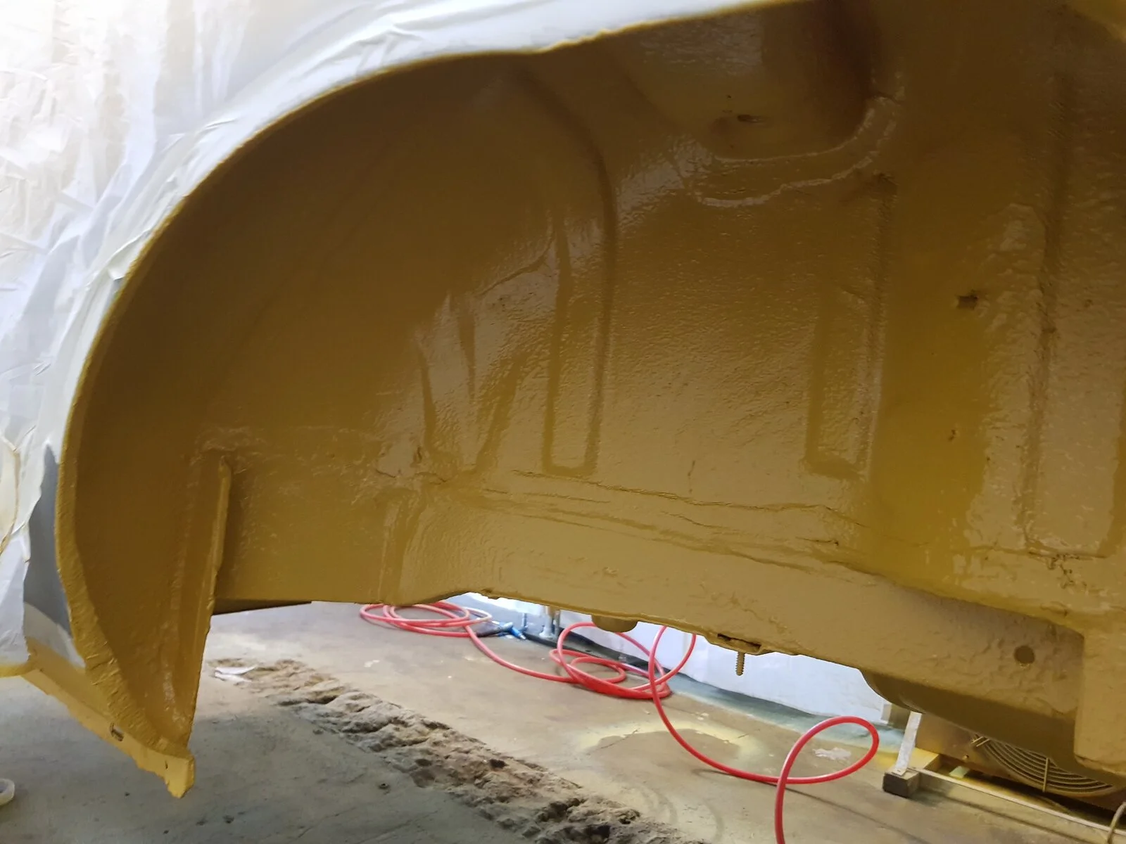

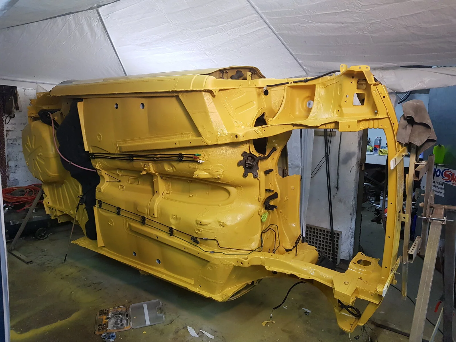

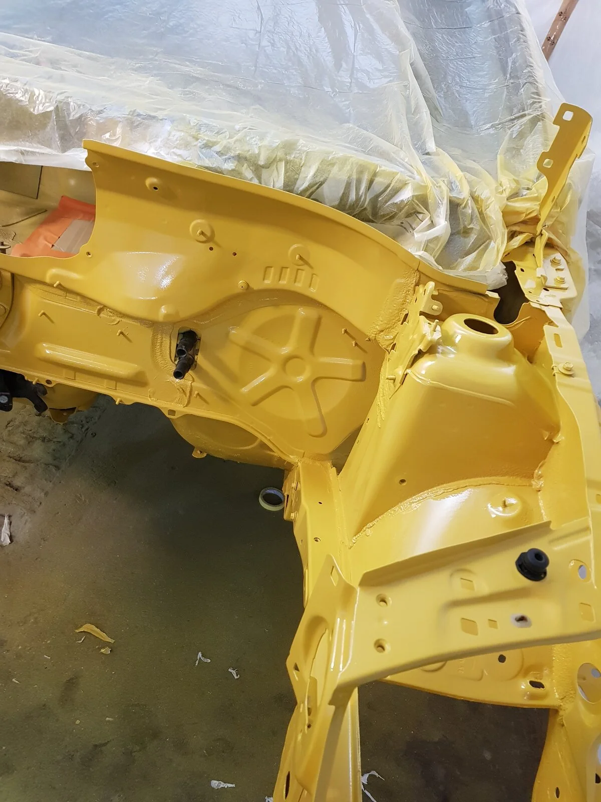

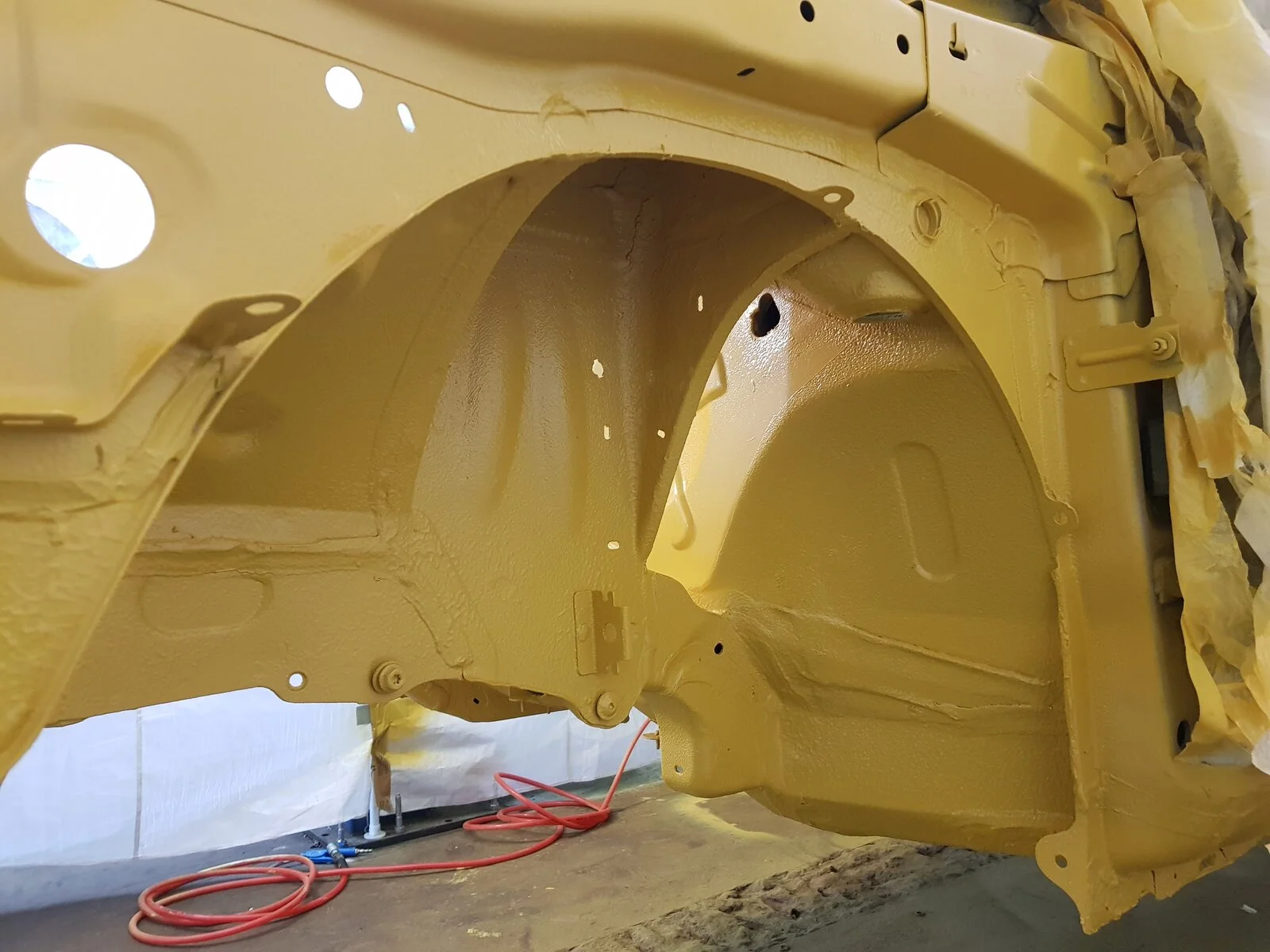

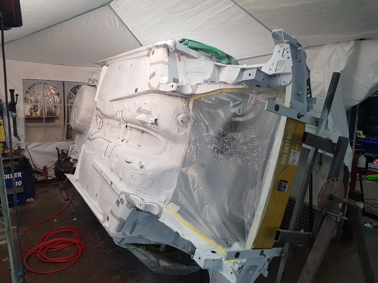

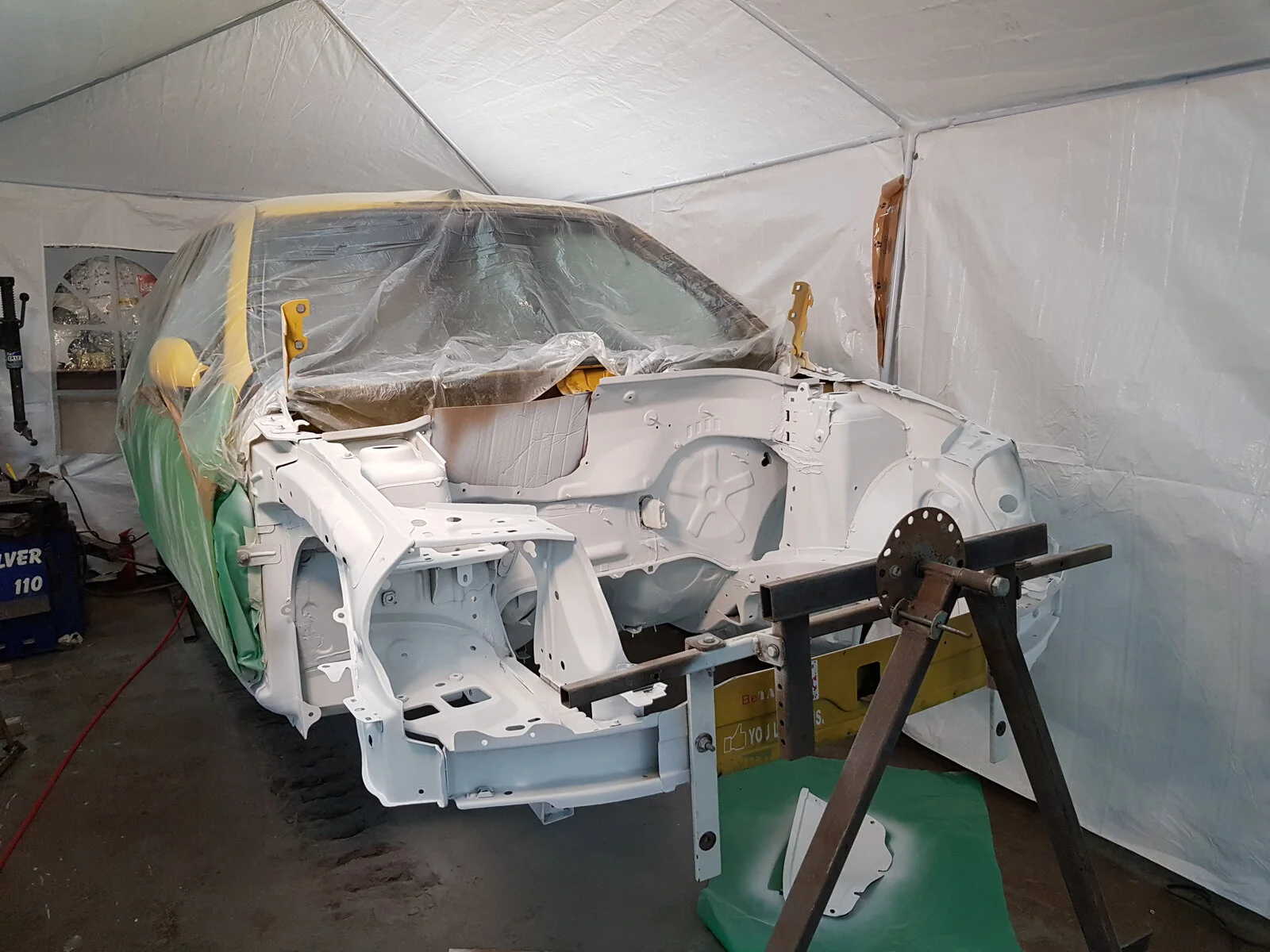

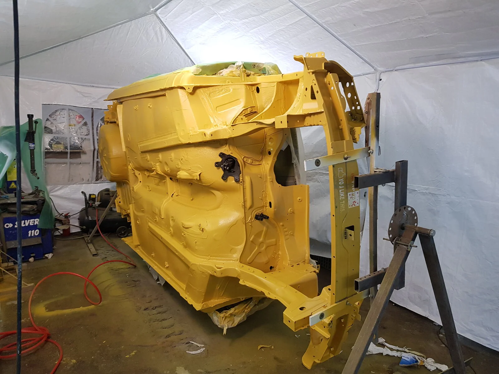

Good afternoon guys, I hope you're all sitting down, It would appear I've not posted in ere for coming close to 2 years :LOL:

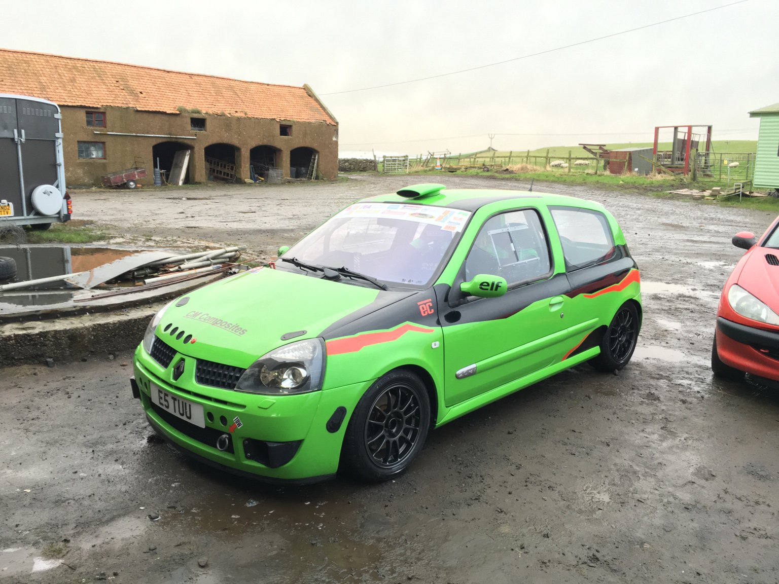

I wont bore you all too much with my life story since the last 'update' as I'm not sure how many clios I've had since....I do have the flamer back agaon that I posted about owning in January 2016....however it is now a caged track car :rolleyes: (I'll add photos at the end!)
Anyway, I've got a little bit more done to the car, More so in the last few months as it sat untouched for so long. Cheers to the few people that have helped/bulleyd me to death about getting the finger out... So yeah, Less talk, More pics right?
Hope the pics upload ok :LOL:
