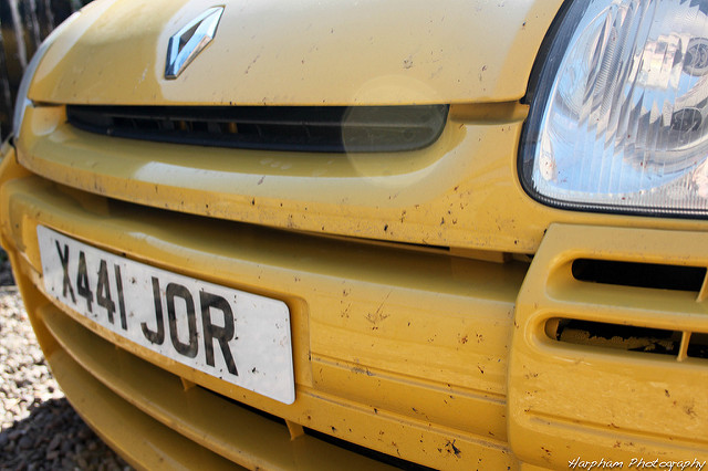

Before:
Sunflower Detail Before by Harpham y0, on Flickr
Car was pretty clean beforehand anyway...

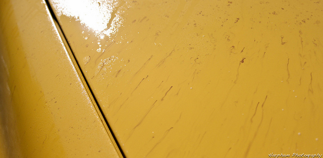

Sunflower Detail Before Road Kill by Harpham y0, on Flickr

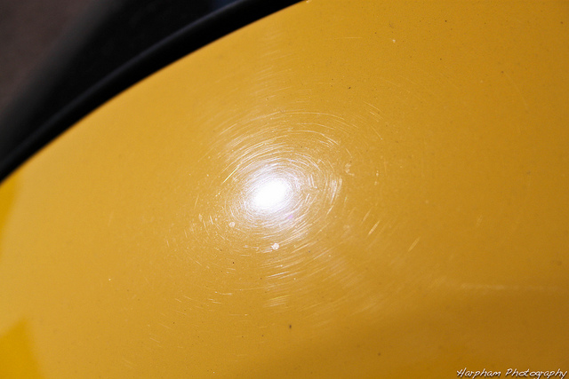

Proper swirlbus. Only managed about 70-75% correction, as the swirls were ridiculously bad and there was plenty of RDS.
Sunflower Detail Before Swirls by Harpham y0, on Flickr

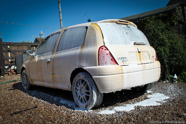

Sunflower Detail - Snow Foam y0 by Harpham y0, on Flickr
Sunflower Detail - Snow Foam by Harpham y0, on Flickr

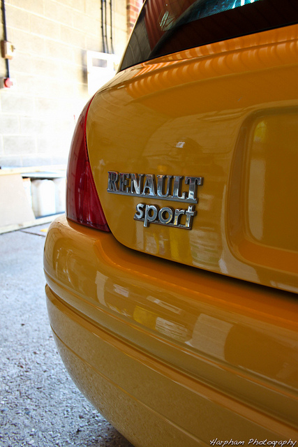

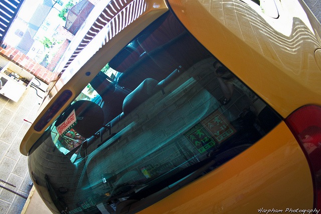

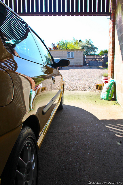

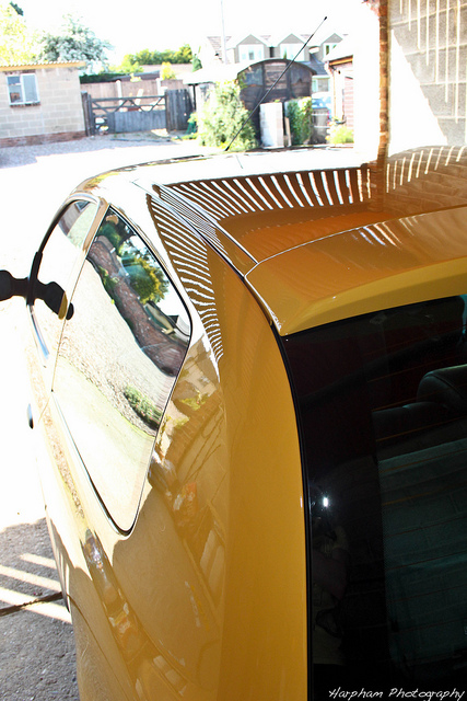

After:
Sunflower Detail After Reflection by Harpham y0, on Flickr
Sunflower Detail After by Harpham y0, on Flickr

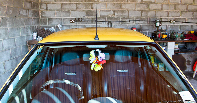

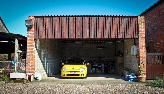

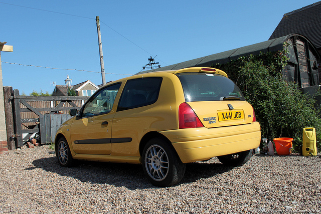

Its home for the day:
Overall, pretty pleased with the results, but still got a long way to go until i'm totally happy with the paintwork.

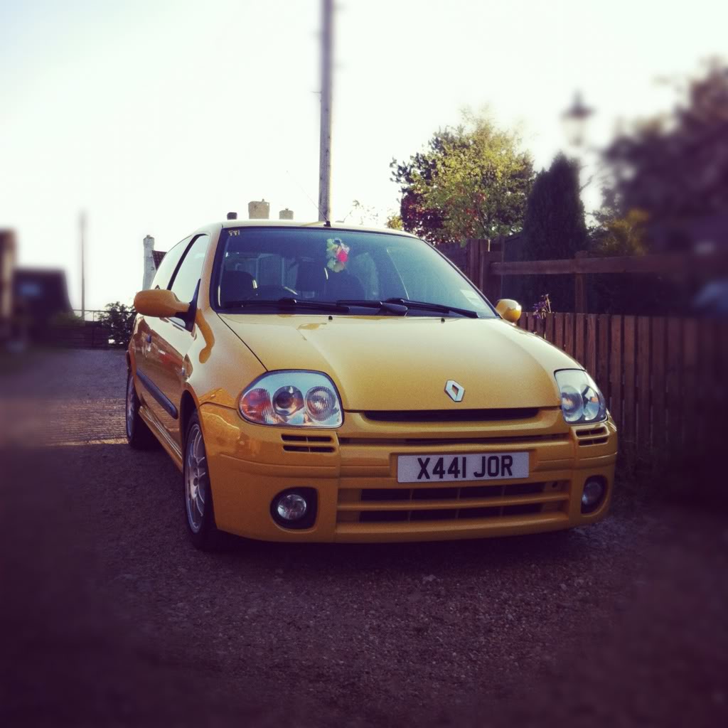

Compulsary iPhone Instagay photo:
Boom. :)
