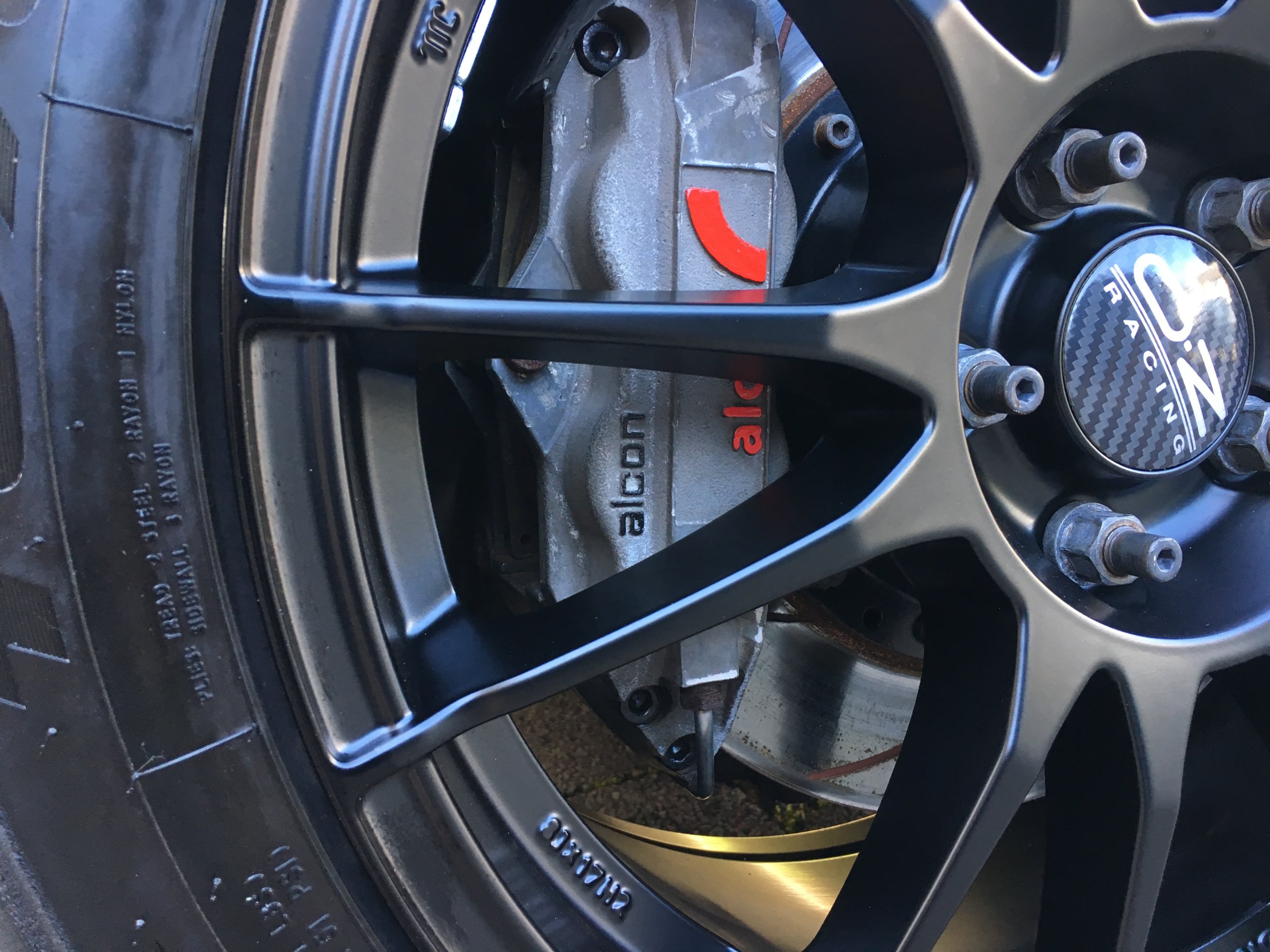

Anyway, looking a little better now and I had the rest of the afternoon to kill, so wheels off and I managed to tie the front Alcon callipers in with the rear. I'm not a fan of the red callipers with the AG paint, but since they are the option that comes with the pack I didn't want to paint them silver.... so I picked out some of the Alcon detailing on the front and made that red to keep the theme going.....
