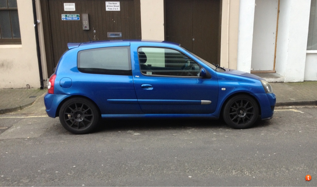

Wanting to replace a few bits on the front end to try cure some of the knocks clonks ect can anyone give me ideas of what can be replaced to stop the horrible noises? Ino its french and its a clio but I love it so dont mind spending money on it :) also when going over drain covers that dip down a bit my steering feels to be all over the place and somtimes feels like the steering has a mind of its own lol

Sounds a bit like a ball joint.
It all depends how far you want to go...
Shocks
Steering rack bushes
ARB bushes
Wishbones including ball joints
Shock top mounts

Brilliant thanks mate :) worth replacing bushes with lowerflex? Or just use oem ones? I already have a powerflex dogbone but want everthing to feel to stiff I have 2 ball joints in the shed I might replace them over the weekend :)

I'm just in the process if doing the front end plus a new set of coilovers as mine are shagged. General consensus seems to be Powerflex are not worth doing and original parts are more than up to the job.

Yea I did read up a while ago about stock parts are more up to the job :) can anyone tell me what bushes ect ars on the front end so I can look them up I might just replace them all and make it nice and fresh
Powerflex aren't worth it. Just use stock items.
