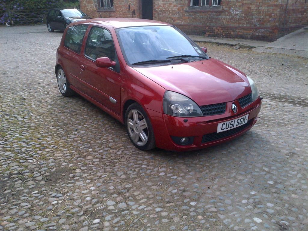

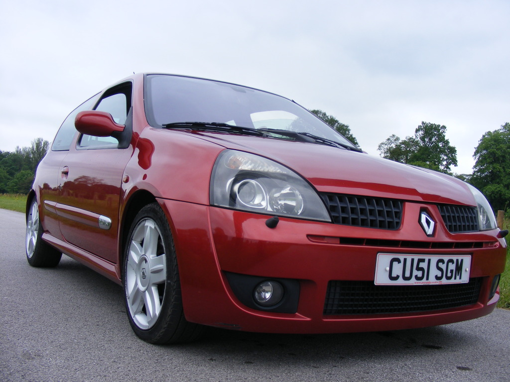

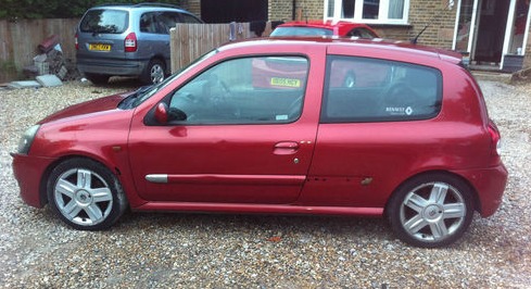

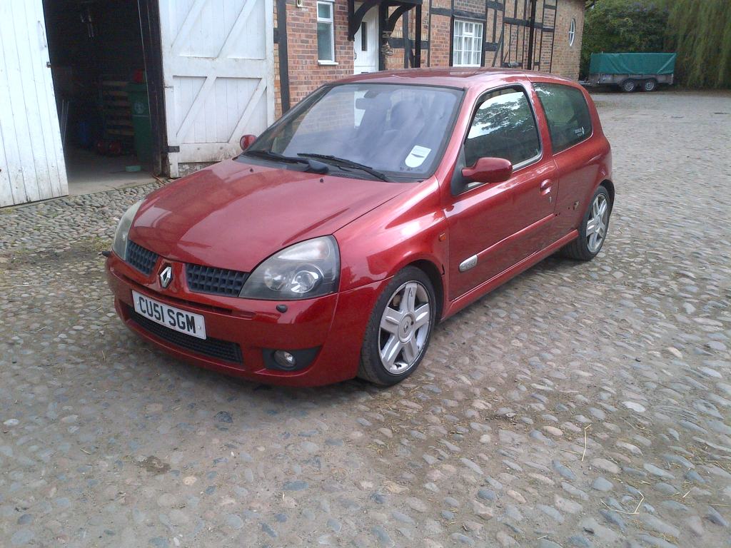

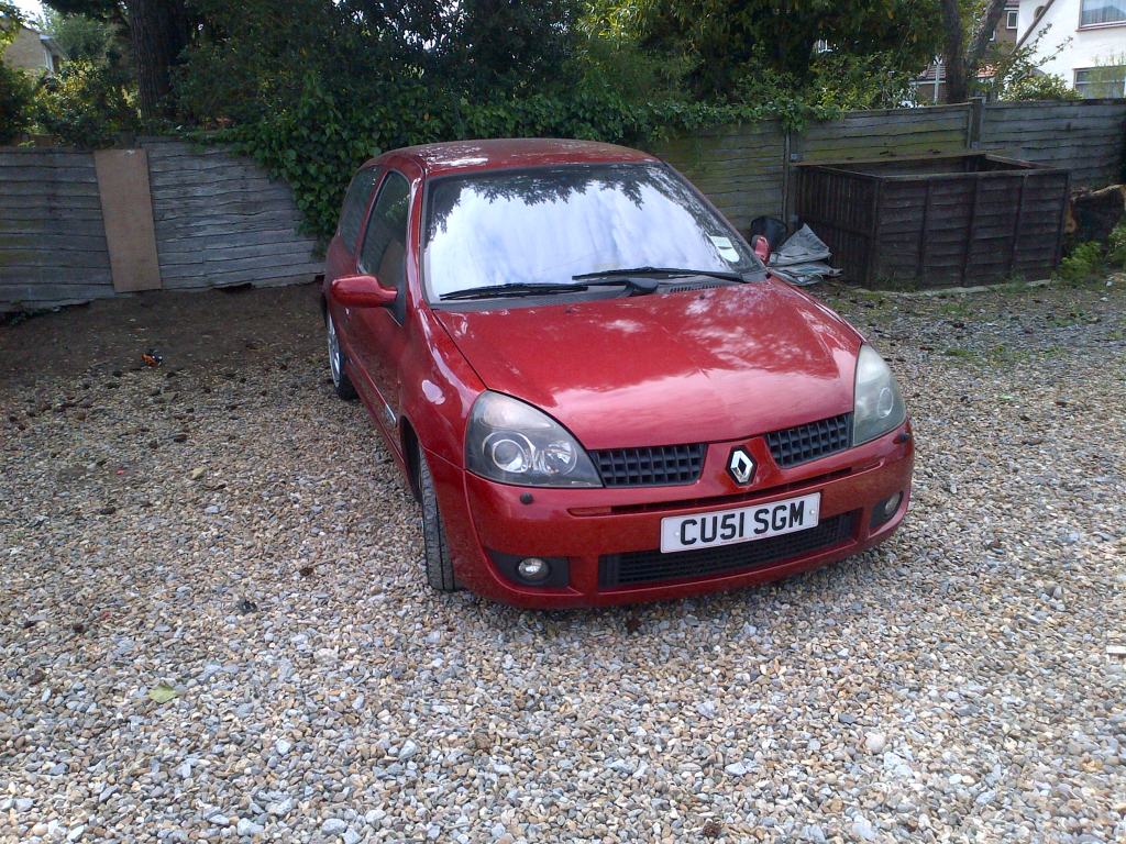

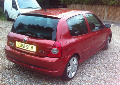

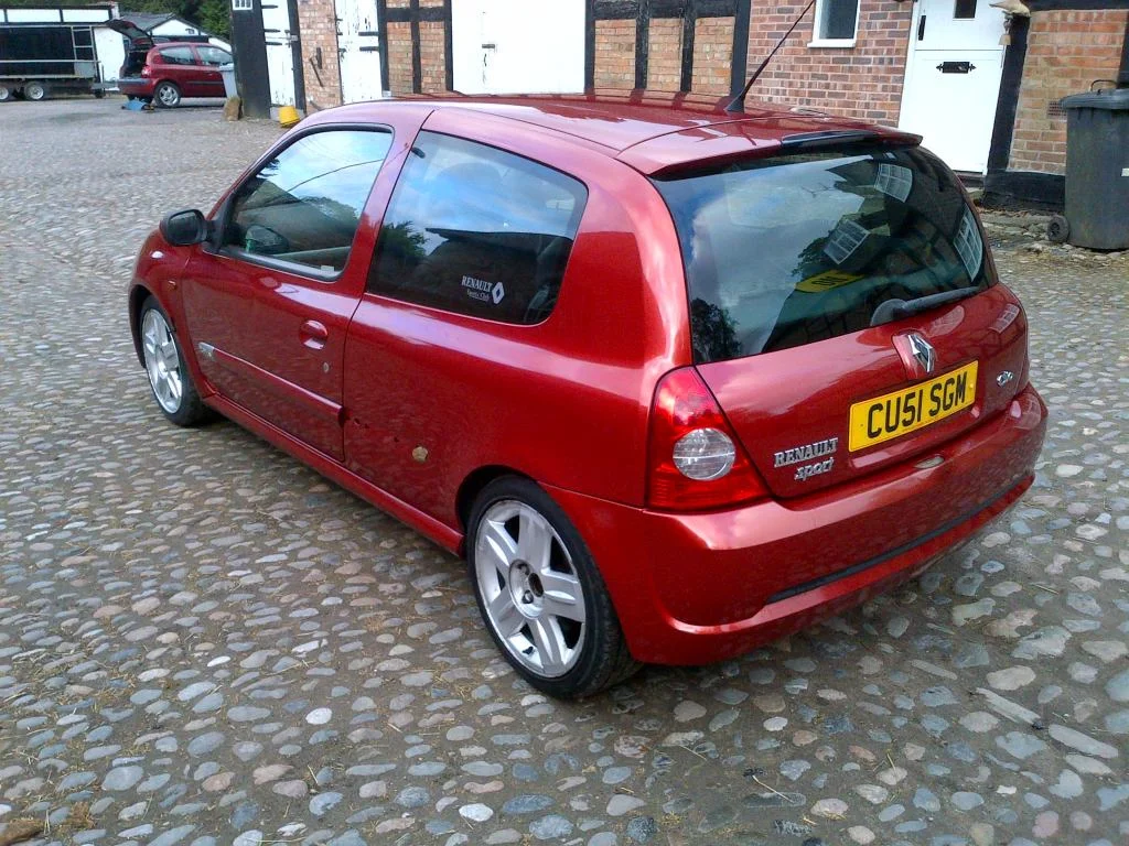

After a long hunt through here, piston heads, Ebay etc for a project car I found this little beasty and won it for £600.

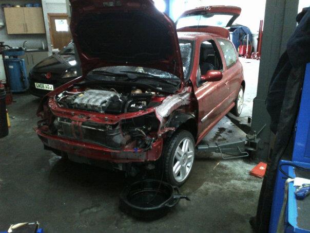

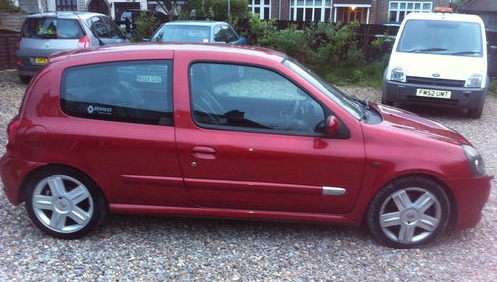

Tidy enough, small amount of bodywork needed to the near side along with a few electrical niggles and two shot window regs.
Towed it back from Uxbridge nr London on the one man tow after collection companies wanting in excess of £400 to lift it!!

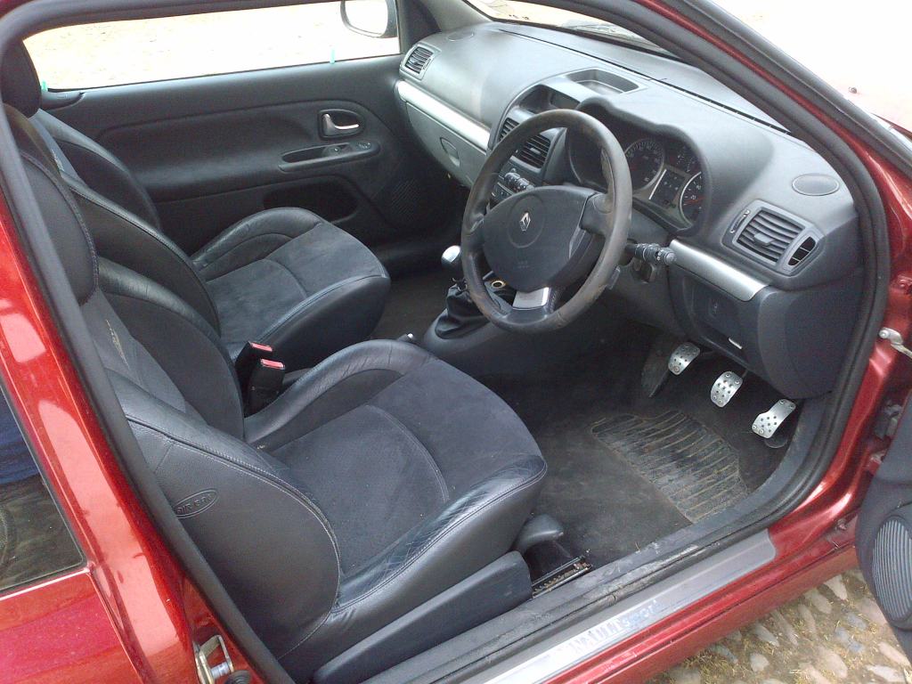

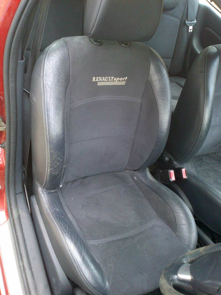

Tidy but grubby interior... all the controls and plastics are covered in minging hand grease so some mega valeting required.

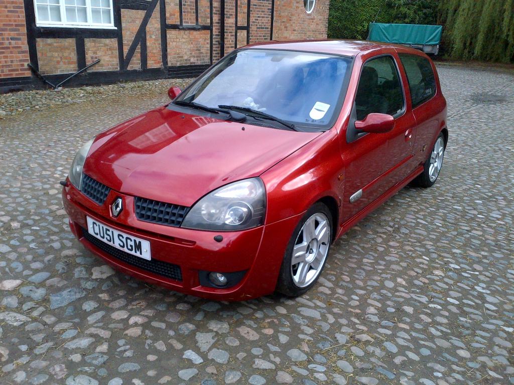

Daft Halfrauds K&N removed and original box (in the boot) replaced complete with ITG panel...

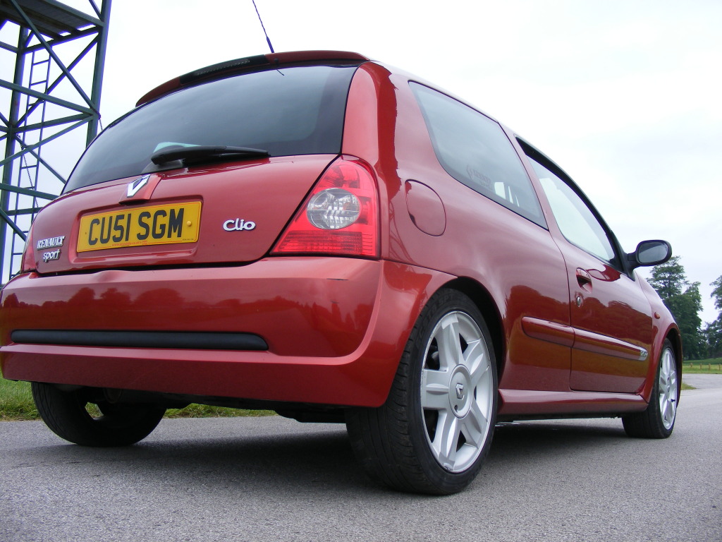

Quick wash and polish and the paint comes up really well!

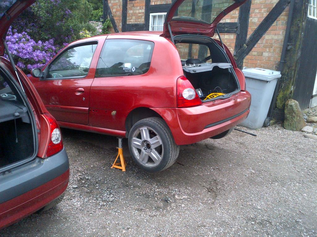

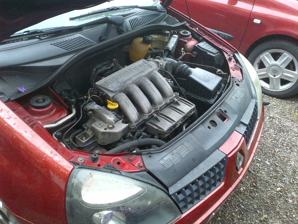

Inlet manifold off and cleaned ( in the dishwasher.... dont tell the wife) throttle body cleaned, and spark plugs changed for good mesure...2 cracked...that'll be the miss fire then!
Then off for a quick test drive..... Any one guess where I live lol......

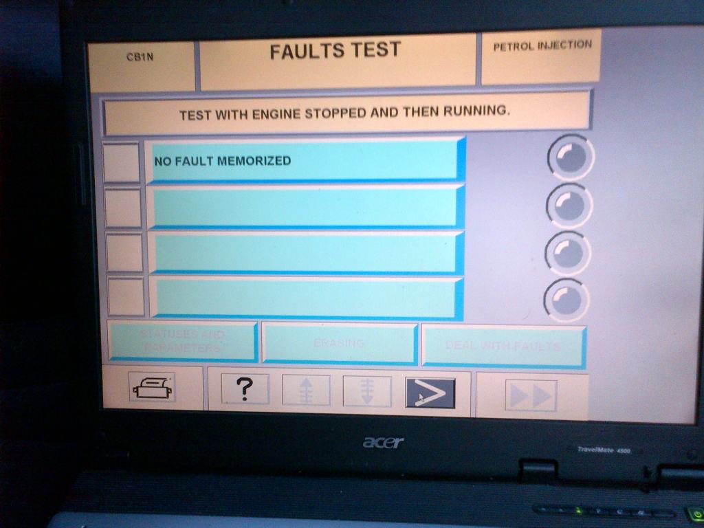

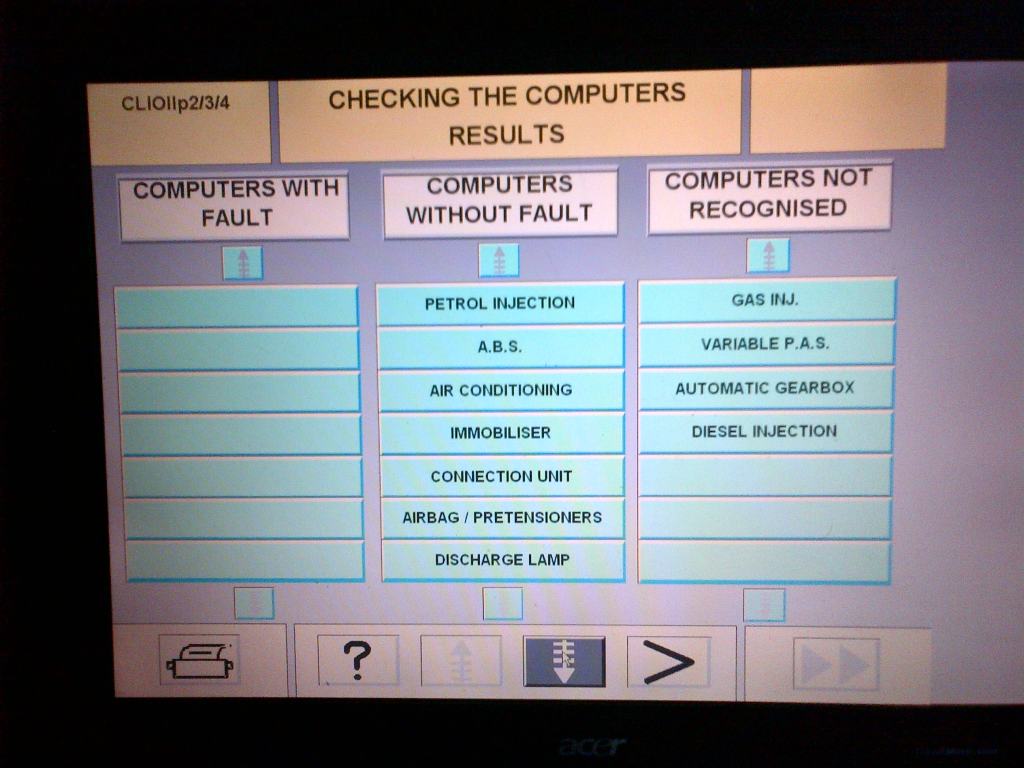

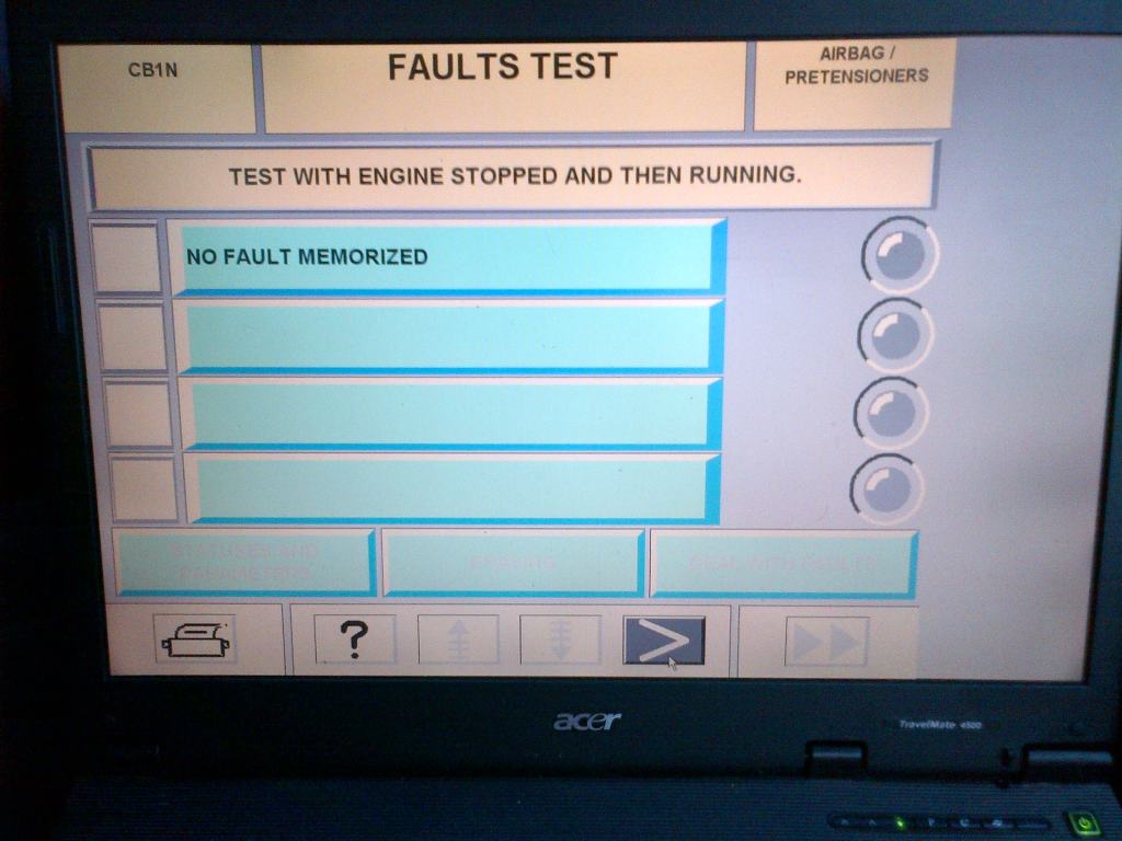

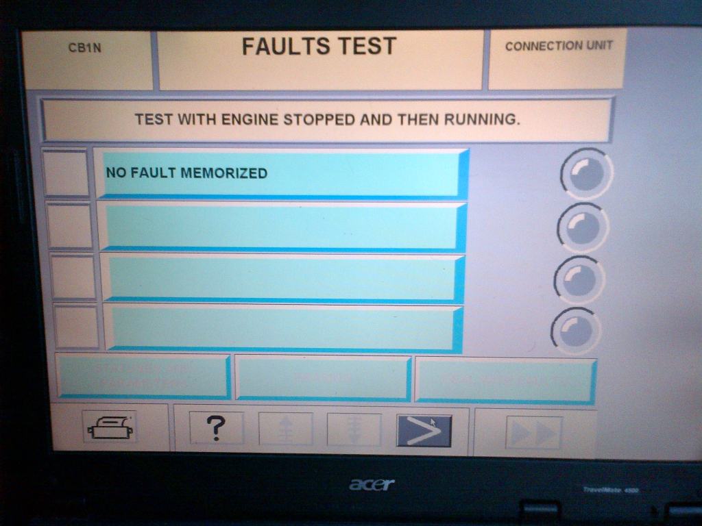

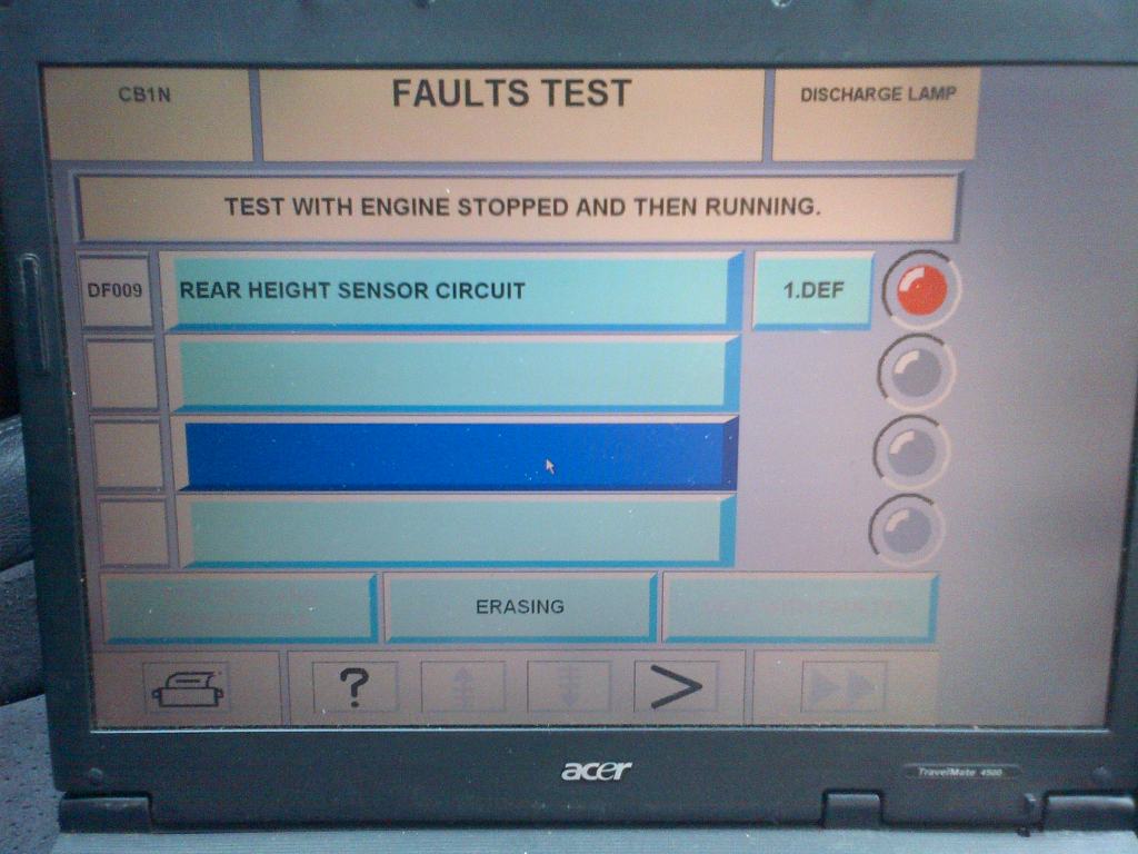

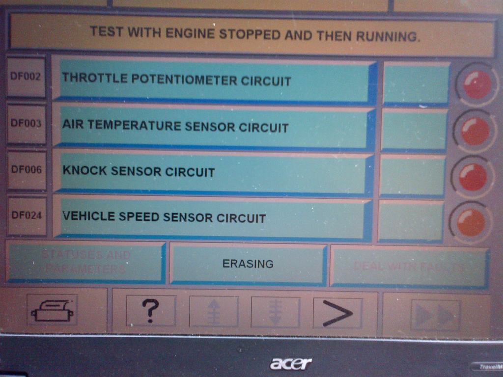

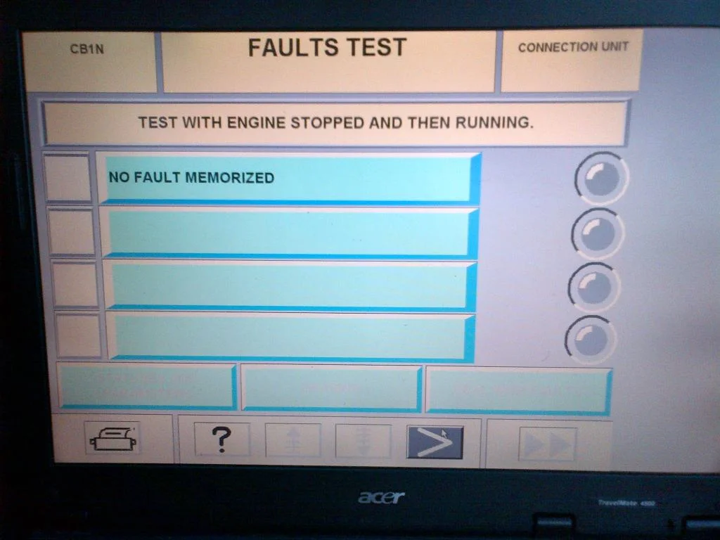

Its Genuine Renault Clip....Dealer soft and hardware.... perks of being an Ex Renult mech ;)
It does literally everything for all models.

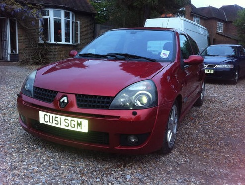

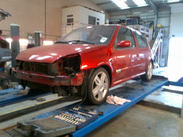

That damage to the N/S doesnt look severe - I notice a new front wing, ding in the door and rubbing strip needed. Is that it, as it seams a fair bargain?

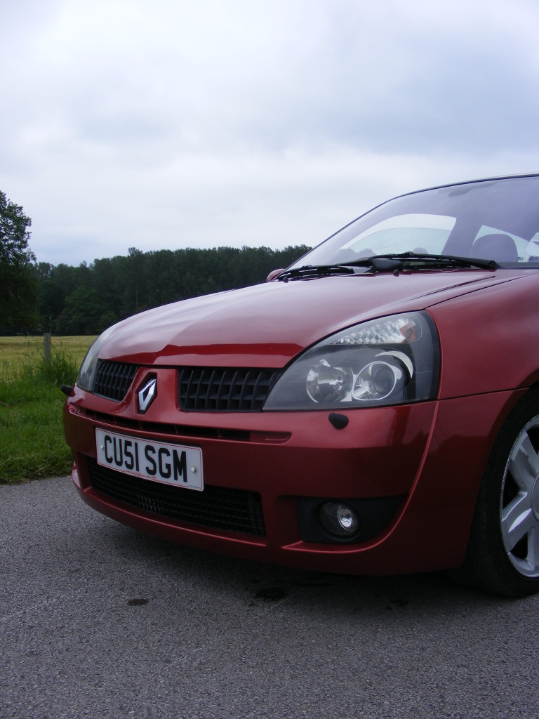

Front wing - off 172Flamer
Door and 3/4 trim - off ebay
Fog light - off Arctic
as for the dents i'll get my mate who doesthe paintless repairs to have a look
all looks very tidy for the money, its my favourite colour - My monaco was all I could find at the time.
Keep up the good work!
I'd have loved a Monaco.... but I'm in the same position this came along at the right time/ right money.

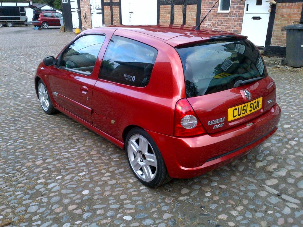

Bit more tidying up to do then off for MOT :)

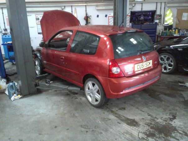

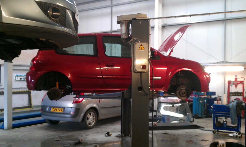

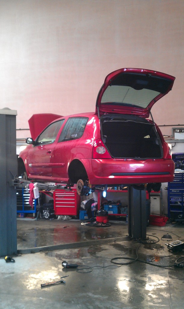

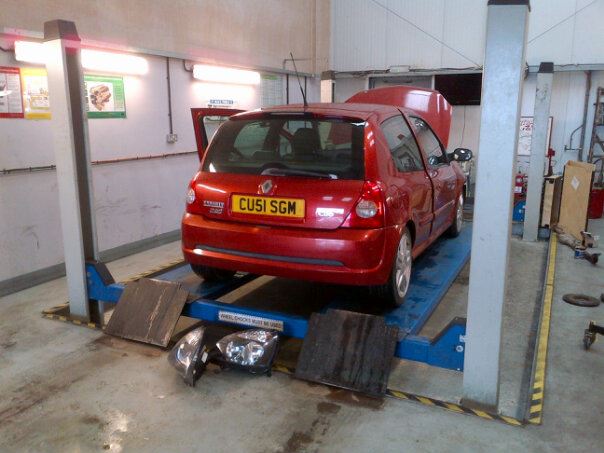

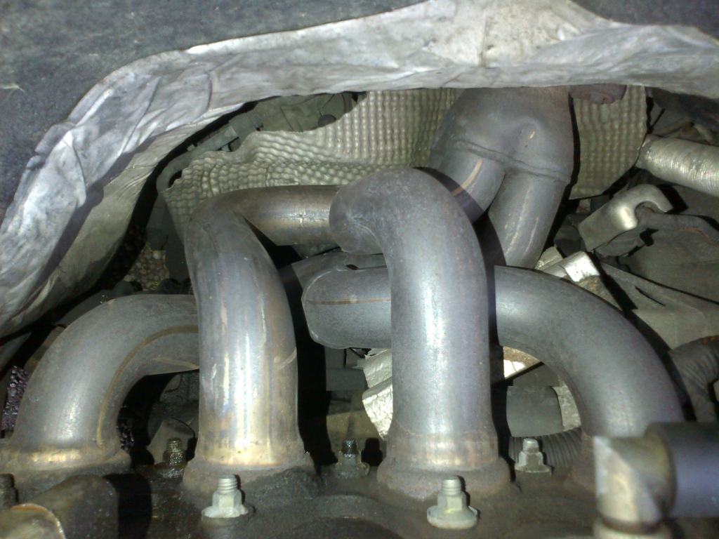

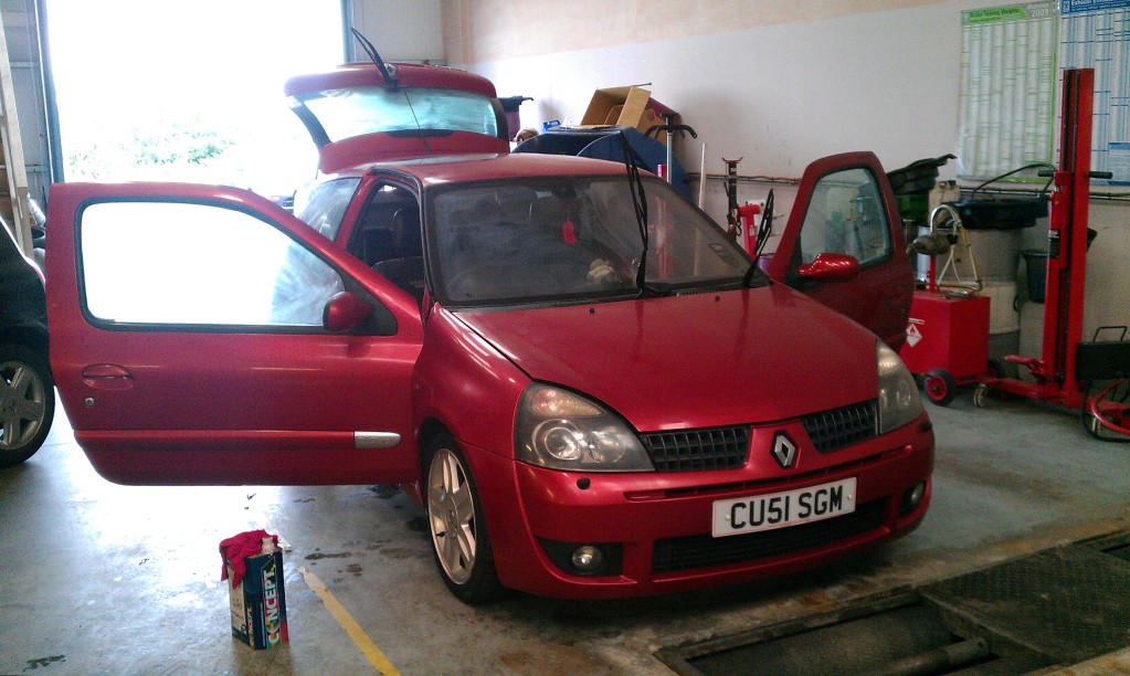

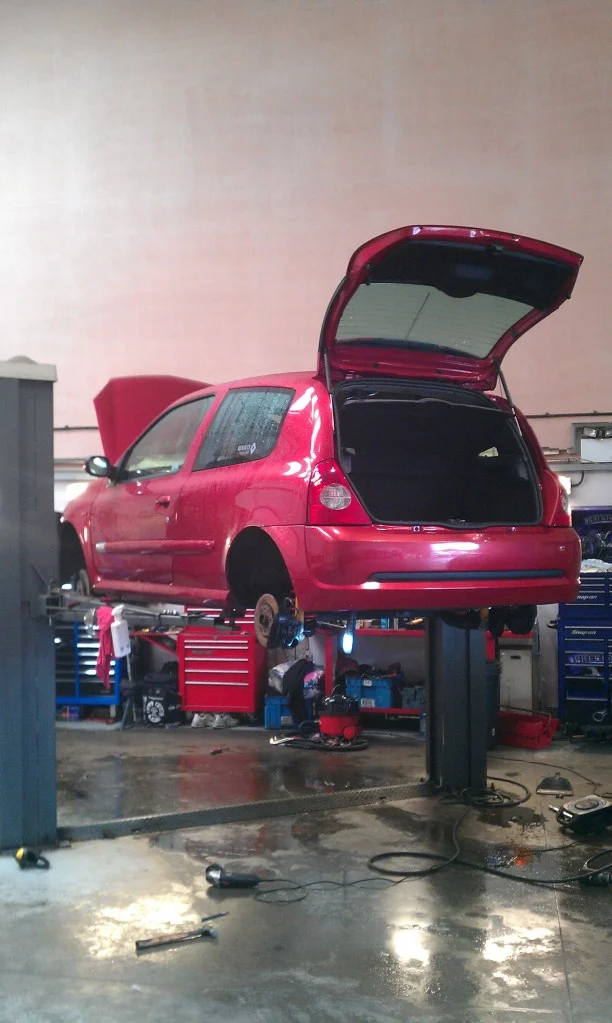

@ work for the belts, service, new coil pack, middle and rear exhaust hangers and pre mot inspection...
Since discovered it's polybushed all round and remarkably clean underneath.... someone loved it once!
Resprayed wing and cill back on

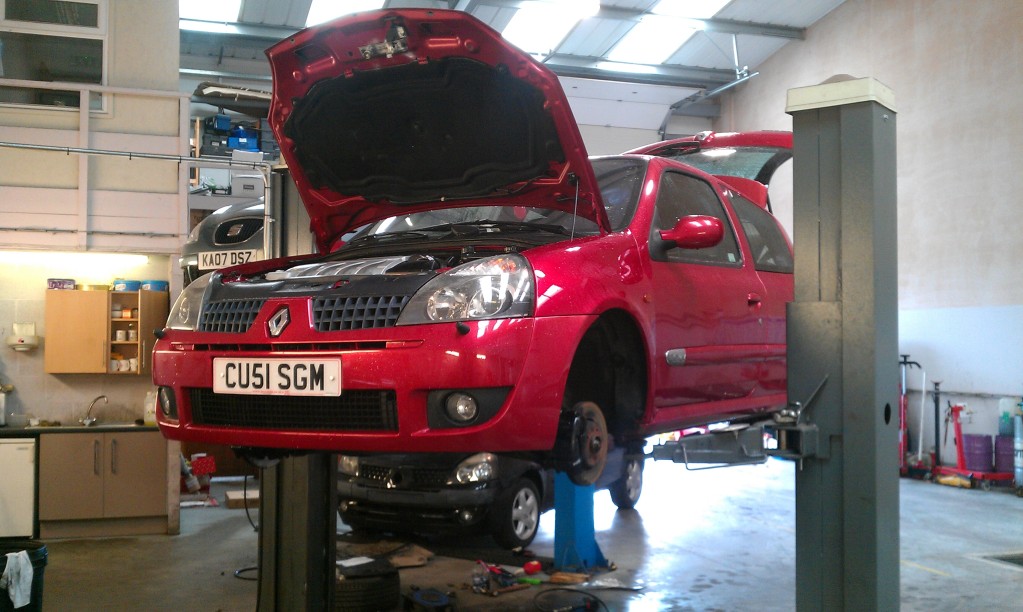

Soooooooo much easier when you have both 2 and 4 post ramps to play with....

Having slight issues with the beasty and a hesatation and misfire..... replaced the plugs ( 2 were cracked ) replaced the coil pack ( tracking marks up the enamel ).... and she's still not a happy bunny, I've ordered a set of leads so fingers crossed this cures it.
Wind screen is arriving on friday so get that fitted on sat morning all being well, then just the ballast pack for the mot and she's good to go :D
Miss fire cured ( duff lead) now just waiting on a windscreen and a ballast pack then MOT here we come!

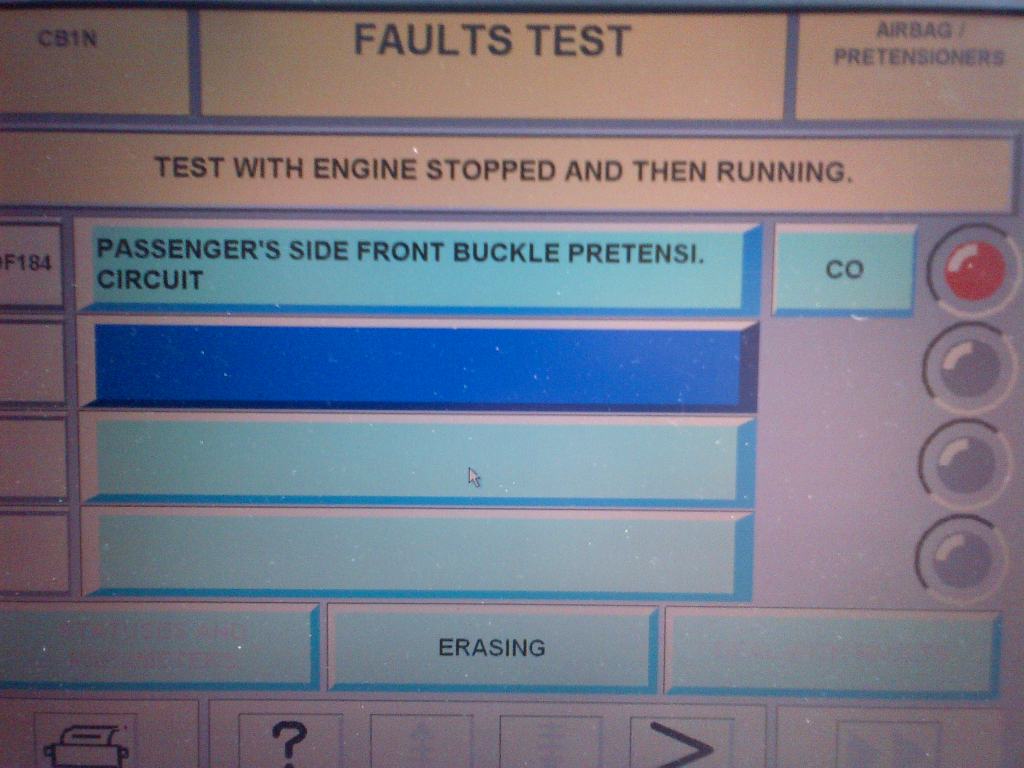

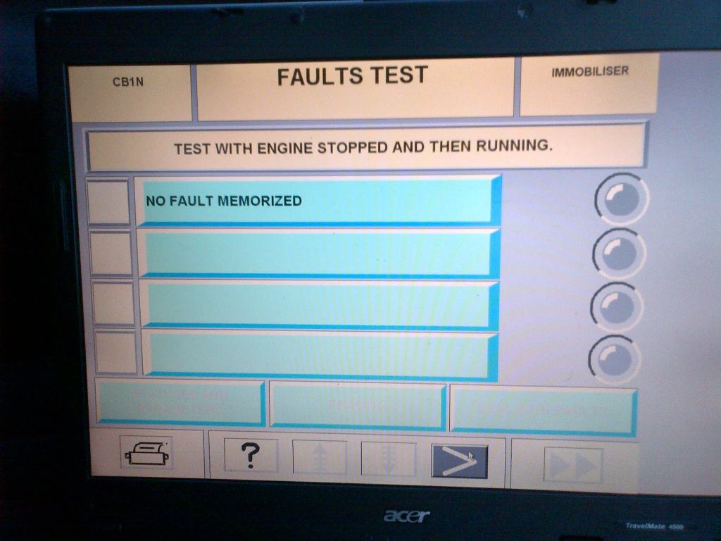

Finally got the windscreen in today at work and cured the dreaded red 'flashing' and 'solid' light..... bloody key fob battery was goosed!!!! and theres me like a dickhead getting ready to start testing all the loom..... just proves go for the simple things first!
