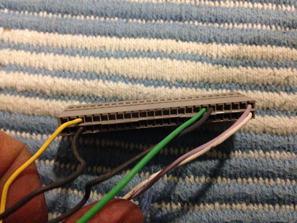

Ah that's what I thought you were talking about. No it wont fit in and I snipped it just above where your red circle is. The two cables that join to one that you have your finger on do fit though without having to snip or crimp.

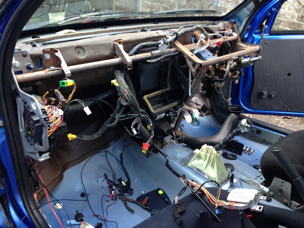

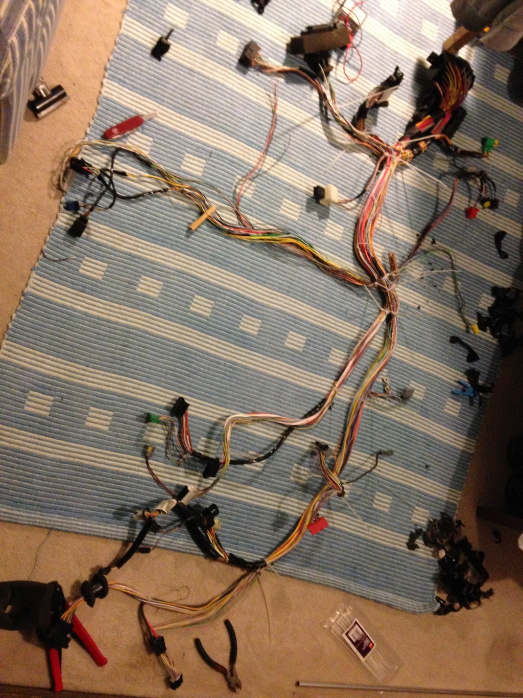

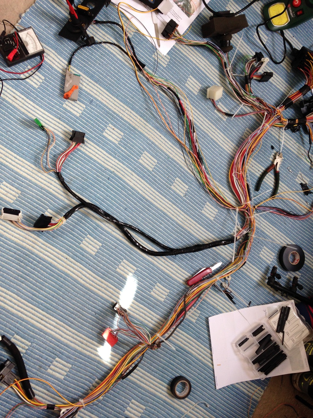

I have all the wiring diagrams for the ph2. I've recently stripped my dash loom and everything is working perfectly. The best bet is to know what each plug is, trace it back through the loom, use the wiring diagrams and remove the unneeded wiring . The canbus network are green wires and they all come together about a foot up the loom from the OBD2 port.

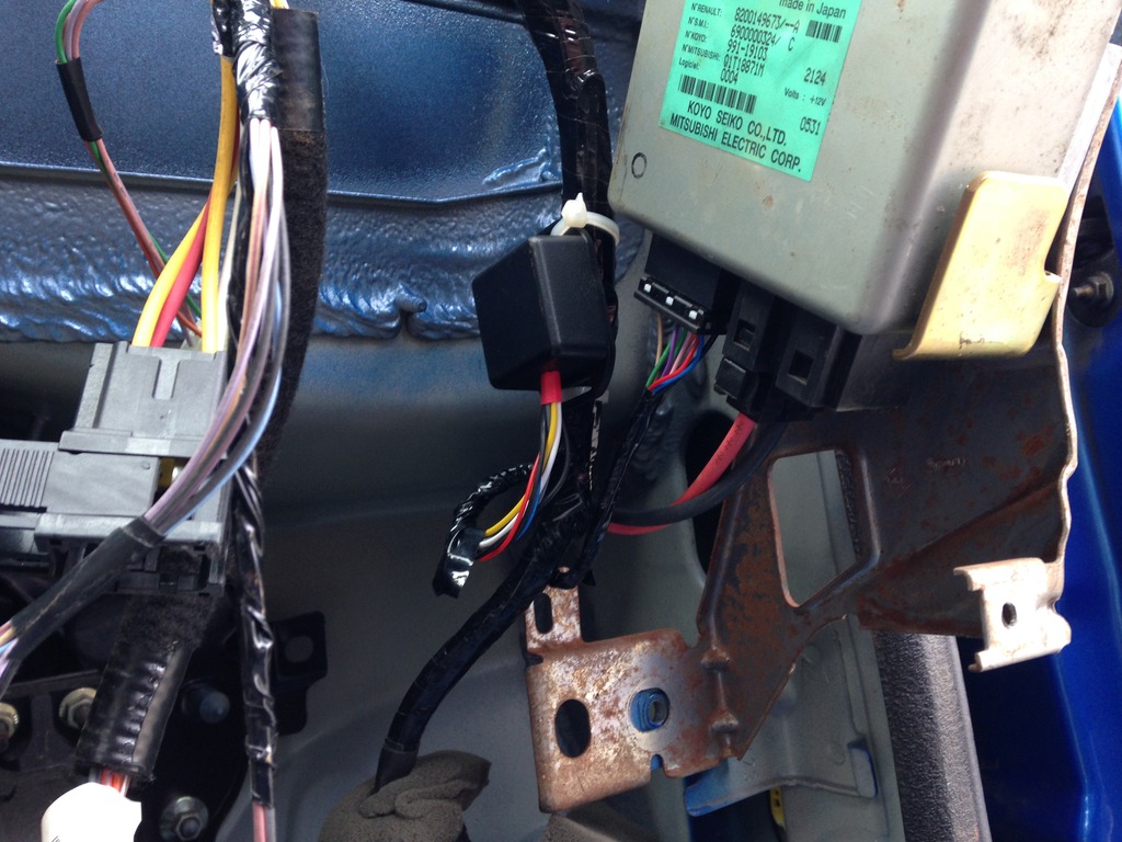

I totally unwrapped the loom, cable tied to make sure the correct spurs were kept and then removed the wiring. I re-wrapped using 19mm non adhesive loom tape. Relocated the 12v socket, obd2 socket and hard wired the EPAS into the fuse box and rest of loom.
Few pics of how I did mine.

hard wired EPAS
I unplugged the air bag ecu and the side impact things. My plan was to use RS Tuner to turn the airbag light out, but that isn't possible. So decided to accept the light, cut nothing, and bundle the loom out of the way. If I was racing I'd maybe chase the weight, plus I'd love a nice tidy loom, but for now tucking it out of the way will do me!
Thanks for that info. I cut the loom going down to the air bag ECU and OBD2 port which is what started my problems. I unplugged the air bag ECU and the engine still fired up so thought it would be ok to cut. Obviously not! I will have a closer look at your photos and my loom. If you could send me the wiring diagrams that would also help a lot.

hard wired EPAS

You're just pro! I didn't actually use them until I knew I made an incorrect snip. I then used them to wire up the EPAS warning light on the dash and make sure the EPAS was on the correct fuse in the box. Simples.
Had enough of this wiring lark now. I attempted to run the standard loom again and connect everything back up including as above following the photos. The biggest problem I had is that there are lots of black wires and didn't know what was what. Now every time I put the ignition on it does something different with all sorts of relays clicking in the engine bay.

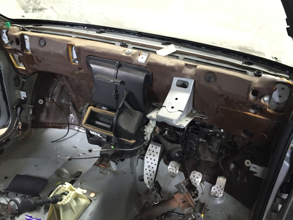

I have decided to strip the whole interior now to bare shell and then weld a cage in, seat frames and then spray the whole interior.

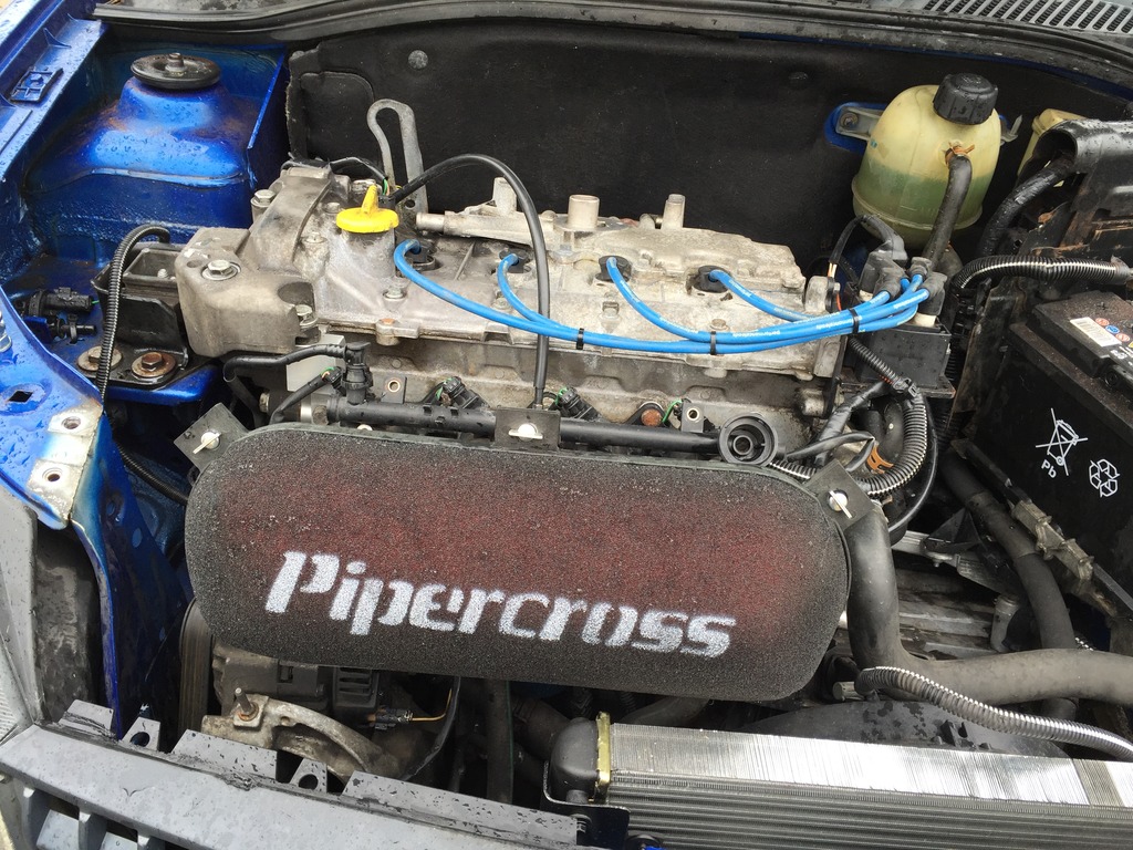

Just realised I never put a photo of the HT leads re-routed and the the Throttle cable cut down to a better length:
This was before the battery relocation obviously.
