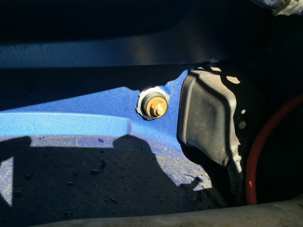

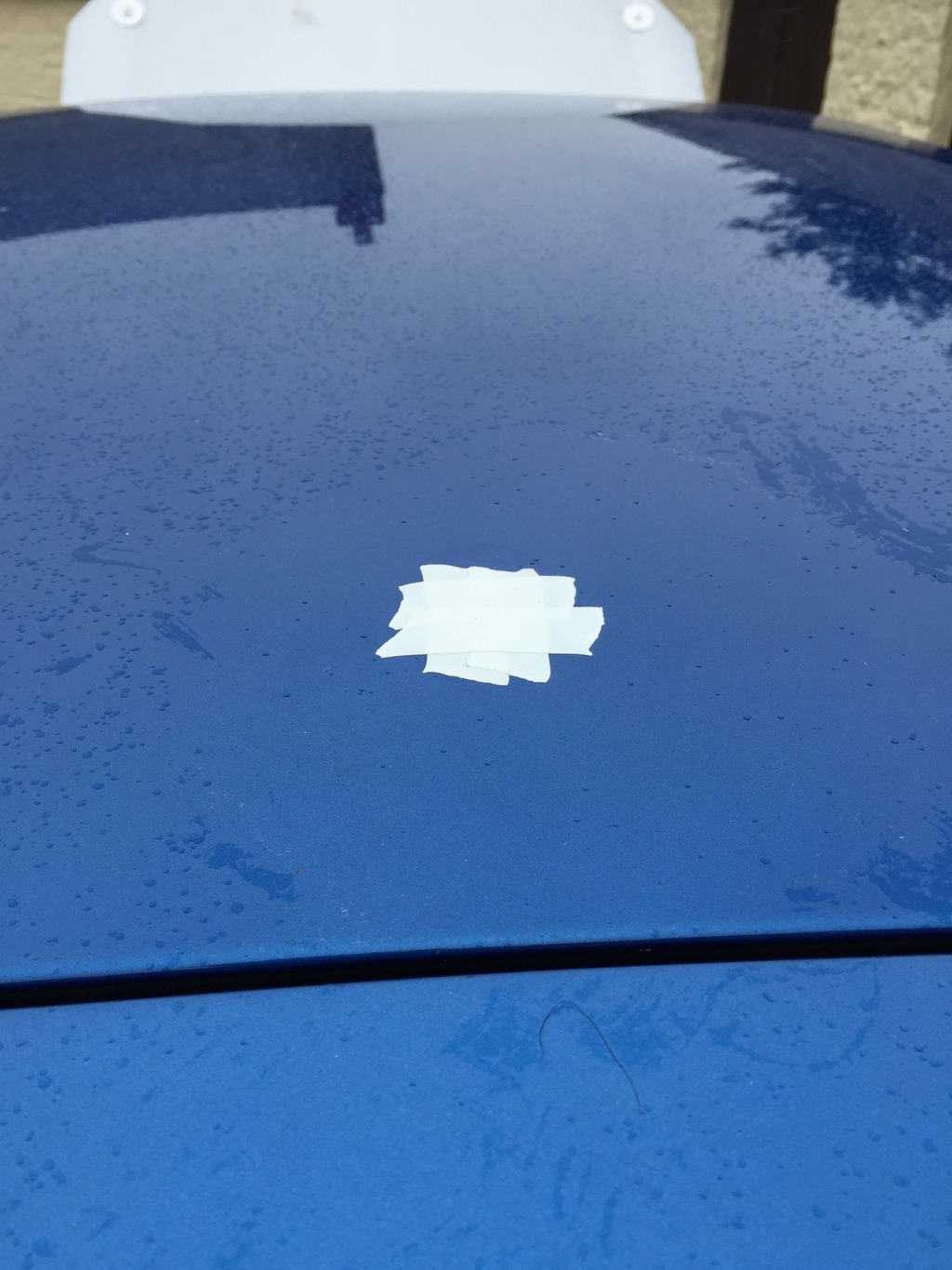

I was thinking earlier about how to plug the hole my aerial left. I was thinking I might be able to buy a suitably sized grommet, clearly I wasn't thinking redneck enough!
My plan is to fibreglass it from the inside and then fill it from the outside. Then either paint with a touch up pen, spray and blend or wrap the roof with vinyl.

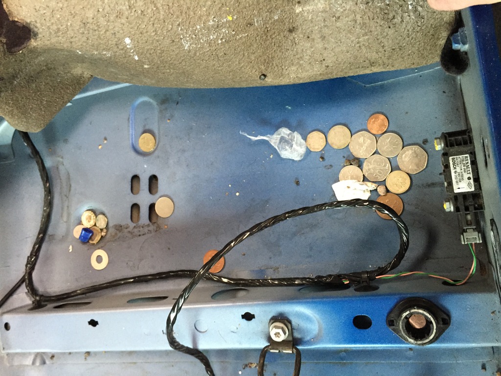

Just took the carpet and passenger seat out. Guess how much money I found!
Used a resistor for the passenger seat connection to kept the air bag and service light off.

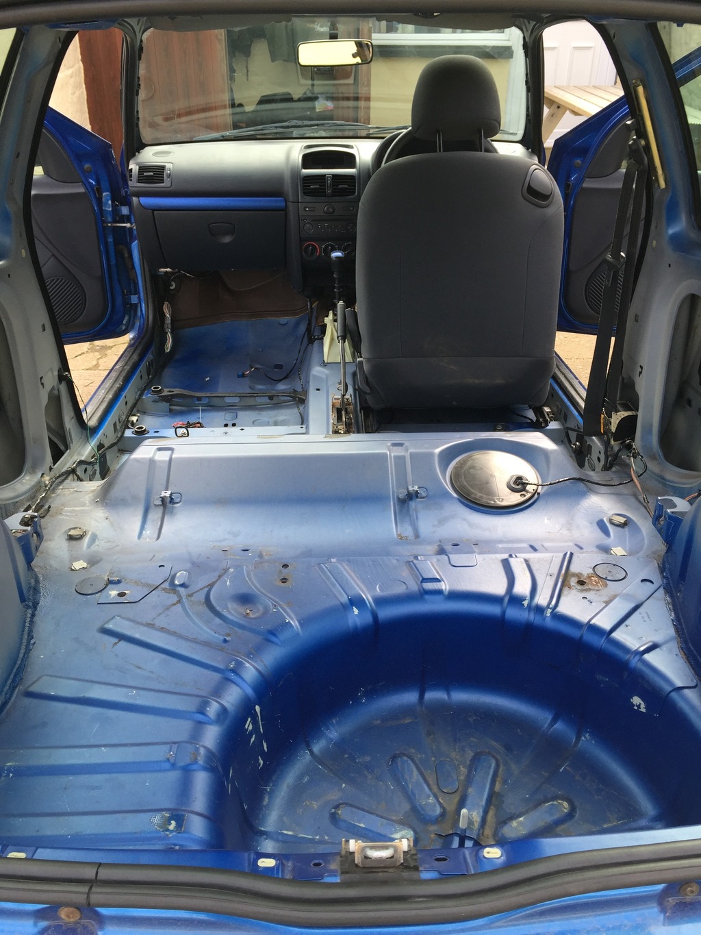

Started stripping today:
Need a 6mm spot weld drill to take the bracket work off.
Also started stripping out the wiring that's not needed. Left the central locking in the boot for now.
Those black clips are a pain to take off. Lol

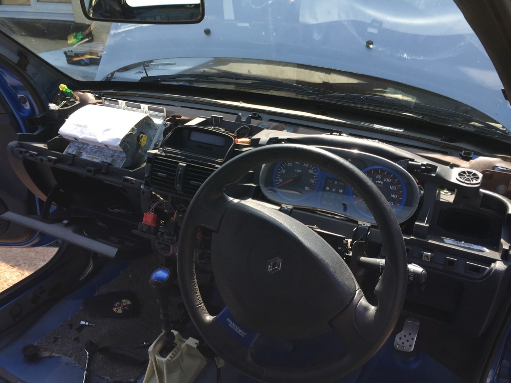

Did some more stripping today.

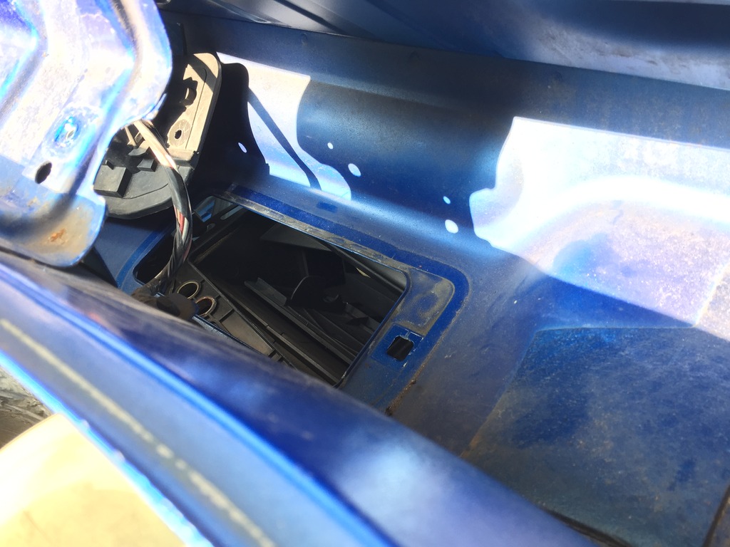

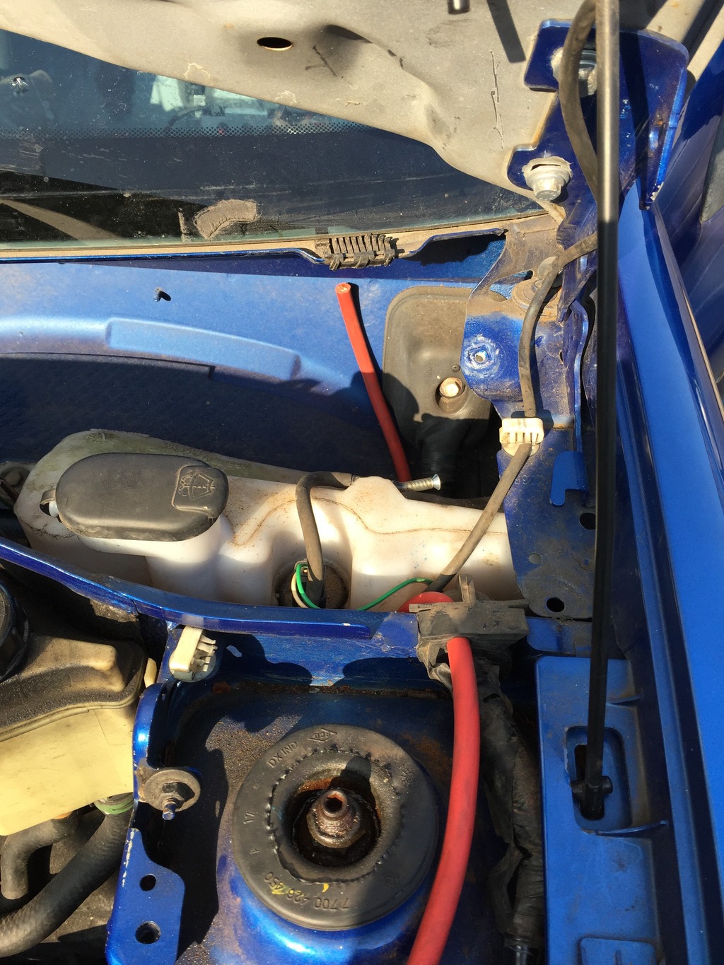

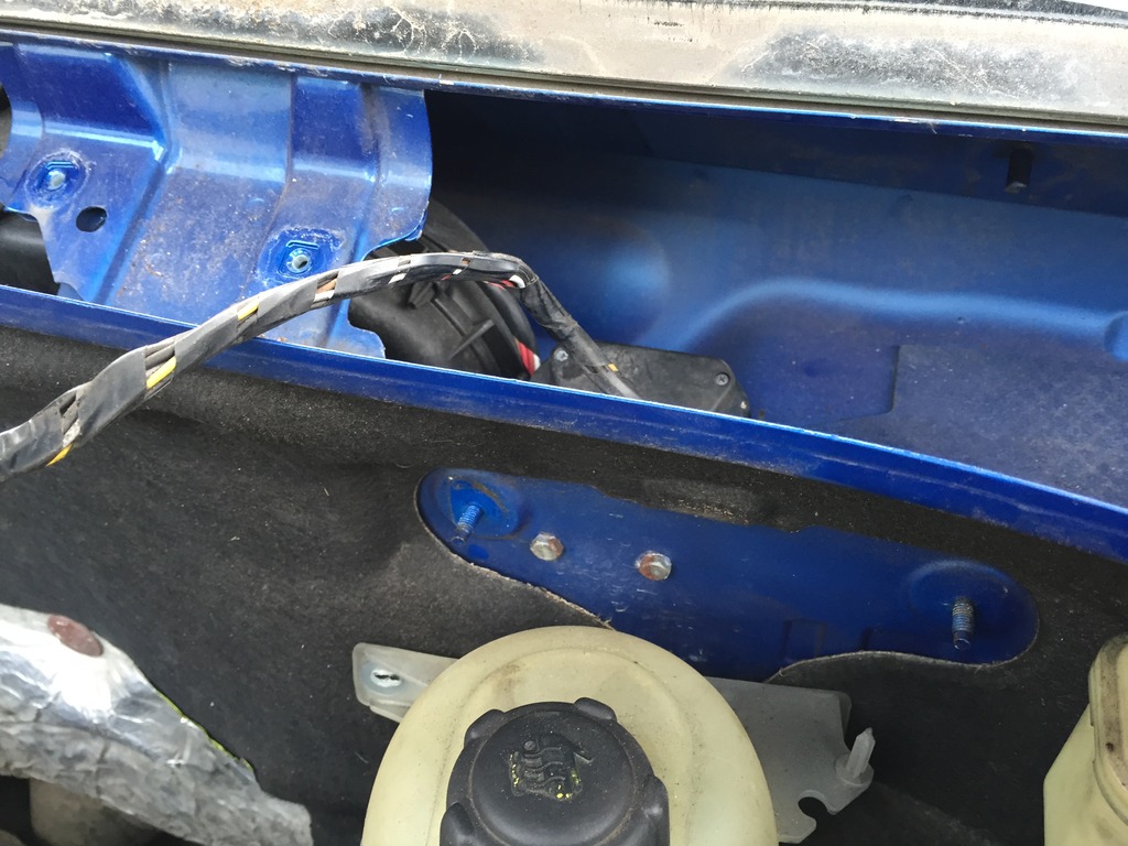

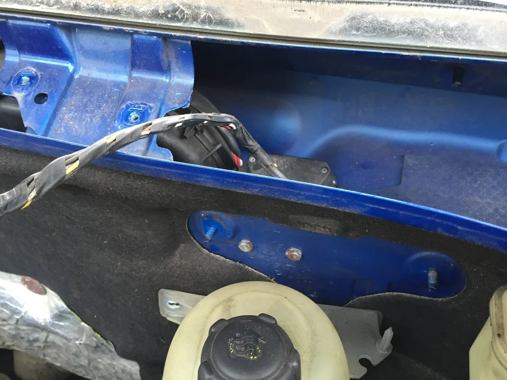

Had to take all this off to get to what I was after:

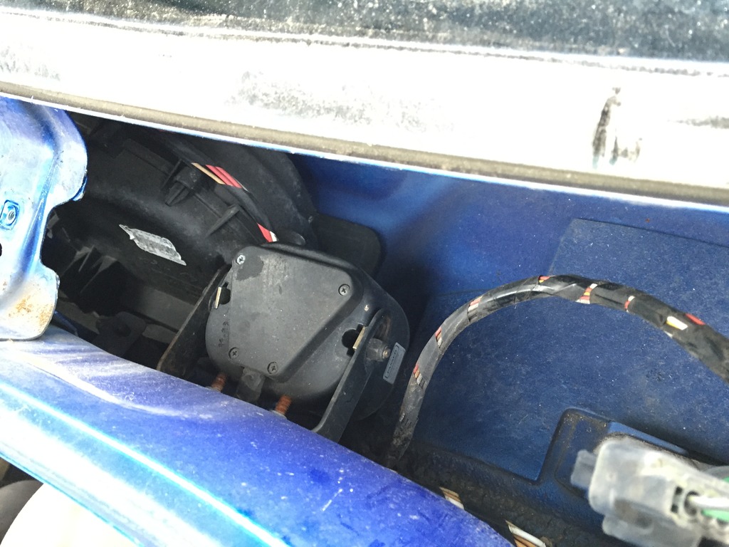

Then took this little monster out:

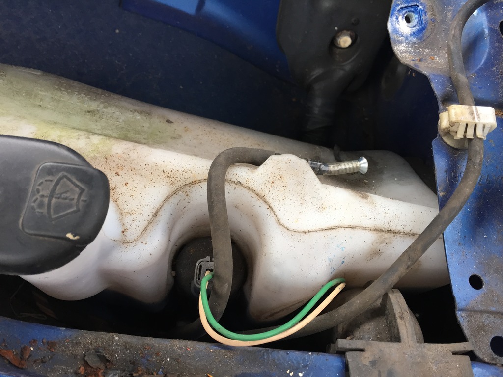

Had to take the coolant bottle off its mounts to get it out:

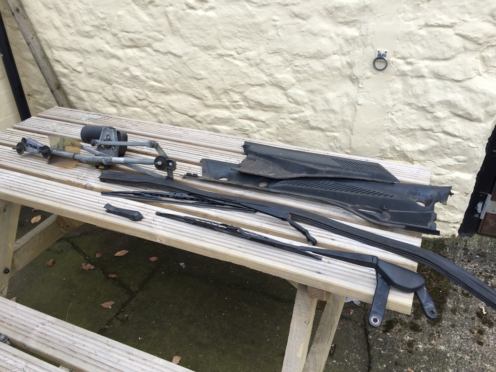

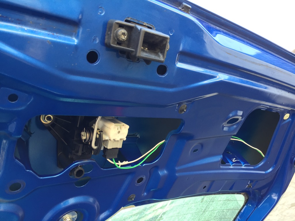

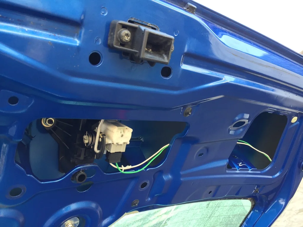

And as a I have removed the rear wiper and fitted the blank I pulled the hose all the way back out and blanked off the pipe just so it doesn't squirt out of you do ask for it.
what is it that you removed? As I've removed my rear wiper too.
At the rear I have removed all the wiring for the wiper, the rear interior light and then pulled it all back to back inside the car so I can continue stripping it down the loom. I also pulled out the sprayer hose back to the bottle.

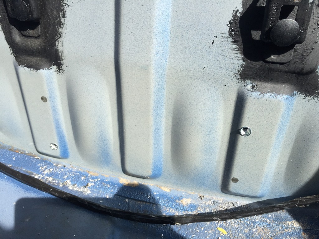

Don't want to mess with too much with the MOT being tomorrow but I started on the battery relocation today.
Used my new rivnut tool too.

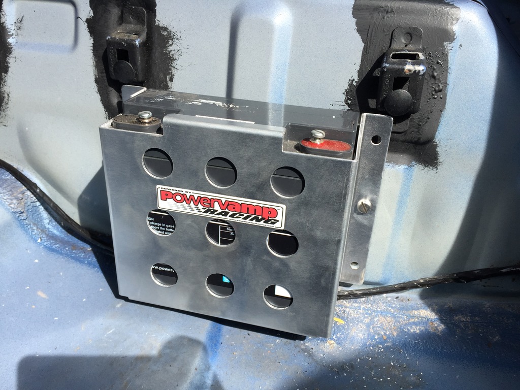

Marked out the battery holder location behind the passenger seat and put in two rivnuts:
Fitted the battery and secured with just two screws which seems more than enough for now:
I have ordered a spot weld drill so I can remove all the brackets from the back including the two right by the battery.

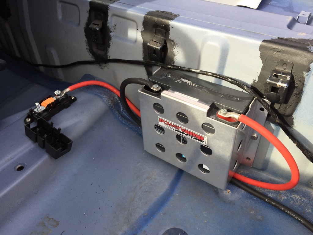

I then started crimping the cable but I only had one piece of heat shrink so need to finish it off when I get that and the M10 crimps I need for some of the terminations. I also fitted the mega fuse holder. I was unsure where was best to locate it as I don't want it to get in the way of the harnesses or seat frames in the future but also wanted it to be accessible. Anyway it's in now.

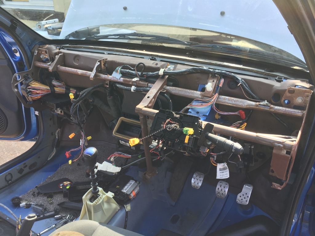

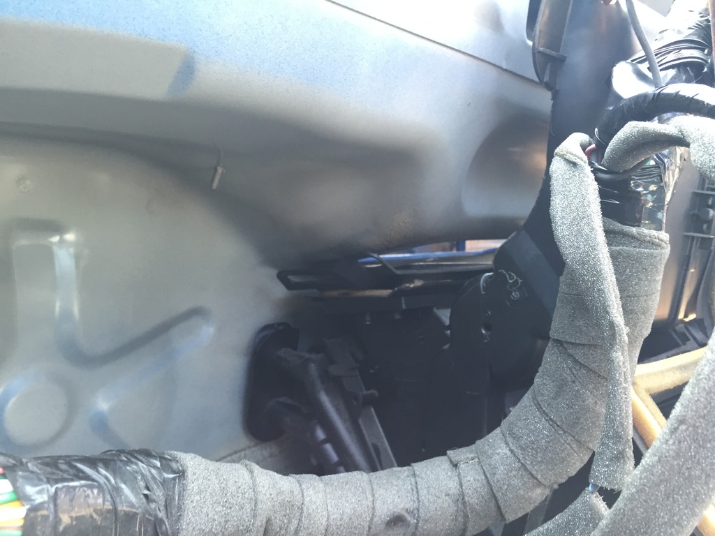

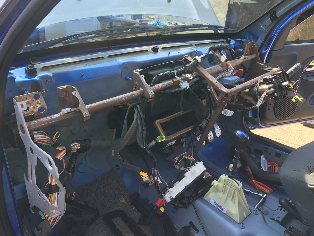

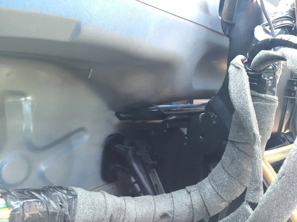

Haha. Mines in the garage looking pretty similar. The top dash comes out so easily you might as well whip the bottom dash out next... At least that's what I thought! Need to put it back soon but I think it might be tricky.
Ph1 Tom
The thought of taking the bottom dash out gives me nightmares.
I cheated and left it in place but loosened the dash cage off, meant I had to cut around the heater though.
I'm more worried about getting it running again. Lol.
Might have been wise cutting around the heater as the matrix box now sits about 5mm from the ducting for the windscreen
I also got the Stanley knife out and just cut the foam off at the heater. I've been super lazy so far and left the foam in on the driver's side as the pedal box is there lol. I'll get round to it but need to focus on getting it on track, can tidy up next winter.
Part of me wanted to take it all apart just to learn. Plus I have the steering colum to change and wiring to strip out. With me also having the donor car I wasn't too bothered about breaking anything and have lots of parts I can refurbish and swap out.
I want to cut the dash down to save weight which will expose the frame which is little tatty so might spray the one from the other car and swap them out.

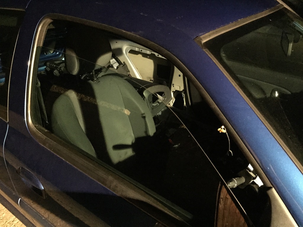

Well it rained last night! The drivers seat is now soaking. lol

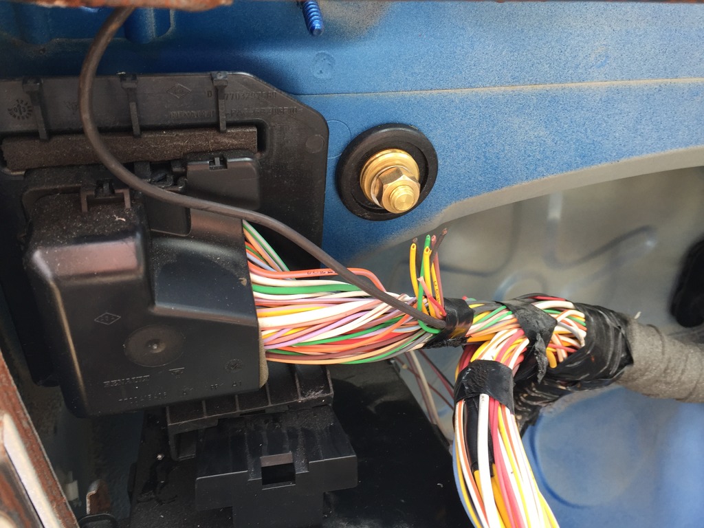

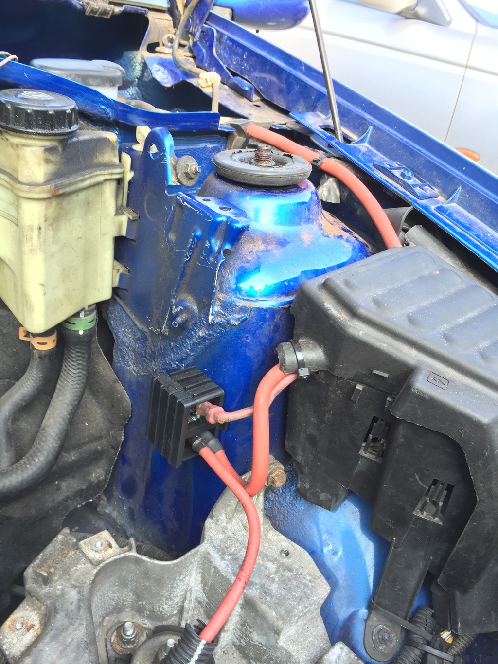

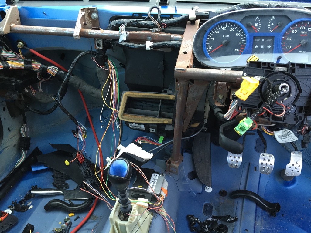

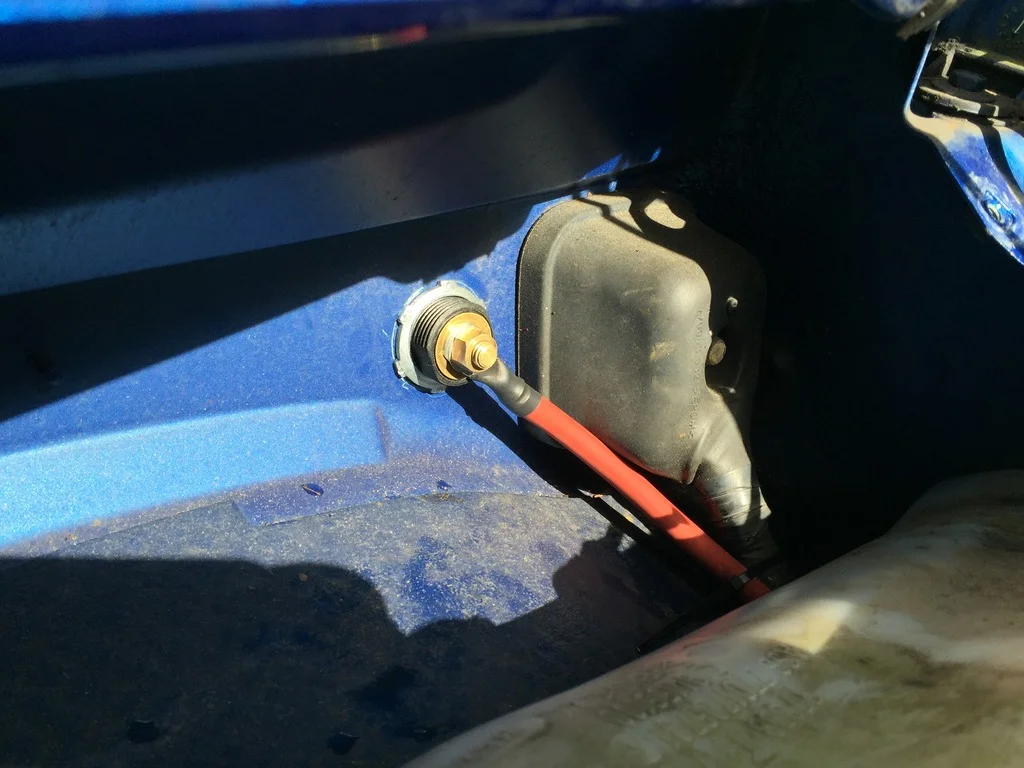

Anyway I managed to get the battery wired up this afternoon.
Inside I have just gone straight from the bulkhead to the mega fuse as I still have the dash out. Once sorted I will wire up the cut off switch properly.
I got the window up and the engine started no problem on the battery. I unplugged the air bag control unit and it still ran ok. Then I went totally daft and cut the loom that went down to to the air bag control unit and OBD2 as the GEN2 ECU doesn't use the OBD2 anyway. Now the engine wont run. I plugged the clocks in to see what was going on and the STOP light was on the dash. Other things worked like the blowers but the central locking and electric wondows dont work either. What a d*ck! I even tried putting the wires back together but I have decided it was a silly thing to do but am just glad I have another loom to play with and this time do things more carefully! lol

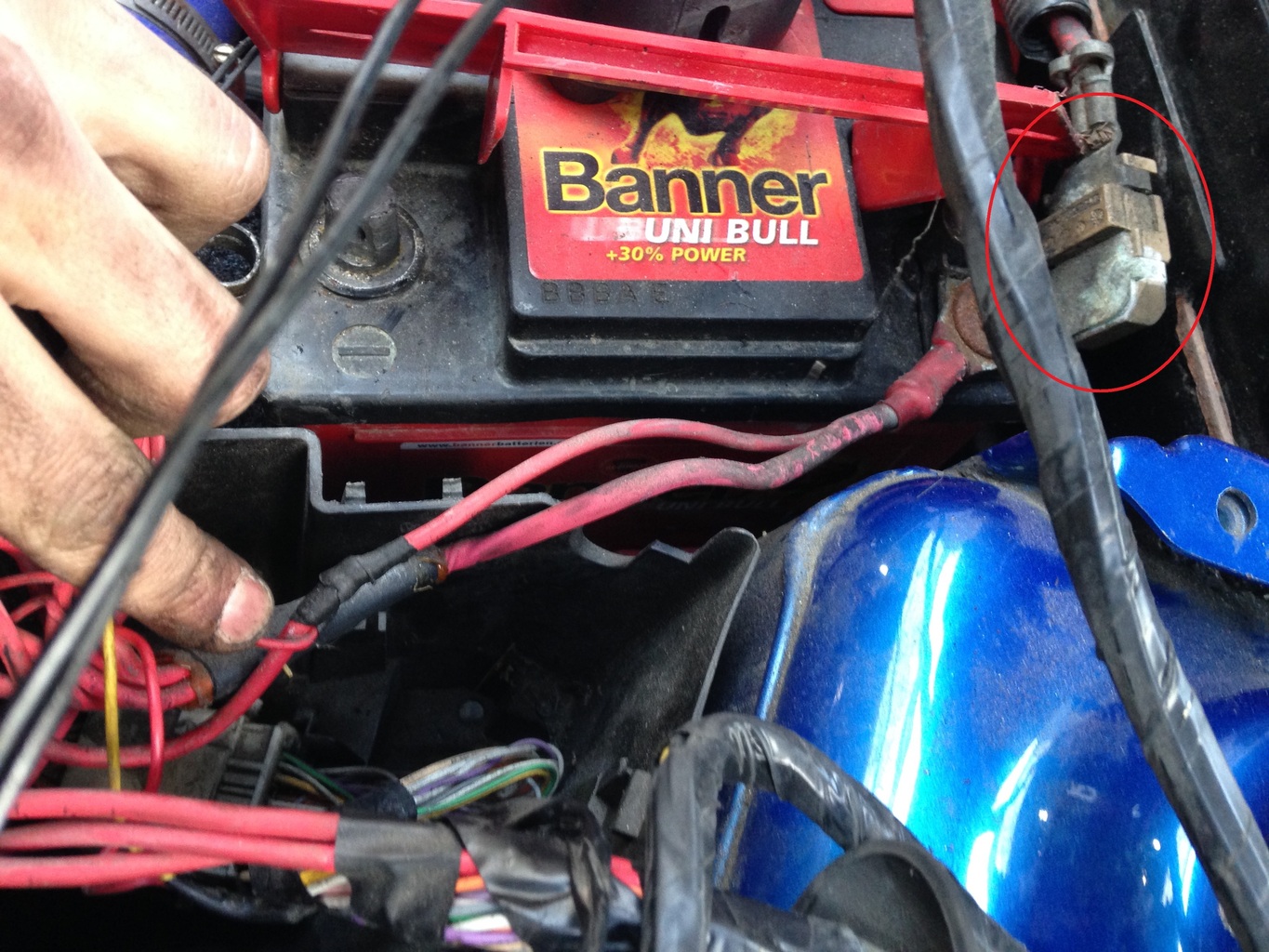

I always enjoy reading your thread Mark. I'm going to do the same with a battery through terminal. What's that lovely great big crimper you've got for your battery cables! I need one :)

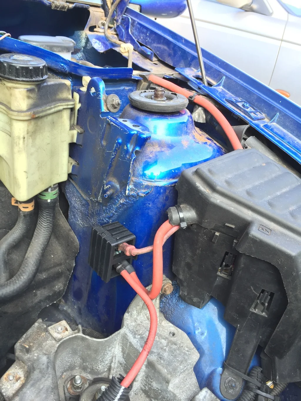

One more question. Does that block on the positive battery terminal fit in that big cable connection box? I've got one but haven't fitted it yet.

As for the last question I don't fully understand what you mean but I snipped the original cable that goes from the starter to original battery terminal. The other cable that originally goes to the battery already has a crimp on that fits in the connector block with no problems.

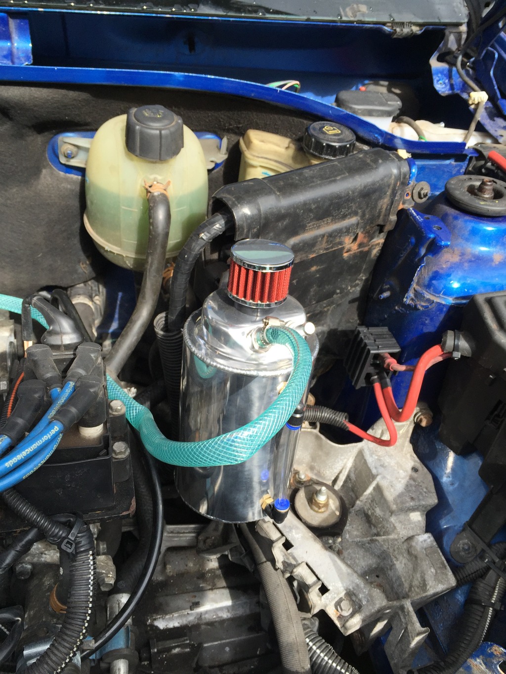

Fitted a 2 Liter oil breather tank too. Most people seem to use a Mocal but they seemed very expensive so thought I would try my luck with a cheaper alternative. Hopefully this will pass the MSA scrutineers.
The hose looks out of place though so will look at replacing that.

Yes my wording wasn't brilliant. I meant the block which is on the positive terminal of the battery in the engine bay. Does it fit in the connecting block? Pic should help.
